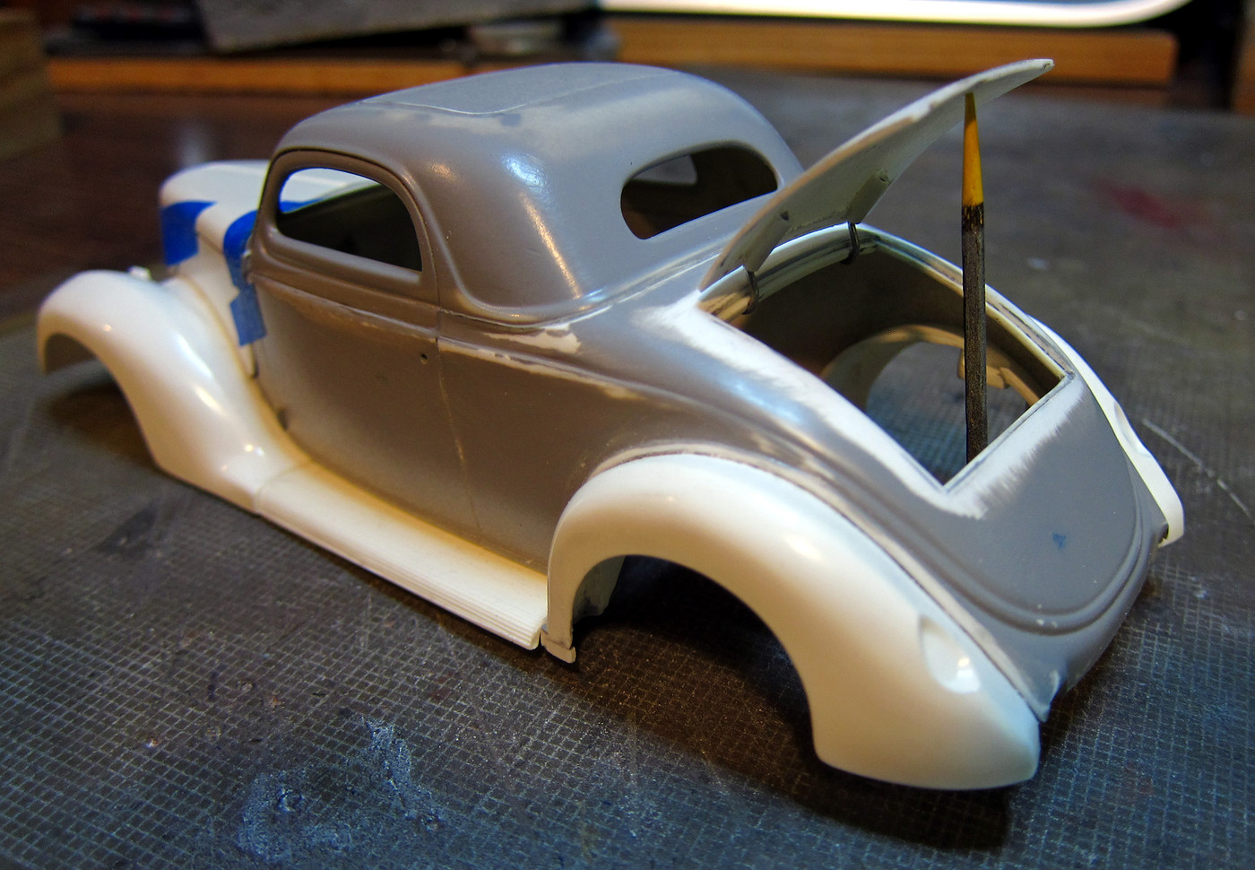

Deck lid fitted:
664 36 Ford wip
And hinged:
666 36 Ford wip
And a bunch of other little things to numerous to mention. Wow, nothing fits very well at all on this kit without a lot of massaging, but I'm having fun so far.

One thing that sort of stands out is the moldings where the body and the top join. The molding under the side window that matches the door skin ends at the back edge of the door. This could be blended into the body with a small addition of plastic in that area. I wonder if the Chopped Top is based on the option from the AMT '36 Ford Coupe/Roadster kit ? Overall the body looks good.
Thanks for that, David. As you probably know, the tops on these things are notoriously hard to match up well. Still some tuning to do here as I get further into it, but I think some of what you might be seeing is where the primer has been sanded away as I tried to get the top to match the body. I'll see what it looks like once I've shot a little more primer on it.
Edit: On third look, you're absolutely right, David. I went back and added a little plastic and putty on the right side and a little putty (only) on the left.
Edited by RancheroSteve

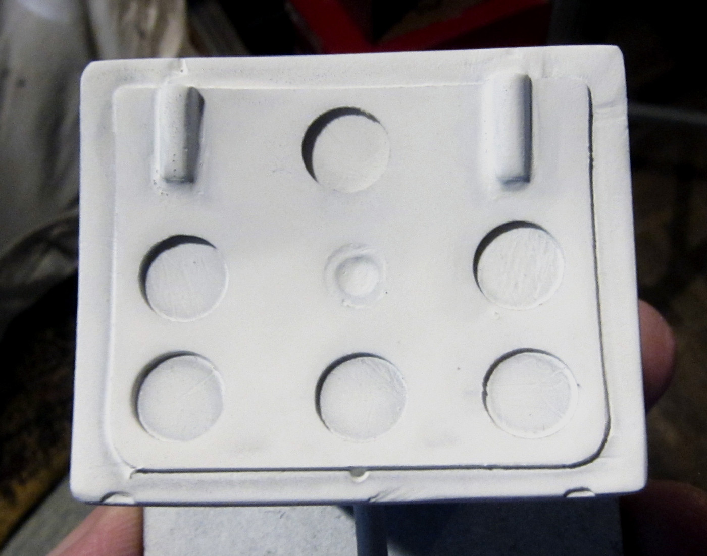

In case you haven't seen one, it's a beautiful kit, extremely well done. One thing led to another and I soon realized the frame and interior pan is a near drop-in to the '36 body. Here's the frame assembled and painted. The only alteration is adding a battery box under the seat (the stock '36 location).
