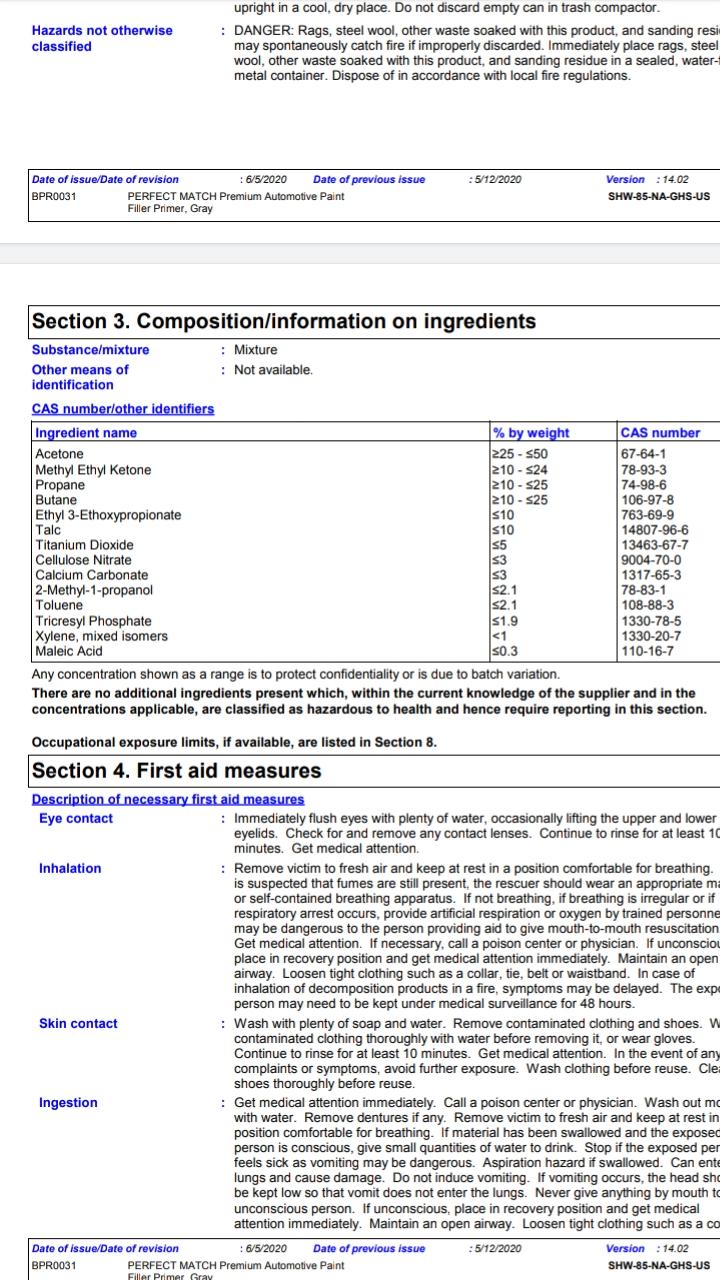

Dodge Driver Posted August 11, 2020 Posted August 11, 2020 For the sake of comparison, here are the formulations of Duplicolor Hot Rod primer and Perfect Match Scratch Filler primer.

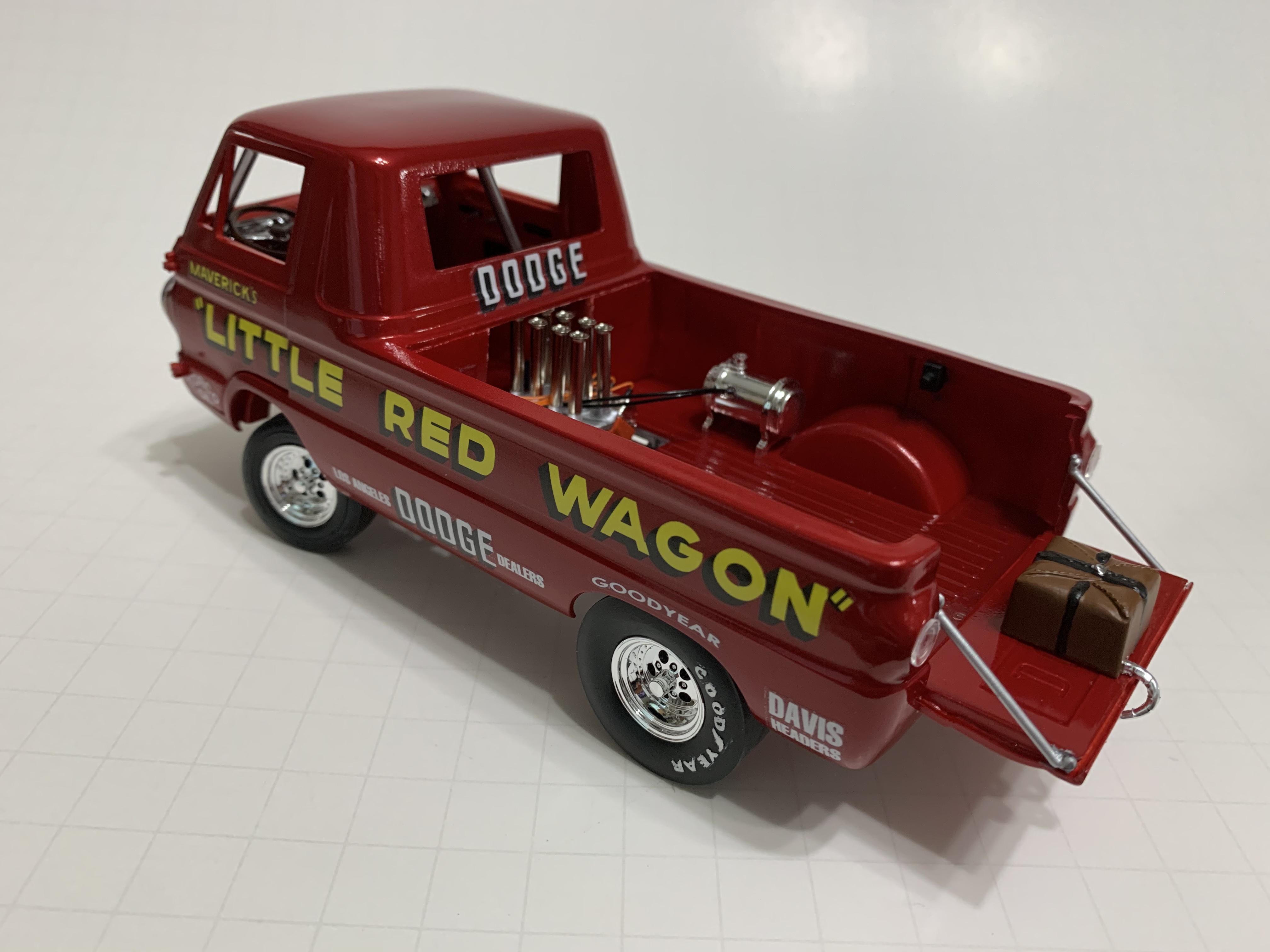

BeakDoc Posted August 11, 2020 Posted August 11, 2020 On 8/10/2020 at 3:13 PM, Ace-Garageguy said: I haven't tried it yet. I'm about to do some testing under hot Duplicolor rattlecan colors...as soon as I have time. Steve Guthmiller may know the answer. Expand I sprayed Duplicolor Inferno Red over Tamiya pink primer on this “Little Red Wagon” build and was thoroughly impressed with how the two worked together. Prior to going full-bore, I did test it on the stock engine cover from the very same Lindberg kit because I knew I wouldn’t be using it in the build. I try to stay away from mixing manufacturers paint/primer/clear, so this is the only example I can produce as evidence that Tamiya primer and Duplicolor paint can coexist on styrene.
randyc Posted August 11, 2020 Author Posted August 11, 2020 On 8/11/2020 at 11:12 AM, Dodge Driver said: For the sake of comparison, here are the formulations of Duplicolor Hot Rod primer and Perfect Match Scratch Filler primer. Expand I see enough differences to make me at least wonder. Thanks for the information.

Ace-Garageguy Posted August 11, 2020 Posted August 11, 2020 (edited) On 8/11/2020 at 11:12 AM, Dodge Driver said: For the sake of comparison, here are the formulations of Duplicolor Hot Rod primer and Perfect Match Scratch Filler primer. Expand Good info. And one BIG takeaway is the fact that both products can be anywhere from 25% to 50% acetone. Acetone is a hot solvent, and can be used on its own as plastic cement...because it melts styrene. No surprise it causes crazing on some model parts if a heavy coat is applied. The second product can also be between 10% to 24% methyl ethyl ketone...STRAIGHT PLASTIC CEMENT. EDIT: Note that the allowable variations in percentage of solvents can easily account for variations in coverage as well as crazing from batch to batch. Obviously, a can that's 50% acetone is going to cover worse and craze more than a can that's only 25% acetone. Edited August 11, 2020 by Ace-Garageguy
Ace-Garageguy Posted August 11, 2020 Posted August 11, 2020 On 8/11/2020 at 12:20 PM, BeakDoc said: I sprayed Duplicolor Inferno Red over Tamiya pink primer on this “Little Red Wagon” build and was thoroughly impressed with how the two worked together. Prior to going full-bore, I did test it on the stock engine cover from the very same Lindberg kit because I knew I wouldn’t be using it in the build. I try to stay away from mixing manufacturers paint/primer/clear, so this is the only example I can produce as evidence that Tamiya primer and Duplicolor paint can coexist on styrene. Expand Nice example, good info. Thanks. Like you, I'm wary of mixing materials from different manufacturers. I've seen countless cowboys in real-car paint shops having all kinds of issues...and mindlessly wondering why...simply because they assumed everything would work with everything else. Wrong.

slusher Posted August 11, 2020 Posted August 11, 2020 On 8/11/2020 at 12:20 PM, BeakDoc said: I sprayed Duplicolor Inferno Red over Tamiya pink primer on this “Little Red Wagon” build and was thoroughly impressed with how the two worked together. Prior to going full-bore, I did test it on the stock engine cover from the very same Lindberg kit because I knew I wouldn’t be using it in the build. I try to stay away from mixing manufacturers paint/primer/clear, so this is the only example I can produce as evidence that Tamiya primer and Duplicolor paint can coexist on styrene. Expand I have used Duplicolor over Tamiya primer. When finding my favorite primer began to be a pain I went with Tamiya primer and love it. Walmart has a great primer but it’s not stocked often and I am not mail ordering and stocking paint and primer..
