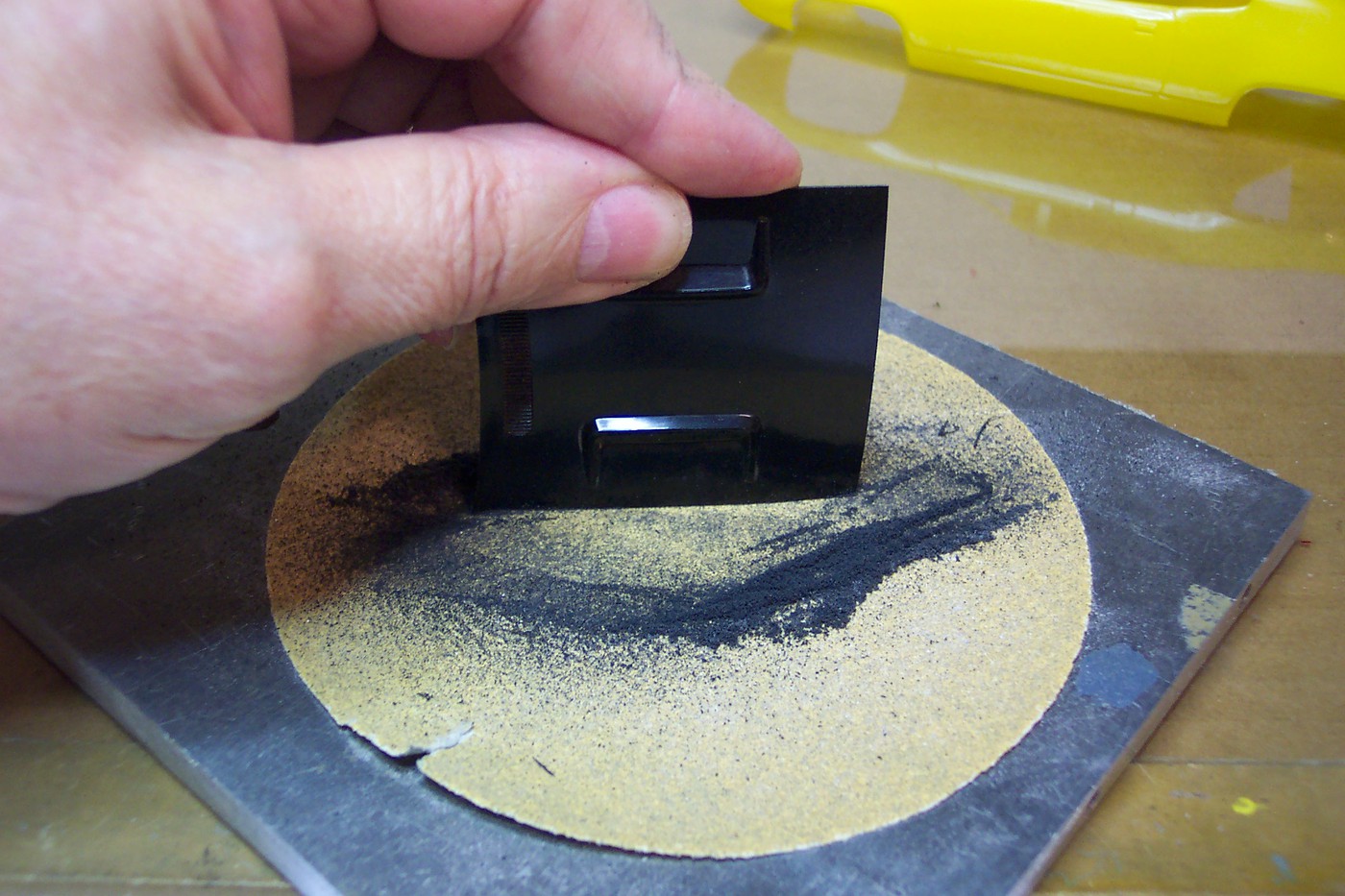

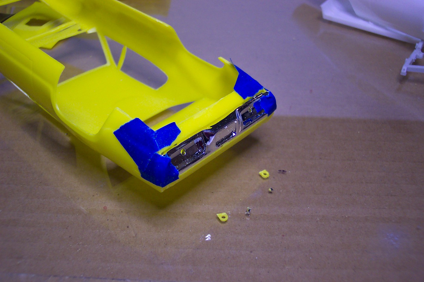

TooOld Posted October 24, 2020 Posted October 24, 2020 Been a very long time since I've posted a WIP , probably because I never finish them , but here goes . I've got both the MPC Roadrunner and a Monogram "71 Satellite kit but when comparing the two the MPC body is so much nicer it's the one I'm using . Plus it can be easily upgraded using the more detailed AMT Charger R/T kit . One part from the Monogram kit I am using is the hood . The size difference in this photo is an optical illusion , it's not that bad . Here's the actual difference . A few minutes of sanding on a flat surface and the hood fits great . Before prepping the body for paint I'm going to glue the rear valence in place using the bumper as a guide . Up next is taking the engine compartment from the Charger and adding it to the Roadrunner body . More pics coming soon !

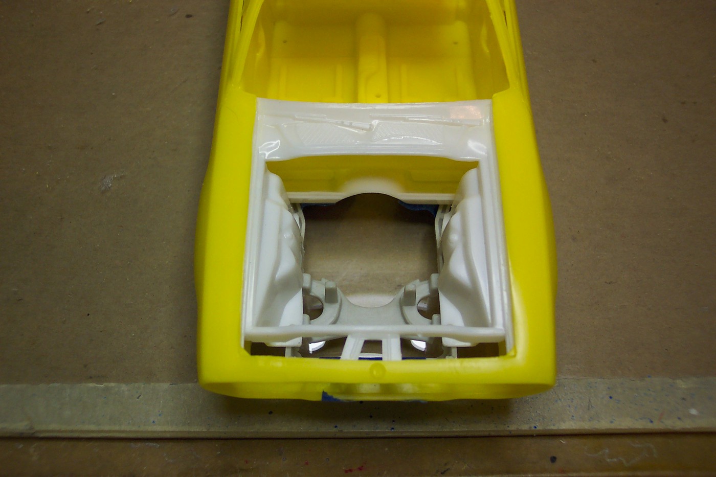

TooOld Posted October 24, 2020 Author Posted October 24, 2020 On 10/24/2020 at 11:50 AM, Mr mopar said: Bob it's looking good so far ! Expand On 10/24/2020 at 4:20 PM, espo said: A lot of splicing and dicing but it sure looks good. Expand On 10/24/2020 at 5:00 PM, bisc63 said: Really enjoy these projects that meld the best of available parts, and this is a nice body style, so I'll be following! What shade of red are you painting it? (hint hint...) Expand Thanks for looking guys ! Haven't decided on a color yet , still looking at pics on the internet . I used a razor saw to cut the engine compartment from the Charger body . Then a Dremel and file to remove the extra thickness caused by remnants of the body . First test fit using the MPC interior tub and the Charger chassis . I've done a few chassis swaps like this before and this is definitely the easiest one yet , the Charger chassis fits right into the MPC body . The only modification was to snip off two locating tabs at the rear and two small frame extensions at the front . Also there was some grinding in the tunnel area so that the interior tub would fit on the chassis .

TooOld Posted October 25, 2020 Author Posted October 25, 2020 Engine compartment is glued in place after I added some flanges made out of styrene strips to the sides , also added a new hood latch plate . Here I'm fitting everything to make sure there are no surprises later on . Firewall , dash , and windshield are from the Charger . . . everything fits great !
