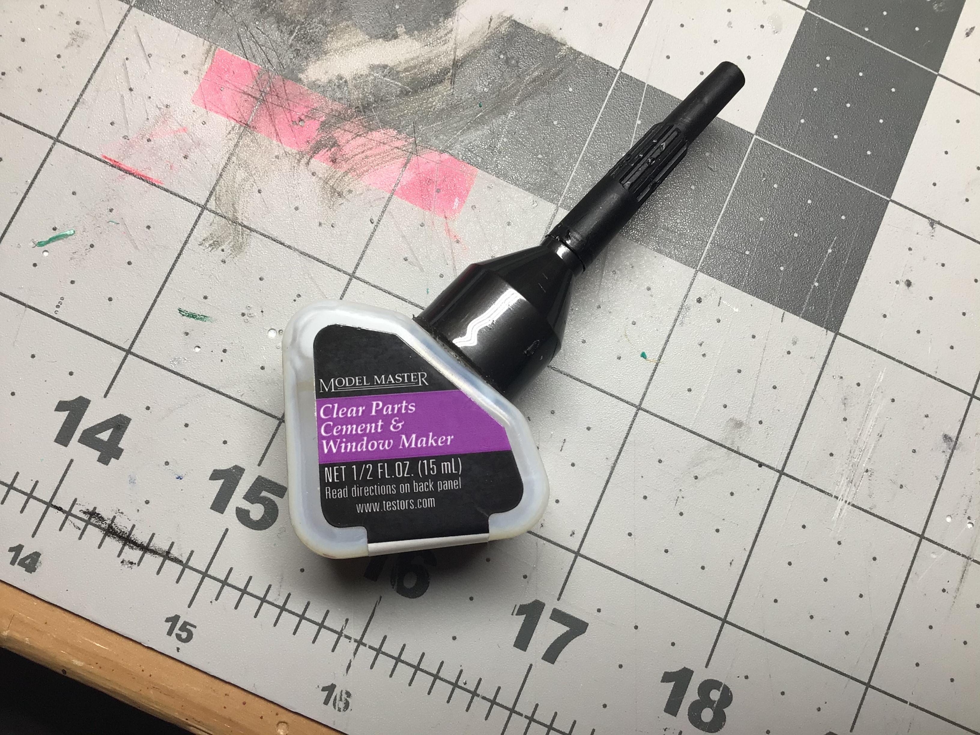

NOBLNG Posted December 9, 2020 Posted December 9, 2020 This is what I use because I have it. It is most likely a watered down PVA of some type.

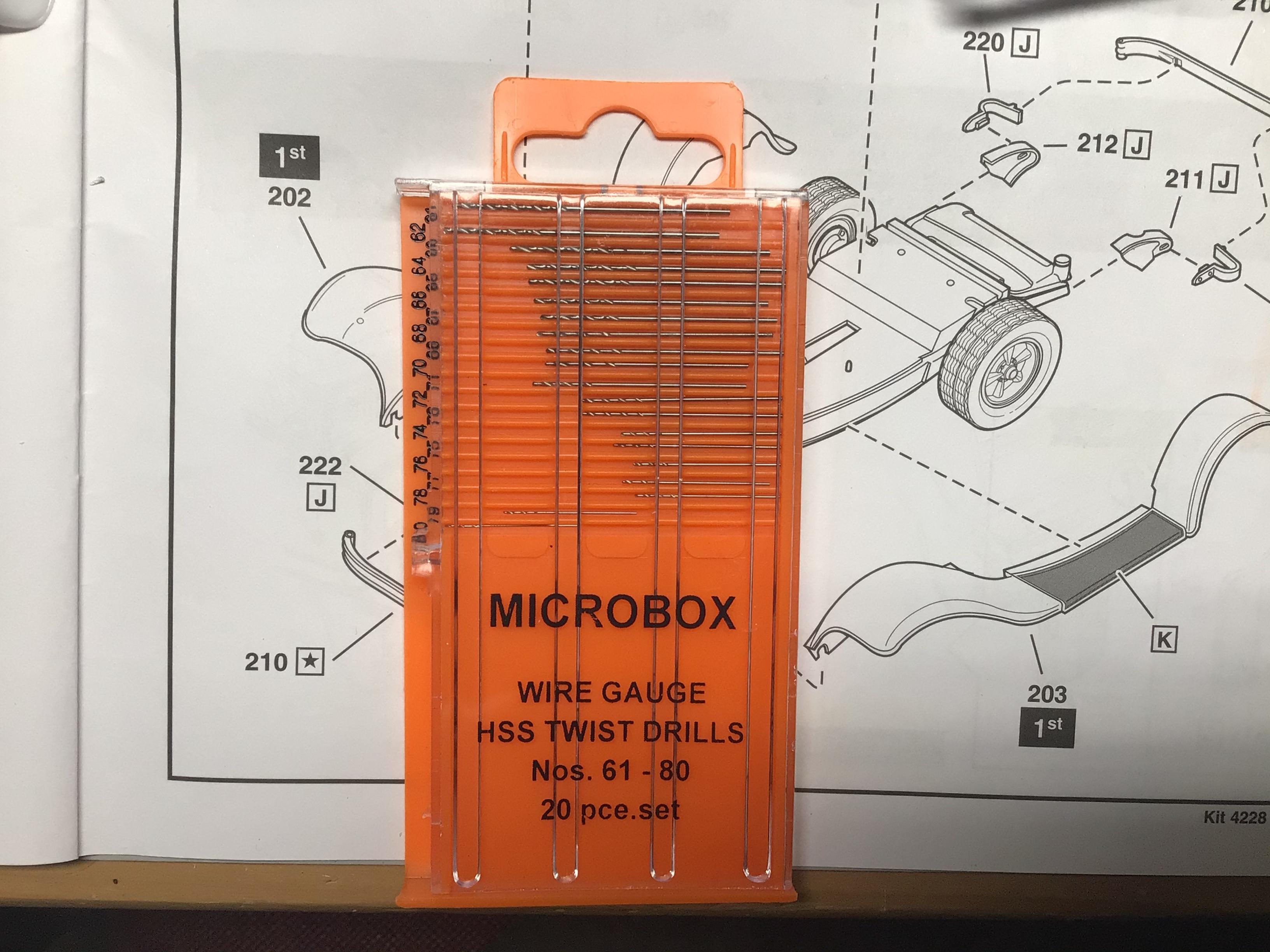

Tom Geiger Posted December 10, 2020 Posted December 10, 2020 I assemble a lot of my parts with straight pins. I believe it’s a number 72 drill bit. I wouldn’t be too keen on drilling through clear plastic as it’s brittle. If I did I would be using my small battery power drill. I’d put blue tape over the glass and drill through it to avoid scratching the glass in case of slippage and to avoid chipping at the hole. You could try to drill both the glass and frame at the same time, but I’d opt to drill the glass flat, then tape it in place using the holes as the template to drill the body. I would check the pin head size, I believe it’s too large. There are pins with smaller heads, check a crafts or sewing store.
peteski Posted December 10, 2020 Posted December 10, 2020 Josh, Most modelers have a set of #60-#80 drill bits in a standard drill index. See the following thread for some good info about drill bits. Don't get the cheap ones from Amazon or eBay. Get the more expensive drill set from a reputable industral tool supplier. More info below. Some sources are given there by Pete J. and others. The stainless steel fine silk pins I use are 0.021" in diameter. So for those bit #74 (0.0225") would work well. Melting the holes on plastic is not a good ideal. That would leave a berm around the hole.
NOBLNG Posted December 10, 2020 Posted December 10, 2020 Good info in that thread! I just bought these Vallejo ones the other day, and they are very good quality (made in Spain) and properly sharpened. I would not try melting the holes either, it will make a mess.? What kind of paint is that? If it’s laquer or enamel the canopy glue shouldn’t harm it.

Bills72sj Posted December 10, 2020 Posted December 10, 2020 On 12/8/2020 at 7:57 PM, NOBLNG said: This is what I use because I have it. It is most likely a watered down PVA of some type. This what I use as the 2nd step. I first use Testors red (tube) in just a couple of hidden places to give it a strong tack to the roof. I then use a toothpick to "wick" in the Clear Parts Cement pictured above, to COMPLETELY seal the entire perimeter but not all at once. Since the glue will run slowly I tend to do one or two sides at a time and position the parts as to have the excess flow AWAY from the window frame. It some times takes 4 or 5 daily applications to completely seal in a window. I use the same method for attaching chrome bumpers to minimize the "air" gap between the body and bumper. The pieces stay well attached since they are adhered on their entire perimeter.

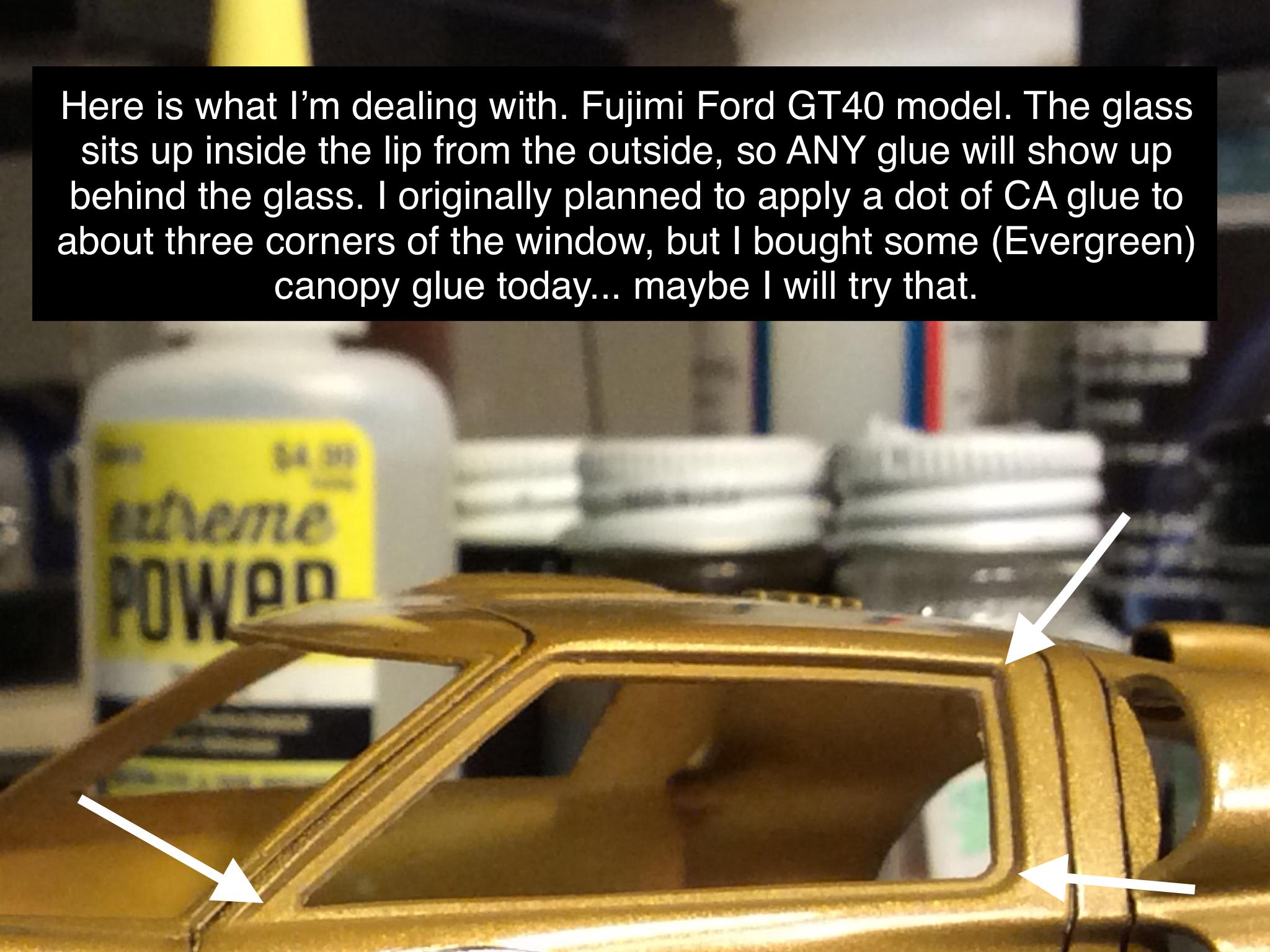

Kit Basher Posted December 10, 2020 Posted December 10, 2020 FWIW, I recently finished the same GT 40. I also painted the inside of the windows (black). I used a thin layer of epoxy in the rabbet where the window goes. The windows fit well, so just placing them in the opening worked fine. No pressure, so no squeeze out. The hardest part for me was painting silver all the little nibs on the windows that represent the screw heads.
