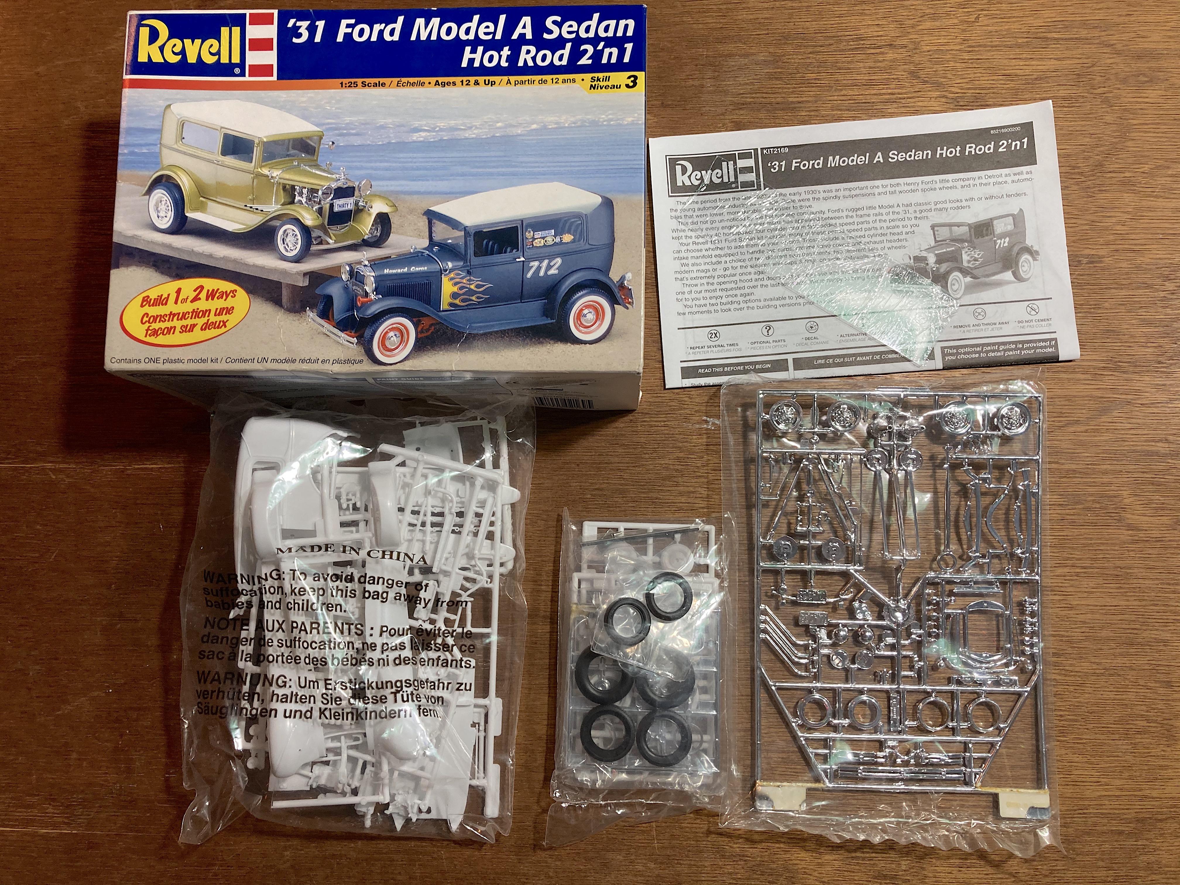

Found on Fakebook Marketplace, arrived today.  I did a quick study to compare to the Roadster, 2004 for the Sedan, 2019 for the Roadster, I will say the quality of the newer kit is much better.  The Sedan has the original four banger engine and rear axle.  I am surprised there are two frames in the Roadster kit, the blower version fits inside the fenders better, but I would rather do the other engine.  I hope the hood fits over the V8, and I can run the exhaust inside because I don't want the header pipe outside.  I really like the mags on the Roadster, so going that route, it won't be important to exactly match the real car.  It will be interesting to see how much of the Roadster I can keep to qualify for the class.
12 hours ago, Spex84 said:
The tooling on that sedan is way older than 2004!  Try 1964 :)
Oh ok, good to know!  Seeing the headlight lenses are chrome, while the new kit has clear plastic, HUGE improvement.

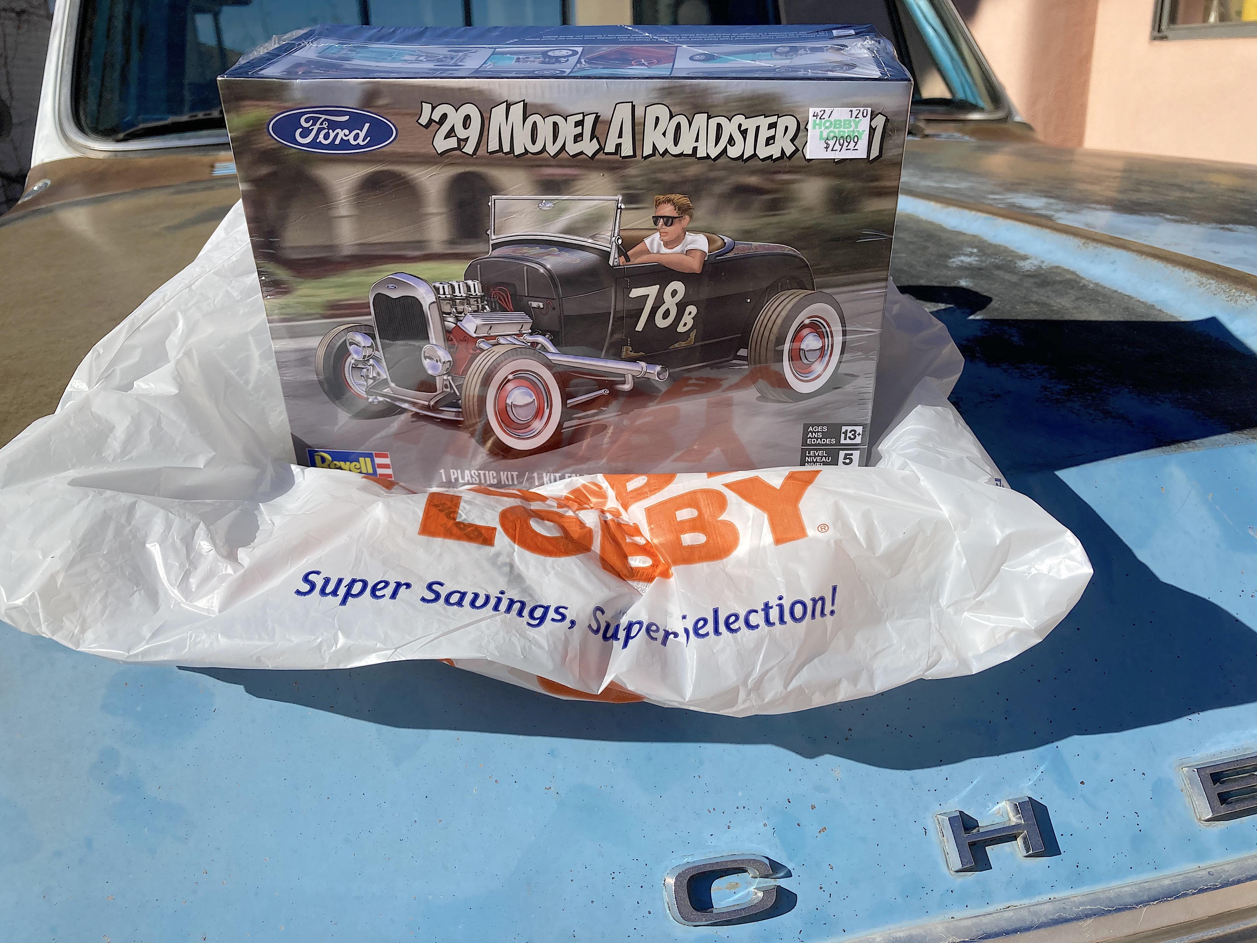

Home from the store:

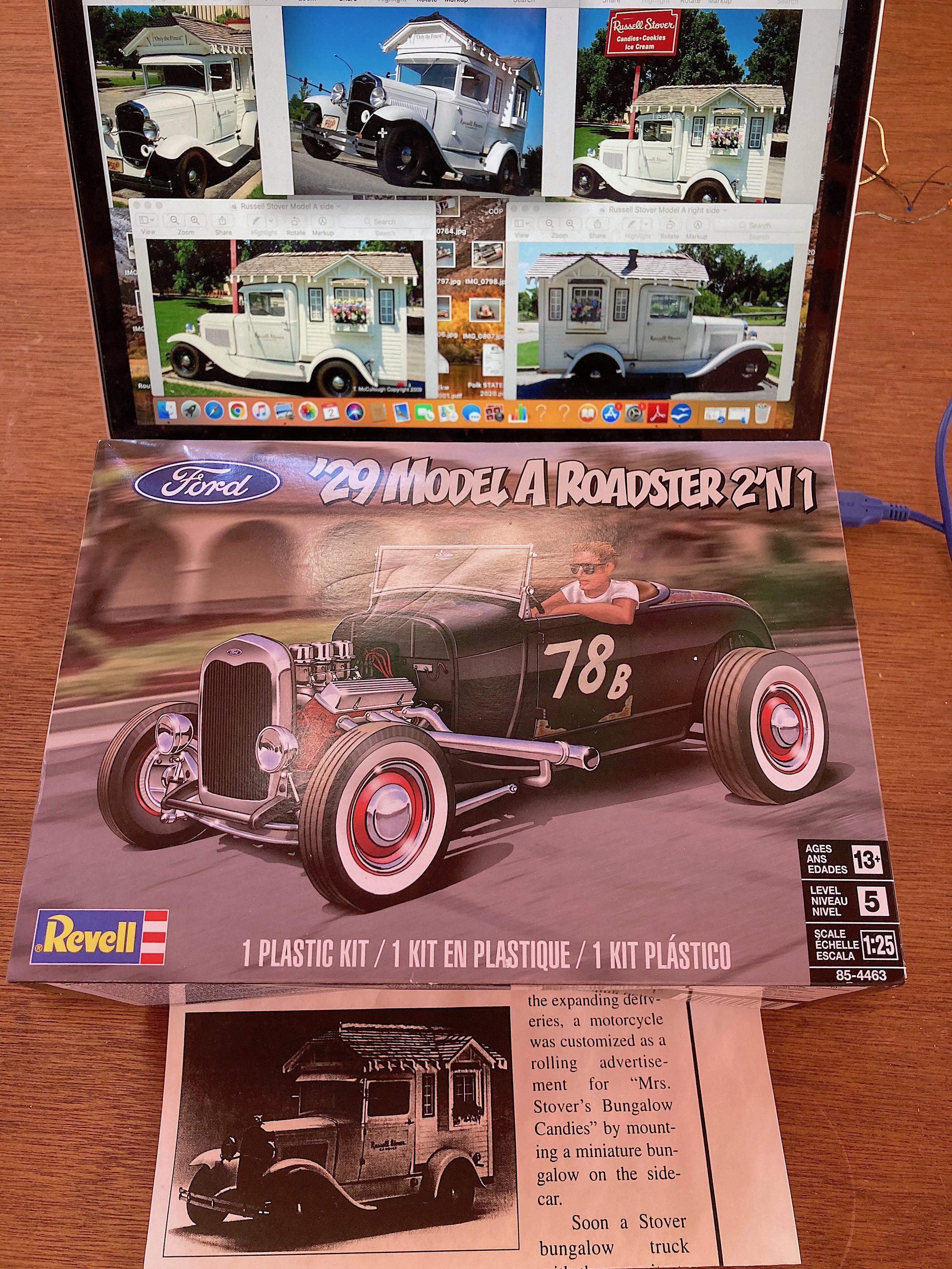

I have wanted to do a Russell Stover candy truck for a long time.  In an issue of Fine Homebuilding magazine, there was a picture that caught my attention.  The picture shows a Model A, but they also used a Dodge truck, which had a different roof design, and only the windshield was used.  In this case, I need to find someone who will part with a pickup cab if there is such a thing.  I won't post reference pictures directly to respect Copyright (in other words not violate more than I already have).  I also do woodworking, so look forward to doing the Bungalow.

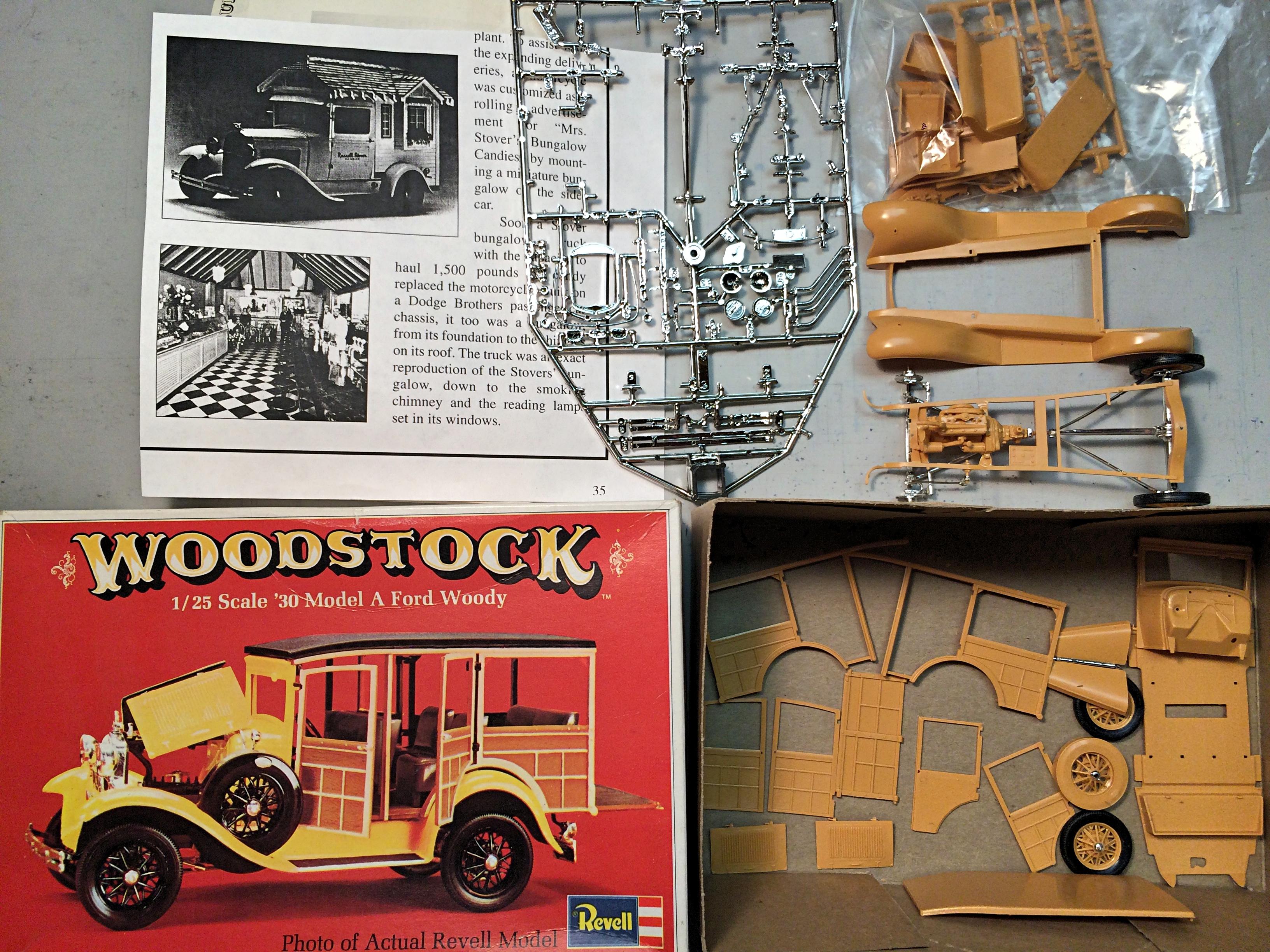

I was originally planning to use this Revell Woodstock kit, which has the fenders, hood and front bumper.  Looking at the frames, it appears these do not share any components, whoever has built these please confirm.  I could try to duplicate the one in the photos, but the hubcaps and perhaps the wheels are not like the kit's.  I'm digging the Halibrand wheels and tires, so if I stick with the engine, don't need the hood.
I have 17 months to decide on what to do, just wanted to start my WIP now to incentivize myself.

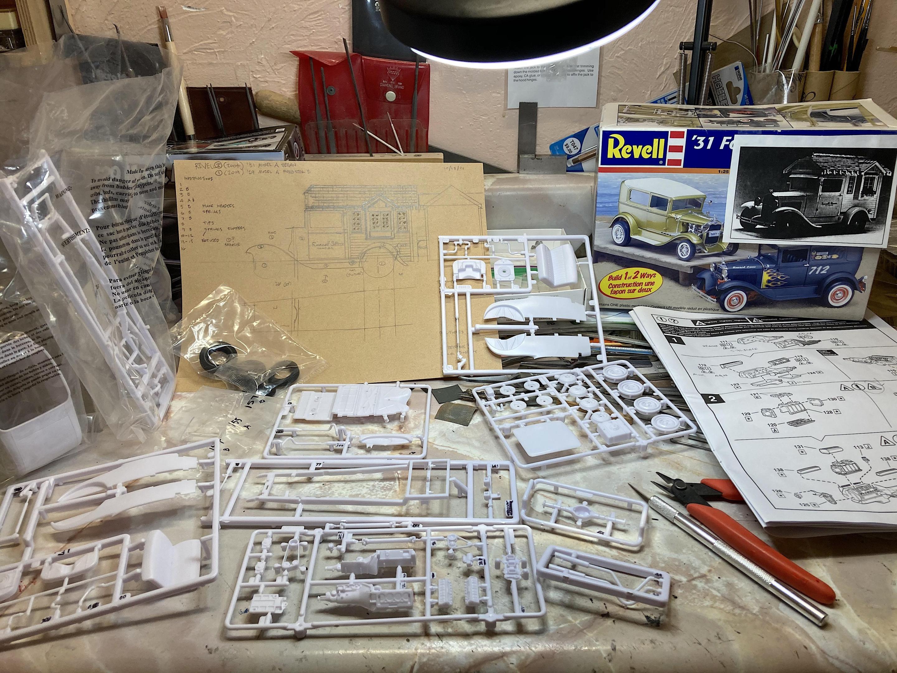

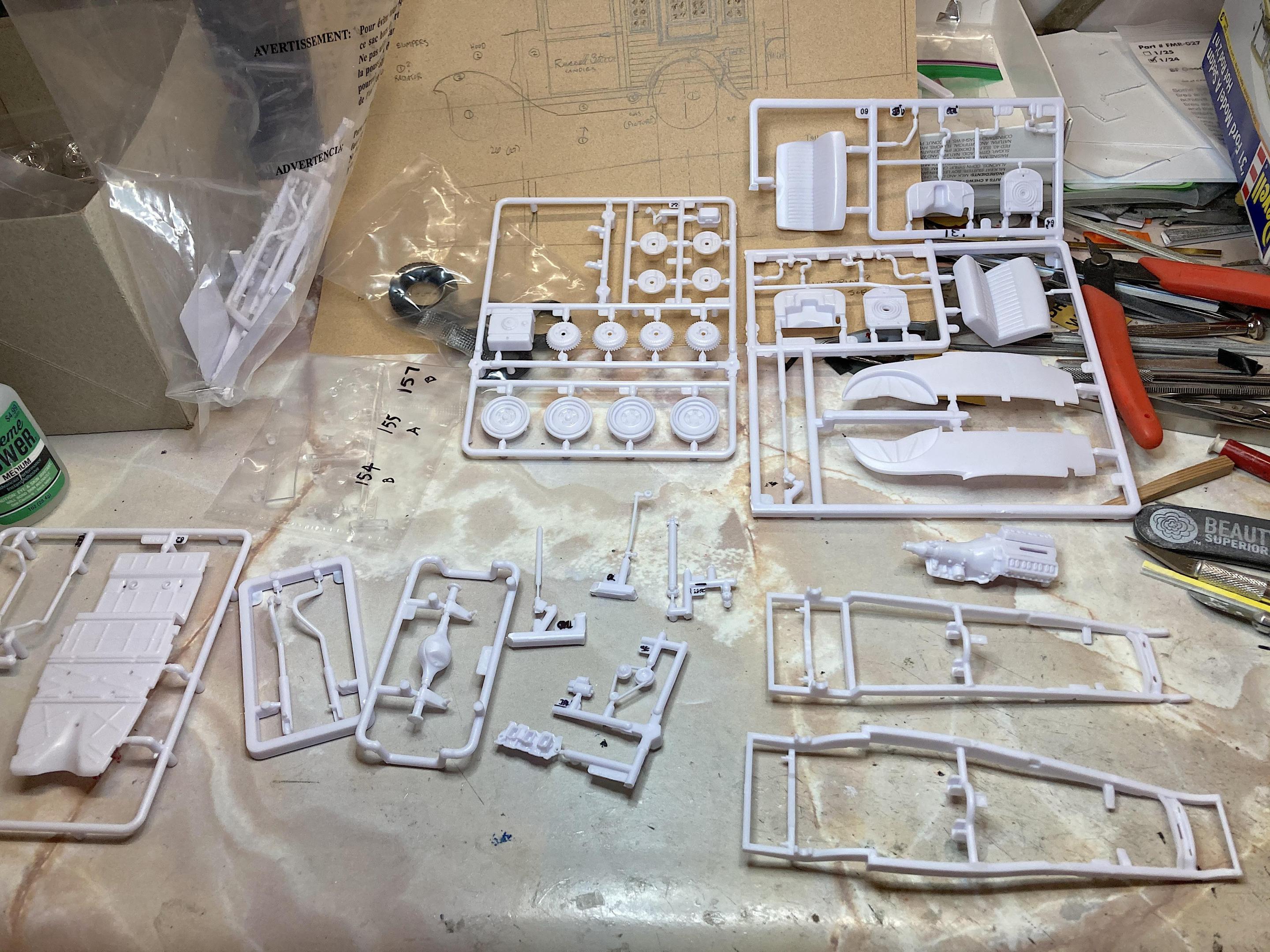

One year later, started it!  They decided to do it 2023, so I still have plenty of time, but you know how that goes.  Already have questions, so if you have built this kit, feel free to chime in.
I have a drawing of the Bungalow, but should contact Russel Stover to see if they have more photos, especially of the back.  It would be awesome to know what the inside looked like, but I might just fake it.  Marked the parts to use, could probably make another car with the left overs.

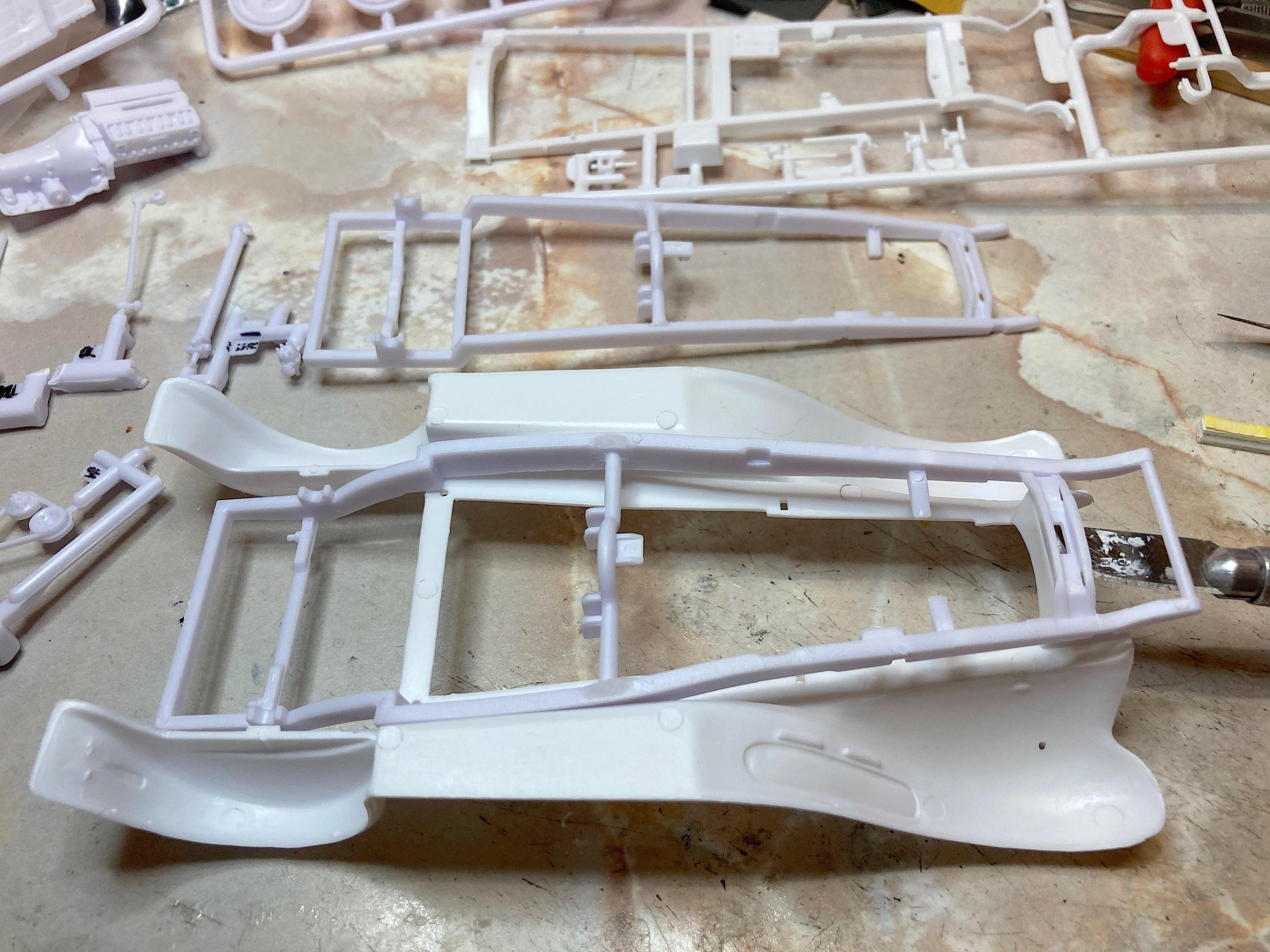

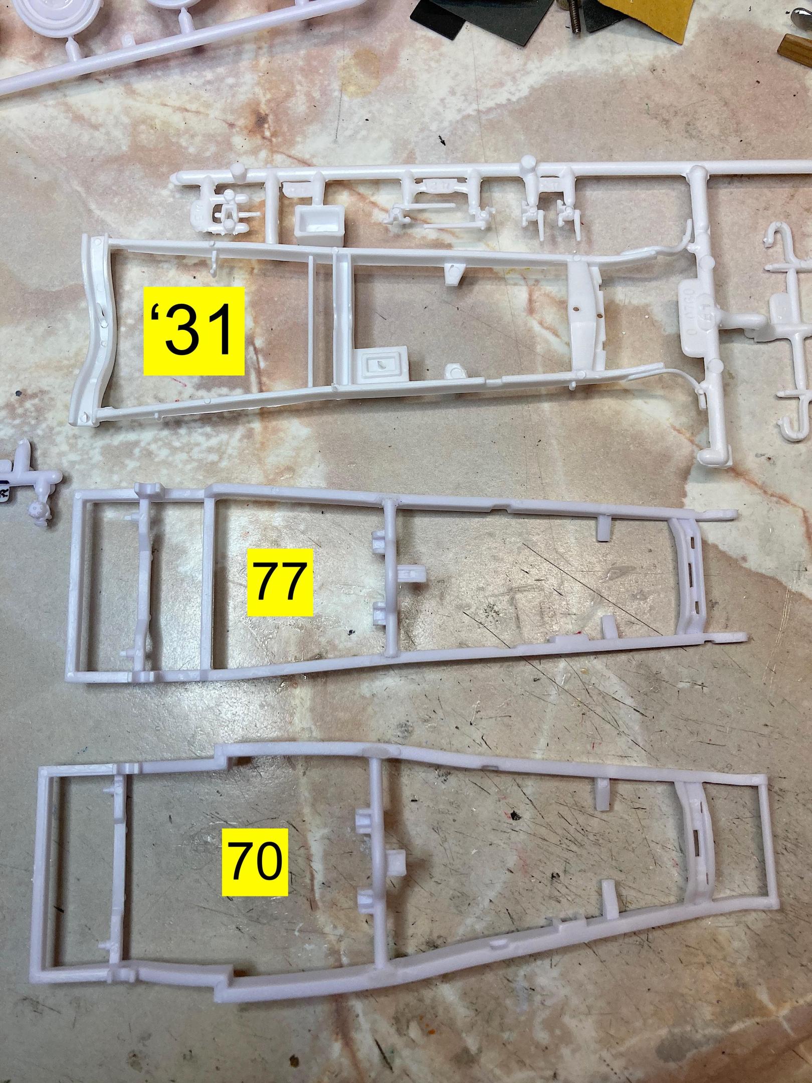

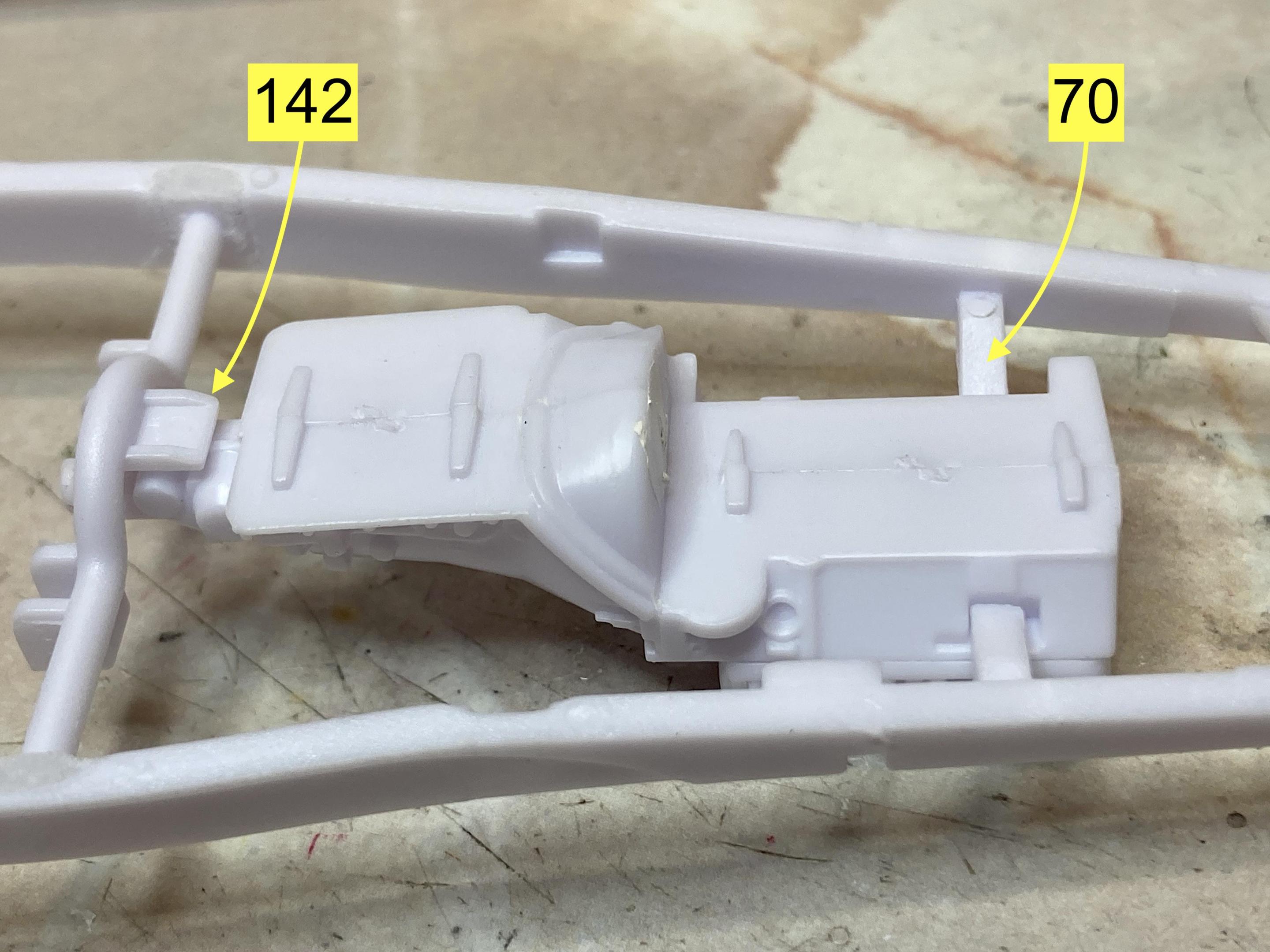

First issue encountered, one frame cross member can't be correct, the pin does not allow the engine mounts to line up.  So I've decided to use the other frame that is intended for the blower version A, can't see a reason why not.
Comparing the frames.  The front tube cross member adds strength, I should be able to add the bumper back on.
What do the fenders look like?  Well dang, there is interference of the front cross member and the body part under the radiator.  So which kit is wrong?

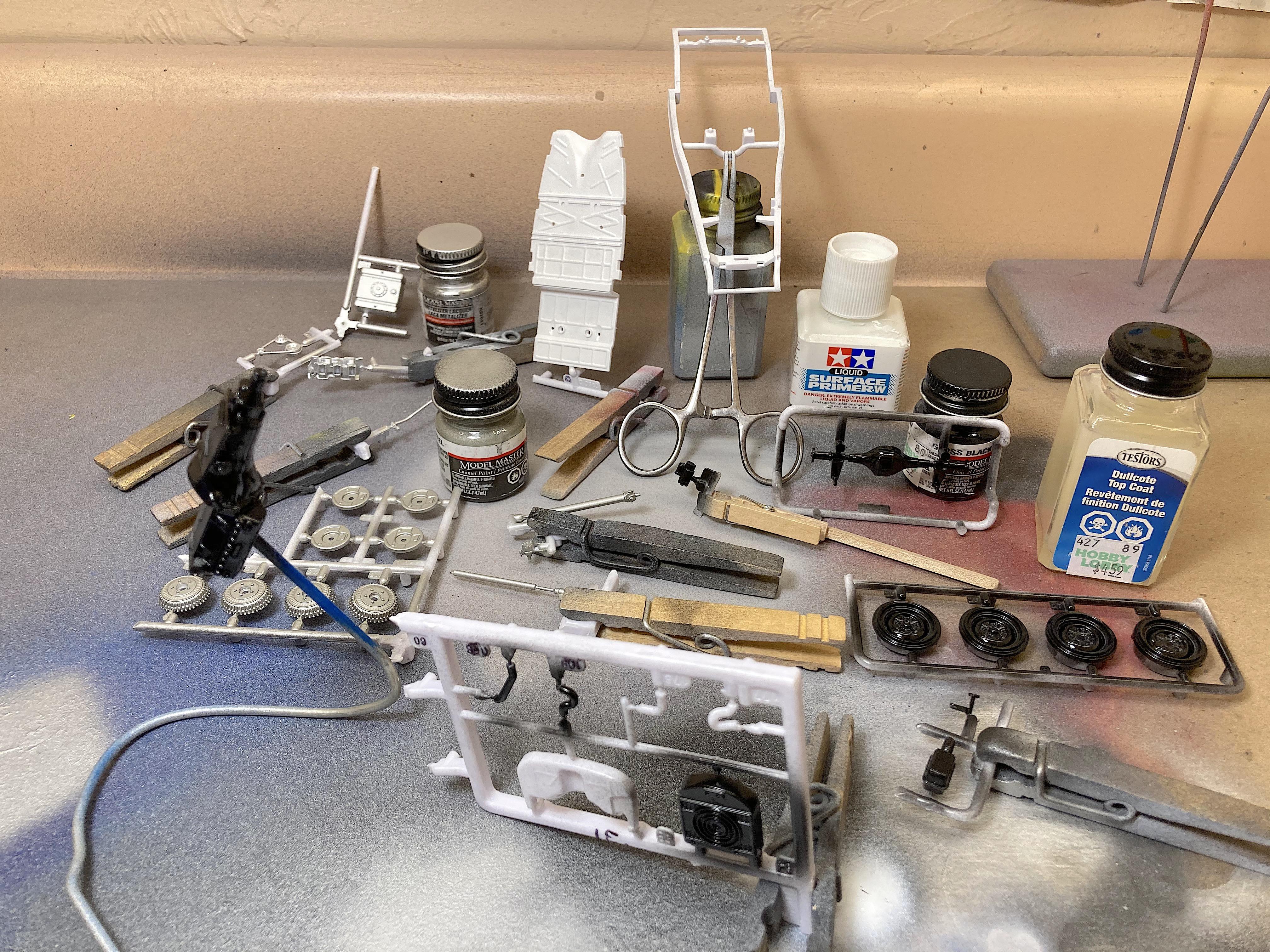

Not many parts could be glued together before painting.

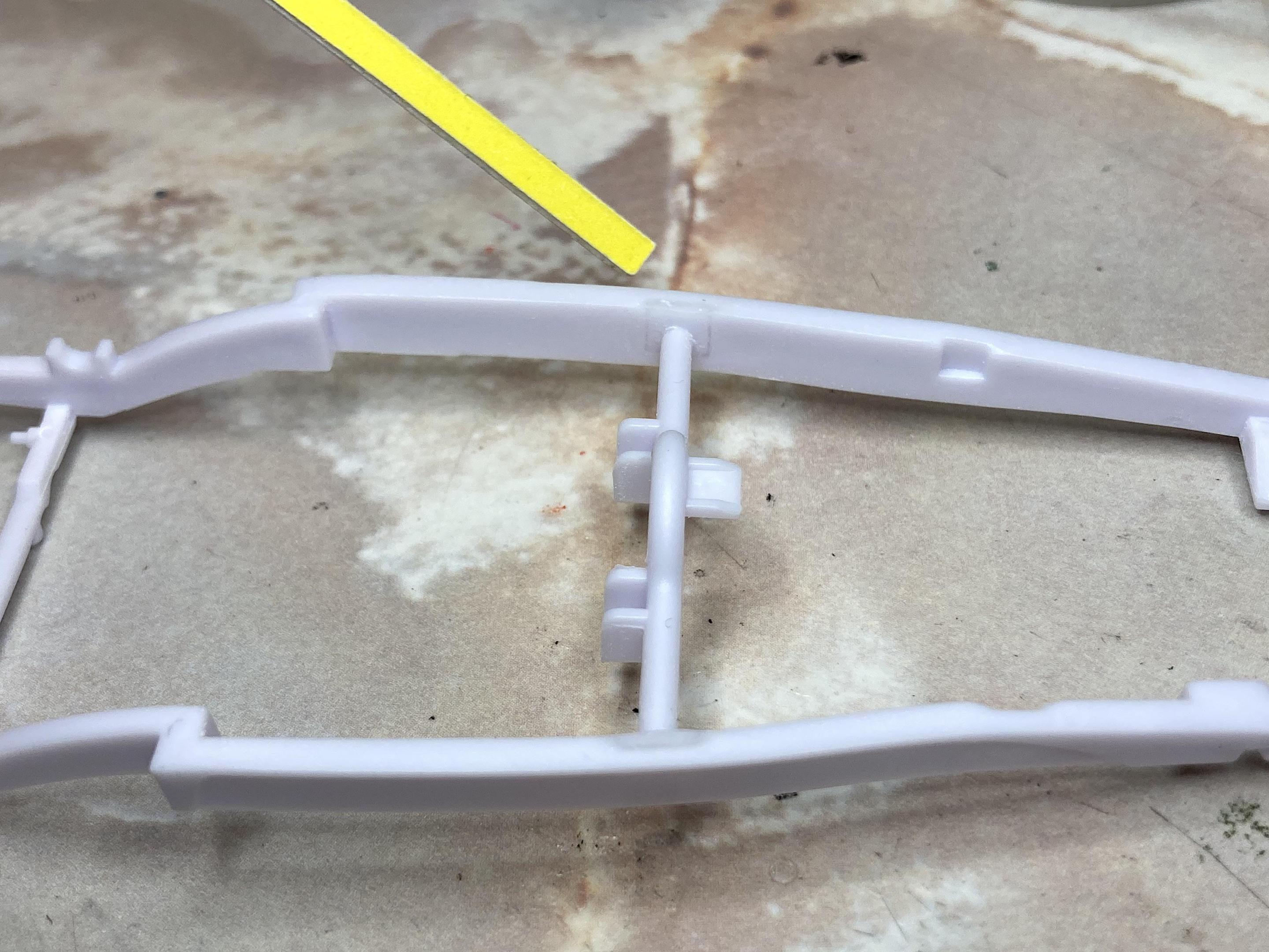

Since I picked which frame, this one needed more superglue and baking soda to fill the gaps at the cross member.
First paint session.  I will have to resist working on the black parts for awhile, since that takes longer to cure than other paint.  The Model Master aluminum is almost used up, will miss it but I have other paints that are almost as good.  I'm mixing Dullcote with gloss black to do semi-gloss.  The instructions are sort of confusing, version A with the blower shows the engine to be orange, and the transmission as aqua.  Really?  Good thing version B is semi-gloss black, looks much better with chrome.  Frame got Tamiya primer, am thinking of painting gloss chocolate brown.  I think black wheels are better than red for this car.

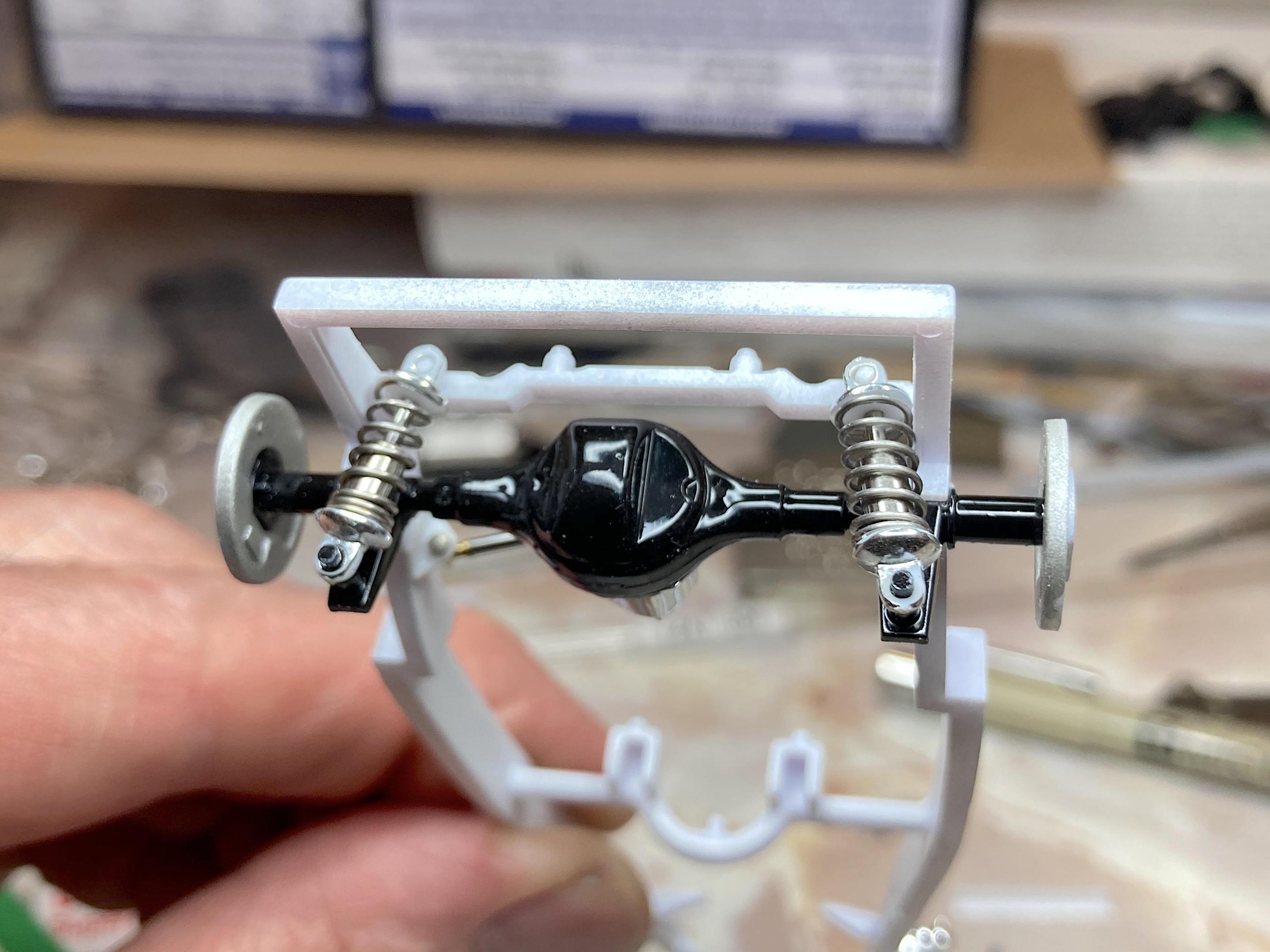

Another question, does the rear axle really glue to the frame?  That would mean no travel at all, like a Hardtail Harley.  There are coilover shocks, those are going to be replaced with scratch-built units, and the front will get coilovers.

Those axle "holders" (locators) are molded into the frame for less accomplished builders who might struggle with getting the axle to sit property when using the coil overs and radius rods as the only locators. On most of my builds with this frame, I used the holders to mockup and glue the coil overs and radius rods to the rear axle/diff, then cut away the holders before painting the frame.  Very easy and big improvement in realism for those of us all who actually care about these things.

Good, thank you for checking in!  That makes sense, and only a few of us would really care about that.  Now I need to shift gears about order of painting, again.

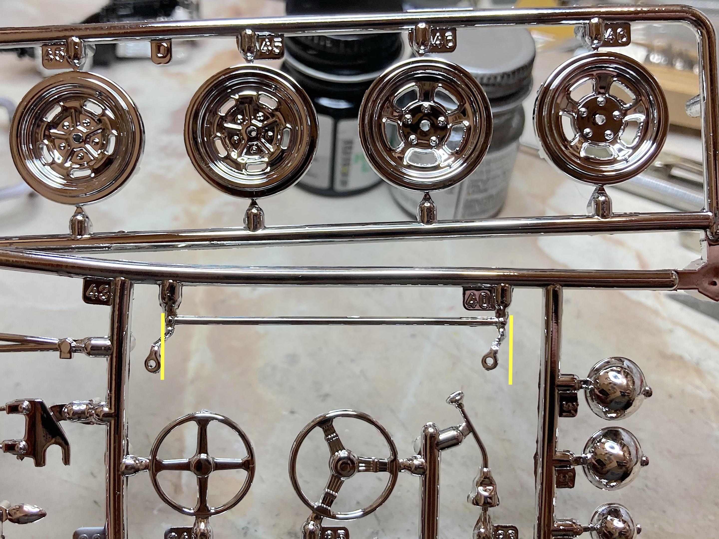

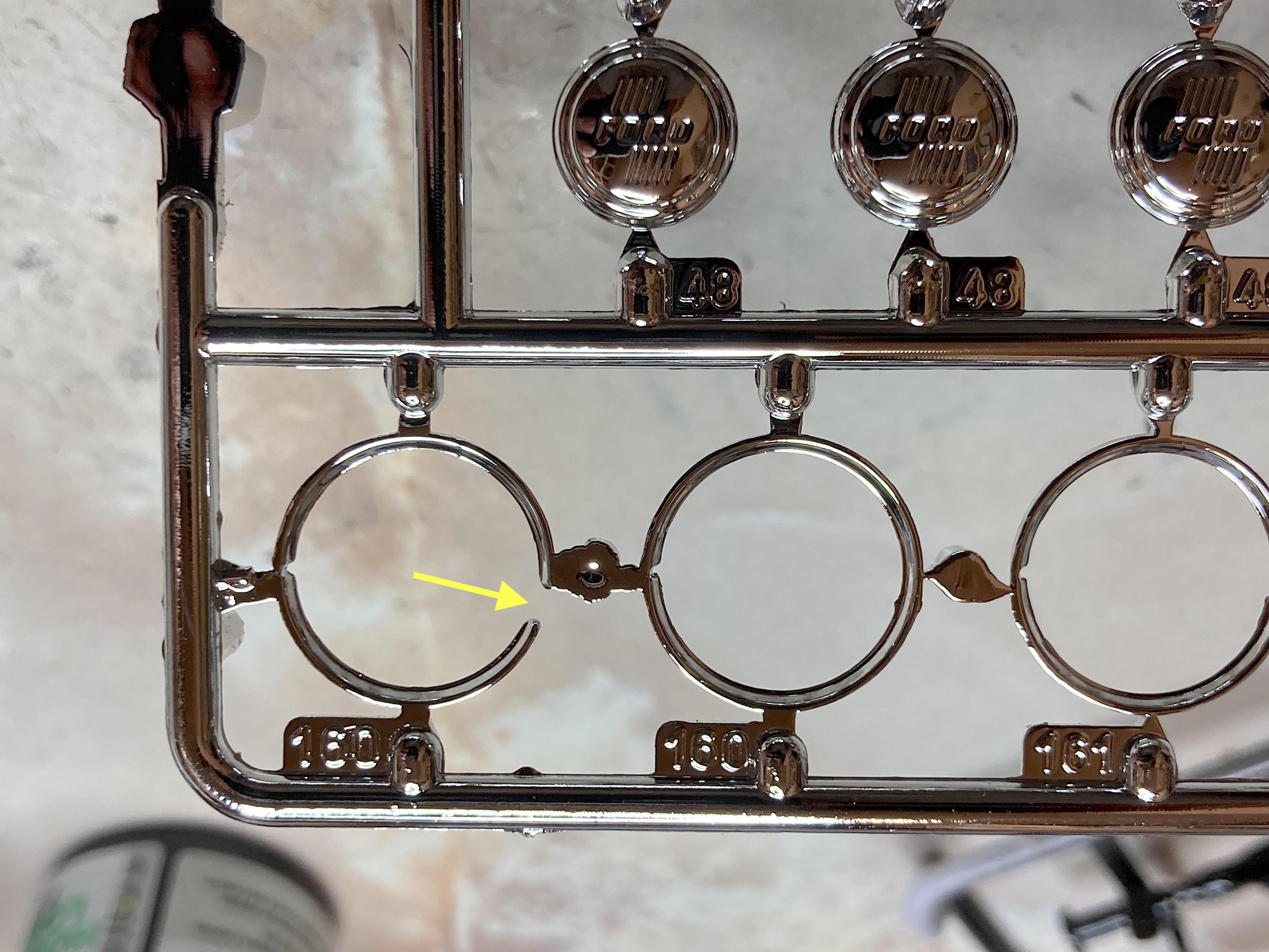

Opened the chrome parts bag, and was bummed to find some parts are ruined.  The tie rod ends are bent over, should line up with the yellow lines.  I noticed the wheels don't steer, so I bet some builders will fix that, and this only taunts me.
One of the trim rings is a short shot.  The mag wheels look nice, but I don't like how they aren't a matching pattern, and don't think they will fit the somewhat replica look I want.   Since I have the other kit, should look there.......

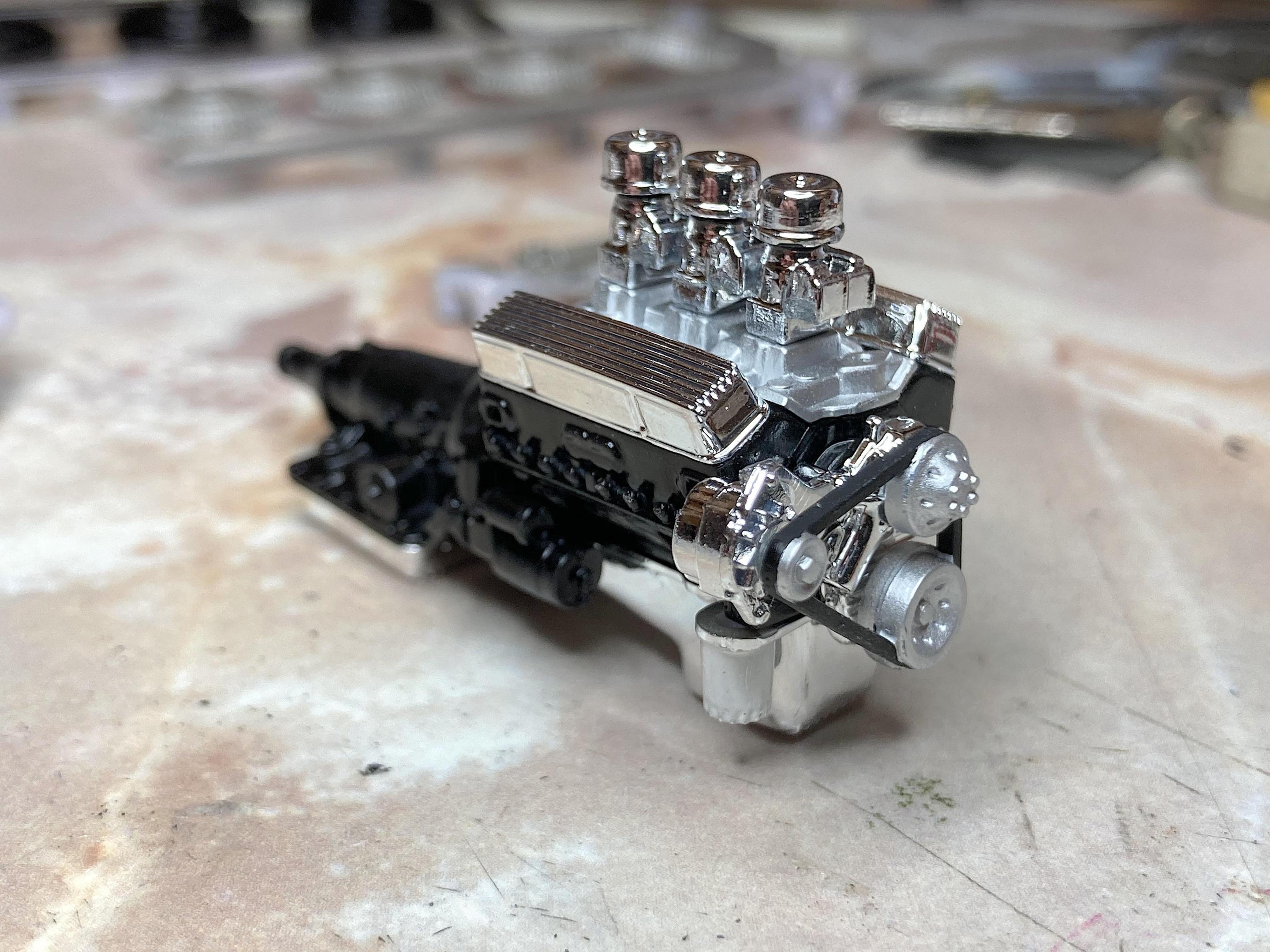

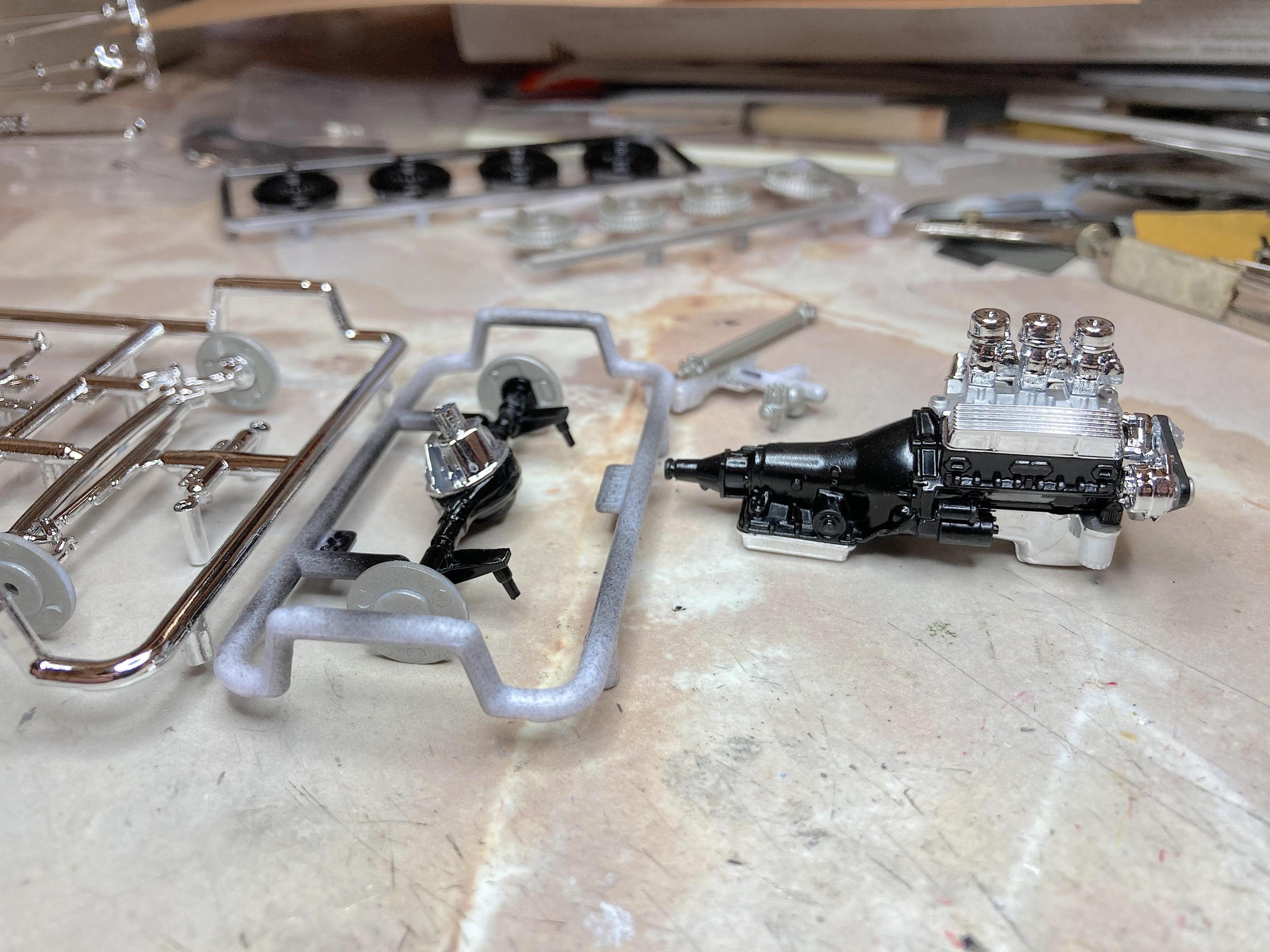

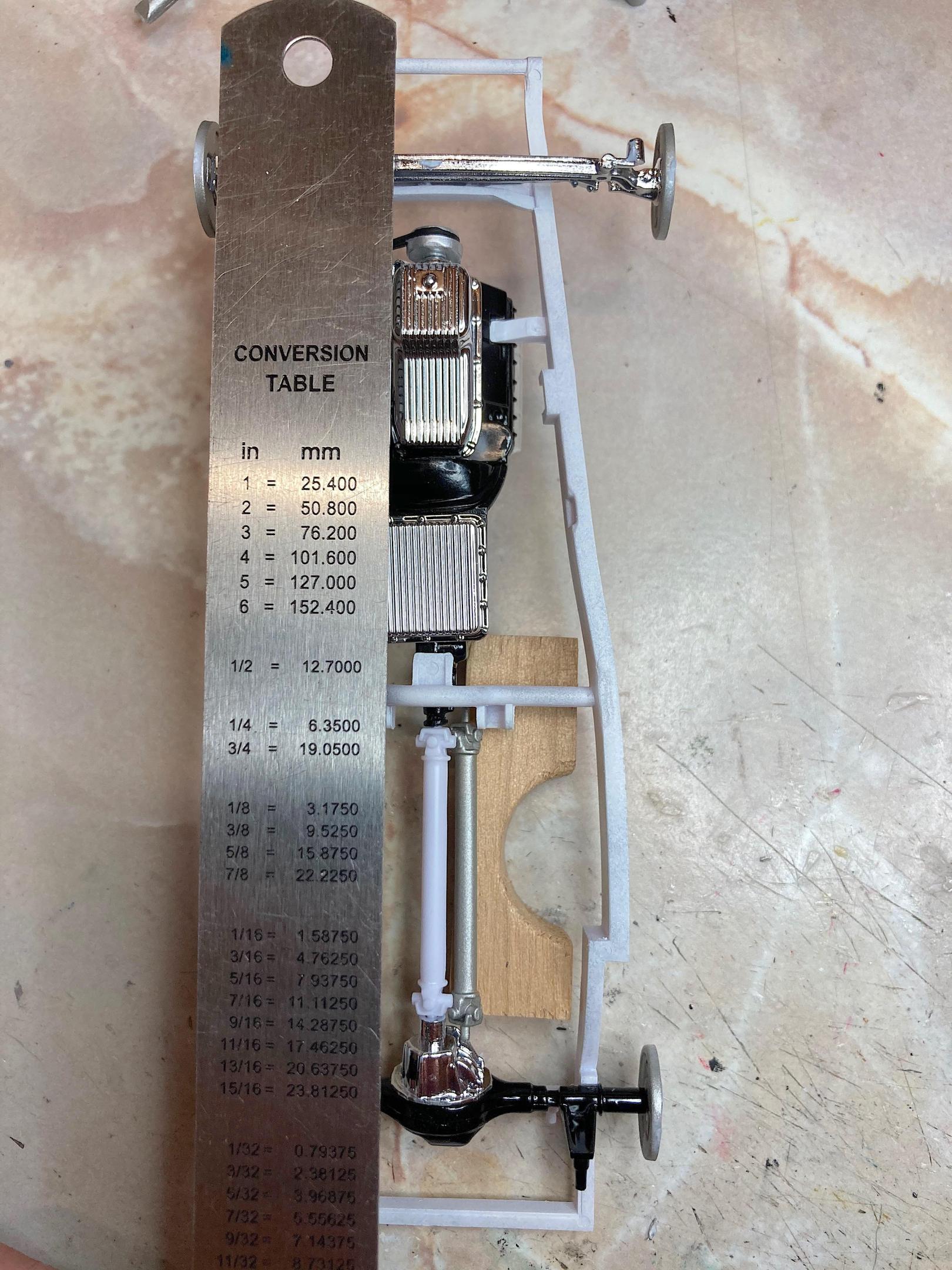

Glued the engine parts on, except the distributor.  Rear axle parts, and also the brake backing plates are on the front axle.
Need to decide how much I need to detail the engine.  I'm already expecting to make headers, need to keep the steering shaft in mind.  I don't know anything about this engine, so I better do some research.  I know some builders are going to go nuts with turned aluminum pulleys, throttle linkage, who knows what else that takes time and almost nobody can see. ?

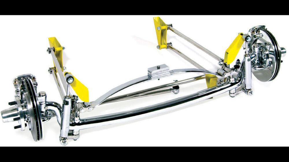

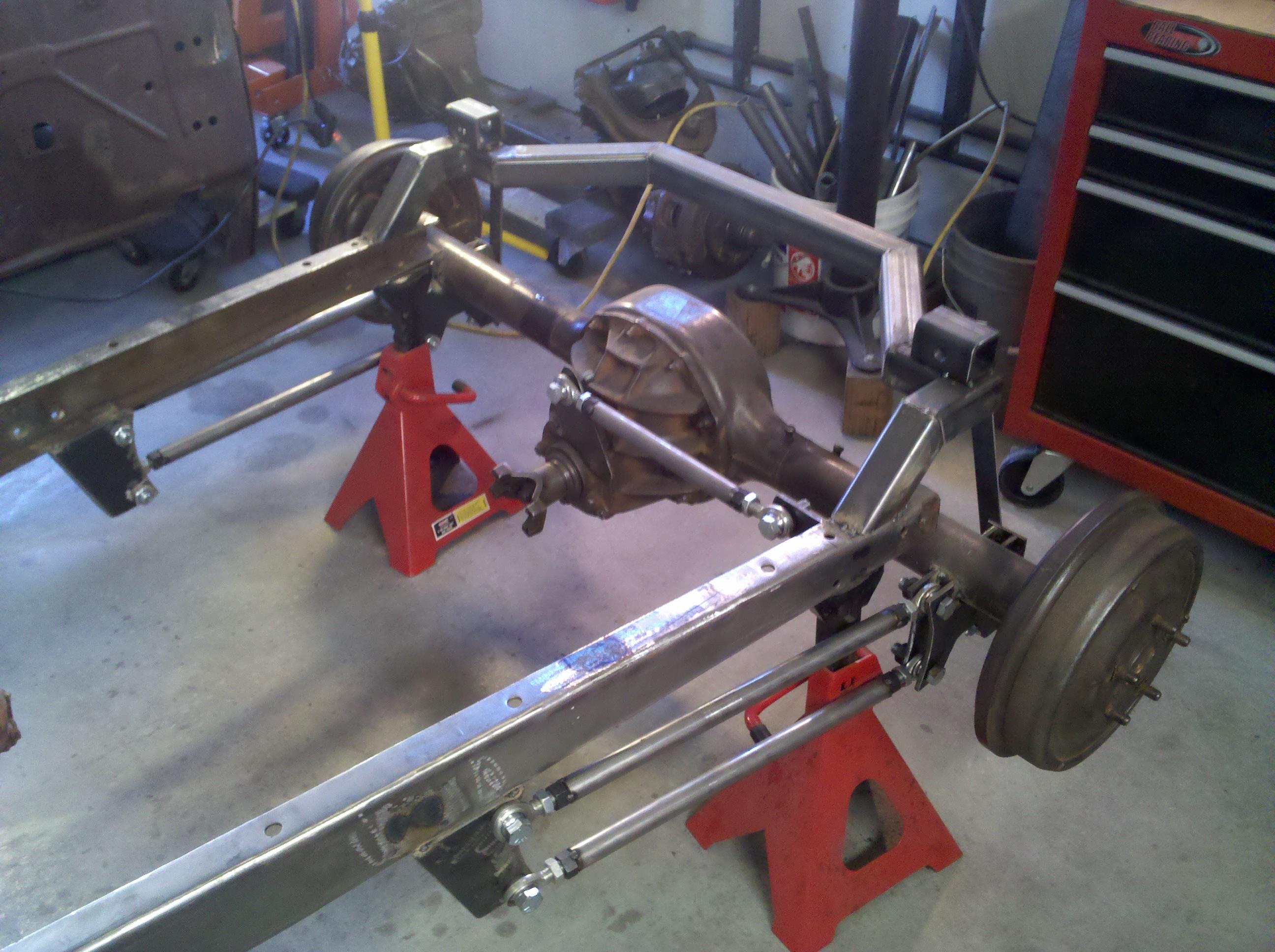

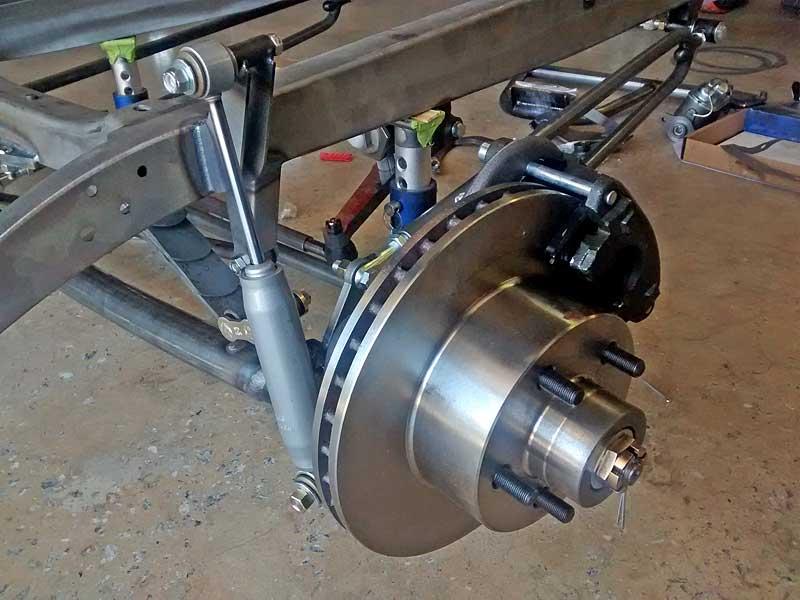

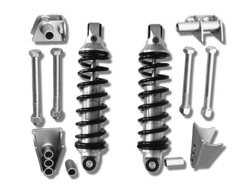

Suspension detail time!  Did a quick search, just looking for decent pictures for reference.  I see a variety of designs, so I tried to not get sidetracked on totally redoing everything.  I didn't see the point of the front shocks and towers staying in one piece, and I saw an opportunity to add something to the rear, but most important, got to fix a pet peeve of mine, coil spring parts.  What I was inspired by, but not duplicating exactly:

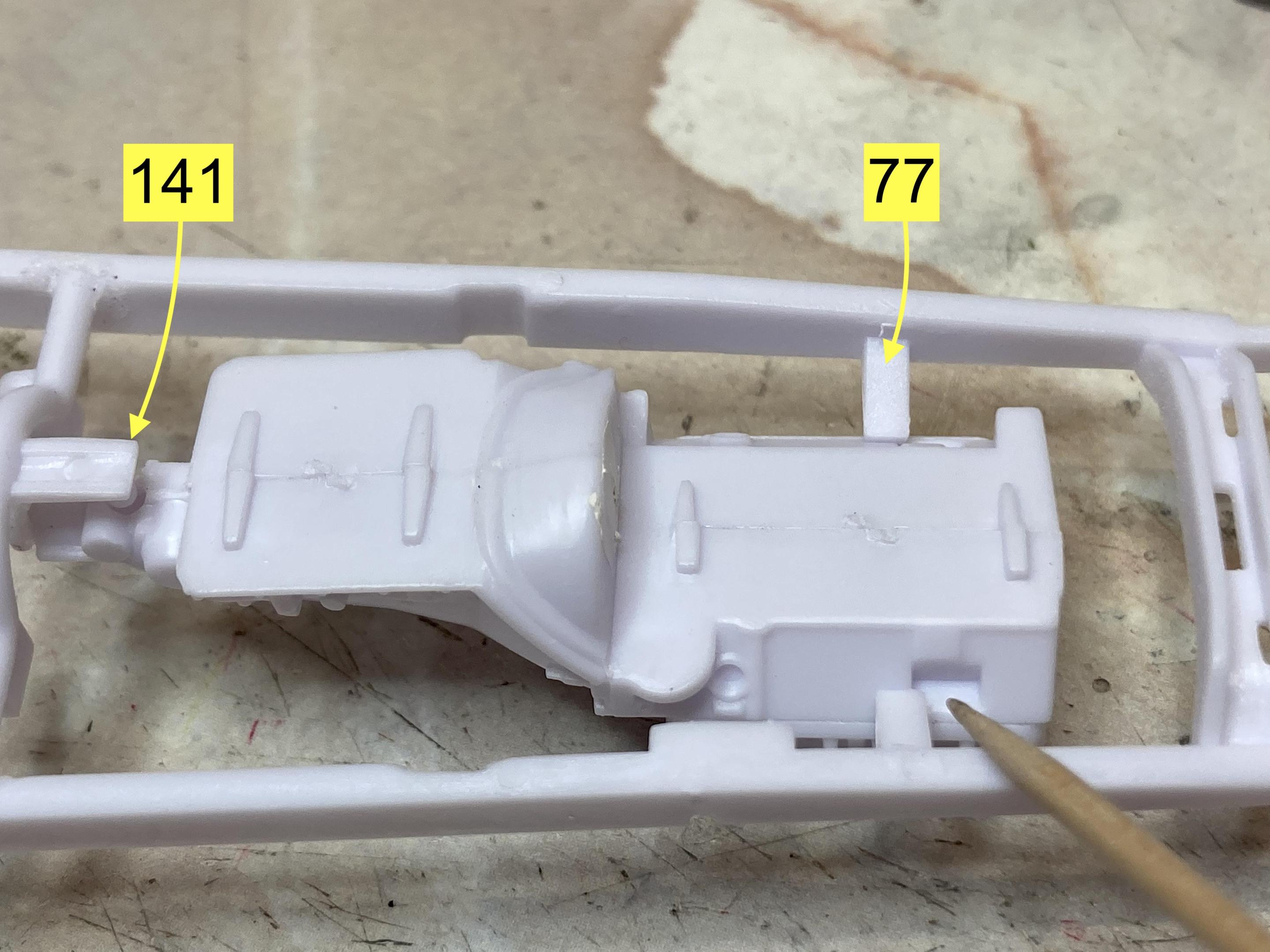

My OCD is getting triggered. ?  The transmission pan sure looks crooked, it appears to have matched the edges all around, so what's up?  The other thing, I picked the wrong driveshaft, mixing the engine and frame didn't help, so I recommend painting both.

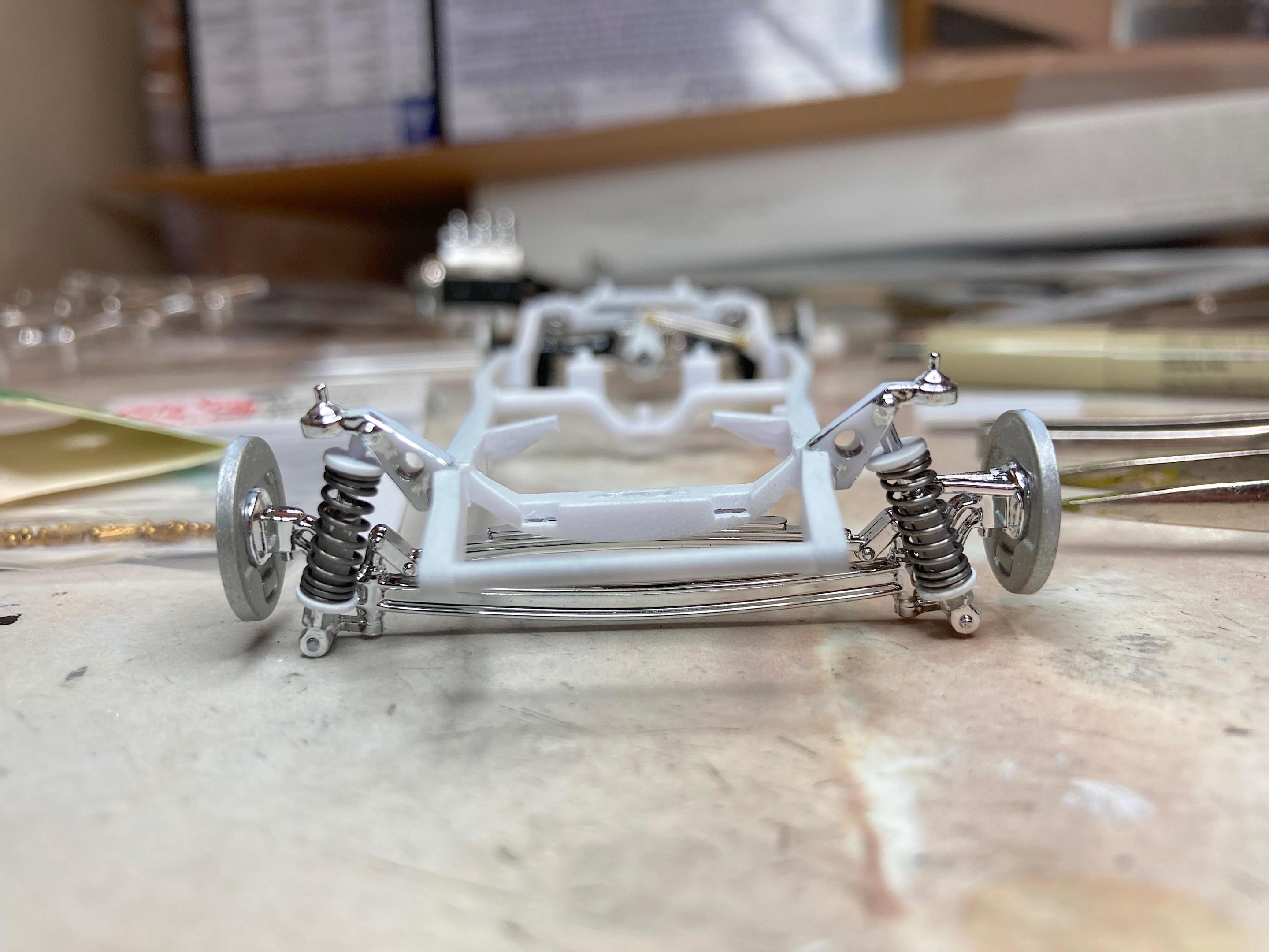

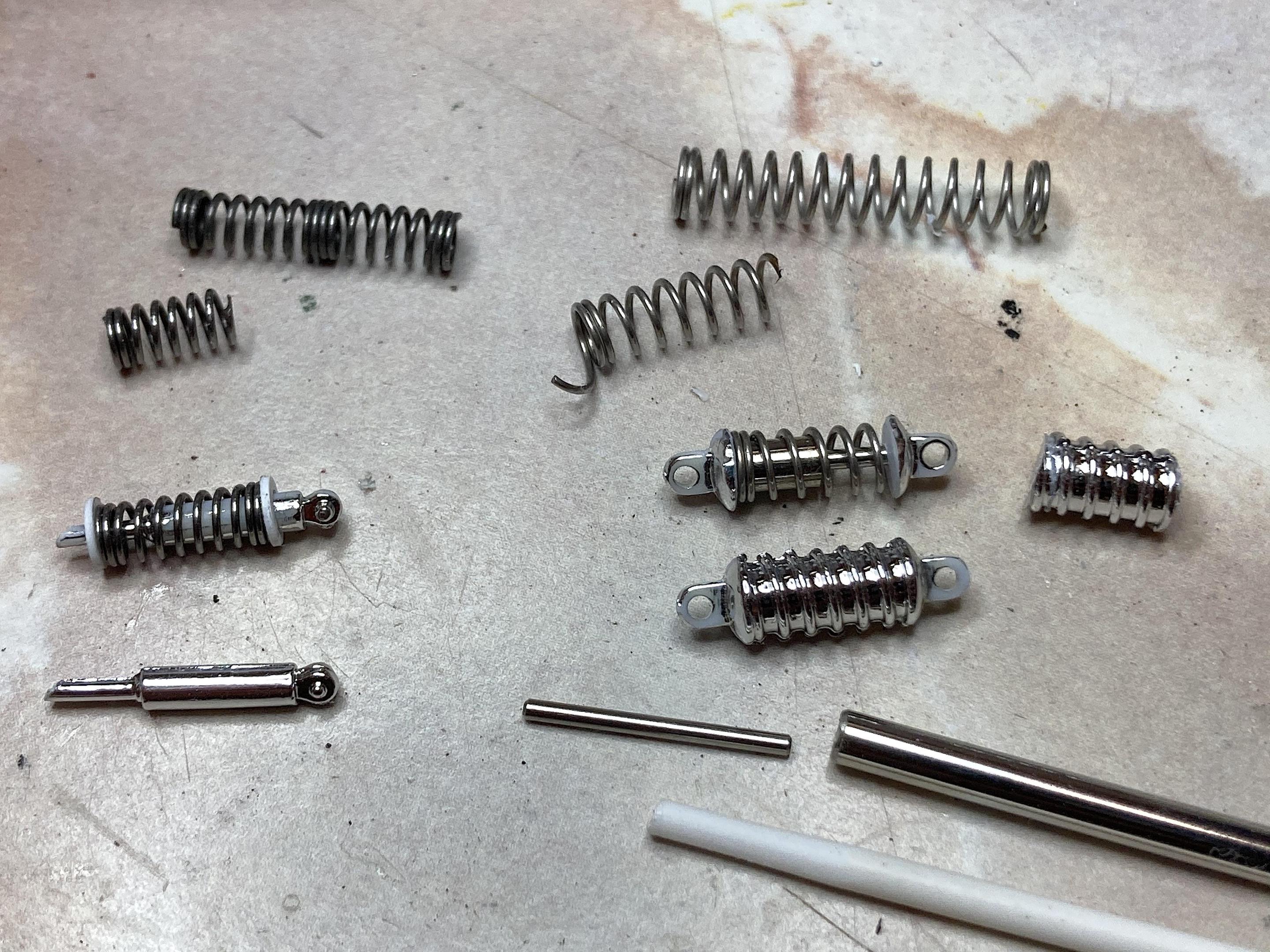

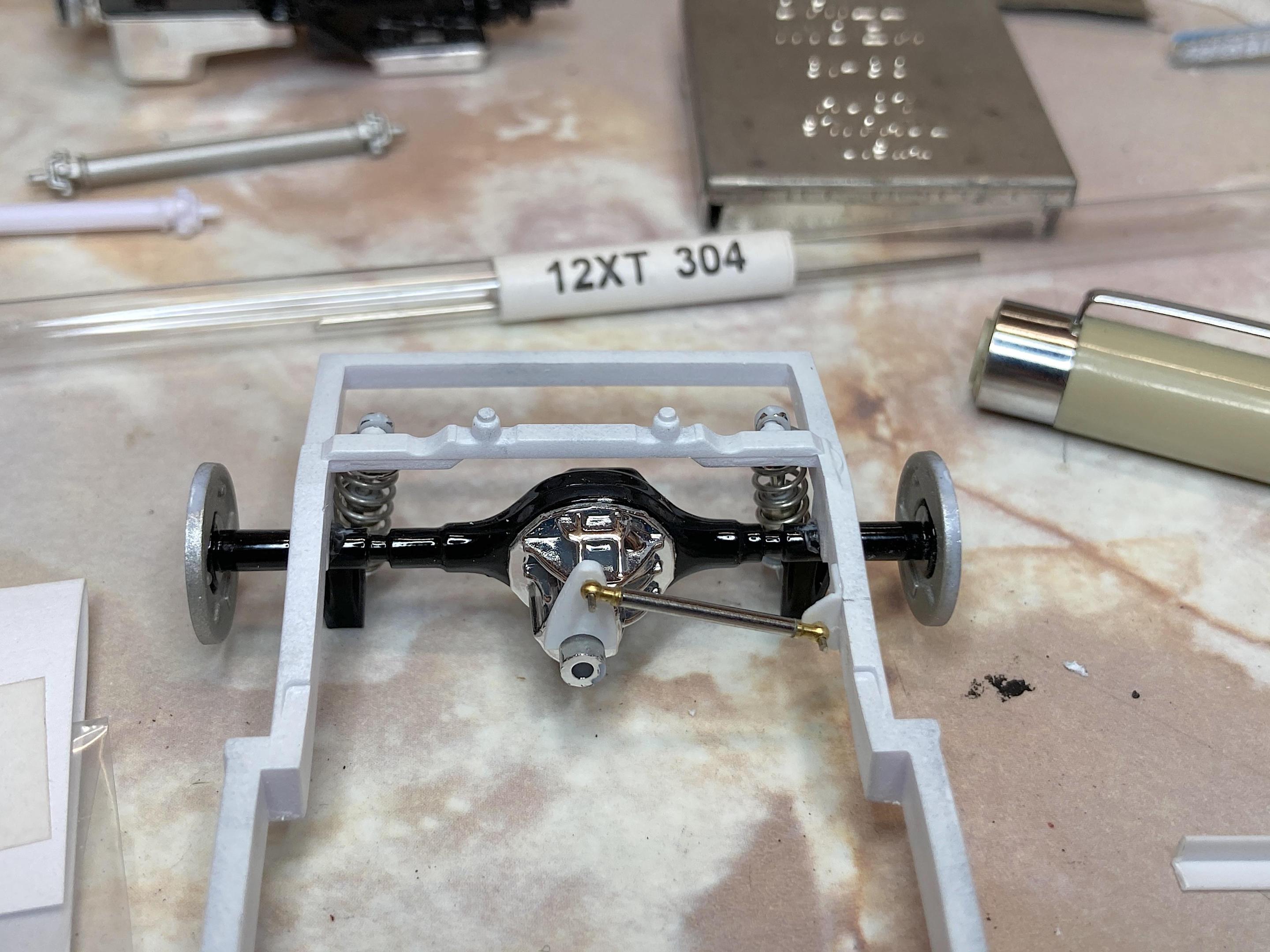

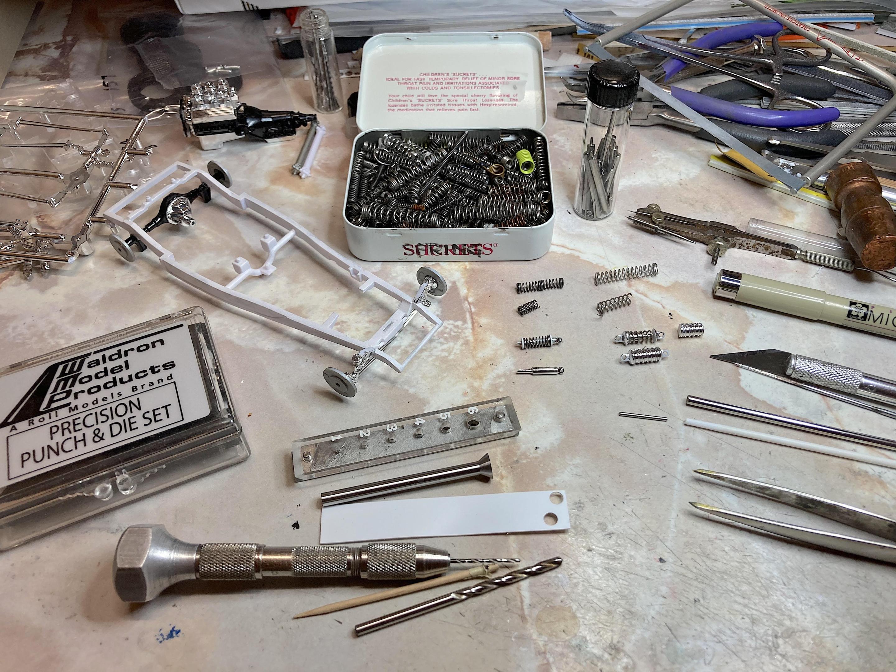

I've been collecting springs and steel shafts for decades, so I have a decent selection.  Front shocks required the Waldron punch tool, drilled holes first in .20" sheet styrene.  Tools not shown that were used, Dremel with cutoff disk, and hot-wire cutter to dismember the rear shocks.  Rear shocks have thick wall steel tubing, with plastic tubing inside, then steel shafts that go the full length into the kit ends.  Front shocks have plastic disks, otherwise the kit shocks are not changed.  Front springs were cut where the spirals come together in the middle, wish I could have done that on the rear.
Front shock towers are cleaned up, glued to the frame, ran superglue as if welded, need to clean up.
Rear springs, happened to have opposite twists.  I plan to use photo-etch nuts to detail the shock ends.

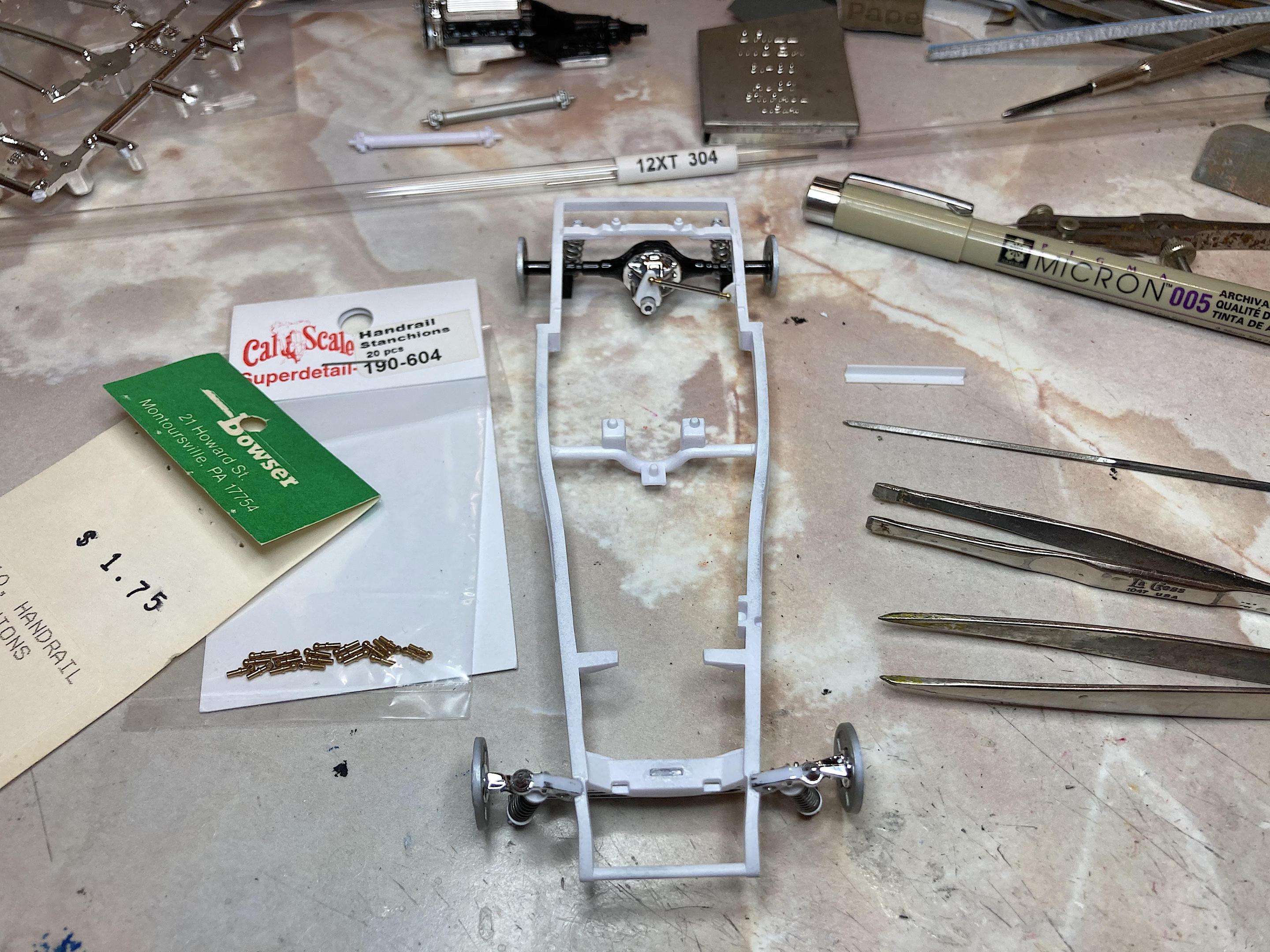

The lateral link is made with railroad railing stanchions (used up my first package, recently got more so I could go nuts), and thin wall steel tubing.  Used a shirt pin for bolts on s-b mounts.  A tool I got recently is a reamer, it's coming in handy.
Now I need to decide if the shocks should remain chrome (steel) or paint black or a tasty color.
I have been using those since the mid-'80s. They're awesome! It's looking great, Kurt! That is some high strangeness, with the trans pan.
Edited by Straightliner59

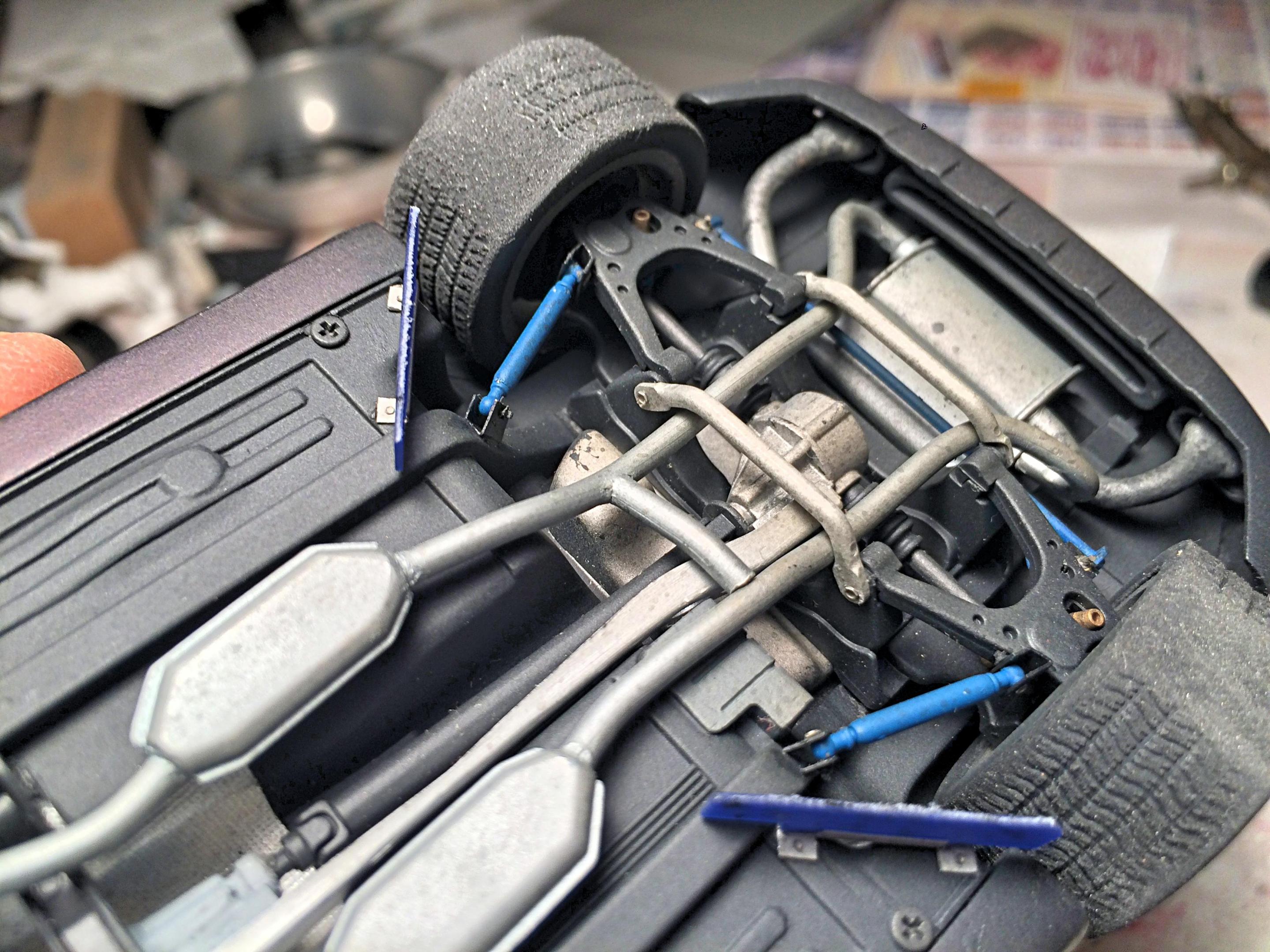

Nice upgrades on the suspension. Ugly, oversized shocks shafts are one of my pet peeves. Those look excellent and I will be stealing that method of correction!?
Thank you.  I was turned onto them last century.  Last project, used brass tubing, which was thicker wall.
Sounds fair, I've been stealing ideas from you. ?  I'm thinking of improving the front shocks, with wire shafts, and taking off the nubs on the towers which are for the headlights.
