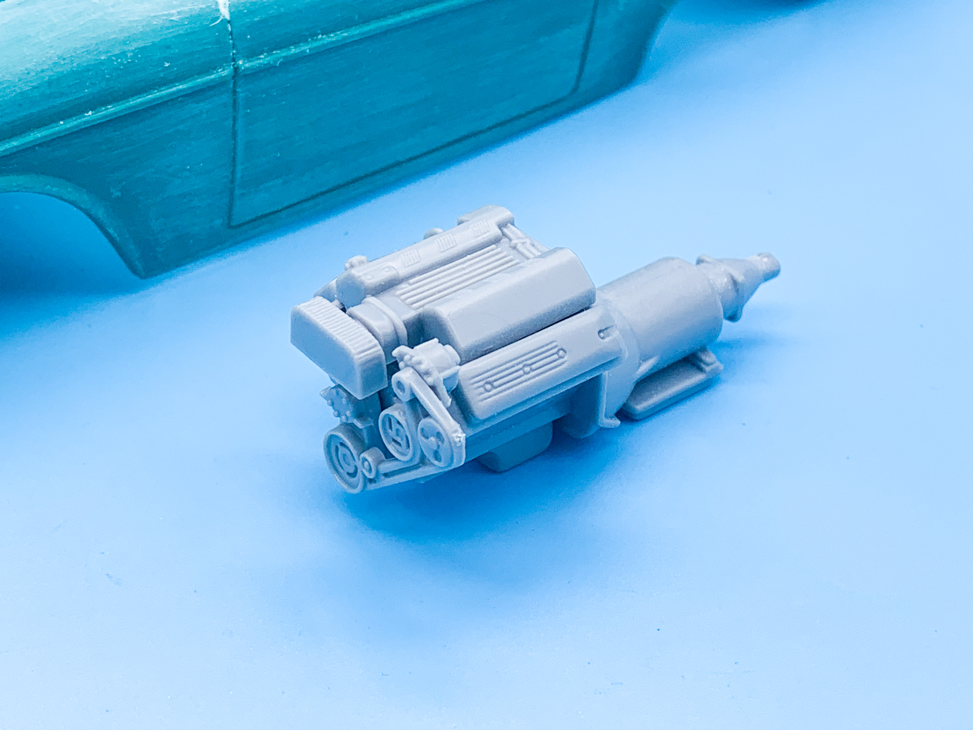

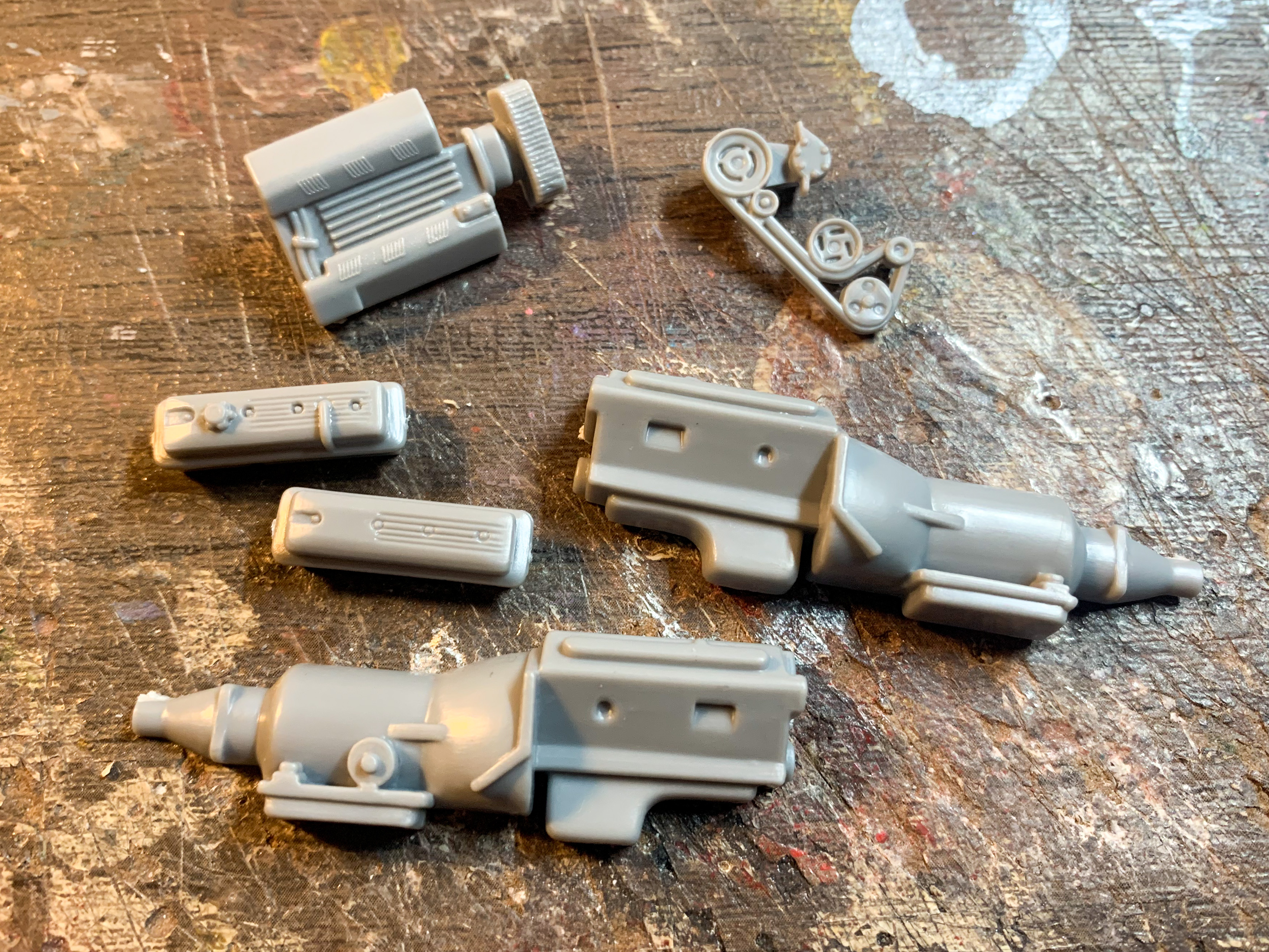

Here’s the engine parts as they come:
A good starting point, but there’s some little details missing that I’d like to add to make this thing a little more accurate:

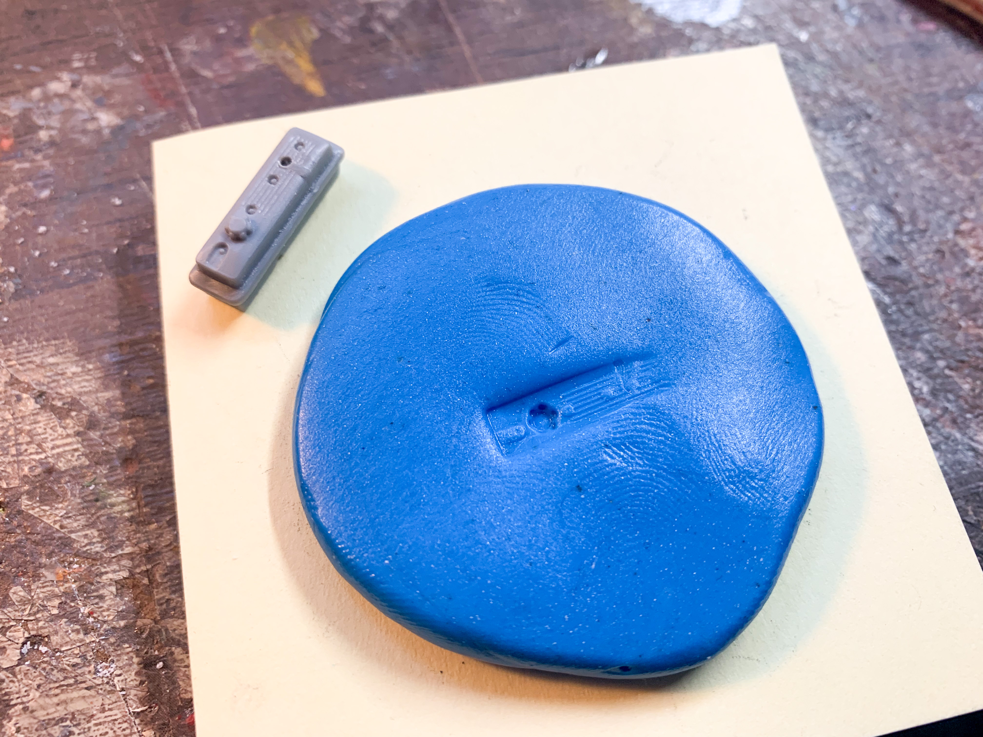

That hollow air filter was first thing that needed to go, so I scratchbuilt a replacement, then turned to that little catchcan that you see on LT1s that sits between the passenger side valve cover and the pulleys.  Now, the Chezoom has a little cap atop that can that (somewhat) matches the one on the valve cover so I made a Silly Putty mould so I could replicate it:
Actually, a bunch of them:
And then after the first batch got smart and added some gray dye to the resin so I could actually see the finished piece properly.
Next up, drilled the engine for hoses, added an alternator bracket and made some plug wire looms out of brass so I can route the plug leads nicely, then scratchbuilt that dipstick that you can see on the 1:1 that looks like it’s maybe for the trans fluid?
Starting to look like the real thing a little more!  I was surprised how little unpainted billet there is on this car considering Boyd’s reputation for using it for everything…won’t need the lathe as much as I thought for this build!

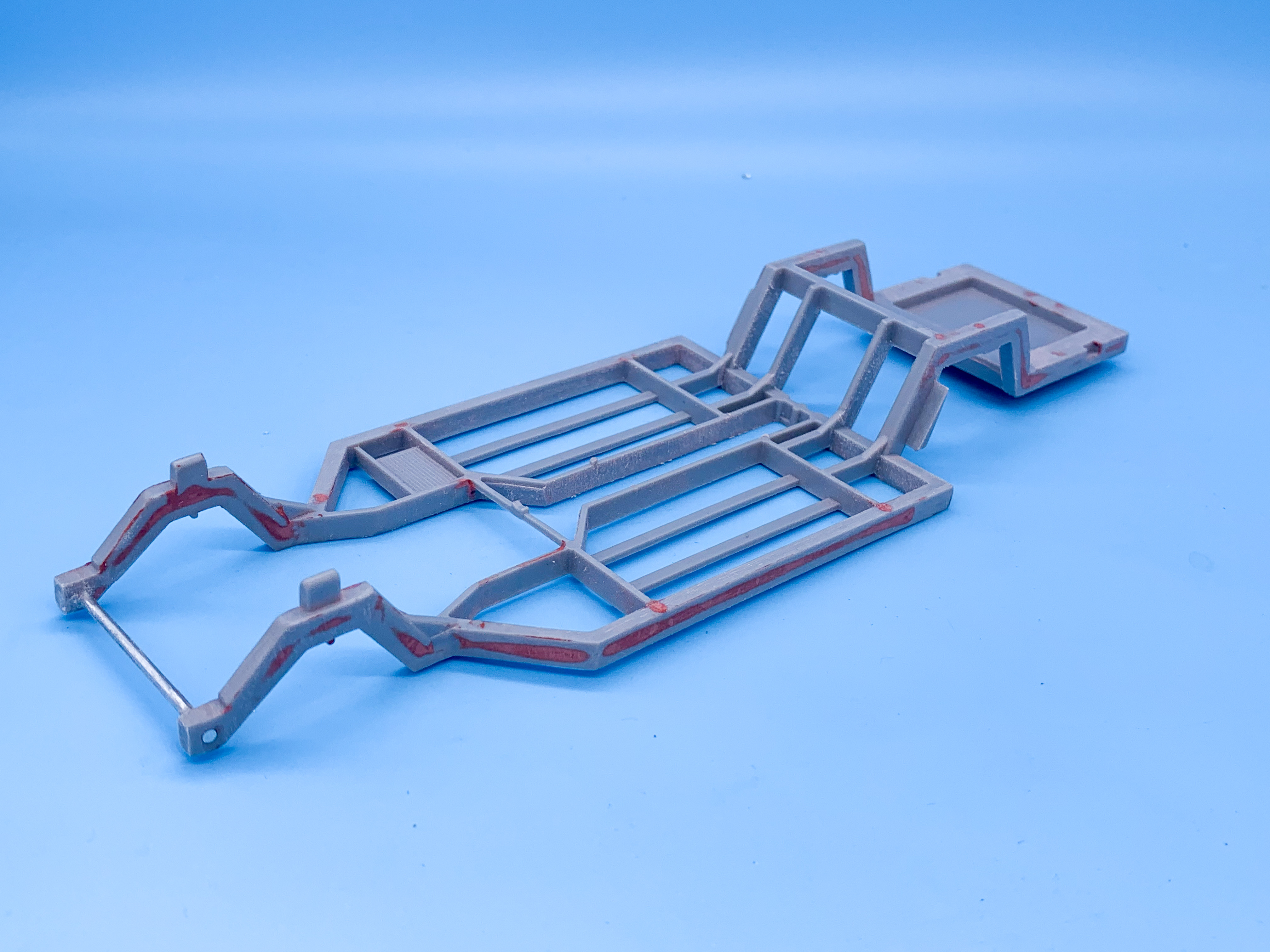

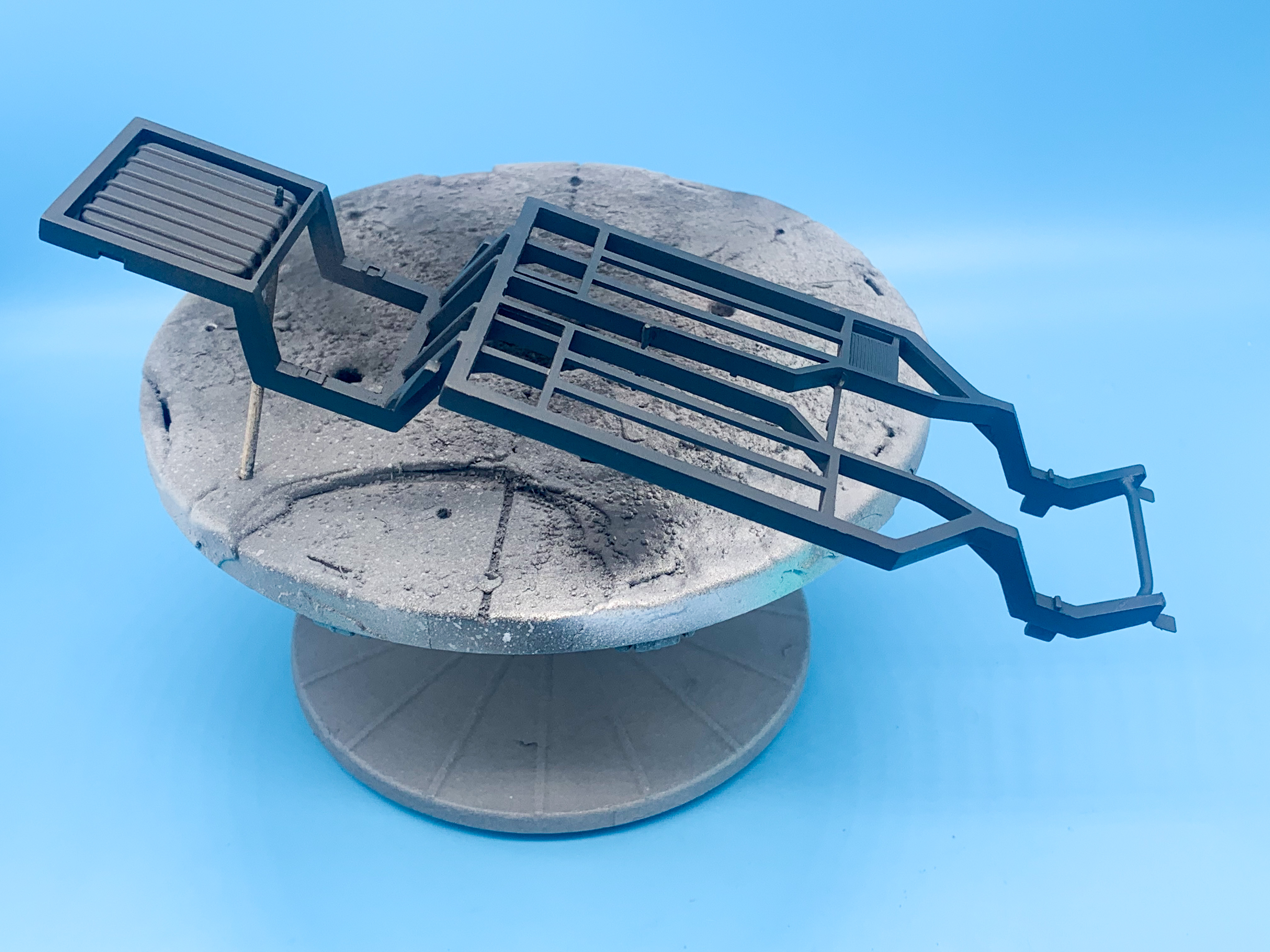

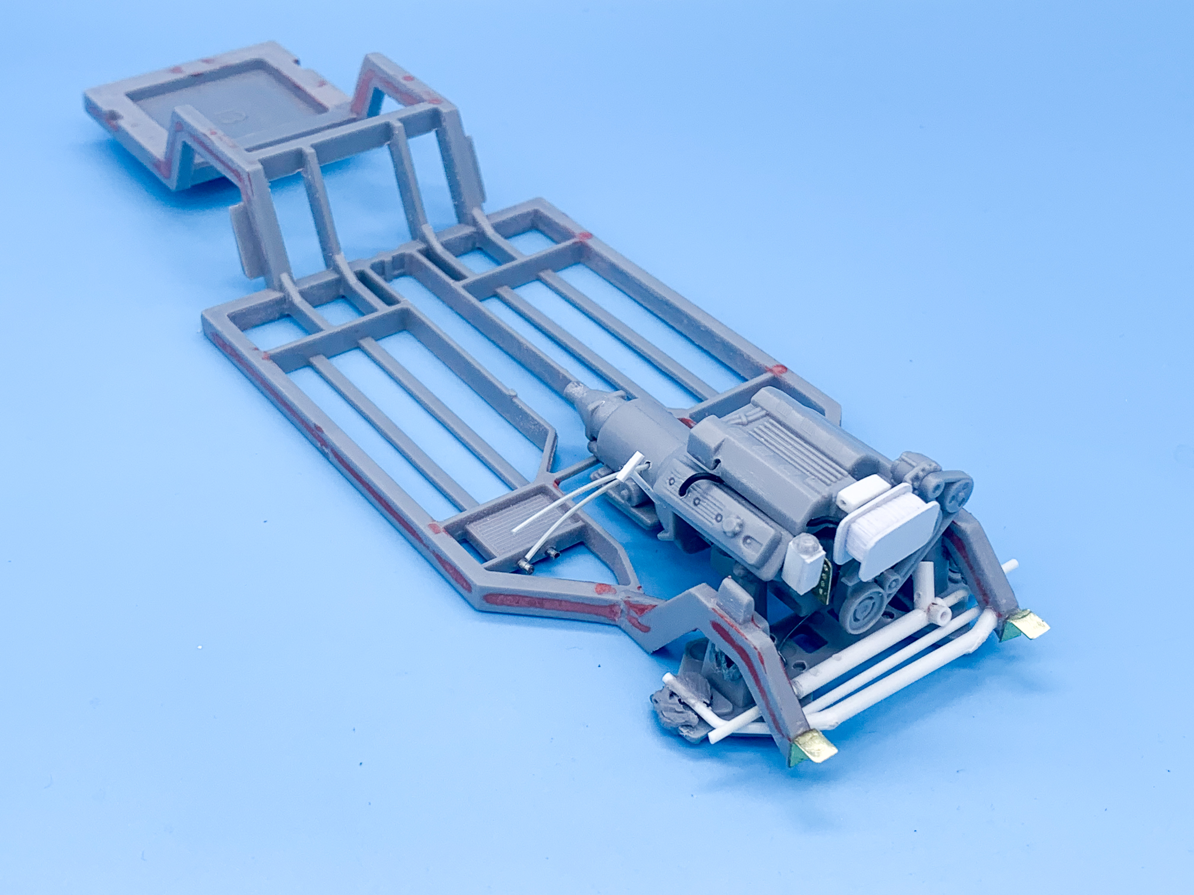

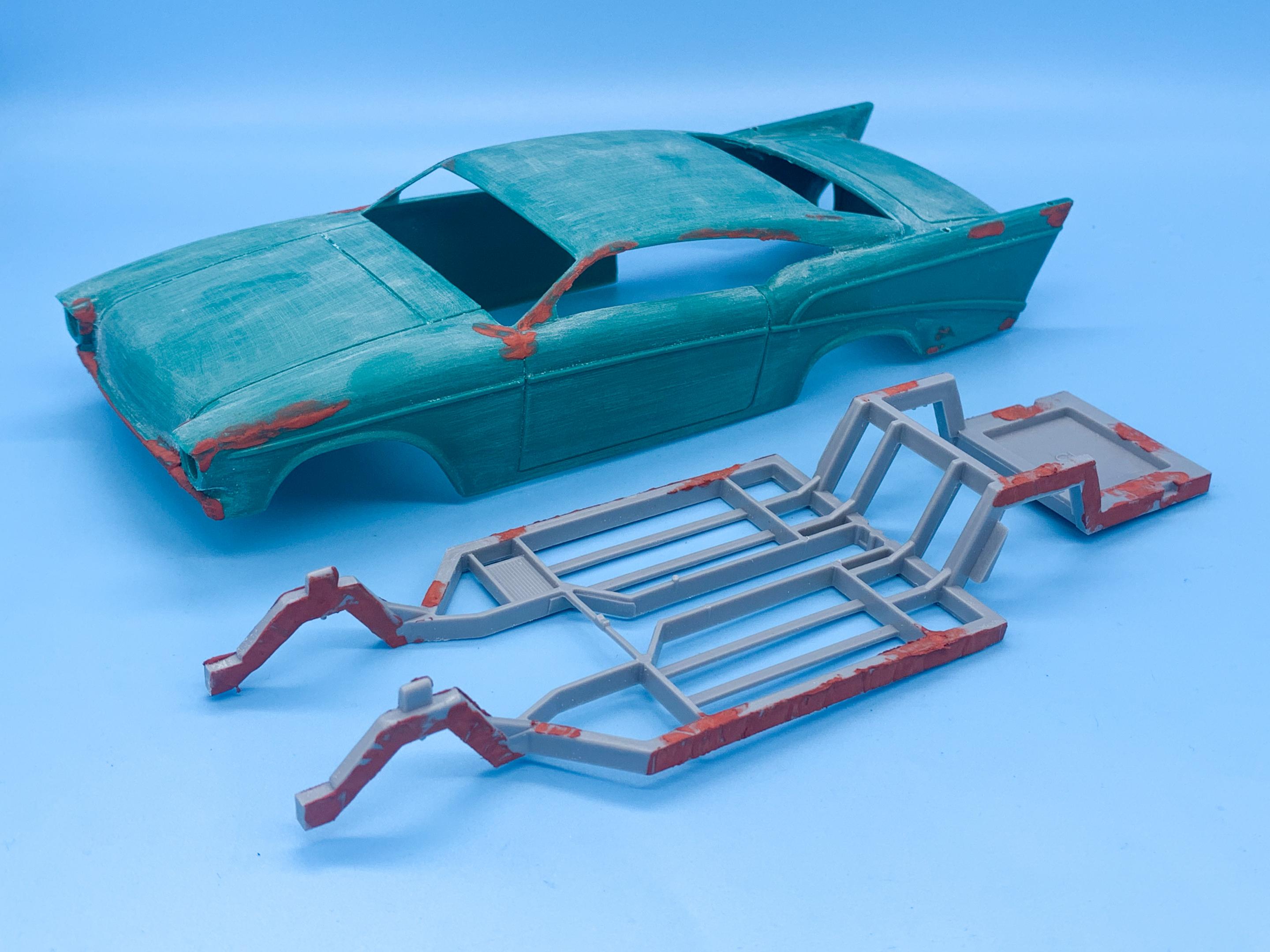

Back to the build, I’ve been trying to figure out what all needs to be done to the frame so I can get that into primer and paint.  First up, a bunch of Bondo to get it straight inside and out (and a little on the body, which I’m slowly getting in line too)
I added that aluminum bar to the front to keep the frame rigid so I could sand it and not break anything - the real car’s frame actually doesn’t have that whole piece that I drilled through there, so I sliced that off and made some brackets for the core support that I think are more accurate to the 1:1, and made a piece that looks more like the real thing.
The kit is missing a steering rack too, plus the sway bar that the real one has; most of the running gear on the Chezoom is ‘92 Corvette stuff, so finding reference pictures was easy enough at least.  I’m just making simple ‘sketches’ of the parts right now to make sure everything fits ok - I’ll detail them up some later…
Oh, and I found a good detail shot of the frame mostly assembled showing off the little transmission cooler and how the lines run for that, so I added some receivers to the frame and drilled out the transmission ready for lines later on:
The front suspension is going to need some scratchbuilding I think - the kit wishbones are pretty blocky and don’t look like the actual car…I think the upper ones will be mostly hidden when the body’s in place anyway but that probably won’t stop me making some anyway - more soon!

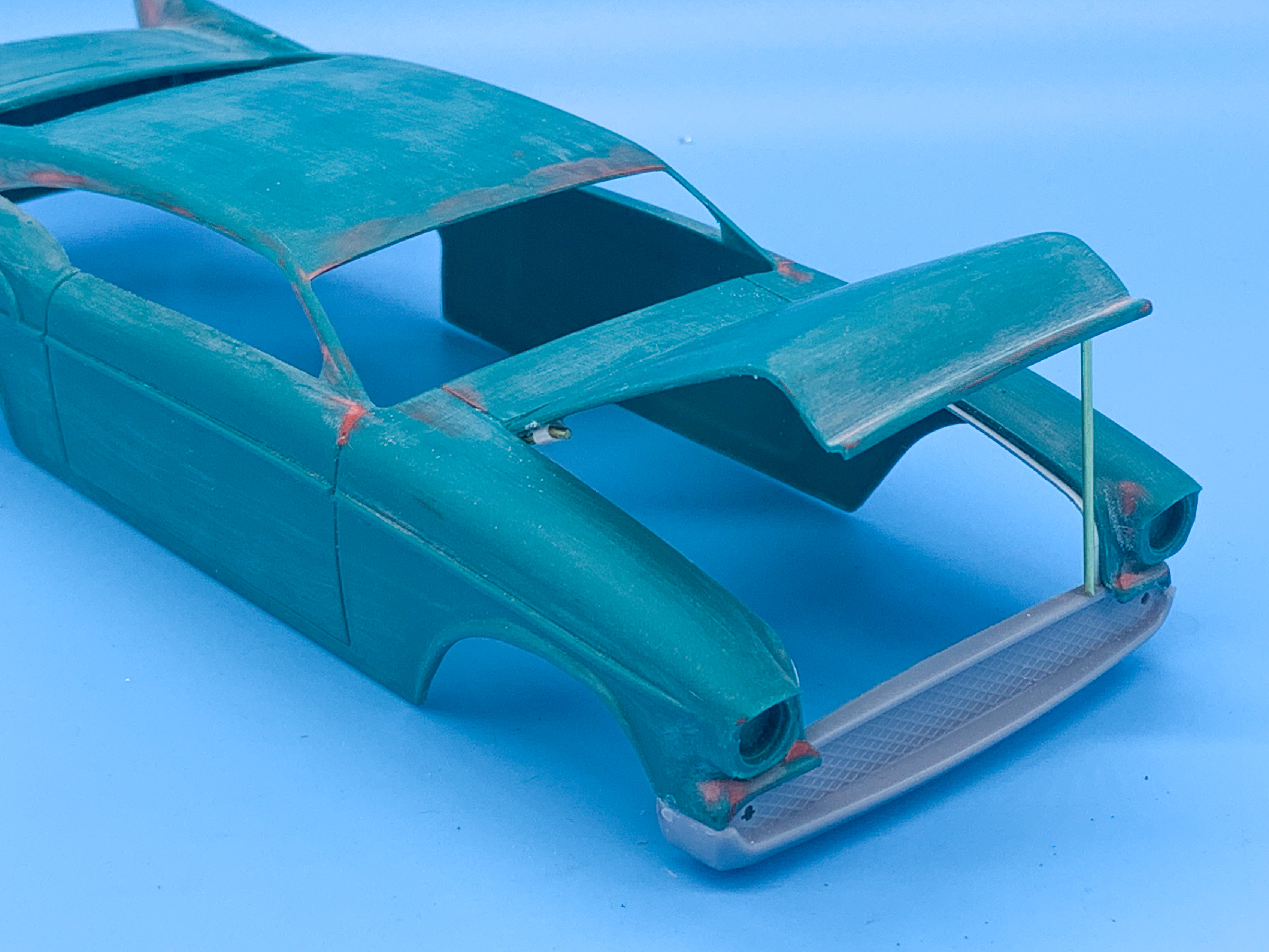

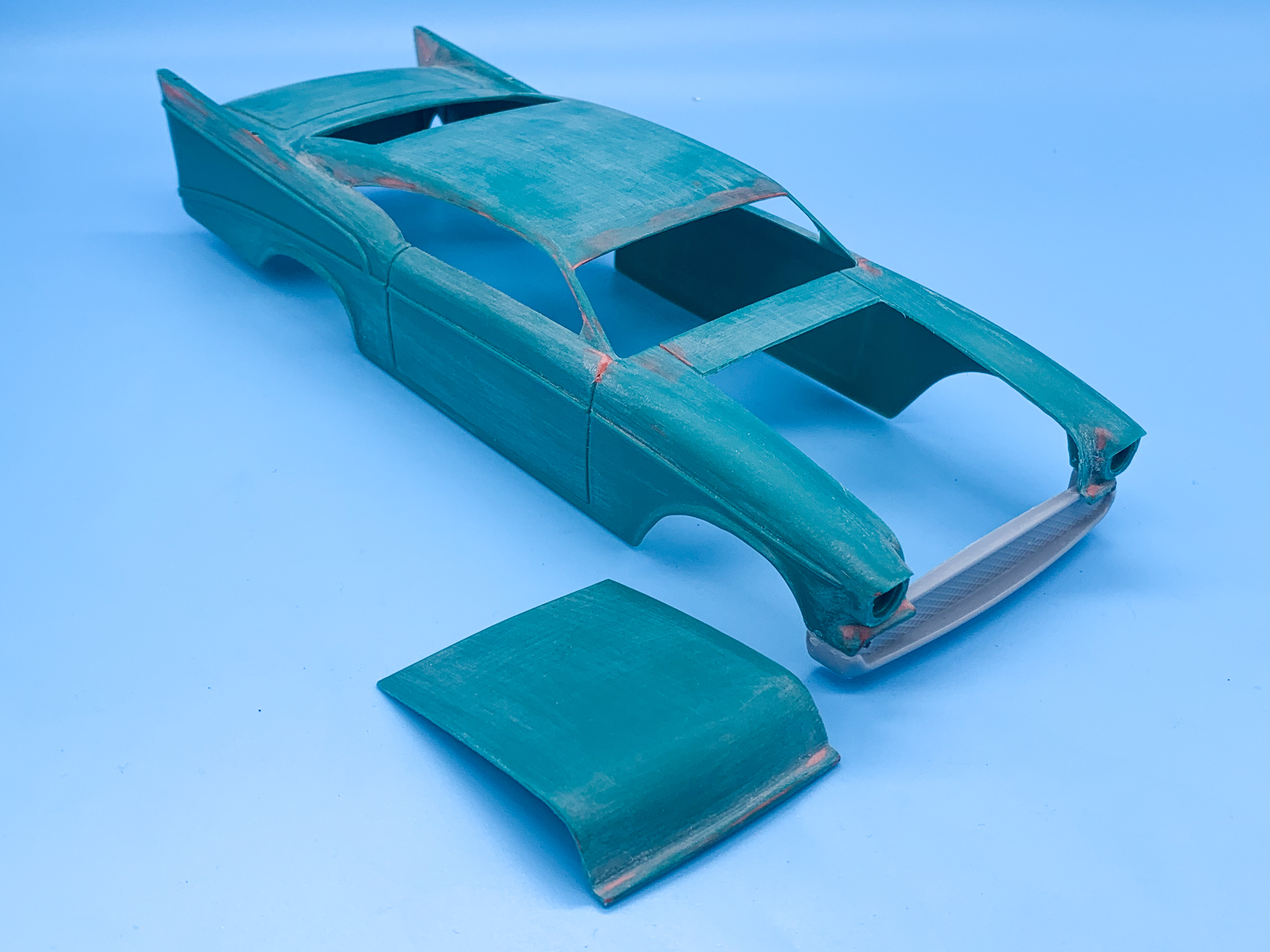

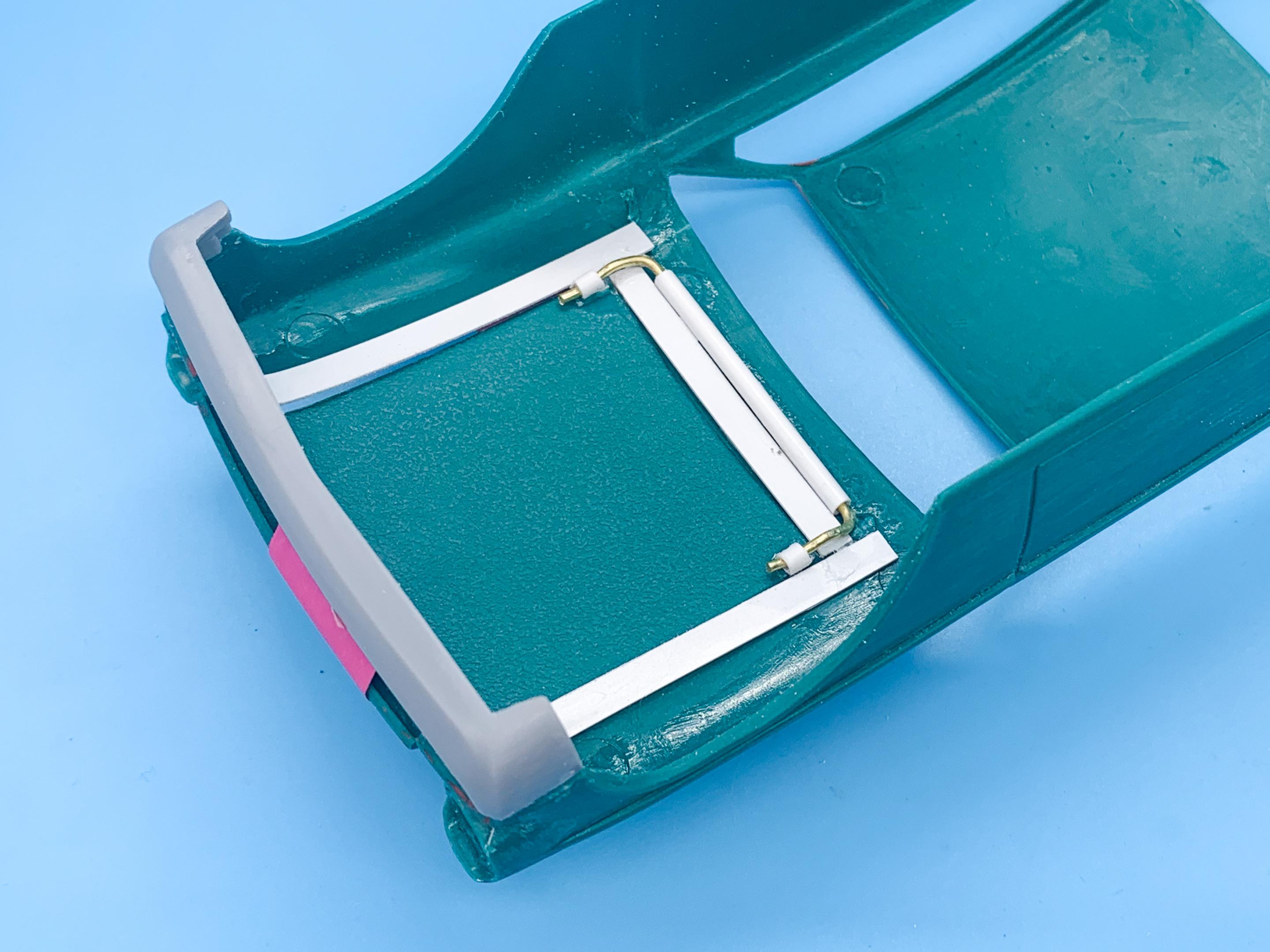

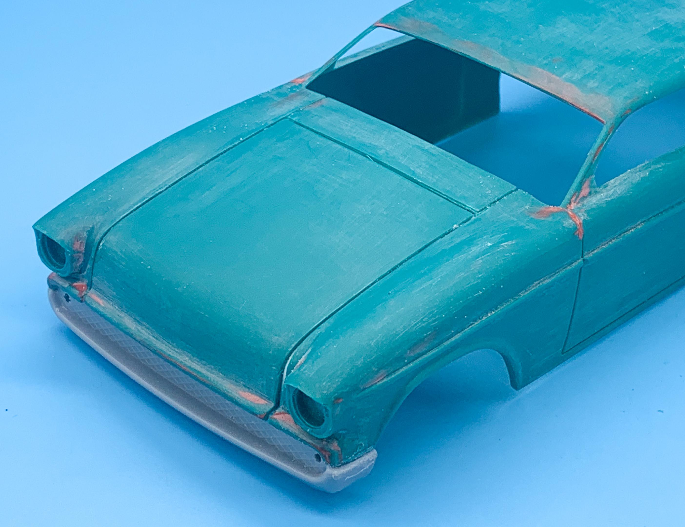

A little work on the body today - this kit has the hood moulded closed, so first job was to scribe it open, then figure out hinges and details.
First step:
Next up, add some bracing to make sure it sits nice and level with the fenders:
Then, I made a brass hinge and added receivers to the underside of the hood:
And the moment of truth…all fits back together properly with the hood closed:
And it opens too!
I’ll need to mess with the firewall a little now that I’ve done this, but I’m pleased to get the hinge done and working at least.

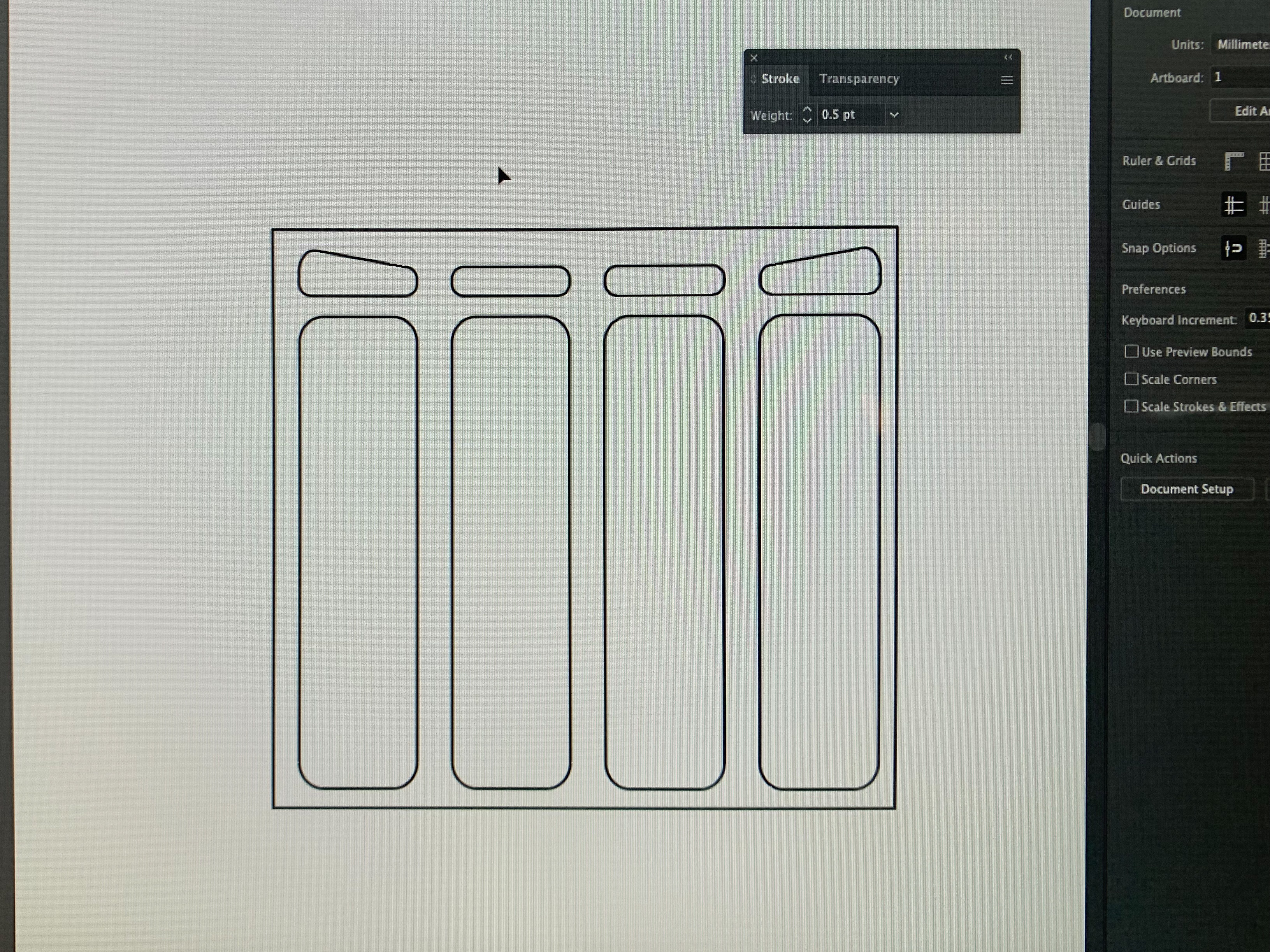

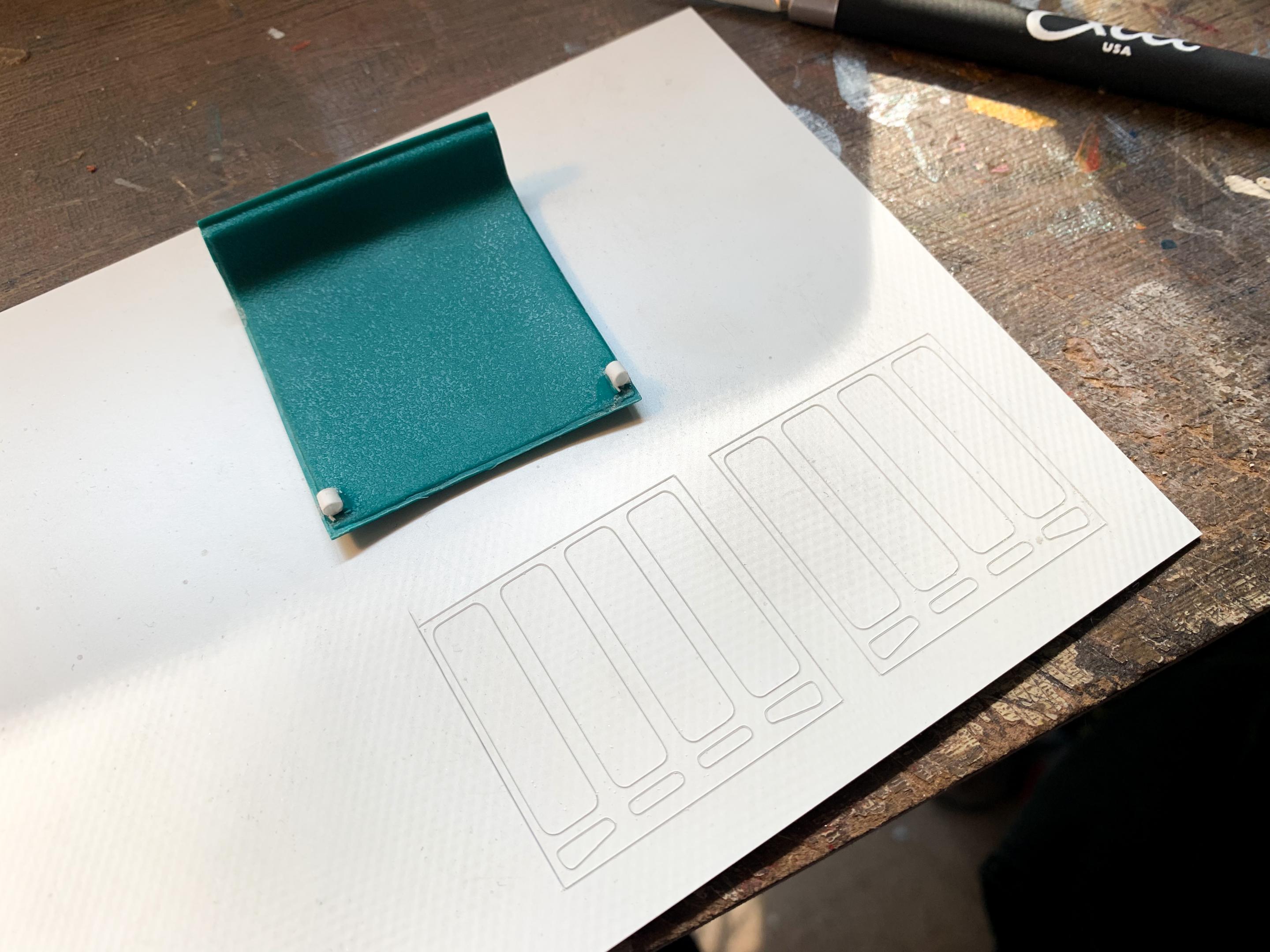

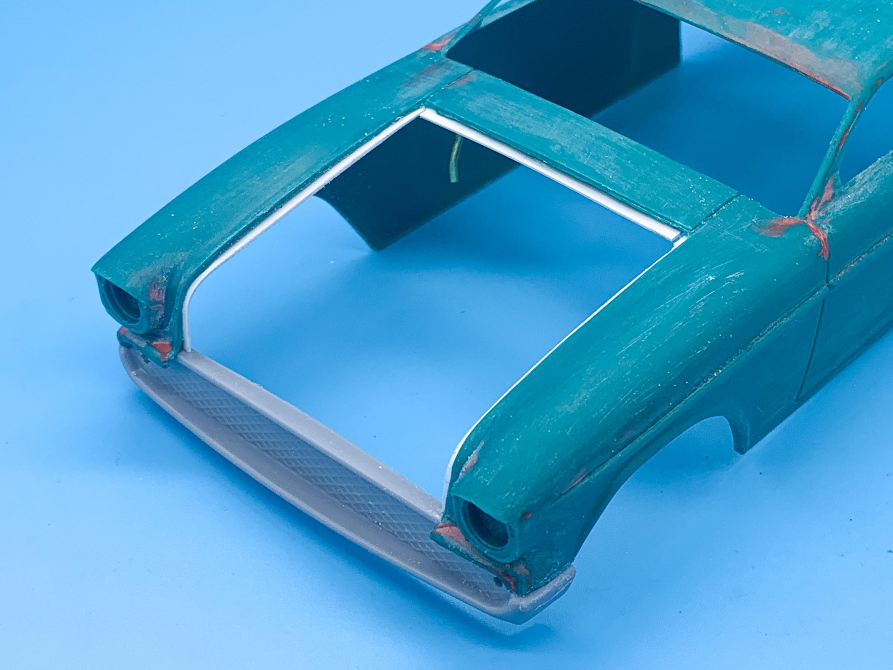

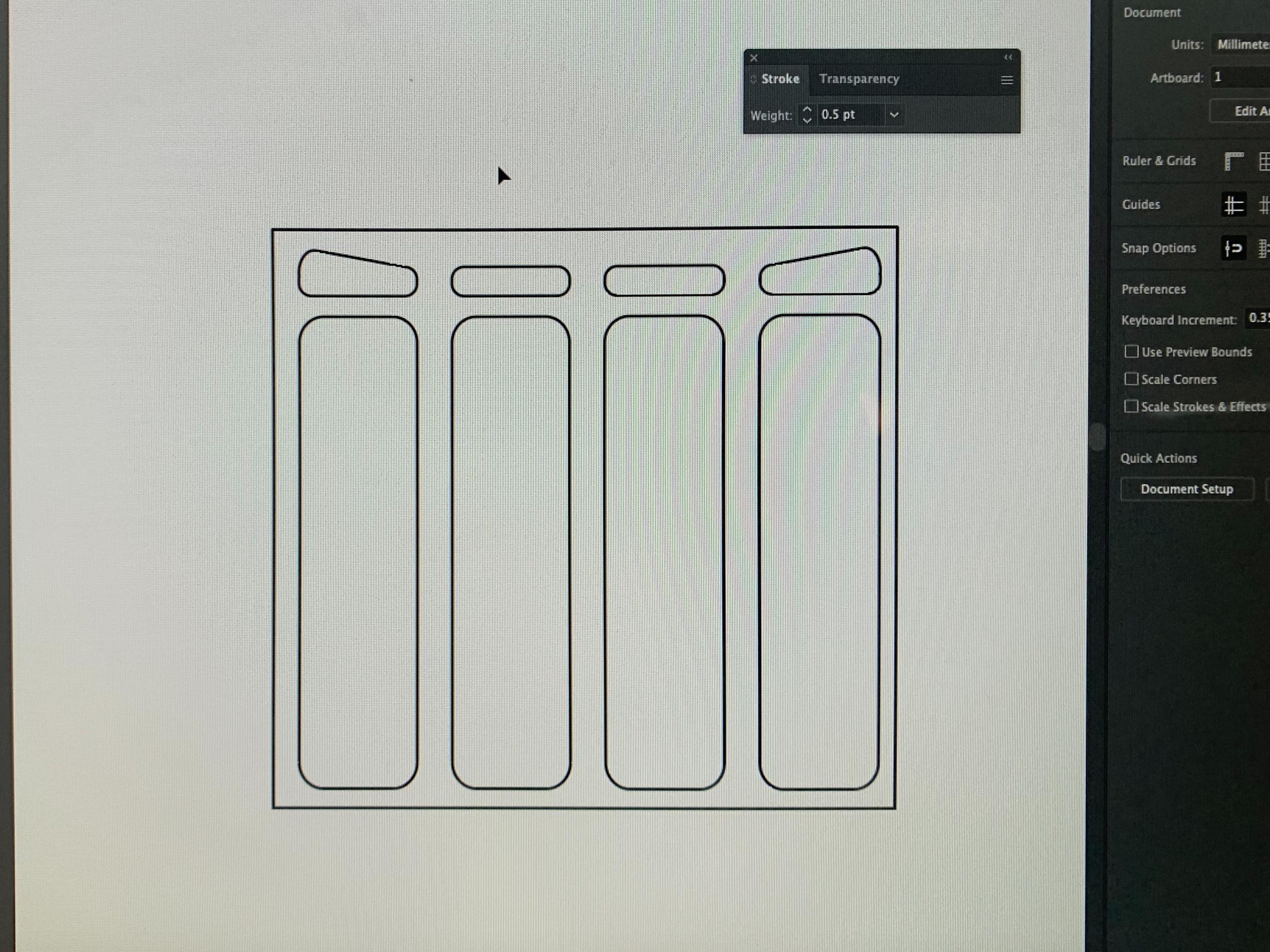

Speaking of the hood, I found a good shot of the 1:1 that shows the bracing on the underside:
So I laid out a version of that in Illustrator:
Cut it on my Portrait cutter:
And got it glued in place ready for fettling and cleanup tomorrow once the glue’s dry:
Just a little extra detail to notice when the hood’s open.

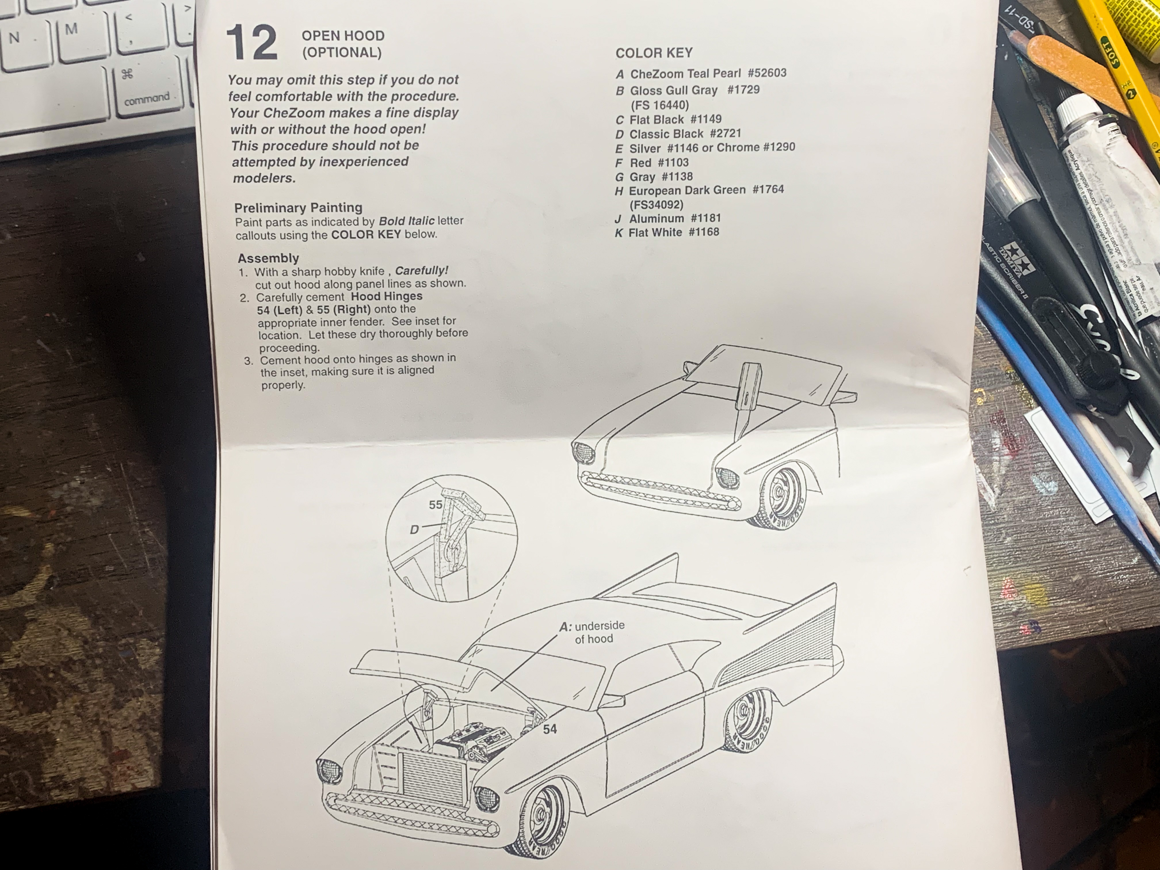

One question for you: you say that the hood on this kit was molded shut, but your box says "full detail" kit, with "engine included". Does-it mean that on the fully detailed kit (not the curbside) the hood is shut? Just curious... I have the curbside in my stash, and it IS molded shut.
CT
  • Like 1
Thanks everyone!
I think it’s the exact same body as the curbside, right down to the closed hood.  The very last step in the instructions, is to open the hood “if you feel comfortable with the procedure” ?:
Kinda late to be cutting the hood open once you’ve finished everything else and already glued the body to the frame if you ask me ?‍♂️  The kit does include some nicely moulded hood latches, but if you use those you're stuck with an open hood so they won’t work for what I’m doing here.

Tiny update, as I was replying anyway - got the frame all cleaned up and ready for color, and mixed up some very-dark-gray paint to match the semi-gloss powdercoating on the real one:

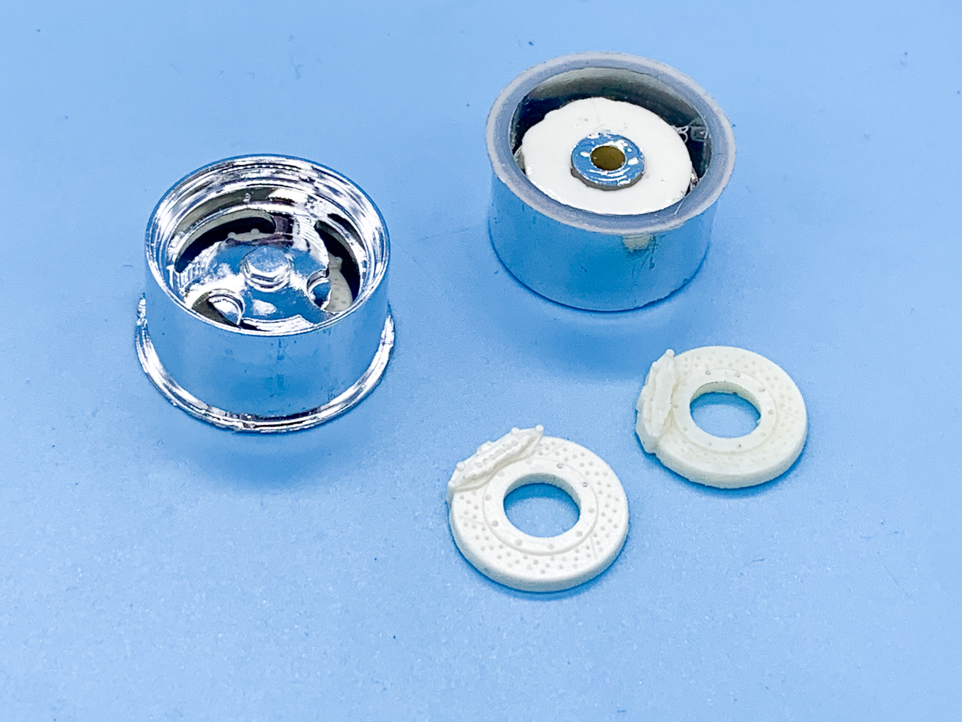

I’ve been trying to make a conscious effort to have something worth showing after my usual two/three hours of bench time every night…tonight’s project was the front brakes.  Now, the kit didn’t come with any, but I had some of the right diameter in my resin parts stash that would work.
Problem was, the front wheels have these unusual pill-shaped centers:
I carefully chucked them into my little lathe so I could machine a little off, and clean up the back of those rims a little too whilst I was at it:
Success!  I’ll need to modify them a little to look more like the 1:1 parts but they’re pretty well hidden in the wheels anyway.

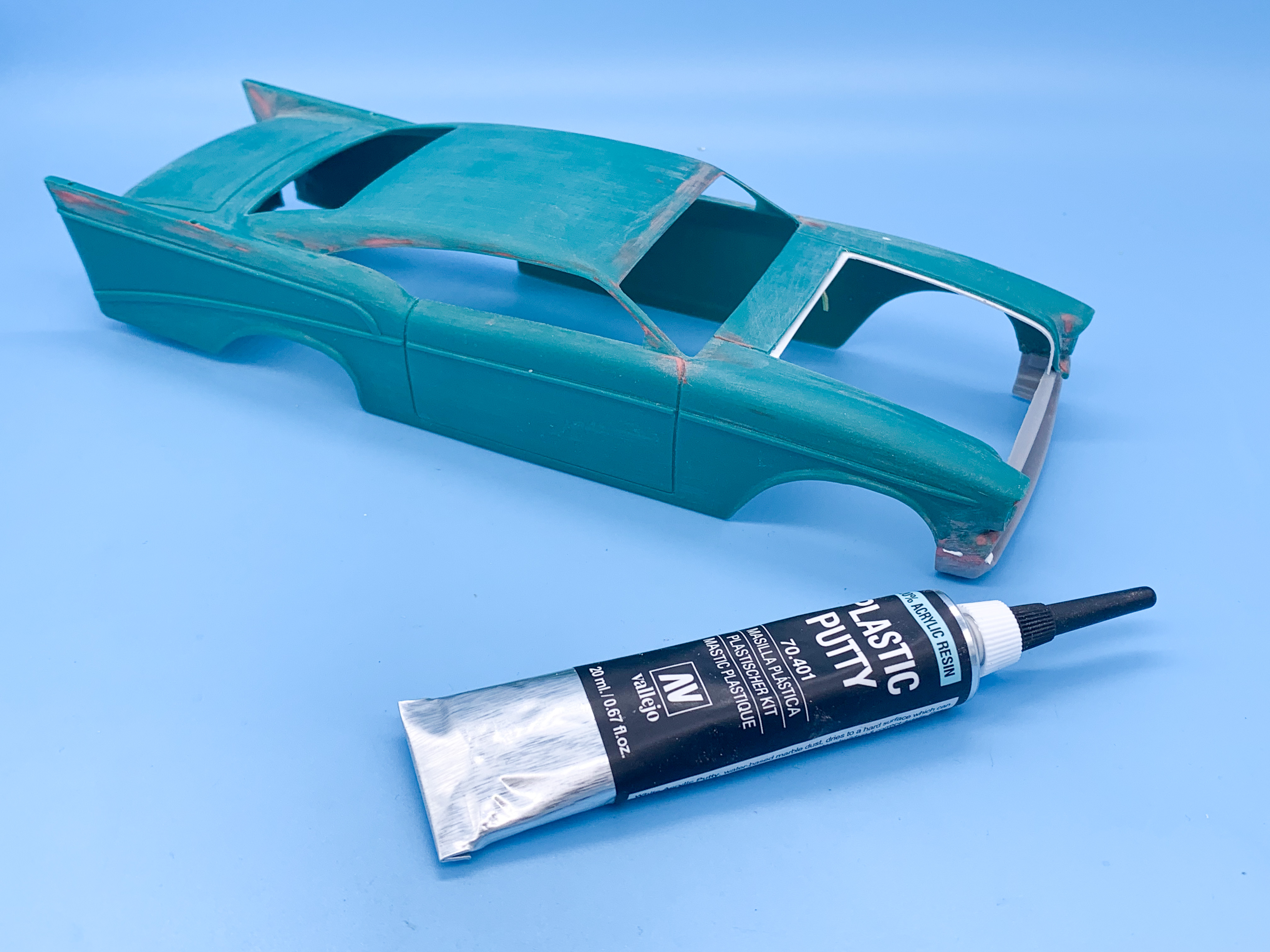

In other news, I picked up this Vallejo Plastic Putty last week to try, having seen some good reviews of it - I guess it’s kinda like when people melt styrene in some glue to make a paste?  Works GREAT for filling little pinholes, I’ve discovered:

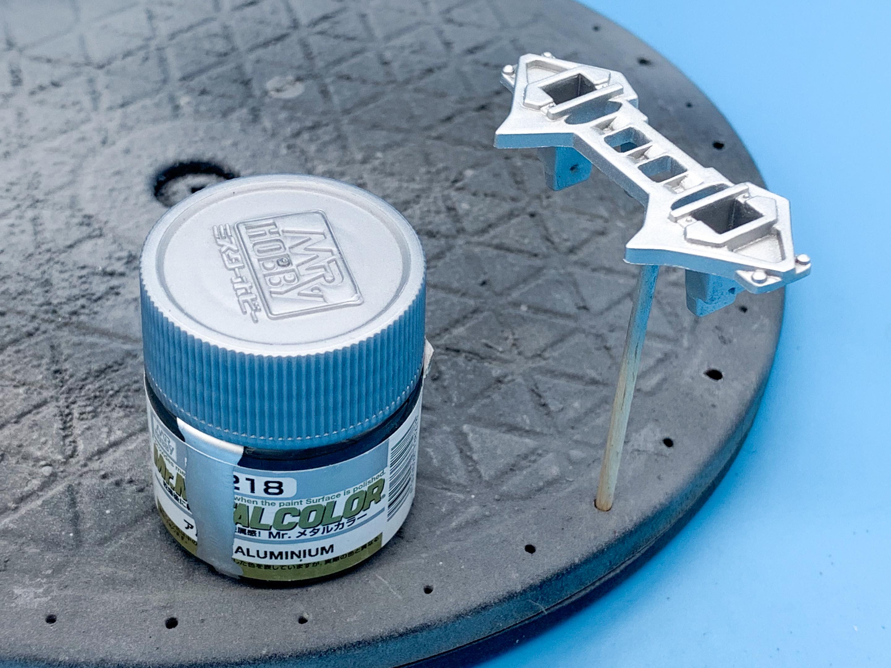

And I’ve started prepping some of the suspension pieces and getting them into paint - there’s surprisingly few bare-metal components on this car, but there’s a few on the frame where I’ll get to use some metalizers:
Not a very exciting update - but a little progress from the bench at least!  More soon!
Interesting that you used Vallejo Plastic Putty . I've been told that it's very thin , dries to a rubbery consistency , and is not sandable . What do you think ?
