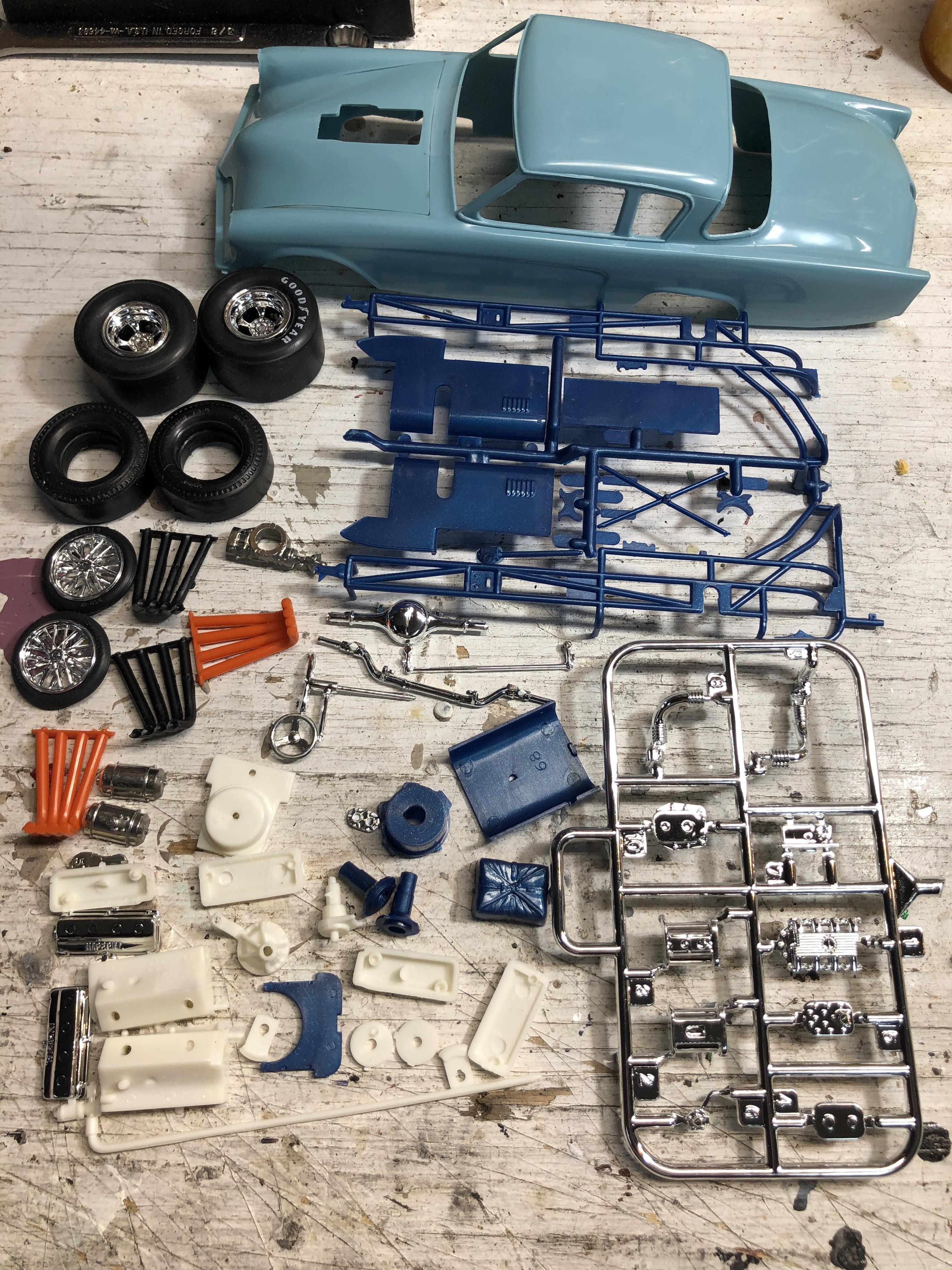

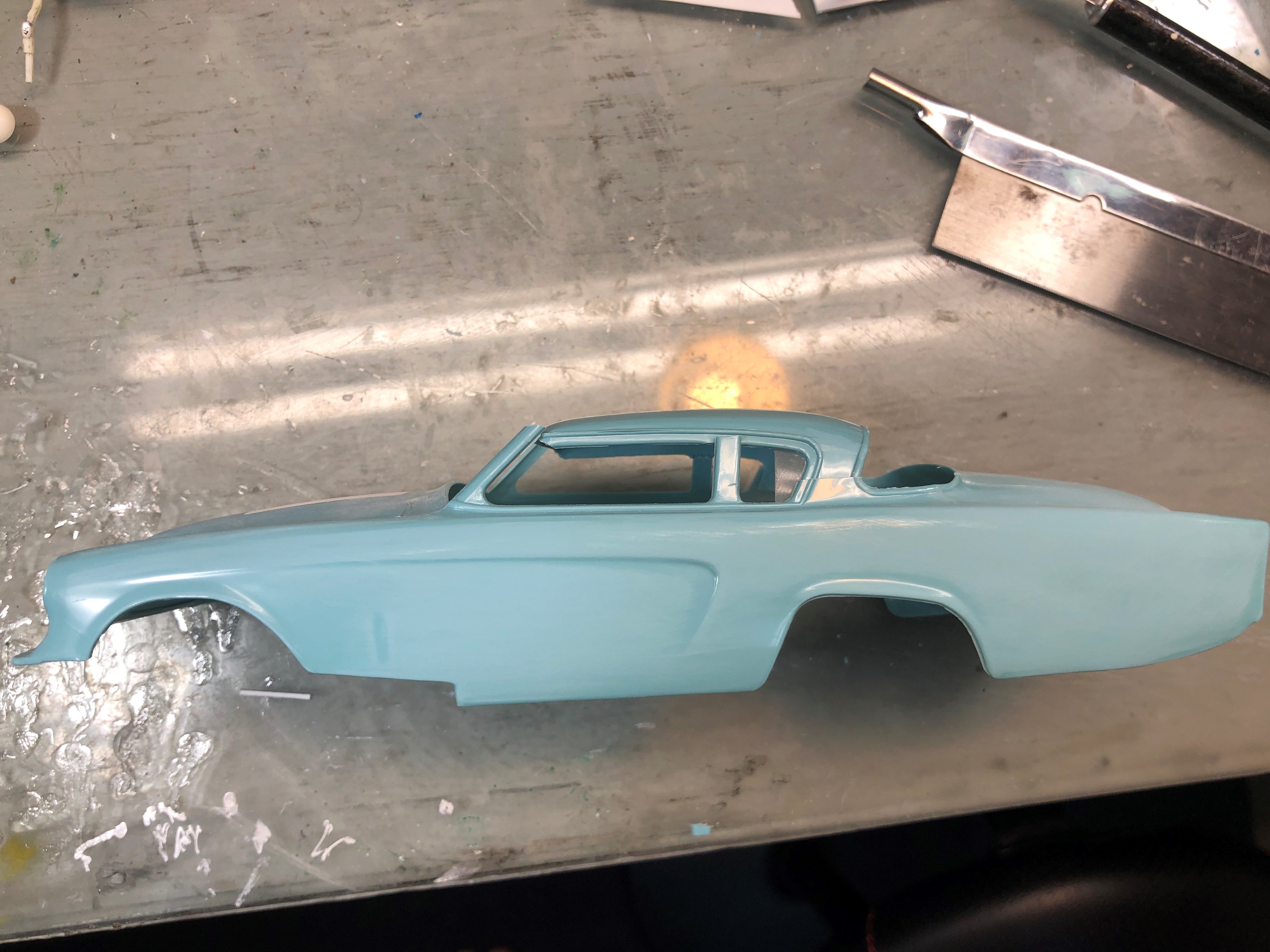

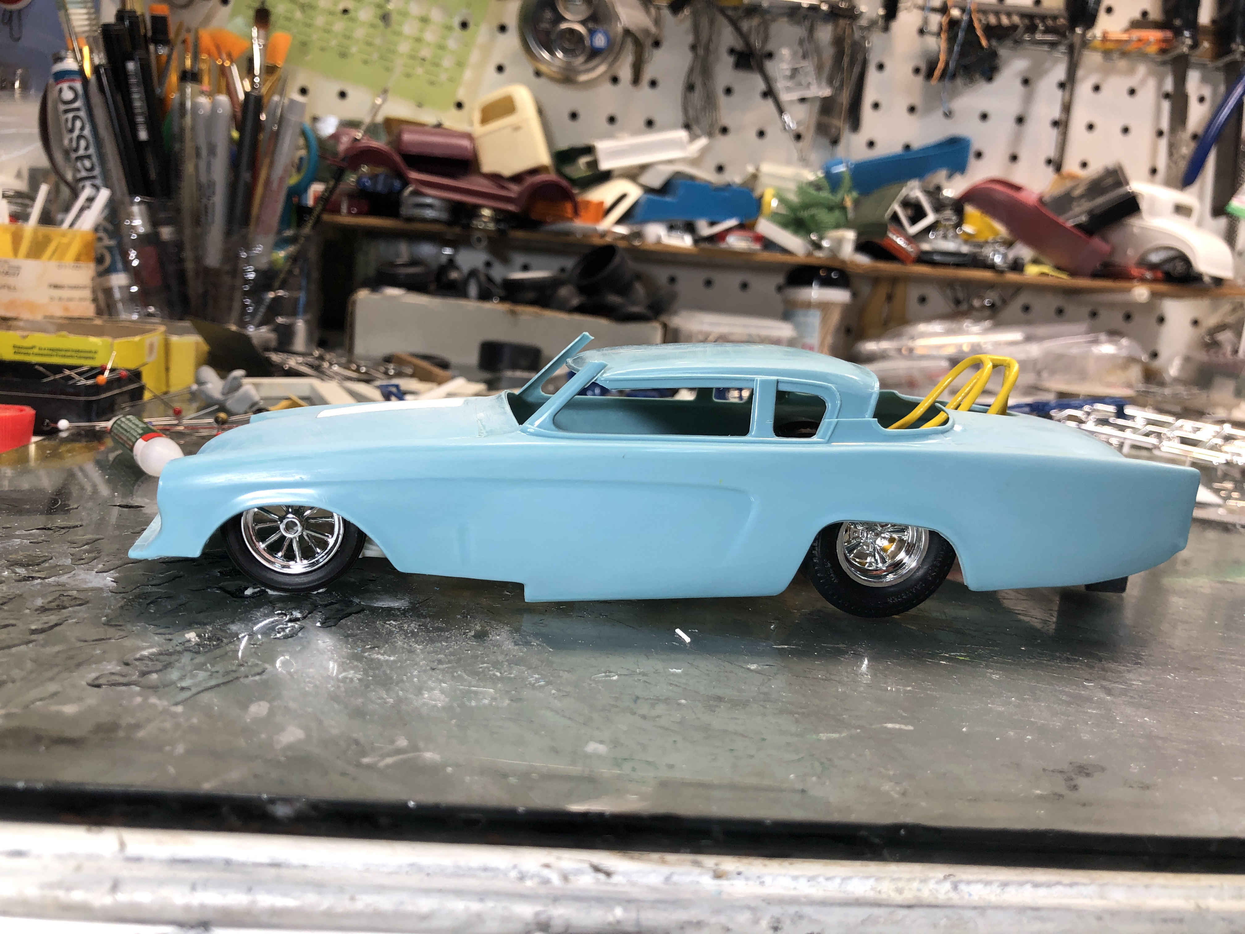

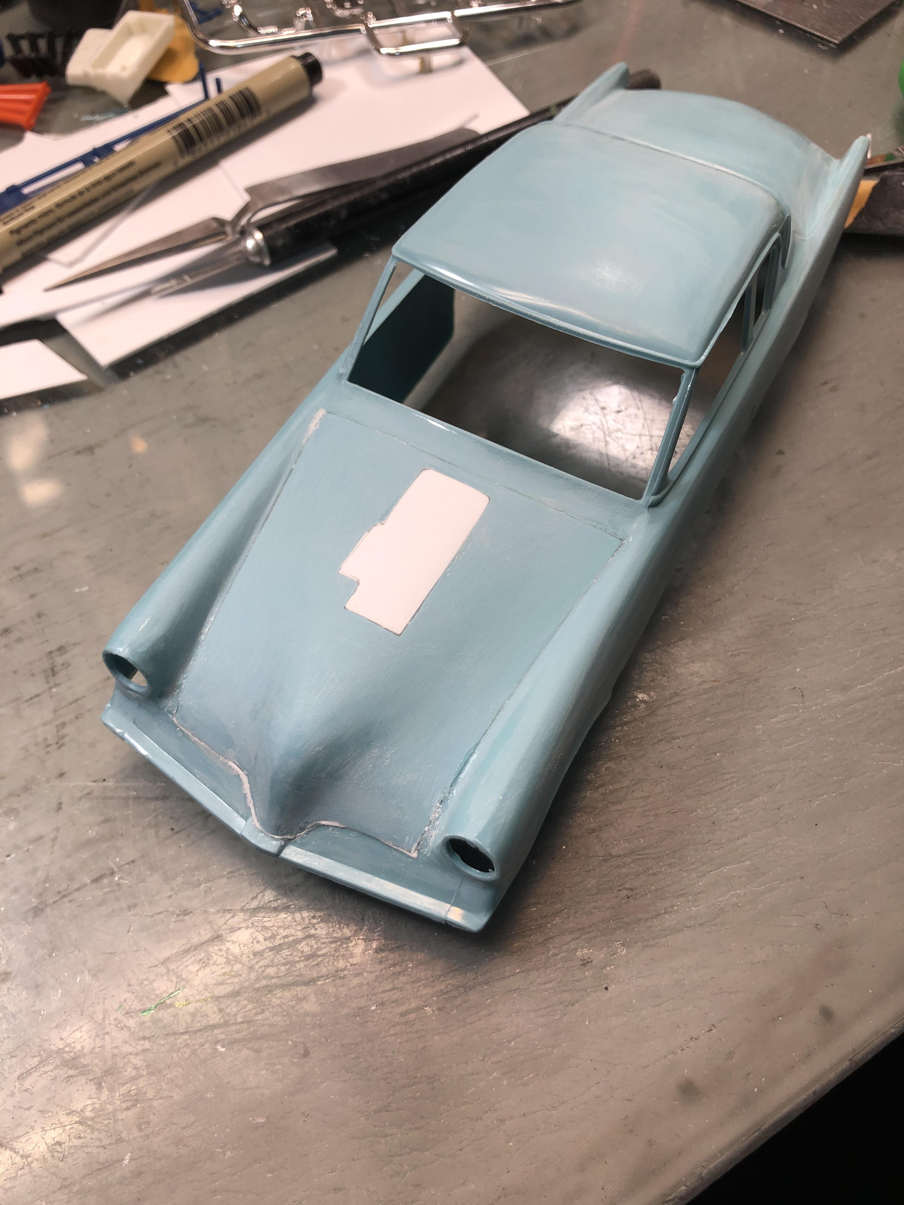

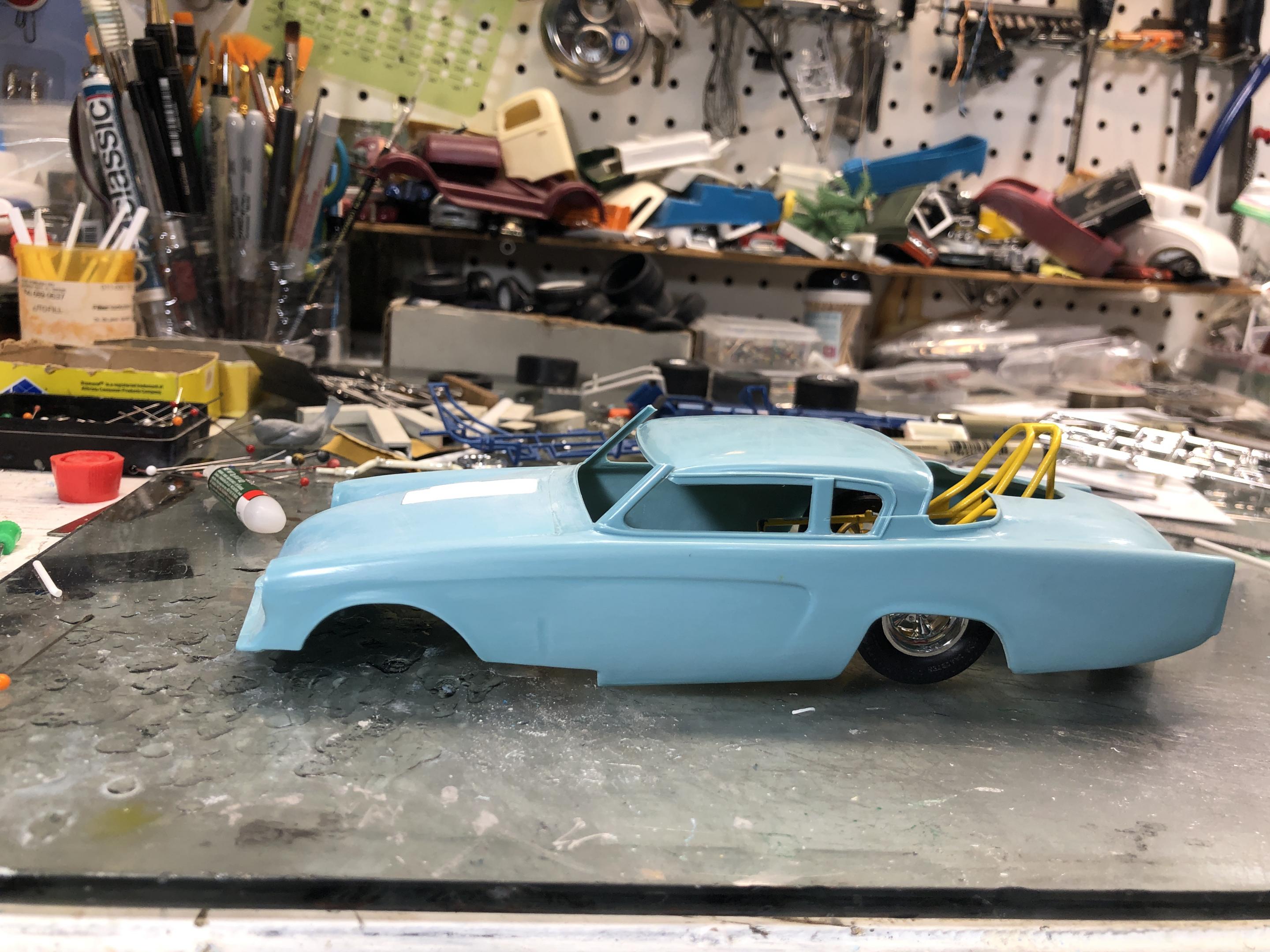

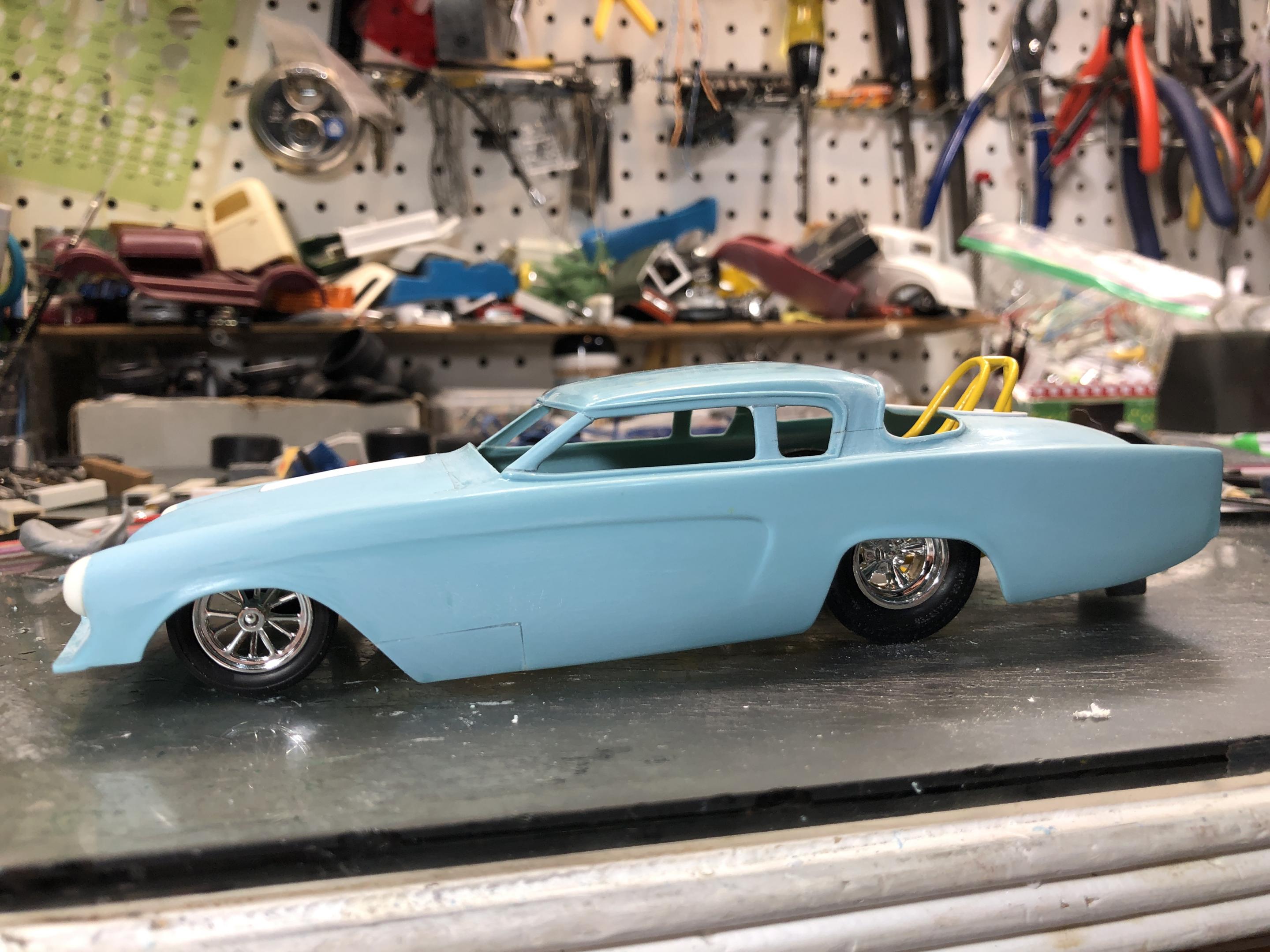

Rocking Rodney Rat Posted August 24, 2021 Posted August 24, 2021 (edited) Here's another idea that has been kicking around in my cranium for decades. I got started pulling parts the other day and it demanded to be built. The base is the old Revell Miss Deal (or should I say Ms. Deal?) body. I've always liked the Revellion kit, a Dodge body with the frame from one of the Tony Nancy kits. This is a 'version' of that using the Miss Deal and the frame from the Attempt I kit. The frame is similar to the Mooneyes frame with a narrower roll cage.... Here's the 'yard sale' of parts... The engine of choice is a Hemi from the Cosmic Charger kit using the optional Potvin front mounted blower (chrome parts on the tree on the bottom right). The first order of business is to close up the blower hole in the hood and attach the hood to the body. The hood doesn't fit very well at the front. I filled in the gaps with some thin strips of styrene, some putty and massaging will be needed here... Of course a chop is in order. I'm using this old yellow painted clapped out frame for mock up purposes. I have a fresh one for final use. While the roof is off, I cut out the hole in the trunk area for the roll cage... About like that? Sure! I decided on some 12 spoke front wheels from the Slingster kit that I had aftermarket chrome plated a while ago...thanks to ADL for the suggestion. The chop is completed. I cut in the front fender area with a piece from another Ms. Deal body to fill that hole. The headlight covers are from the AMT '53 Studebaker kit...next up is a front air dam...more to follow. Thanks for looking. -RRR Edited August 24, 2021 by Rocking Rodney Rat 1

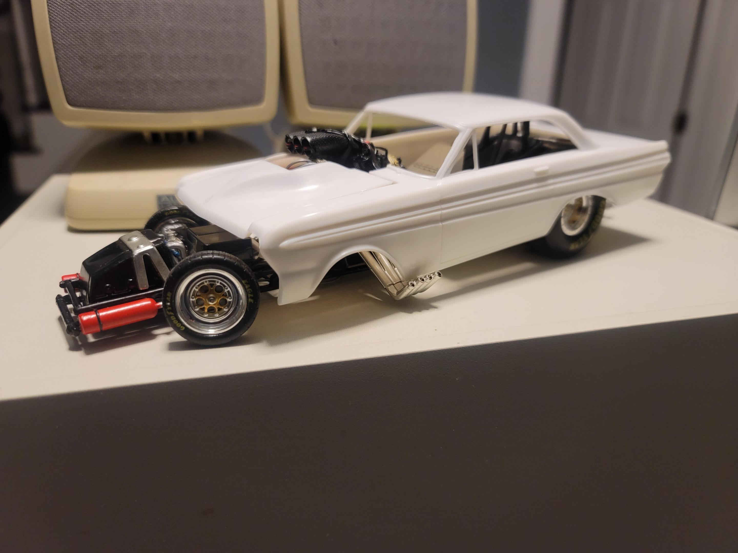

chris chabre Posted August 24, 2021 Posted August 24, 2021 I LOVE IT!!!!! Im actually planning to do this with one of my Chezoom bodies, Im also always looking at dragster chassis' for just the right ones haha here is a modern Funny car chassis and AWB Falcon I started messing with and set aside 1

lucky 130 Posted August 25, 2021 Posted August 25, 2021 Wild! The chop is perfect, all the body work just makes it look fast sitting still.

Dennis Lacy Posted August 26, 2021 Posted August 26, 2021 That last picture with the chopped top looks absolutely WICKED! You’ve got the magic touch when it comes to retro drag cars. Always a treat to watch you put them together.

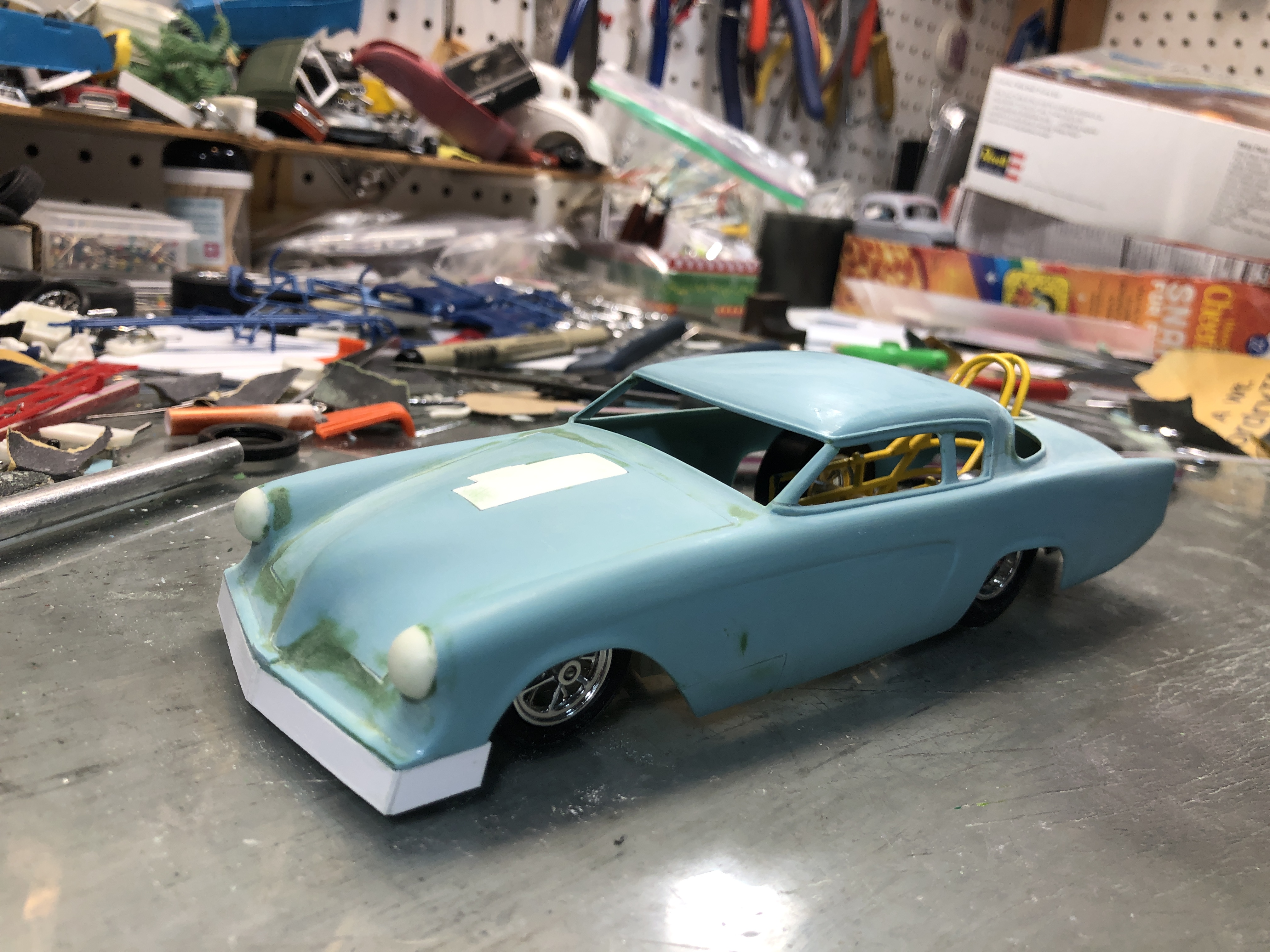

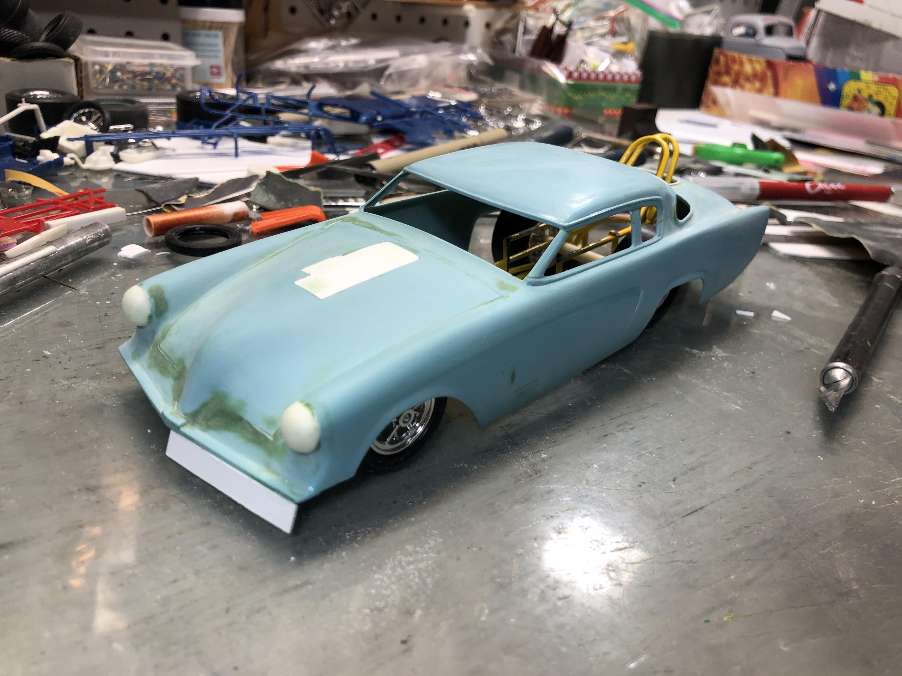

Rocking Rodney Rat Posted August 28, 2021 Author Posted August 28, 2021 back on the Stude this weekend. Fabbing up the front spoiler. Lots of filling and sanding on the front of the hood where it meets the body. The fitment is poor and it's taking a few schmears of putty and elbow grease.... I'm going to add a strip of half round where the white and blue edge meets, that will clean it up a bit...more later. -RRR

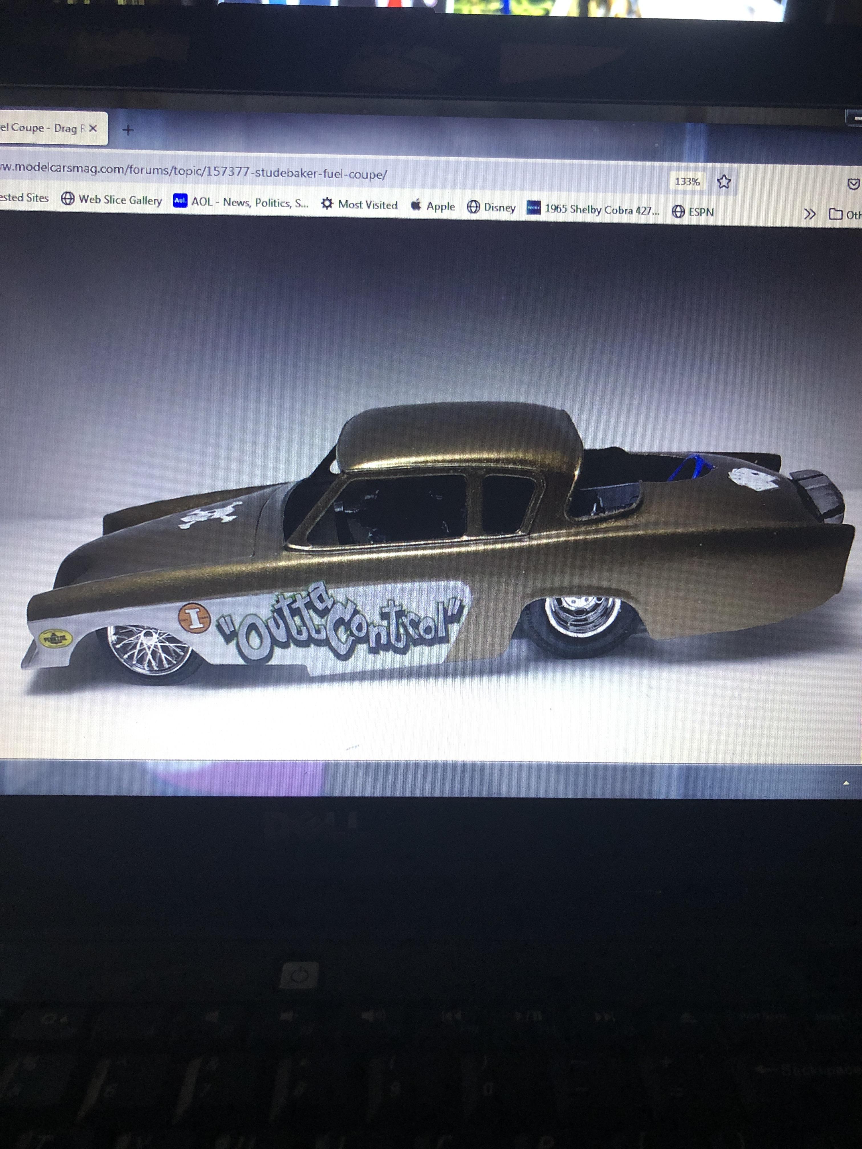

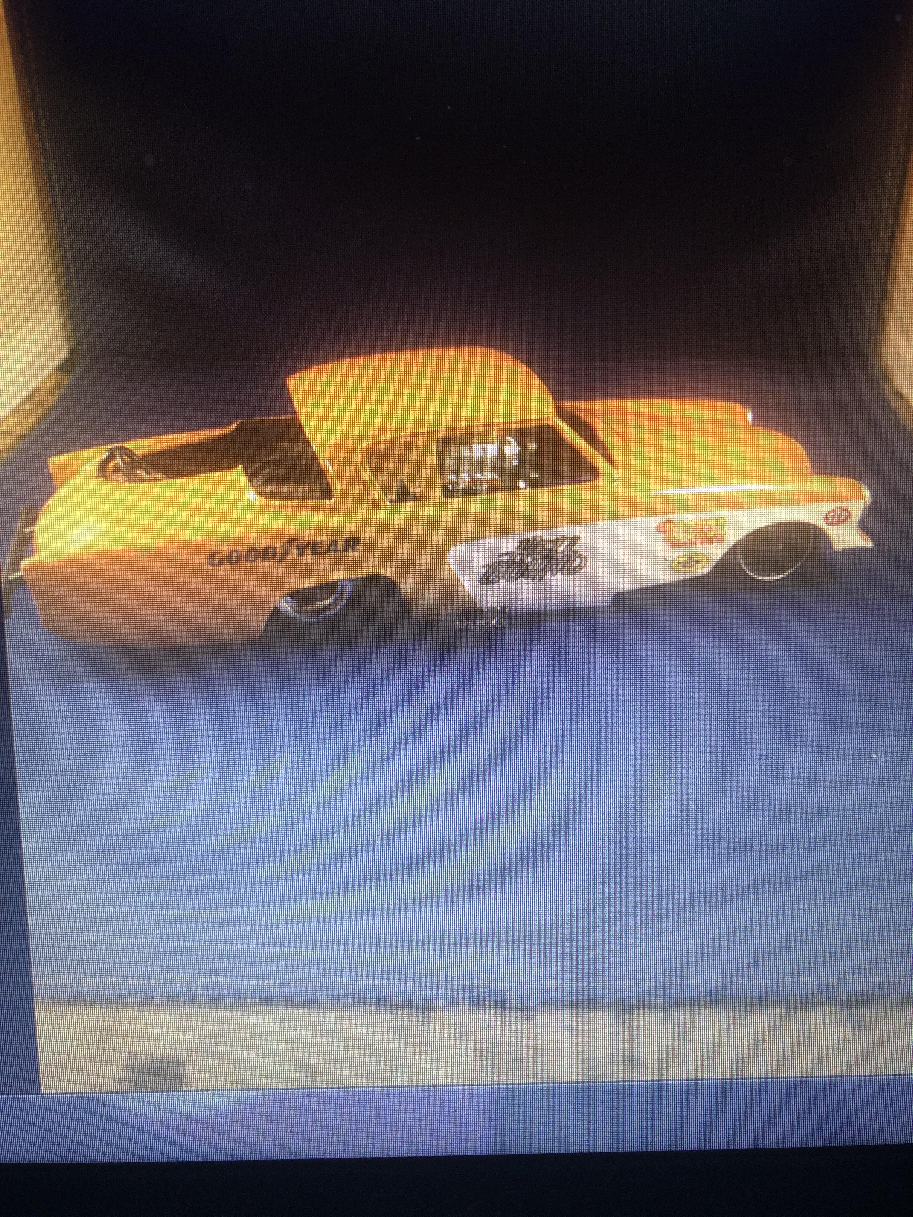

cobraman Posted August 28, 2021 Posted August 28, 2021 Cool project ! Not to take away from your build but thought you might like to see a couple I did .
Rocking Rodney Rat Posted August 28, 2021 Author Posted August 28, 2021 26 minutes ago, cobraman said: Cool project ! Not to take away from your build but thought you might like to see a couple I did . Yup, very kool, Ray, thanks for posting. I knew I'd seen some done before. I'm also planning to mask off the boomerang side swipe as you did....still debating color combo... -RRR
cobraman Posted August 29, 2021 Posted August 29, 2021 Looking at yours I wish I had thought to fill in the header area..

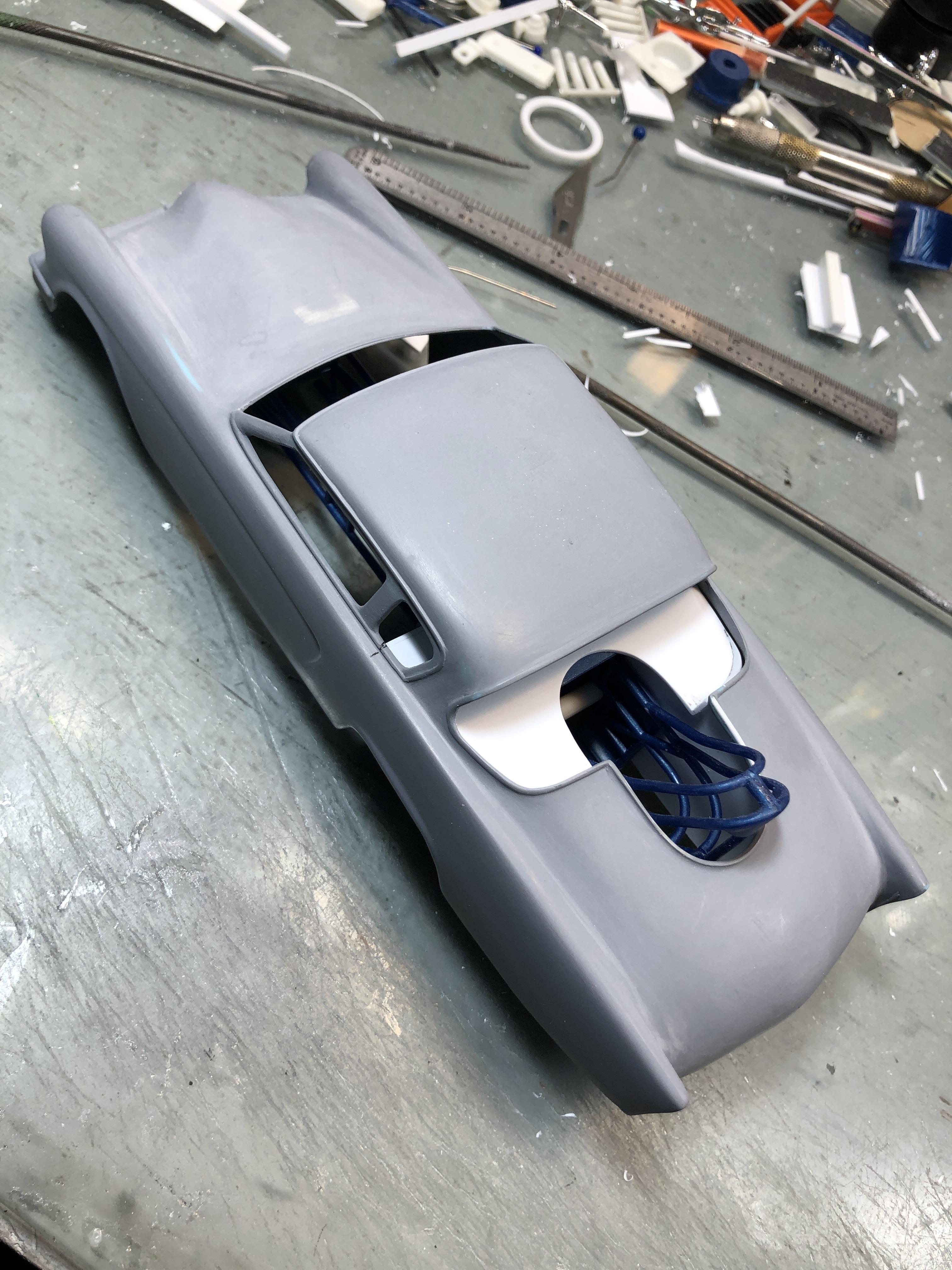

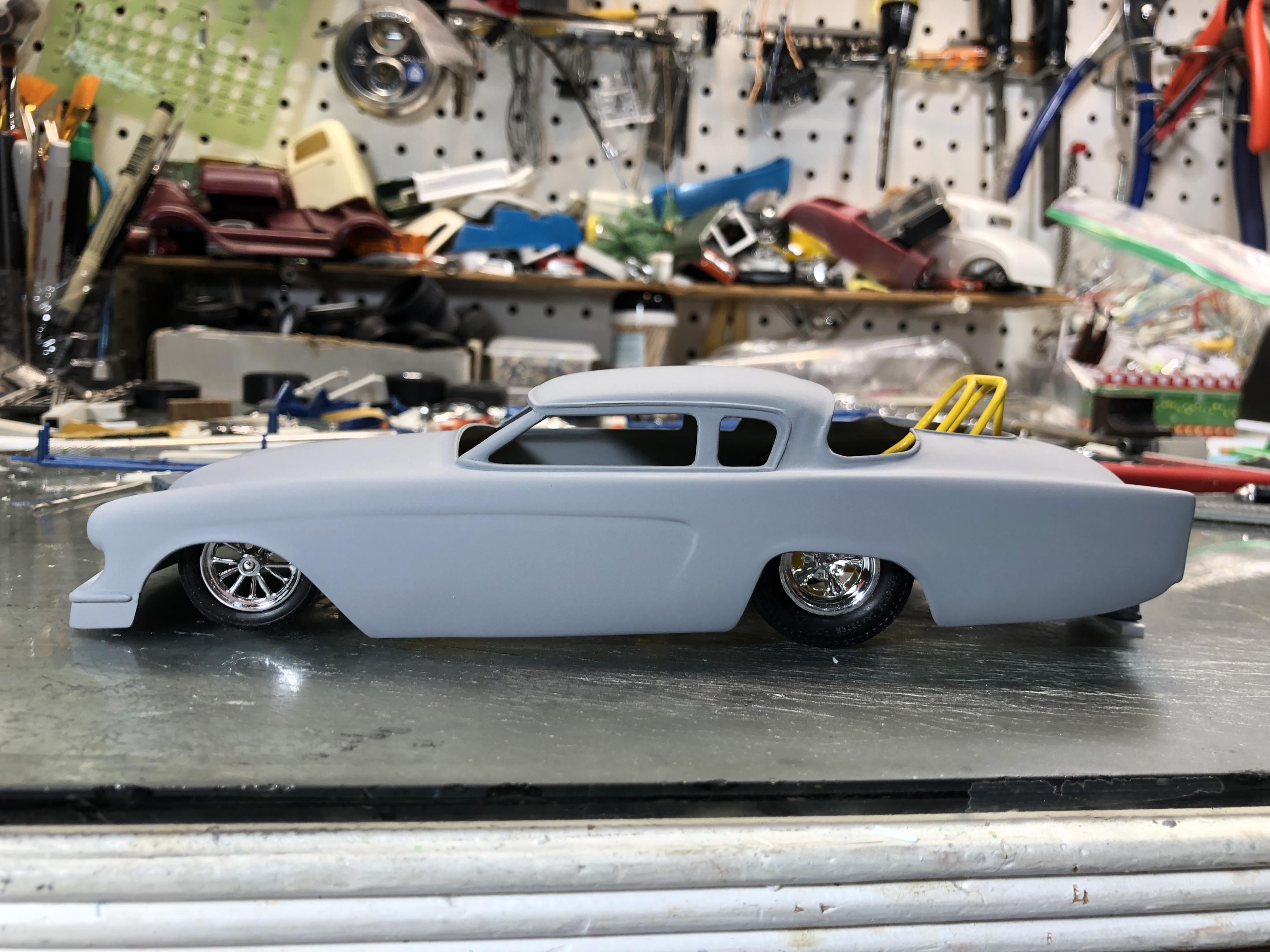

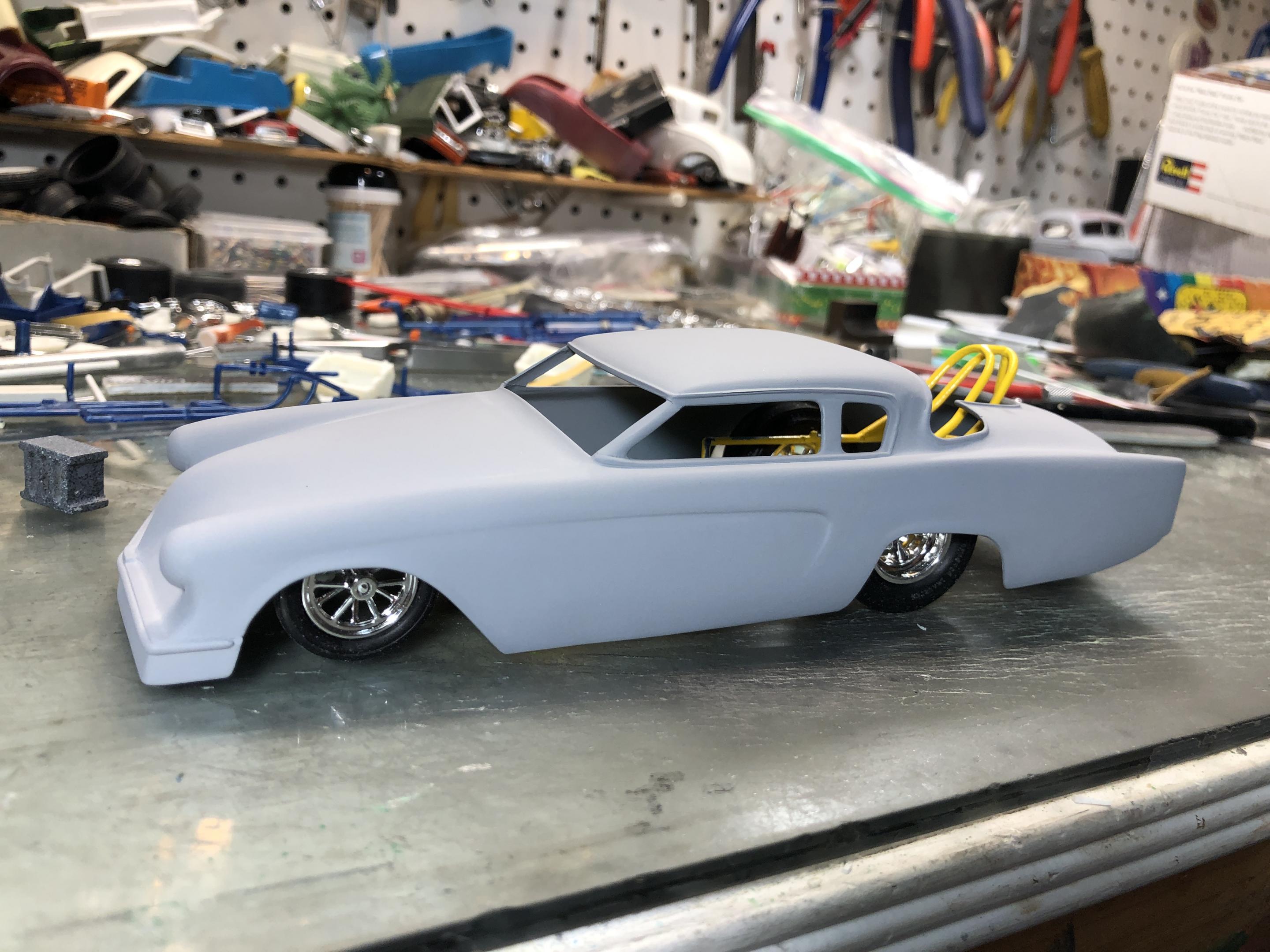

Rocking Rodney Rat Posted August 29, 2021 Author Posted August 29, 2021 I shot a quick coat of primer to see how the body looks...a few spots to work on, but not too bad at all... now to turn my attention to the chassis, suspension and engine... -RRR 1

Draggon Posted September 3, 2021 Posted September 3, 2021 Great project RRR! Love that chop, it's looking really swoopy. This will make a great companion to that Mr. Speed funny car you did awhile back!
Limeyglue Posted September 3, 2021 Posted September 3, 2021 This looks really cool. The chop looks perfect

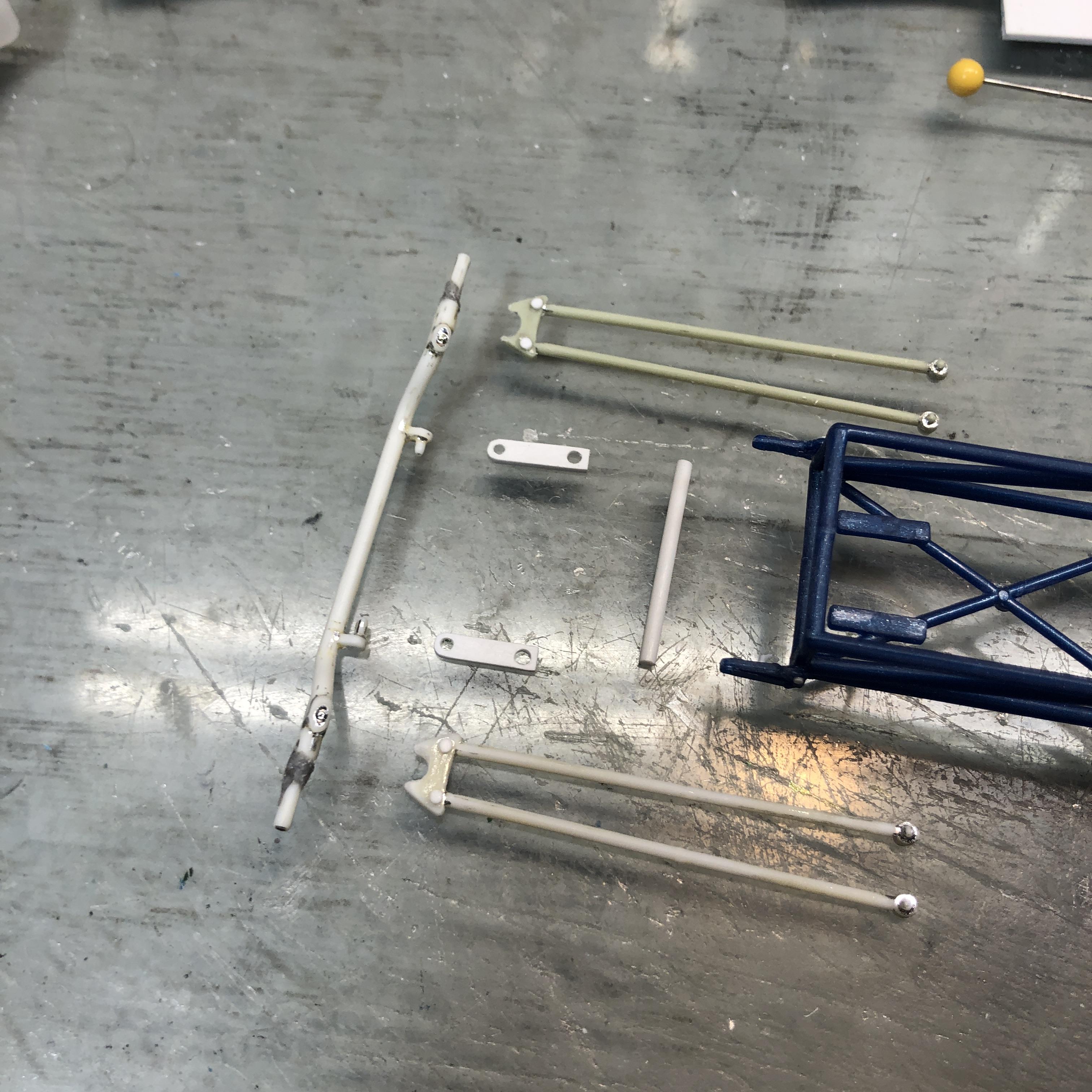

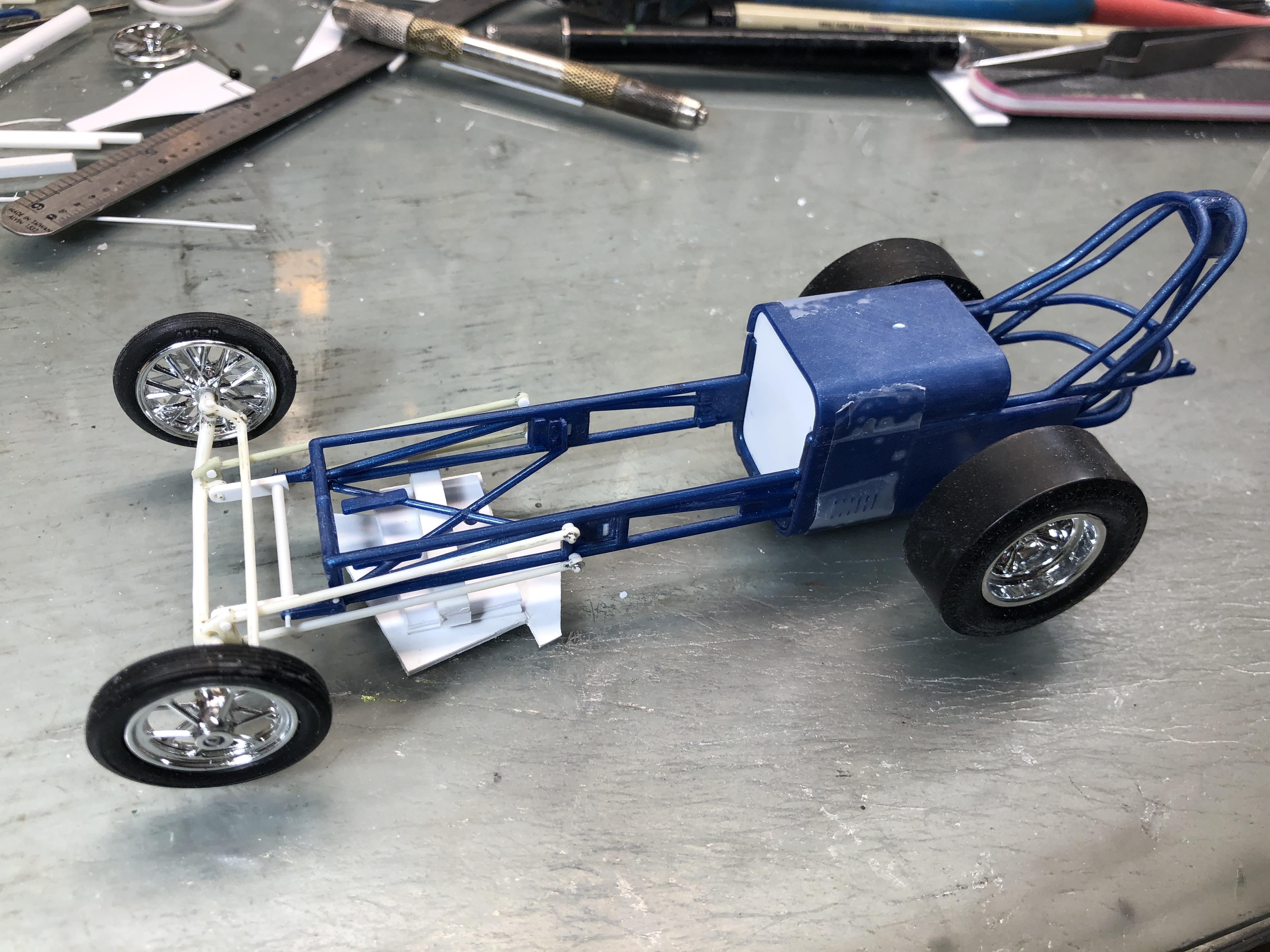

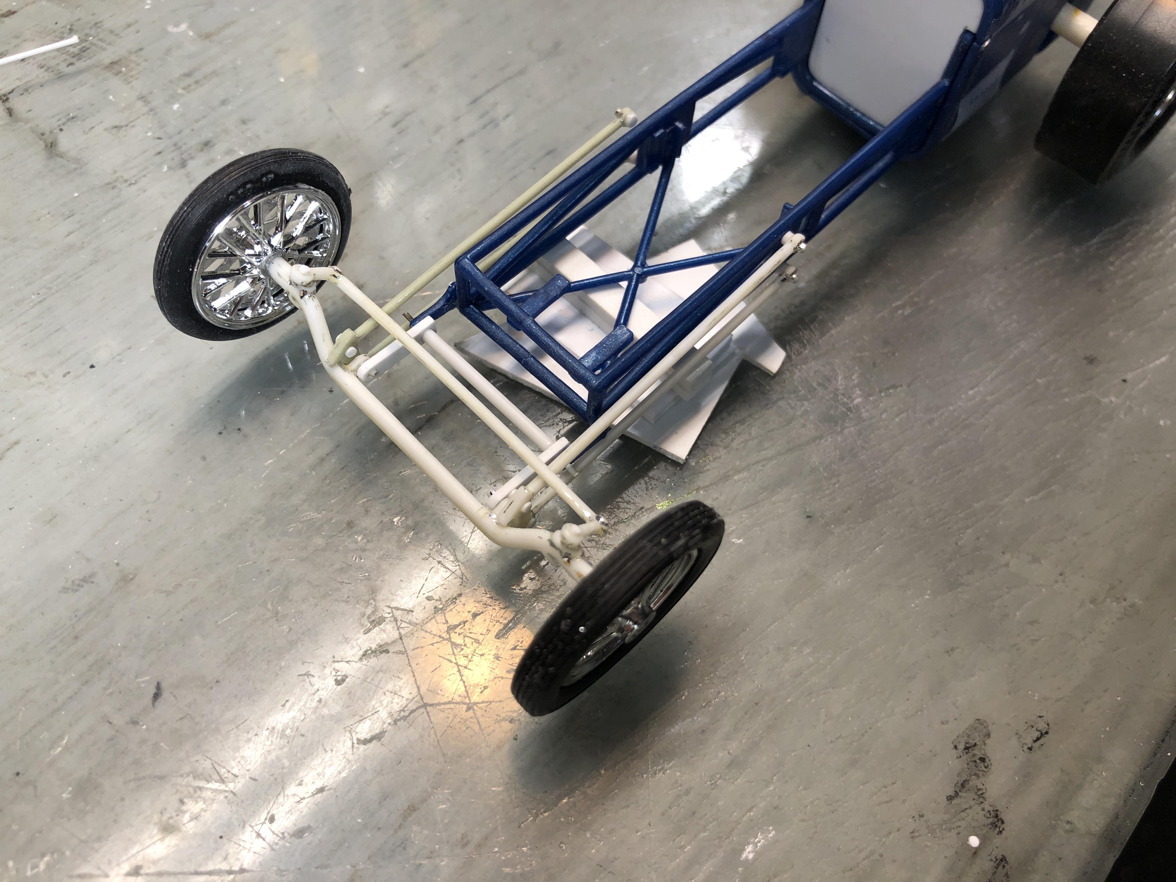

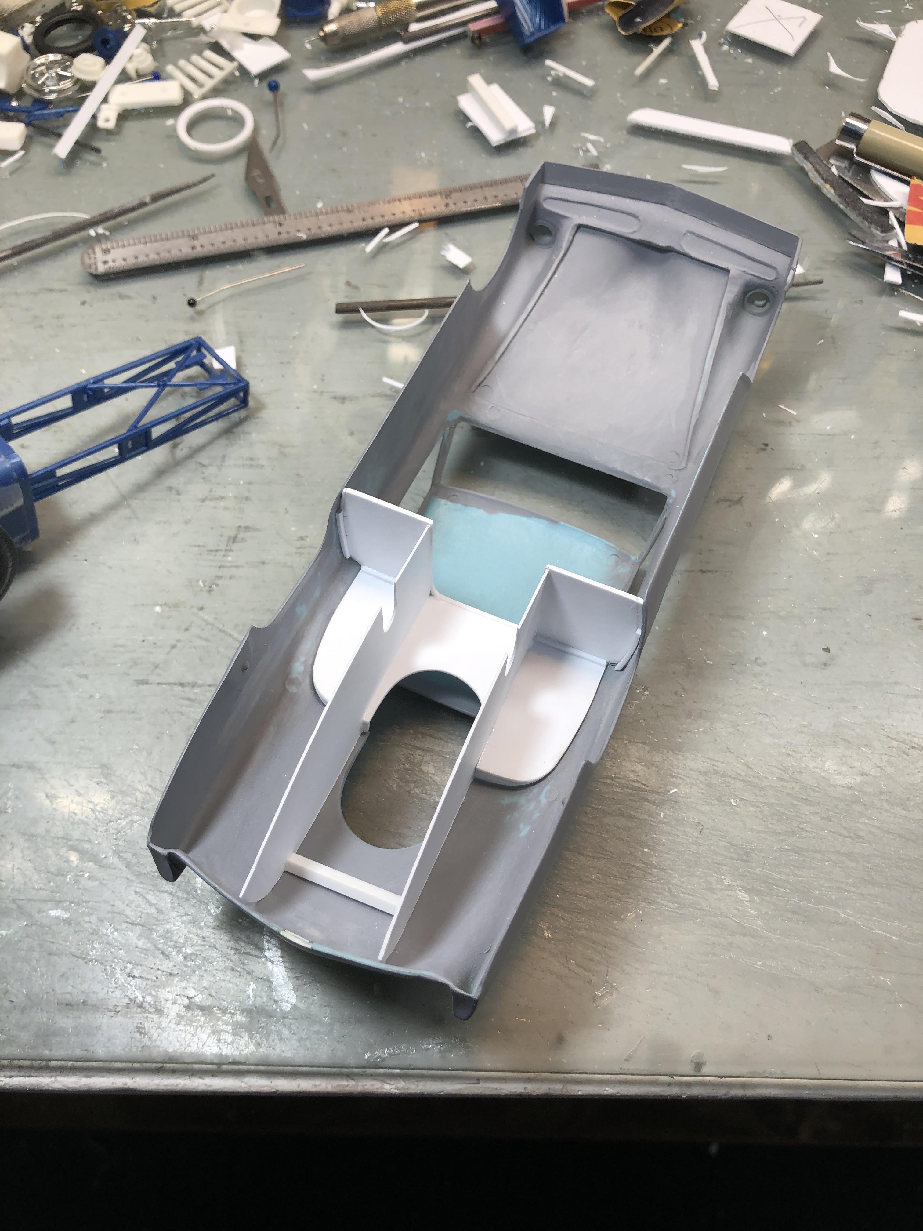

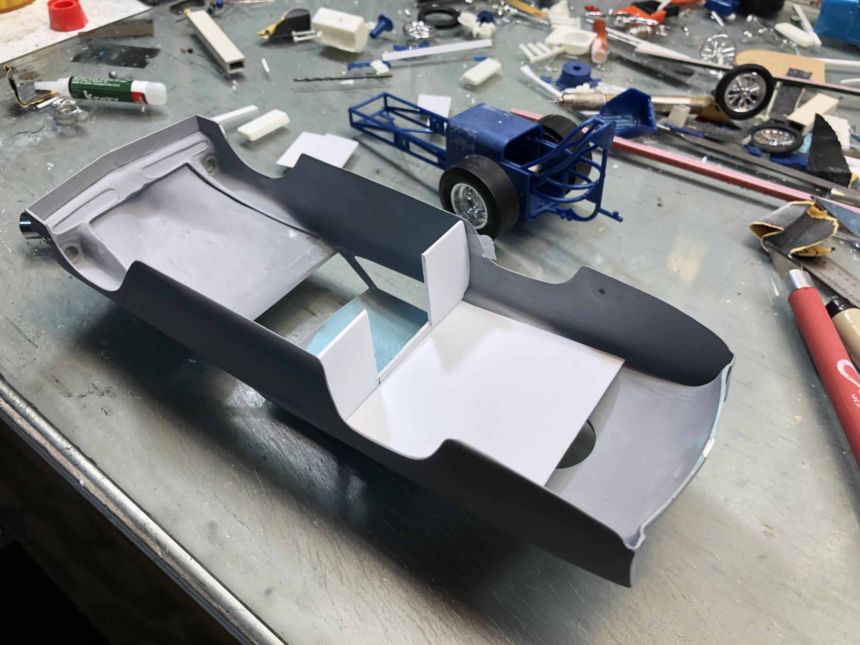

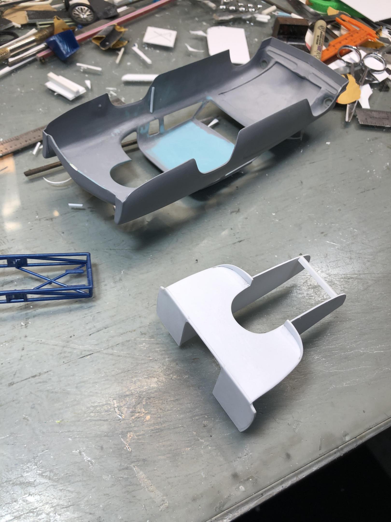

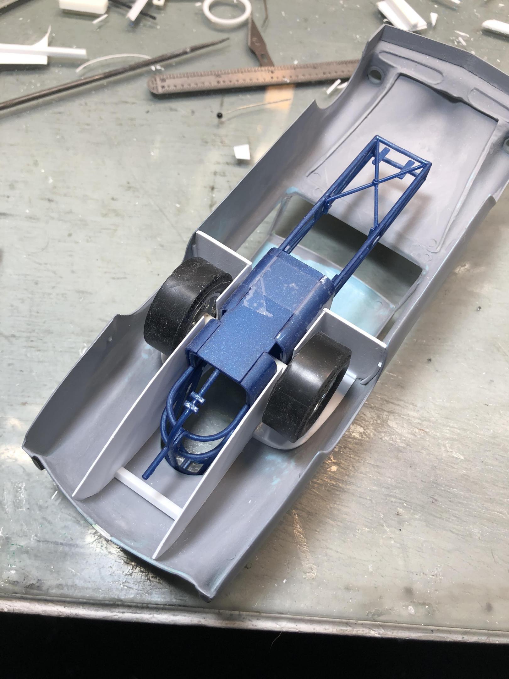

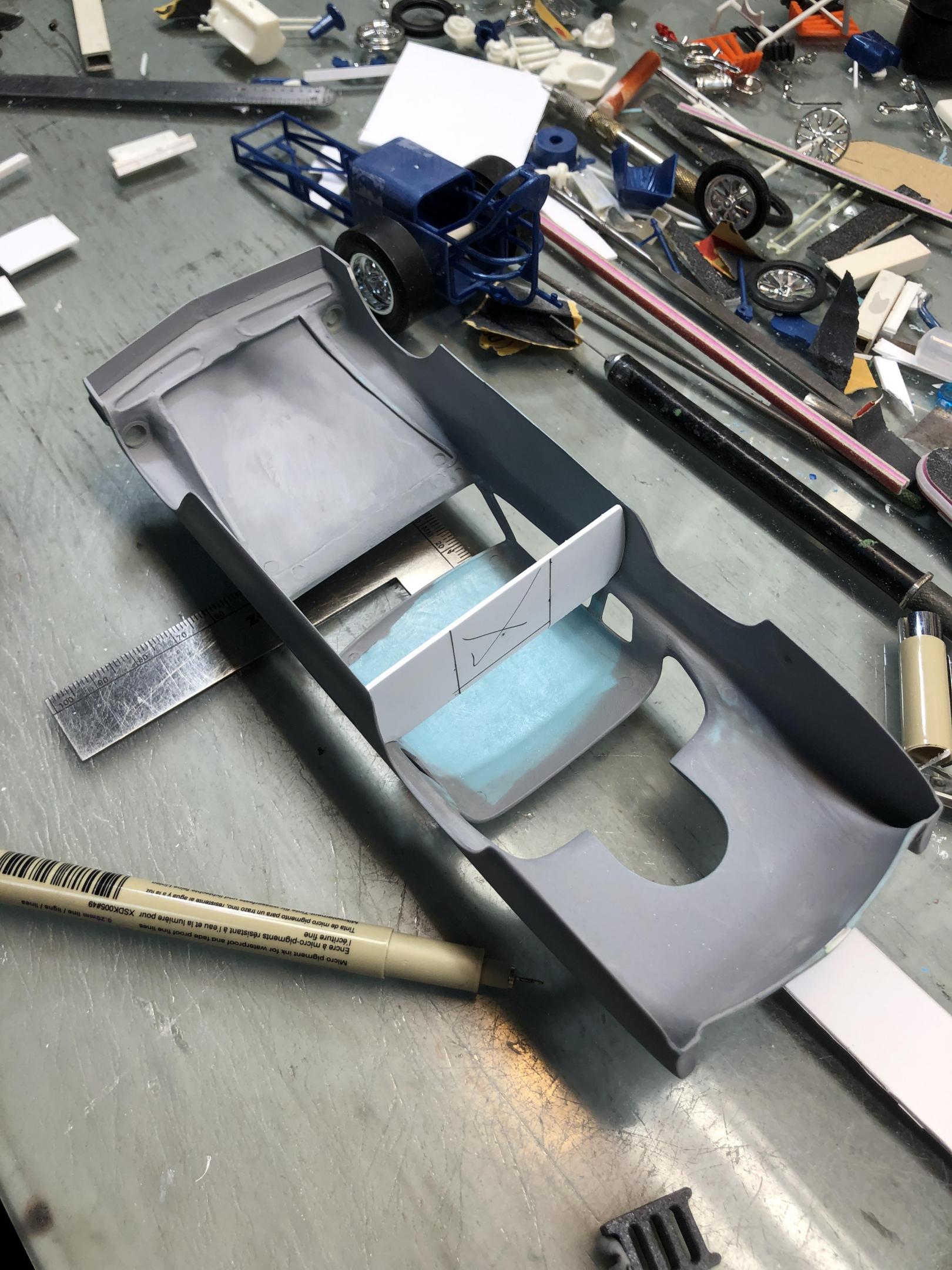

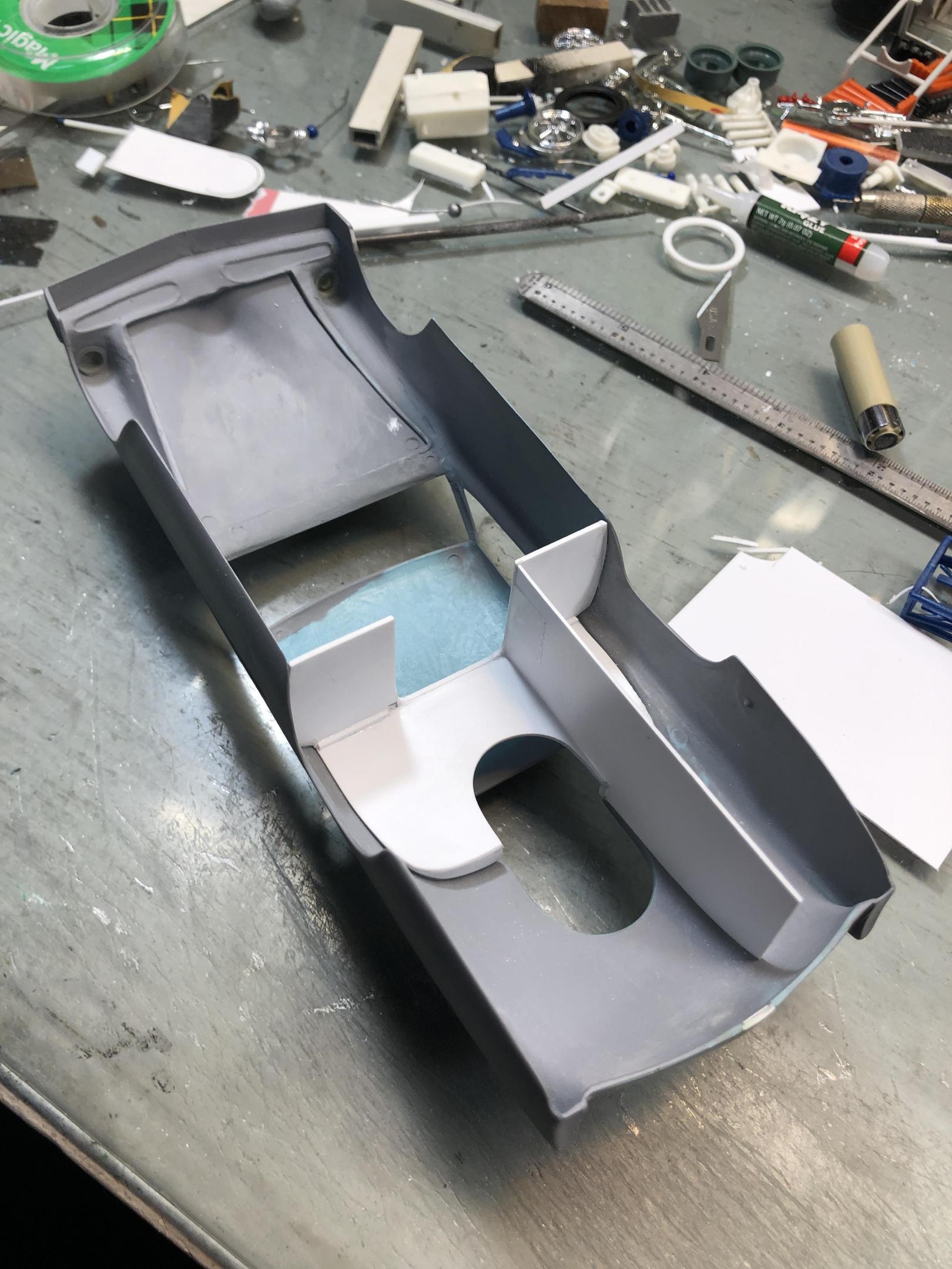

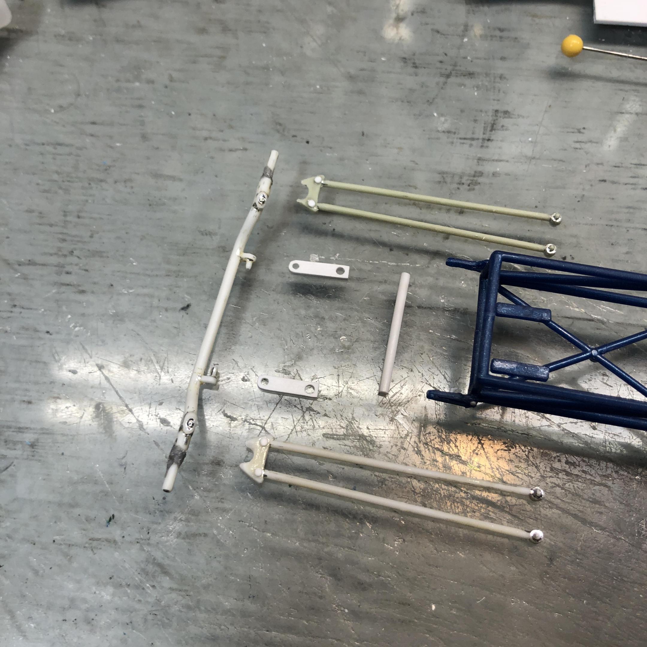

Rocking Rodney Rat Posted September 7, 2021 Author Posted September 7, 2021 (edited) Work continued on the Stude this past weekend. I fabricated up an interior/firewall.... I also got the front suspension dialed in.... the front axle is from the Cosmic Charger, the four links are from a Polar Lights funny car kit. More later.... -RRR Edited September 8, 2021 by Rocking Rodney Rat
