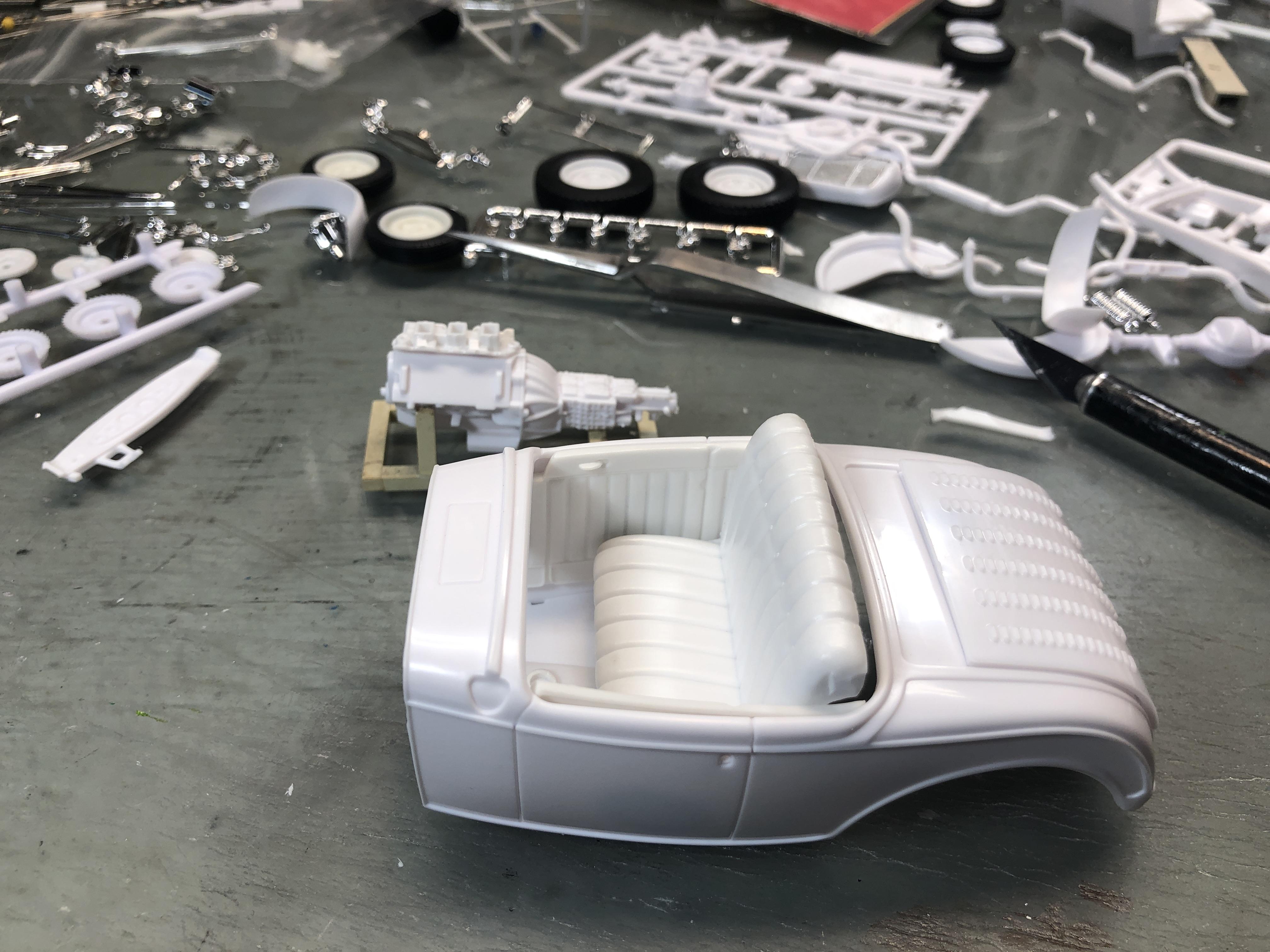

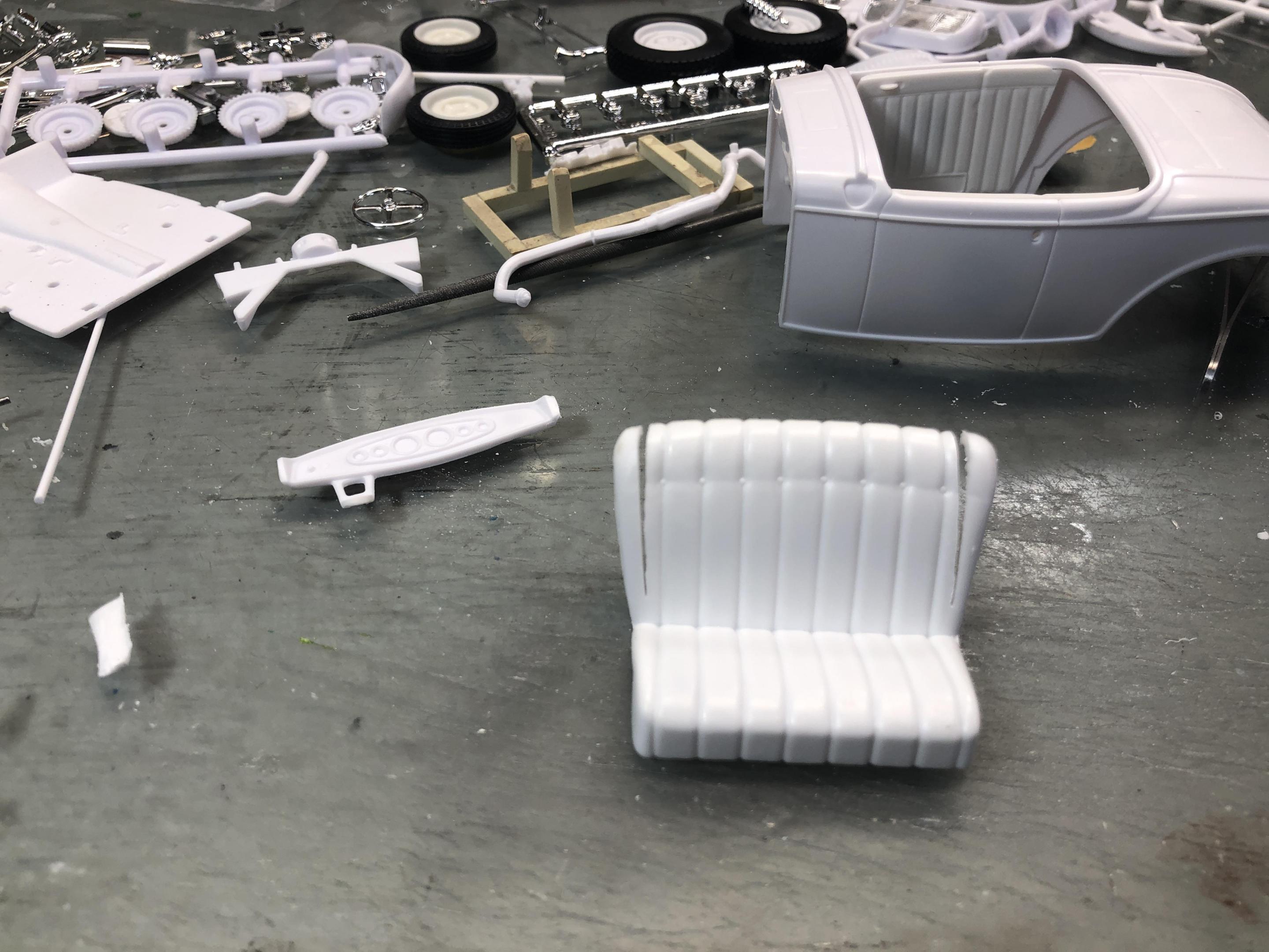

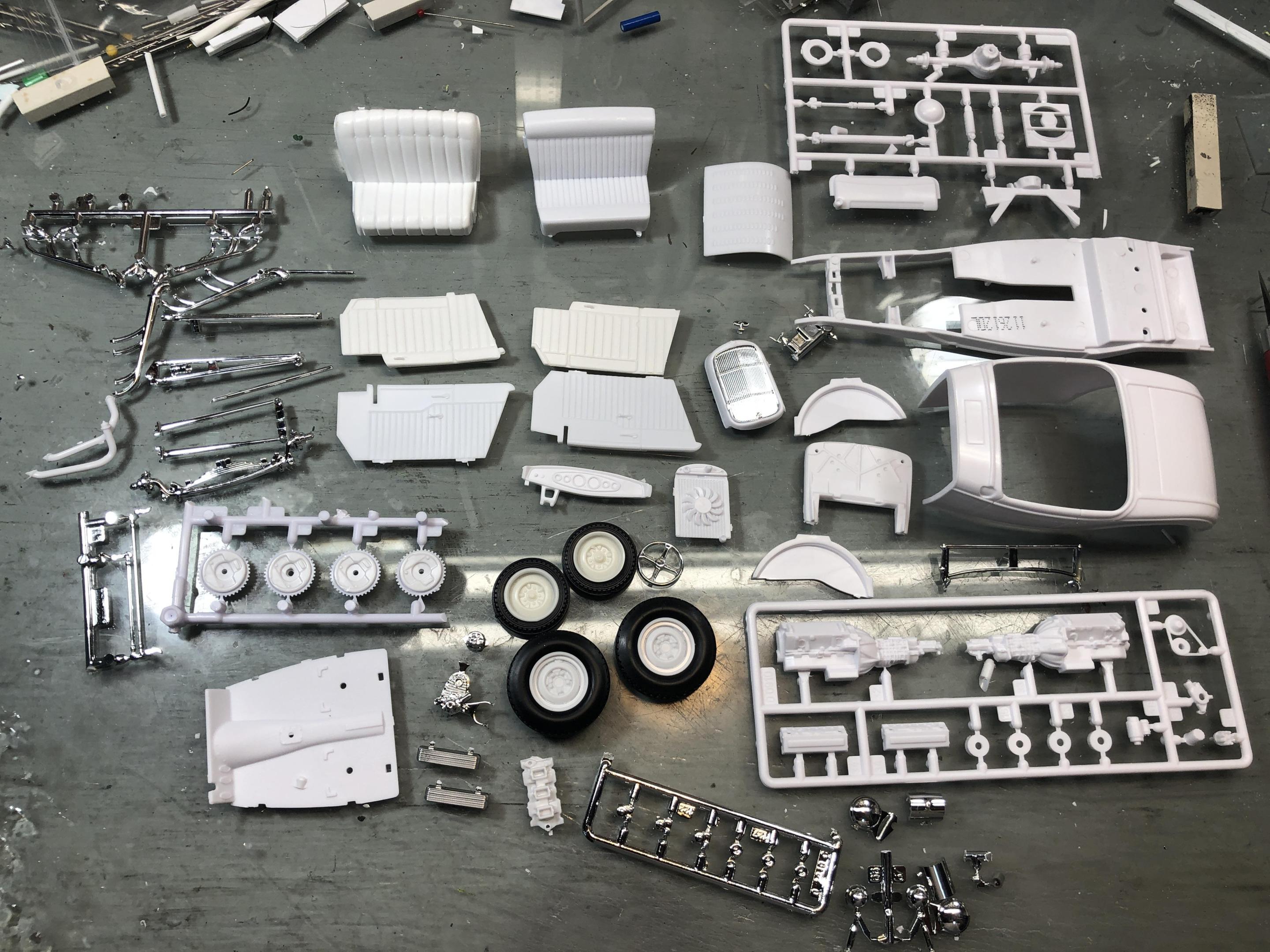

Rocking Rodney Rat Posted November 23, 2021 Posted November 23, 2021 (edited) As a hot rod model car builder, the Revell 1932 Ford series of kits originally released in 1996, starting with the three window coupe, is one of my all time favorite kits. Since that time, Revell has brought out a roadster, Speedwagon, 5 window coupe, a sedan and the Stacy David inspired Rat Roaster. Revell has announced that they will be modifying the Rat Roaster kit, without the Stacy David tie-in. Plans are for a DuVall windshield and Limefire style headers and a redone interior and...??? The Rat Roaster, is a wealth of parts. It has a blown Weiand SBC with a standard transmission, really nice wheels and tires, but some other things are not so cool. The original car was a mishmash of styles, IMHO. In any case, I thought it would be a fun project to remove the Rat from the Roaster. Although this kit is based on the previous '32s Revell has released, but it does appear this is a whole new tooling. The body is far superior to the original roadster body and the chopped windshield is sweet. So, I started pulling parts, many from other '32 kits and some from the Revell Model A series kits. I had a couple of other projects that stalled for various reasons and I feel like I need a simple build to work on... Here's my 'yard sale' of parts, obviously, not all of the parts pictured below will be used... From the Model A kits: -Rear wheels and tires, fronts from the parts box. -3x2 intake manifold, carbs, headers (that ugly exhaust pipe 'bump' will be removed). -Finned Buick style brakes. -Rear axle (not shown here). From other '32 kits: -Interior, 5 window or original roadster? Seat from the 3 window coupe? -Louvered trunk lid from the 5 window kit. -I'll most likely use the original '32 style radiator and fan, since I won't need room for the blower belt drive. Otherwise, it's pretty straight up. I'm considering making a ragtop for it. Thanks for looking.... -RRR Edited November 23, 2021 by Rocking Rodney Rat 2

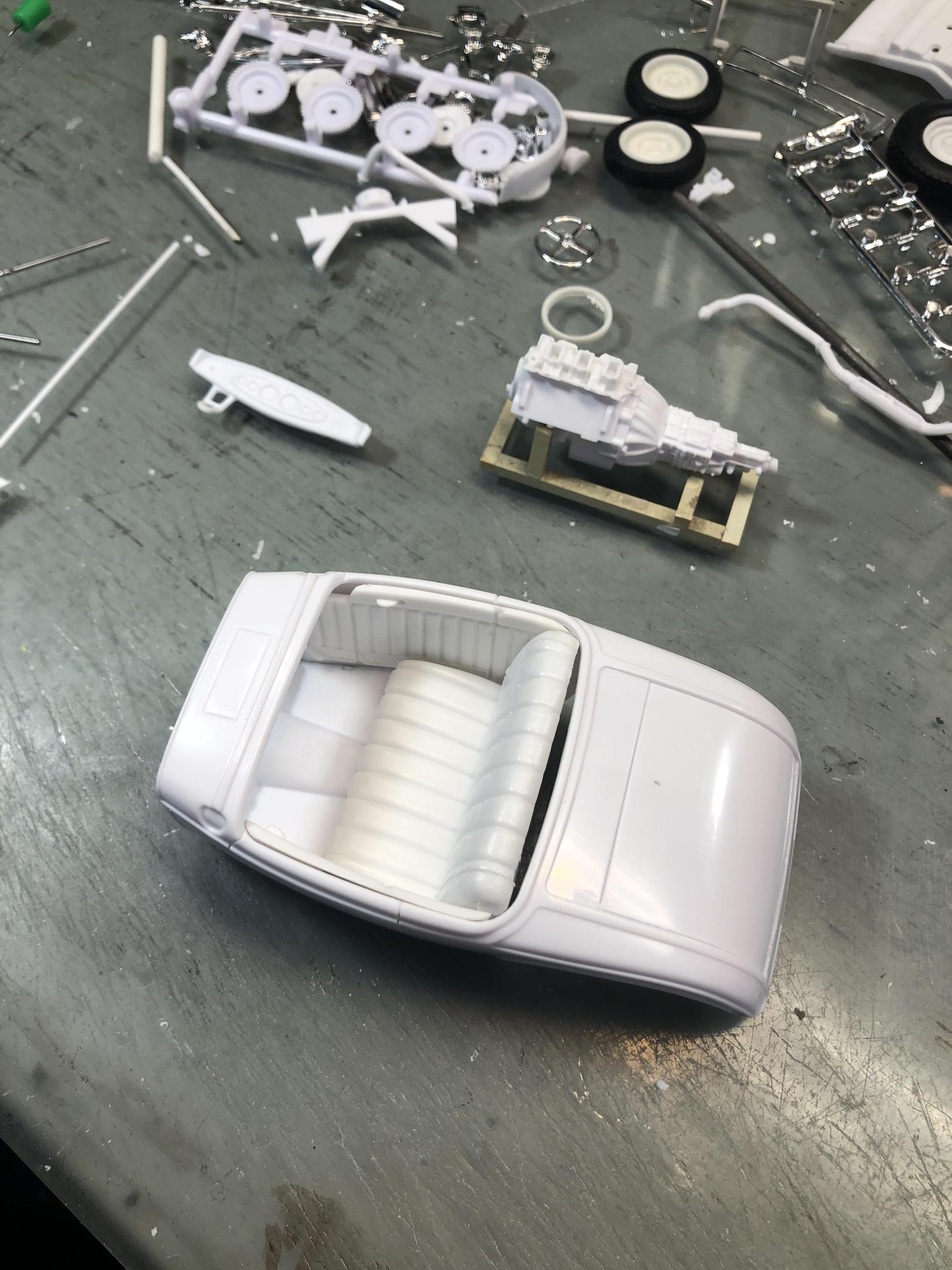

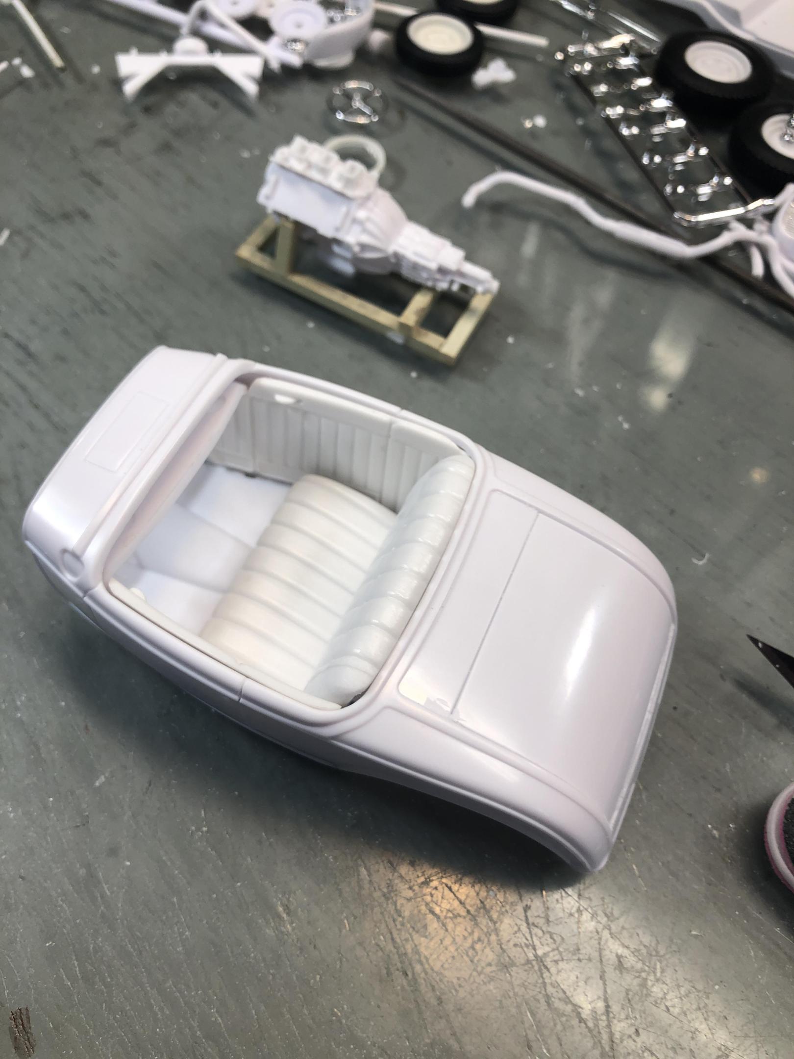

Rocking Rodney Rat Posted November 25, 2021 Author Posted November 25, 2021 I decided to use the original roadster door panels and the seat from the 3window coupe...a slice and a tuck and it fits....-RRR

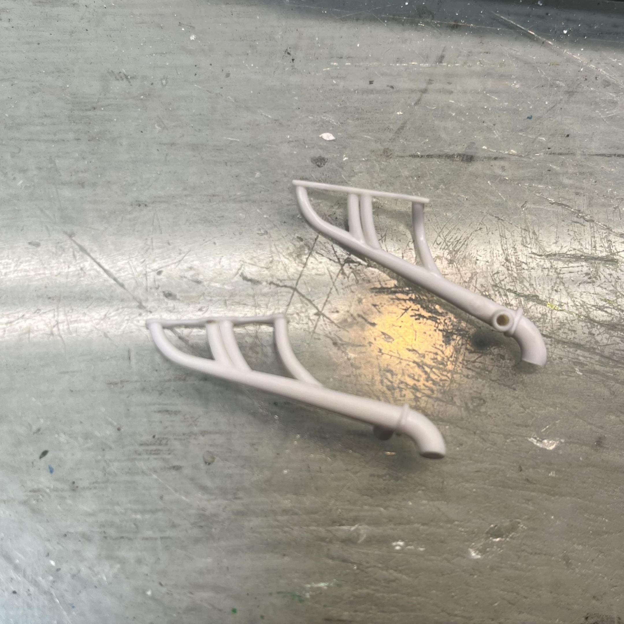

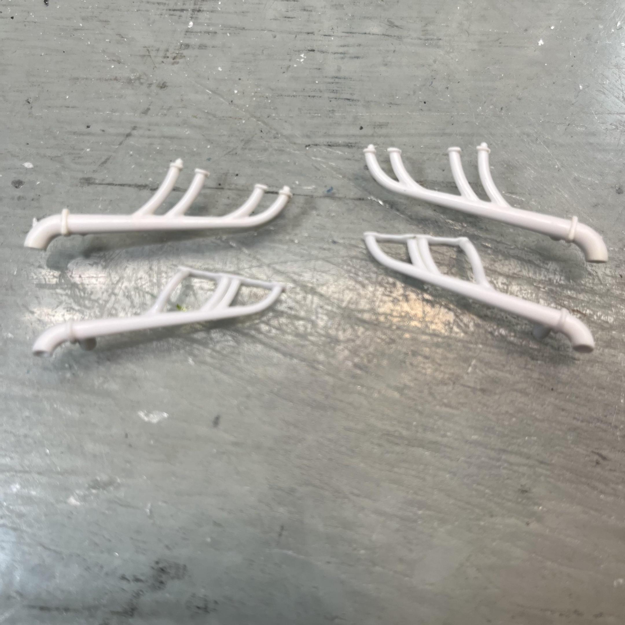

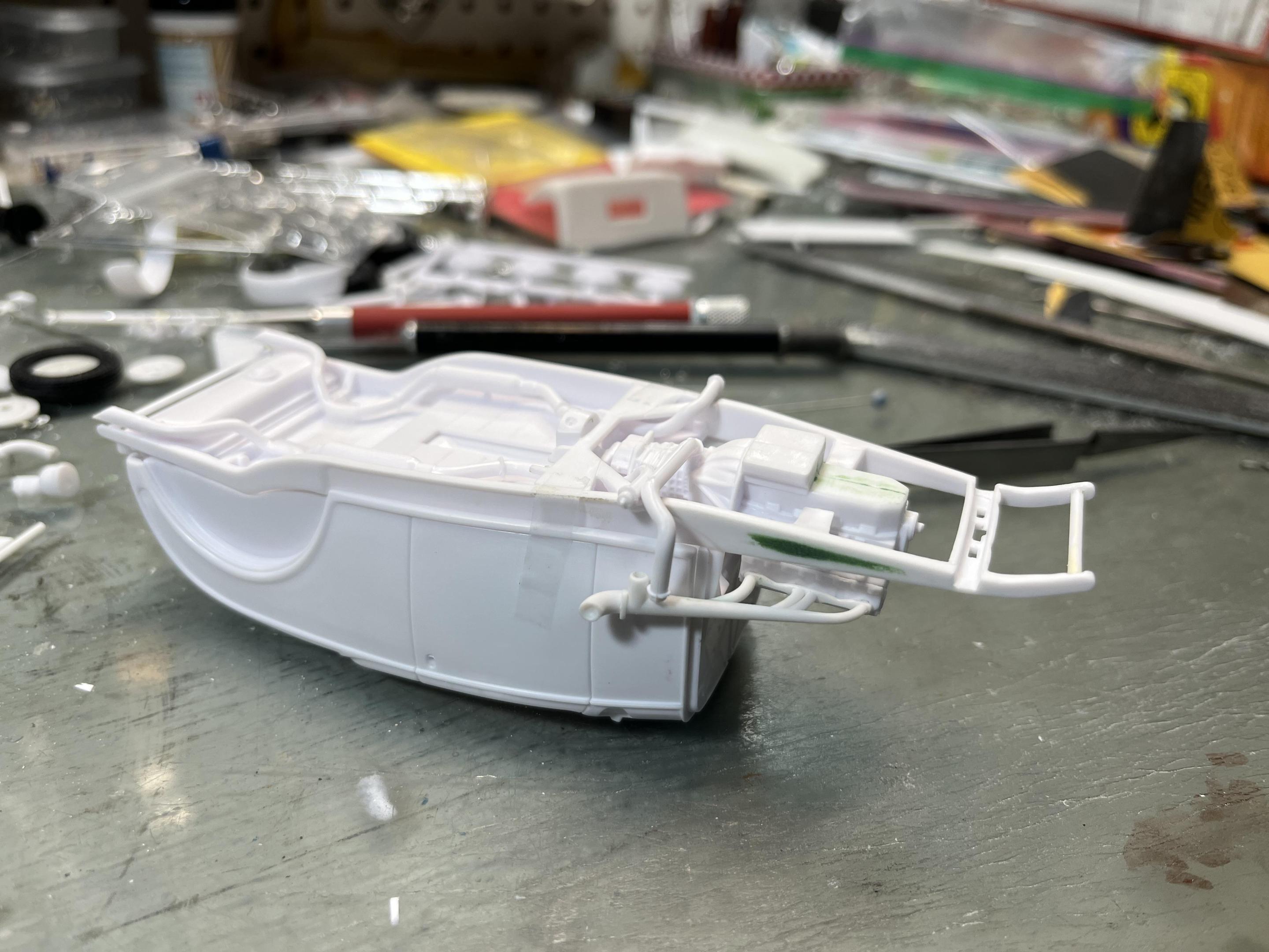

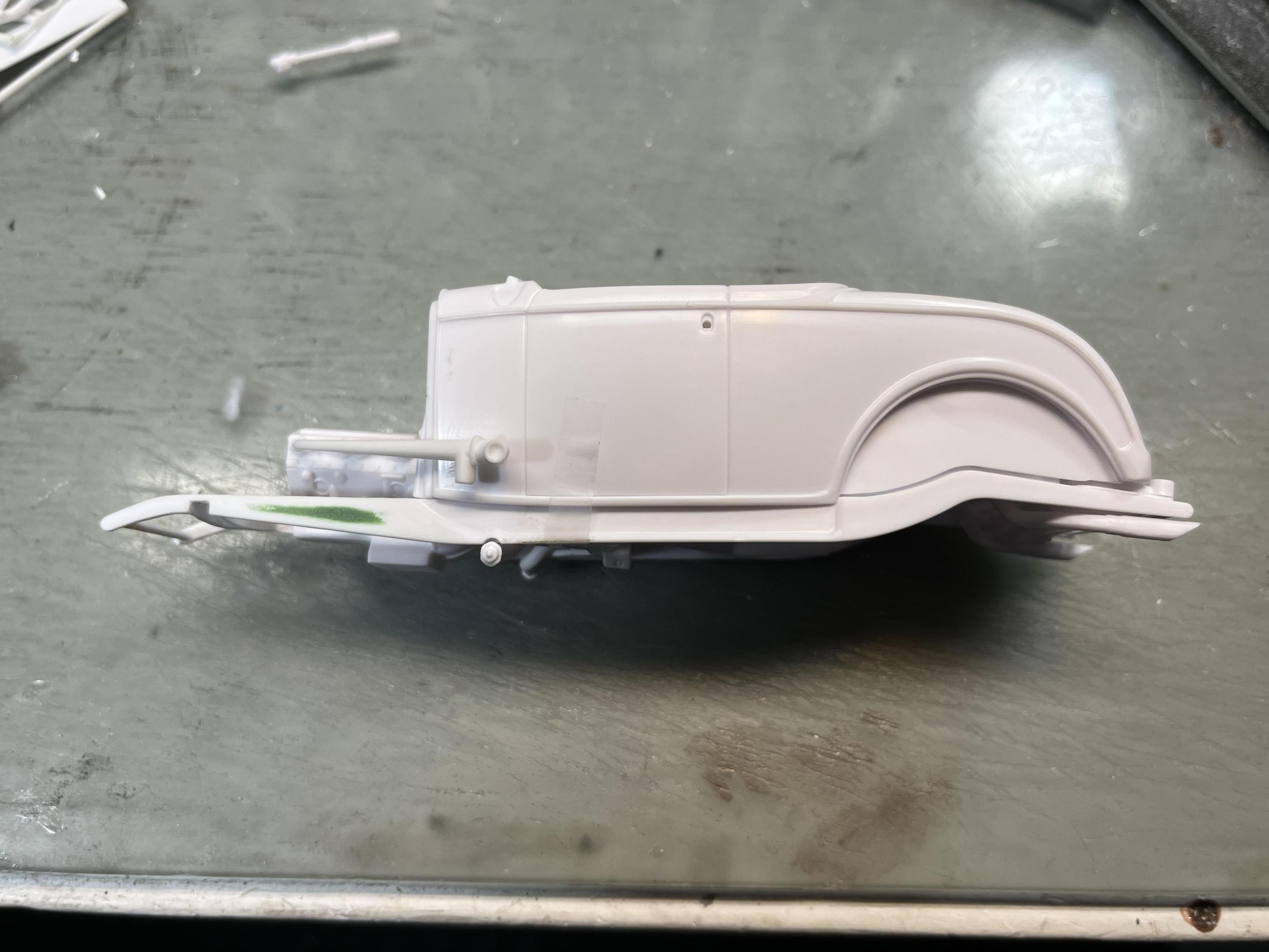

Rocking Rodney Rat Posted November 26, 2021 Author Posted November 26, 2021 The other man modification is to the exhaust system. I'm using the Limefire style SBC headers form the Revell Model A series of kits (roadster and coupe). A quick mockup indicates they'll fit...I really don't like that bump on the #4 header tube, made that way to clear the steering column. Again, with a mockup, I can eliminate that bump and still clear the column. I'll use one of the tubes from the Buick Nailhead headers from the Revell Model A series... The original header (de-chromed) on the top, the header with the tube replaced with one from the Nailhead. Sorry I don't have more and better pix, I got a new phone and I'm still getting used to the camera, some of the pix were way out of focus...more to come.... -RRR 1
mrm Posted November 26, 2021 Posted November 26, 2021 Great job on the headers. I hope Revell don't get lazy and reissue their new roadster with the same headers from their A series.

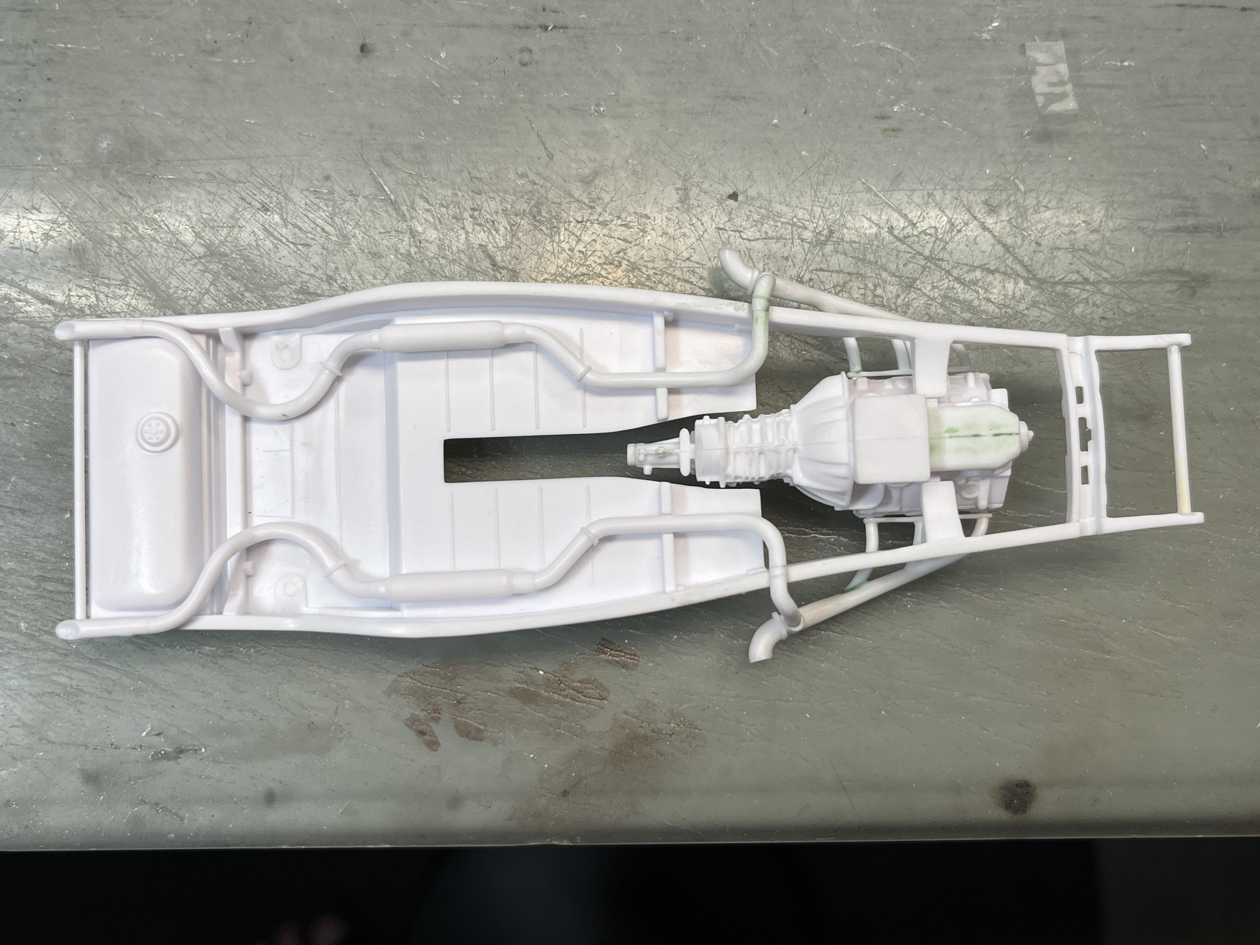

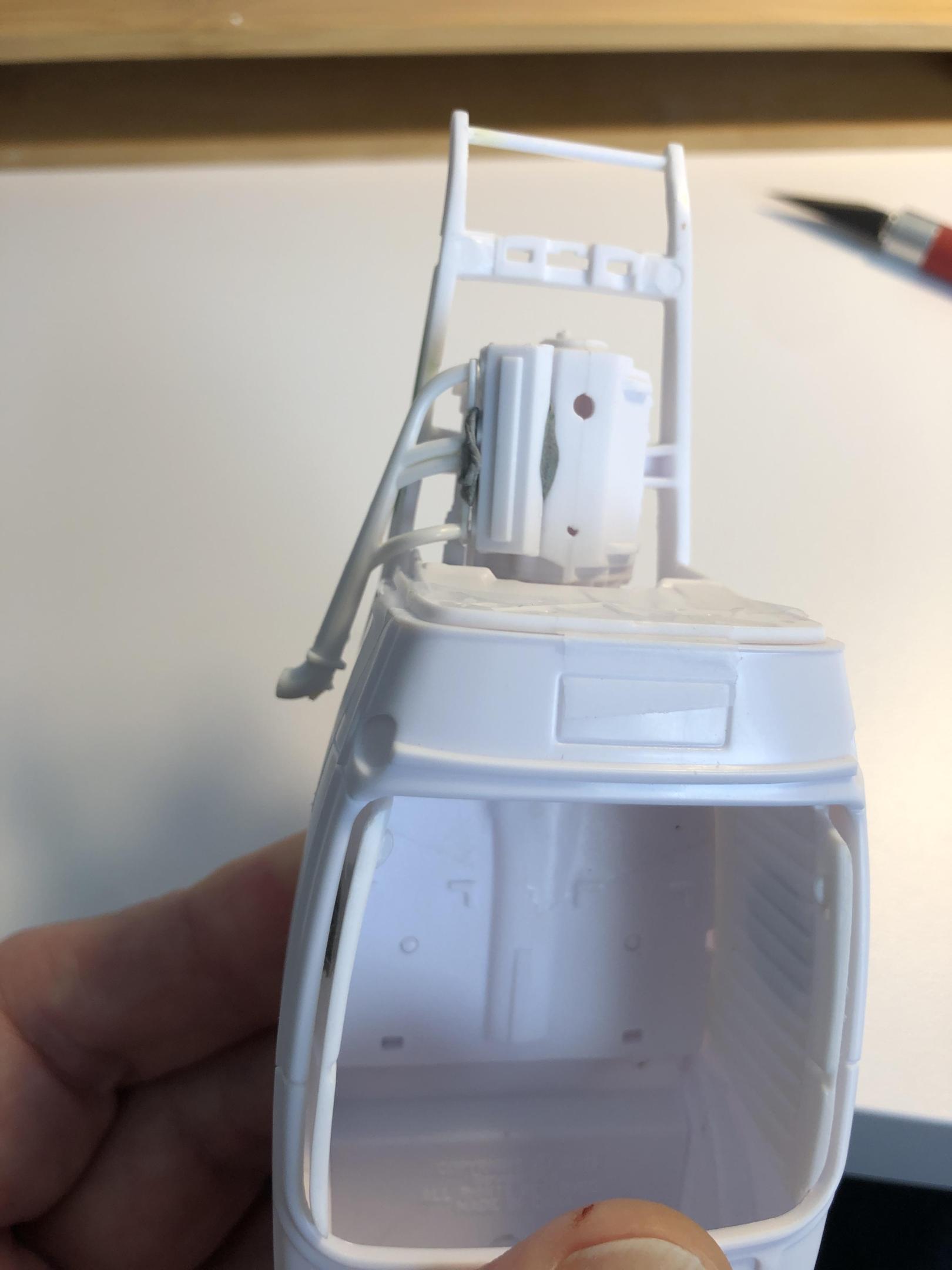

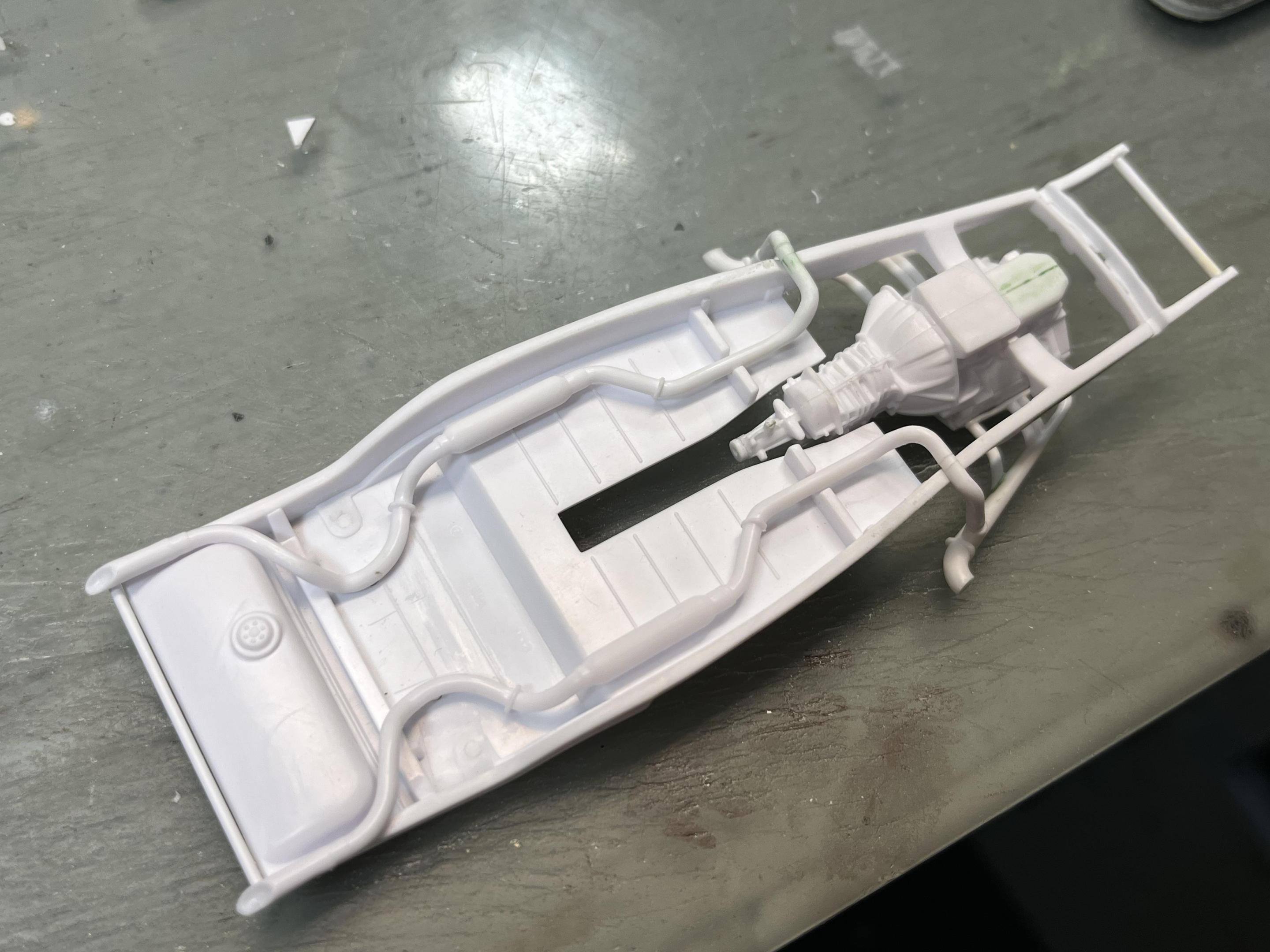

Rocking Rodney Rat Posted November 27, 2021 Author Posted November 27, 2021 (edited) I completed the exhaust system, I fabbed up the section that connects the existing pipes to the headers. I used leftover pieces from a second Rat Roaster exhaust.... -RRR Edited November 27, 2021 by Rocking Rodney Rat 1
