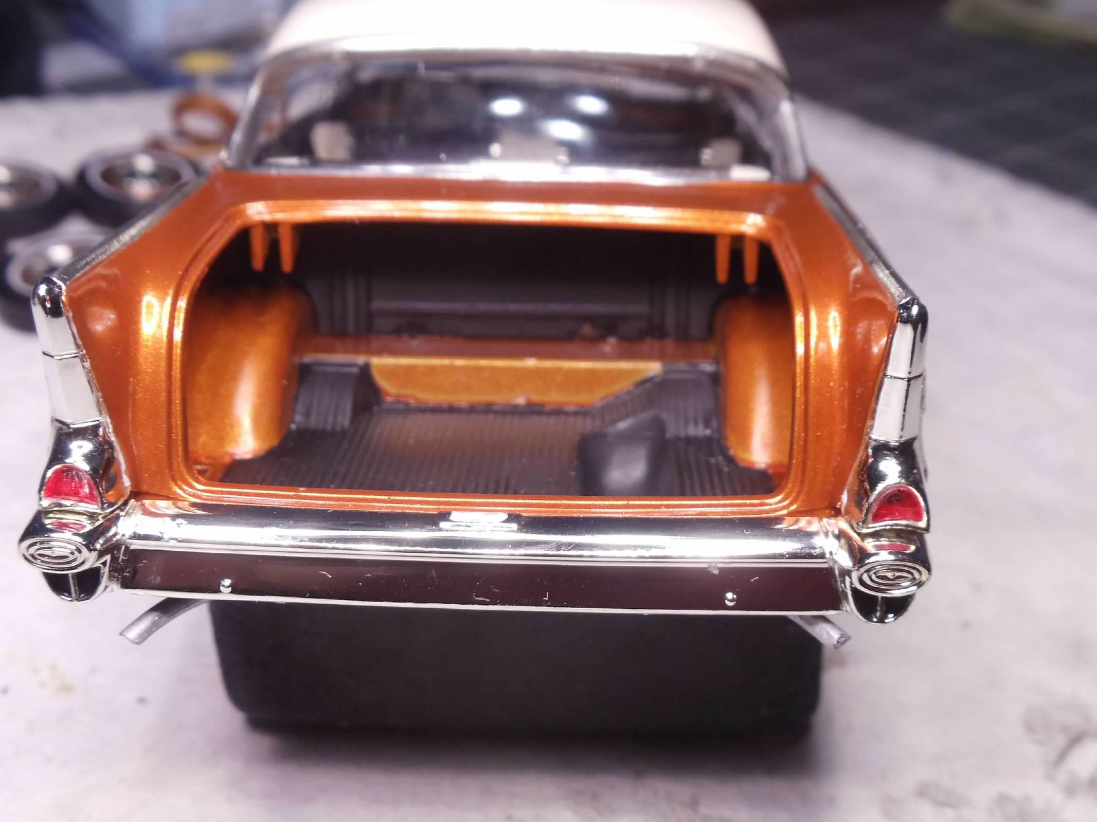

Rodent Posted December 4, 2021 Posted December 4, 2021 7 hours ago, ModelcarJR said: Used matte aluminum foil for the rear fender insert. John, did you foil the insert first and then go back over with the chrome on the moldings? Is there a seam in the foil on the moldings around the insert?

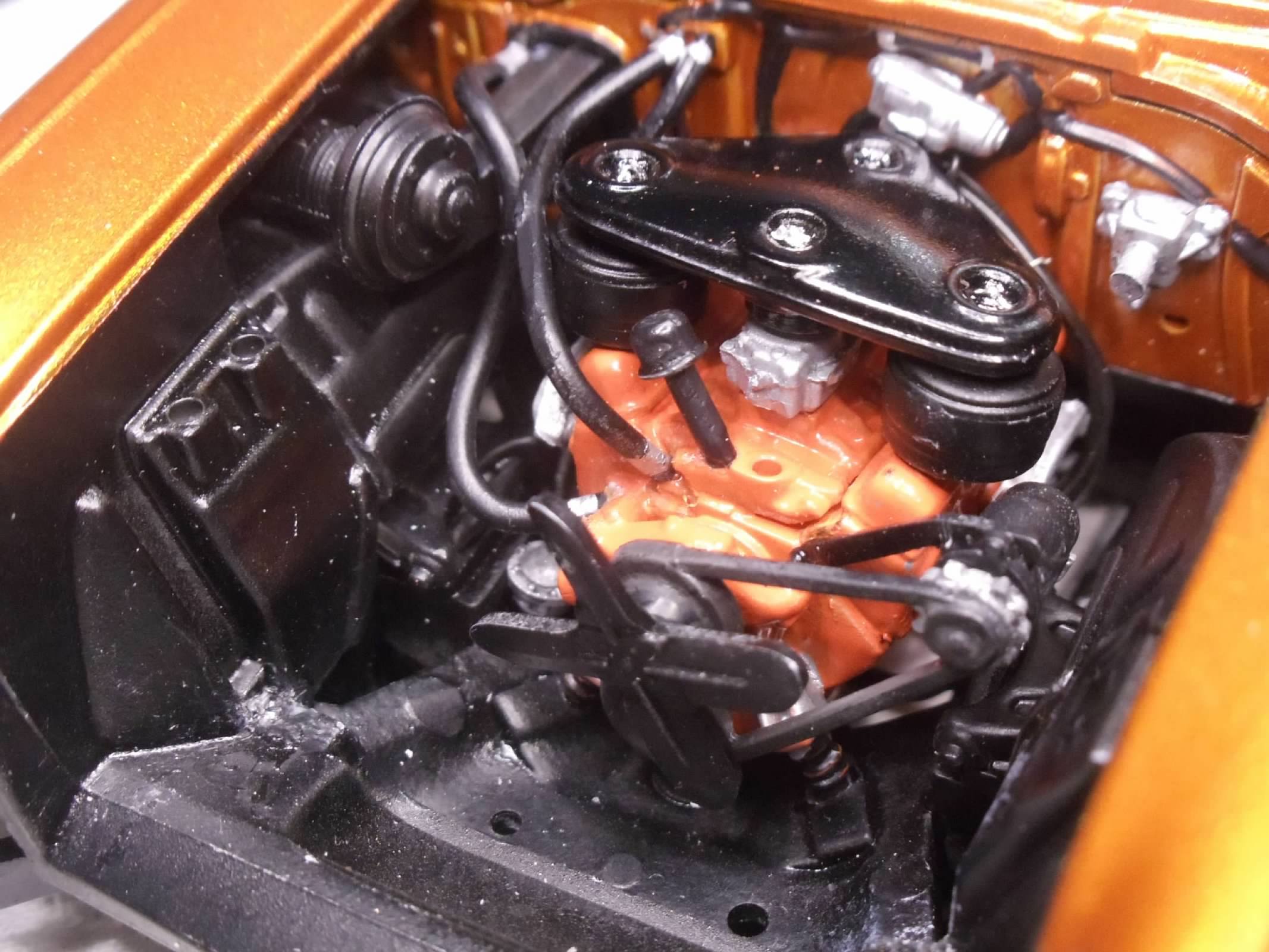

ModelcarJR Posted December 5, 2021 Author Posted December 5, 2021 Thanks, Mike, Carl, and Steve! I appreciate your comments! Steve, I only did the insert in matte aluminum BMF. The trim around the insert is chrome BMF. I'm not sure what you mean by a seam. But I did cut the aluminum foil along the inside of the chrome trim before finishing with the chrome foil. Finished the engine. Somehow I managed to lose the fan belt. I remember I was thinning it down when I was interrupted one day. When I got back to the bench I pushed it aside and worked on something else. And it was never to be seen again! But I used one from a Revell Sedan kit and although it doesn't fit exactly, I made it work. I used a MAD pre-wired distributor and cut off the coil molded to the distributor in the kit and used it. Thanks for looking! ? 1

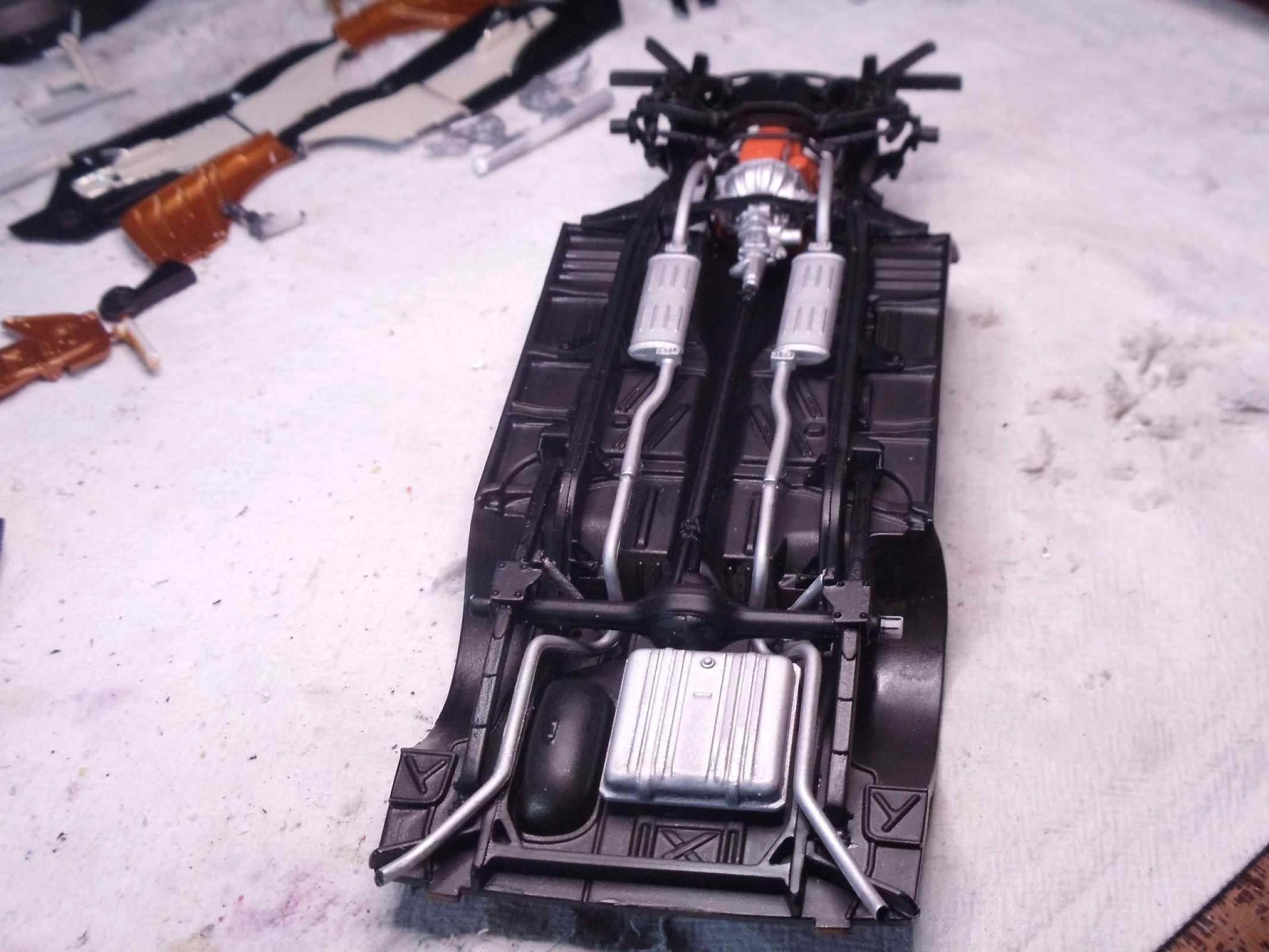

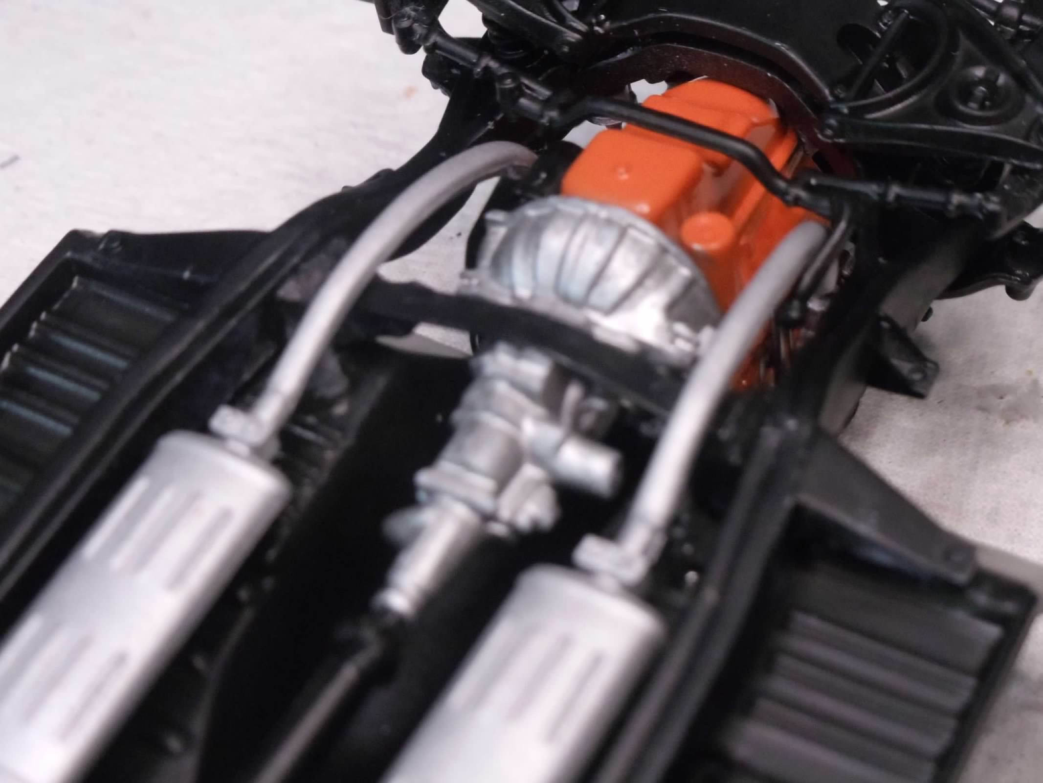

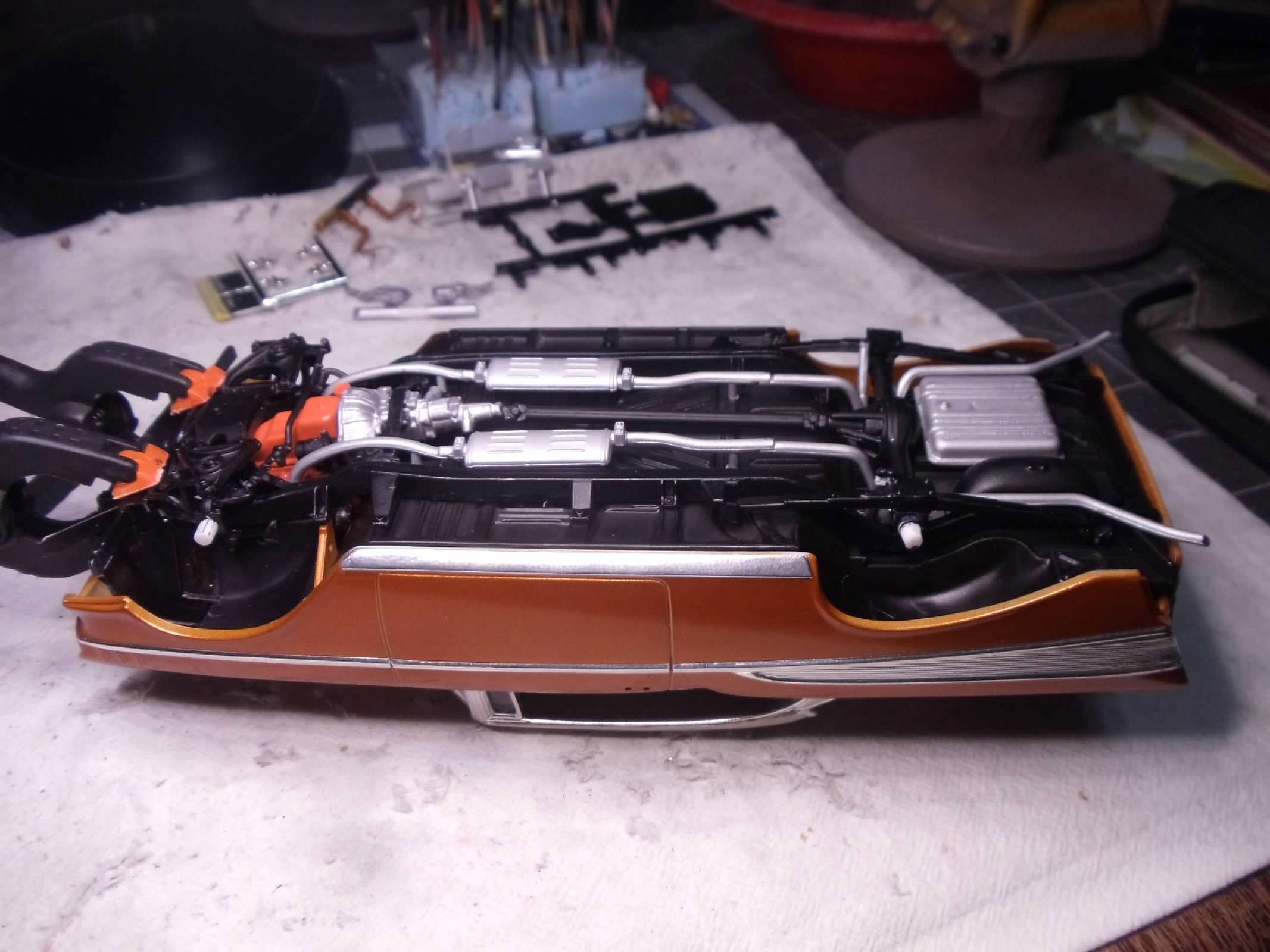

ModelcarJR Posted December 5, 2021 Author Posted December 5, 2021 Engine is in and the chassis is done. The transmission mounts didn't work for me. I thought I had them glued in the right place and I had the engine in place but the transmisson mounts held the transmission too high and the driveshaft wouldn't go through the tunnel. So I removed the mounts and used a piece of .015" strip plastic across the chassis mounts and glued to the bottom of the transmission (photo is a little blurry). Other than that and the fact that each pin had to be trimmed and each receiving hole needed to be enlarged, it was an easy assembly! Thanks for looking! ? 1
TransAmMike Posted December 5, 2021 Posted December 5, 2021 (edited) 1 hour ago, ModelcarJR said: Engine is in and the chassis is done. The transmission mounts didn't work for me. I thought I had them glued in the right place and I had the engine in place but the transmisson mounts held the transmission too high and the driveshaft wouldn't go through the tunnel. So I removed the mounts and used a piece of .015" strip plastic across the chassis mounts and glued to the bottom of the transmission (photo is a little blurry). Other than that and the fact that each pin had to be trimmed and each receiving hole needed to be enlarged, it was an easy assembly! Thanks for looking! ? Good idea there John on the transmission mount. Those little mounts are hard to get just right (at least for me)....and that was after it took me a long time to actually figure out exactly where they went?. Continuing to look really good? Edited December 5, 2021 by TransAmMike

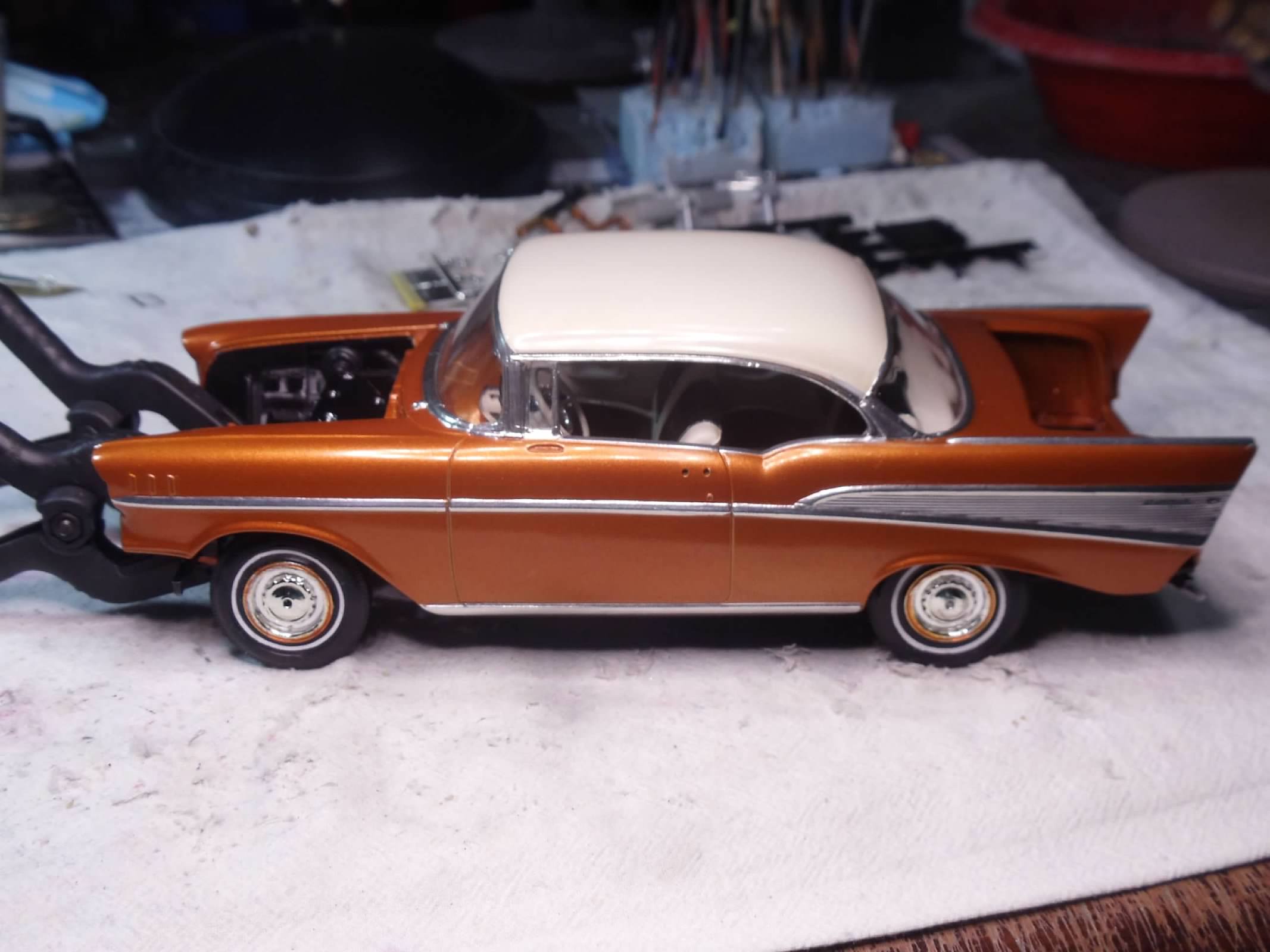

ModelcarJR Posted December 8, 2021 Author Posted December 8, 2021 Thanks, David! I appreciate your comment! Yes, I agree on the transmission mounts. More time should have been spent on on parts fit! Body is mounted with a little bit of coaxing and its on wheels. I also got smart and attached the engine compartment heater hoses and steering box before installing the radiator and hoses. Engine compartment is done. Its all over but the shouting! Thanks for looking! ? 1
