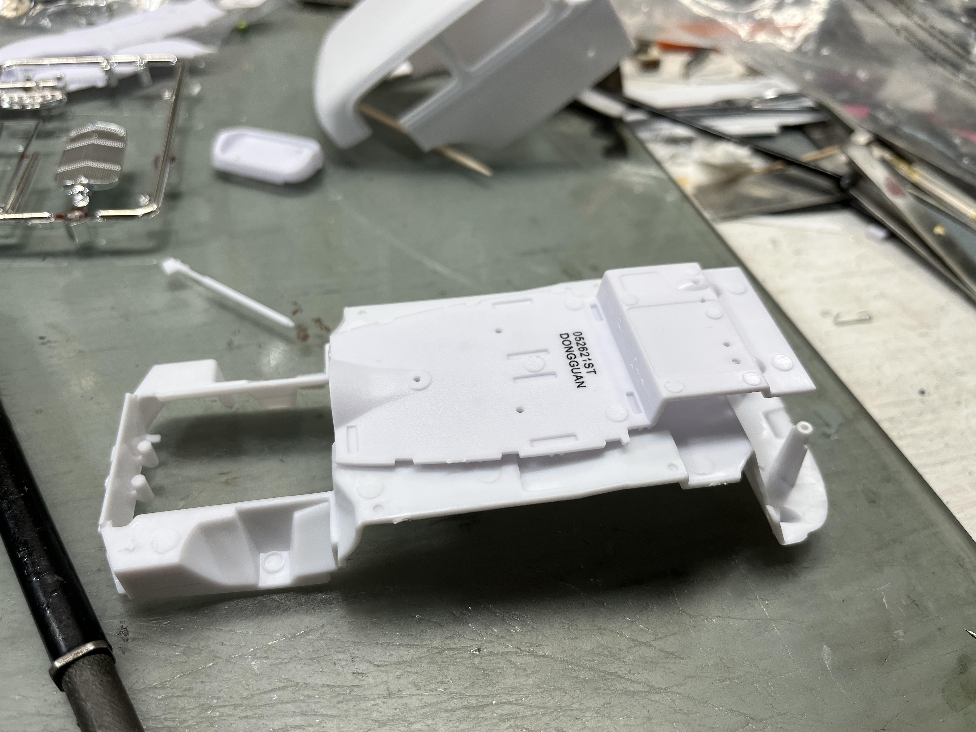

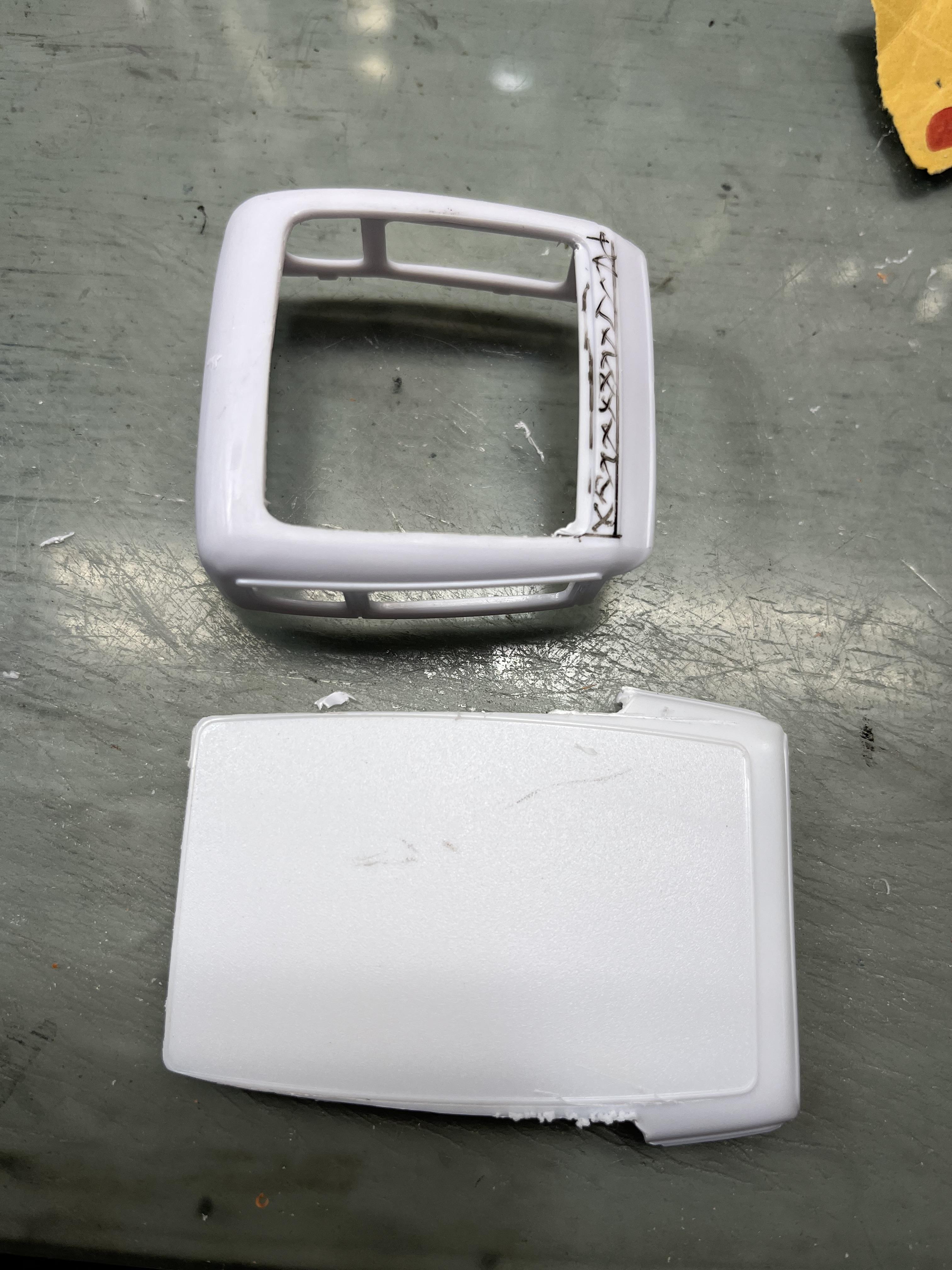

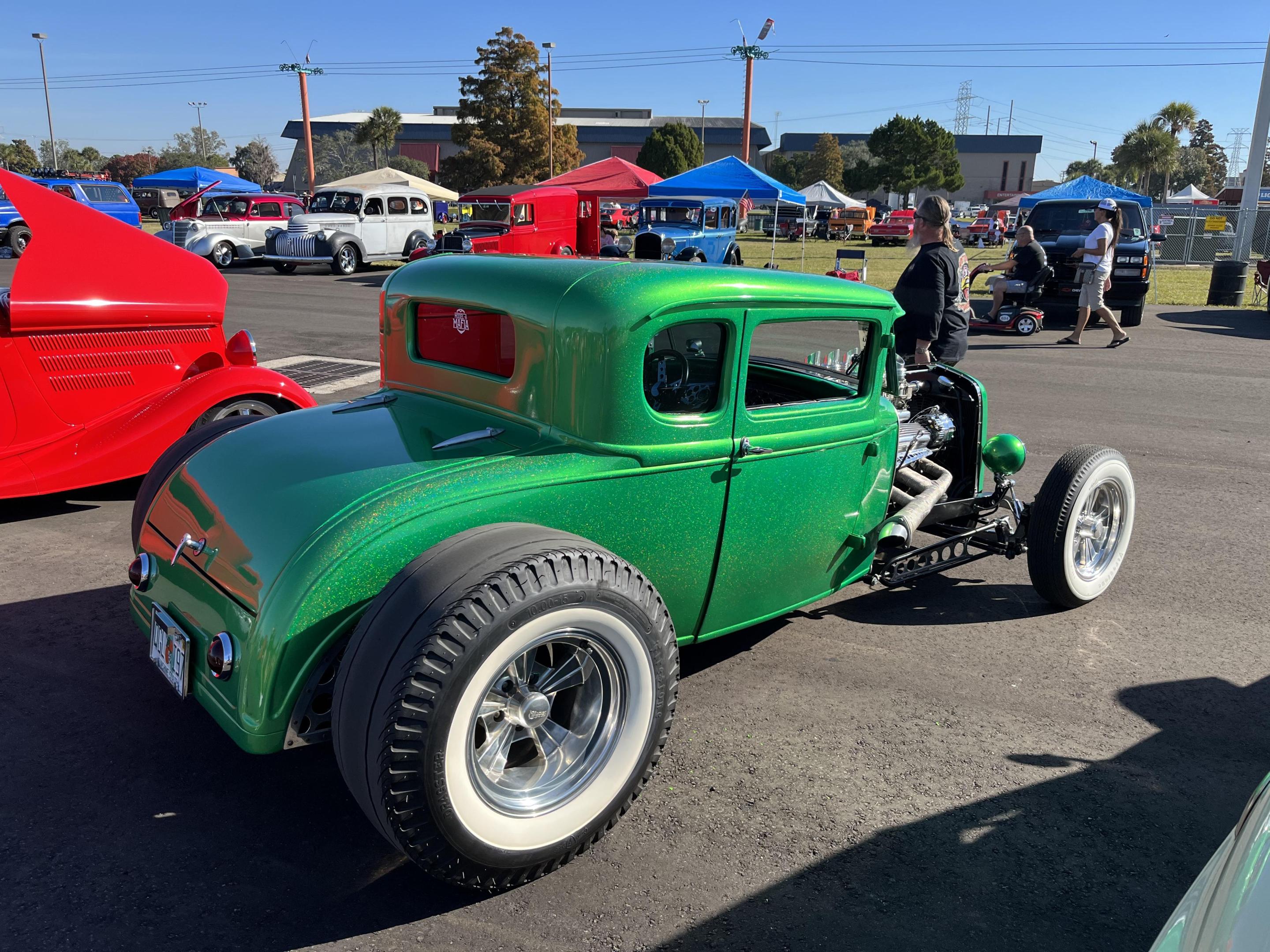

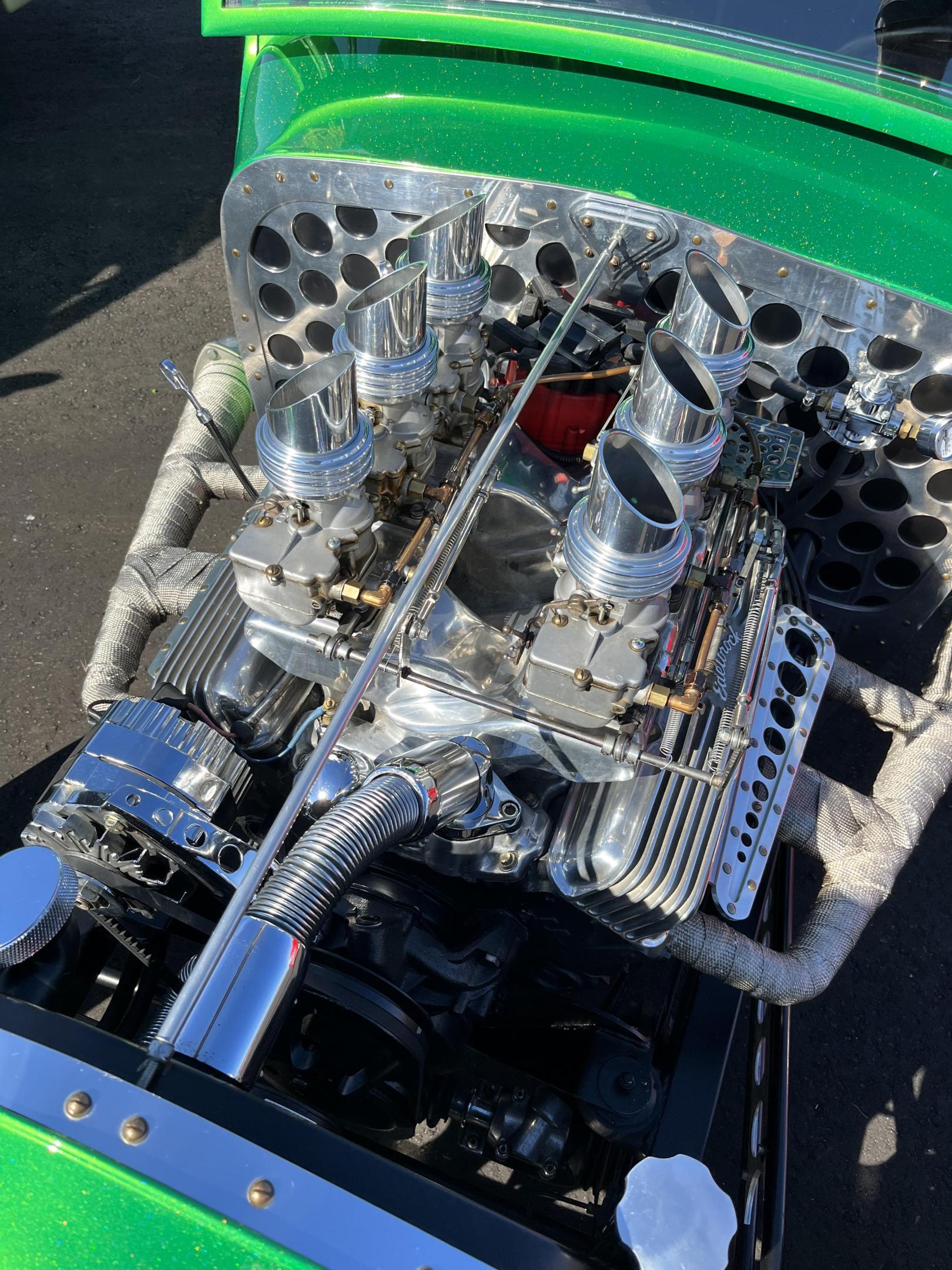

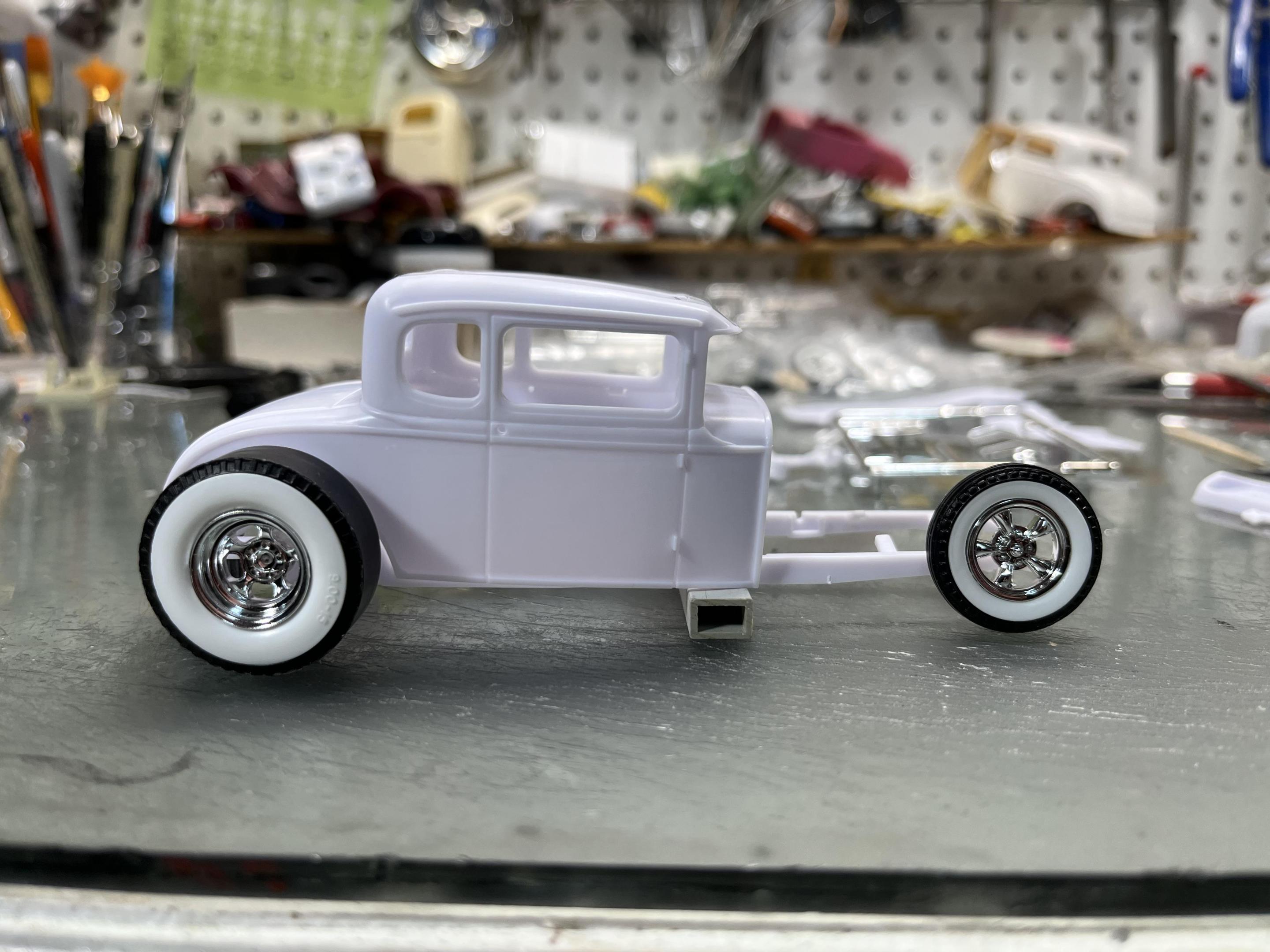

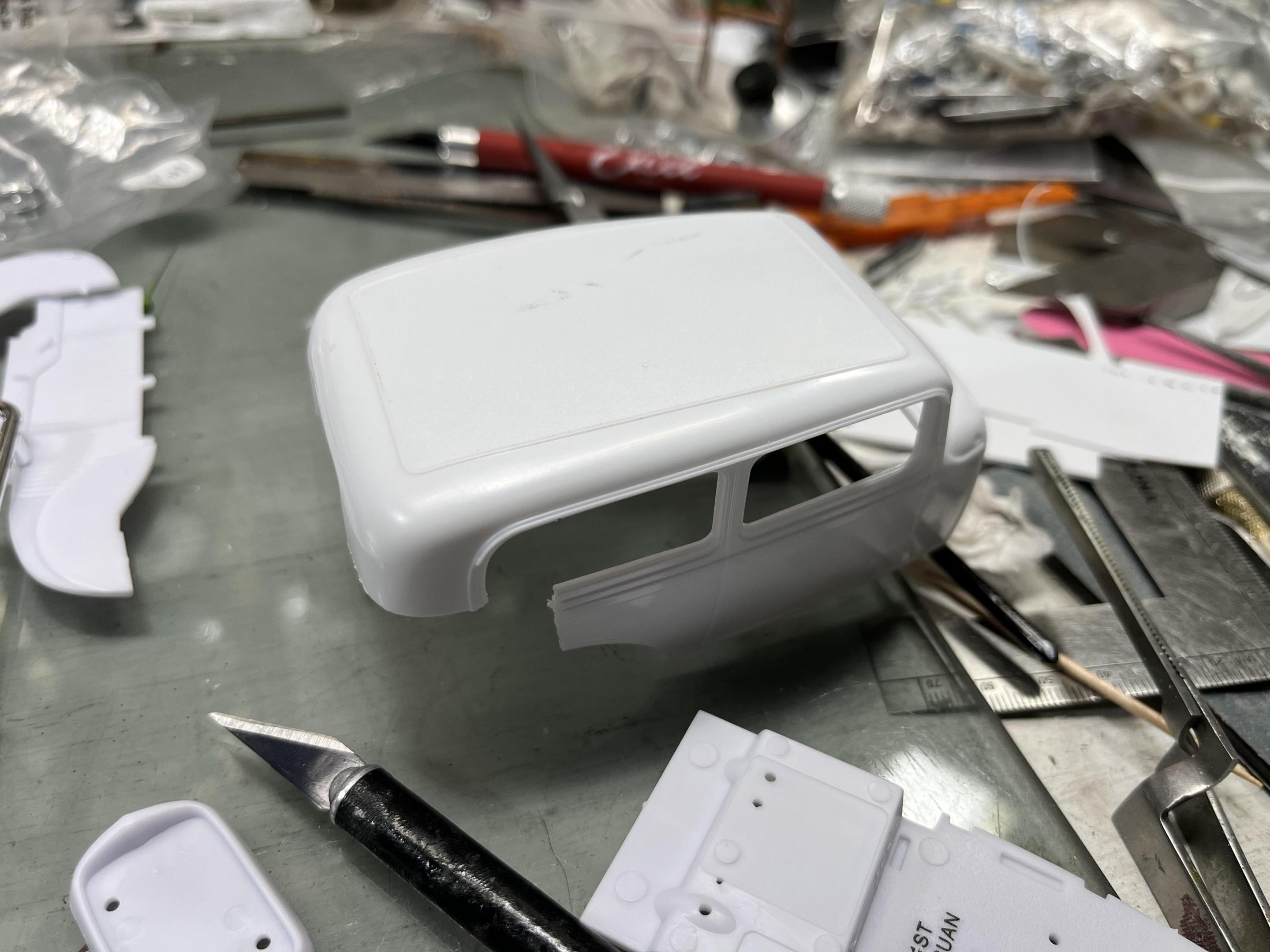

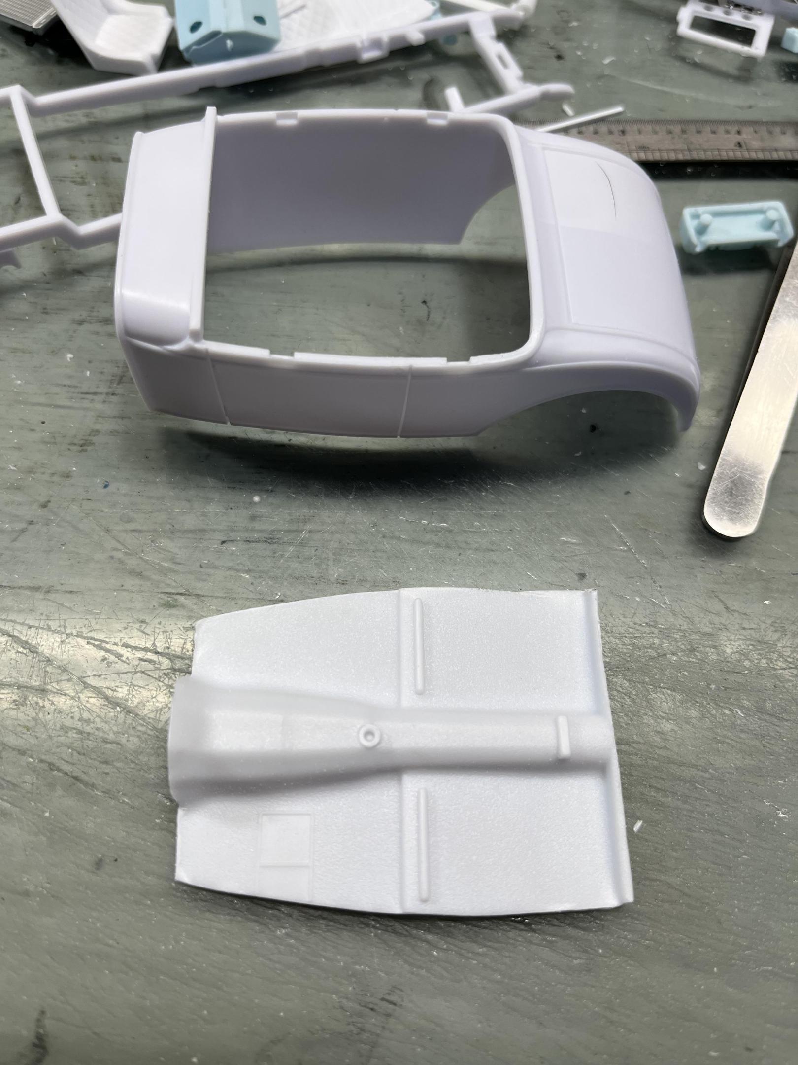

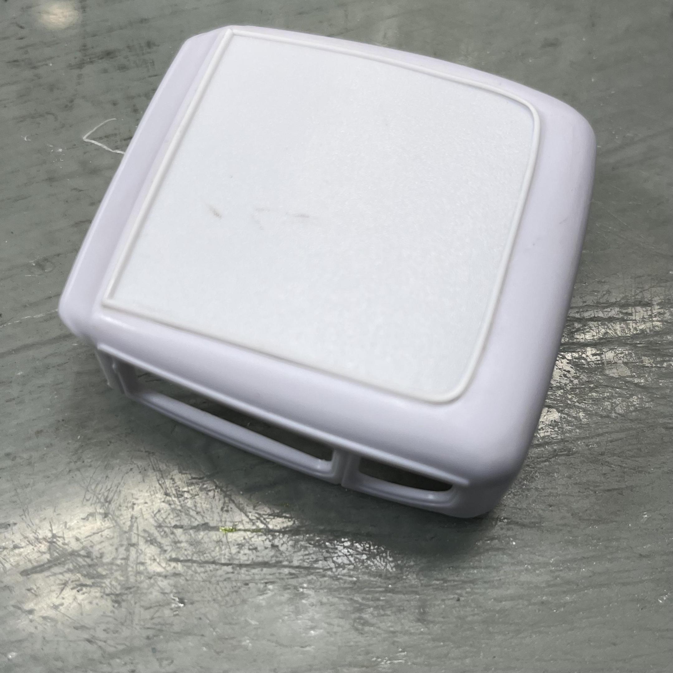

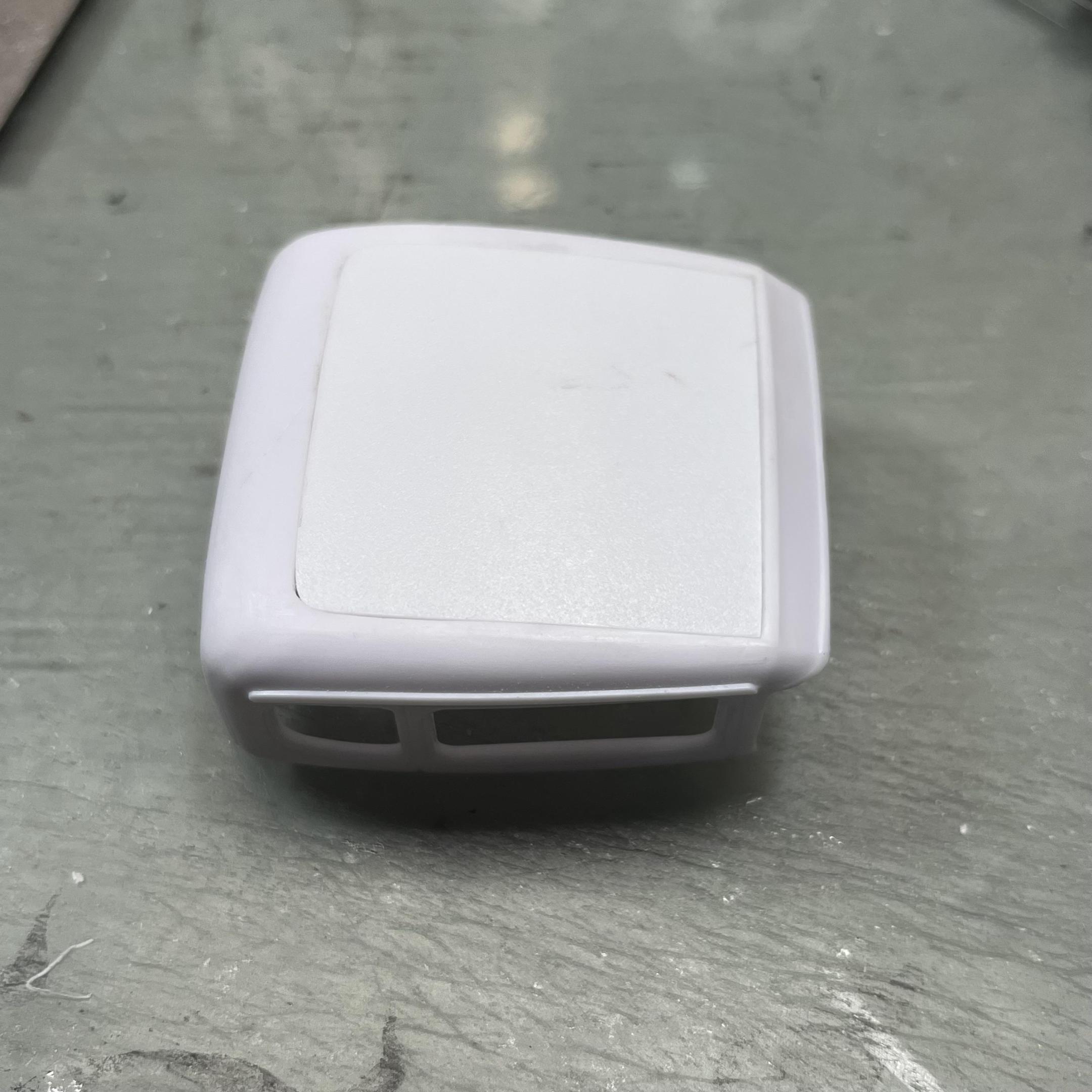

Rocking Rodney Rat Posted January 15, 2022 Posted January 15, 2022 (edited) I saw this very kool Model A Coupe at a show recently and I decided it would make a good take-off point for yet another Revell 1930 Model A Coupe build (this will be my fifth one). I really should taken a few more pix of the car but I didn't. ----------- So, I started pulling some parts and mocked up what I think will be a good stance. I'm going with a '30 frame, channeled over the body, a nice rake and a bad attitude. The tires are from Modelhaus... ------ I found a Mustang floorpan in my stash of stuff, this will do nicely, I will slice it apart using the kit floopan as a pattern... ----- I wanted to fill the roof with a cloth top. I grabbed a Revell '32 sedan body that I had hacked apart for another build and will cut the roof up to fit.... ----- I decided to cut the '30 roof opening to more of a stock configuration, cutting off the front part of the opening marked as below. The '32 roof has been cut away from the '32 body... ---------- A bit of slicing, trimming and sanding gets the top to drop into the opening... ---- I trimmed the edges of top with pieces of Evergreen .040" half-round... (sorry about the crappy pix, but you get the idea...) KK sent me a W motor (just to use a different powerplant) and I will slice off the bellhousing and transmission (too wide to fit under the tunnel) and graft on the T5 transmission from the same Mustang kit I got the floorpan from.... More later.... -RRR Edited February 23, 2022 by Rocking Rodney Rat 1
espo Posted January 15, 2022 Posted January 15, 2022 The stance looks just like the pictured car. I don't know just how close you're going to stay to the green car's features, but there are a few that standout to me. The firewall treatment is interesting and don't recall ever seeing one done in this way. The stacks on the carburetors are set differently as well. Usually, the opening would be facing toward the rear of the car or the front and these are facing the side. Using a Chevrolet W engine will make this different. 1
Ace-Garageguy Posted January 15, 2022 Posted January 15, 2022 (edited) On 1/15/2022 at 6:10 PM, espo said: ...The stacks on the carburetors are set differently as well. Usually, the opening would be facing toward the rear of the car or the front and these are facing the side... Expand Funny how folks in the 21st century seem to have forgotten which way bologna-cut stacks HAVE to face to work right. Edited January 15, 2022 by Ace-Garageguy 2
Rocking Rodney Rat Posted January 15, 2022 Author Posted January 15, 2022 On 1/15/2022 at 6:10 PM, espo said: The stance looks just like the pictured car. I don't know just how close you're going to stay to the green car's features, but there are a few that standout to me. The firewall treatment is interesting and don't recall ever seeing one done in this way. The stacks on the carburetors are set differently as well. Usually, the opening would be facing toward the rear of the car or the front and these are facing the side. Using a Chevrolet W engine will make this different. Expand I'm not really planning to stay very true to the real car. I'm going to make a flat very slightly recessed firewall, intake stacks will be frog mouth scoops.... -RRR 1

rightrudder Posted January 16, 2022 Posted January 16, 2022 On 1/15/2022 at 7:04 PM, Rocking Rodney Rat said: I'm not really planning to stay very true to the real car. I'm going to make a flat very slightly recessed firewall, intake stacks will be frog mouth scoops.... -RRR Expand Yeah, that Swiss-cheesed firewall is just weird. Beautiful workmanship! 1

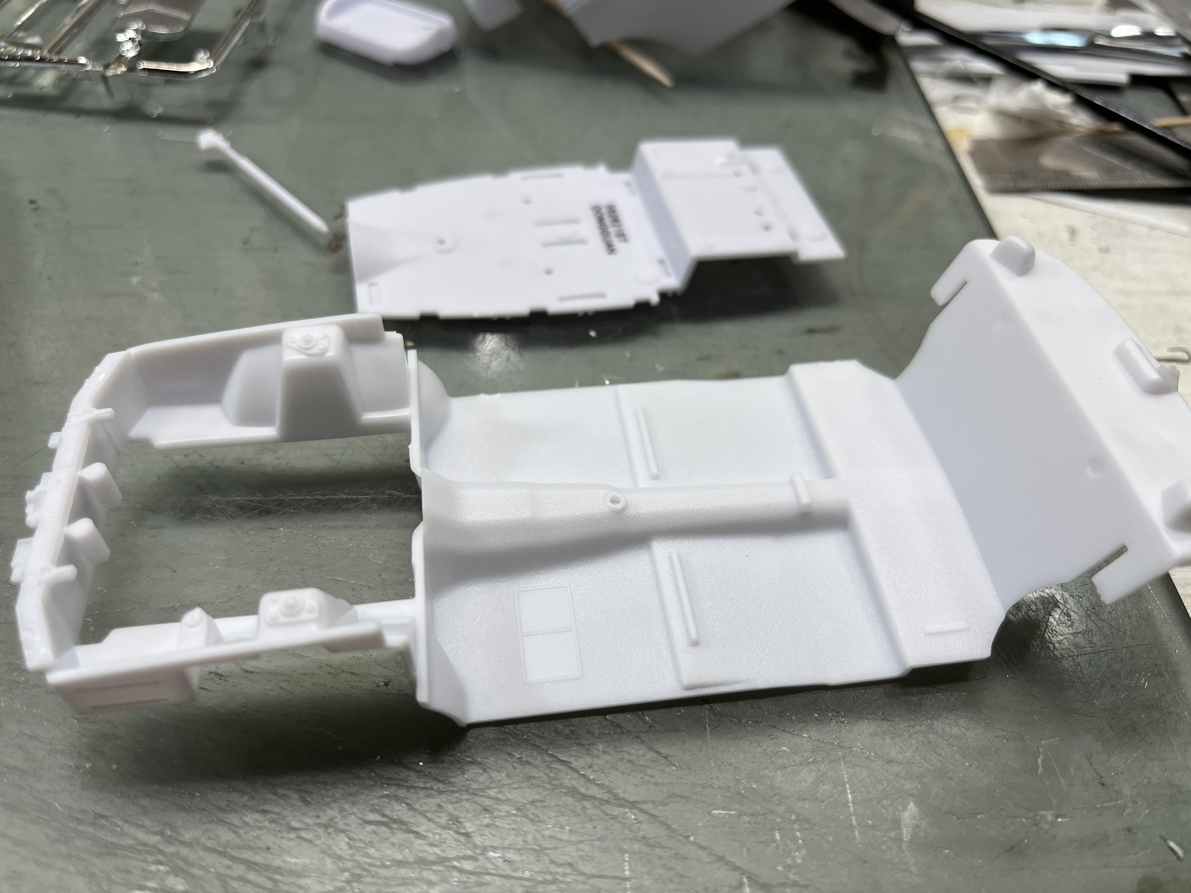

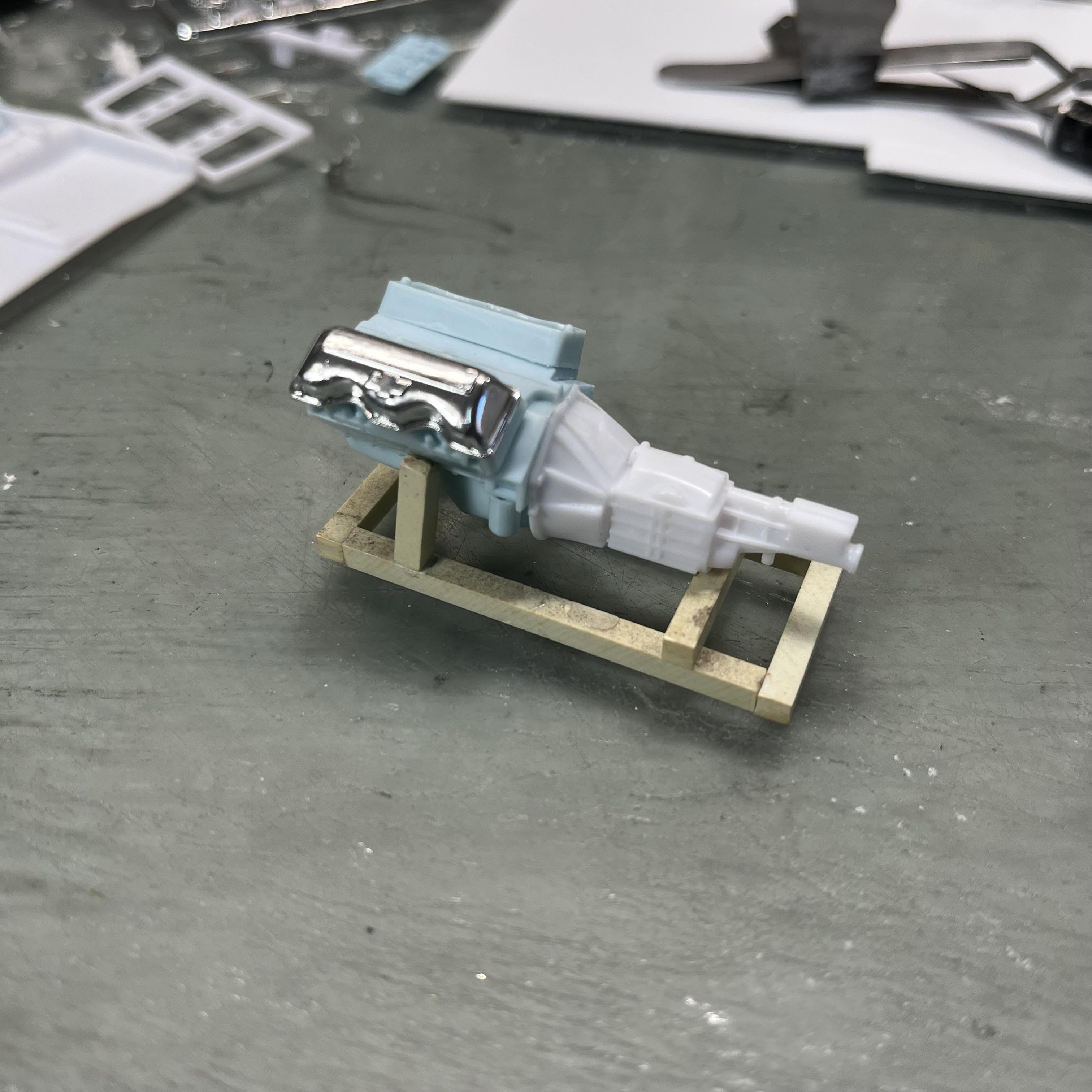

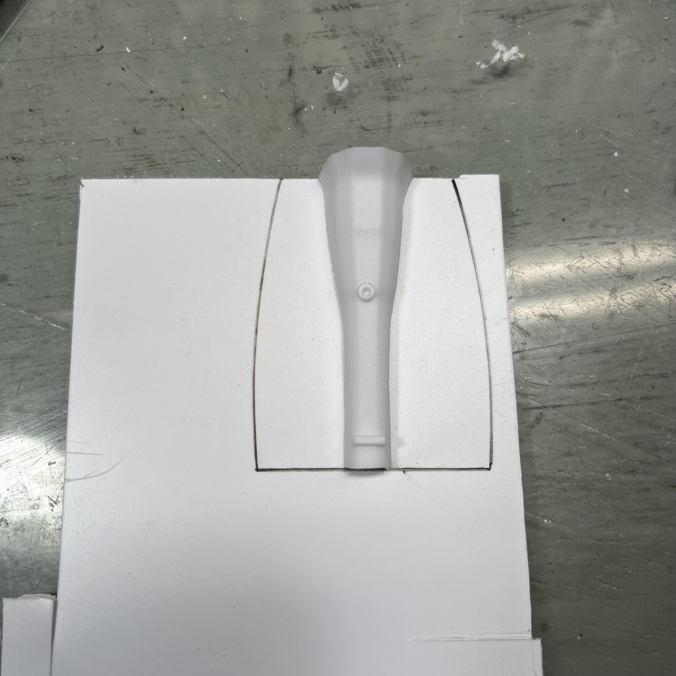

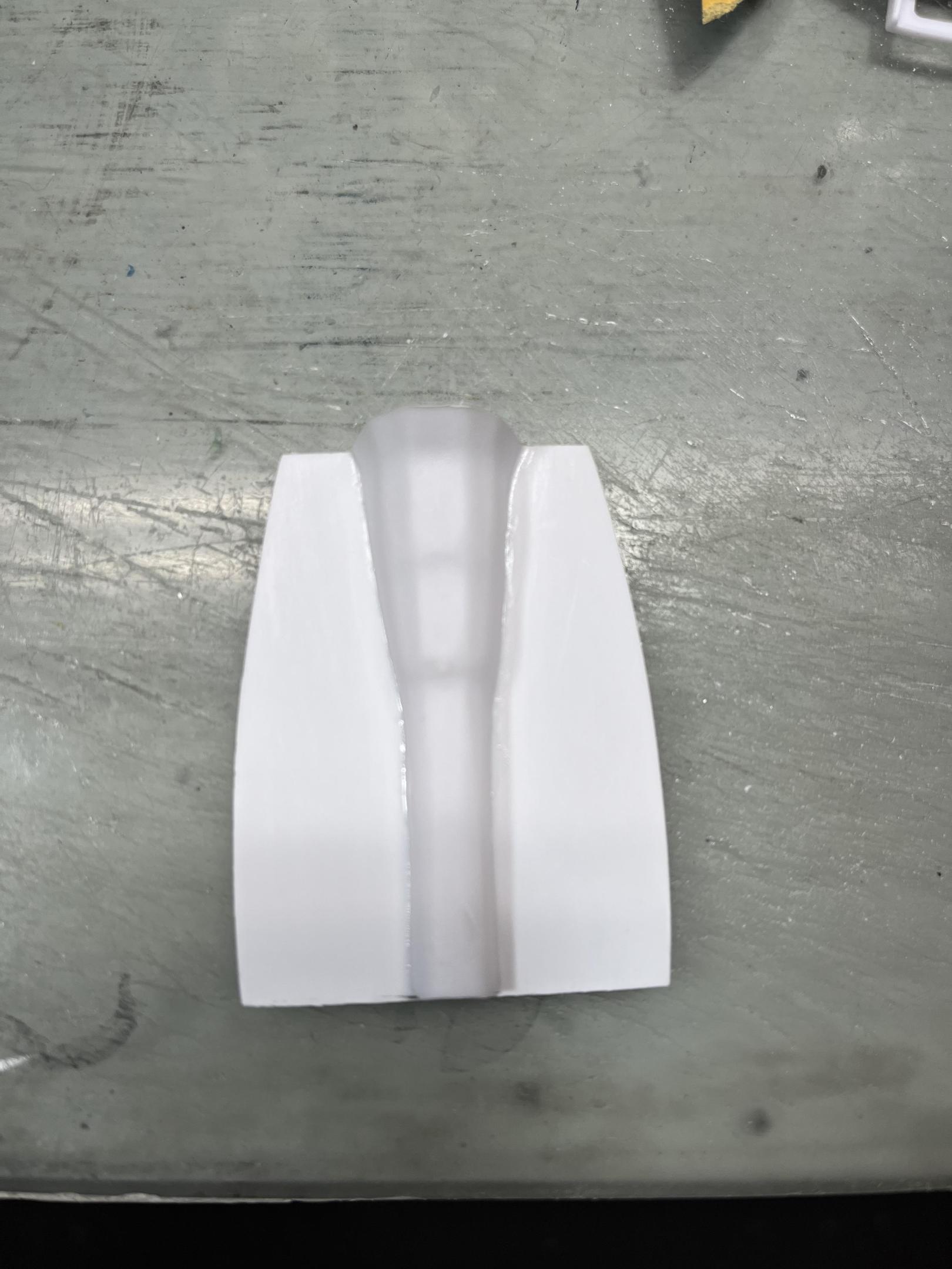

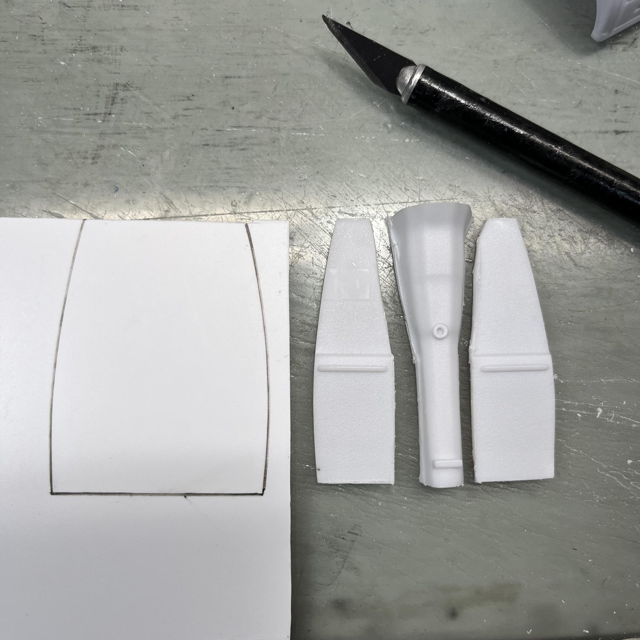

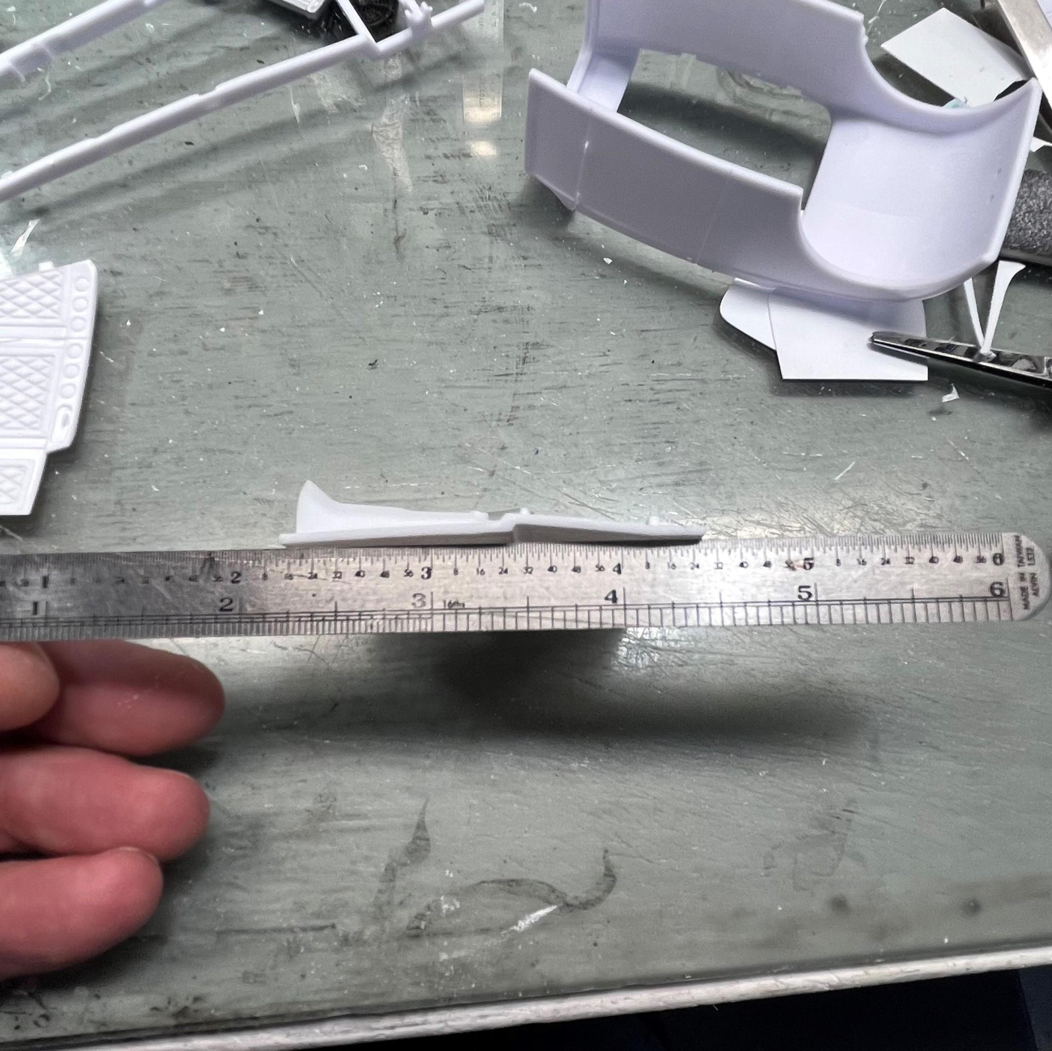

Rocking Rodney Rat Posted January 17, 2022 Author Posted January 17, 2022 (edited) A little more work on the coupe. I started whittling away on the floor pan (from a Mustang kit). ------ after looking at it more carefully, I came to the realization that the floor had too much whoop-dee-do in it. That wont work. I will cut off the tunnel and attach it to a flat sheet of styrene... ------- The W motor I'll be using has a bellhousing that's way too wide to fit into the trans tunnel. The solution is to separate the block and use the T5 from the same Mustang kit the trans tunnel is from. That will fit. I'm planning on adapting the two 3x2 log manifolds from the Nailhead in the Revell Model A kits... ------------ I glued it all together. Much better.... I tried my Molotow chrome pen on one of the valve covers. Looks pretty good... More later, thanks for following along... -RRR Edited January 17, 2022 by Rocking Rodney Rat 1

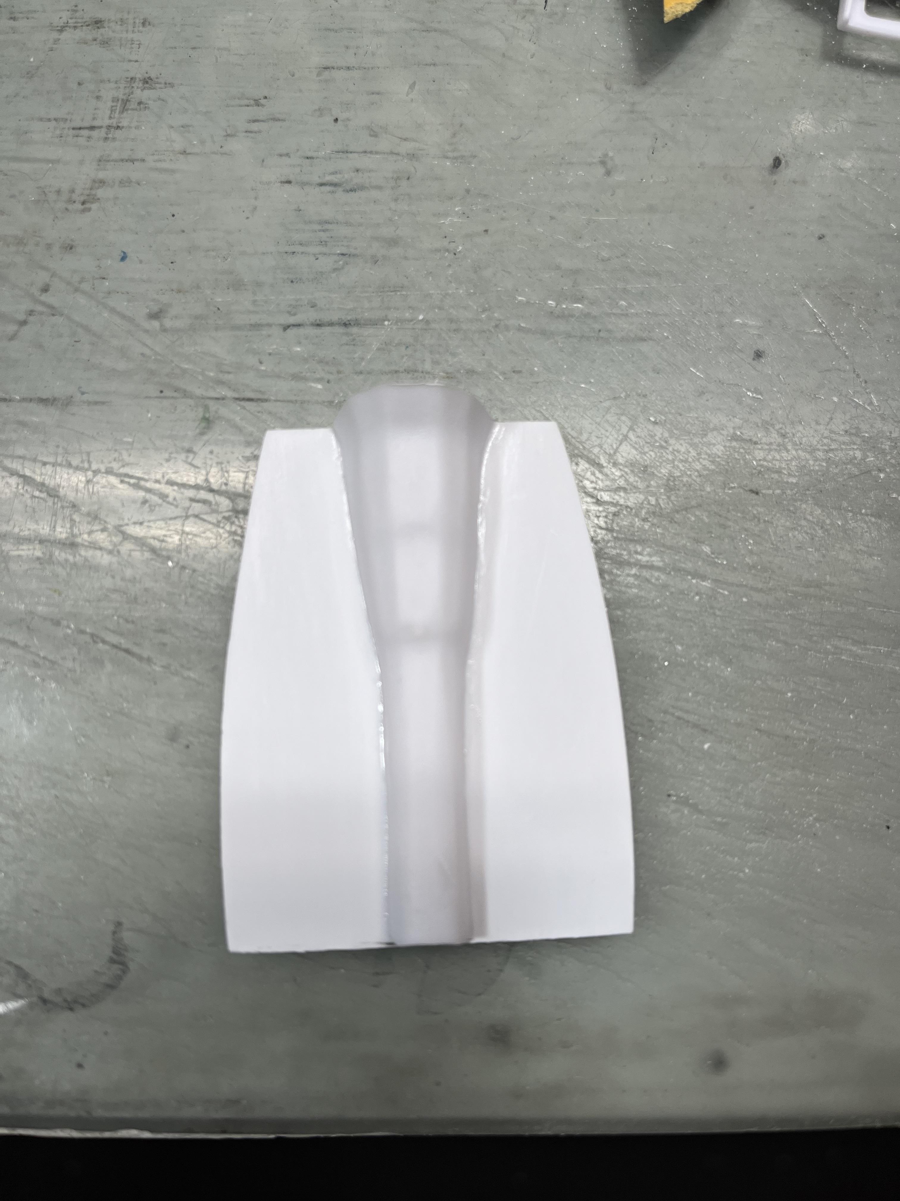

Rocking Rodney Rat Posted January 18, 2022 Author Posted January 18, 2022 As we left off a few days ago, I decided that floor wouldn't work, so the tunnel was cut off, cleaned and attached to a sheet of Evergreen styrene... I traced around the original floorpan as it was shaped to fit the '30 body and then separated the two sides from the tunnel... ---------- I cleaned up the cut sides of the tunnel and measured a few times to get it as close to centered as I could and glued it on.... --------- I cut the pan out of the sheet of styrene and cleaned up the edges. The next step is to grab the trusty Dremel and grind out the tunnel on the underside. I have a plan for the interior, that's coming up next... -RRR 1
