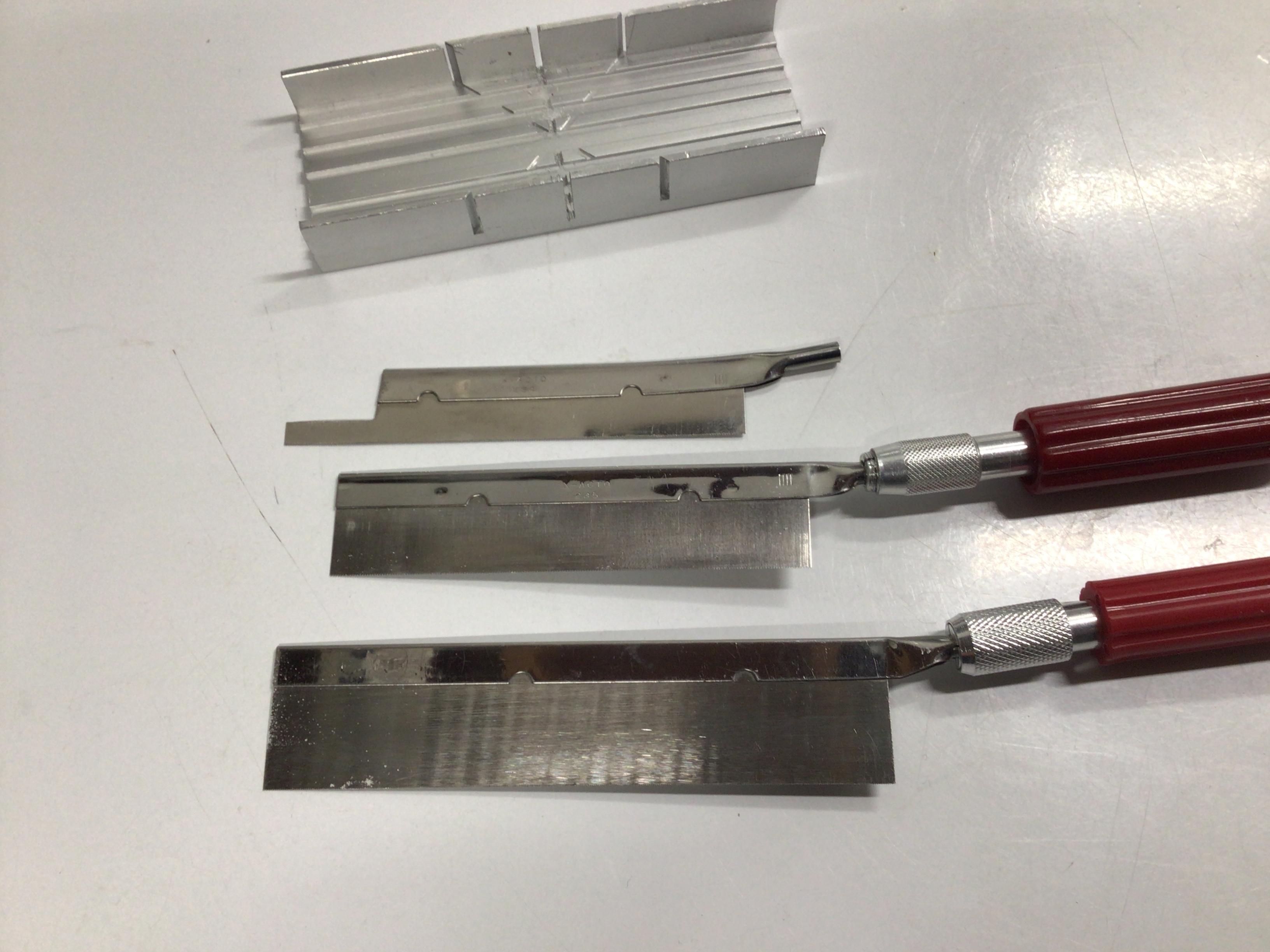

NOBLNG Posted February 22, 2022 Posted February 22, 2022 (edited) I use the Exacto mitre box also. I keep a finger up against the side of the saw blade to hold it tight against one side of the slot. The slot in the mitre box is wide enough that the saw can wobble if not held vertical. And yes, some blades are not deep enough to work properly. The top one in the pic Is too shallow to be used with the box. Edited February 22, 2022 by NOBLNG

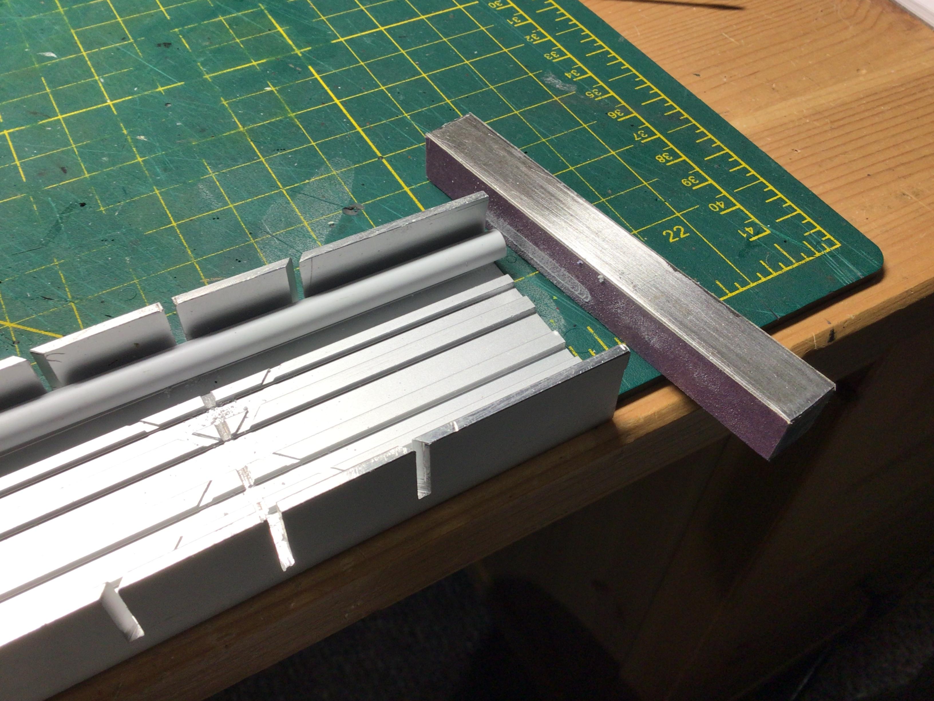

NOBLNG Posted February 22, 2022 Posted February 22, 2022 I attached some sandpaper to a piece of square bar with double faced tape that I can square up the cut if it is off a touch. 1 1

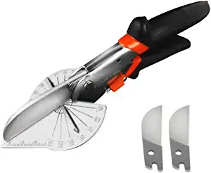

yh70 Posted February 22, 2022 Posted February 22, 2022 (edited) i do use my miter box a lot but i also got these .. get u a set i think u will like them..https://www.amazon.com/gp/slredirect/picassoRedirect.html/ref=pa_sp_atf_tools_sr_pg1_1?ie=UTF8&adId=A0802540271O7LP23UCW1&url=%2FGARTOL-Lengthen-Multifunctional-Adjustable-Replacement%2Fdp%2FB08FR4XS5J%2Fref%3Dsr_1_1_sspa%3Fcrid%3D1Z8YBUETXJ1LT%26keywords%3DGARTOL%2BMiter%2BShears%26qid%3D1645569405%26s%3Dhi%26sprefix%3Dgartol%2Bmiter%2Bshears%2Ctools%2C129%26sr%3D1-1-spons%26psc%3D1&qualifier=1645569405&id=4394493787431029&widgetName=sp_atf Edited February 22, 2022 by yh70
