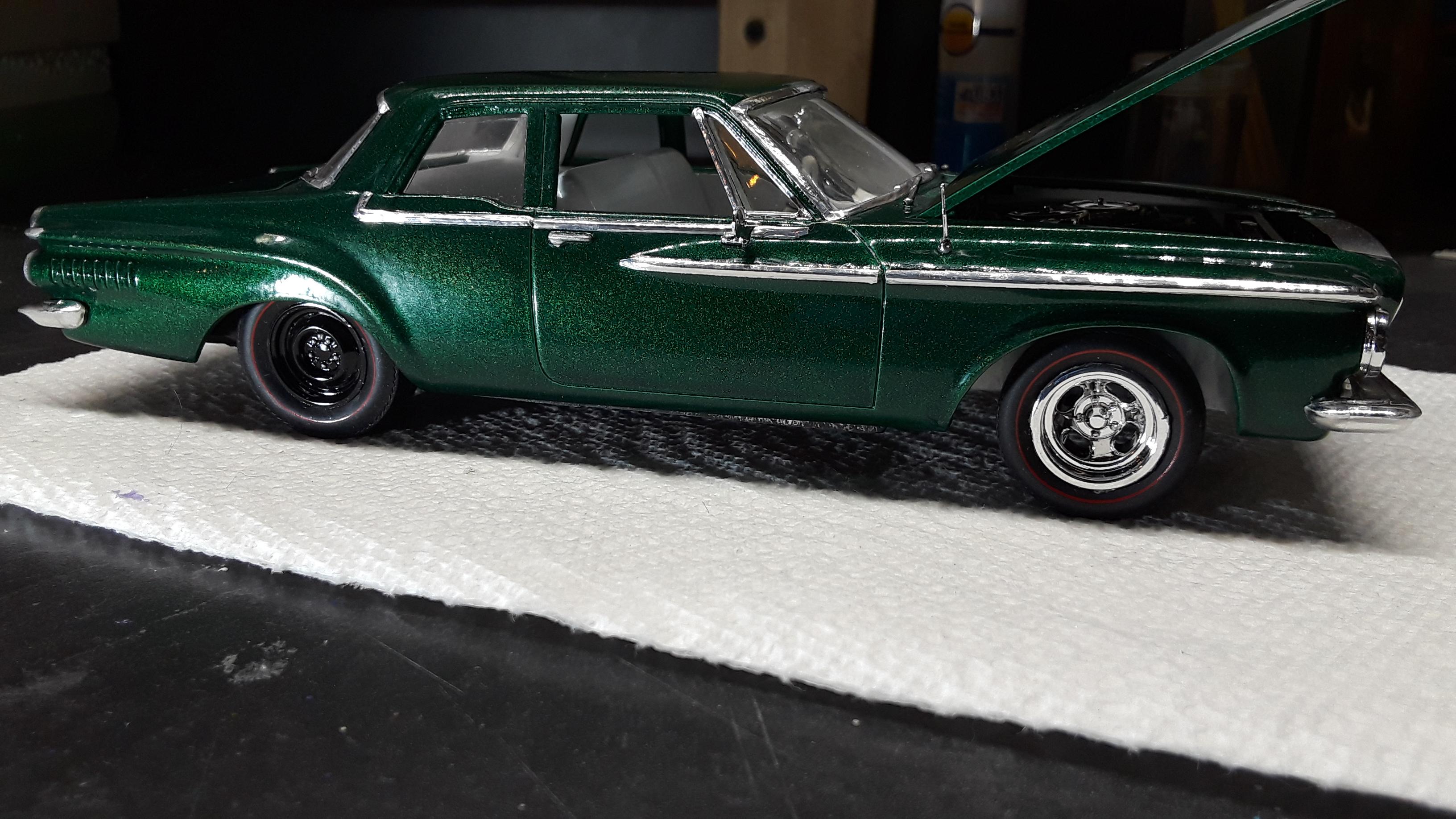

69NovaYenko Posted June 1, 2022 Author Posted June 1, 2022 (edited) On 5/25/2022 at 12:50 AM, Bills72sj said: Bills72sj One tip I learned from Steve G is to use thin line masking tape over an oversized piece of BMF before cutting. It helps produce laser straight cuts AND protect your paint from an errant blade. His results speak for themselves. I used this techniquique to cut my desired stripes in my Parafilm used to mask on the following projects. Two done and one in progress. Expand Thanks for the tip. I will have to try it. The chrome on your completed projects look very good. On 5/27/2022 at 1:24 AM, Leica007 said: For the past 5 years I've been using HVAC tape for my chrome trim with very good results. I learned that it's better to cut size appropriate strips then apply, rather than try trimming wider pieces on the model; although I have had to carefully trim occasionally. I've never used BMF so I don't know how it compares in strength, but I really like the HVAC, doesn't tear too easily while working with it. I usually work in strips btw 1.5 - 3 mm wide for widow frames, roof edges, etc. Sometimes increasing to 4 or 5 mm if needed. I use a wooden cuticle tool (pointed on 1 end, beveled on the other) to burnish the strips after they're in place and to fit into creases/edges. Then buff with soft rag or paper towel to really polish. Using thin strips makes it easier to conform around curves. Also used for other trim/molding. I'm attaching some pics of models where I used the hvac tape. I'll be glad to answer questions, hope this gives an alternative to chrome painting for us older guys without the steady hands we once had. Expand Leica007 I`m not familiar with HVAC tape. However, I really like the results & look of the tape. With a little searching I was able to find it on Amazon. I will be ordering a roll to try it out. Once it gets here I may reach out to you again for additional how to use it tips & tricks. I`m VERY impressed with how the HVAC tape conformed to the Gremlin logo. Your projects also have awesome looking chrome as well!!!! On 5/28/2022 at 7:04 PM, Jon Cole said: Two things I would like to add, if I may. Sometimes I have trouble gripping the X-Acto handle, so I tried holding a raw #11 blade between my finger & thumb. It seemed to help. Second idea, tho mentioned by others already, is to use a metal ruler to cut a length of BMF. Apply like you would with pinstripe tape. This is more suited for straight chrome trim, tho I suppose it could be used around windows and such. Only after it is in place where you like it, do you then burnish it. Good luck with experimenting. Expand Jon Cole Thanks for the helpful advise and how to apply Bare Metal Foil technique tips. Edited June 1, 2022 by 69NovaYenko
