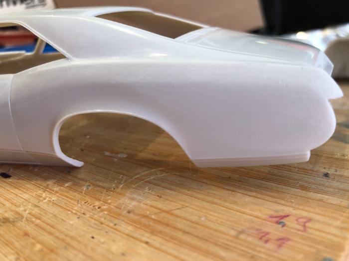

OK, the body has been cleaned now
Next up will be the heavy part. I'm a bit anxious  for I know I'll have to cut the roof in at least 5 pieces! The first cut is the deepest... ?

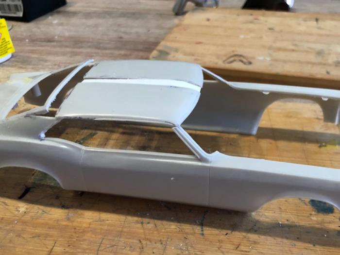

A quick update on what happened so far:
After changing my mind on where to cut the C-pillars...
...I cut around the backlight first:
Then I cut off the roof at the top of the A- and C-pillars
I also removed the front edges of the C-pillars for I might have to relocate and angle them
Next, the roof was cut in halves...
...and after shortening the pillars I widened it with the help of Evergreen strips
And finally with the roof back on the body I laid back the backlight:
Now a lot of putty and sanding work lies ahead of me...

I see what you did with the roof and it looks logical. I think it will work great! Did you figure out how much chop your method resulted in or are you just going by the look of it? Looking forward to more progress.
