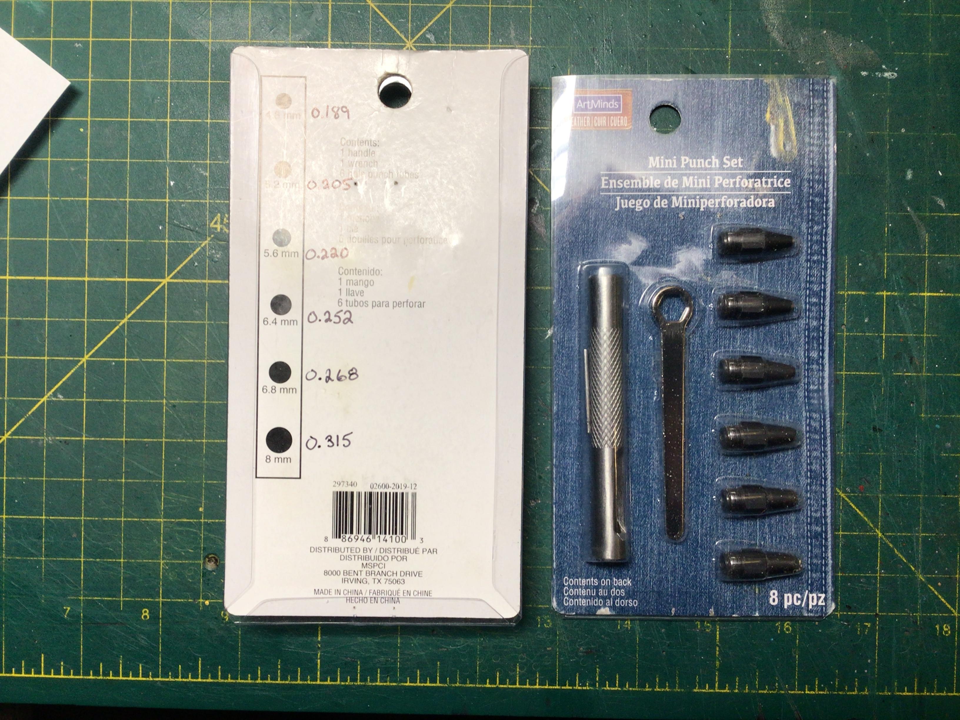

For rounds too small to use a circle-cutter (compass) or too big for my Stanley multi-punch, I use these old-school "gasket punches", a tool that's been around now for probably 100 years.
Wholesale Hollow Punch Set Leather Hole punch Punching Tool Gasket Cutter  Hardened From m.alibaba.com
Below is the Stanley punch for small holes and rounds.

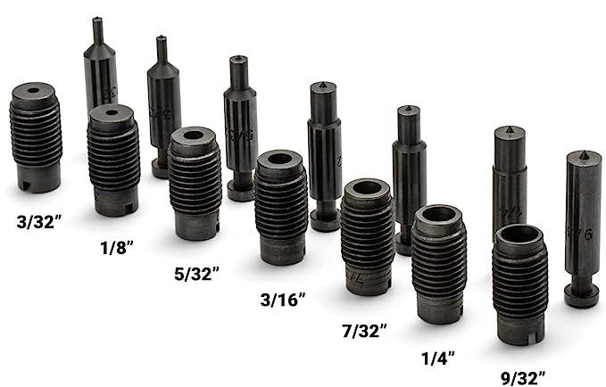

I’ve been wondering about this topic too.  Would something like this punch & die set work?  I’ve used them in the past with sheet metal, but never plastic.
Also wondering if the same thing would work for round decals?  Or would they paper just tear?
That depends on how  precise the fit of the punch and die is.  If they have very close fit then they can punch even very thin materials, but it the fit is too sloppy, then the thin punched material will tear or even stretch.

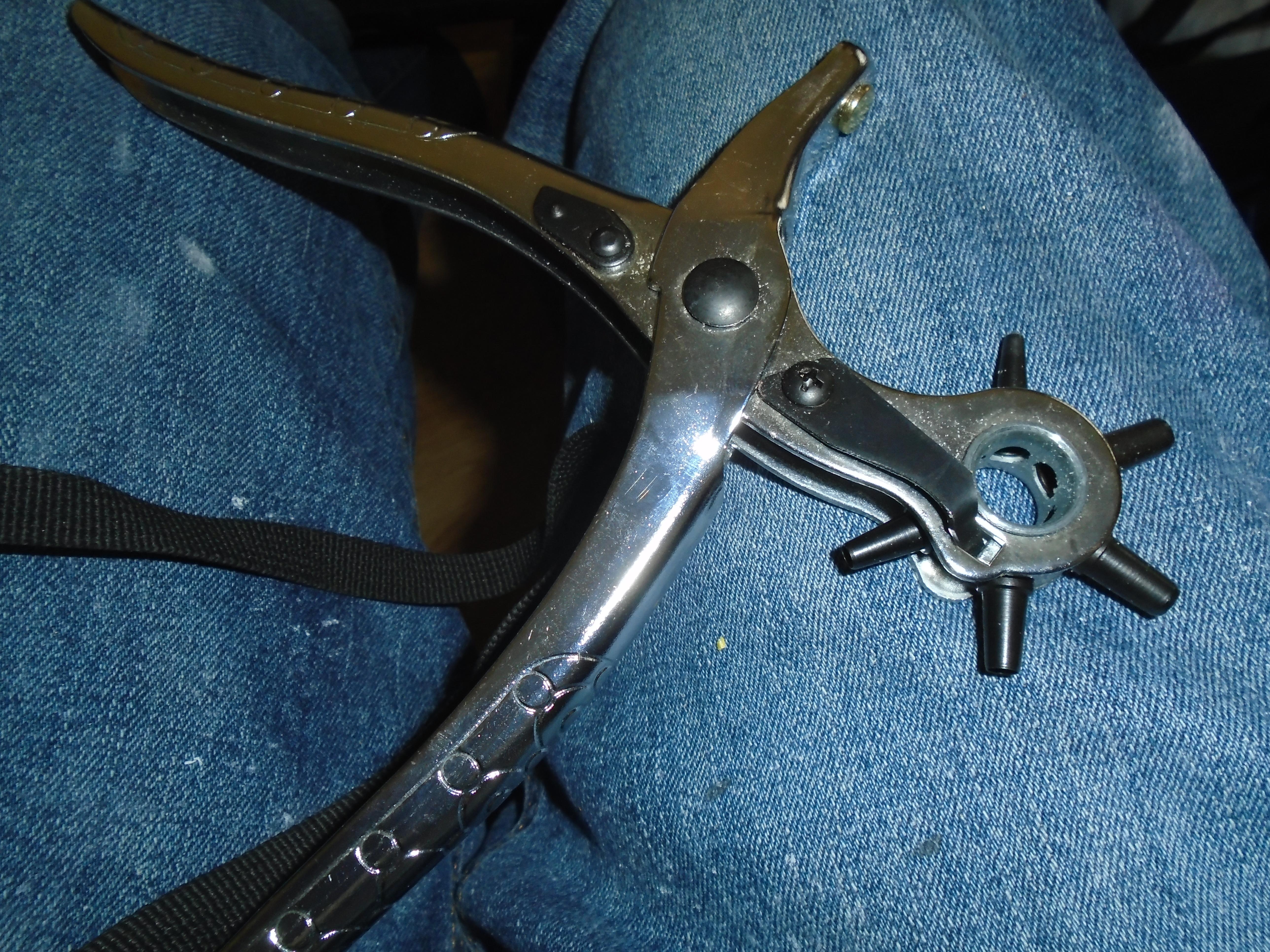

Bought a set of these at Harbor freight and there is one size in there that works perfectly for headlight covers, of course depending on headlight size and whether one light or two.

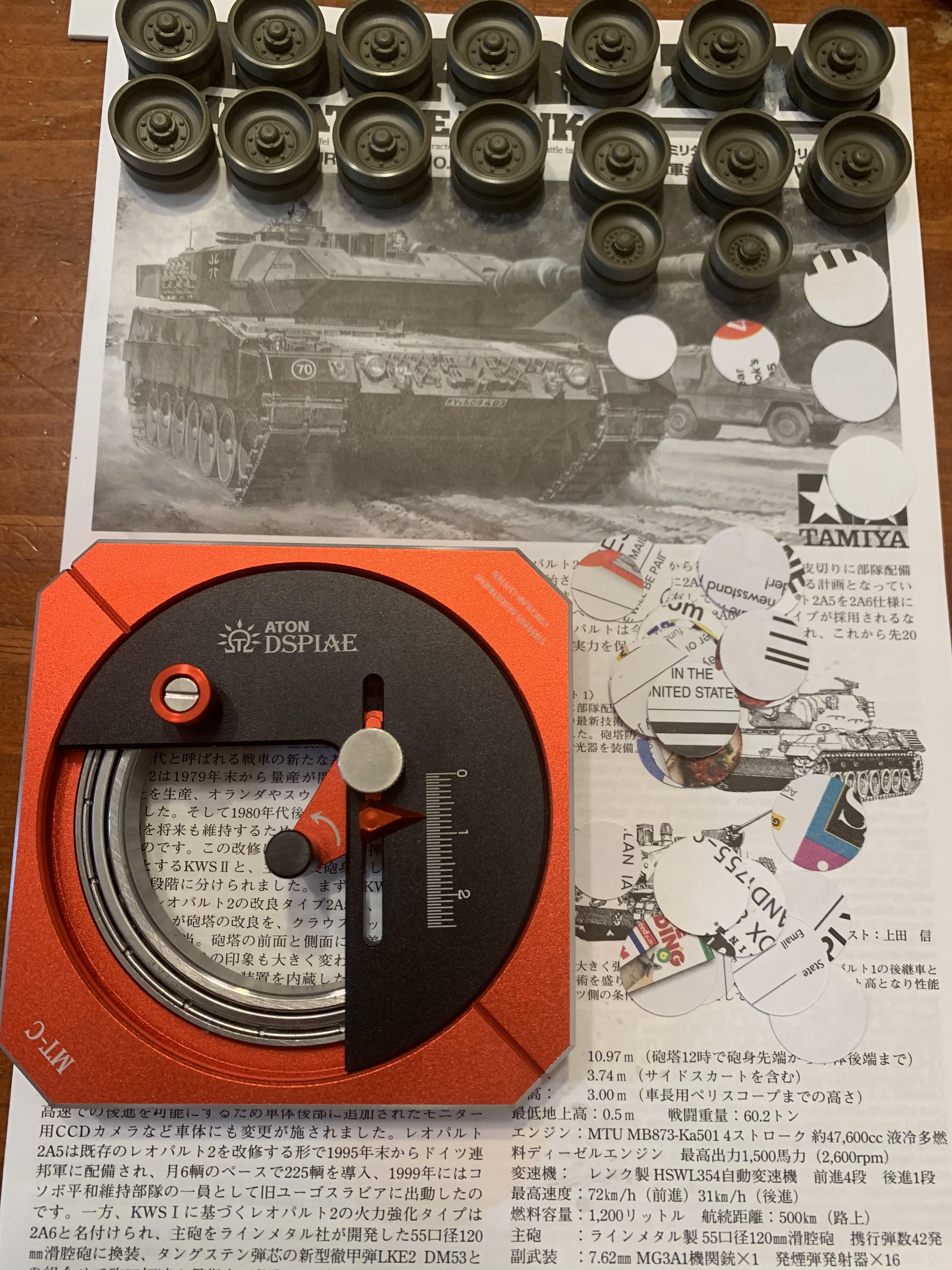

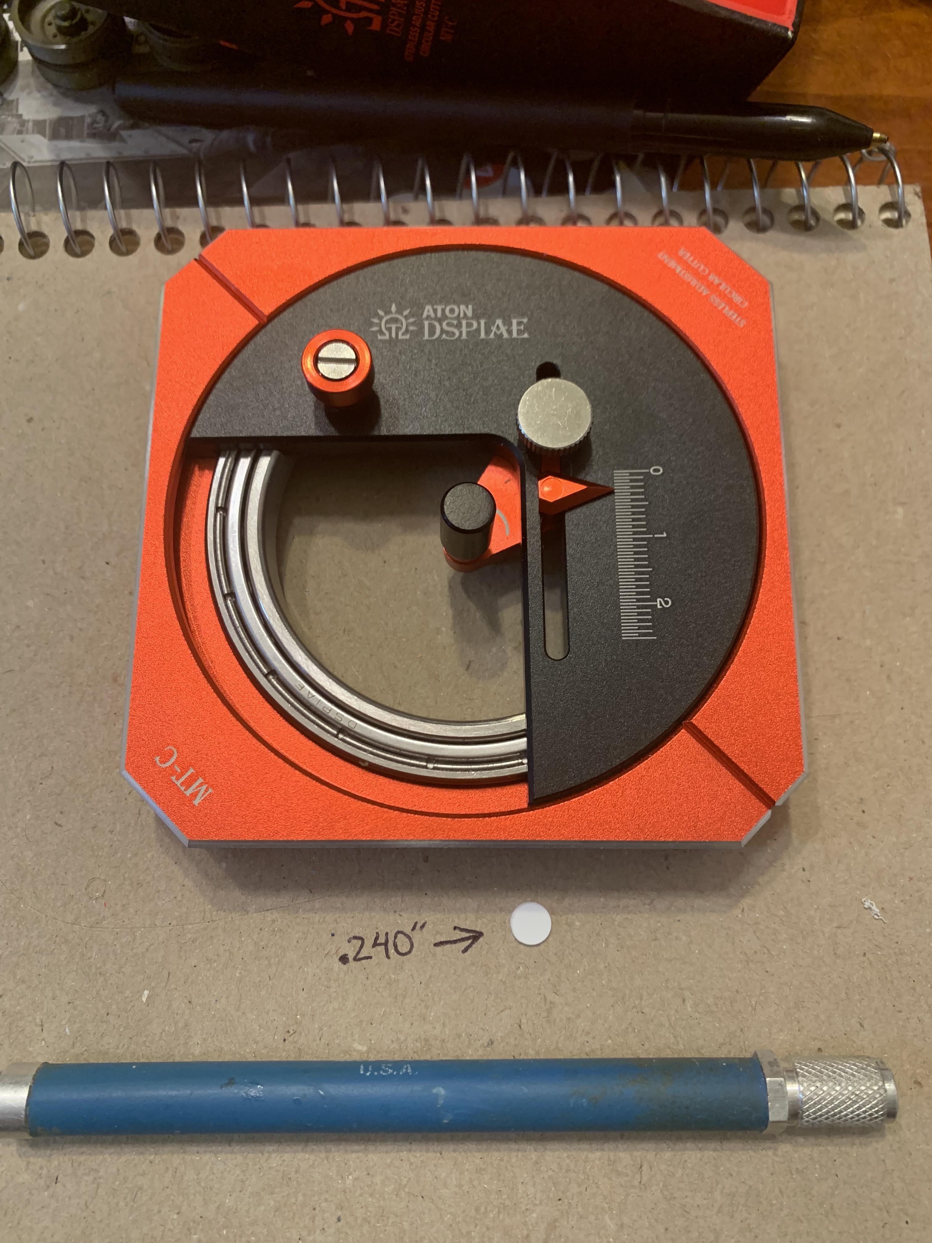

I like this one. It goes from 1mm to 50mm. I made a bunch of discs to mask road wheels for a tank, while painting the rubber “wheel” on the outside diameter. These were made from magazine subscription cards.
I tried cutting a smaller one that is 1/24 car headlight size. For that I used .020” Evergreen sheet styrene. I had to turn it a bunch of times to cut through .020”. I think .010” would be better, but I don’t have any right now. This is not the only brand for this type of cutter. I don’t remember the prices.
Some notes on using it; the bottom is covered with non-stick pads that are included. These are not optional. The tool will try to move the paper or plastic being cut. The entire base should be on what’s being cut, the blade can move the material around. Also, the next circle can’t be too close to the last for the same reason (when cutting paper). I think that .020” is the thickest that can be cut, at least for smaller diameters. For larger diameters, a compass type cutter is better, and easier to set for the proper size. (Divide desired diameter in half, then use a caliper to make two holes in paper, then set the compass point and blade in the holes).That’s really darn close to the desired diameter.

One disadvantage of the DSPIAE* tool is that it’s “centerless”. It does a great job of making circles, but it can’t make a circle with a centered hole (think of a vinyl record). I drove myself batty and wasted three sheets of styrene trying to make it work. It is also difficult to get a circle to an exact diameter (if you measure with a ruler, it’s ok. If you use a dial caliper, you’ll need cut several circles, chasing the right diameter with each try).
*I’ve heard the name pronounced as a word, like “Display” minus the L.
Link to comment
