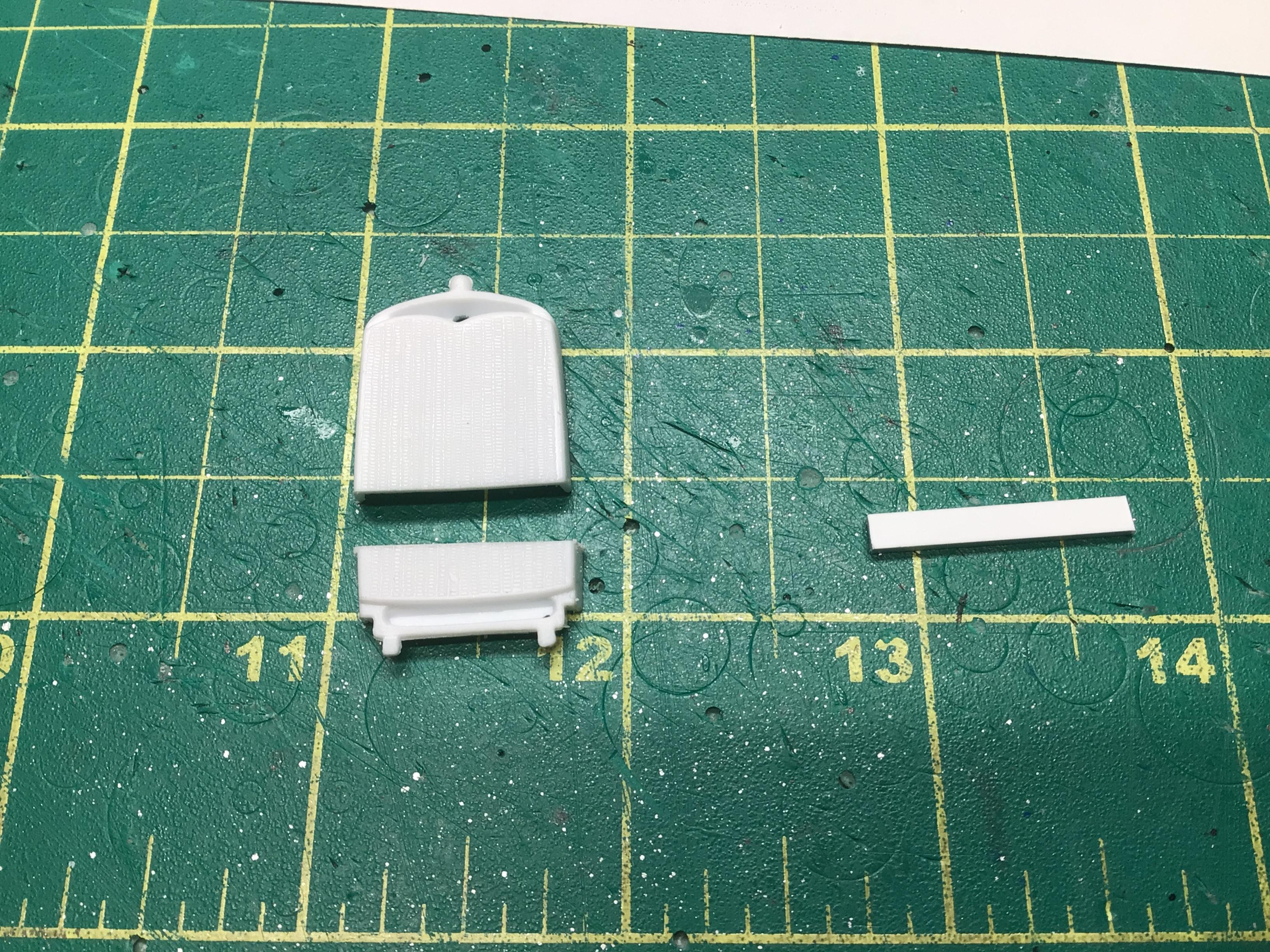

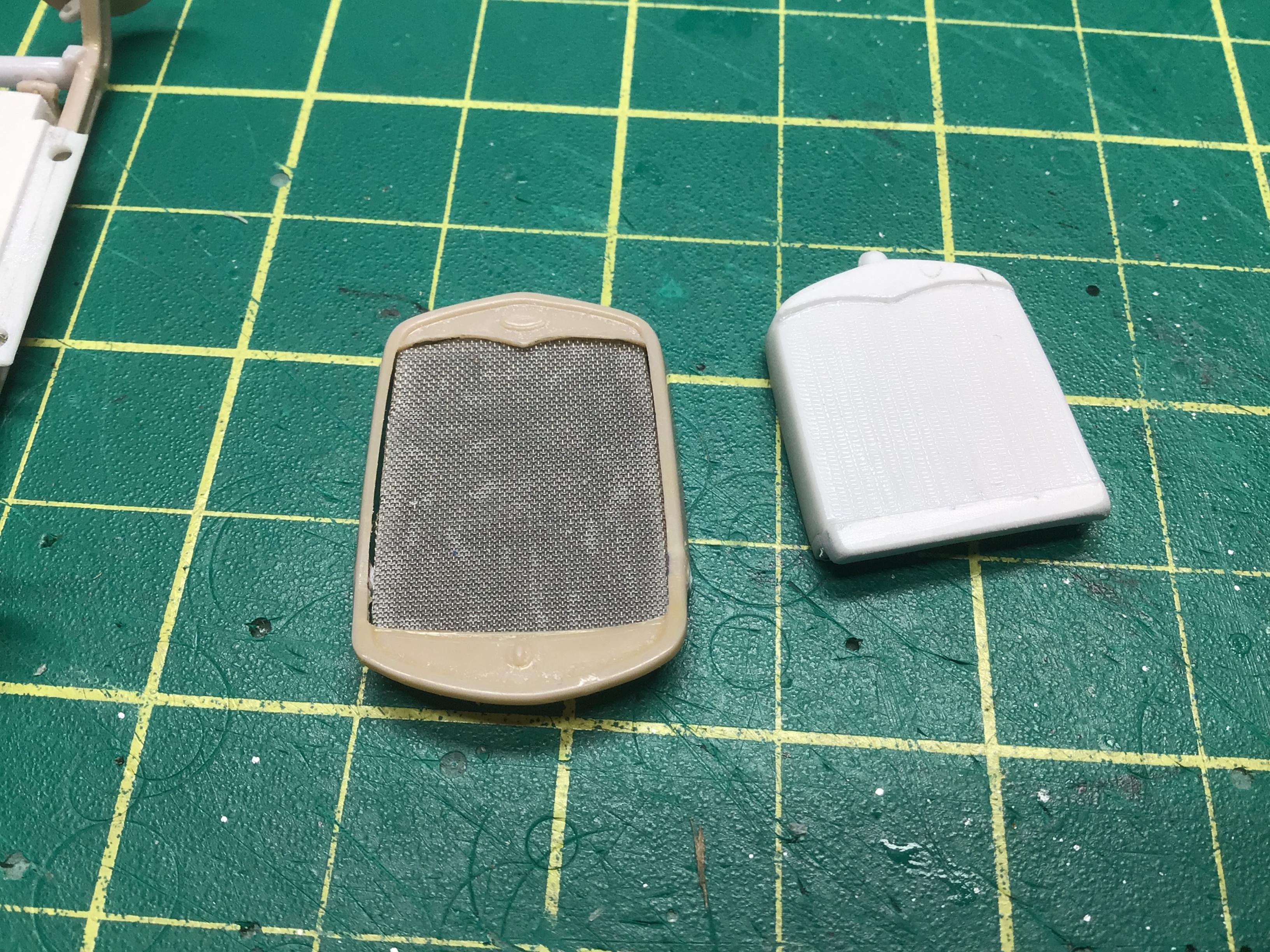

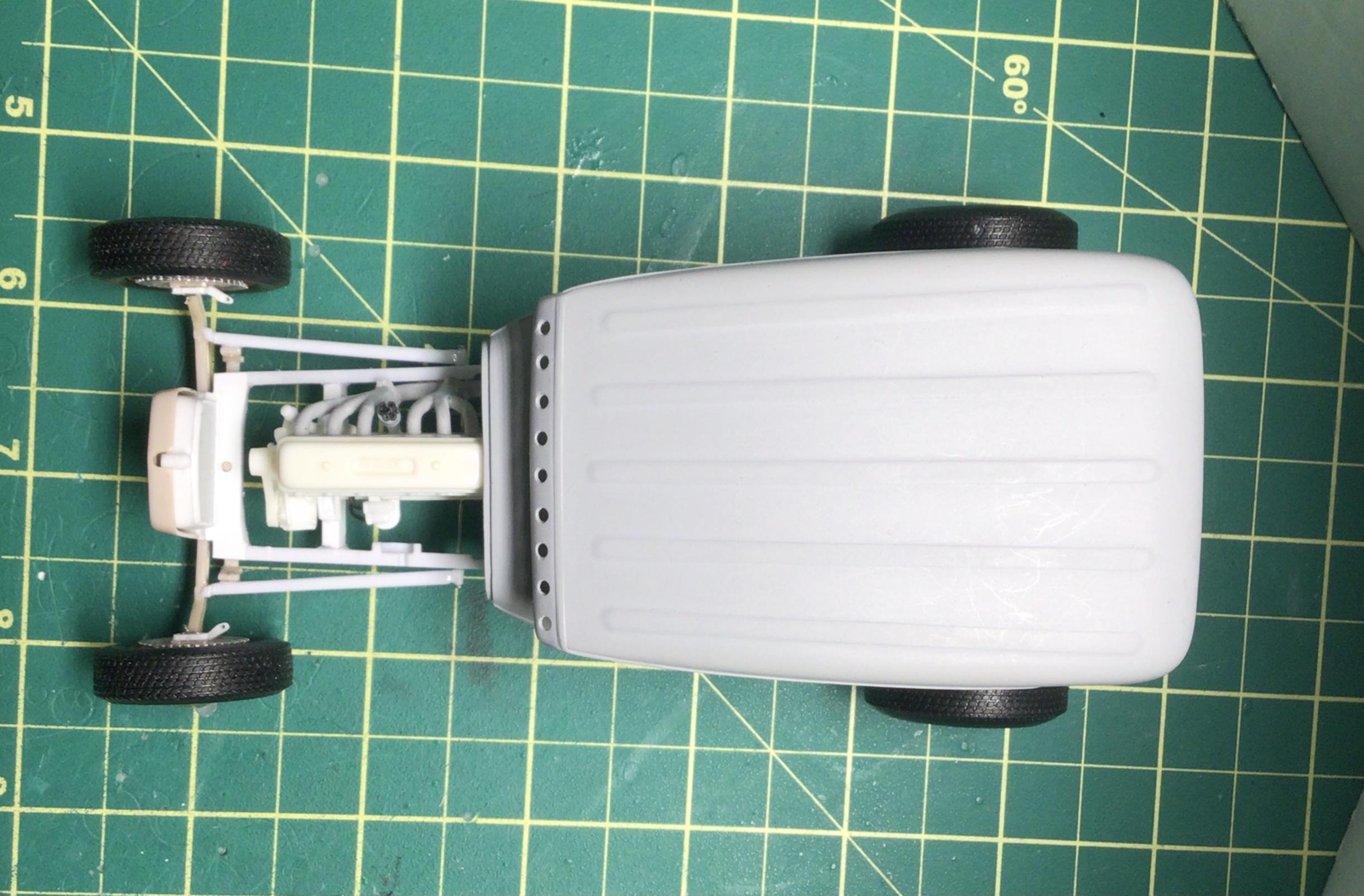

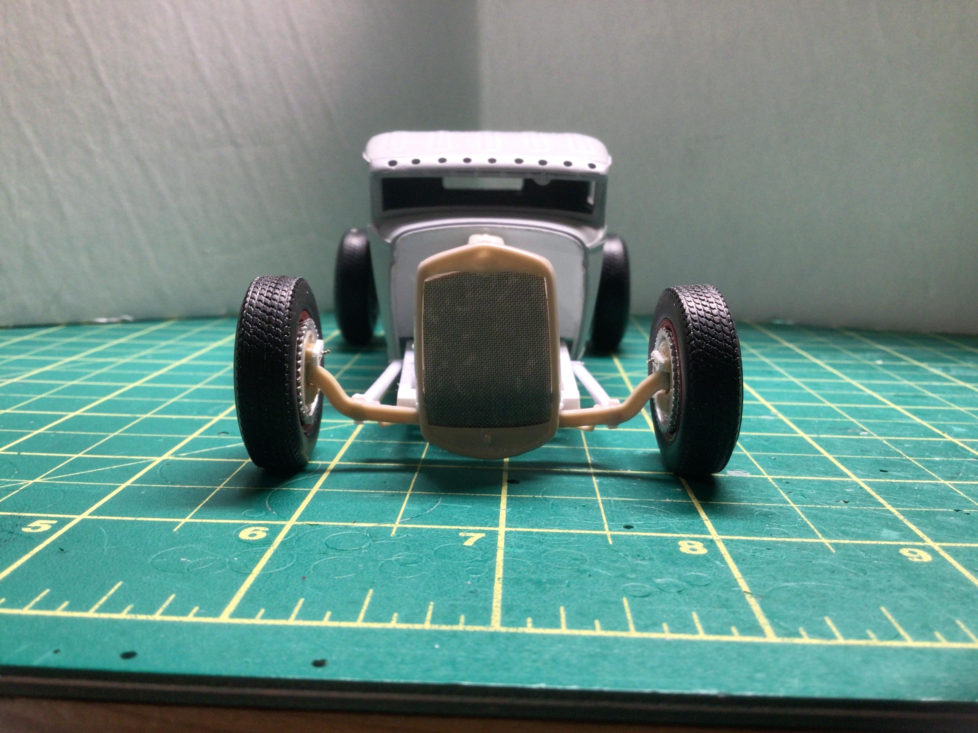

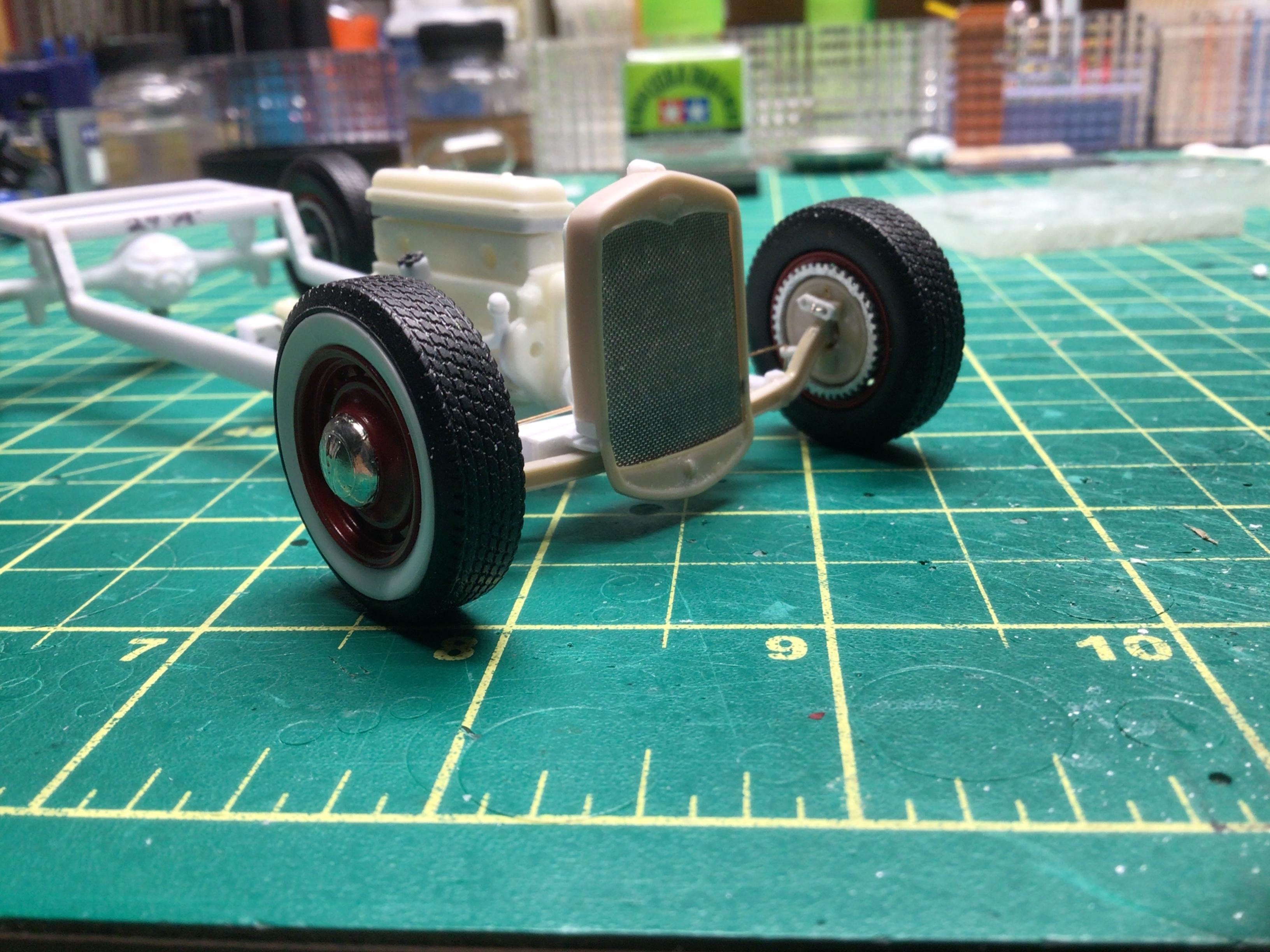

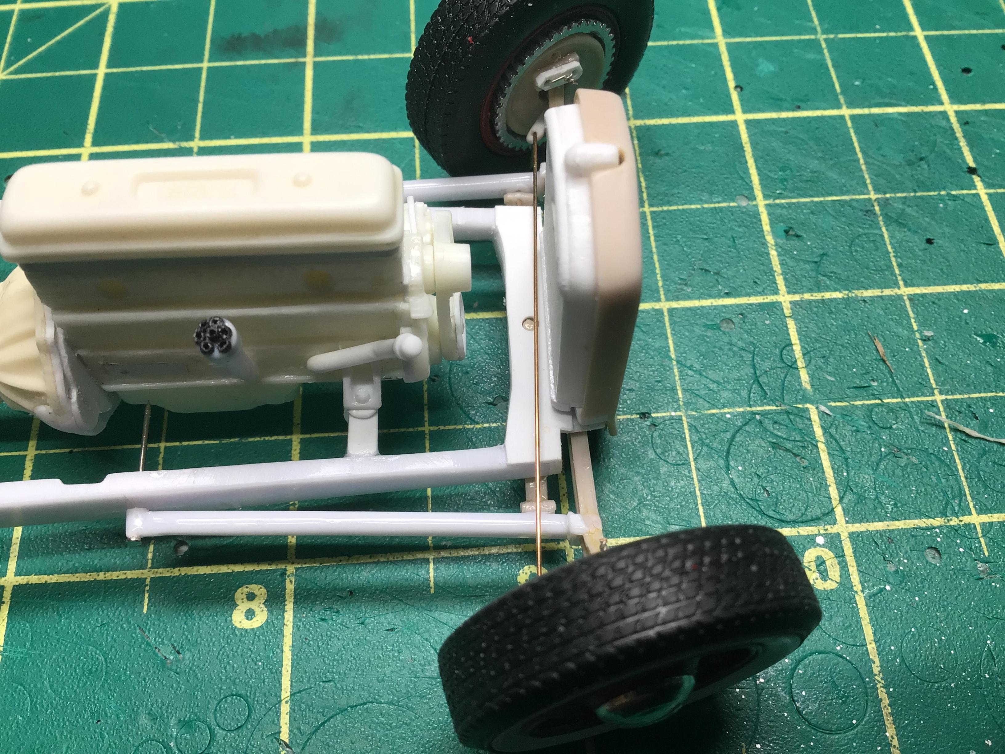

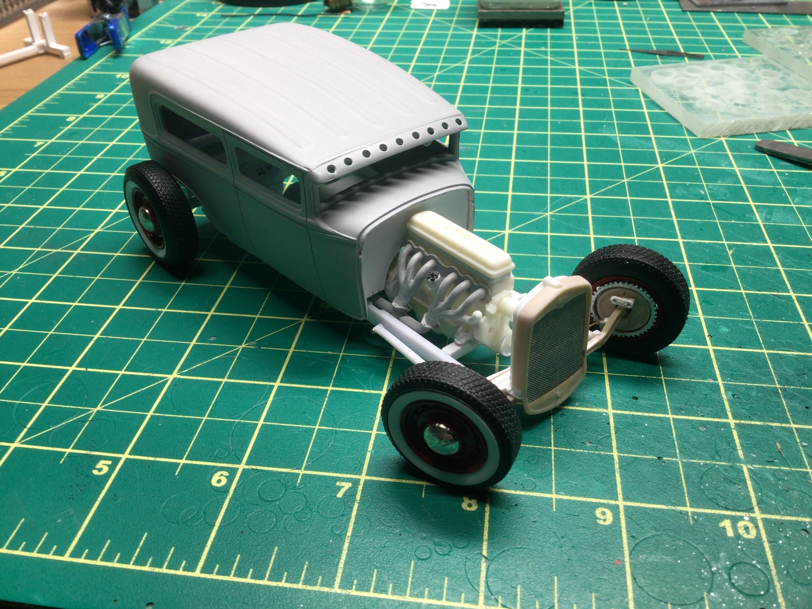

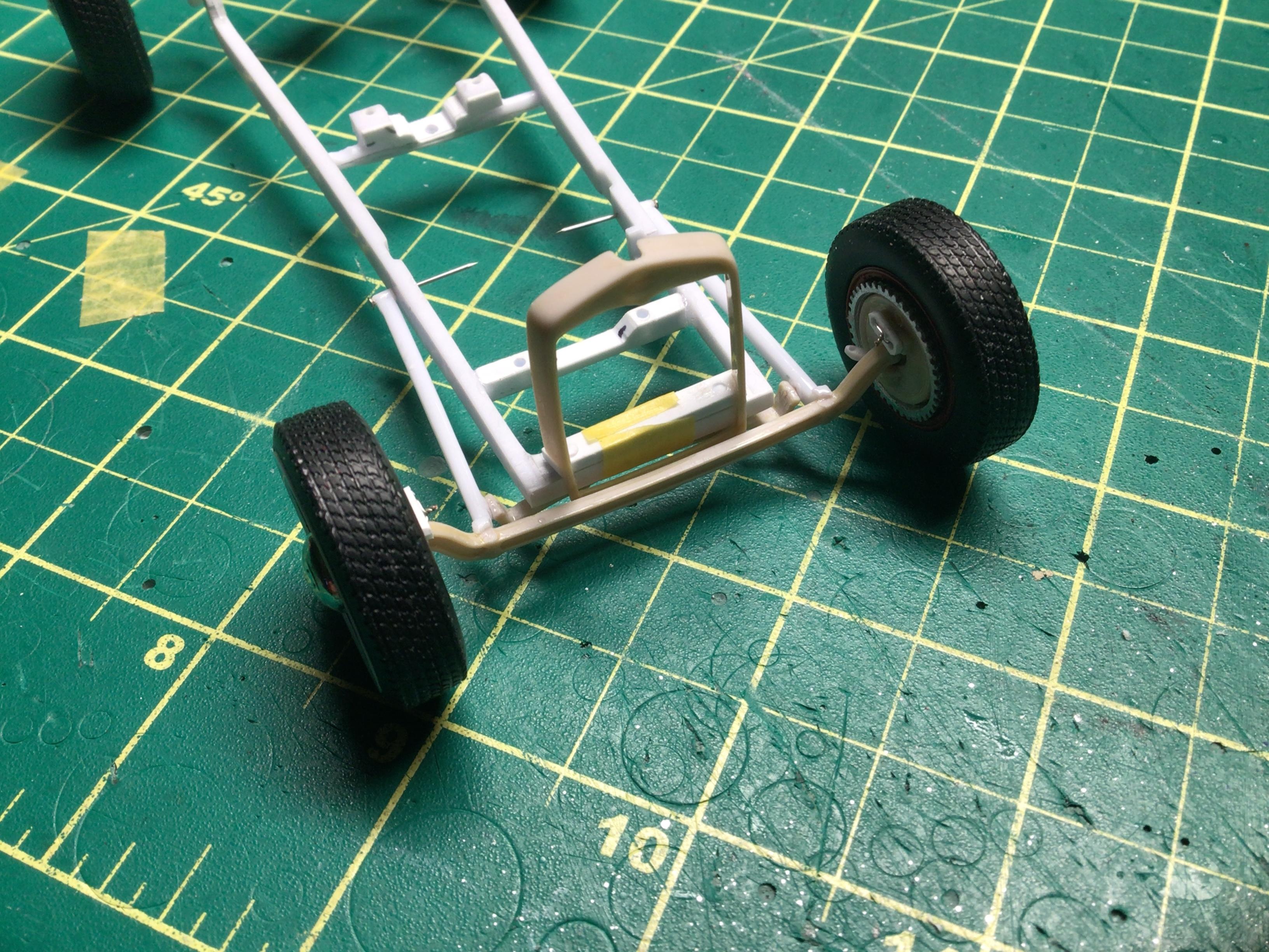

Well I had a bit of a conundrum about how to mount the radiator and grill. Moving the axle out in front of the frame rails creates a problem for both the grill and the steering system.🤯 At first I had the grill shaved and tucked in between the frame and axle. That  left no space for the tie rod. The solution that I finally decided on was to move the grill out in front of the axle. Very limited suspension travel now, so I will have to avoid speed bumps.😬

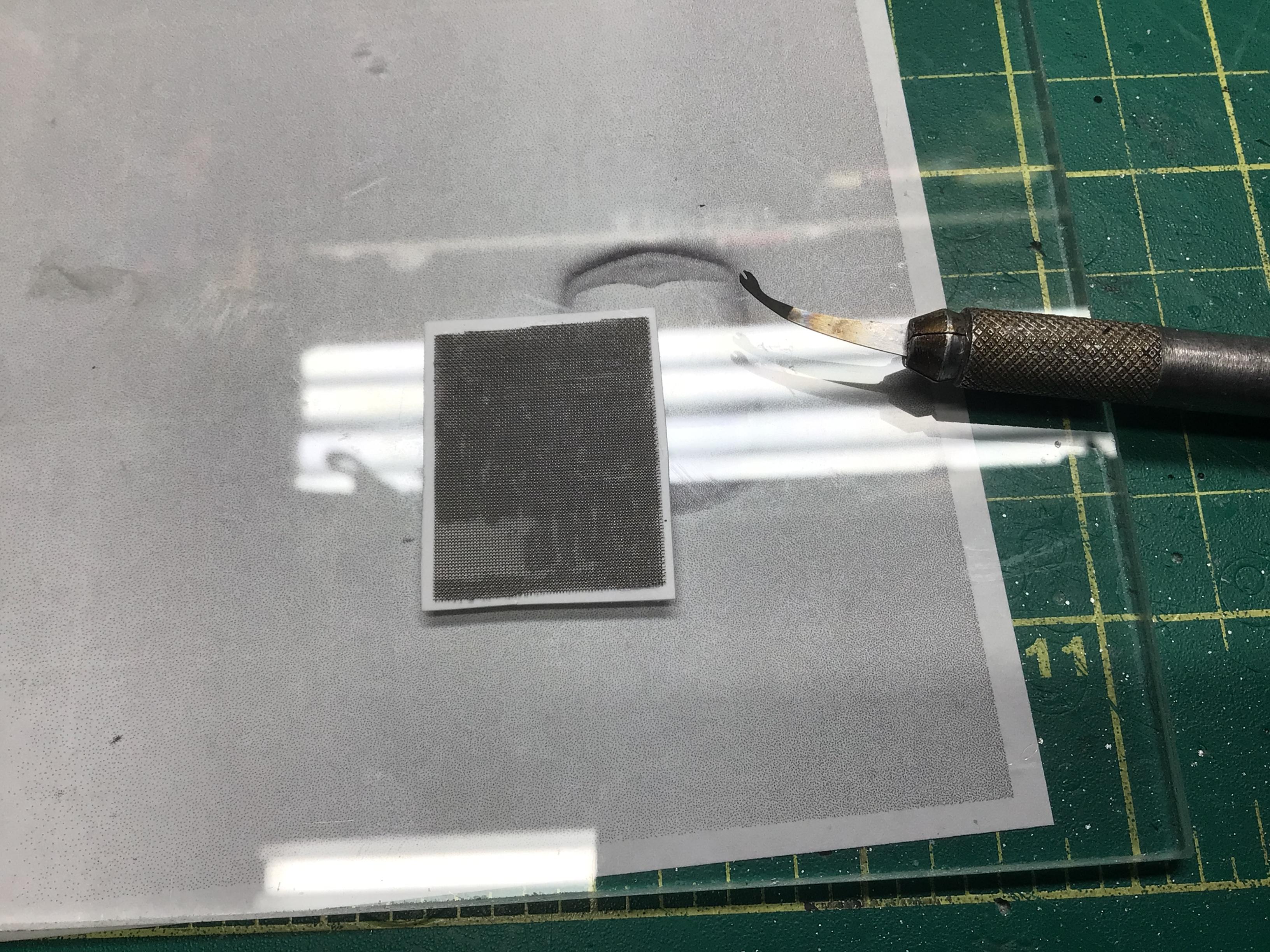

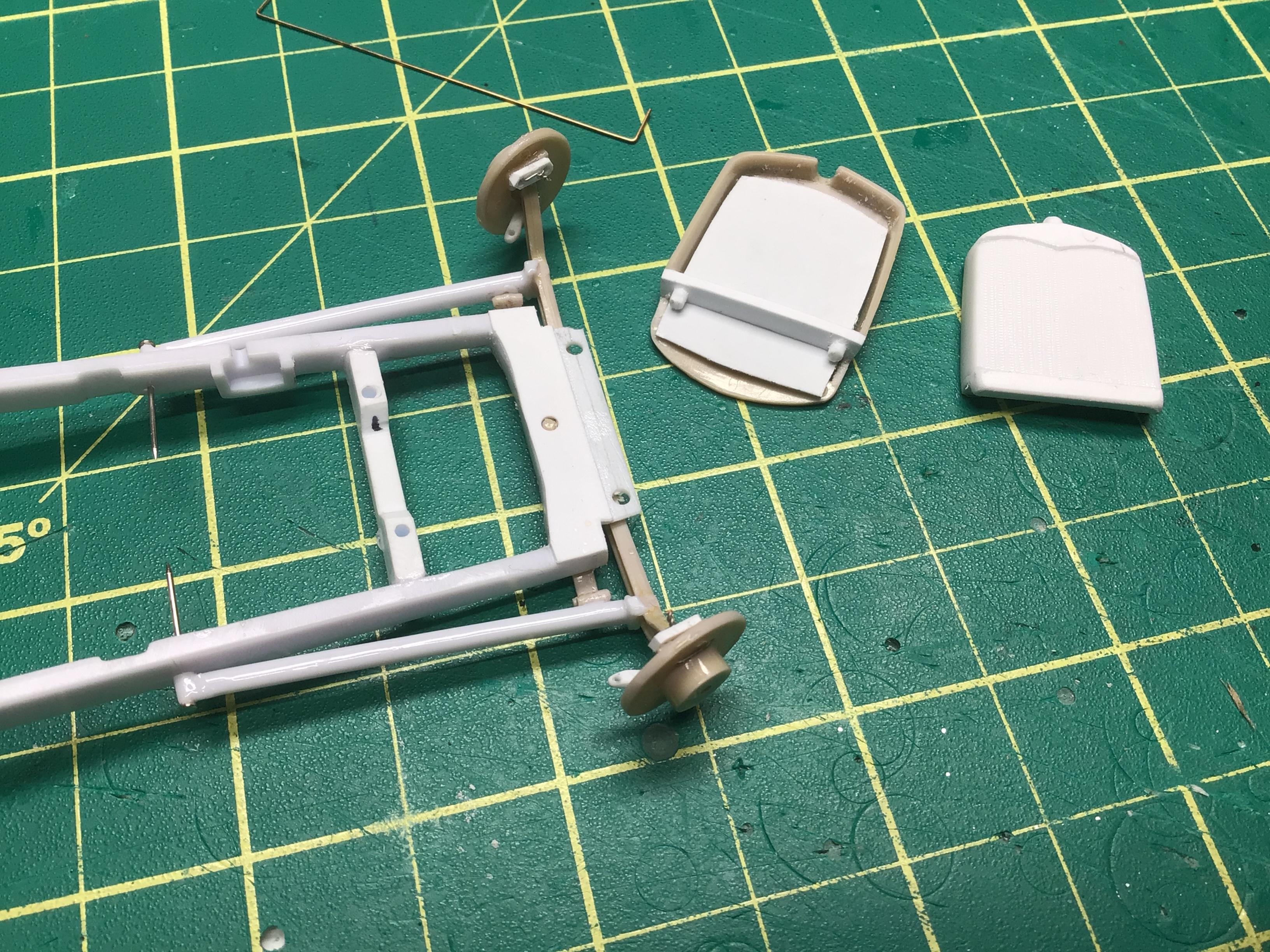

I sectioned the kit radiator and mounted it backwards in the grill shell. Then I used thin CA to glue some fine mesh to a piece of.010” styrene sheet for the front of the radiator.
The new setup leaves lots of room for the tie rod and whatever fan setup I decide on. Thanks for your Patience everyone.🥴

1 hour ago, rattle can man said:
How about using a "suicide" spring perch and notching the center of the grille around the mount?
I think I’d have the same issues mounting the grill and radiator. I don’t like the raised spring mount though…I think it looks a bit scary.😬

As long as the welding was performed by a competent tradesman, the "suicide" spring mount wouldn't be dangerous, in and of itself.  It's the unprotected stuff sticking out everywhere that's the problem. 😁

He should be fine over the speed bumps, Len, after he installs some heavy duty shocks. 🙂

Thanks for your interest, encouragement and patience everyone!🙂 I am kinda making this up as I go along…trying to fix issues as they arise.🥴 I’ve never really been good at making a plan and sticking to it. I have a general idea of where I want to go but usually wind up changing tack a number of times due to unforeseen issues or just whims.🤪
Yup - suicide front end - best left for T bucket IMO

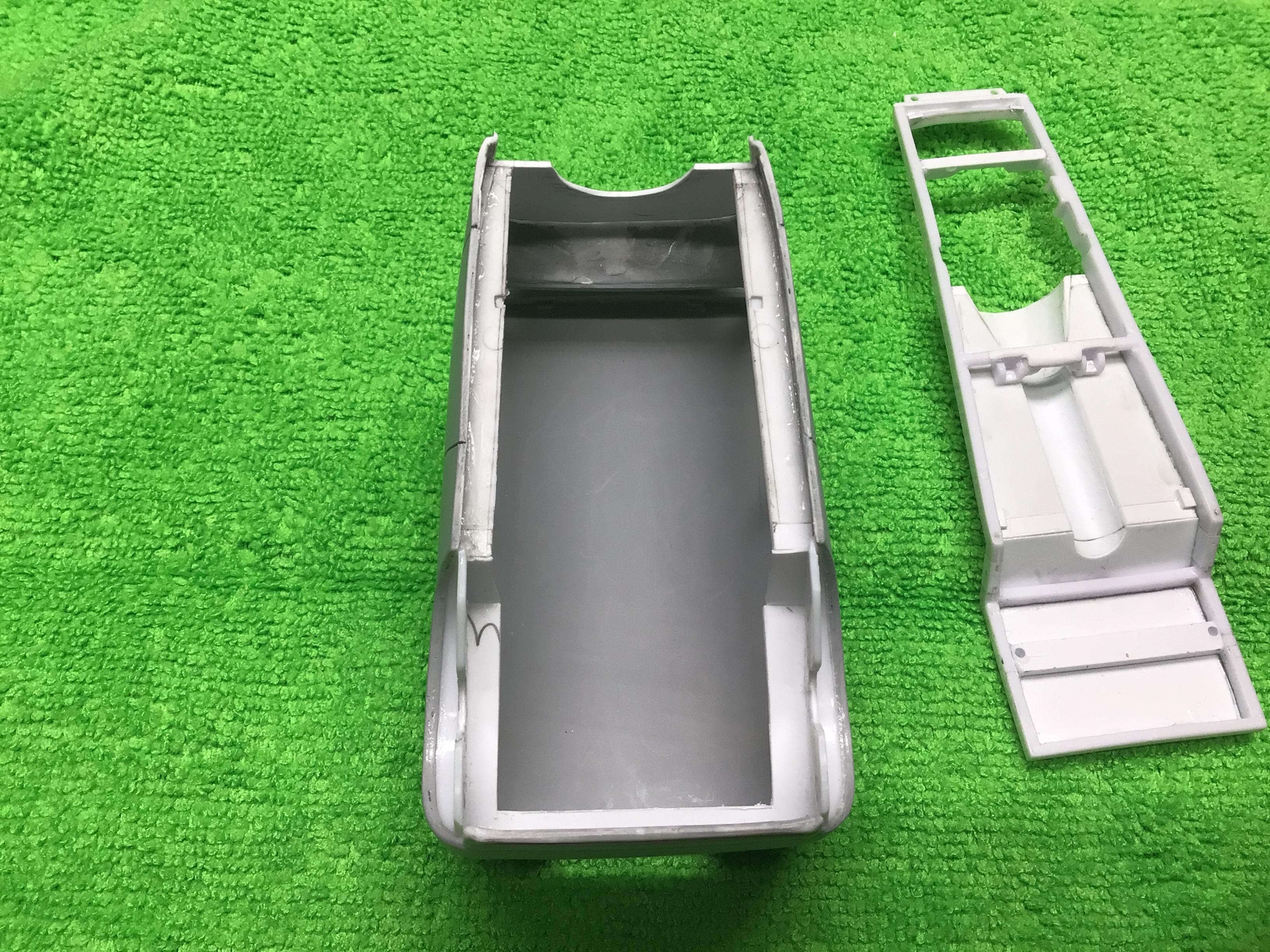

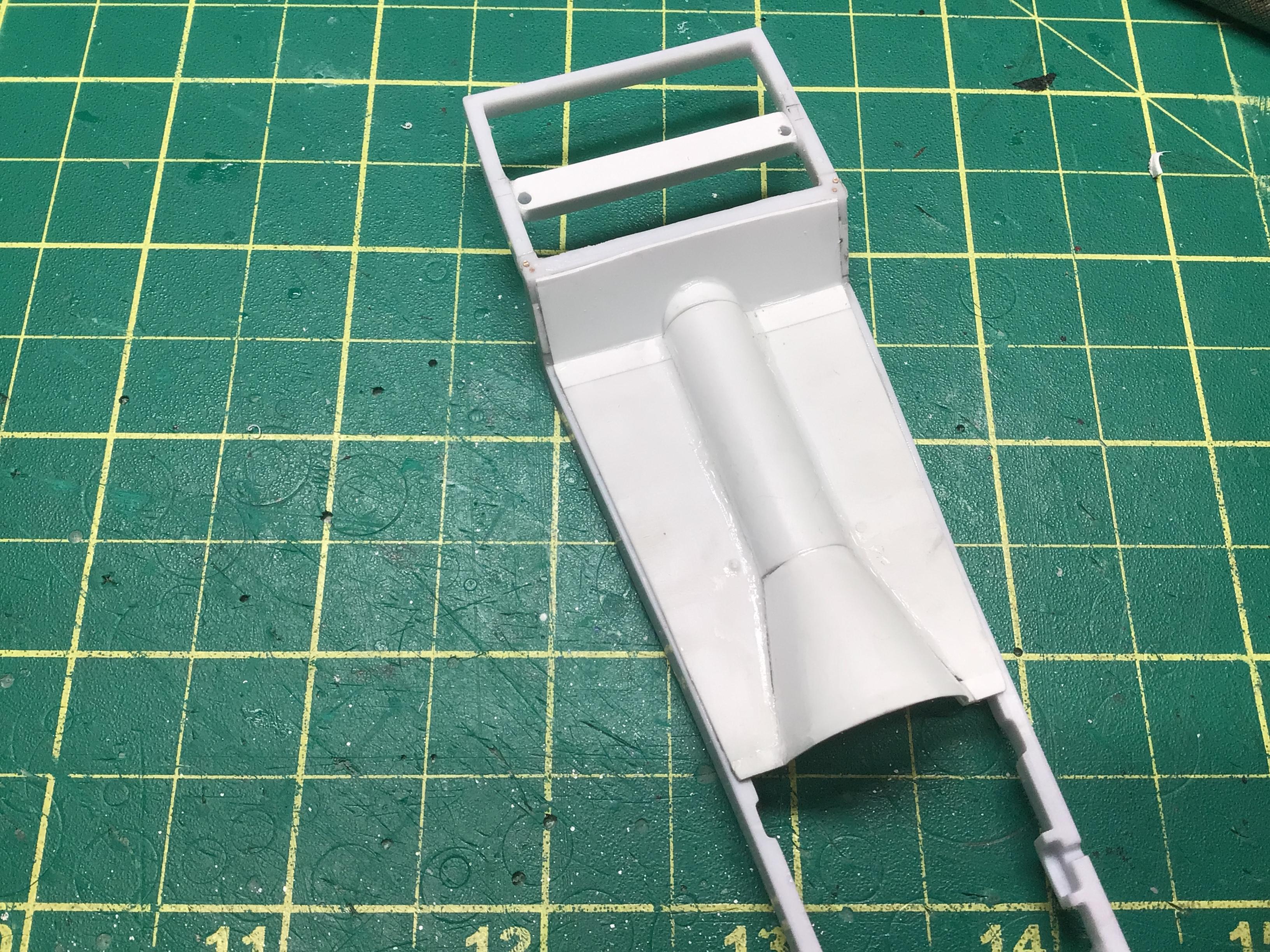

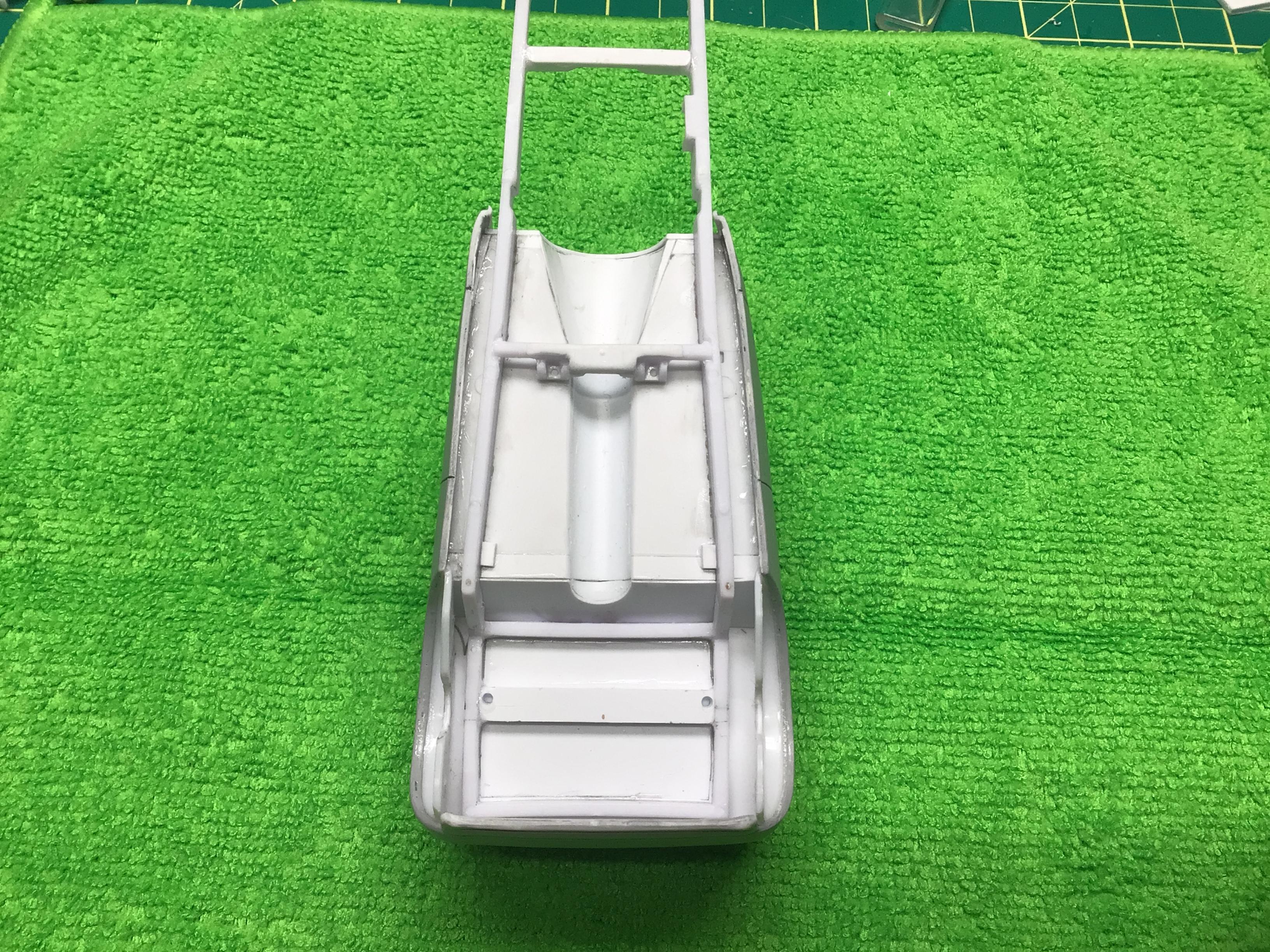

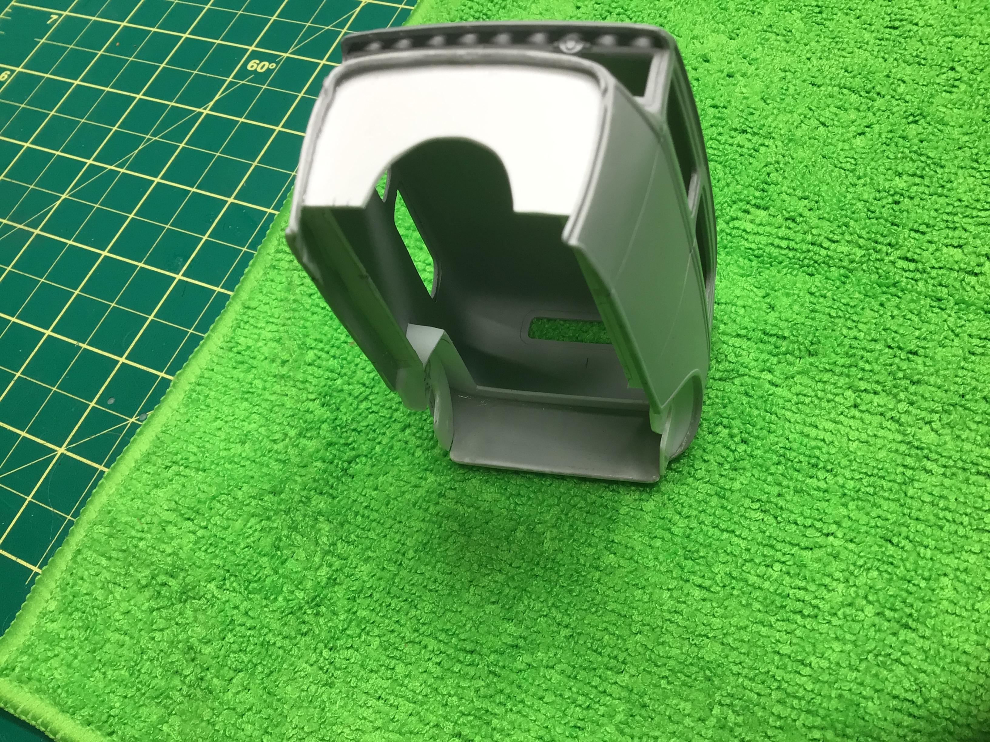

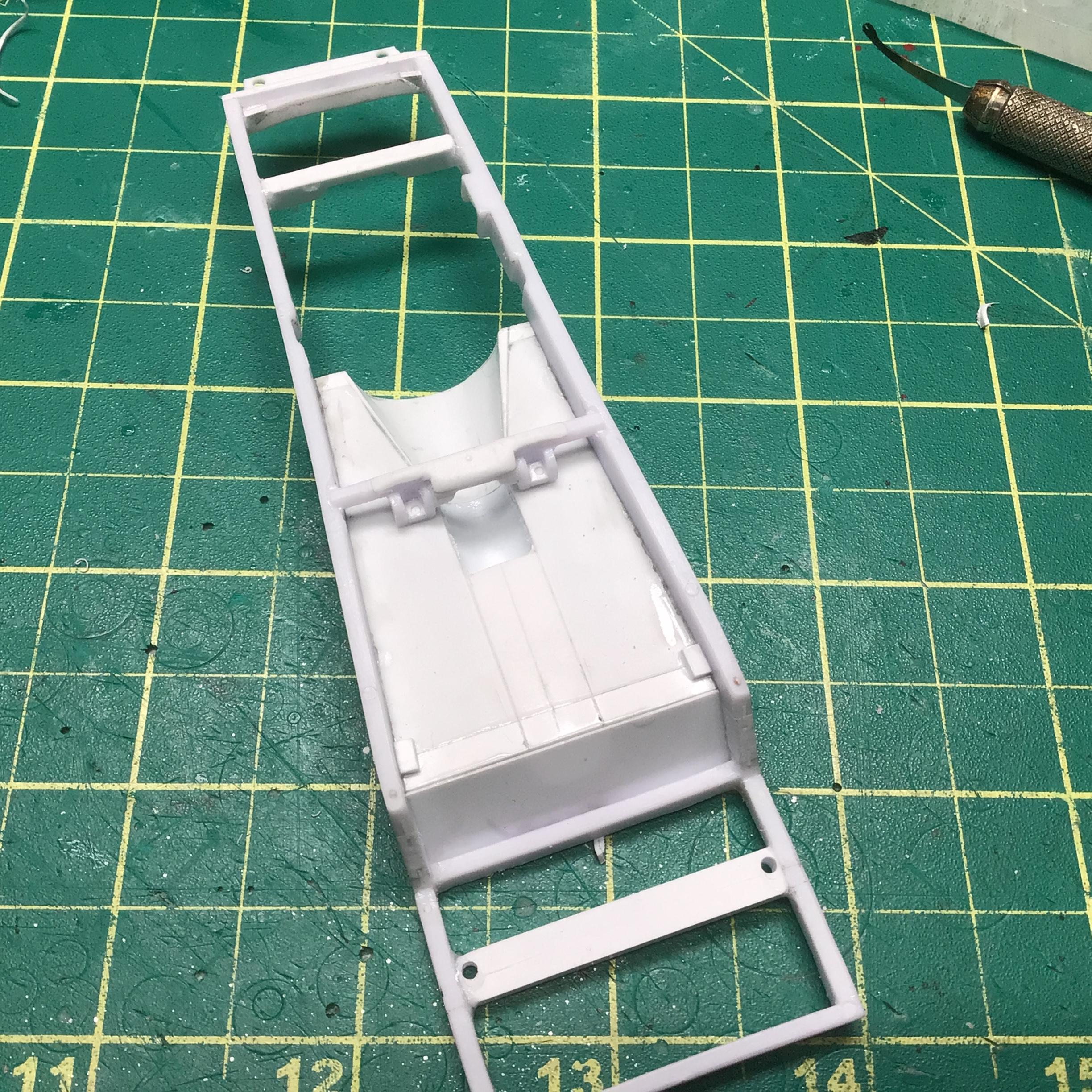

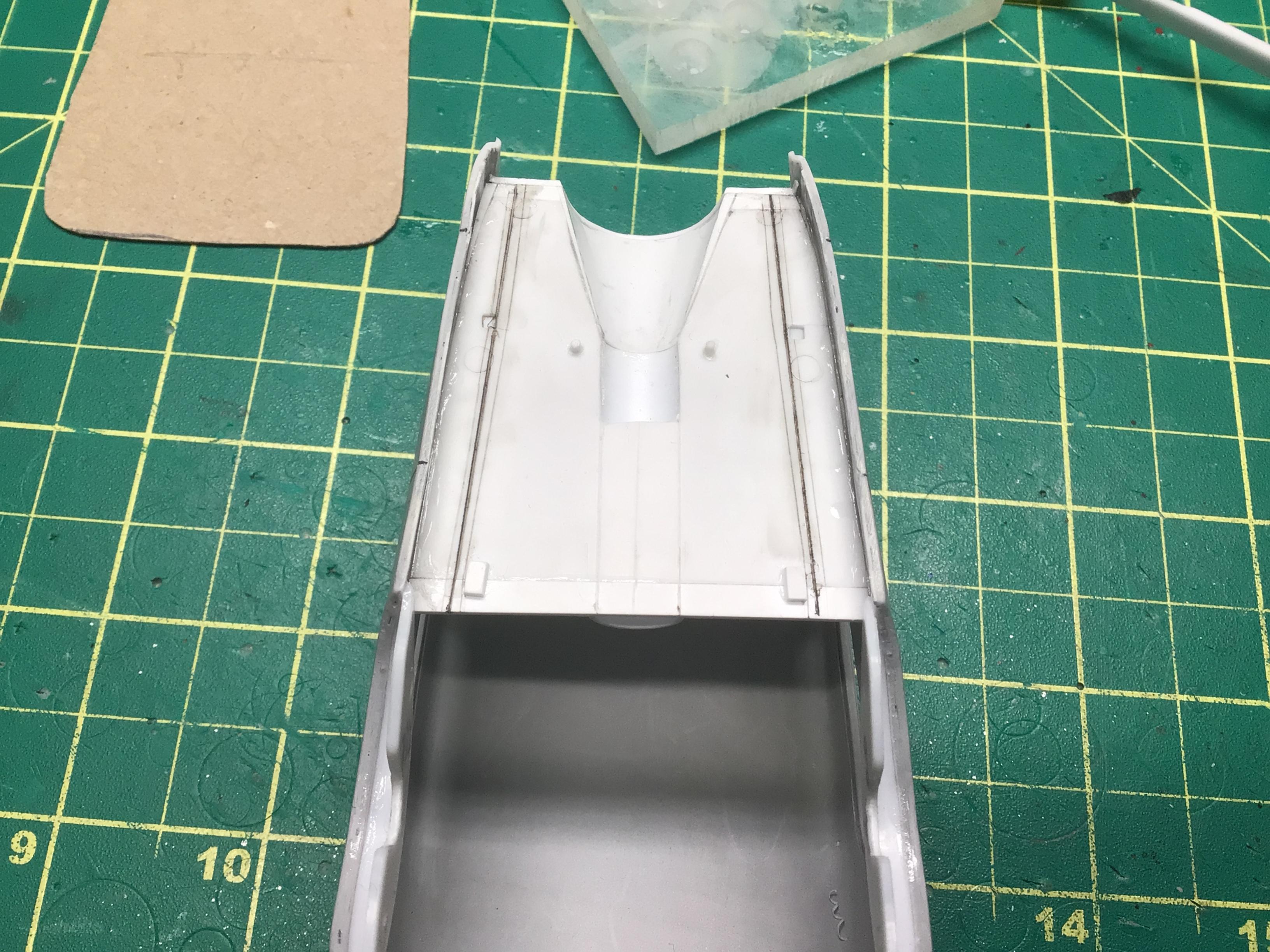

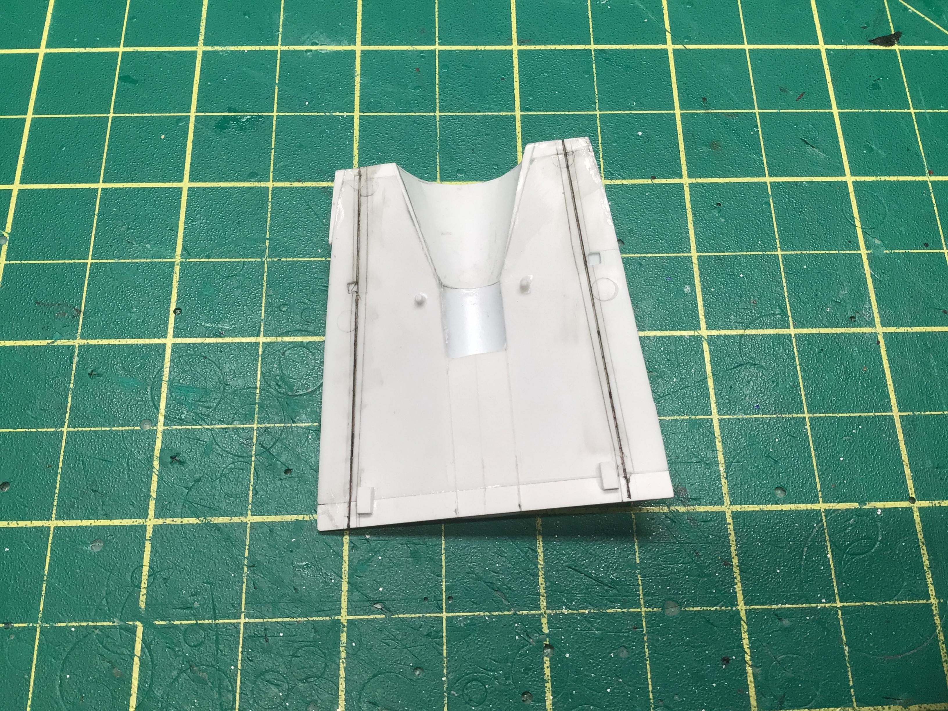

I finally figured out how to get some sort of interior into this wedge shaped body. I made a tracing of the frame rails on the floor pan then scribed the floorpan partially through dead center of the frame. Then I glued the floor pan to the body, cut the center portion free and glued it to the frame. Now I can get a minimal interior installed in separate sections…one attached to the body and one attached to the floorpan. It may be a little unorthodox, but I have no idea how else to deal with it.🤯
