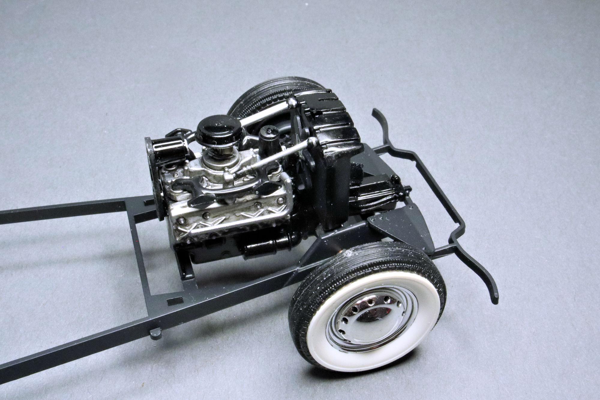

David G. Posted November 22, 2024 Author Posted November 22, 2024 Hello Everybody! This time of year, for various reasons I don't get much time at the bench. So here's what I was able to get done during my last build session. I have the basic engine assembly completed. All the reference photos I've found on line show the engine and transaxle painted gloss black with aluminum cylinder heads and intake manifold. Not very much visual interest but I'll throw some washes and a little more detail painting at it to bump up the eye-peal a bit. It's time to start smoothing out the parting lines and other casting remnants. That's all for this round. As always, thanks for taking the time to have a look and please feel free to post any comments you may have. David G. 4

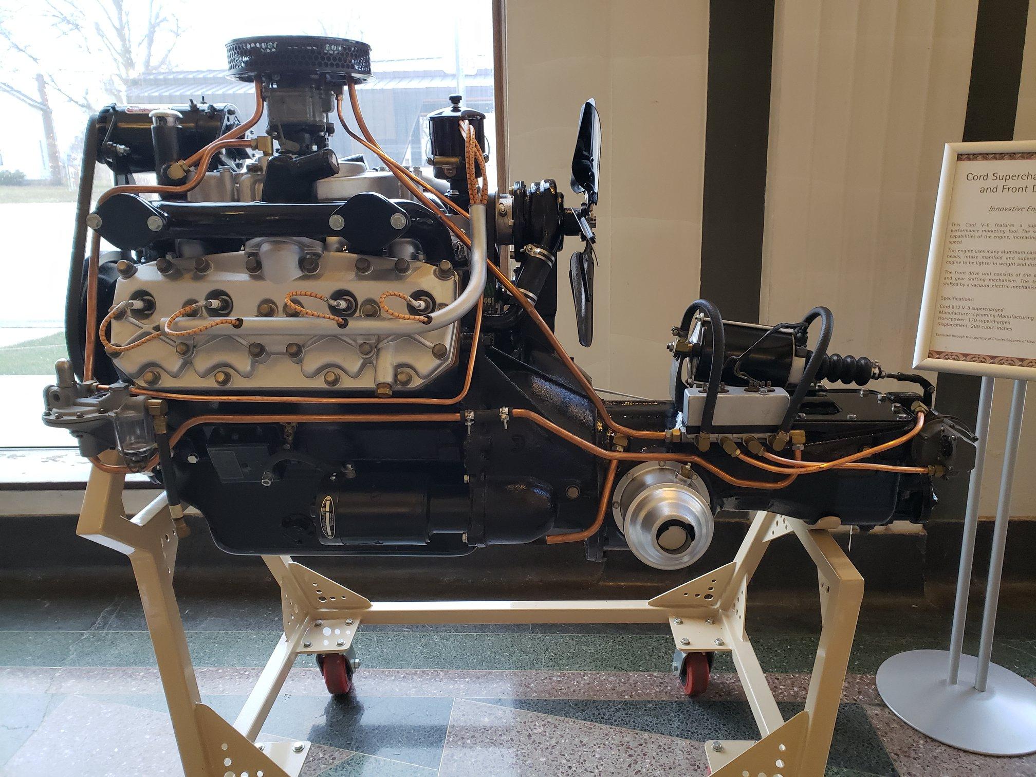

LennyB Posted November 22, 2024 Posted November 22, 2024 David looking good. I think the washes will bring out the details quite a bit. Are you going to try and duplicate the spark plug harness? 3
David G. Posted November 23, 2024 Author Posted November 23, 2024 15 hours ago, LennyB said: David looking good. I think the washes will bring out the details quite a bit. Are you going to try and duplicate the spark plug harness? Thank you Len. I thought about doing that but the "tubes" provided in the kit are pretty small, not much bigger than the 26 ga wire I would use for wiring the plugs. I do have some plans for a little extra added detail but thins one will be OOB for the most part. That's a great reference photo! I grabbed a copy of it for my research file, thanks for posting it. =D- 1

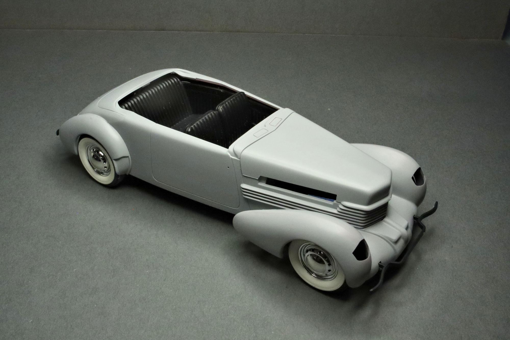

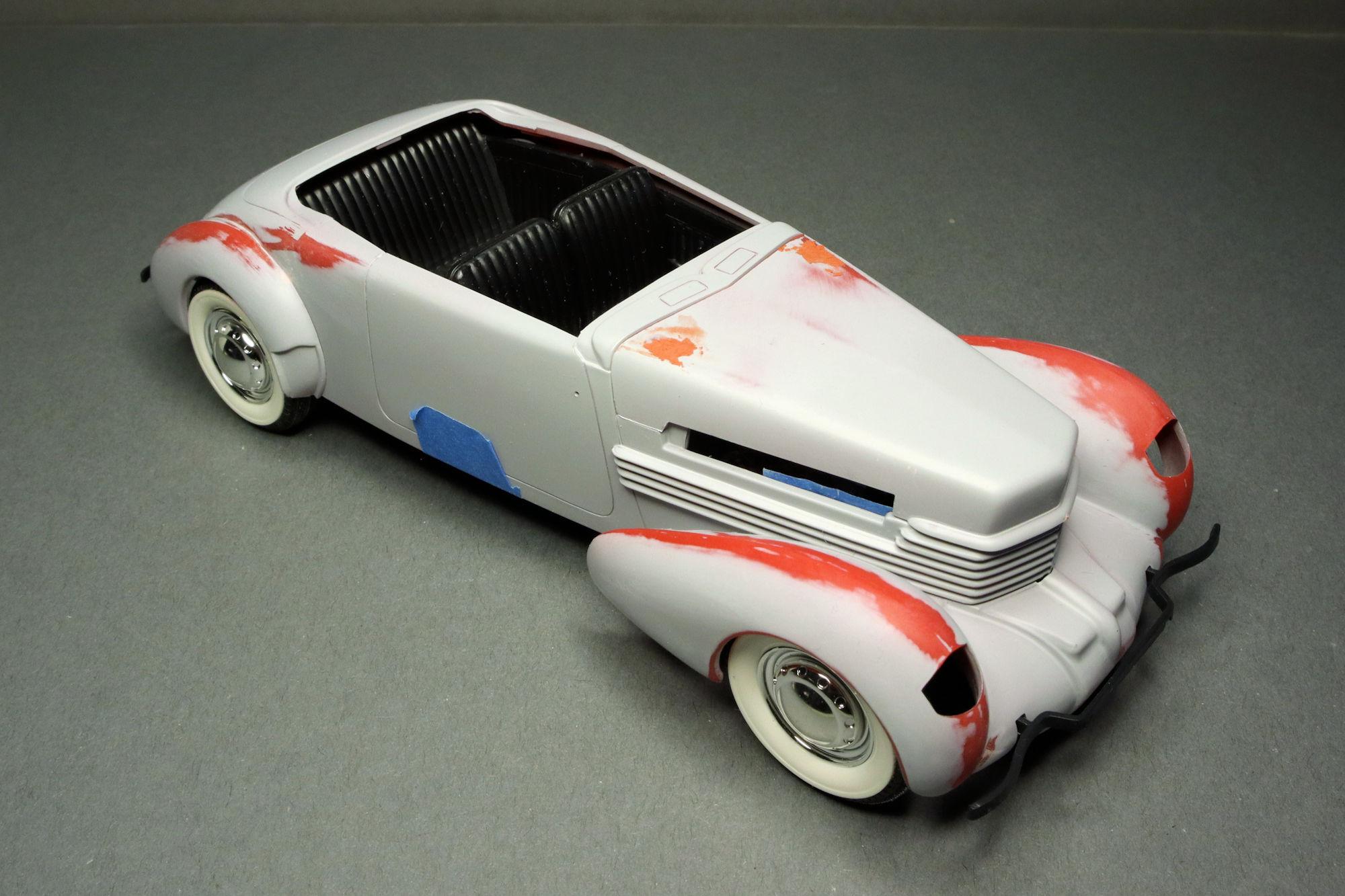

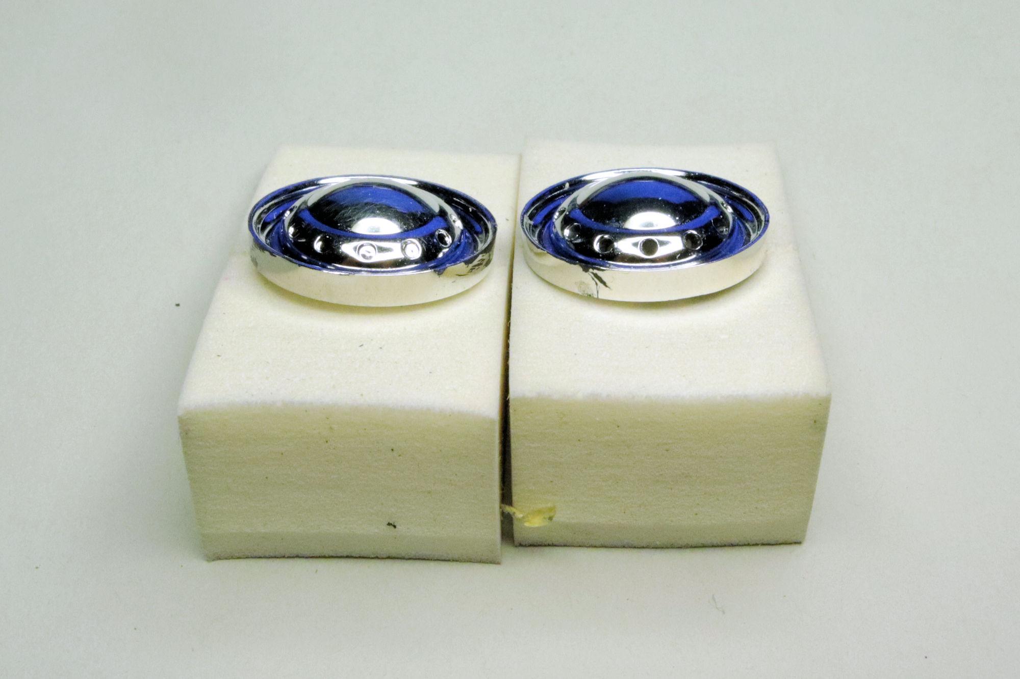

David G. Posted December 3, 2024 Author Posted December 3, 2024 Hello Everybody! Now that I'm back from the long holiday weekend, it's time to get back to the bench. After attaching a final few pieces and a quick blackwash, the engine is finished. Not all that interesting to look at but there it is. On the actual car the wheels have holes which are represented on the model by the circular indentations that can be seen on the left wheel. Rather than trying to paint all of these little circles black, I decided that drilling them out would be easier. I think the wheel on the right looks much better with the holes drilled out. After a little more sanding and a coat of primer, the bodywork is coming along quite nicely. There are just a few spots that need a bit more attention. I'm still trying to decide what color to paint it. That's all for this round. If you're reading this then thank you for taking the time to do so. If you've ever followed any of my WIP threads then you also know that I welcome comments of almost any kind. Thank you. David G. 7
