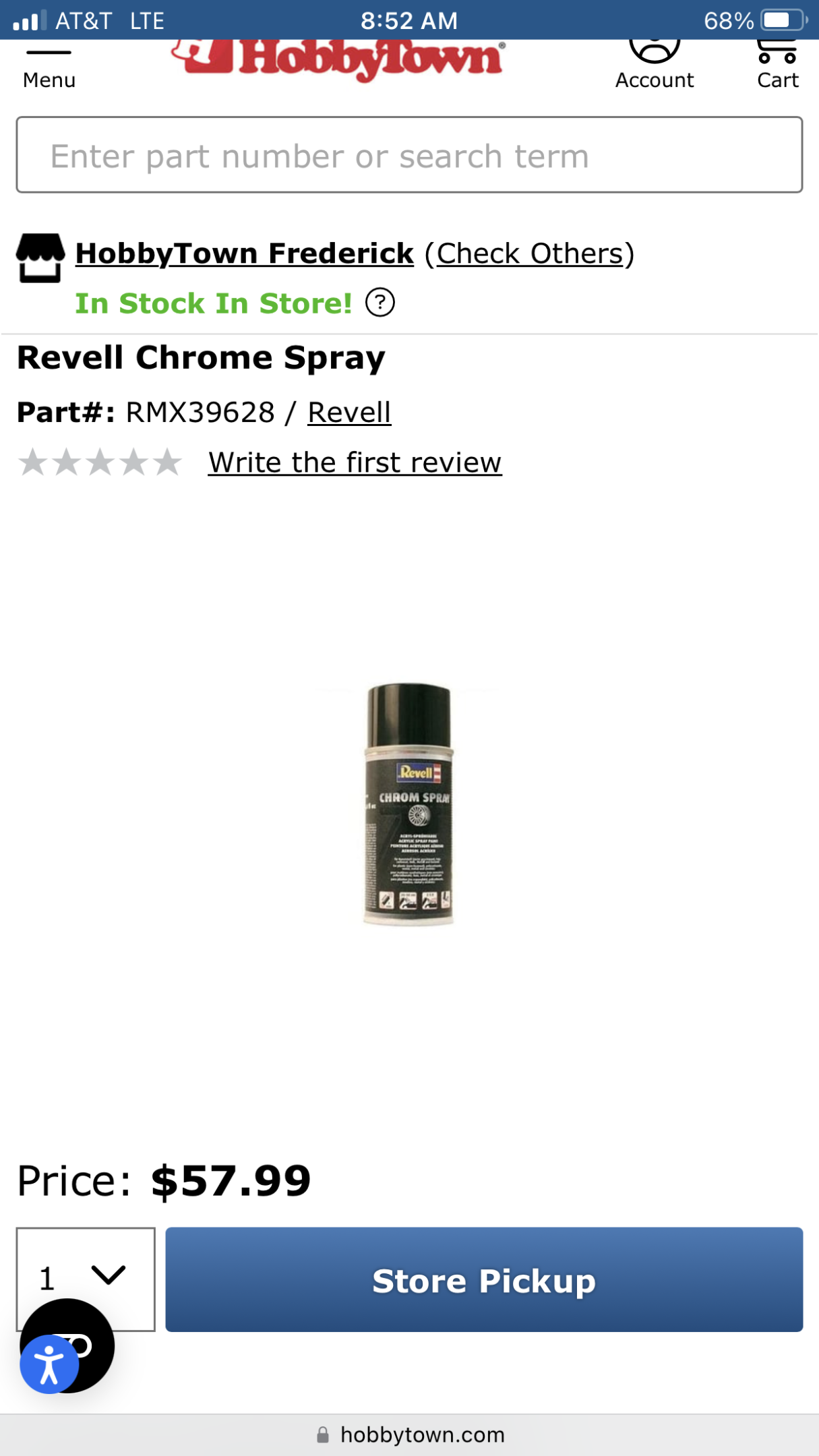

I was at Hobbytown in Frederick MD the other day and was interested in the Revell spray chrome until I saw the price…
$60?????
ah…no! Alclad works fine…
It's most likely your local Hobbytown thing (I don't really like the chain at all, we have the largest one in the country and some of their empty paint slots and complete lack of others, yet every Gundam paint known to mankind are all well-stocked tell me they don't really care about model car guys, having a bunch of kits isn't much good if you don't have the right stuff to go with them) than an actual price we can find it elsewhere. That's easily double what I see it selling for by model show vendors or some online sources. It's good stuff.

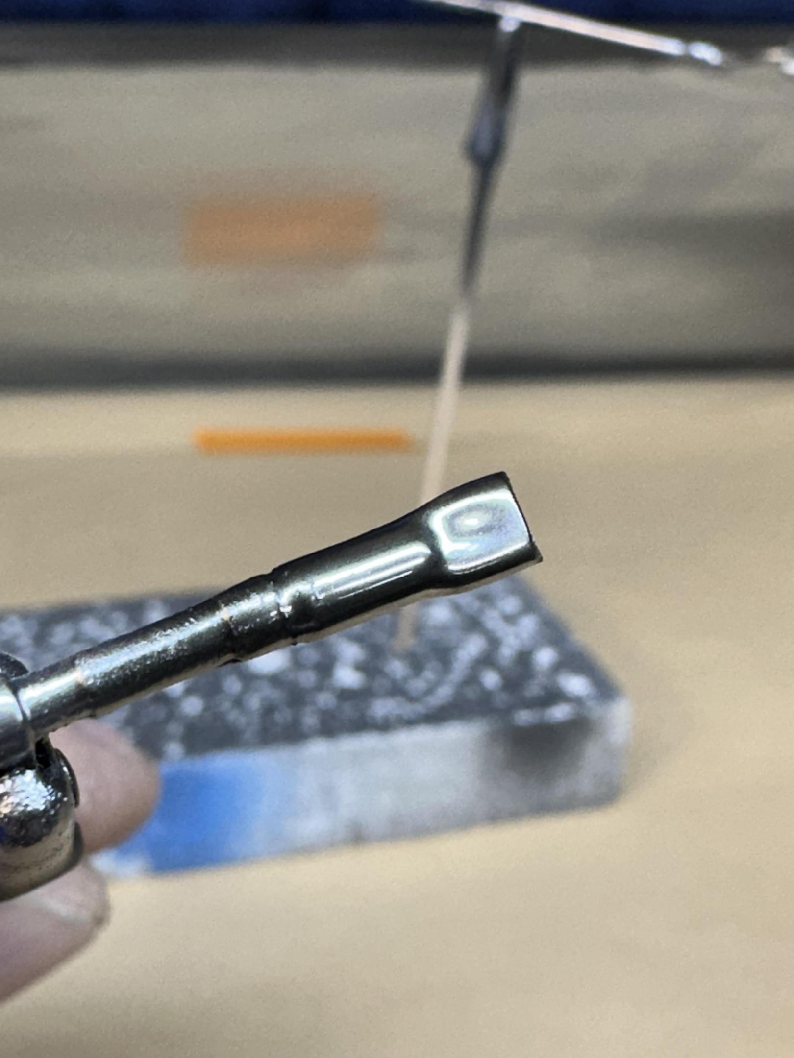

Yes. I’ve been using it for years. Even though it’s labeled for Lexan, it works just fine, after stripping the chrome off of parts, and using a gloss black or blue base. Looks way more realistic than the kit supplied chrome. These stacks were stripped and were sprayed with it.

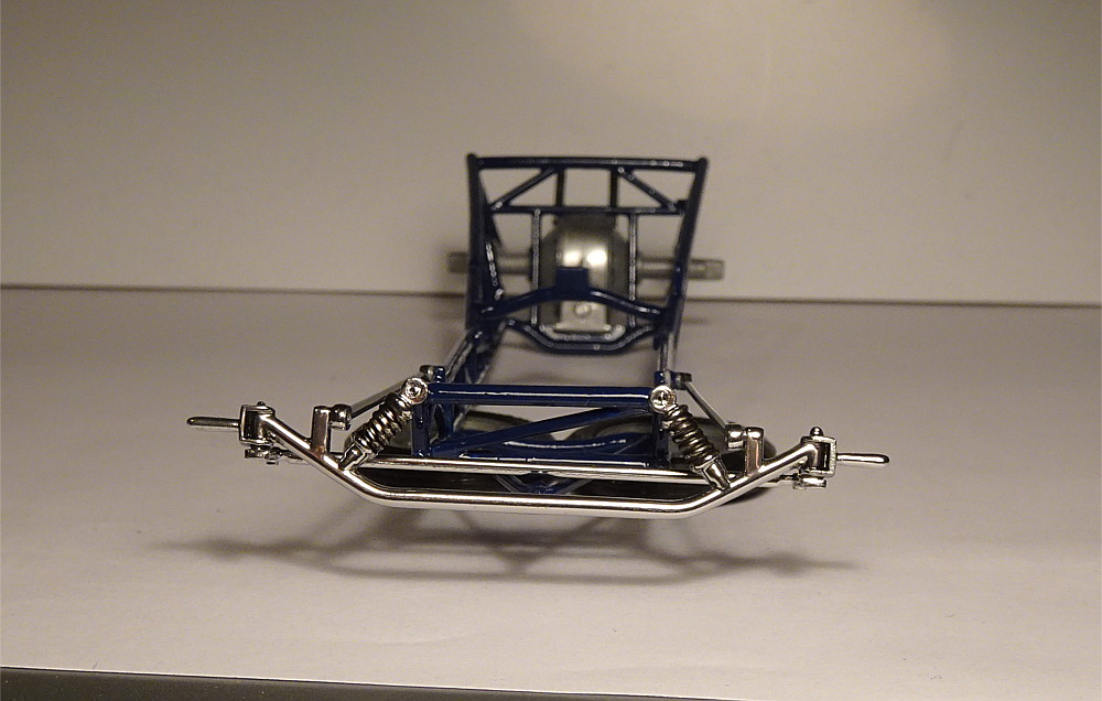

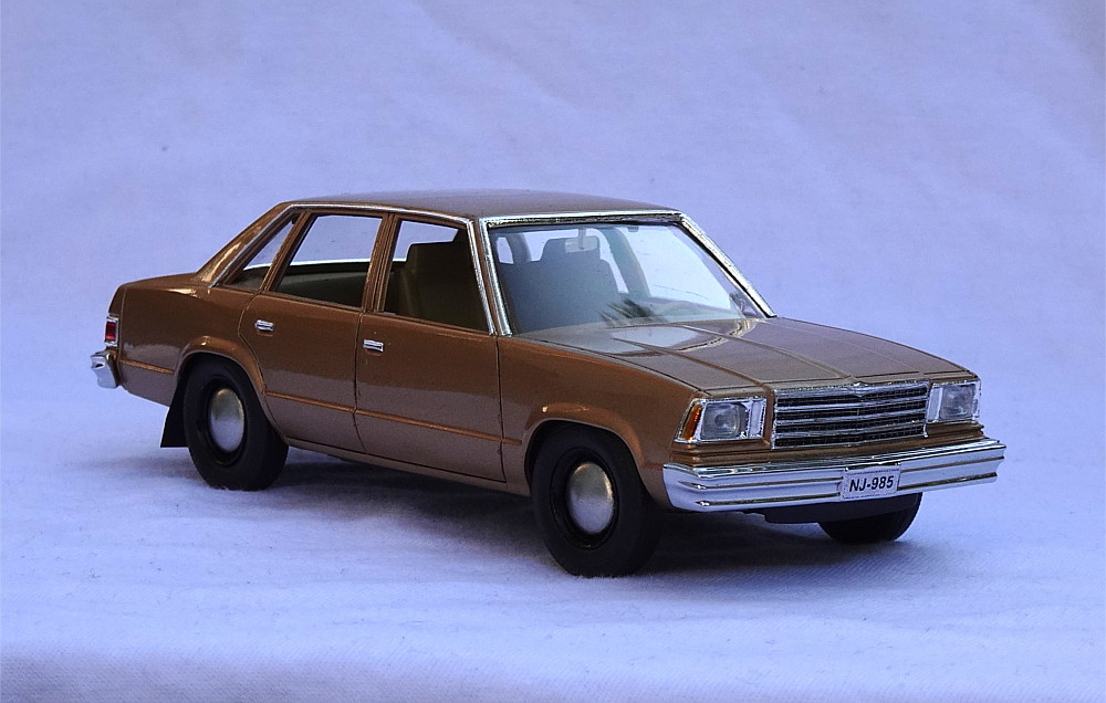

I've used Revell Chrome Spray on a few builds. When reading threads about it in the internet, I found so many different opinions regarding the durability that I wanted to try it out myself. I've used a regular automotive spray can primer and then I just shoot the chrome on top of that, so it doesn't need any kind of basecoat.
My suggestion is that let the parts dry properly before handling. After drying, let's say, for a week, it's still not very durable, but it can be handled so that you're able to install the parts. When handling the parts, I suggest wearing gloves, it helps with the durability. I've had no issues with the spray chrome myself, it's not cheap, but it gives a good chrome finish for sure.
A couple of examples with Revell Chrome Spray:
Front axle parts for Jo-Han '71 Pinto Funny Car.
Bumpers for Monogram '79 Malibu.

Just like any part, let it dry. I’ve had an issue before with a fingerprint, but, it was my fault that I handled it too soon. It’s nothing like Molotow ink, as I only use that to touch up where a chrome part was attached to a sprue. That ink doesn’t take handling too well, and I hardly use it. These stacks were handled to add black paint inside, and no problems, because they sat for 24 hrs. Also I don’t have an airbrush, so this is what I use when I need to have a part chromed. I’d like to try the Revell spray sometime, but it’s a bit out of my price range.

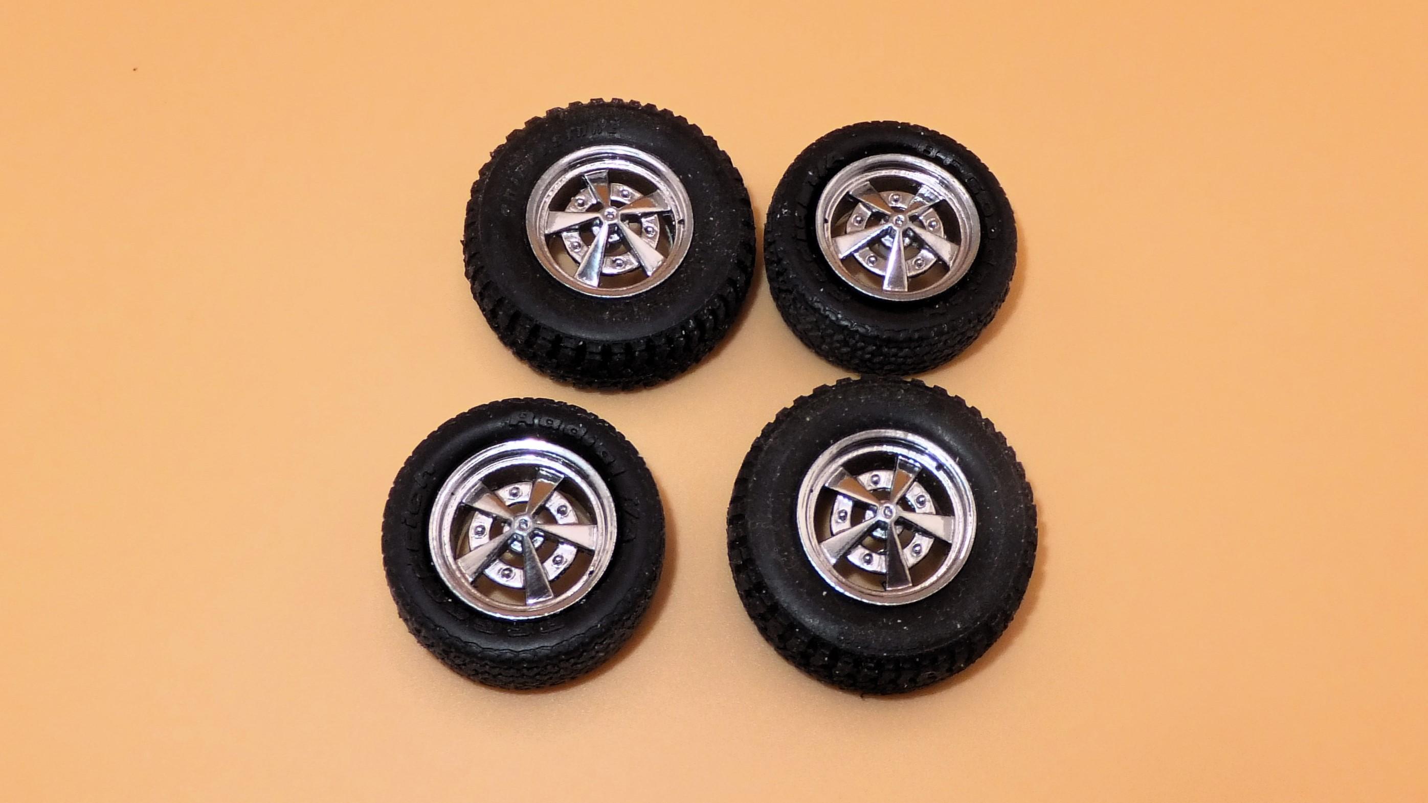

I think Revell Chrome is worth the almost $40 I paid for a can.  Easier prep than Alclad and reasonable results.  These are 3D printed wheels cleaned, primed with Mr. Surfacer 1500 Black and then Revell Chrome.  I let dry for 5 days (2 is usually enough) and it can be handled (carefully).
But everybody has their favorite and a technique that works.  The nice thing with Revell is if you have a kit chrome bumper with mold lines or other imperfections, you can fix them, clean the bumper and spray Revell over the existing chrome and repairs (Be sure the repairs are smoothed out).

This is why I find the price to be a little more acceptable. Now I'm not spending $7 bucks or so for a can of gloss black to pair with my chrome spray paint. Your 79 Malibu is beautiful, by the way.
Thanks!
And, you're correct. The no need of a basecoat makes it a little "cheaper" but it's also much more straightforward to chrome something with this stuff as it doesn't need a basecoat at all.

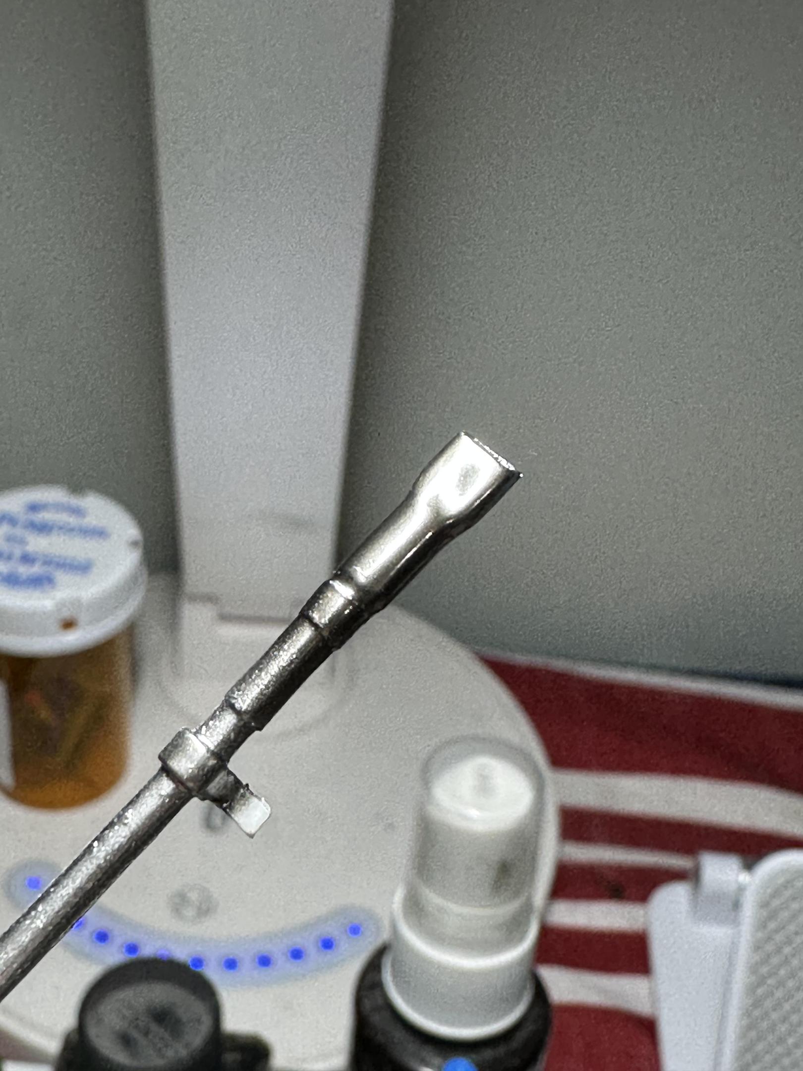

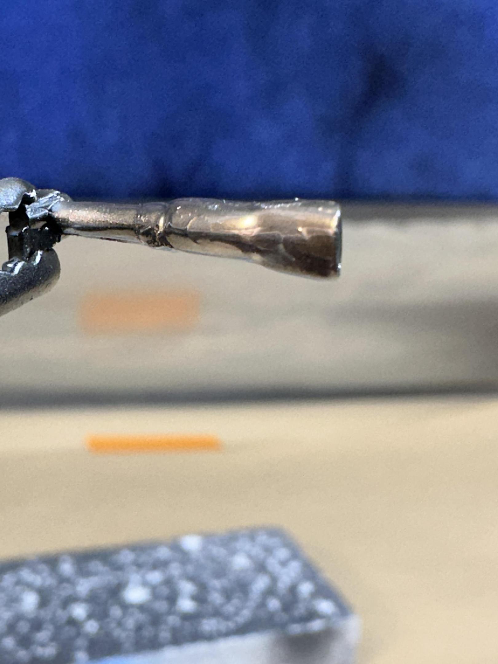

I have just bought this stuff, best stuff I have used to date, I tested it on the exhaust tip in the pic, I black based it with my Alcad black, then lightly applied the chrome on it , no clear after and rubbed it between my rough sandpaper fingers about 25 times and nothing  came off! I only let it dry for about 1/2 hour! I bought mine from bobs hobby shop and r c , guys name is Ed as his father was bob. he is the only distributor for outlaw paints as they are out of Australia
