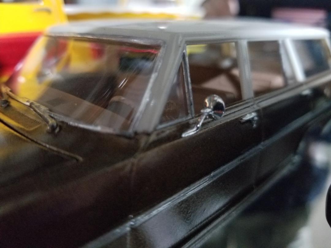

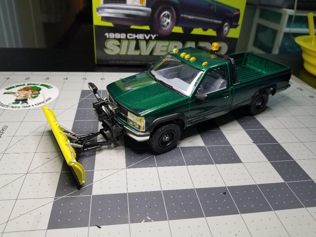

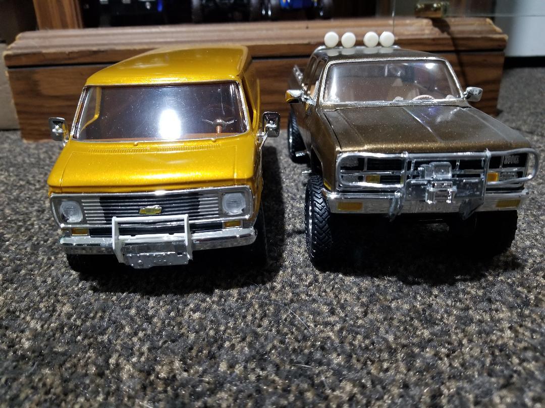

Zen Posted March 13 Posted March 13 On 3/13/2025 at 8:37 AM, WillyBilly said: I take the point of an X-acto knife and scrape a small line in the paint trying to make a shallow pocket and expose bare plastic for the part to rest where I want to attach a part. I allow the glue to touch the part to essentially get a film of glue on the part. Then with a headset, and tweezers, I attach the part on the area I scratched off holding it until it sets. Usually about 5 to 10 seconds. I have had good luck with this method. The trick is to use very little glue. You can use superglue too, but there is not time to position. I prefer model glue just to give you a little time. I scratched the paint on every single one of these models to get the part to stick. I had gotten sick of gluing it to the paint, only to have it fall off, or pop off when the wind blows. Expand And what type of glue are you using?

WillyBilly Posted March 13 Posted March 13 On 3/13/2025 at 12:33 PM, Zen said: And what type of glue are you using? Expand Just Testors.
