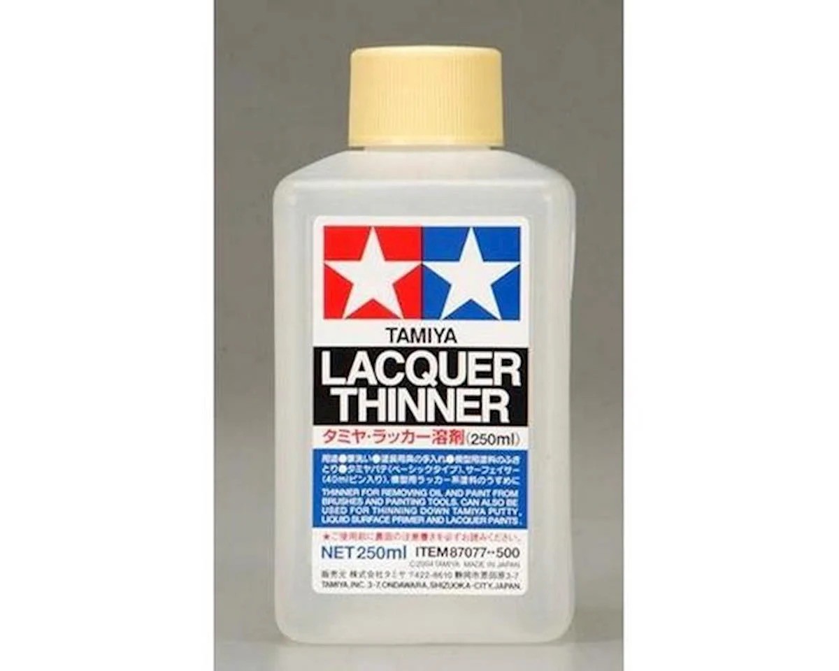

Zoom Zoom Posted May 1 Posted May 1 On 5/1/2025 at 5:43 PM, rossfox said: I think it with the Tamiya thinner and I was at 50/50 with airbrush. It sprayed on really nice. So, if it might take months to fully cure, sounds like not a good paint to work with???????????????????? Expand It's good paint to work with, with caveats. The flat colors dry faster. Tamiya developed a mild lacquer thinner for builders who wanted the acrylic paint to spray like enamels/lacquers, it was first aimed at aircraft/armor builders who use mostly matte finishes, but it works equally well to reduce the gloss acrylics and have it flow out on a model body like enamels/lacquers. Meanwhile many have found that Mr. Hobby Mr. Color Thinner/Mr. Leveling Thinner work as well (very similar to the Tamiya thinner), and I've even tried hardware store lacquer thinner to thin Tamiya acrylics and it worked well (at least for flat colors), and is good to clean out the airbrush, but using Tamiya/Mr. Hobby lacquer thinners make the paint spray smoother than hardware store lacquer thinner that tends to have a lot of acetone in it. Tamiya also makes a new range of lacquer jar paints (Tamiya LP line) for modelers, they're not as common as the acrylic colors that have been available for decades but for car modelers they are ideal for airbrush users, as good/better than their TS line of rattle can paints for those who don't airbrush. Get some of this and try it out, if you liked spraying w/the acrylic thinner you should like this better, and it'll dry faster. If you still find it too slow to cure, consider getting some jars of their LP lacquers. Great paint for beginners and experienced builders. 1

rossfox Posted May 2 Author Posted May 2 On 5/1/2025 at 9:05 PM, Zoom Zoom said: It's good paint to work with, with caveats. The flat colors dry faster. Tamiya developed a mild lacquer thinner for builders who wanted the acrylic paint to spray like enamels/lacquers, it was first aimed at aircraft/armor builders who use mostly matte finishes, but it works equally well to reduce the gloss acrylics and have it flow out on a model body like enamels/lacquers. Meanwhile many have found that Mr. Hobby Mr. Color Thinner/Mr. Leveling Thinner work as well (very similar to the Tamiya thinner), and I've even tried hardware store lacquer thinner to thin Tamiya acrylics and it worked well (at least for flat colors), and is good to clean out the airbrush, but using Tamiya/Mr. Hobby lacquer thinners make the paint spray smoother than hardware store lacquer thinner that tends to have a lot of acetone in it. Tamiya also makes a new range of lacquer jar paints (Tamiya LP line) for modelers, they're not as common as the acrylic colors that have been available for decades but for car modelers they are ideal for airbrush users, as good/better than their TS line of rattle can paints for those who don't airbrush. Get some of this and try it out, if you liked spraying w/the acrylic thinner you should like this better, and it'll dry faster. If you still find it too slow to cure, consider getting some jars of their LP lacquers. Great paint for beginners and experienced builders. Expand I was looking at the Tamiya Lacquer Paints and maybe considering switching over to them instead of Tamiya Acrylics. I did build a car last year, and used Tamiya Acrylics and seemed to have the same problem as now, with the paint seeming to be soft and easily marred one way or the other. I read some good reviews on Tamiya Lacquer Paint and it seems like they do everything the acrylics do, but better?????????
