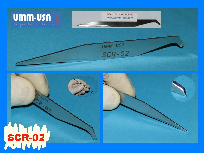

Pete J. Posted February 27, 2018 Posted February 27, 2018 I've been using this one for a long time and it's a really nice tool. For me it it easier to control and has a nice feel in the hand. There are two different sizes. This is the smaller of the two. I find the hook end is great for following curves and the straight follows a straight line very well. The hook pulls a nice curl of plastic out of panel lines The other nice thing about this tool is that it is easy to resharpen. I can get it up to a razors edge very easily. http://umm-usa.com/onlinestore/product_info.php?cPath=21_105&products_id=4798

Bainford Posted February 28, 2018 Posted February 28, 2018 23 hours ago, Pete J. said: I've been using this one for a long time and it's a really nice tool. For me it it easier to control and has a nice feel in the hand. There are two different sizes. This is the smaller of the two. I find the hook end is great for following curves and the straight follows a straight line very well. The hook pulls a nice curl of plastic out of panel lines The other nice thing about this tool is that it is easy to resharpen. I can get it up to a razors edge very easily. http://umm-usa.com/onlinestore/product_info.php?cPath=21_105&products_id=4798 Thanks for the recommendation, and the link. I just went to the site and purchased this scriber. I have few scribers already, some bought and some made, but I really like the look of this one. The site itself is a great site for tools. I never knew of this place. Cheers.
