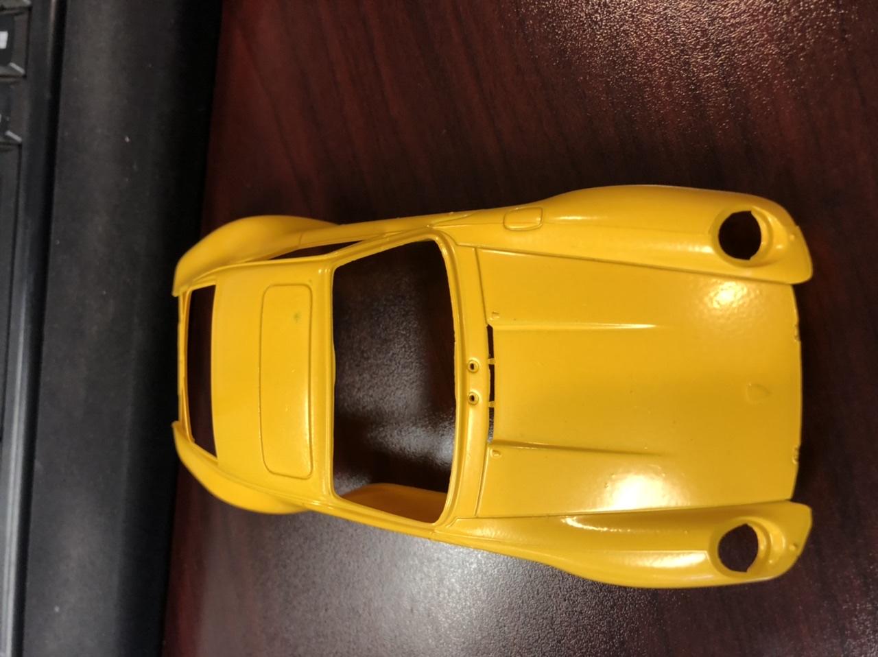

drodg Posted January 6, 2020 Posted January 6, 2020 (edited) So just bought an Italeri Porsche 993 that was started with the body painted yellow. I cannot tell if enamel or lacquer. I would assume enamel if I was guessing. So with it being painted yellow and I am changing the color to Aventurine green (dark) what luck would I have in priming the body over the yellow and not stripping the paint? The majority of the car has not been painted. Just wondering your thoughts and what is the best things to use if I strip the paint. I am guessing from the posts that EZ -off yellow can is the best ? I have never stripped paint but have used EZ Off for stripping chrome. I am going to post a picture of the body. Edited January 6, 2020 by drodg
crowe-t Posted January 6, 2020 Posted January 6, 2020 23 minutes ago, drodg said: So just bought an Italeri Porsche 993 that was started with the body painted yellow. I cannot tell if enamel or lacquer. I would assume enamel if I was guessing. So with it being painted yellow and I am changing the color to Aventurine green (dark) what luck would I have in priming the body over the yellow and not stripping the paint? The majority of the car has not been painted. Just wondering your thoughts and what is the best things to use if I strip the paint. I am guessing from the posts that EZ -off yellow can is the best ? I have never stripped paint but have used EZ Off for stripping chrome. I am going to post a picture of the body. I'm not sure priming over the yellow and then painting will work out so well especially since you don't know what type of paint the yellow is. The EZ Off Yellow can is better for removing paint although I have used the EZ Off Blue can with no problems. However I mostly use 91% Isopropyl Alcohol for stripping paint. It's much safer to be around. If you use the EZ Off wear gloves. It's burns the skin.
drodg Posted January 6, 2020 Posted January 6, 2020 6 minutes ago, crowe-t said: I'm not sure priming over the yellow and then painting will work out so well especially since you don't know what type of paint the yellow is. The EZ Off Yellow can is better for removing paint although I have used the EZ Off Blue can with no problems. However I mostly use 91% Isopropyl Alcohol for stripping paint. It's much safer to be around. If you use the EZ Off wear gloves. It's burns the skin. So I have read also about Simple Green which I also have at home but have again never used it for anything but cleaning cement. Weird that I wouldn't think it would work at removing paint.
Ace-Garageguy Posted January 6, 2020 Posted January 6, 2020 (edited) 1) Painting over what's there without knowing exactly WHAT it is is nothing but a recipe for disaster. 2) Whoever "painted" the poor thing didn't bother to remove the mold parting lines from the fenders. Painting over that is just sloppy and childish. Trying to sand out the parting lines with the thing still painted yellow is just begging for wrinkling and lifting on the feather-edges. 3) Different "strippers" work on different paints. Easy Off works great on rattle can enamel. Like the man said, wear disposable gloves. You should have some in stock for painting anyway, and they're only $5 for 50 or 100 at the grocery store or pharmacy. Wear eye protection too. And after you spray the model, put in in a big ziplock bag so the stuff can work without drying out. I usually put the whole bag under warm water, too. EasyOff works MUCH better warm. It often helps to spray more stuff in the bag after a while. After the paint s loose, scrub the body with a toothbrush and some abrasive cleanser like Comet. This will remove the stripper residue, and it gets into all the little nooks and crannies. It also scuffs the surface nicely for excellent primer adhesion. 91% isopropyl alcohol works on most factory and many rattlecan lacquers, but not so hot on other paints. You need enough to soak the body, sometimes for hours. Brake fluid works...sometimes...on stuff the first two won't touch. Brake fluid can also cause extreme brittleness on some plastics. I've taken parts out of brake fluid and watched them crumble while I was finish-cleaning them. ETC. 4) Experiment to see what works best on your yellow mess. Edited January 6, 2020 by Ace-Garageguy

Snake45 Posted January 6, 2020 Posted January 6, 2020 29 minutes ago, drodg said: How many days with the EZ Off in a bag? Thanks again Easy Off does its best work in the first 20-30 minutes. Then hit it with an old toothbrush under warm running water. If NO paint at all comes off, you can forget EO, as it will never work on that paint. Repeat as necessary. It can take 4 or 5 or more treatments to get all the paint off, but it can be done in one afternoon. It's much easier to toss the body in a sealable Tupperware thing full of Super Clean, which is actually the same chemical as EO (lye). Let it soak 24 hours, come back and wash it off with the old toothbrush under warm running water. No muss, no fuss. This treatment will take 95%+ of the paint off in one shot, if it's gonna work at all. If nothing happens, time to move on to some other chemical. 1
