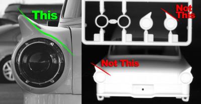

Sledsel Posted March 8, 2015 Share Posted March 8, 2015 Sorry, was not on for a bit... I read that people feel the sedan it is dead on... wrong.... There is a 1:1 57 in my dads garage and the kit is far from accurate. Here are my major issues with this kit. the front wheel body line (bulges out instead of concave behind the tire), front valance (should wrap around the side to wheel well) front fender issue, (fender should not extend below the grill), rear quarter body lines (upper body line should extend almost to the rear bumper, lower is supposed concave, the kit looks like it was merely gouged out and does not extend back far enough) the front bumper is too short, should extend to wheel well) and the speaker cover on the dash should be flush, not sticking up a scale inch. Compare your kit body to some of the pics on here. Link to comment Share on other sites More sharing options...
Ace-Garageguy Posted March 8, 2015 Share Posted March 8, 2015 Sledsel, thanks for clearing up what the major specific inaccuracies are on the Revell '57 Ford body. I haven't built any of mine yet, or looked at them very critically yet either, but I'll be comparing online shots now with the models. Sounds like the major fixes won't be too difficult if someone wants to go to the extra effort. Still, it would sure be nice if stuff like this got caught BEFORE the models were on the shelves in sealed boxes. Link to comment Share on other sites More sharing options...
Sledsel Posted March 8, 2015 Share Posted March 8, 2015 (edited) Oh, I wrote a very lengthy email to Revell about it. The 57 Ford and 49 Mercs are my favorite cars and both their kits were unacceptable to me. The Merc I tossed the body in the trash after cutting out the quarter glass and removing the headlight bezels. I'm using an AMT body I chopped myself on the Revell chassis. As for the 57, after seeing builds online, I did not even purchase it. The problems stood out so strongly in my eye. I'll get a Modelhaus resin body instead. Ace, pay attention to where the shadows are on the body lines.... big help Edited March 8, 2015 by Sledsel Link to comment Share on other sites More sharing options...
Guest Posted March 8, 2015 Share Posted March 8, 2015 Besides the inaccuracies Andy has pointed out on the body, this is what kills the 300 sedan kit for me. More than likely, they will also be transferred to this Ranch Wagon as well. Revell seriously needs to abandon molding the inner wheel wells with the floor pans! Here's proof. Notice in this photo how they extended the floor pan far out into the inner wheel well just so they could mold the inner wheel wells to it. The body mount on the chassis is also too far forward (at least 4-5 mms). It should be just in front of the bottom of the firewall. View from the side showing how far it extends into the inner wheel well. Then, there's this problem. The inner wheel wells are also too low. This photo is the body resting on a set of tires. It makes lowering the front of the model impossible without making major modifications to the inner wheel wells. It's wrong even for a stock build as it would allow almost zero suspension travel. I also marked the areas on the body that need to be corrected and blacked out the bulge in the wheel well. I'll still buy the Ranch Wagon only because I want one badly. But, I'm sure not looking forward to fixing the chassis, firewall and wheel wells. Maybe I'll just build it curbside like I plan to with this 300 sedan. Sometimes, the effort it takes to correct a kit just isn't worth it. Link to comment Share on other sites More sharing options...
John Goschke Posted March 8, 2015 Share Posted March 8, 2015 (edited) Sorry, was not on for a bit... I read that people feel the sedan it is dead on... wrong.... There is a 1:1 57 in my dads garage and the kit is far from accurate. Here are my major issues with this kit. the front wheel body line (bulges out instead of concave behind the tire), front valance (should wrap around the side to wheel well) front fender issue, (fender should not extend below the grill), rear quarter body lines (upper body line should extend almost to the rear bumper, lower is supposed concave, the kit looks like it was merely gouged out and does not extend back far enough) the front bumper is too short, should extend to wheel well) and the speaker cover on the dash should be flush, not sticking up a scale inch. Compare your kit body to some of the pics on here. Don't forget the top inside surface of the fins, too. (click to embiggen!) Get out your needle files, ladies! Edited March 8, 2015 by John Goschke Link to comment Share on other sites More sharing options...

John Goschke Posted March 8, 2015 Share Posted March 8, 2015 And how big is the dip at 1/25th scale. Not a question just a point. Larger than a straight line. Link to comment Share on other sites More sharing options...

John Goschke Posted March 8, 2015 Share Posted March 8, 2015 (edited) The thing I feel I should say about the Revell kit is the much better interpretation of the '57 Custom/Custom 300 Tudor roofline than that on the old '57 Custom 300 promo tool that Modelhaus had issued in resin. The new Ranch Wagon looks to be just as nice with regard to the shape of the roof and windows, etc. Those features when done well contribute more to capturing the character of a car in a model than anything else. The weak modeling of the features around the wheel openings I can live with (Having long tolerated different, but equally troublesome weaknesses in my favorite kit, the AMT '58 Ford). I'll fix the taillight issue! Edited March 8, 2015 by John Goschke Link to comment Share on other sites More sharing options...
