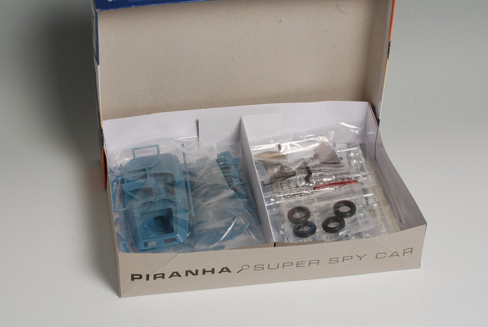

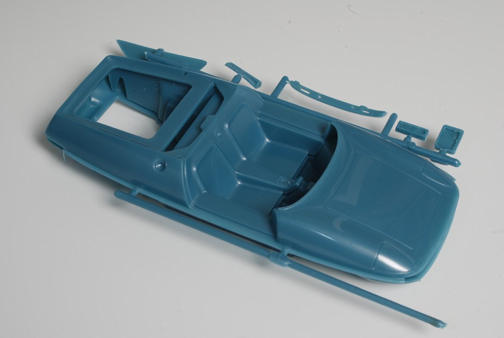

Someone tell us about that blue plastic. Is it metallic? Is it suitable for polishing out, or does it have swirl marks and so forth?
Richard....according to John G at Round 2, they added a bit of pearl to the plastic to repicate the color of the real car. The effect is there, but very subtle.
I just checked my kit...there is only one swirl mark, across the upper rear quarter panel on the driver's side.
Hope that helps....TIM
Round 2 AMT Piranha first look
Link to comment
I started on one last night, and I can say this one will be a challenge to get it to my standard. It can be done, but this one is not a walk in the park. There is quite a bit of flash all over it, so I have spent a lot of time removing ti, and fitting the doors and hatch, and I cannot accept the swirl in the rear fender, but I love the colot, so I have to paint it anyway. I am not too mad though, as I realize that this is an old tool, and just to have it is a blessing. I want to do the U.N.C.L.E. car, as I am a big fan of the show. There is not a lot of reference material, but I think I have enough to give it a go.
