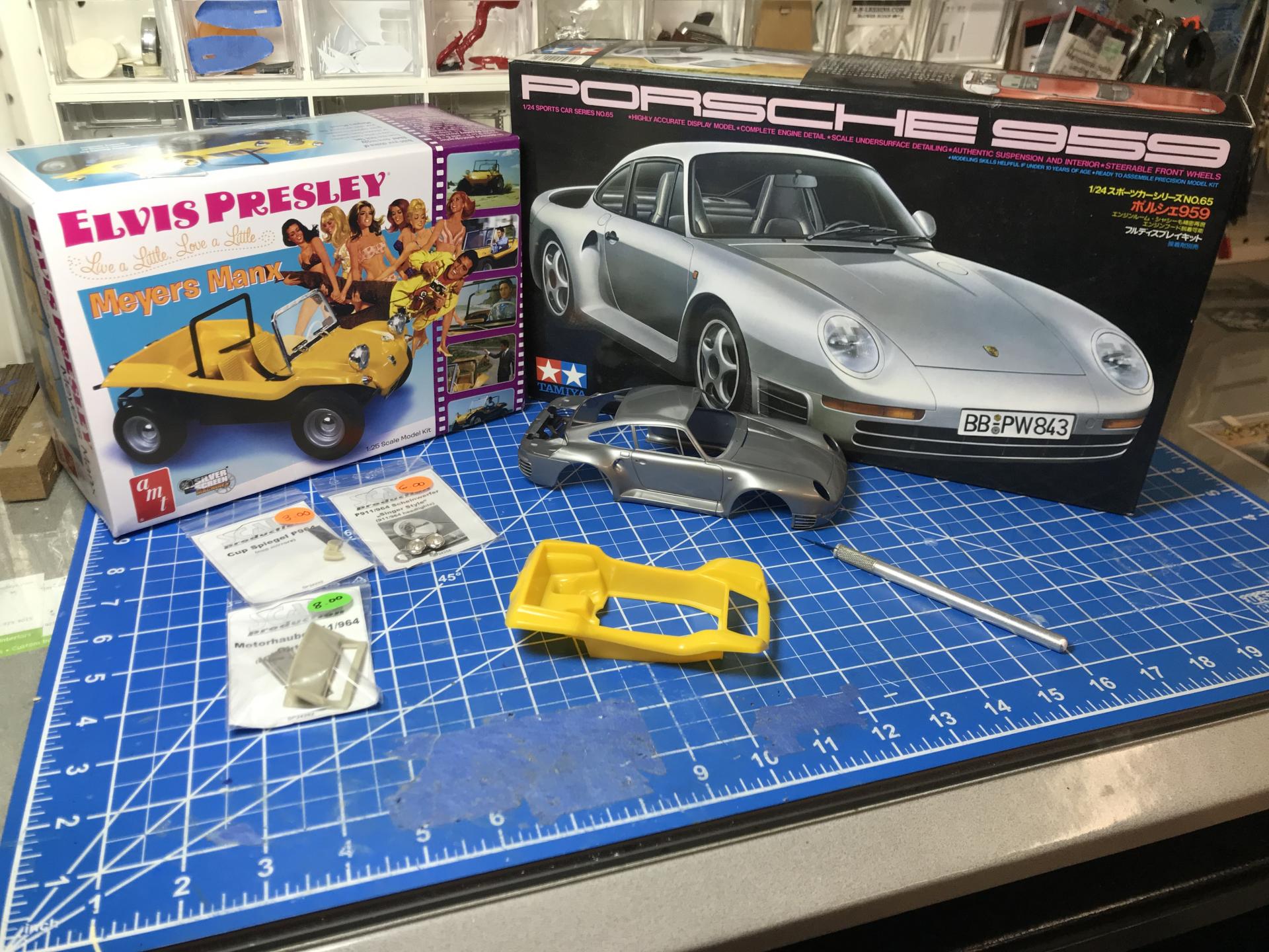

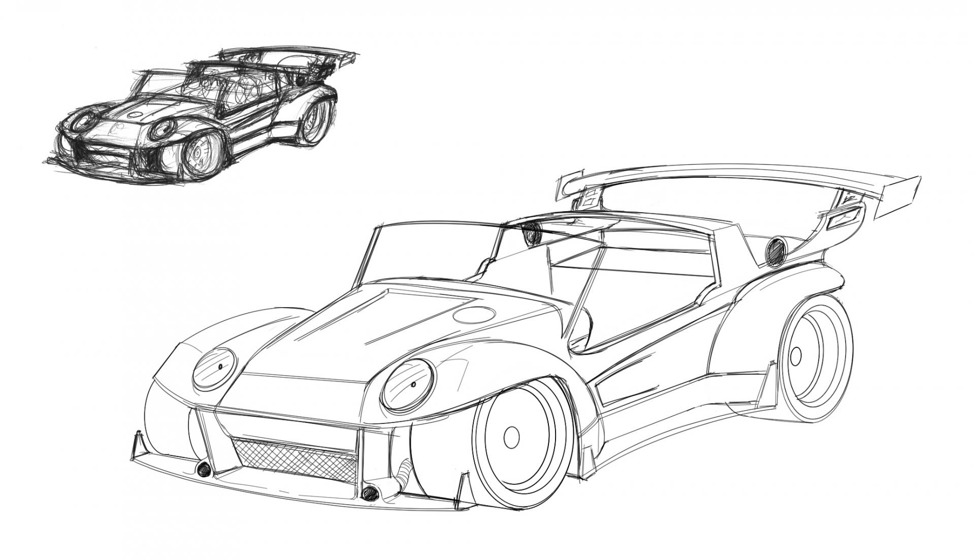

Twokidsnosleep Posted July 8, 2019 Share Posted July 8, 2019 On May 29, 2019 at 10:25 AM, Impalow said: So here is a fun project that came to me on the drive to NNL East this year.... You know Rauh welt Begriff? the guy that is building crazy wide body Porsche's? https://rauhwelt-usa.com/roughworld/ What if he got a hold of a Meyers Manx? I mean a Porsche is basically a Volkswagen, and a Manx is a Volkswagen so therefore a Manx is a Porsche... I started this fantasy build by working up a quick concept sketch... that i then cleaned up a bit. Then it was time to figure out what kits I needed... I picked up an Elvis Manx kit and some Scale Production pieces at NNL East. I had this 959 kit laying around i bought for basically just the tires, seemed like a good donor. Holy molars!!! Loving the imagination and talent here Definitely have my attention Quote Link to comment Share on other sites More sharing options...

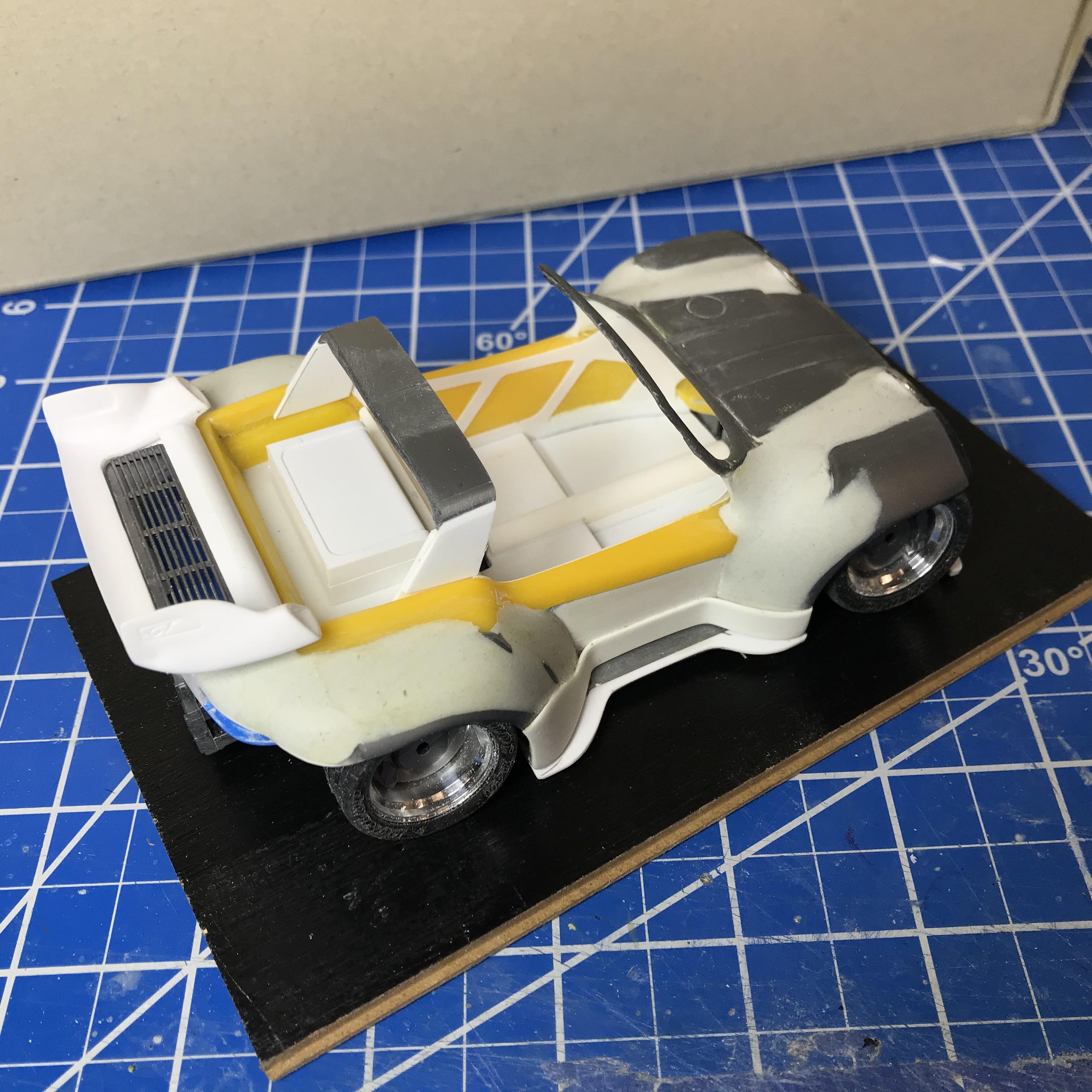

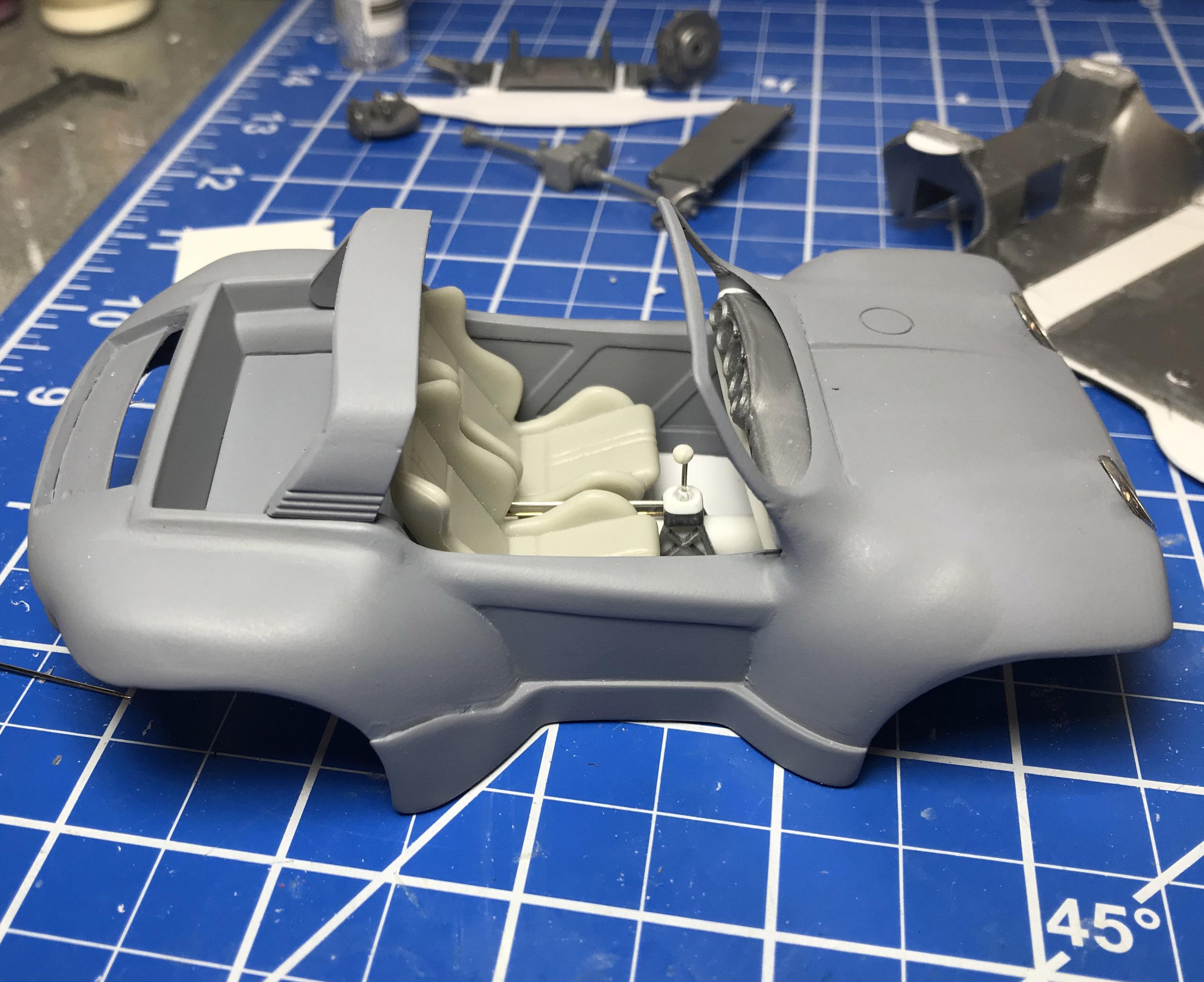

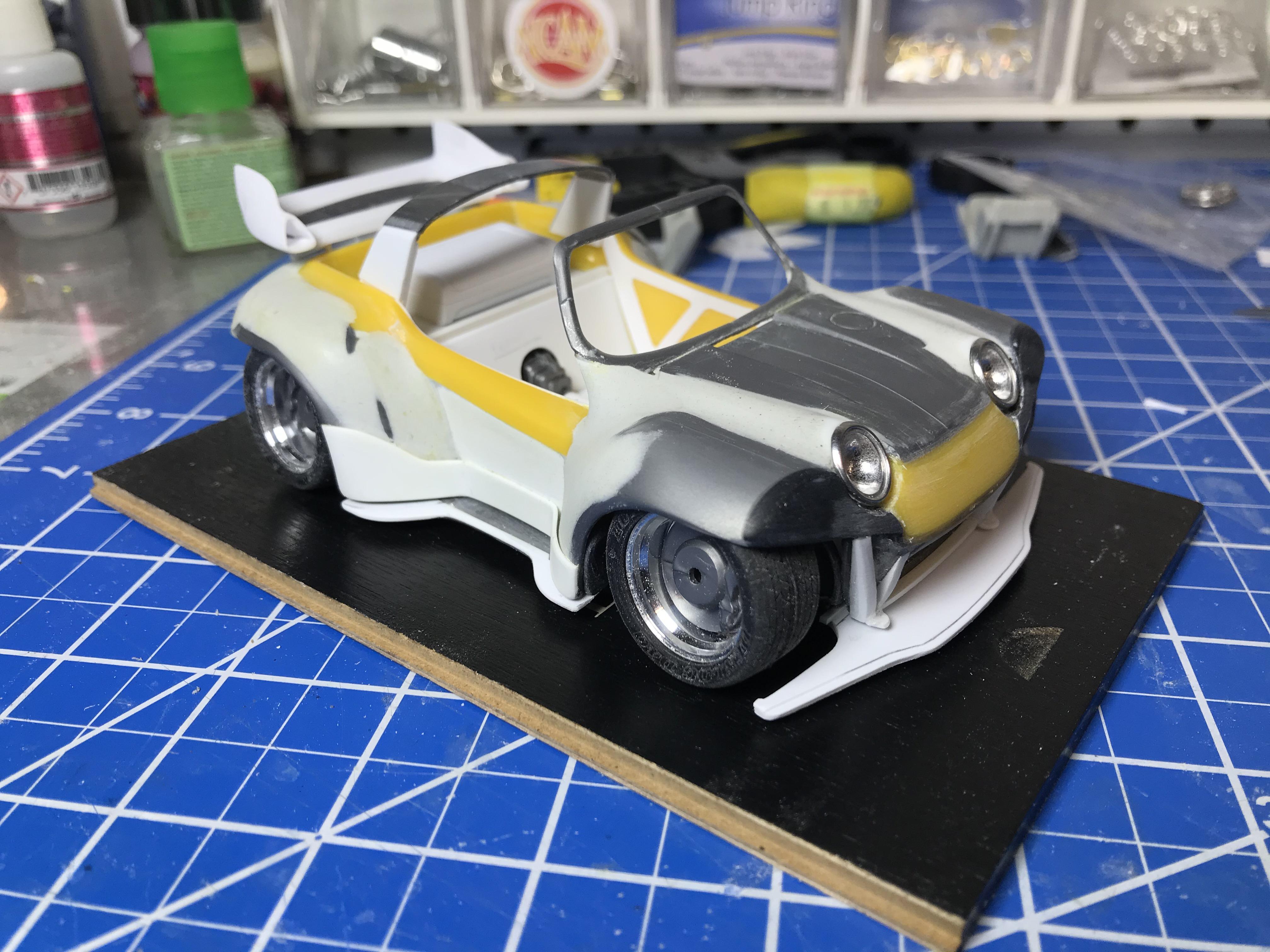

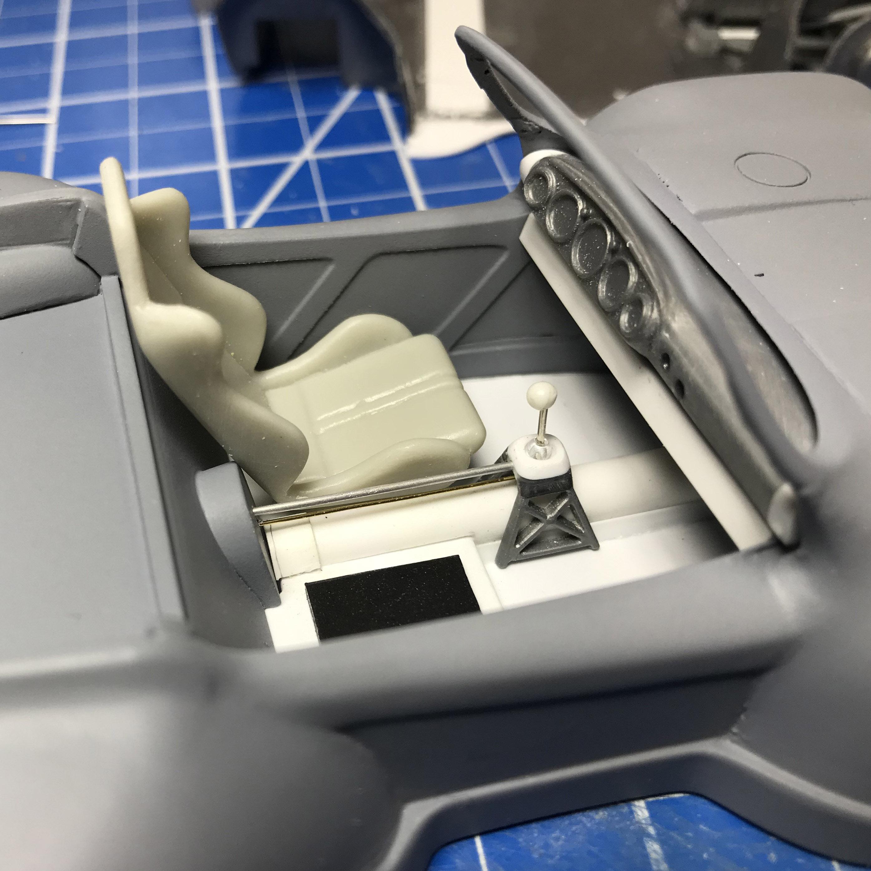

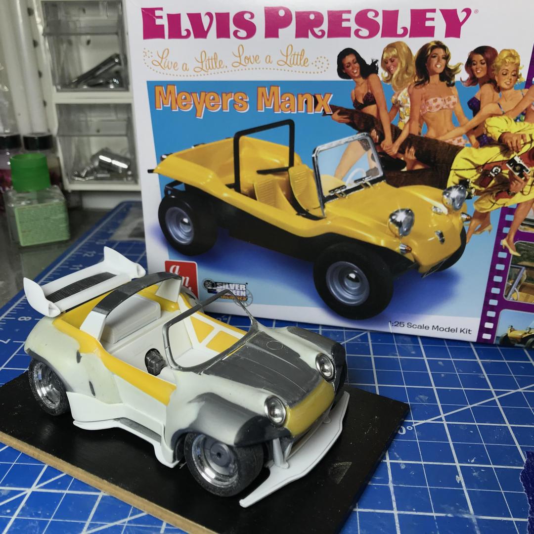

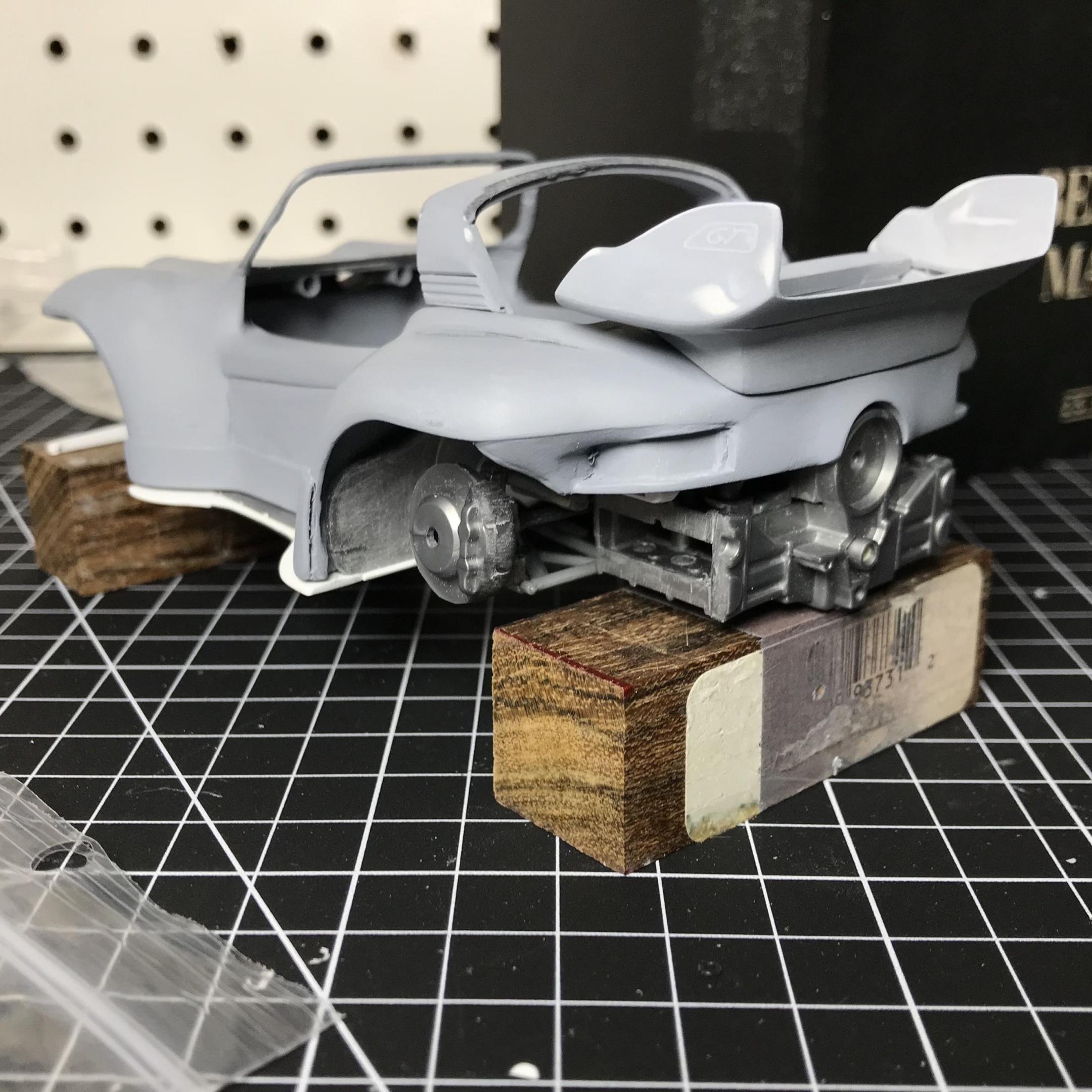

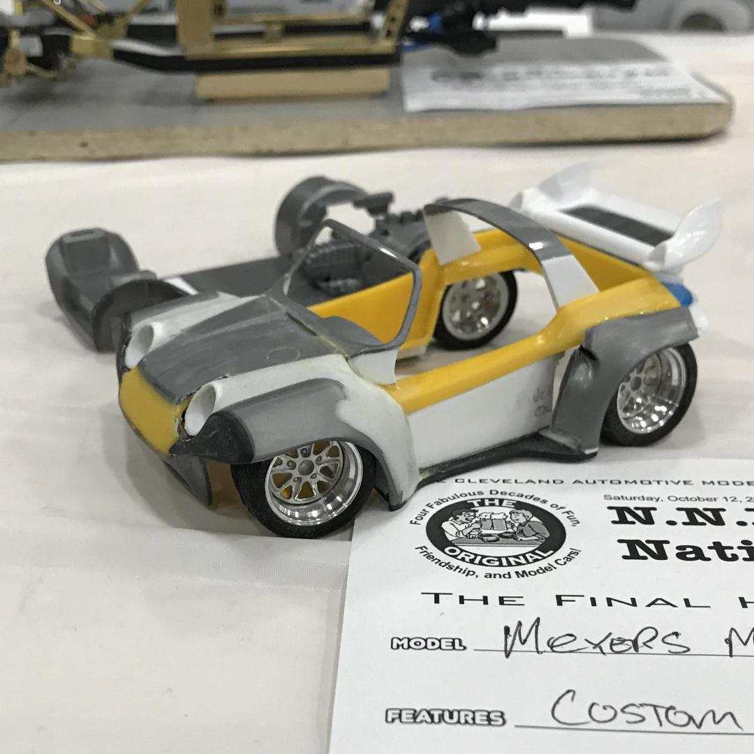

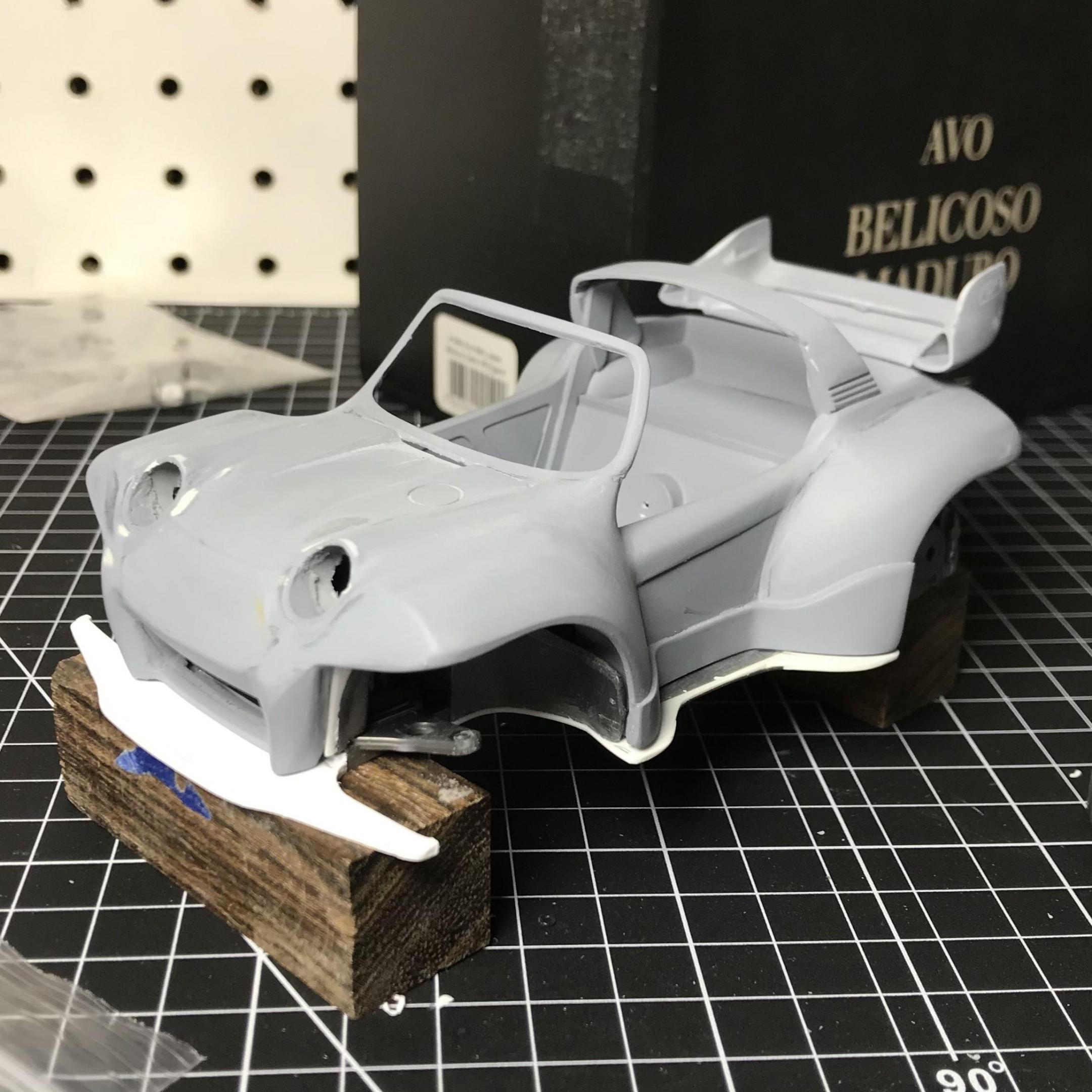

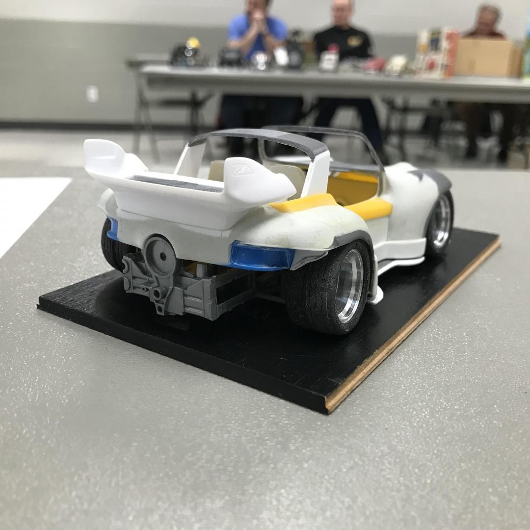

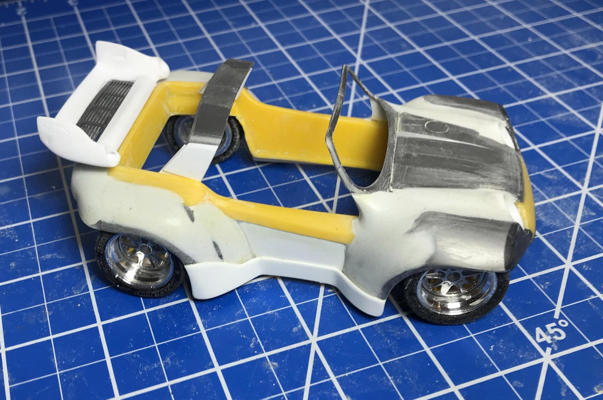

Impalow Posted December 17, 2019 Author Share Posted December 17, 2019 (edited) So I haven't logged in here for quite awhile... like almost 6months(yikes), but I have been working on this project off and on. Hopefully I can keep some momentum on this one for awhile... I would like to at least have something fresh completed for next years show season. Here are some updates from the past few months! This is how it looked at the Final Toledo NNL if anyone saw it there... I shrunk the 959 windshield down, molded it in and built a targa bar... The Heller 934 sacrificed its dash, and I got that wing to fit much better. After Toledo I had a fit of motivation, and knocked out the next round of filler and molding. Then it got pretty crazy, working on the front end to make it less "smiley", making the chassis and suspension actually fit, correcting (ruining) the ride height and working out the aero items. I also scratch-built the interior pan, and used my silhouette cutter to make some side panel detail and a tiny piece of luggage. Last night i was able to shoot some primer on it, and check out how questionable my rough body work was..... and it is quite questionable... however it looks like it should be salvageable with some time and effort. I also scratch-built an exposed shift mechanism using a couple of ferrari testarossa a-arms and some beads and pins. Edited December 17, 2019 by Impalow Quote Link to comment Share on other sites More sharing options...

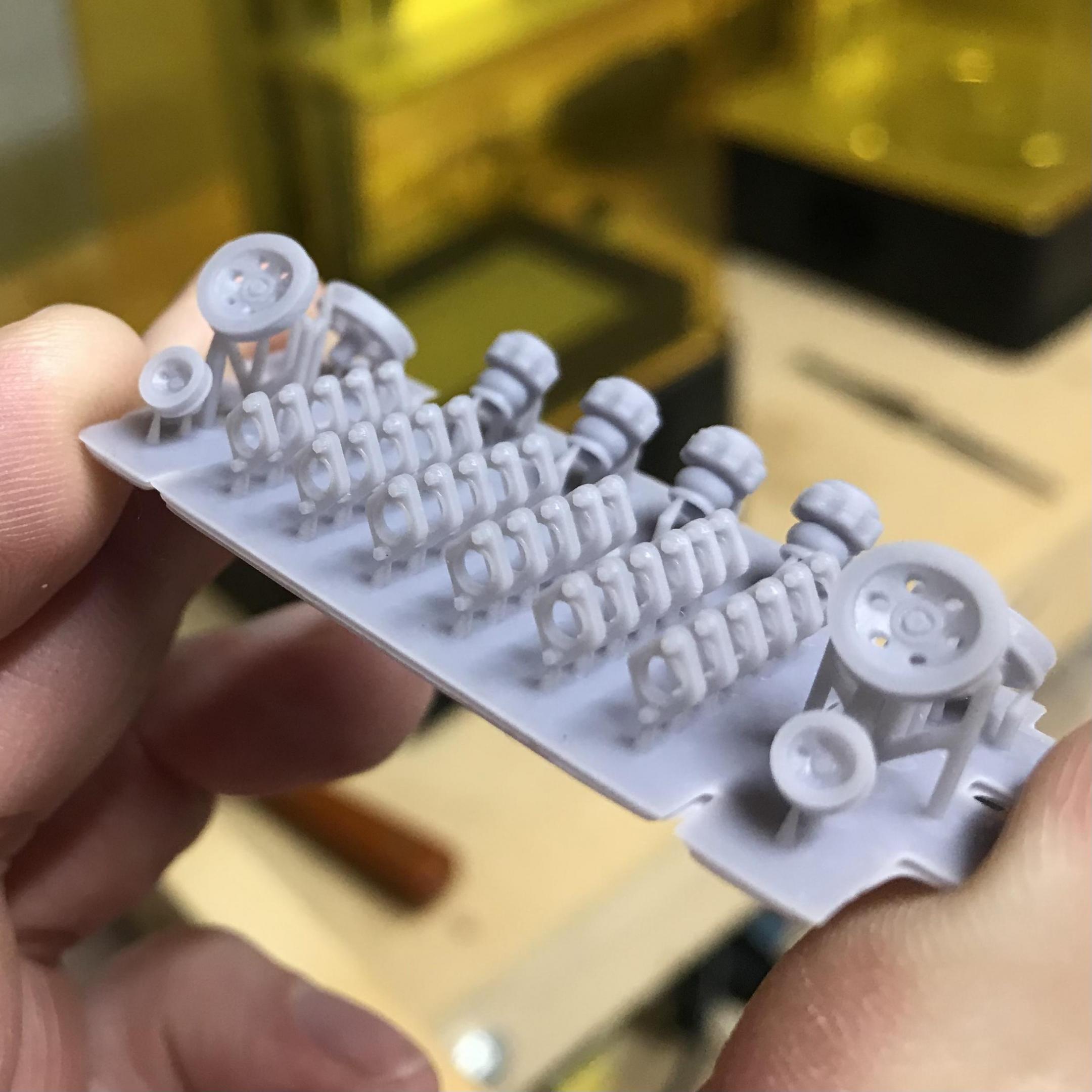

Impalow Posted December 15, 2020 Author Share Posted December 15, 2020 Thanks guys! Remember this thing? Well I got distracted for awhile but its back on the bench. Santa Eric brought me a New AnyCubic Resin 3d printer, so it helped me over the hump with a couple things on this.. I never really liked the tread pattern on the Tamiya 959 tires, so I modeled up some Yokohama Advan Neovas at the same size, then the signature air cooled Porsche fan had the pesky belt molded in over the fins, and finally I downloaded a Turbocharger model from Thingverse then mirror imaged it...so I can scratch build a symmetrical system. Literally the first prints off the printer, and I still have a lot to learn... But so far im quite happy with the results! Quote Link to comment Share on other sites More sharing options...
Mattilacken Posted December 15, 2020 Share Posted December 15, 2020 Awesome project! Great execution! 3D printed parts looks good! What material is that? Quote Link to comment Share on other sites More sharing options...
CabDriver Posted December 15, 2020 Share Posted December 15, 2020 Those 3D printed parts look great! I've been casually looking at one of these...did you have to buy something to cure the resin or does it set up ok without UV light? Think of the crazy frames you'll be able to make with that thing! Quote Link to comment Share on other sites More sharing options...

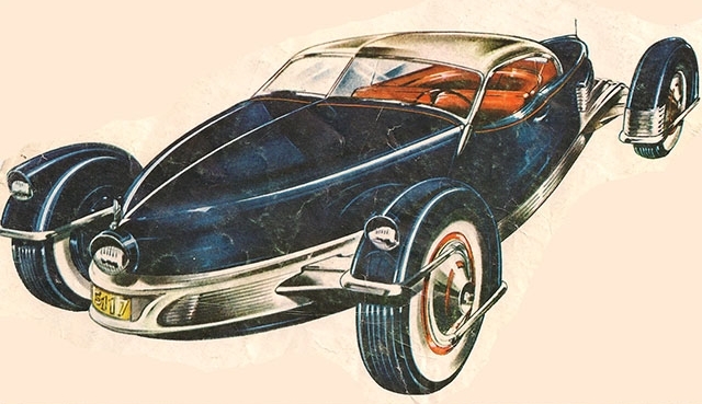

Impalow Posted December 15, 2020 Author Share Posted December 15, 2020 (edited) Thanks guys! I'm really excited about the possibilities with the printer... my goal is a future build with hardly any kit parts, of a car that was loosely designed but never built .... the Tucker Carioca... Between that and my Dad building a 1:12th scale replica of my 1:1 LS-Datsun Z this printer should technically pay for itself over ordering Shapeways prints. 27 minutes ago, CabDriver said: did you have to buy something to cure the resin or does it set up ok without UV light? I bought the package set with the wash/cure station... It makes the workflow easier and cleaner, although I can see its still pretty easy to make a big mess... I think the parts need a final cure of some sort, I know guys just set things out in the sun.. but winter in ohio, the sun is missing. This setup seems more control-able, however I am only one night into it... I did make more usable parts in one night than I did the entire time I had the FDM printer I bought for the same price in 2015.. ? Im already thrilled with it! Edited December 15, 2020 by Impalow Quote Link to comment Share on other sites More sharing options...

Impalow Posted December 15, 2020 Author Share Posted December 15, 2020 Thanks guys!! 2 hours ago, Mattilacken said: Awesome project! Great execution! 3D printed parts looks good! What material is that? Hey Anton! sorry your question got lost in there! Its a water washable UV cured resin from elegoo! Quote Link to comment Share on other sites More sharing options...

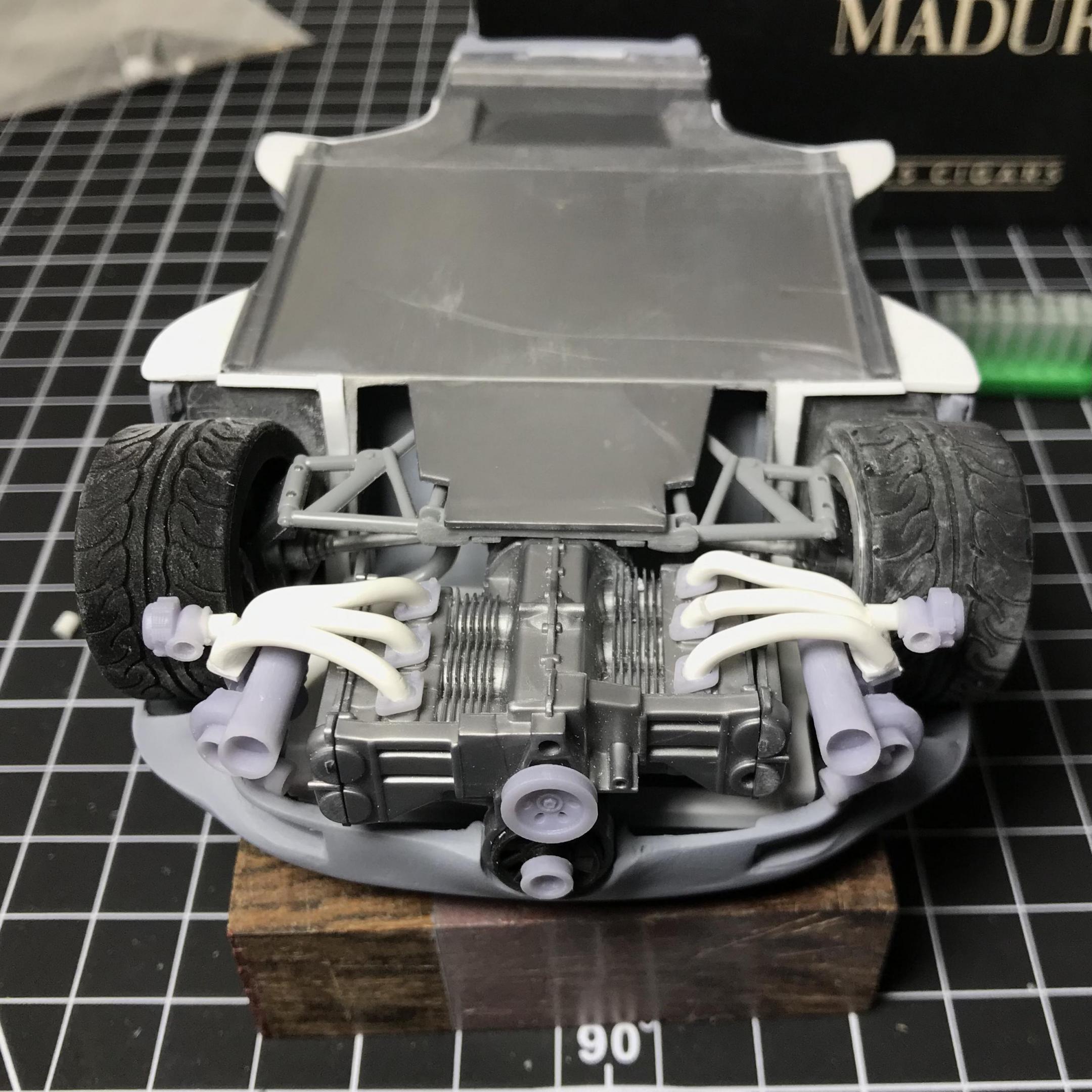

Impalow Posted December 28, 2020 Author Share Posted December 28, 2020 Thanks guys!! Been making some progress on the turbo system... quite inefficient in real life, but it looks cool.. hahaha! all the bluish-grey pieces are off the new 3D printer! Quote Link to comment Share on other sites More sharing options...
Impalow Posted December 28, 2020 Author Share Posted December 28, 2020 The best experiment so far are these 3d printed exhaust flanges... look way better than the photoetched options in my opinion, also way easier to work with.. Quote Link to comment Share on other sites More sharing options...
