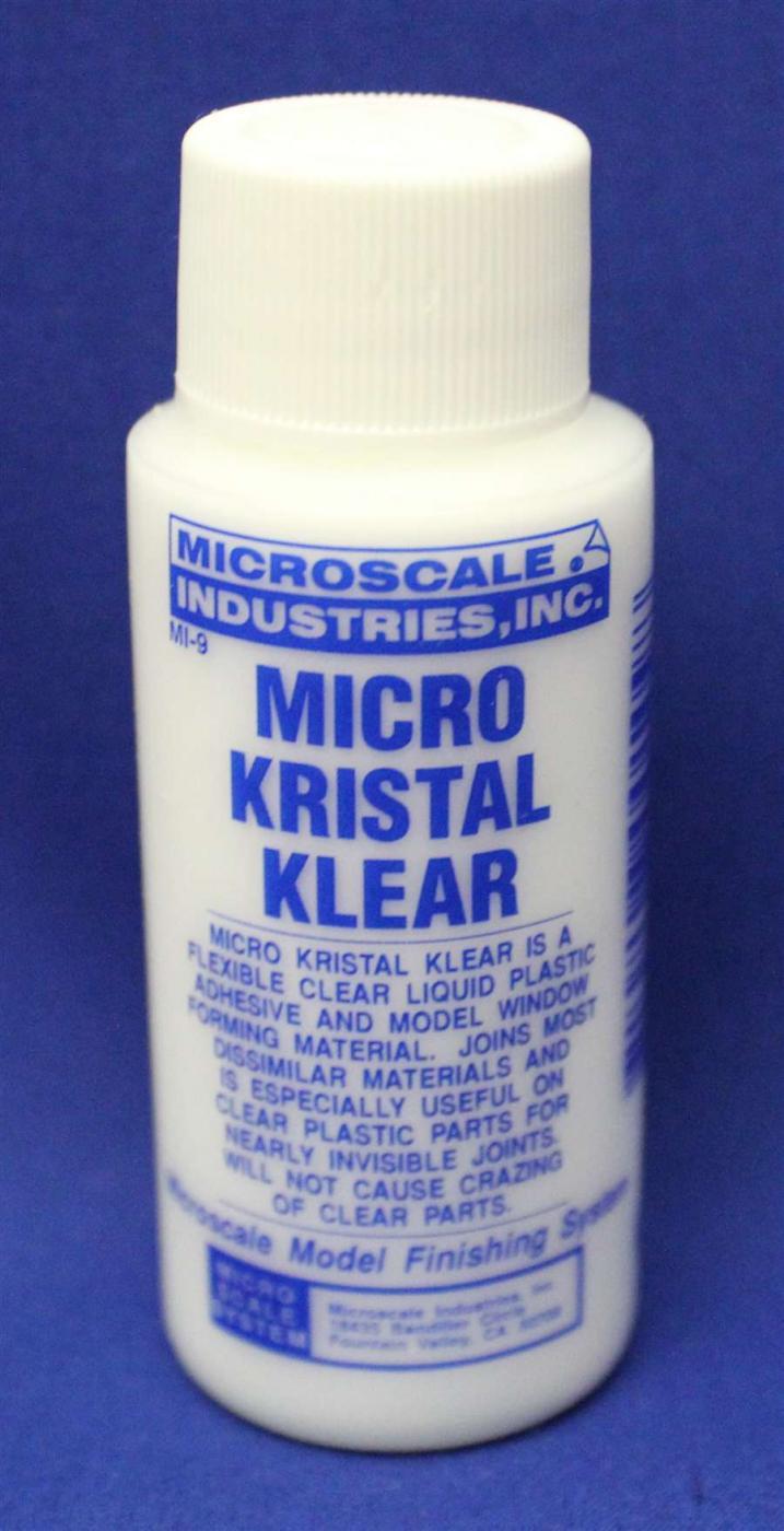

Either of the above two products are made for affixing clear glass and work well. The Evergreen product is sold at Hobby Lobby.
This Is clear double sided tape I got at Michaels. This also works well on glass either by itself or in combination with above glues. I’ve secured glass in place with tape along stop and bottom edges, then filled in the remaining seams with glue
