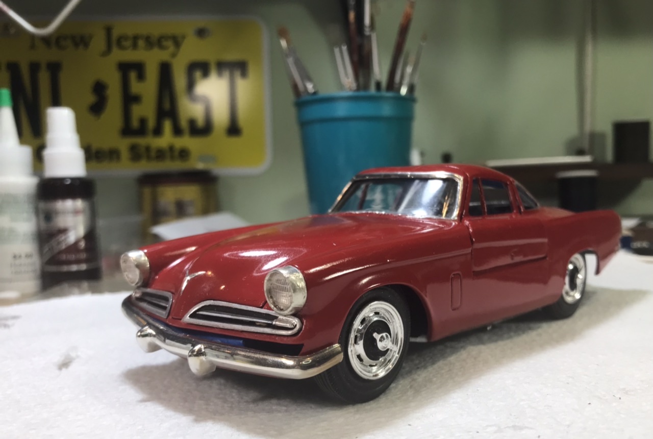

Tom Geiger Posted September 4, 2021 Share Posted September 4, 2021 On 9/2/2021 at 1:14 PM, mr moto said: Duplicolor primer is so good that there's no reason to try the paint over something else. I use their primer under everything. Bingo! Check Ollie’s hardware dept when you go hunting for models. They often have Duplicolor, both primers and colors for $2.99 a can. This is Duplicolor Cherry Red over Duplicolor red primer. No polish or clear coat. Once you master using it you’ll never use Krylon again. 1 Quote Link to comment Share on other sites More sharing options...

Tom Geiger Posted September 4, 2021 Share Posted September 4, 2021 2 hours ago, bluestringer said: I was in our local Ollie's just this past Wednesday looking for models, they had 0. Didn't even think to look at their paint. Thanks, I'll check them out next time. That red does look good. There is a learning curve with Duplicolor colors.. a bit like painting with a fire hose. Bit when you think you put on too much. It shrinks down and settles nicely! Quote Link to comment Share on other sites More sharing options...
