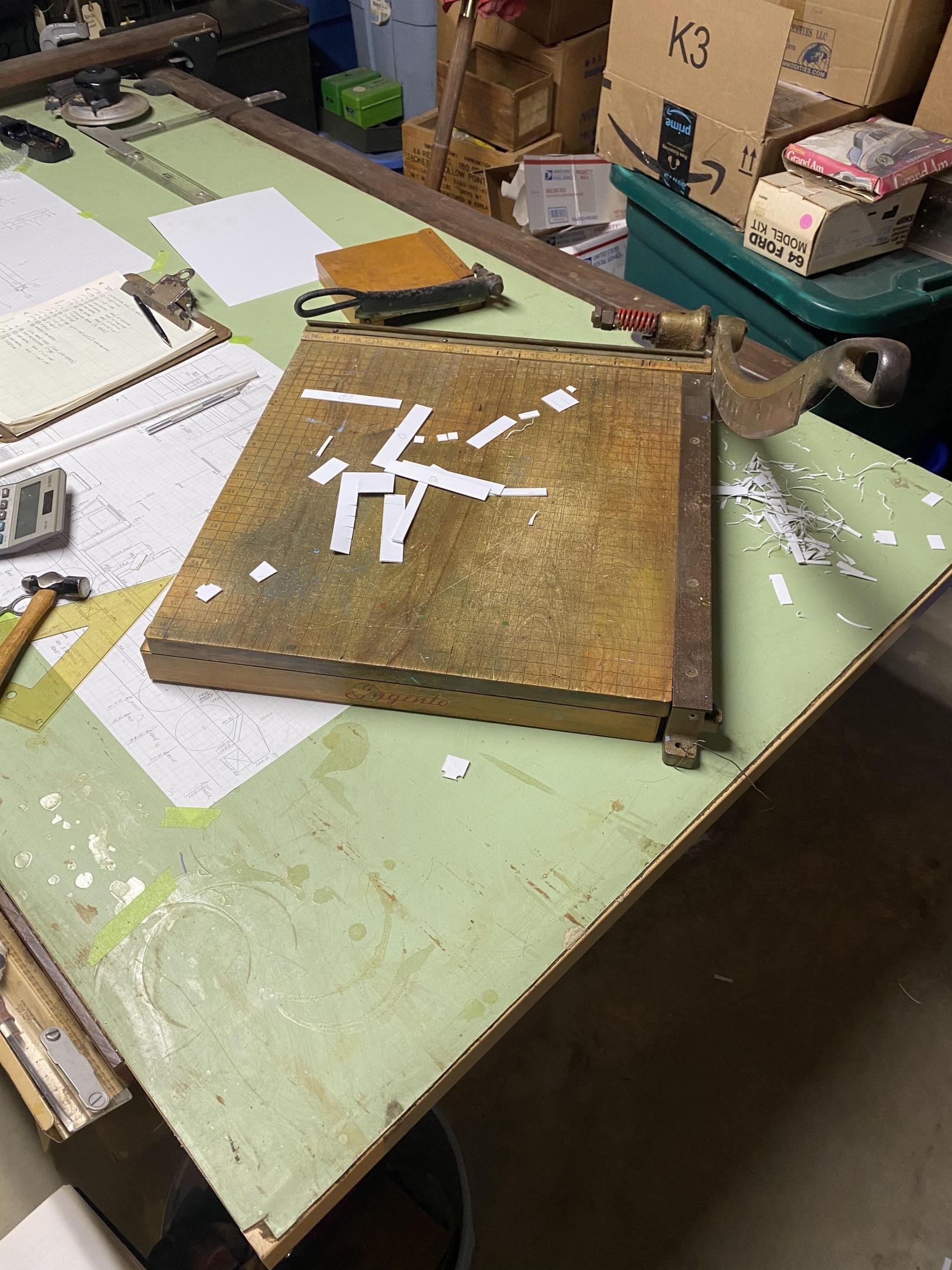

Cutting Sheet Stock Accurately & Easy

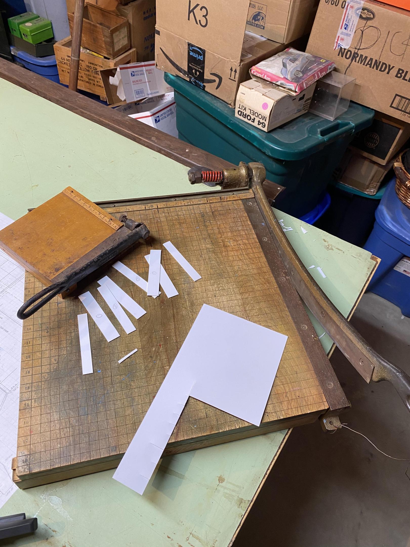

Many most likely have one already, but I just added these to my bench when I started the Link Belt HC-218 crane that is in the large trucks WIP section.  Found these at an antique shop.  One is a small size and the other is huge.  These paper cutters are sharp, quick, and accurate and are easy to cut multiple quantities of the same size piece. I had a newly made one but it could hardly handle three sheets of paper.  These old timers can cut 1/8” of plastic sheet without batting an eyeball! What a time saver!

That is a nice heavy duty cutter. They sure don't make them like this anymore.  Cast (or forged) steel handle with replaceable blade.  No wonder it can cut through thick plastic.  I bet it would also cut aluminum sheets.

For thicker plastic.. the Evergreen we score and break, the grid on the bed will come in handy. True up the plastic against the top, and mark both edges at the cut mark using the increments engraved into the bed.  Then cut the piece with your eXacto against your metal ruler.

This sure is an oldie, as is it's little brother also shown here. Got both of them in an antique shop for $20 for the pair. With the scratchbuilding I do, it has become priceless. And, yup, it could make me into a three fingered Tom in a heartbeat! But I like my fingers attached to my hands, so I am VERY careful. And, yes it does cut sheet aluminum as well as brass. When I do thin brass and aluminum with it, I use a "cover sheet" which is just a heavy steel ruler, that I put over the part still on the cutting board, right up against the blade and hold pressure on it over the sheet. This helps me prevent curling of the edge of the cut. All in all a VERY handy tool
