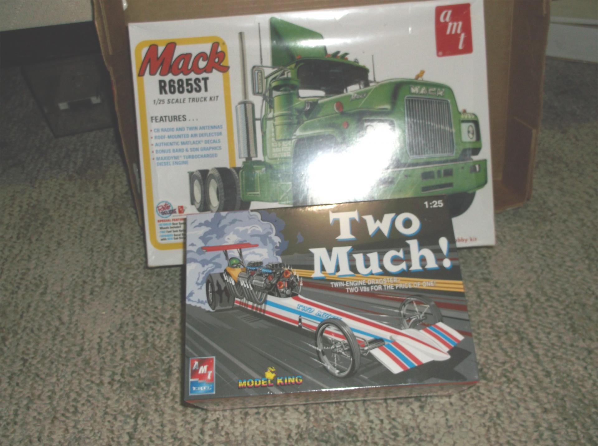

I went to a model show/swapmeet today and scored this. The dragster isn't important to this conversation but the Mack is. Both are sealed. Now I will not need to try to convert my Convoy rig. Thank you to all who helped me. It is greatly appreciated. This project is on the back burner for now but I have a better start thanks to you fine gentleman. I'll need to place an Auslowe order too. -
