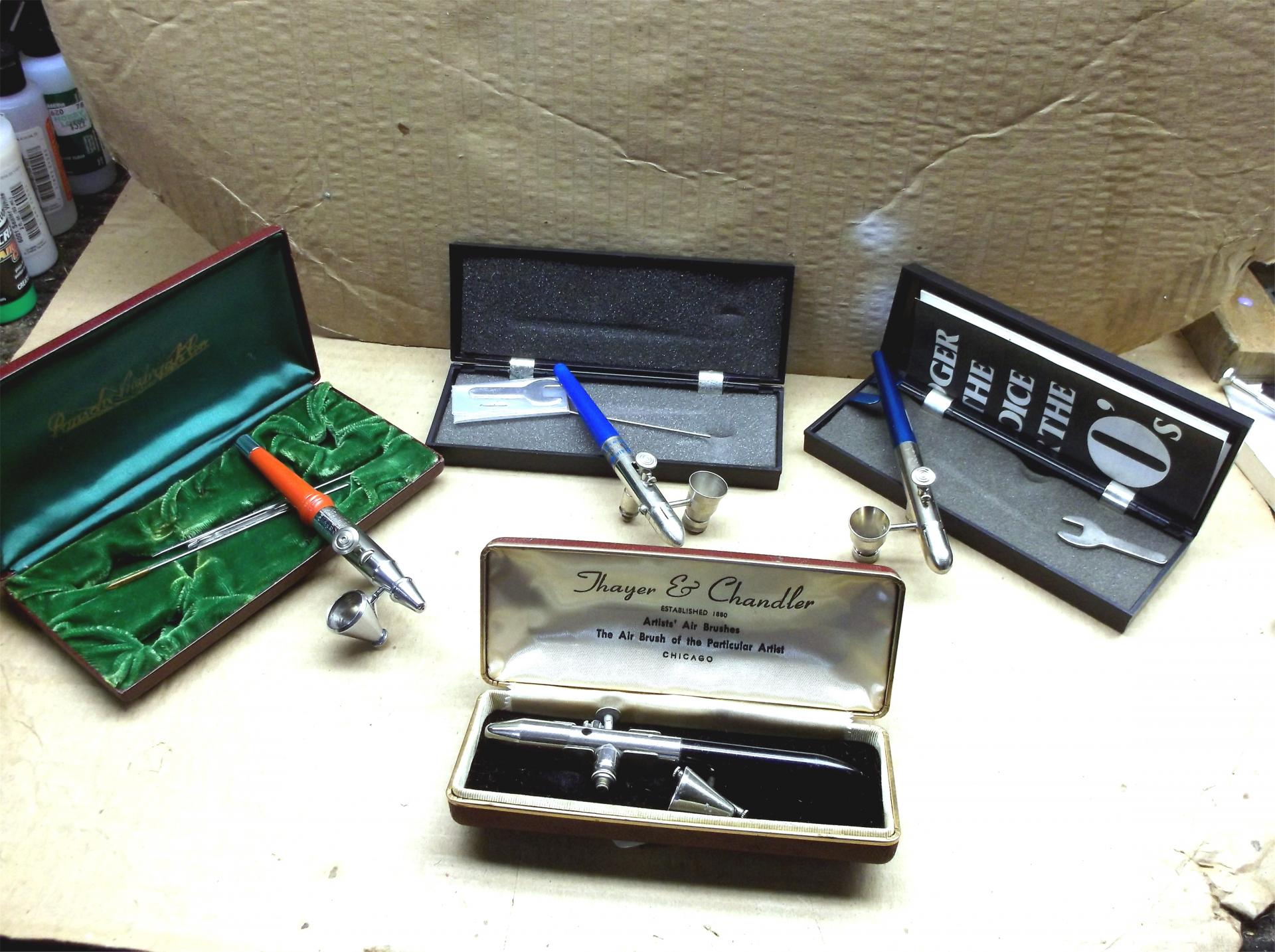

A few examples of a double action, side feed airbrush. In front is a vintage Thayer and Chandler model A, On the left is a vintage Paasche V, on the extreme right is a Badger 100XF and the center rear is a Badger 100XFL, left handed model. To my knowledge the T&C only uses a fine needle/nozzle combination. The Paasche V can be changed to either fine or medium needle/nozzles and the Badger 100 XF will accept all three combinations, fine, medium and heavy needle/nozzles.

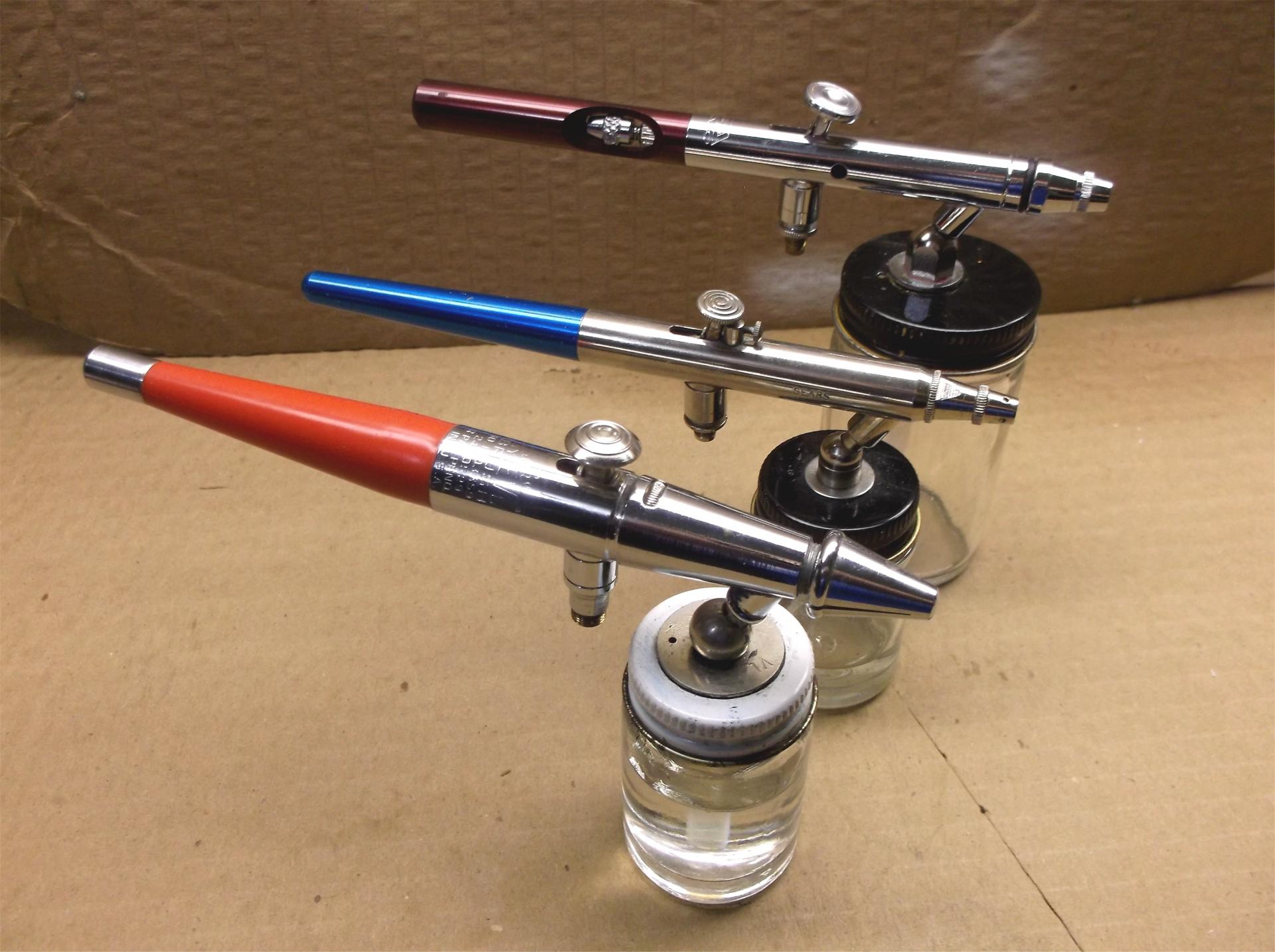

A few examples of a Double Action Siphon Feed Airbrush. Front to Back: Paasche VL, Sears (Badger) 150 and a Vega 2000. One thing to notice here is the shape of the shell (body). The Paasche is what I would call "pudgy". The Badger and Vega are more streamlined (smaller in diameter) with the Vega being a bit longer in length than the Badger.

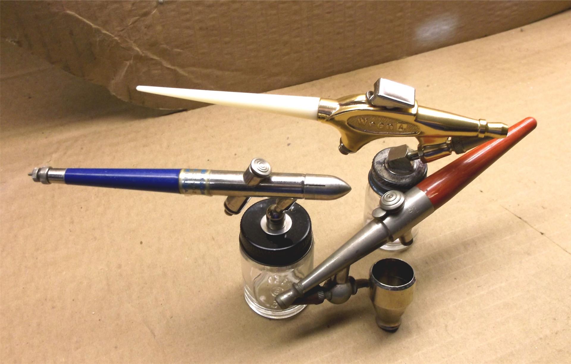

A couple examples of a Single Action Airbrush. Paasche H is in front. Badger 200 is on left and Binks Wren "A" on right. There are quite a few airbrushes available that use the same Tip/Needle design as the Paasche and Binks. To adjust the spray pattern you turn the tip in or out depending on what you need. The Badger is a bit unique as it has a needle like a double action. To adjust this spray pattern you turn the inner knob on the rear clockwise or counter-clock wise. This moves the needle in and out.

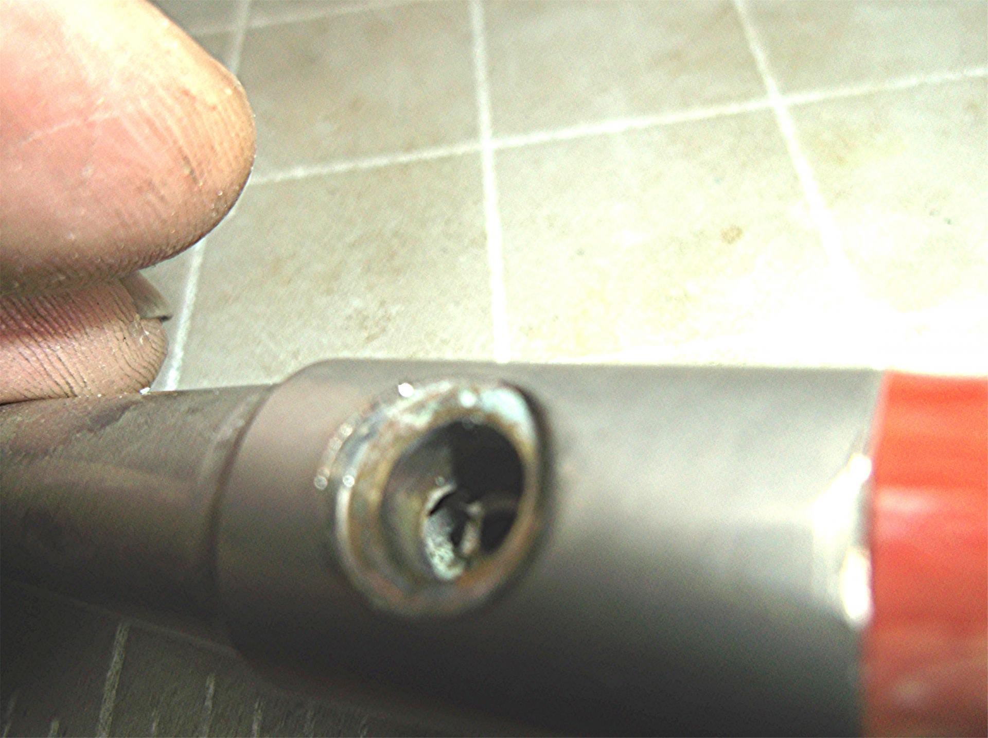

The only threads would be for the hose. The knock off was a throw in with a lot of airbrushes that I purchased a good while ago. I'm going to ask Paasche if it would be possible for them to .put old style threads in it if I send it to them. The person I'm dealing with there still has a hard time understanding that there are no threads. He thinks that there is still part of the assembly in it. I don't think so. I took a couple pics I hope to send them. Here's one:

I received an email from Paasche. I was given the same diagram that GeeBee posted along with the part numbers. I was told that both the new and old style valve assemblies are threaded. Hmmm, my shell (their term for the body) isn't threaded. I sent another email asking if they ever used press fit assemblies. Maybe I will hear back. Was able to tell mine is an older model. It has the stipple adjuster in front of the trigger. Thinking about it,this airbrush may have been a factory defect that was not caught. The assembly may have blown apart, and much like model parts that go flying, the pieces couldn't be found so it was set aside. Thank you for the idea Snake. I have a knock-off Badger 150 I may see if I can make work. The trigger mating with the air valve of two different systems would seem to be the biggest hurdle as a preliminary thought.

It only helps if someone would know if part H128A has threads that screw into the body. Mine does not have a threaded hole. I've seen the old style, H175A, and it has threads. I sent an email to Paasche and I hope to get a response. Thank you though.
