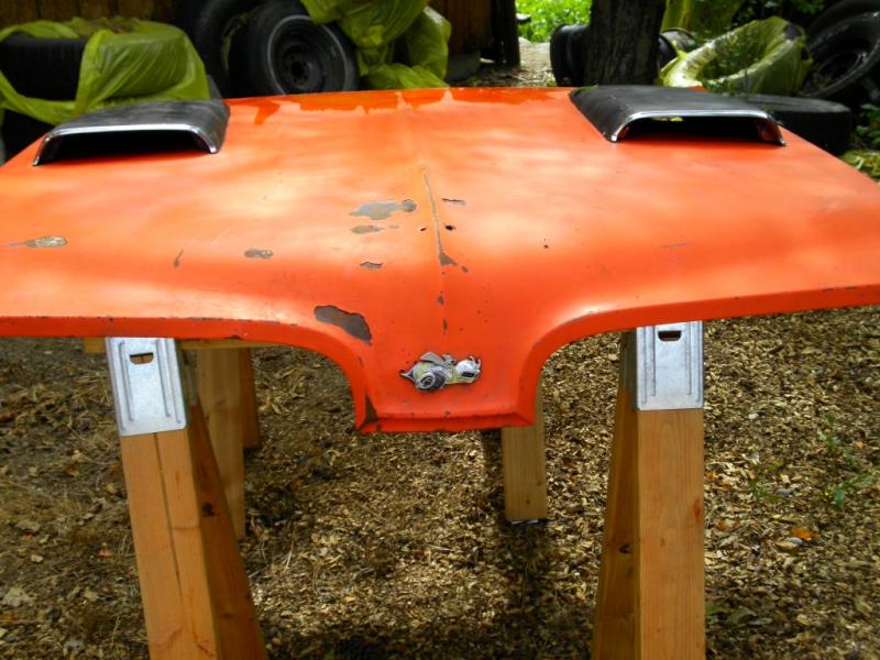

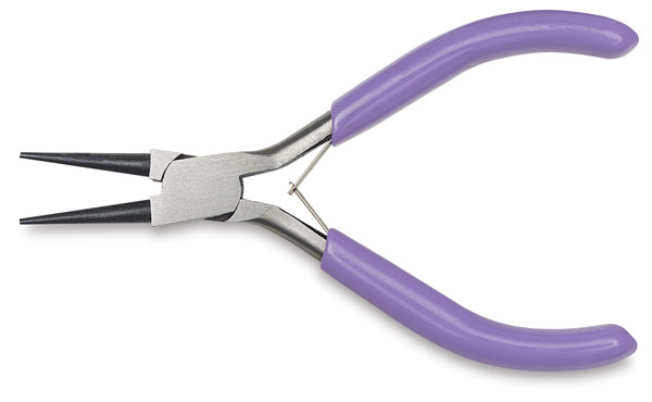

Actually, it's pretty easy. Time, patience and some scratchbuilding skills are all that's required. I've used .016" brass and aluminum sheet to fabricate parts like landing gear and bomb bay doors for a 1/48 scale B-52C and door skins for the Revellogram '59 Impala. The .016" brass needs to be annealed so it is easier to form over a buck such as a cut out door. I've also made new hoods, for kits such as the AMT '70 Coronet, using .016" aluminum. Round tip pliers are especially useful in forming and shaping the complex curves as found on the Coronet's hood. As far as rust goes, it ain't gonna happen using non-ferrous material. Unless you plan on using steel sheets, which require far too much work, you'll have to simulate rust with weathering pigments or paints.

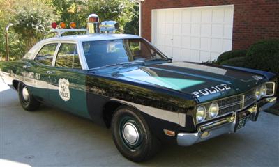

The problem with this kit is that it's a phantom vehicle and doesn't represent a vehicle used by the NYPD in the early '70s. Aside from the Suburbans used by the Emergency Services Unit as REPs, Broncos used by the Central Park Precinct, Ford Boyesmaster vans (Paddy Wagons) circa 1965 (ignore the red dome on the Beacon Ray 175. This is a restoration and a correct clear dome wasn't available) and Galaxies in 1970, NYPD used only Mopars through the '70s. Afterward, Ford E-Series vans were used as motor transports/ prisoner transports to Central Booking. Ford is still the make used today. NYPD also used Chevy/GMC G-Series vans for a short time in the early 1980s, though: That classic green/black/white scheme was used until 1972. Also note that the door shield for this scheme is different than the one shown in this decal sheet: That door shield was used when the paint scheme for NYPD vehicles was changed to blue/white in '73: About that decal sheet....I don't know where it came from; but, don't even think about using the yellow NYPD markings. They were never used on any real police fleet vehicles. The correct decals for NYPD vehicles to 1972 are available on ebay . The seller's ebay name is policedcalsanddeals and he has literally hundreds of different sets covering P.D.'s from around the country. Lastly, if one were to model an early '70s van, ditch the red and blue beacon domes. From 1963-71, the standard setup on RMPs and vans was the Federal Beacon Ray 175-H and Pulsator siren. The 175-H had a clear dome, 3 red and one amber light. The two opposing red lights were oriented one canted up and the other down. In 1972, Signal Stat revolving lights with clear domes were used with the same light setup as previously and the Pulsator Siren was also used. From '73-77 Signal Stat light bars were used on NYPD vehicles, with 4 lamp revolving light at each end of bar, 2 red 2 white lamps electronic siren middle of bar, barrel light between siren and each revolving light flashing red front amber rear. Custom Squads Models by Tony, among other police accessories, makes the proper beacons and sirens. They also produce light bars for later vehicles.
