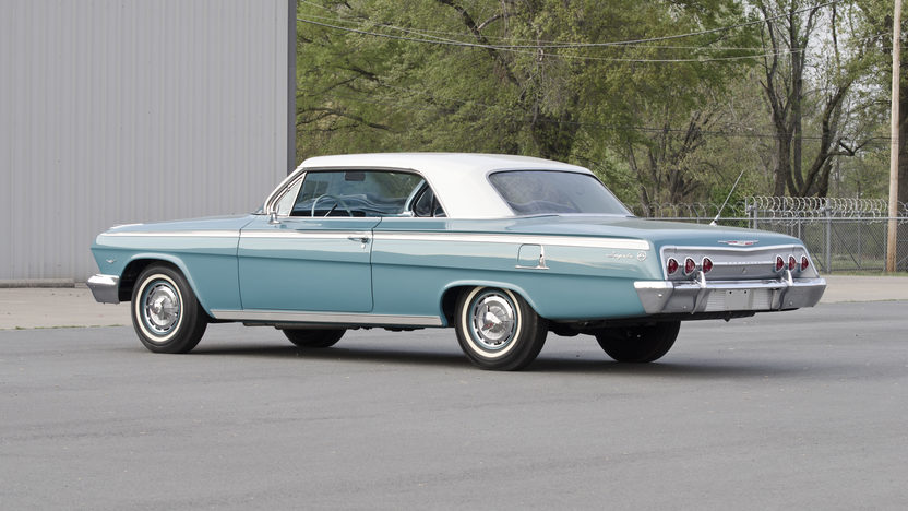

  4. Interesting. Seems like everybody sees something different. I don't see any similarities. Neither the '63 Tempest '63 Impala 2dr HT nor the '62 Impala 2 or 4dr HTs are good starting points because the C Pillars are too narrow, meaning increasing the width will be necessary; and, there is the beveled edge along the rear of the pillar which needs to be removed if Kurt wants to model the roof as in the photo he posted: The C Pillars on this are flat, slab-sided, with to beveled rear edge. The C Pillar of the '58 T-Bird HT roof is a lot wider than the pillar in Kurt's pic. This, too, needs to be addressed by performing surgery. The Lindberg Dodge roof, as I pointed out, shares most, if not all, of the characteristics he's looking for. BTW, you guys must have an odd sense of humor or a large pile of disposable income to even suggest using an AMT '63 Tempest as a donor. It must be nice to be able to hack up a kit that goes for almost 200 bucks just to use the roof on a 15-20 dollar snap kit and not think twice about it.

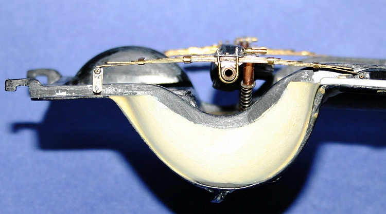

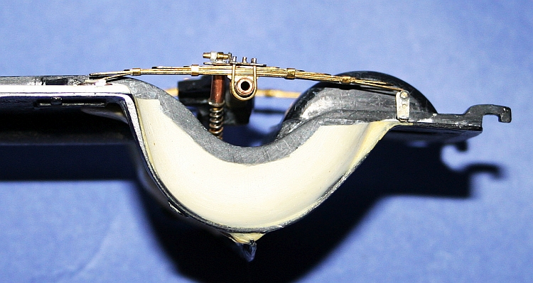

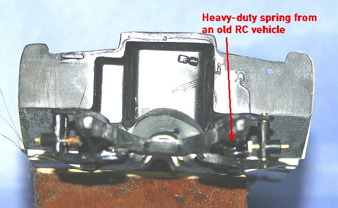

  18. I used pen springs for the scratched rear shocks on an "H" Series Revell '55 Belair, the one with opening doors, hood and trunk. I fabricated functional leaf springs and shocks (each one composed of six parts), in addition to accurizing and detailing the chassis. I slipped the springs over the shock shaft and the shock is mounted to the spring plate while the spring is held in place when the shaft end is placed in a hole drilled into the sheet brass upper mounts on the chassis. The front springs were made from a heavy-duty spring I scavenged from a junk RC vehicle. You can barely see it; but, it is the proper scale thickness and diameter. I used the same kind of spring to detail the scratchbuilt front suspension I made for a Johan '64 Caddy DeVille. There are some cheap, Chinese-made hand tools that sell for a buck or so apiece at your local 99 cent store which have similar springs.

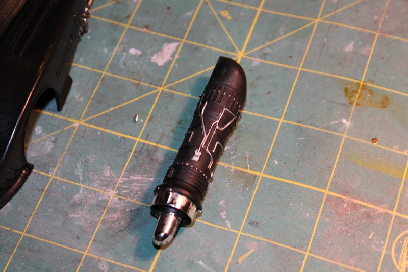

  22. Well, AMT 1107, the 1989 Keaton Batmobile kit contains a "complete" turbine engine Unless one is resigned to the fact that a Cobra will require major surgery to stuff this baby under the body, it ain't bad looking. Honestly, I don't think this mod would be believable, engineering-wise.
