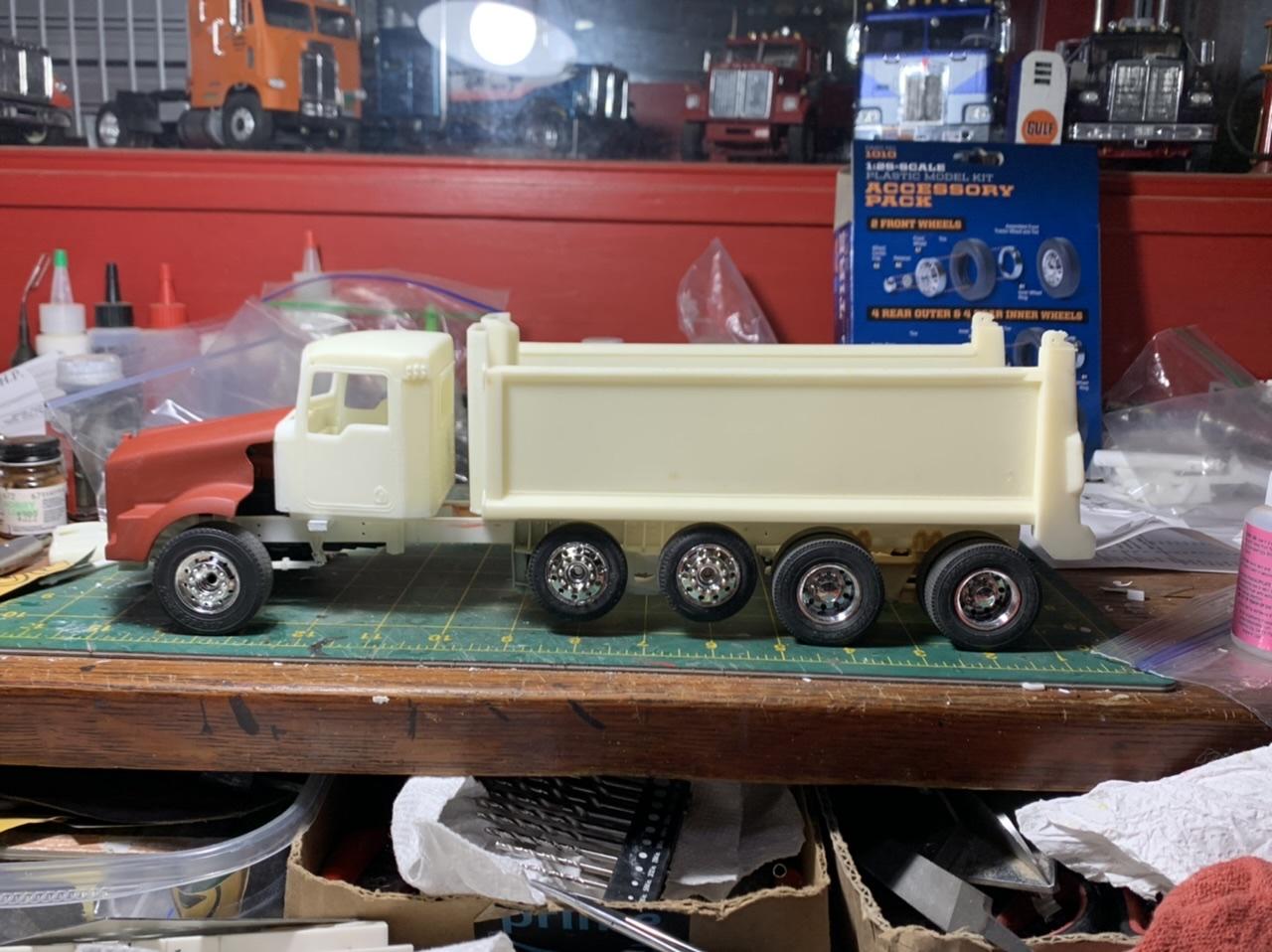

Thanks guys! After the hood seemed to get a little soft in Bleachwhite, I wasn’t sure how the cab was going to do in Purple Power. I used that instead of Super Clean since I understand that Super Clean is stronger. It removed the paint pretty well without harming the resin at all after about a 5 hour soak. I used a toothbrush and Comet to clean the cab and then used self etching automotive primer. That solved 99% of the problems. There were only a couple of very small fish eyes this go round. Interestingly I used the same color primer and the same can of paint and it seems that it came out a slightly different shade than the hood that I painted two days ago. But here it is. We will see what color the breathers and the bed turn out.
I hate when I do something that I know better than doing!! It all started when I soaked the hood overnight in Bleachwhite. The hood seemed to get soft. I’ve read that some casters don’t recommend soaking overnight because they say it will reactivate the resin. With this I opted to simply wash the cab. Even after washing this milk jug like resin is so slick that Gorilla Tape will not even stick to it. I should not have went on and painted, but it was a pretty day and they are getting fewer with colder weather coming. To make a long story short, it is soaking in Purple Power now. We will see if it survives. JT, here is a sneak peak at the color that I “Hope” to finish this thing in. It is hard to tell in the picture but the paint is turning loose in several places.
