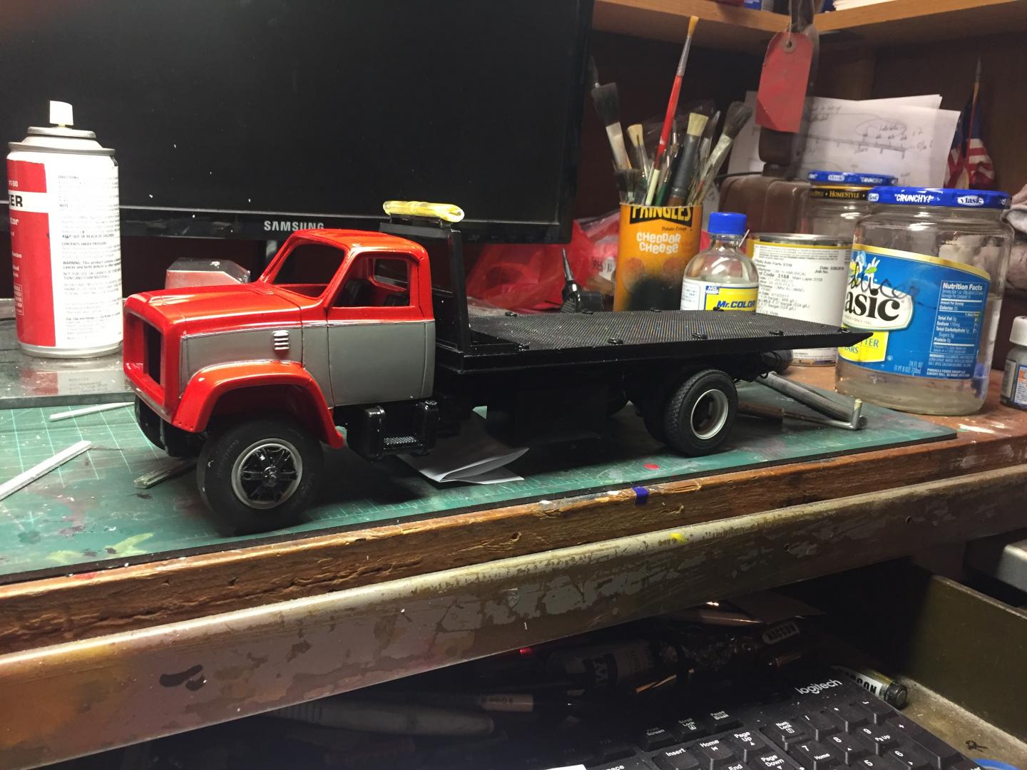

  1. Got it masked for the silver and painted. Came out ok

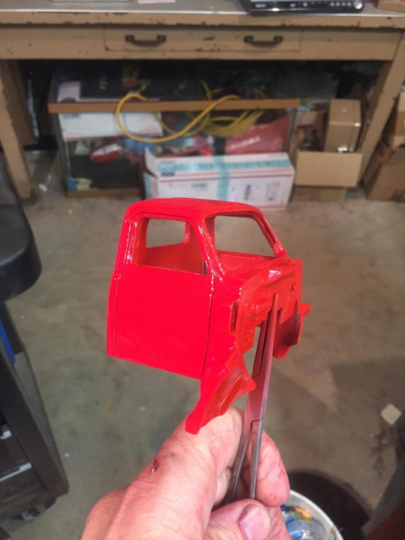

  3. Used the Dremel tool to cut the glass channel around the windshield and rear window openings. Got the cab into primer and final bodywork done, and then got the red done. After a few days of drying to allow masking for the two tone job , will get the second color of silver done. Wheels and tires assembled and attached.

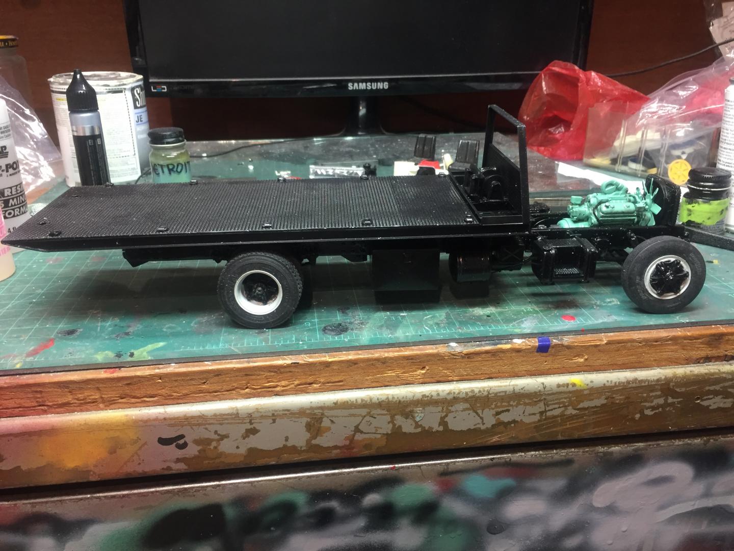

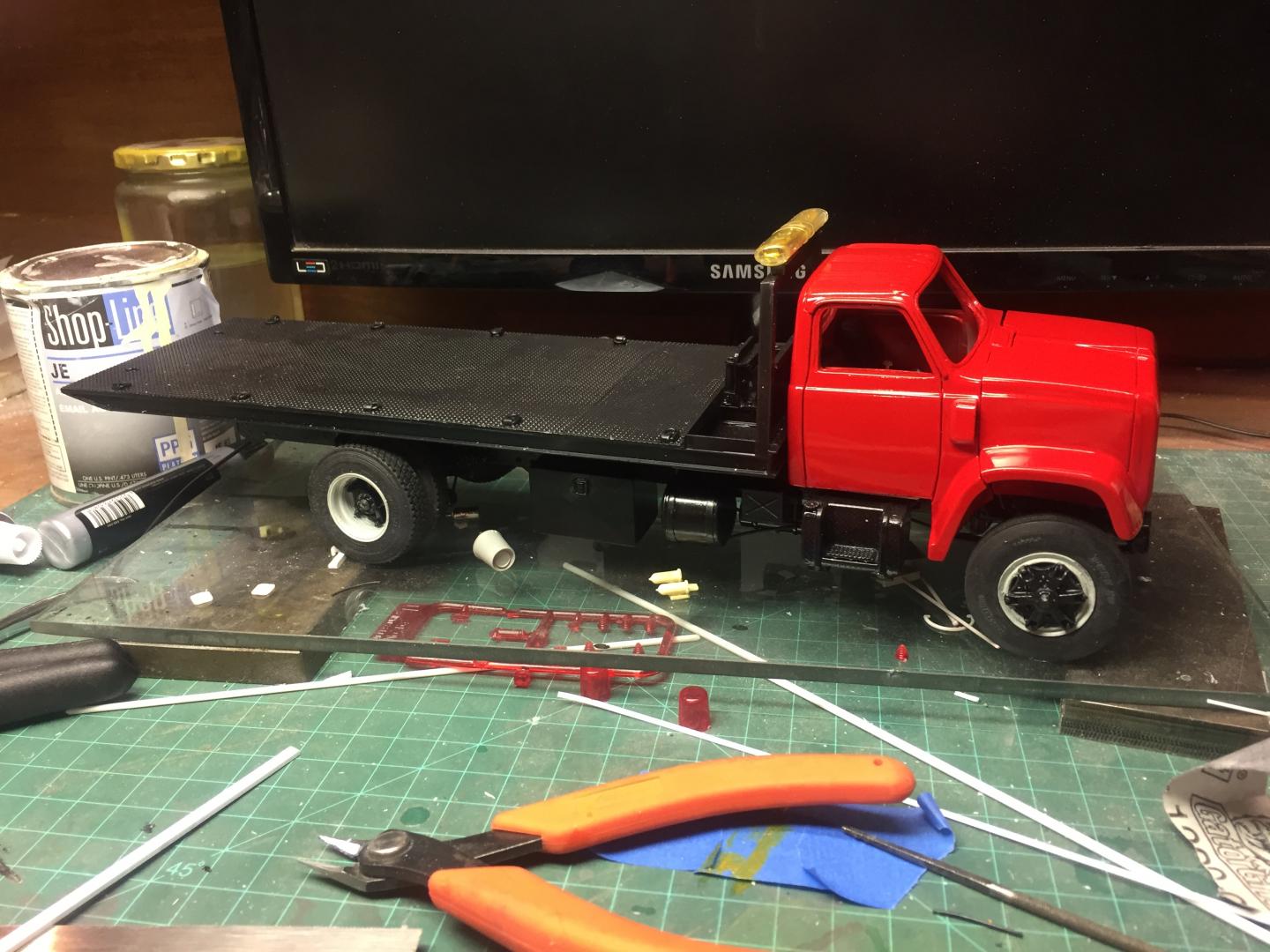

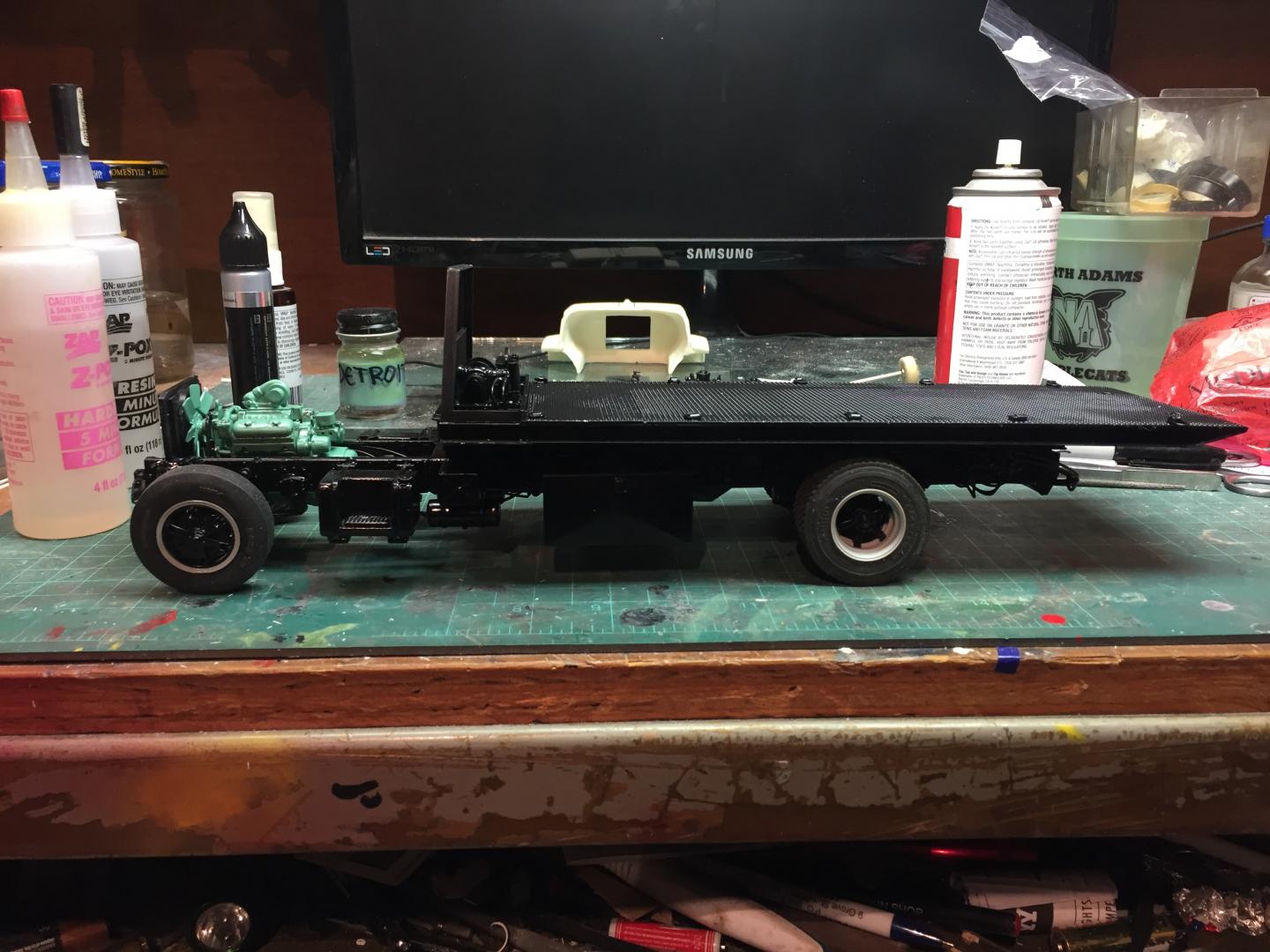

  10. Chassis and body all done. Just have to finish the tires and mount them and then attack the cab and the engine intake and exhaust systems. Am awaiting dremel bits to cut the glass channels for the windshield and rear window. This thing looks like a bowl full of black spaghetti underneath with all the hydraulic lines, exactly like my old truck. Am going to paint the cab red with silver/gray sides, in the factory two tone style. Am also going to try my hand at mild weathering instead of a paint shop fresh build.

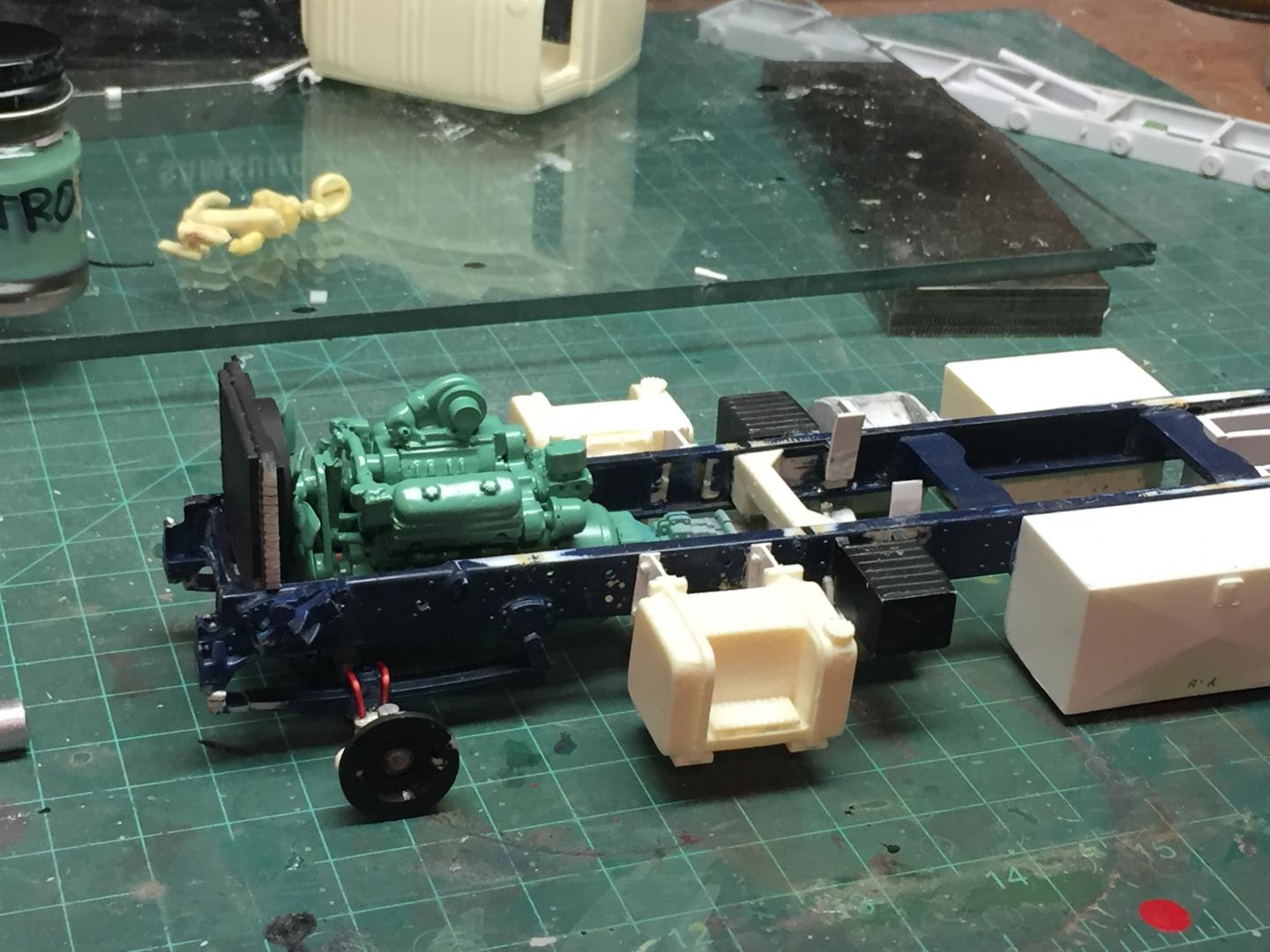

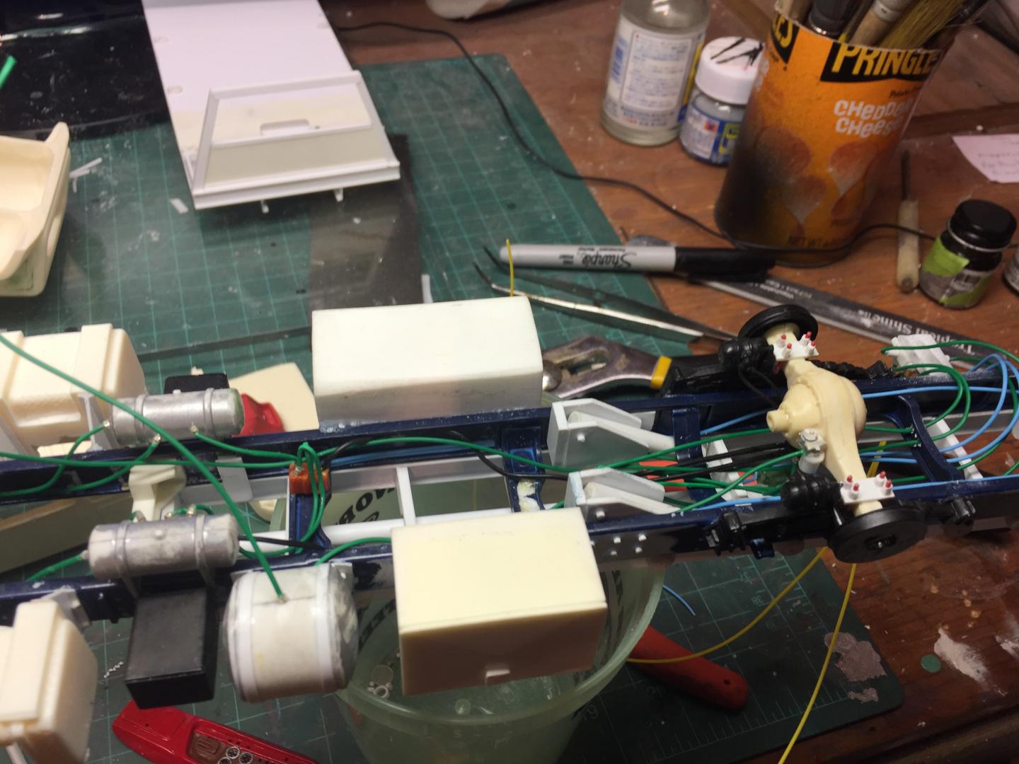

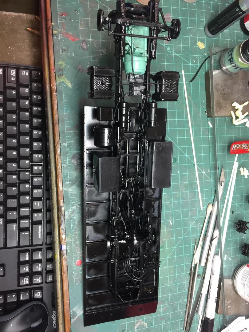

  11. Got the air tanks and fairlead installed and the load tie down d-rings. Installed the brakes. Installed all of the air, fuel and hydraulic lines and got paint on the chassis and rollback body. I mixed up a batch of Detroit green and painted the engine as well.

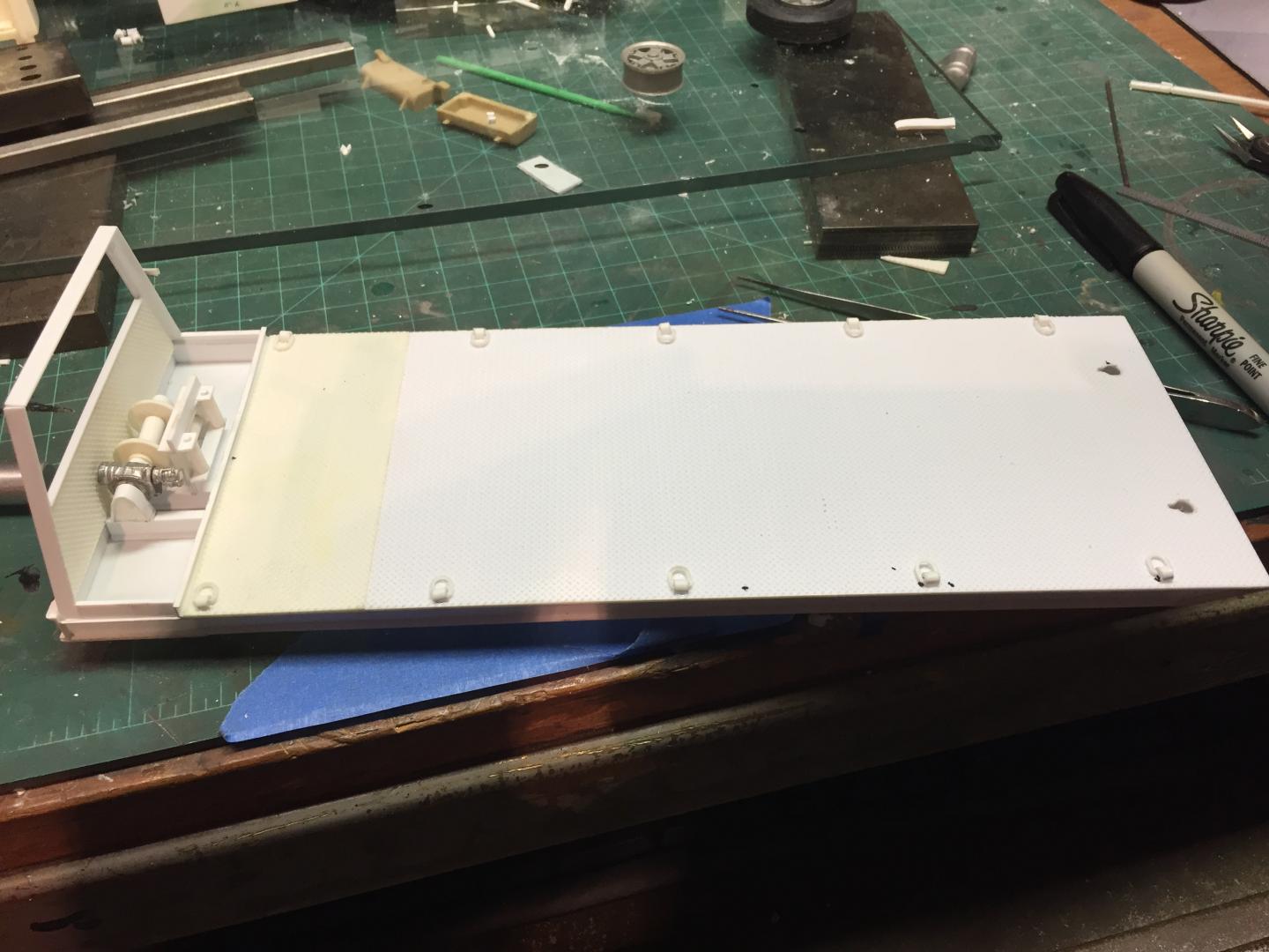

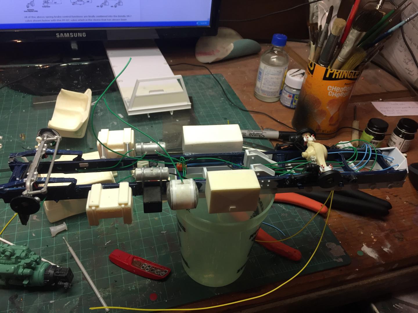

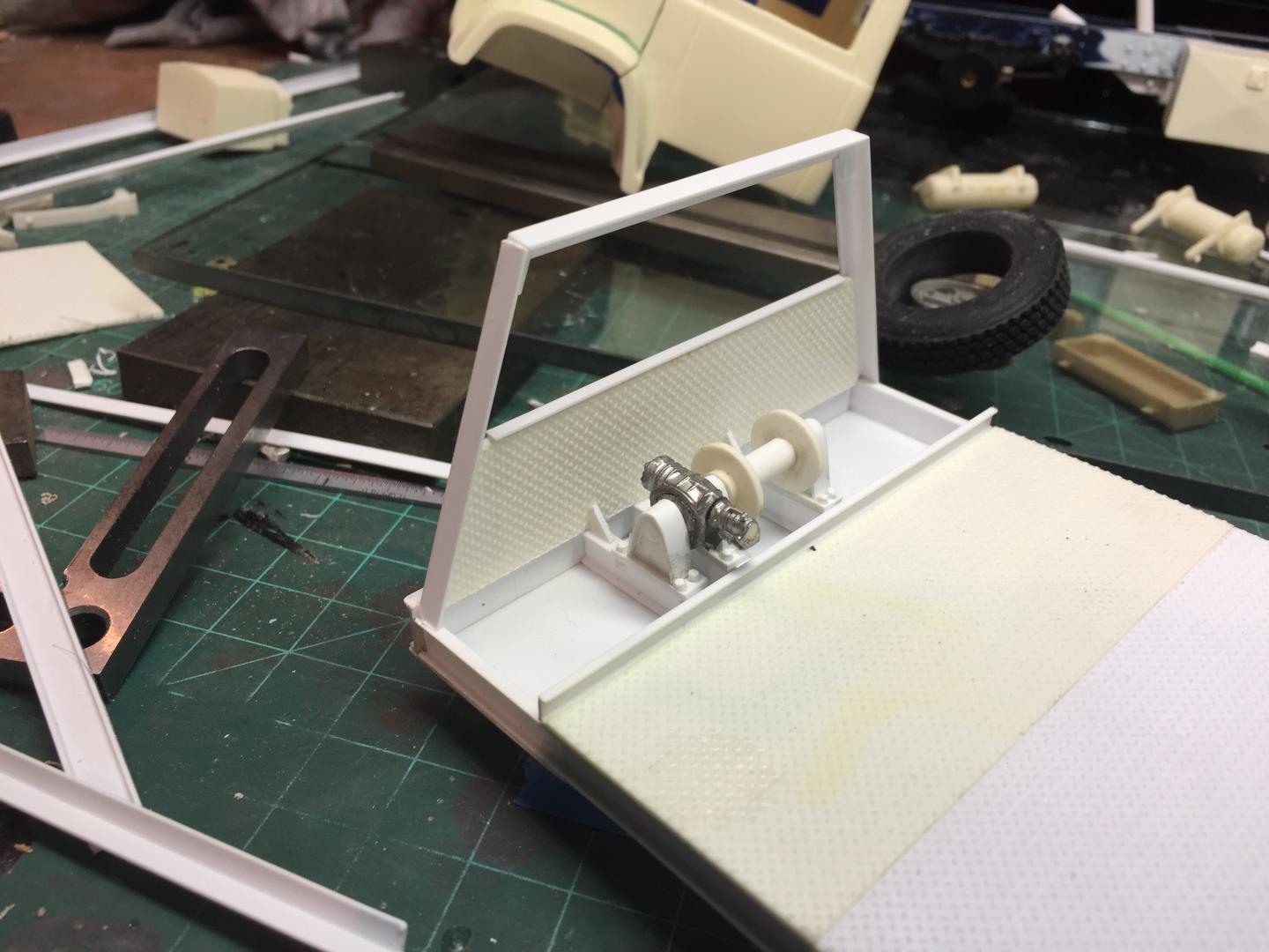

  13. Added the rest of the underbody cross members, and built the headache rack. Still have to make a roller fairlead for the winch. Attached the fuel tanks, hydraulic tank, battery boxes and the tool boxes. Need to detail the mounts with hex nuts yet.

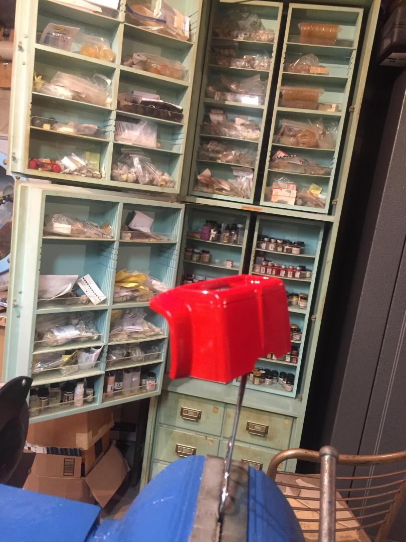

  15. I have two barrister cases that have three sections each with glass fronts, as well as an old gun cabinet that I added glass shelves in. I also have an old china cabinet, with glass doors, and all of these work very well, keeping the models dust free and protected.

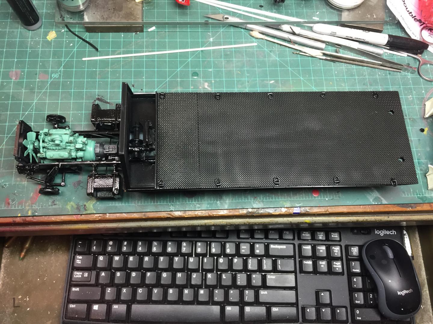

  19. Made up a three bank hydraulic valve and attached it to the left rear of the frame. Put some levers on it, and just need to add the knobs and piping. Also added the mounting bolts for the hydraulic winch. NOW, on to the rest of the truck.......................

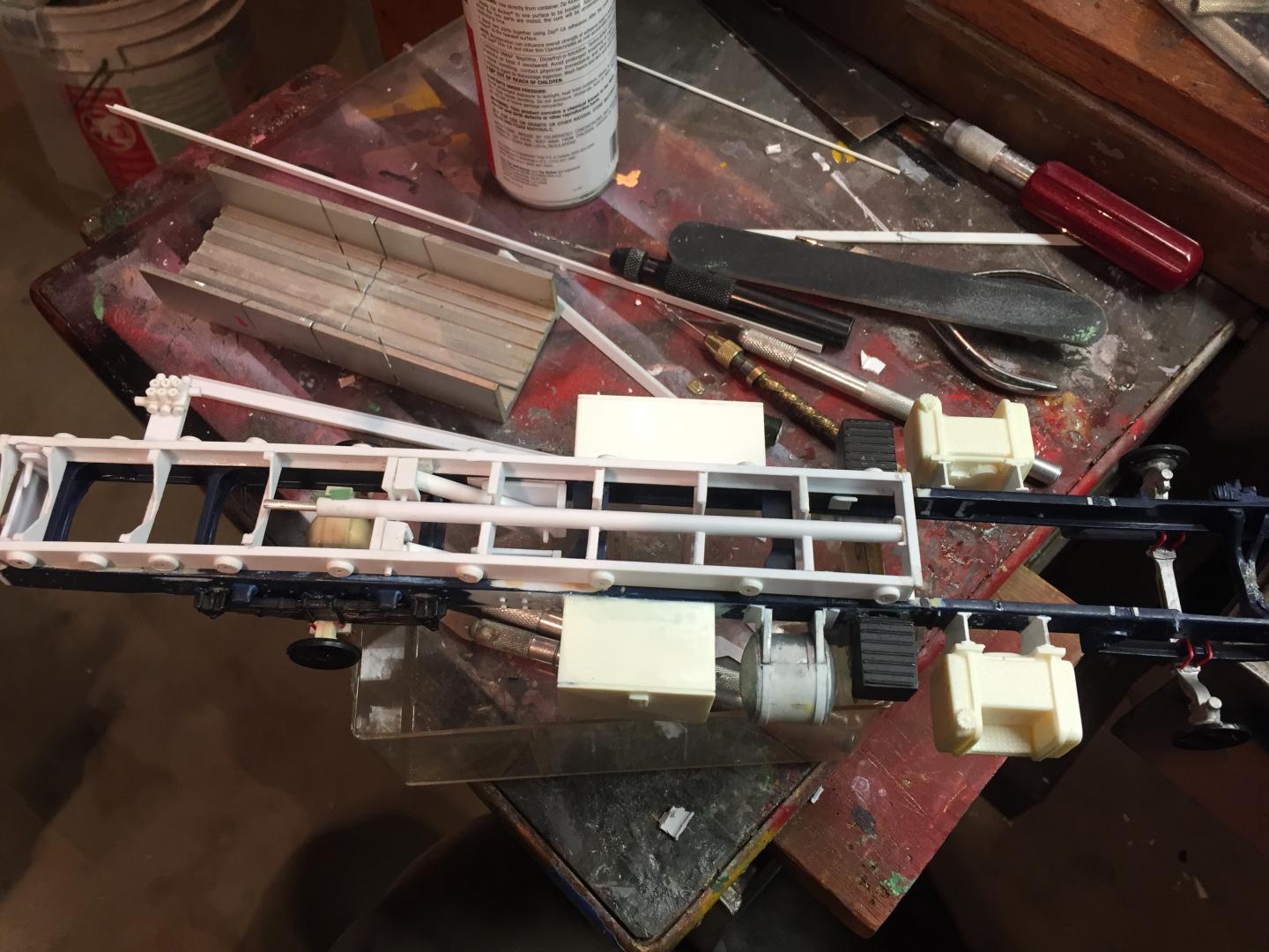

  20. I finished up the lift cylinder mounting supports and the attachment for the cylinder rods to the subframe. The lift system is done, and now it's time to make up a hydraulic valve to run it all and get it all piped. Left the pivot pins removable for the meantime and will final install them after paint. Threw together a winch very similar to the homebuilt one that was on my truck, made from a double reudction gearbox and a hydraulic motor. That thing had LOTS of power! The only issue with it was that with all of the reduction ratio, it was necessary to rev the truck quite high to get any speed out of the winch. Time to move on to the piping, brakes and air lines as well as getting the rest of the frame done with the fuel tanks, air and hydraulic tanks and the engine and cab...............so much to do, so little time!
