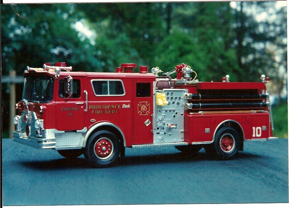

Wrap the hard suction hoses in masking tape; either 1/2" or 3/4" wide. Do it on a diagonal. This will represent the reinforcement that was used on the hard suction. Paint them flat black. Here's what they should look like when they are done. If you look close at the photo you can see the diagonal lines of the masking tape wrap. They are the same hard suction pieces you are using. Here's another pic that shows the hard suction a little better. Smaller tubing but same masking tape covering. This model was not finished at the time but you get the idea. -
