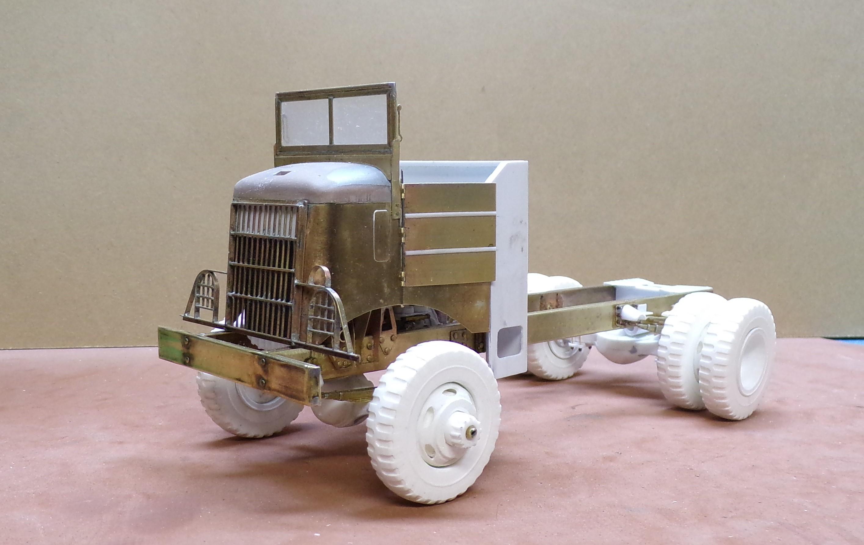

  12. First posting of the work in progress. This is a big model by model standards but is to scale in 1/25. Wheel base is 268" which is 10.5 inches. The majority of the frame is from the Trumpeter ALF kit with the back portion coming from an Ertl International kit. Some liberties have been taken with the tandem axles to make them movable. The IH kit parts when glued together don't move at all. By drilling out the trunnion portion and the ends of the connecting rods to each axle they were pinned with brass tubing and rod sections. They are kept in alignment using the torsion rods at the top of each axle and connecting them to the frame cross member. The tires and wheels are resin castings from the Trumpeter ALF as well. Why not use the soft rubber tires and chrome wheels? Well, that's just me. I'll use Alclad on the wheels and Tamiya TS-82 rubber black on the tires. In the background is a drawing of the cab at 1/25 scale from the truck plan. Evergreen sheet stock and PVC tubing will be used to form the basic shape. The grill I have already made from the Jacksonville model of a couple of years ago so it's a matter of casting another one and then doing the Alclad thing on it. Each axle has a brass tube to hold the wheels. Inside each wheel is another brass tube that acts as a bushing to allow the wheels to rotate and without wobble. The tubing also increases the strength to support the final weight which will likely be a lot given the size of the aerial device. The axle tubing will be filled with plastic rod, which will be drilled out for screws and washers to hold the wheels and tires in place. Each screw will be covered as part of the final build. The rear portion of the frame will likely be made longer once I know where the body will sit. But that is a way down the building road. Cab will come before that. In the meantime there is some detailing to be done on the frame and get the wheels and tires mounted with the screws and washers. More to come.

  15. Well I just made my first mistake with it. It does not have a 280" wheel base, only 268"! So I had to cut 12 scale inches out of the frame. Got it back together ok. Need to pay closer attention!!!?
