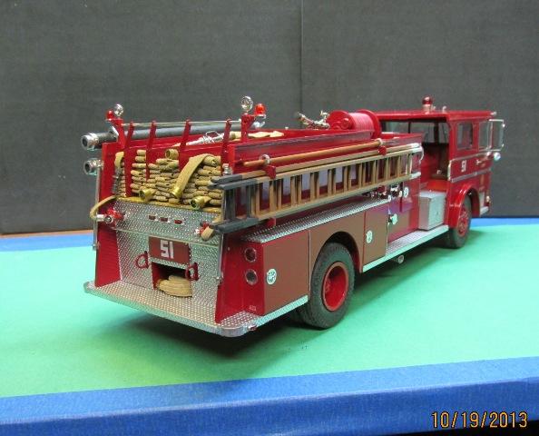

If it's not too late I'd cut down on the size of the booster hose. Most booster hose is either 3/4" ID or 1" ID with garden thread for couplings. If you can remove the current hose load try substituting some red electrical wire about 1/16 diameter. That will put it more in scale for what you are doing. Got a good start on the red paint. What brand are you using? Here's a look at some of the electical wire I've used on rigs that I have built. This happens to be a 1961 Maxim. The hose reels are the same as yours, only thinned down so you can see the relative size of the hose is smaller. Same wire again and on this one I slipped on pieces of aluminum tubing to look like couplings. The hose may appear larger but it really isn't. There is just more of it on the reels. -
