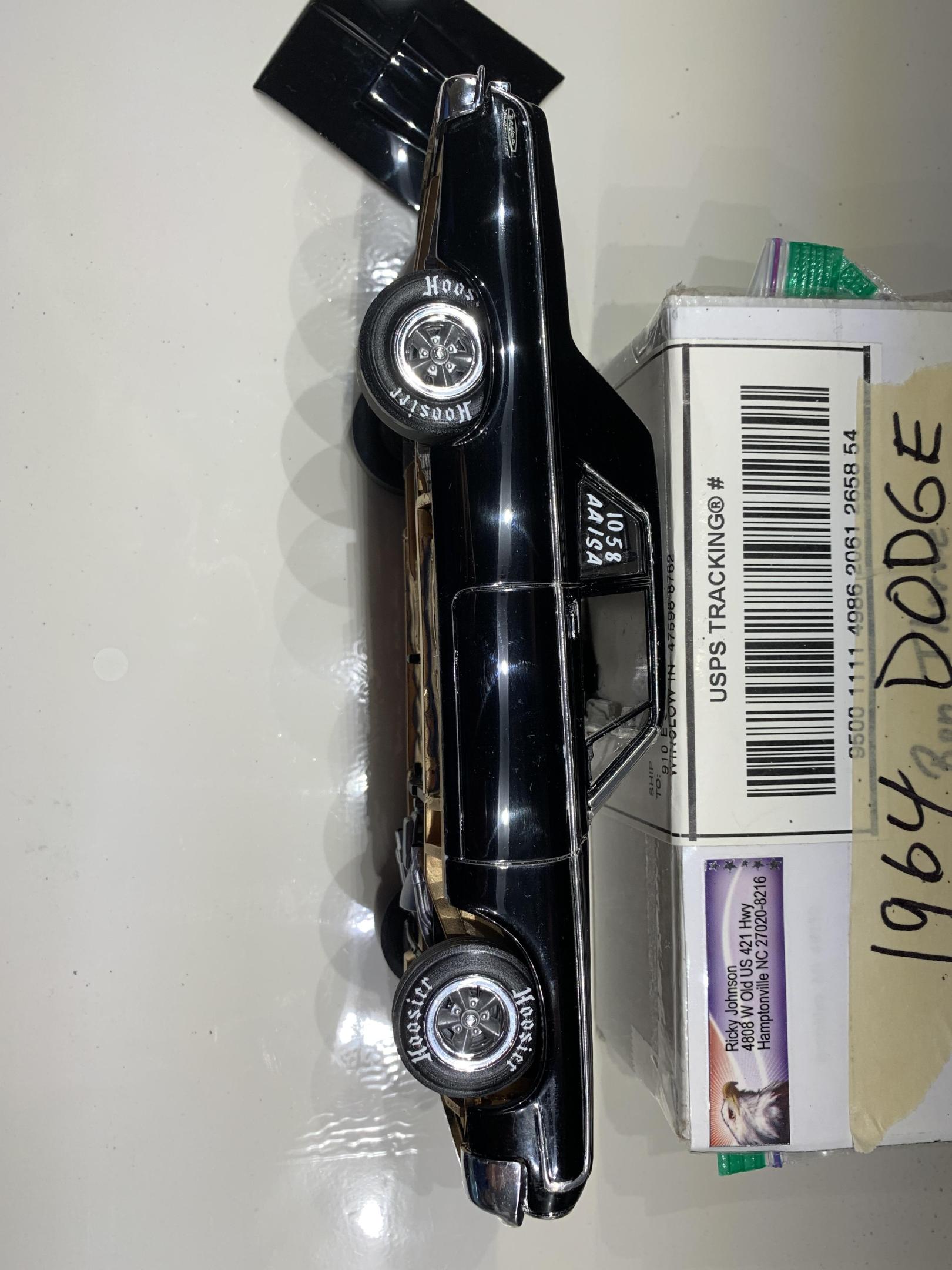

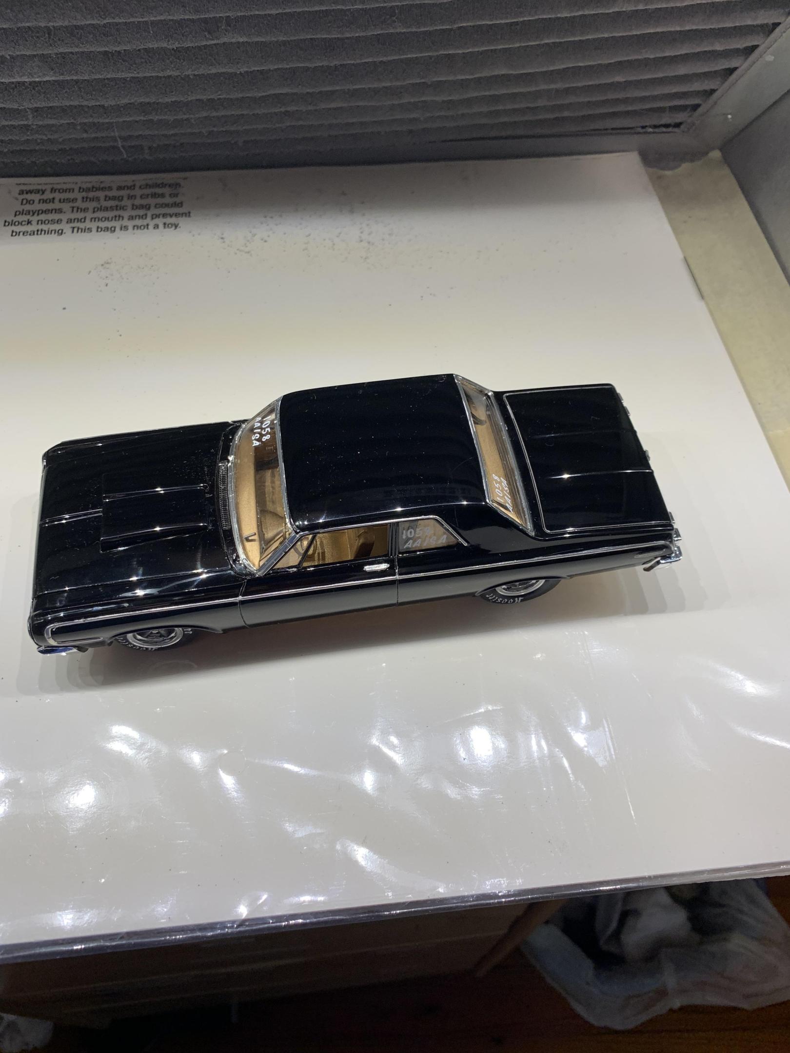

Finished this a couple weeks ago. Any questions can hopefully be answered in the wip section. #4 aa/sa is on hold for now as an A/SR 1932 Ford 427 SOHC has gone on for way too long. I am attempting to climb out of the mid 60’s Mopar hemi rabbit hole.

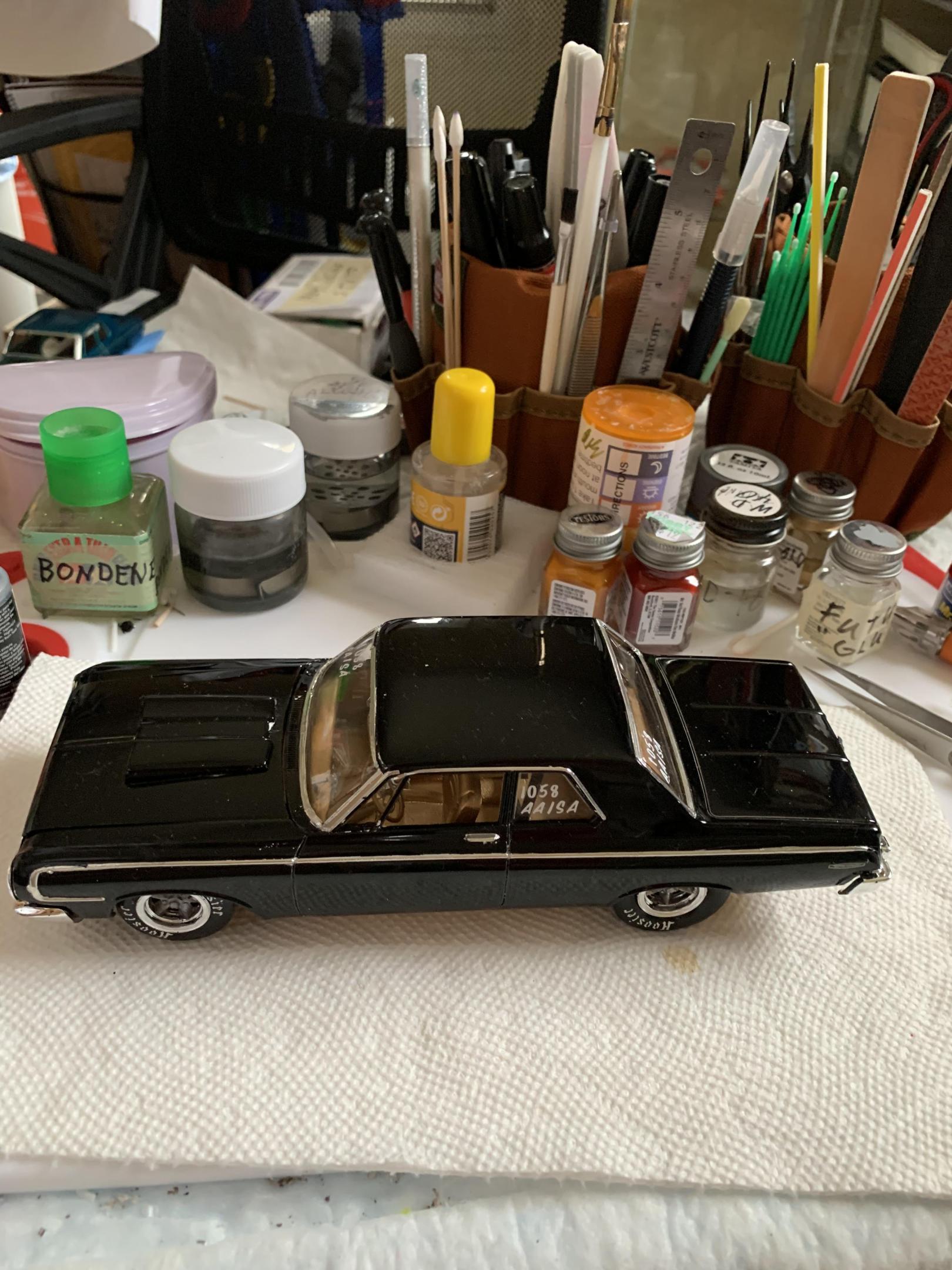

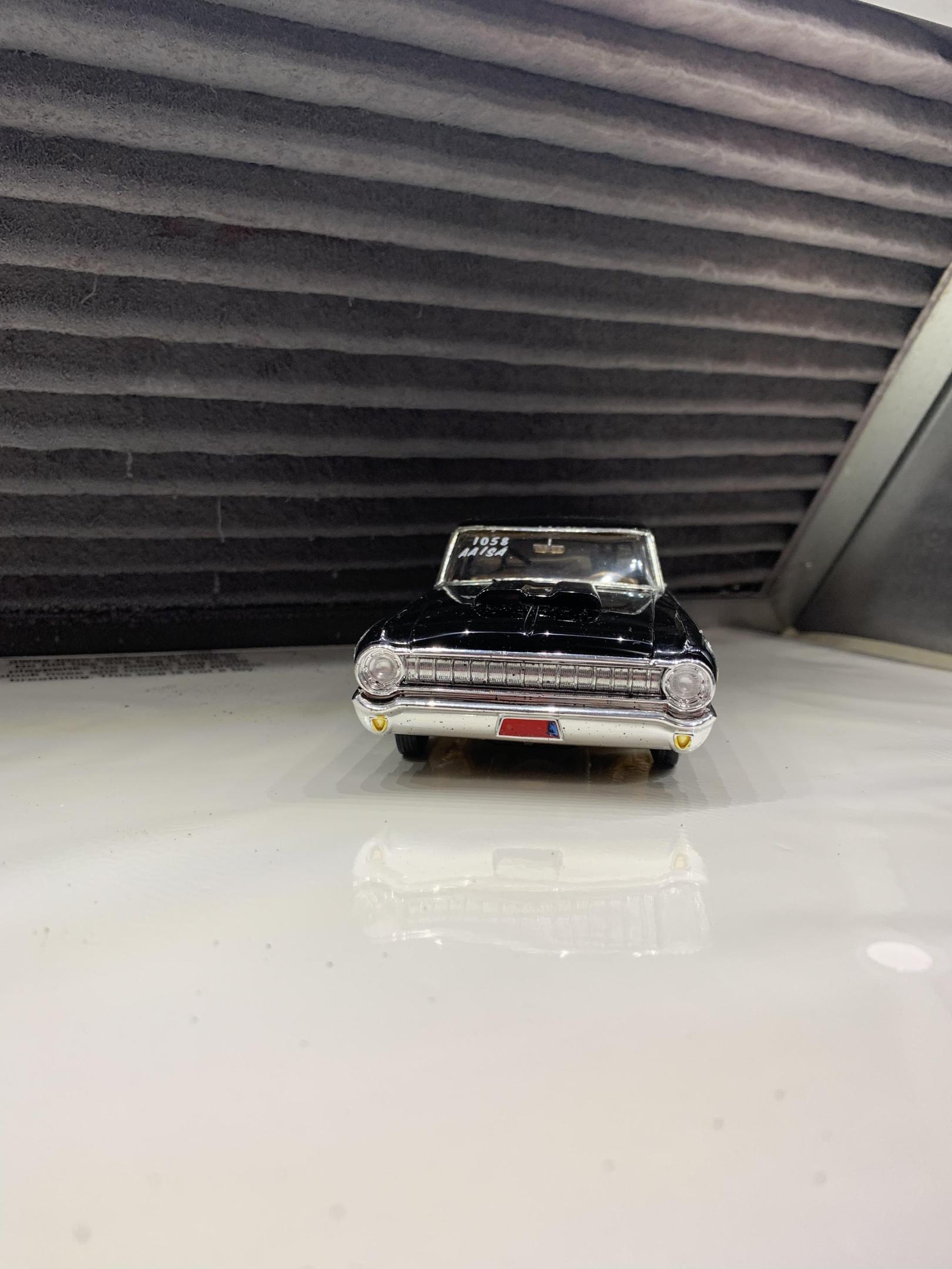

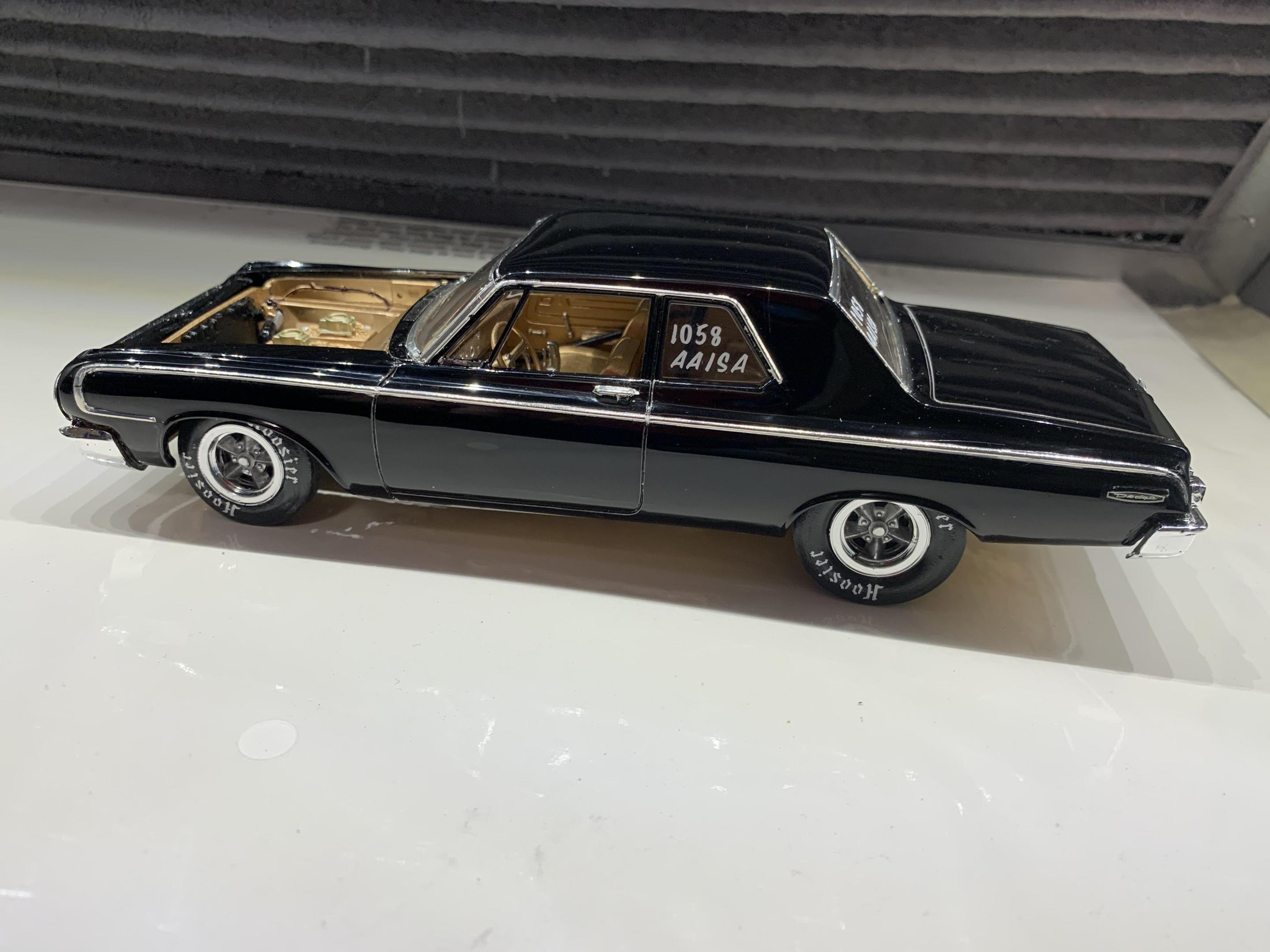

Calling this one done (well, for now, at least). Time to remove some dust with that great Tamiya brush and take some final pics for the finished column. #4 is on hold for now. Thanks for looking. Comments, critiques, etc., always welcomed. -

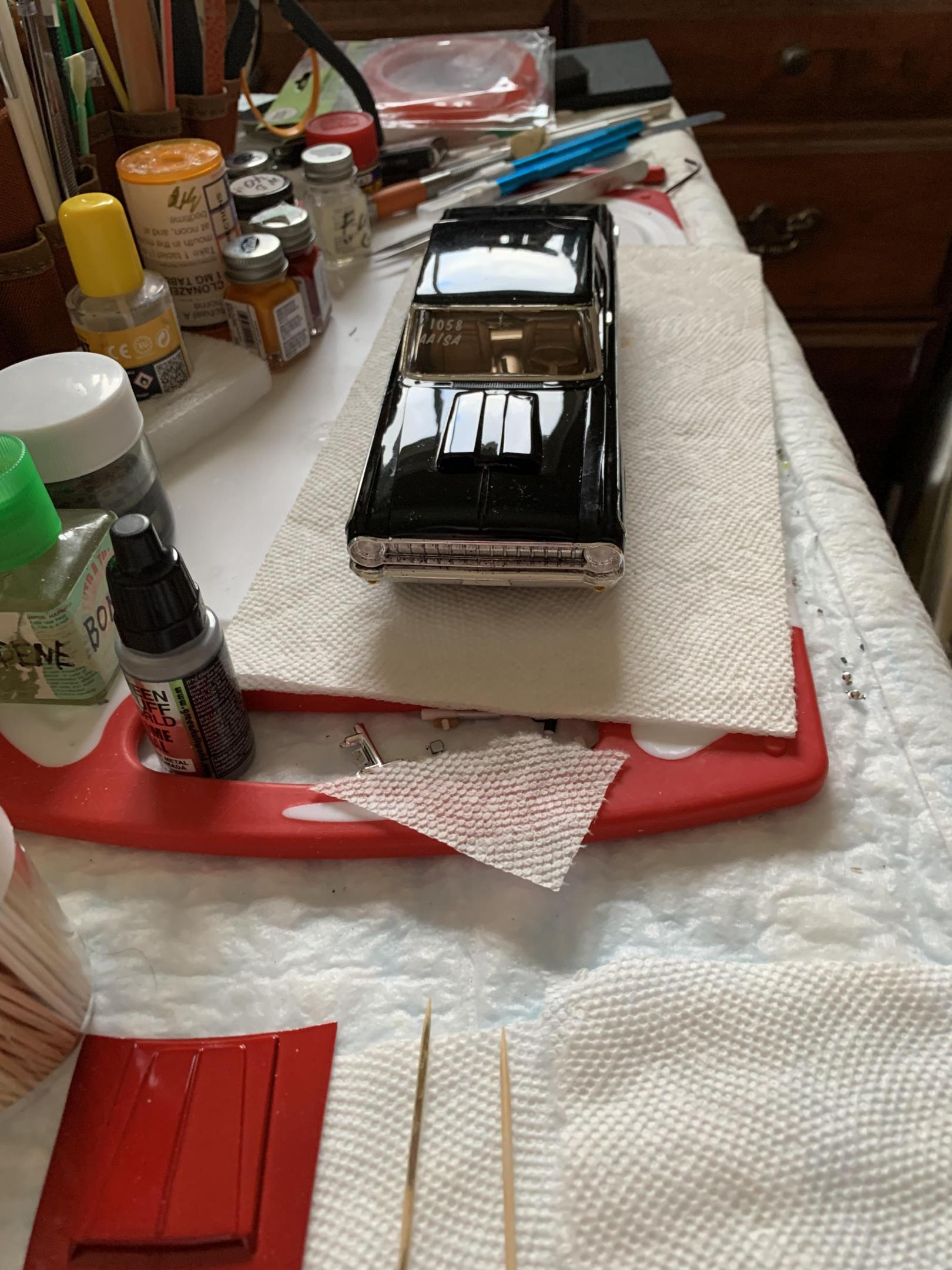

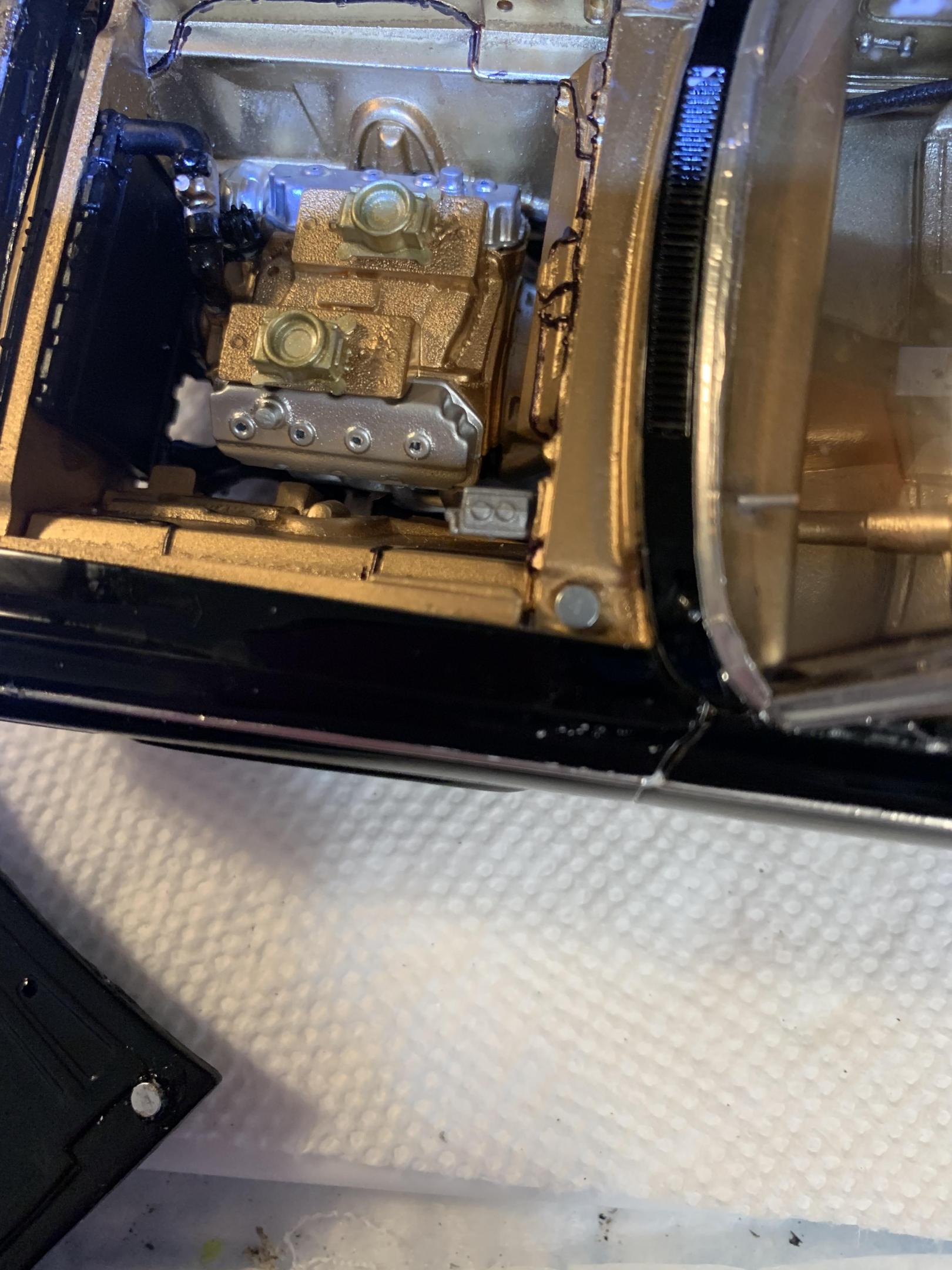

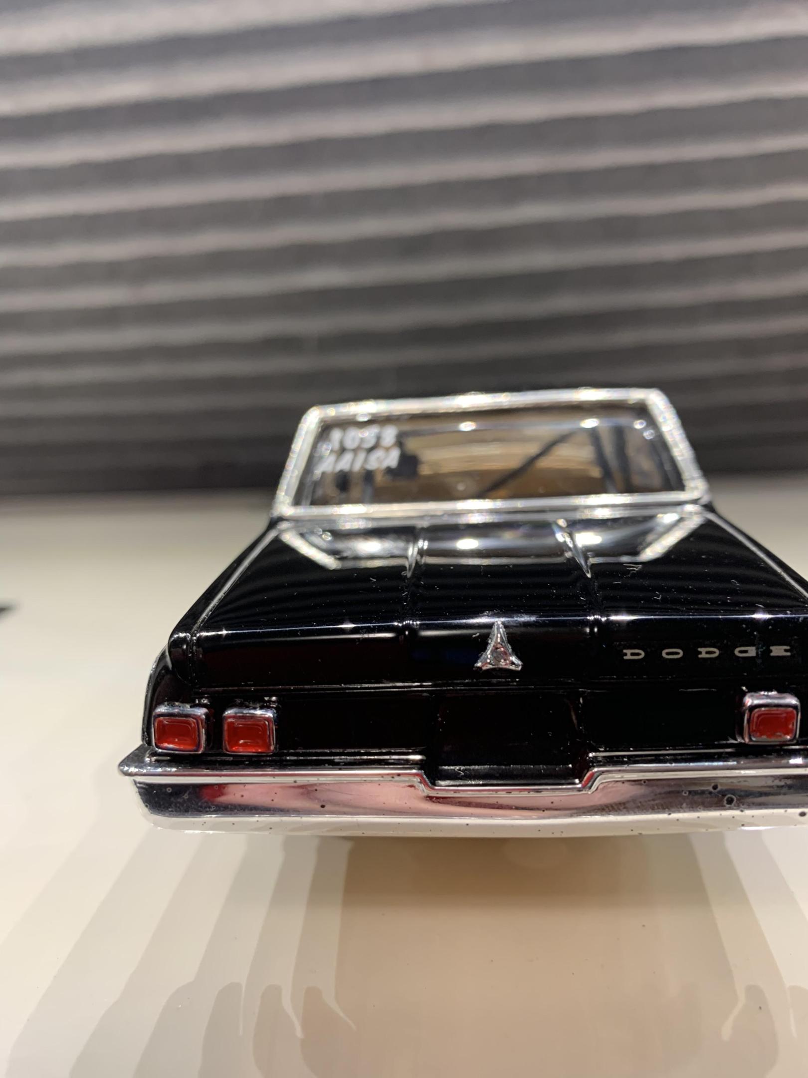

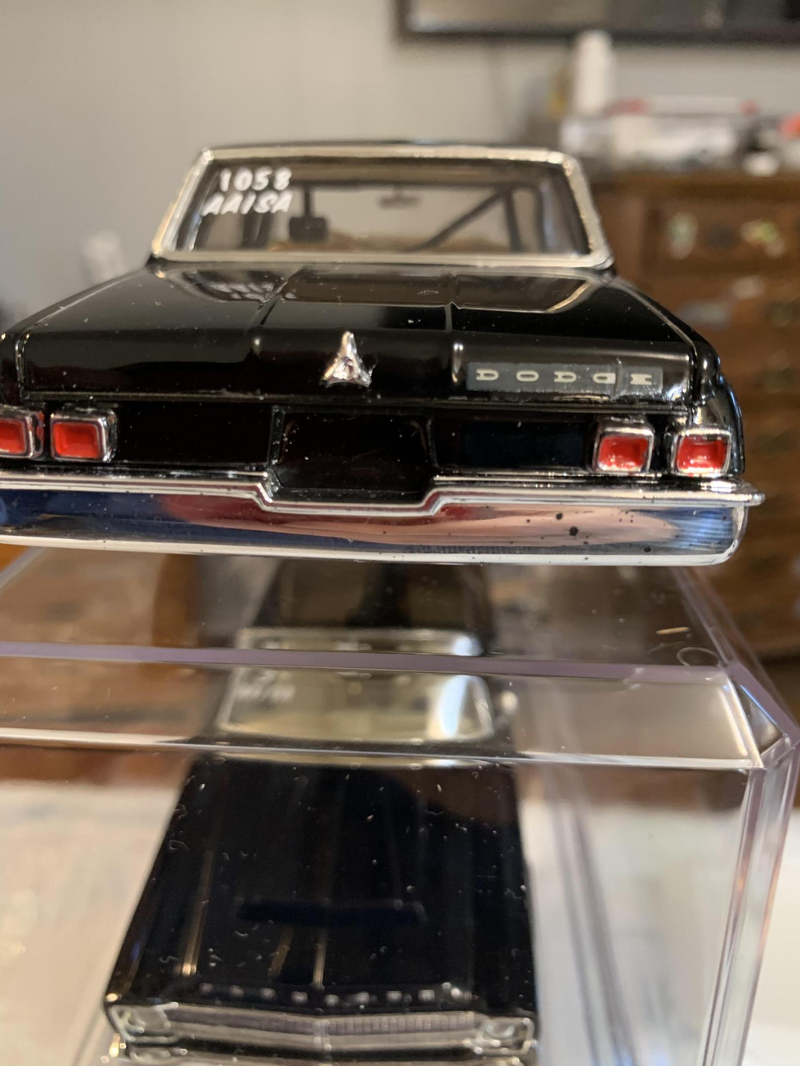

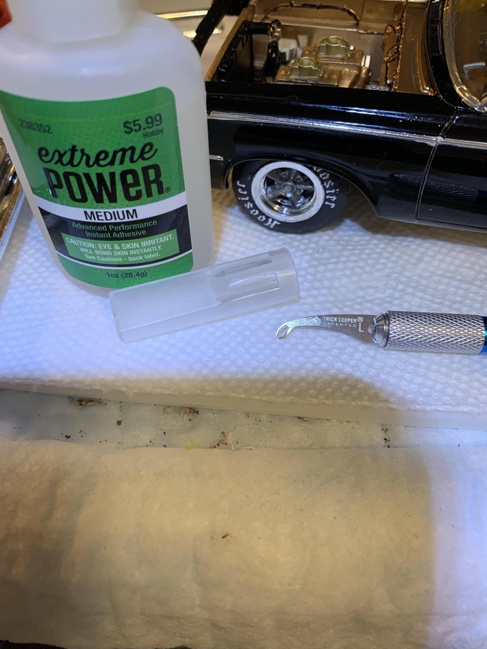

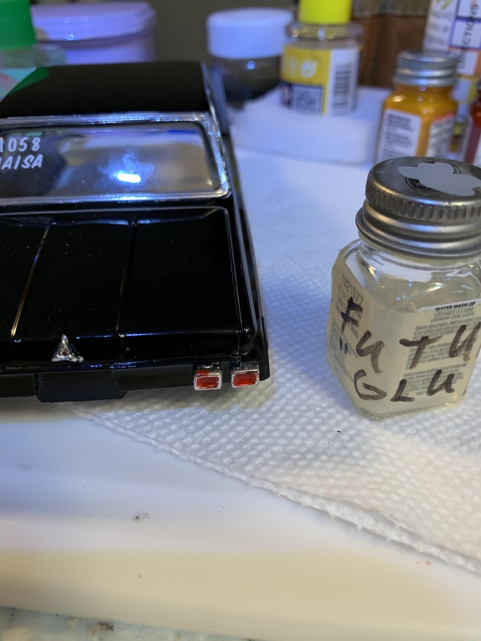

Had to trim some of the shift light for clearance. Tried thickened future to hold the tailights on. Didn’t like it and used ca instead. Need to clean up some paint off tailights. -

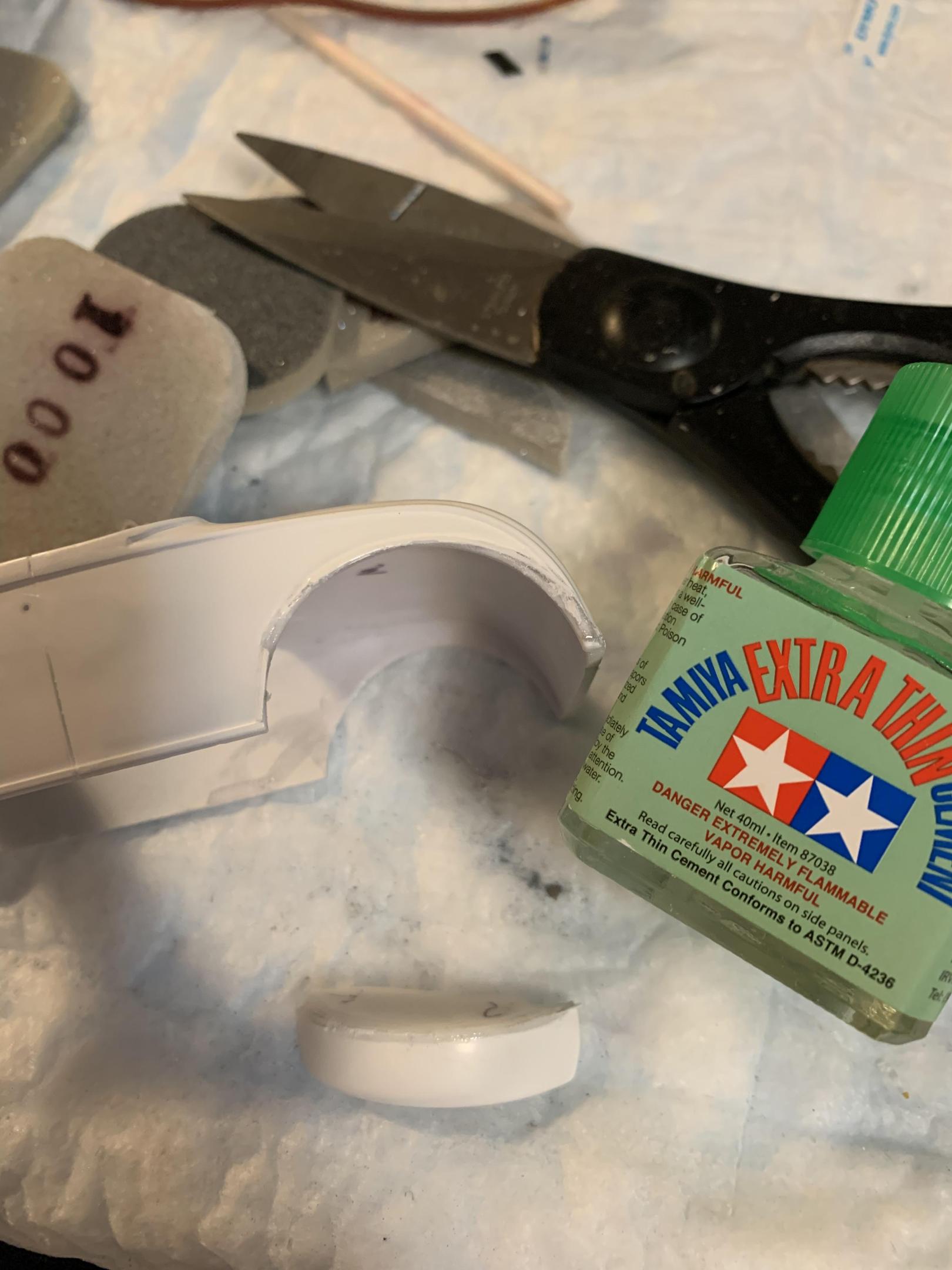

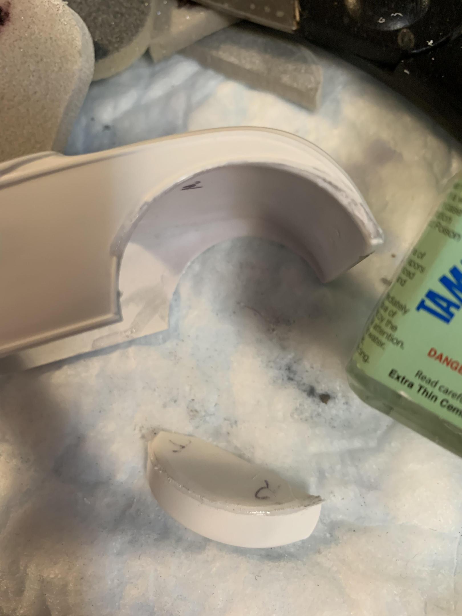

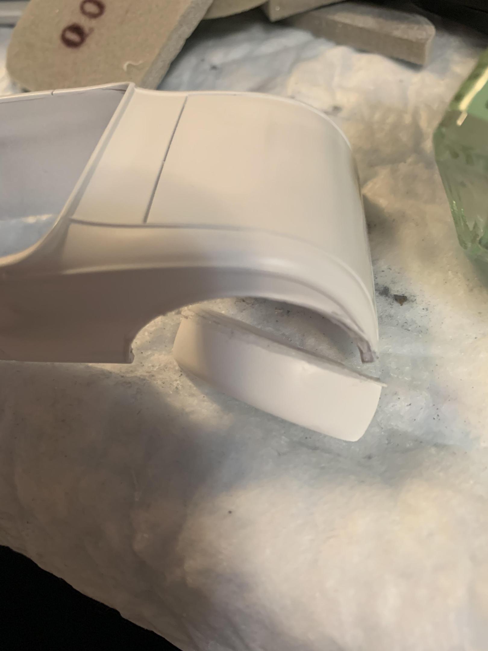

Don’t know where I had heard of this “technique”, but gave it a try. Had to use a different body (don’t ask) and didn’t want to go to the trouble of making another set of bobbed rear fenders. These were fastened with Tamiya extra thin cement and removed with the same product. I simply flooded the area where it was fastened originally with cement, let it sit for 3-5 minutes, and pried it off with my fingers. I had tried this before applying cement, but it would not budge. Stands to reason the cement would “melt” the original bond. Anyway, it worked for me, and the fenders and body suffered little deleterious effects.

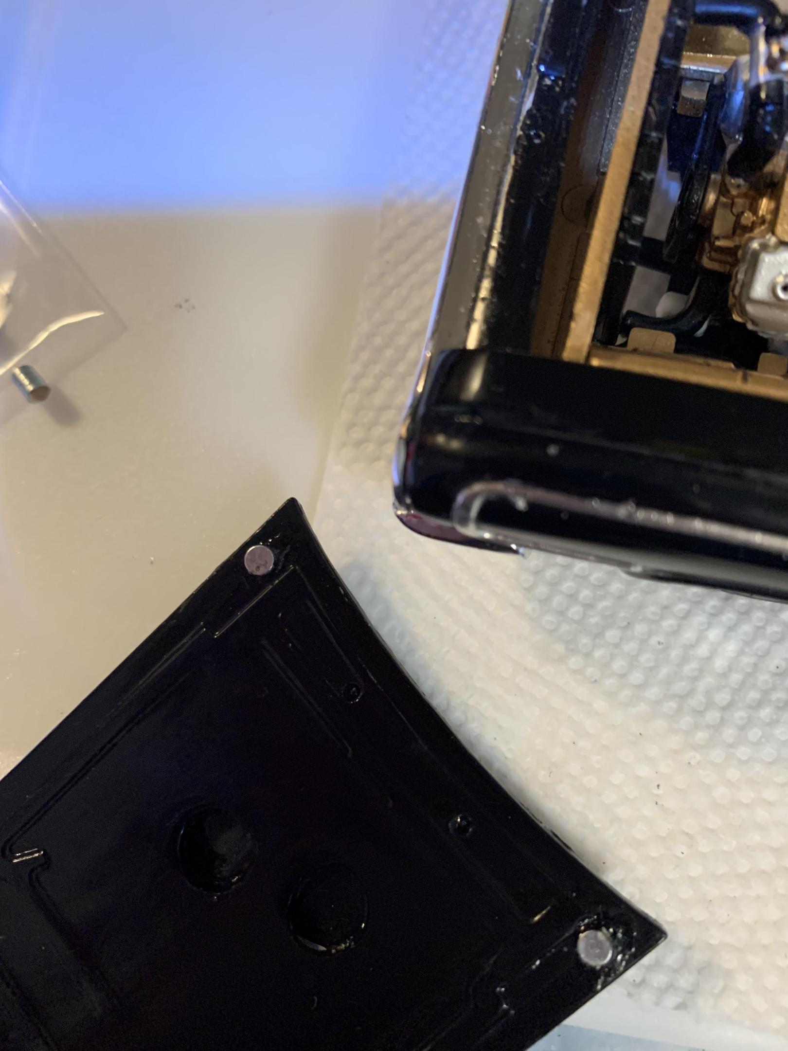

Nice, sanitary, white Dodge, Marcos. Thank you for the words of caution on the grill work. My grill is the single headlight grill, so may be different. I was going to work on that today, but discovered a goof on the rear panel and had to fix that. This is the 3rd Ramchargers kit I have built and I somehow succeeded in gluing the panel on upside down. I was ready for major surgery, but, luckily, it popped off with just some firm pressure. I credit the ease of disassembly to the Ammo by Mig cement and tiny brush included (doesn’t flood as much cement on as Tamiya’s brush). No noticeable damage. Glued it on correctly, did some paint touchup, and set it aside til tomorrow (good excuse to work on #4). Well, my exciting New Years Eve party of model building awaits. Thanks again, Marcos, and happy New Year everyone. -

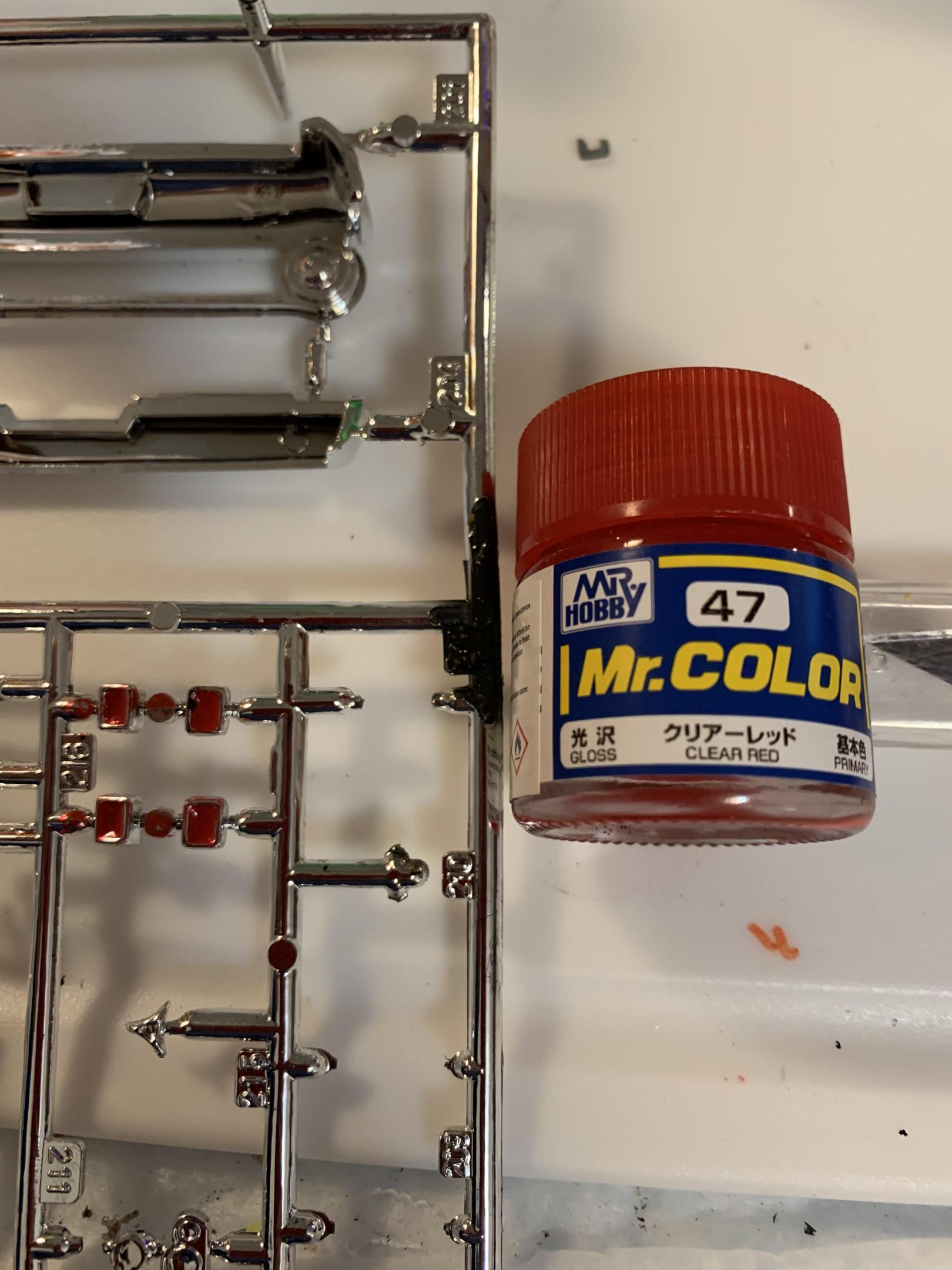

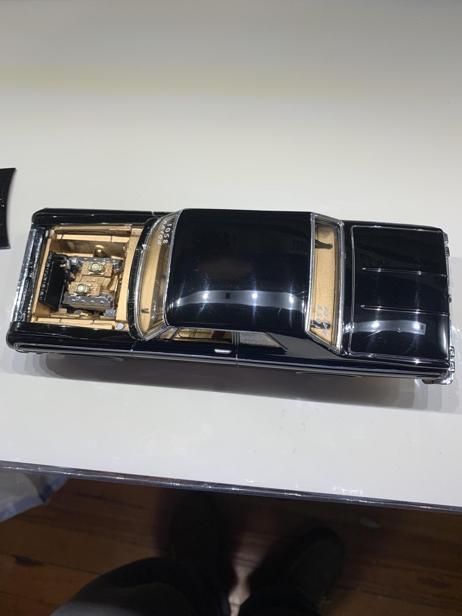

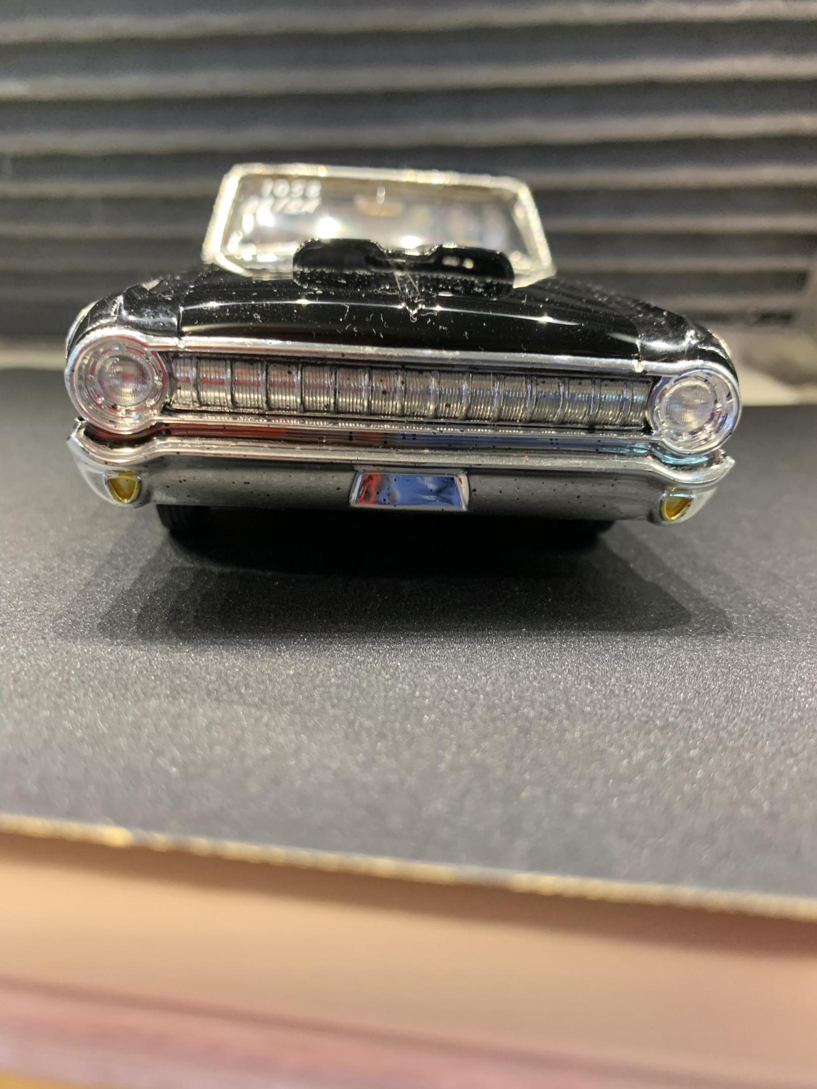

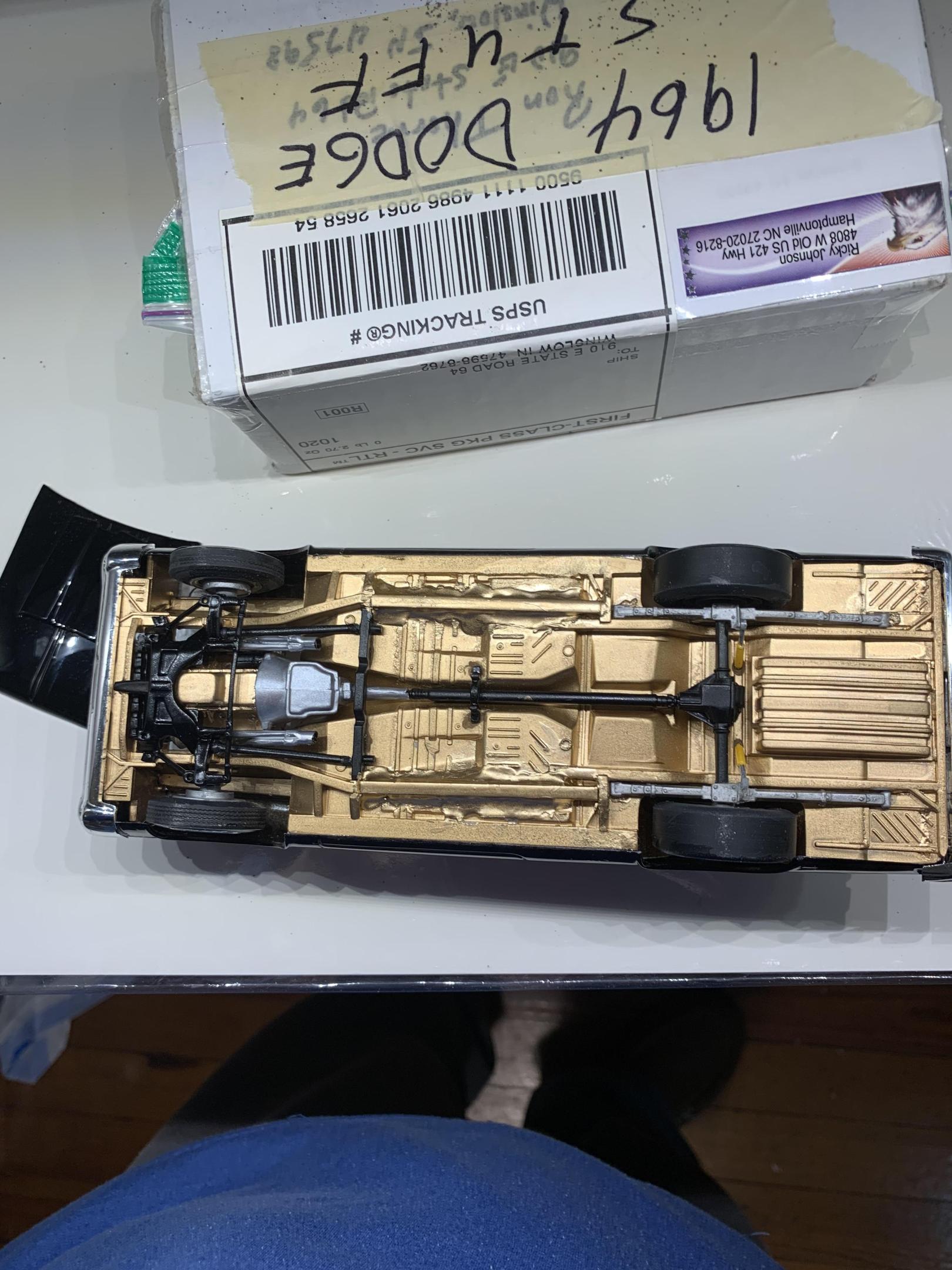

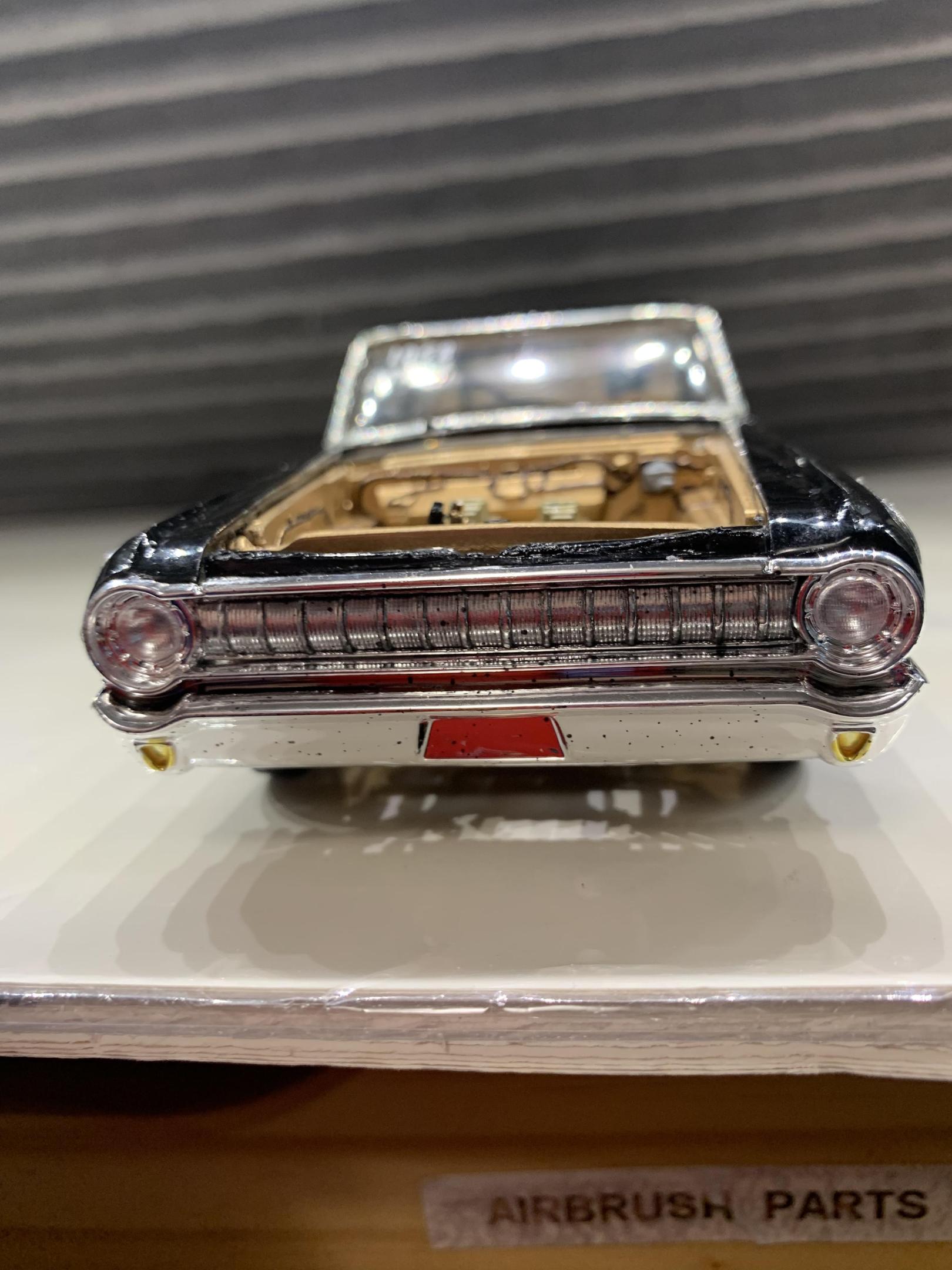

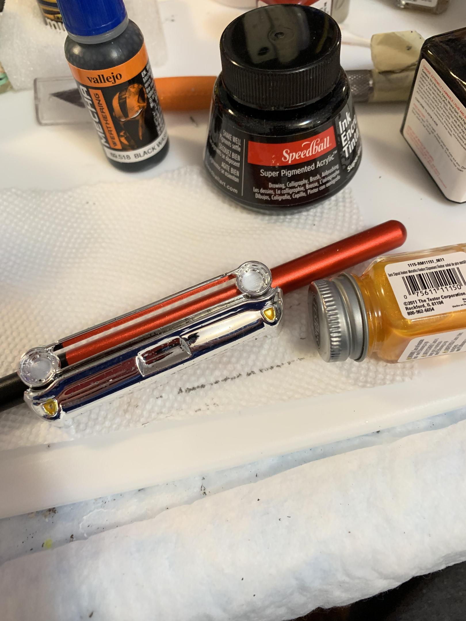

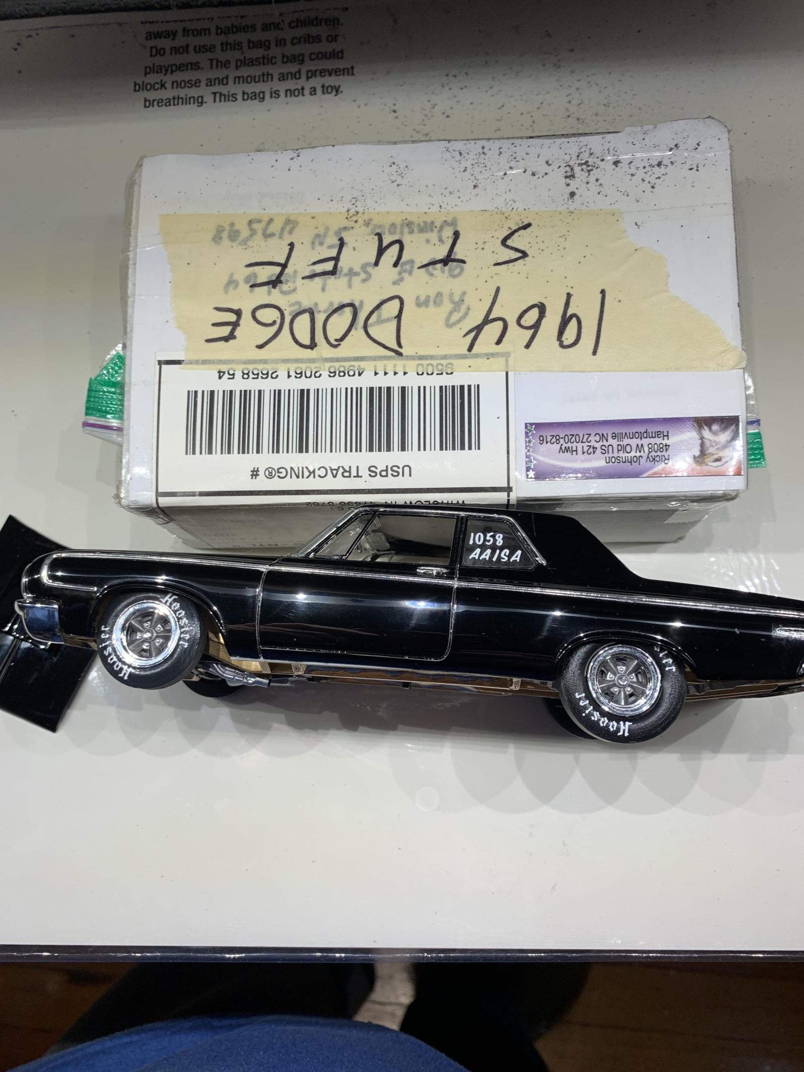

Did the headlights and front turn signals. Used testors turn signal amber. Tried to narrow the thickness of the rear turn signals for a more accurate appearance. It was a complete failure (tried sanding first, then cutting with my nippers). Gave up on that painted some spare ones (this time with Mr. Color clear red, not Testors stop light red). Trial fit of body. -

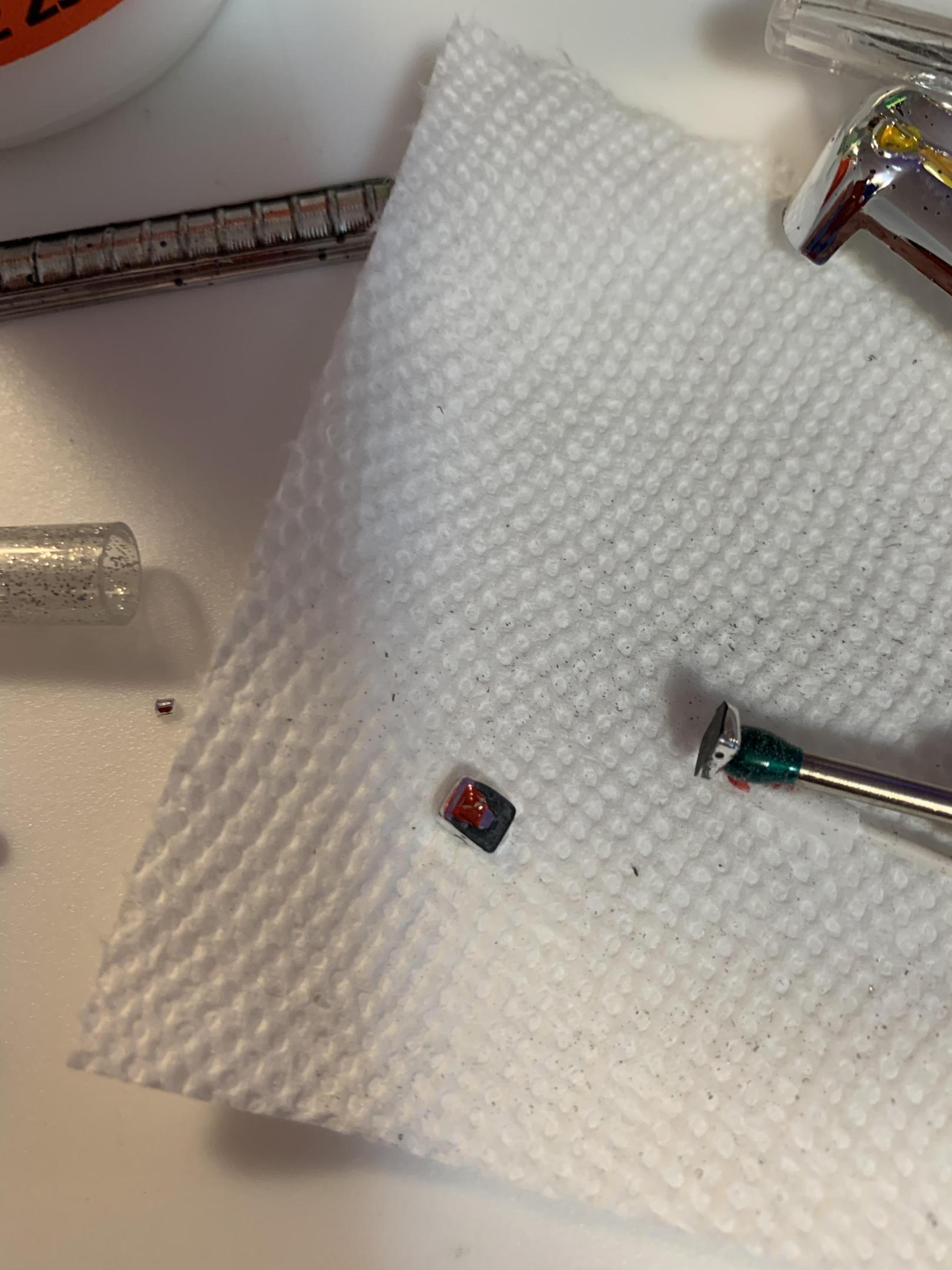

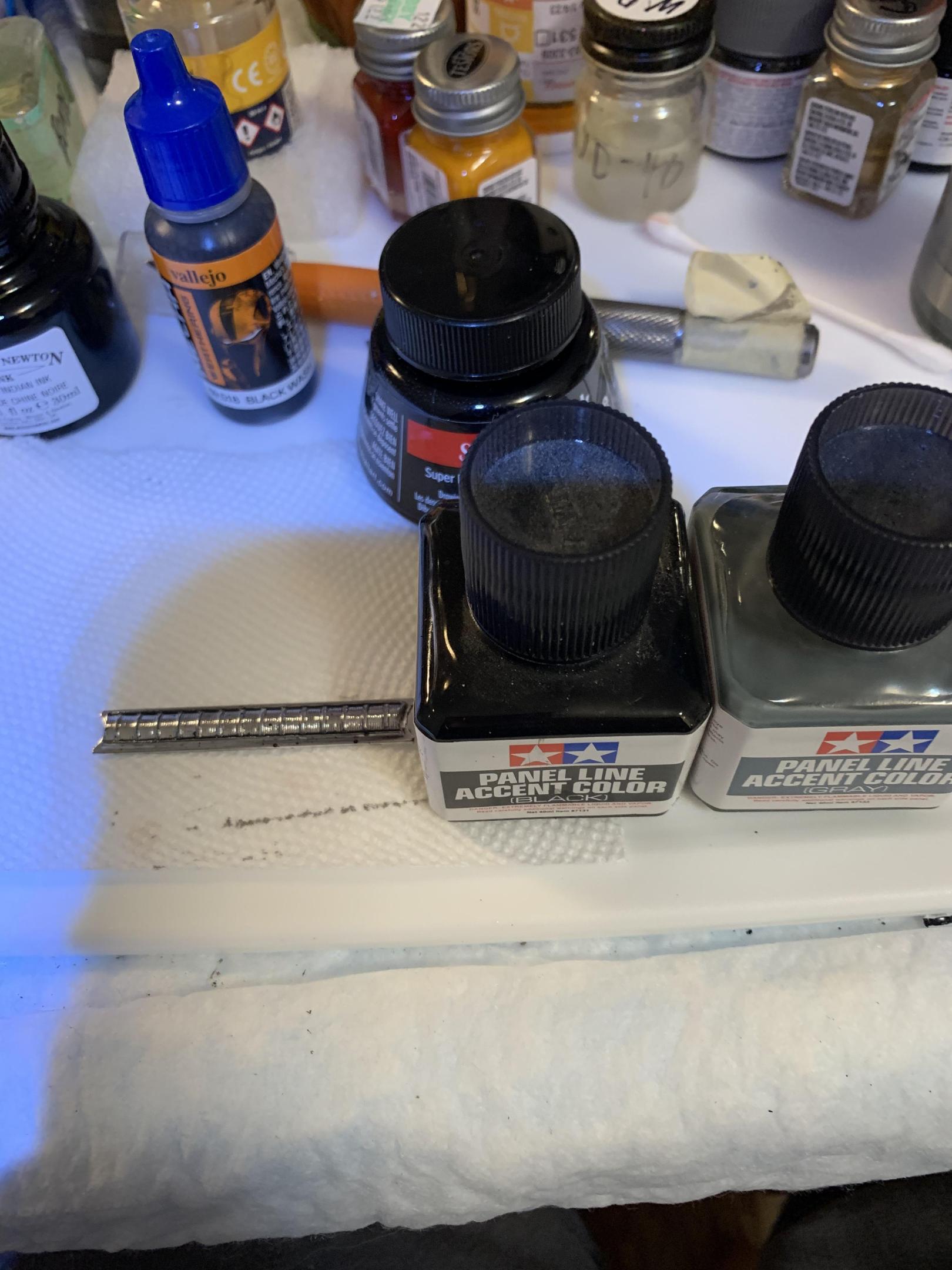

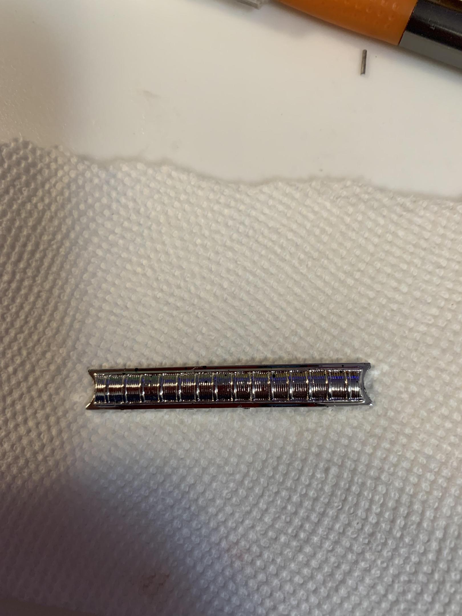

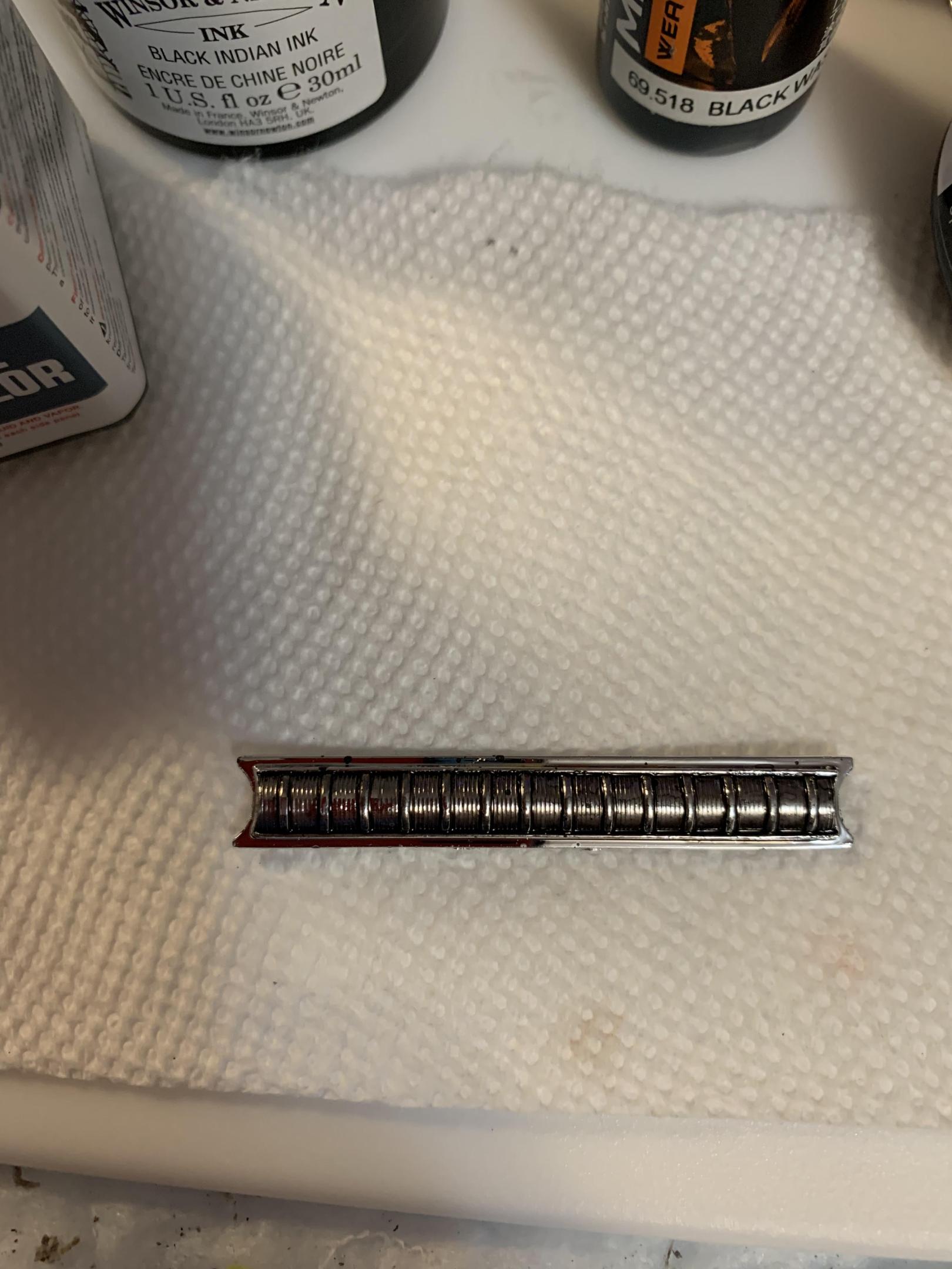

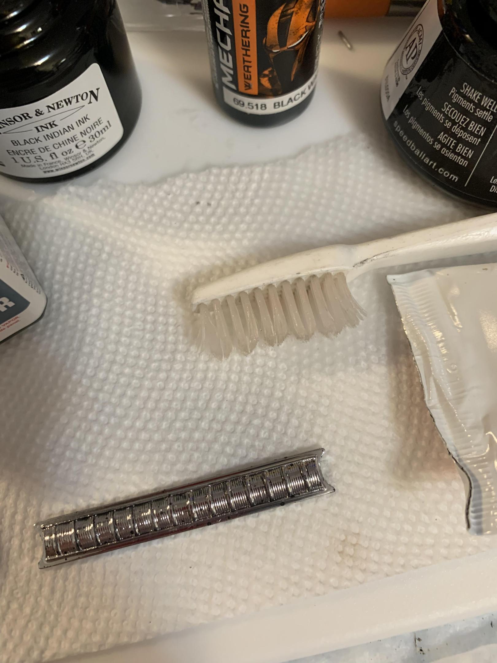

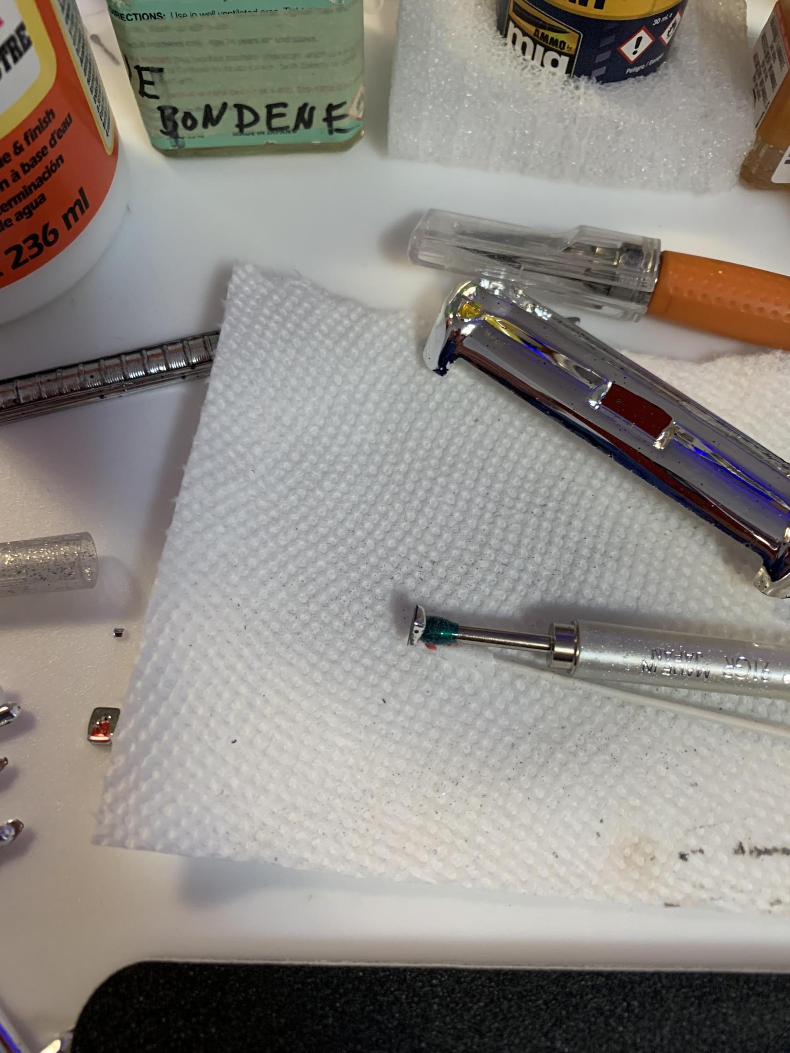

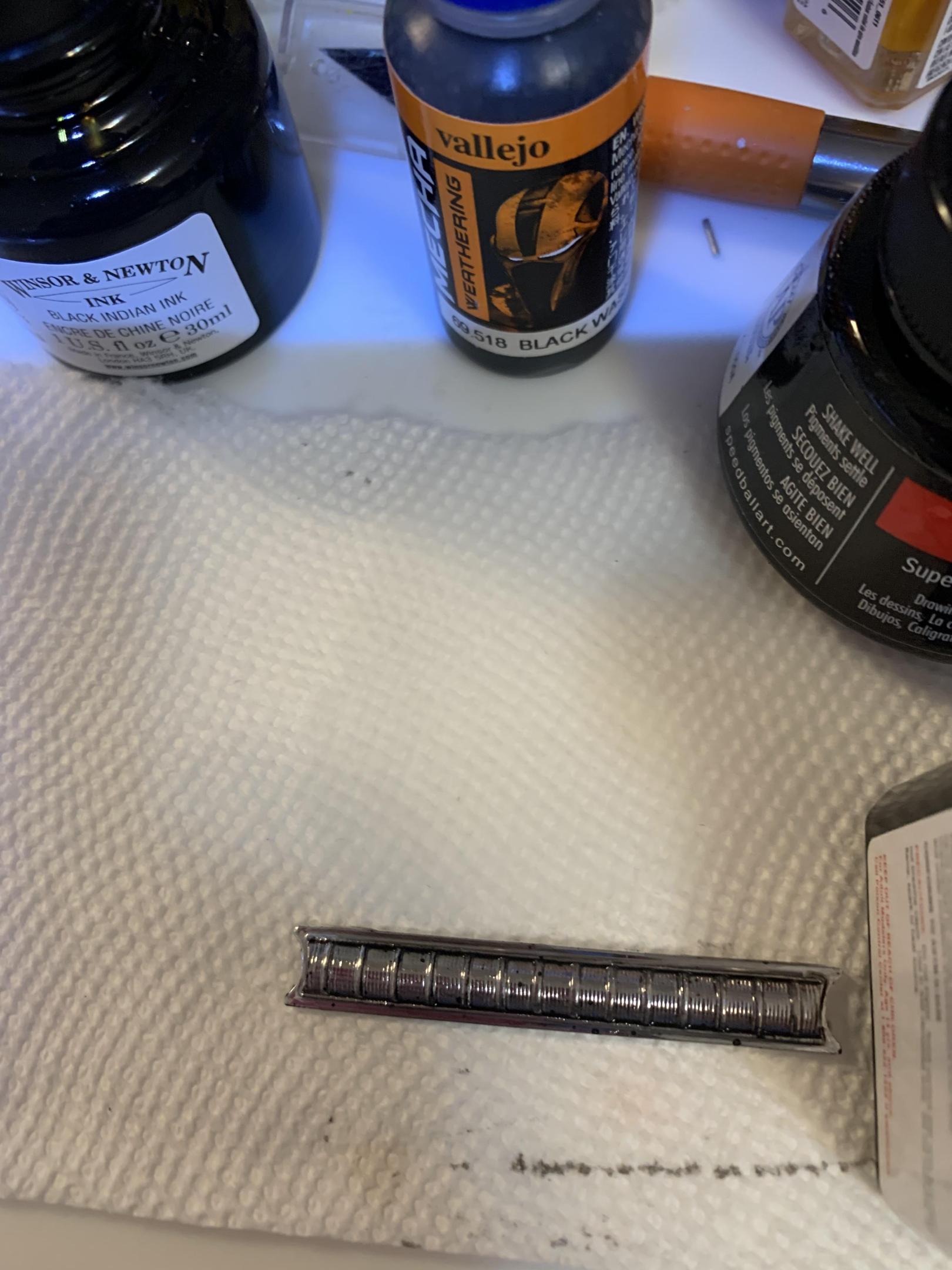

Tried to calm down the “shinyness” of the grill scrubbing with tooth paste and then applying Tamiya black then gray wash. Well, it looks a little better, anyway. Tried out a new Dspiae pen applying the wash and painting the tailights. Doesn’t flood as much as the Tamiya brush and allows more pin point painting. Will also use it for applying wash to door and trunk panel lines. -

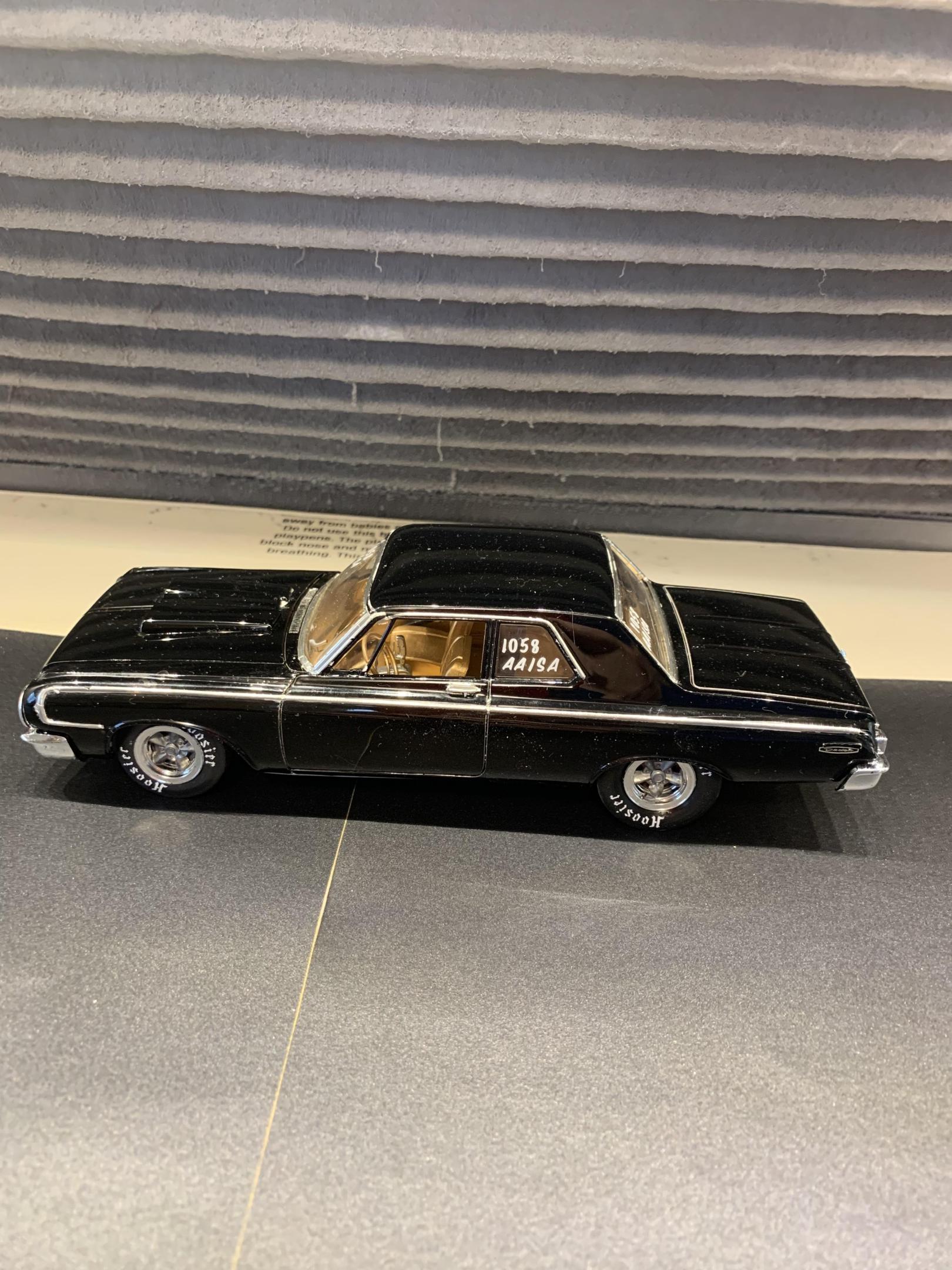

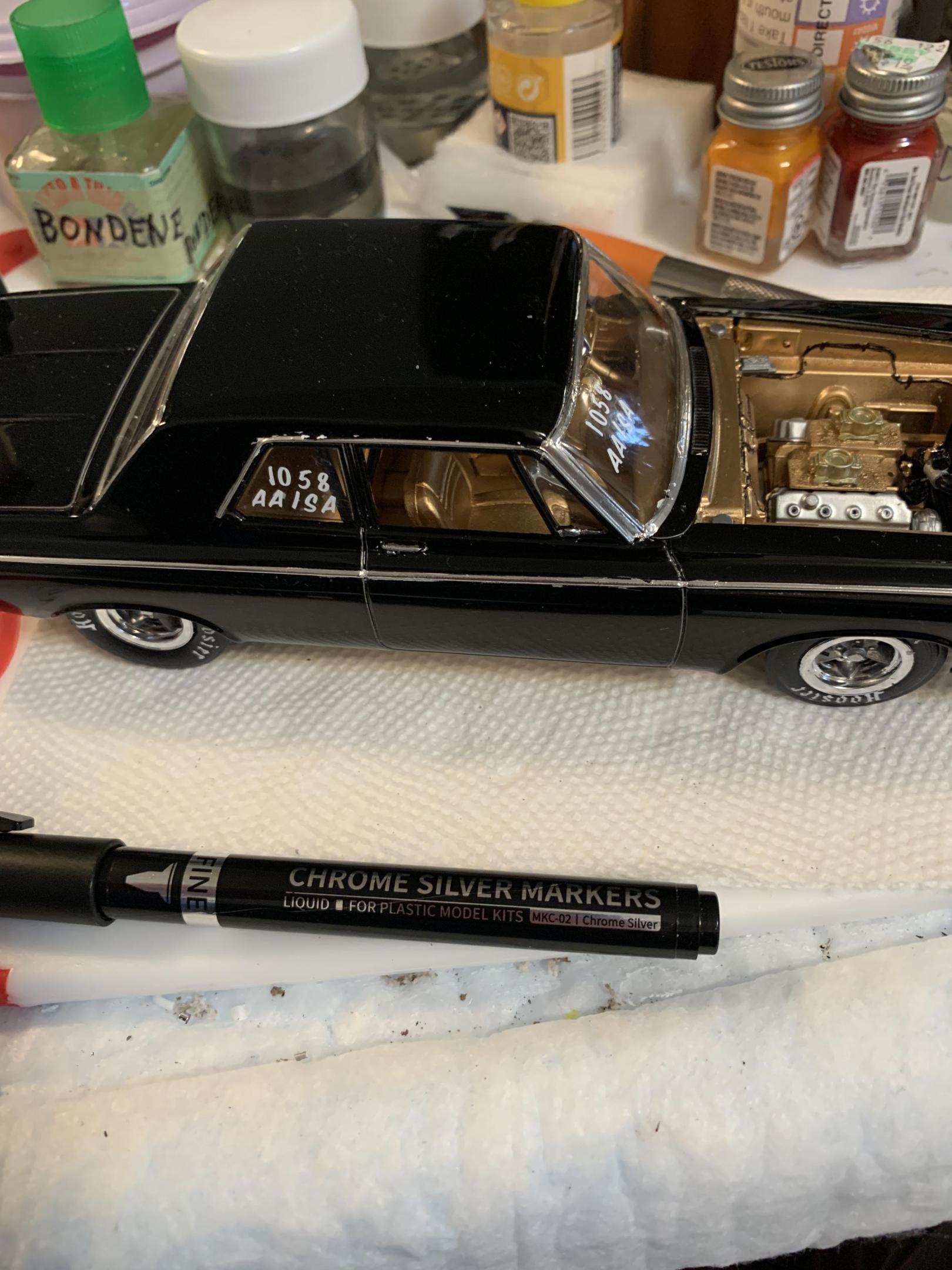

Blasted bare metal foil adhesive. About ready to make my own like I used to. Anyway, picture doesn’t really show how much adhesive was left on the body. Tried wd-40 (spray it in an old paint bottle and dip a qtip in it to apply), then wash off with Dawn and warm water. After 2 applications and baths afterwards, there was still some residue left. Took that off with Tamiya fine polish which is what I should have tried in the first place. Enhanced the shine some also, but probably not worth the effort, if not for removing the adhesive. Lots of lint on the car in the pics. Keep in mind this is Tamiya ts14 only, no primer, no gloss coat, just a quick Earl Shieb (old guys will know what I mean) type of paint job. -

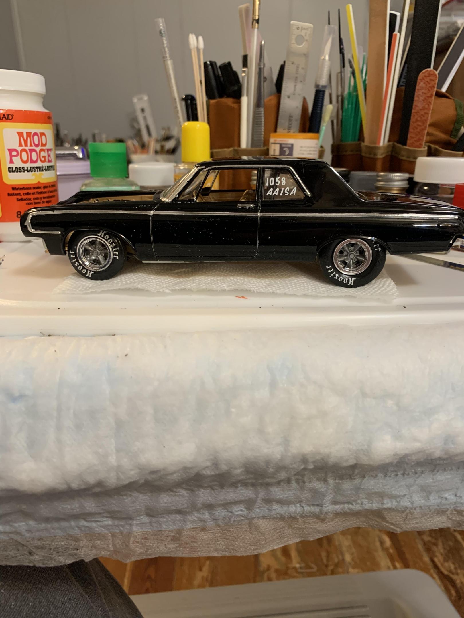

Put class letters/numbers on yesterday. Goofed up on first back window, as I put them on facing towards the inside. I was able to salvage some of the numbers by soaking them with decal solution and reapplying. Much easier to apply them before installing the windows, but have to be alert as to how they are installed. -

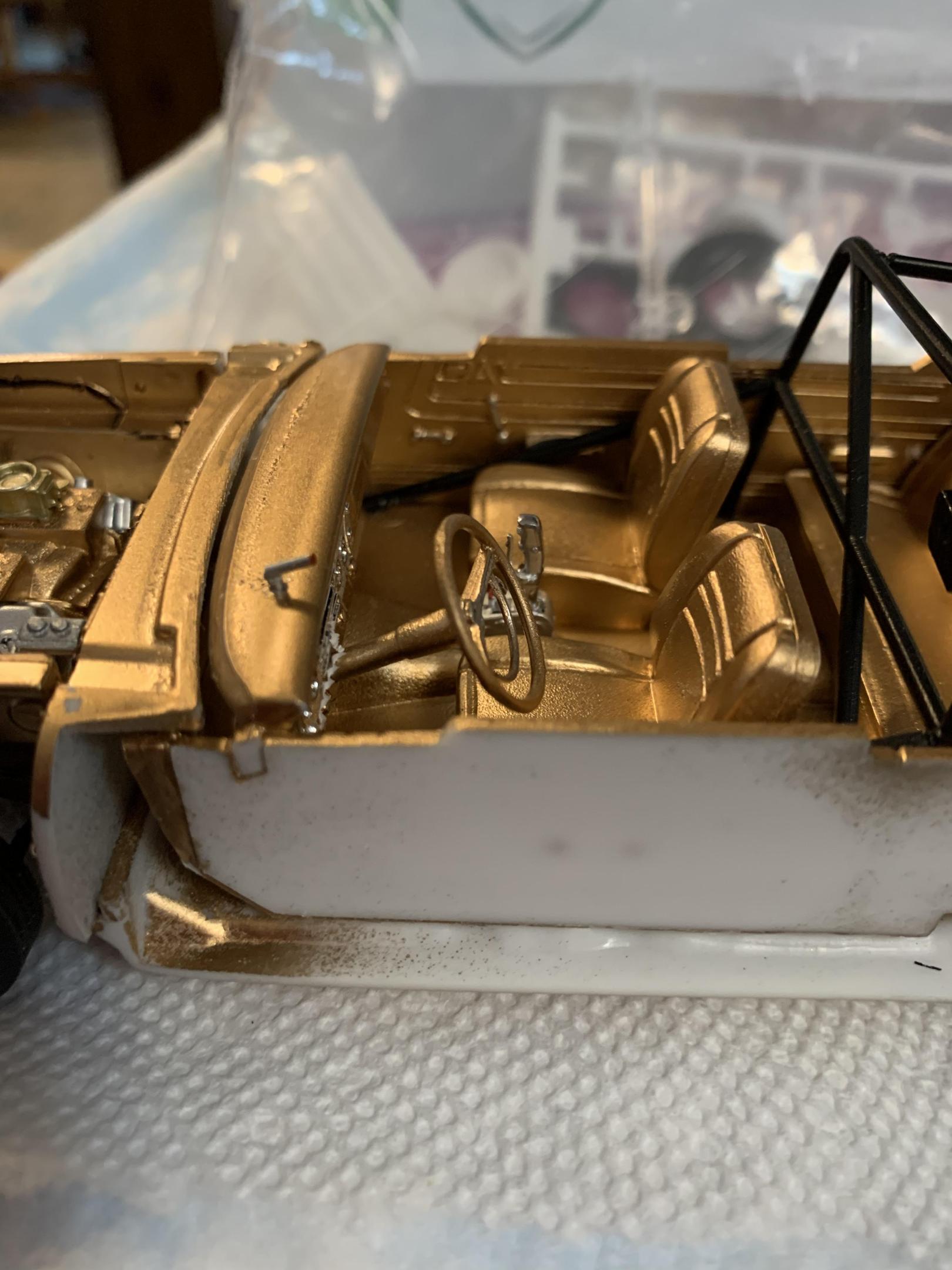

Tried a couple of things different. Scratch built a chiller valve, installed in the upper hose, used for cooling down cars between class eliminations. Made it from a front stabilizer bar. Also, built a shift lite, installed on dash. Some guys use these in lieu of a tachometer. Last thing was a head rest, installed under the top of the roll bar on driver’s side, of course. Also, perhaps most importantly, discovered something that may help with installing bare metal foil. Initial tests are promising. More on that next time.
