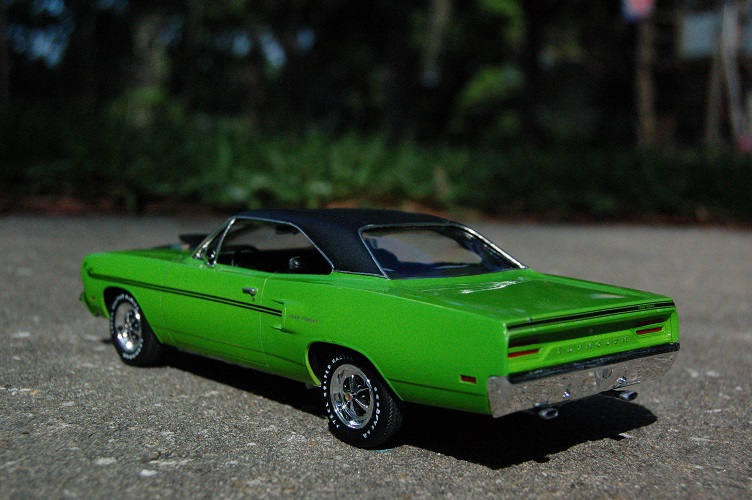

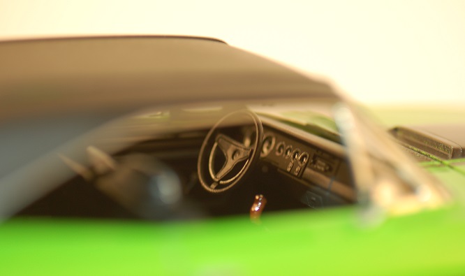

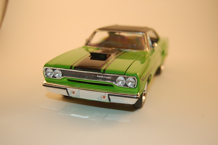

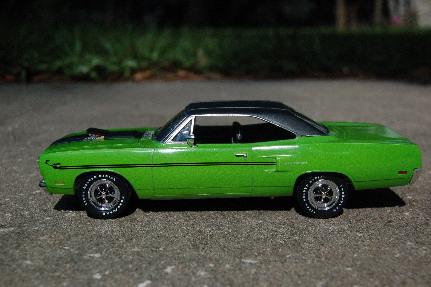

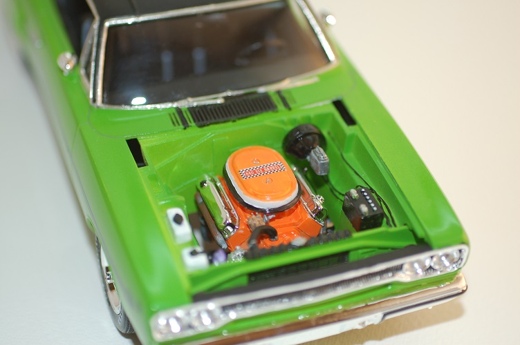

  24. I think you're right. I noticed it looked weird after I painted the top but the green was already done, so I decided it was too late to turn back. Next time I will have all the construction work done on the top before I shoot any paint.
  25. I just finished this one for a club build. My first experiment with a vinyl top, and I learned a lot. After much experimentation with the paint, I settled on Valspar rattle can flat black #86001. It was shot from about 3 ft. above the model. The styrene strips on top are a bit too thick - lesson learned. I used bits of monofilament fishing line to make the trim between the quarter window and back window, and covered them with BMF. Paint is Gravity Colors Chrysler Sublime Green. 10 coats of Future were used as the top coat, and hand rubbed to a glossy shine. By the way, NOTHING sticks to Future, including decals, which I learned the hard way, and CA glue, which is a good thing. The model is basically box stock except for the Beep Beep horn and a more detailed distributor. Comments and suggestions are welcome.
