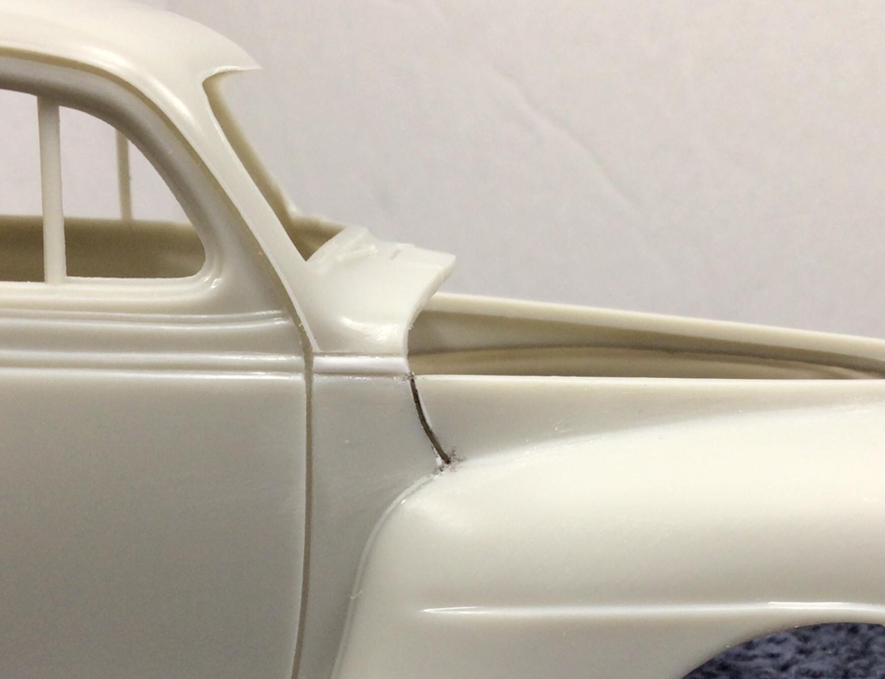

  2. Thanks Jim.? I certainly don’t mean to shame anyone into anything. We all have our own limits as to how far down the rabbit hole we want to go….it could be endless with some kits. Another inaccuracyon this one is the cowl vent which should be separated from the hood opening. I think I will just ignore that one though. I thought about scribing in a new leading edge, but that would make the vent too skinny and may look worse.? I’ve had cold bent styrene snap as soon as the Tamiya cement touched it so I intend to heat the welting with my hot air gun to get it to conform before glueing it.

  8. On a positive note, I filled the seams between the hood and fenders and re-scribed them with the proper curve more or less. I also added a piece of 0.30” half round to the molding just ahead of the passenger door, and I think I’ll do the drivers side too. The hood is just a tad wide at this point and those moldings being recessed like that make it seem worse. I’ve sanded off the original fender welting and when I get back on this I will try to scribe the line for the new welting which will be 0.020” Evergreen rod. I will likely just paint it body color.
