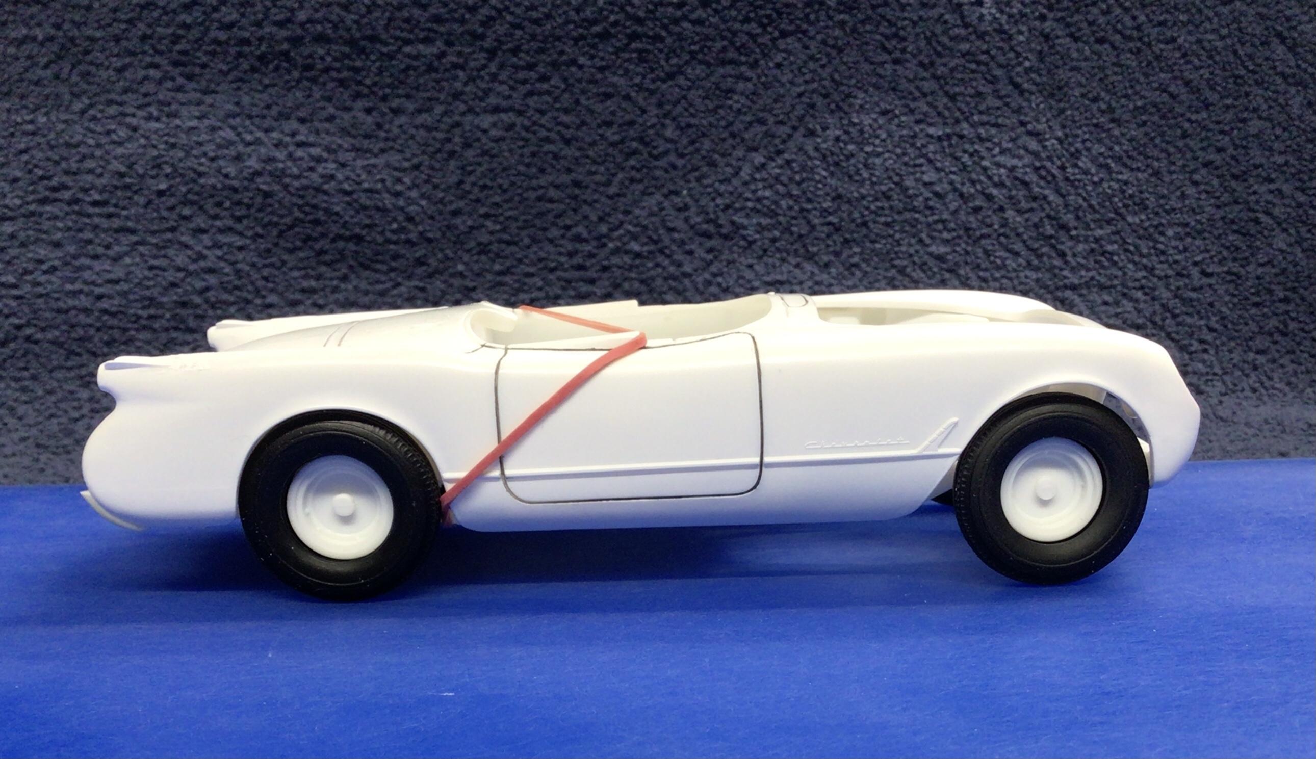

Yeah, talk about a loyal bunch of customers!? Thanks. There are lots of little issues to fix on this one.? Thanks!? Yes Dennis, it looks like the frames are identical. I definitely have some suspension issues to sort out.?

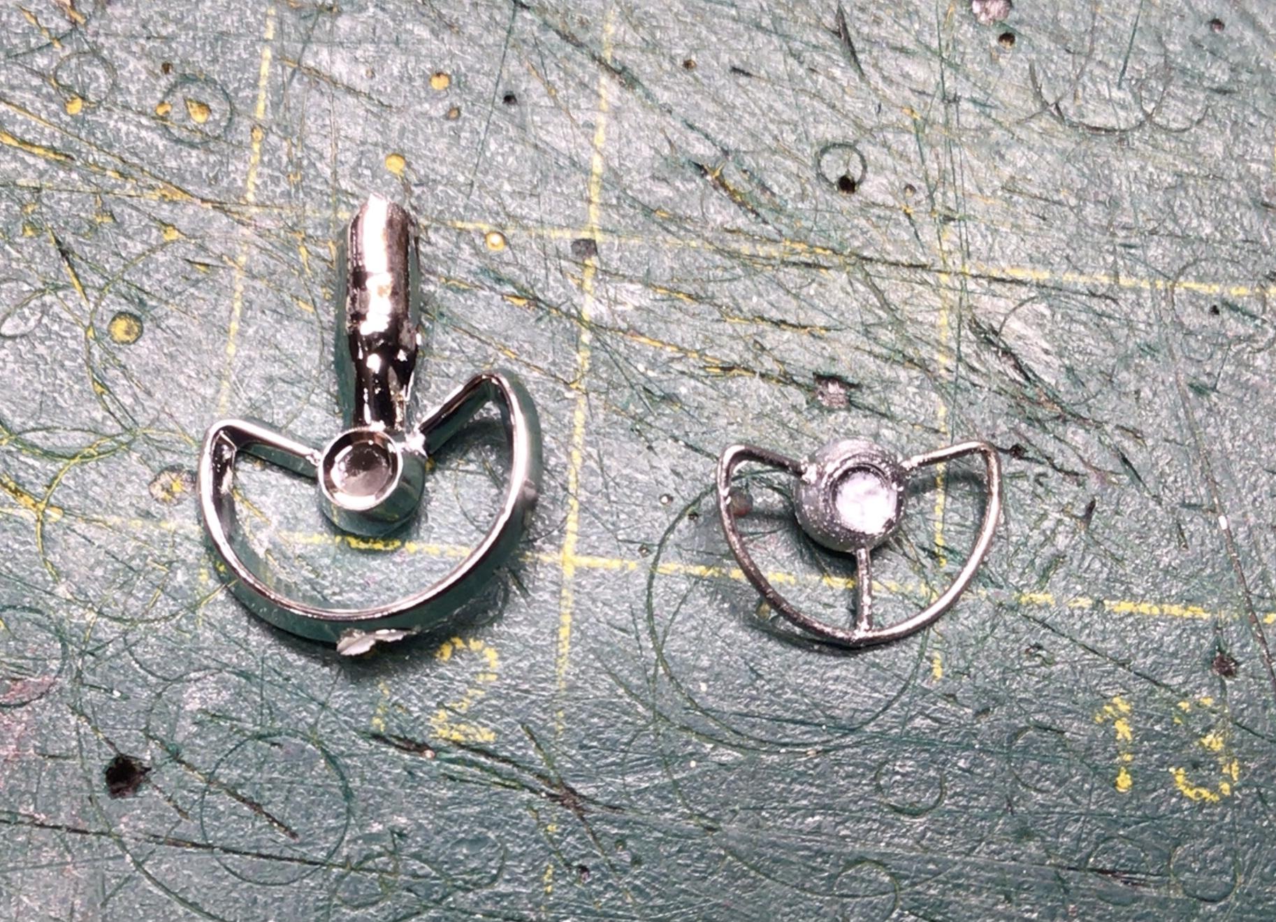

Thanks Justin.? Yeah, well they did originally make these kits for kids I believe who are probably a little less obsessive.? My second attempt at a horn ring… Edit: I actually wound up using my first attempt, which at first I thought was too large on the diameter.? Horn button is just printed off the internet.

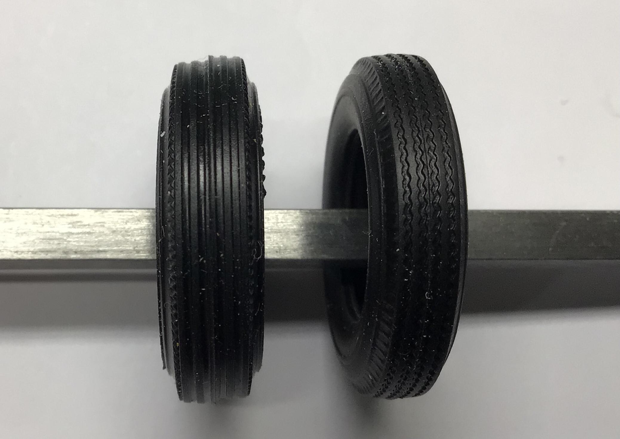

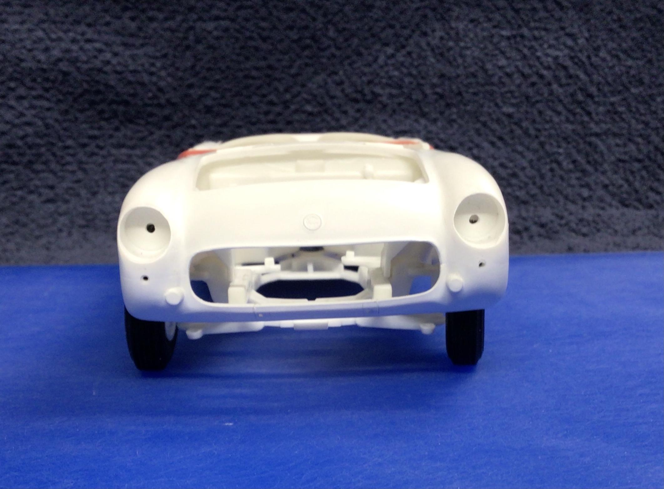

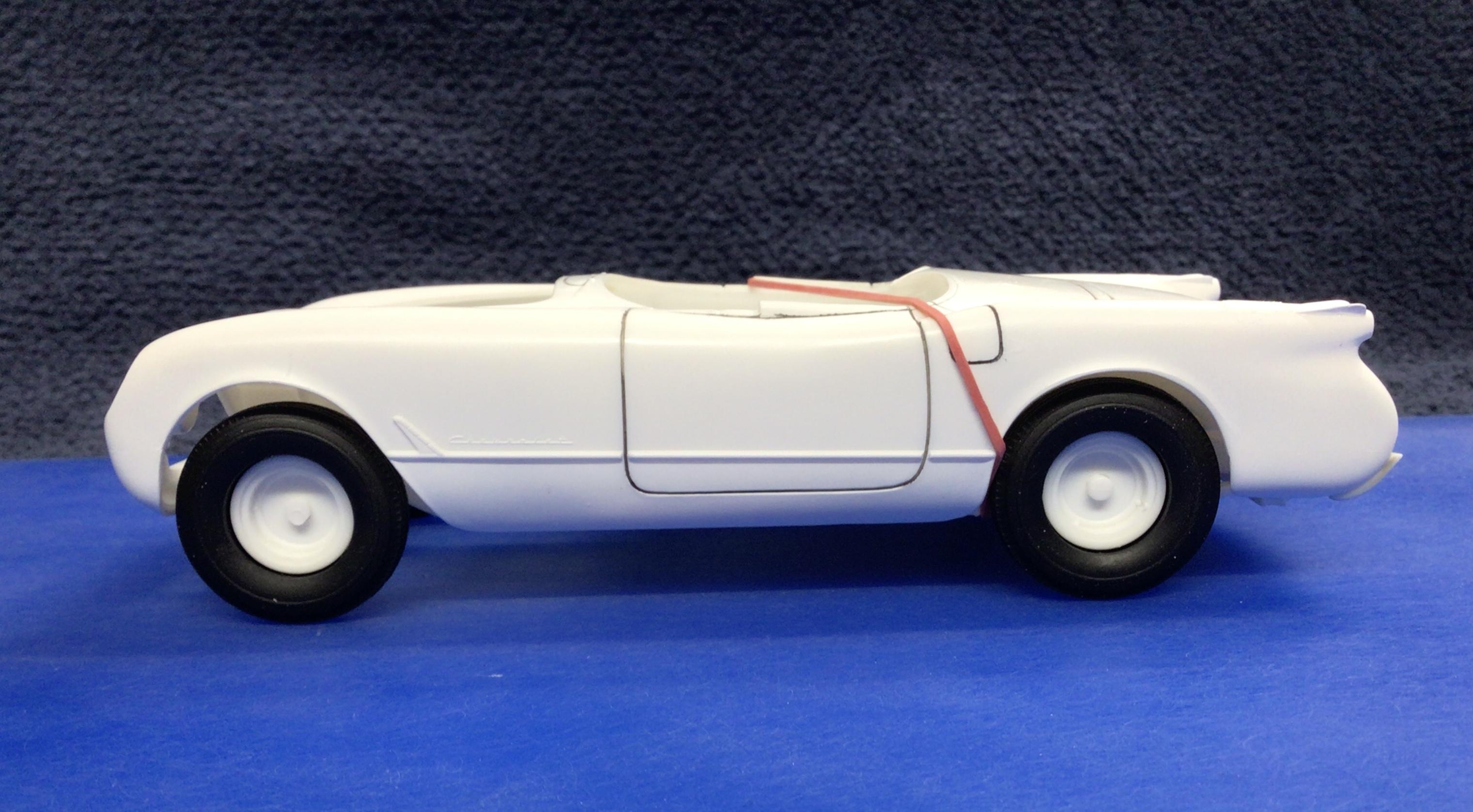

I am going to use the tires from the Revell ‘62 Vette. The Revell ones have nicer tread and AMT molds were not perfectly aligned, so the tire halves are offset slightly.? The ‘53 rims will fit thankfully. I did do a mockup, and as Garry said, the front is way too high. I do have a twist in the frame also that I will need to rectify. I figure the easiest way to lower the front is a set of dropped spindles (kingpins actually) and rather than modifying the kit pieces I am just making some from Evergreen.

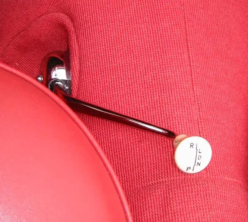

Thanks Sonny.? Thanks for the heads up Garry!? It is definitely way too high. Glad you’re enjoying it.? Thanks.? That is one of my pet peeves…shifters, signal levers, horn rings, etc.?

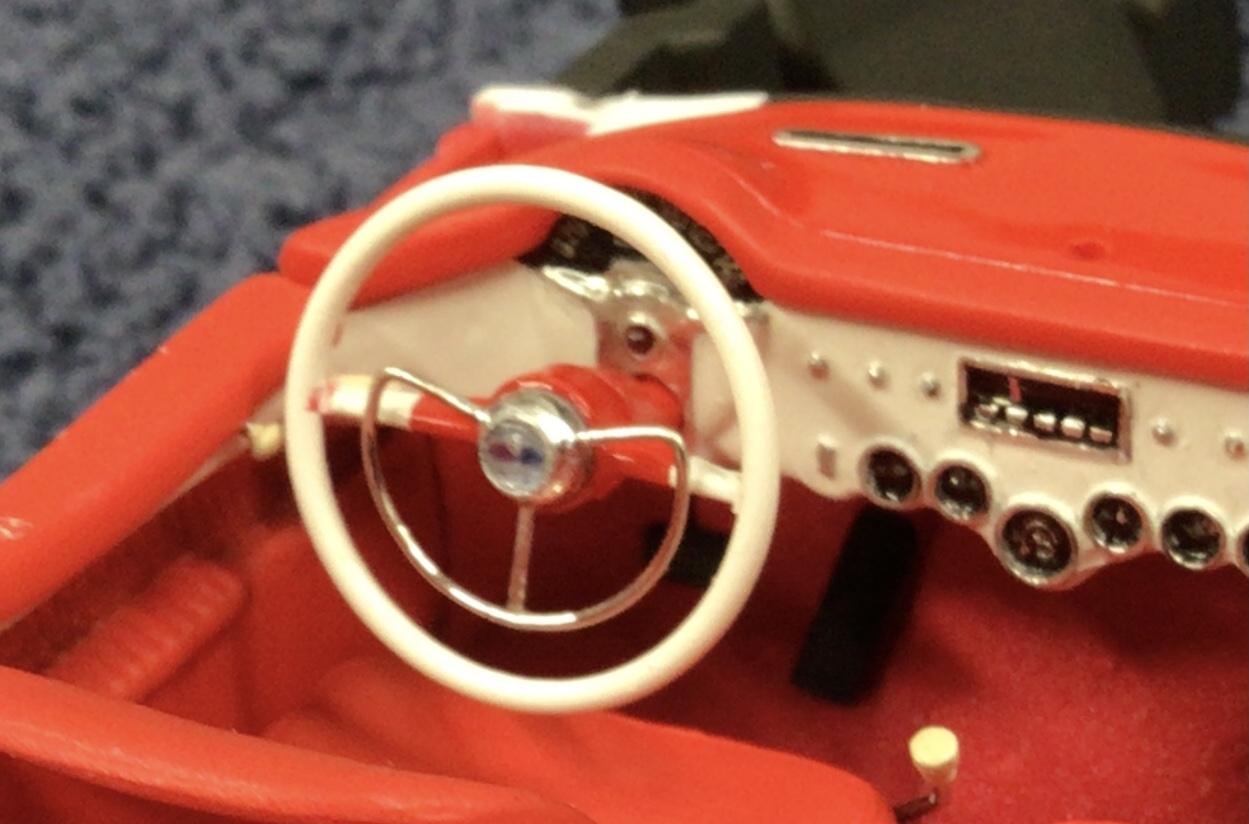

I glued some blocks under the seats and then mounted them on posts. Then I trimmed the seats so that they are not sitting on the floor. I don’t like the oversized shift lever or the location, which is too far forward on the transmission hump, so I scratch built one from evergreen and a stick pin. That’s all for now. Thanks for lookin.?

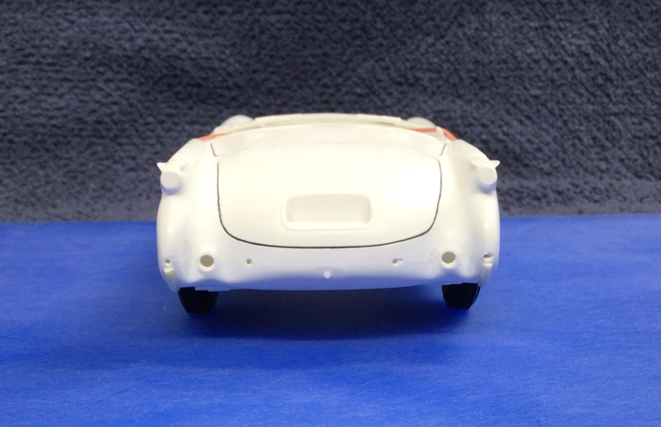

Thanks Joe…here you go.? The front bumperettes and LP mount needed a bit of reworking to fit in a decently stable manner. I added some top latches and did the panel liner. A bit more putty work on those little fins to get them looking more subtle.
