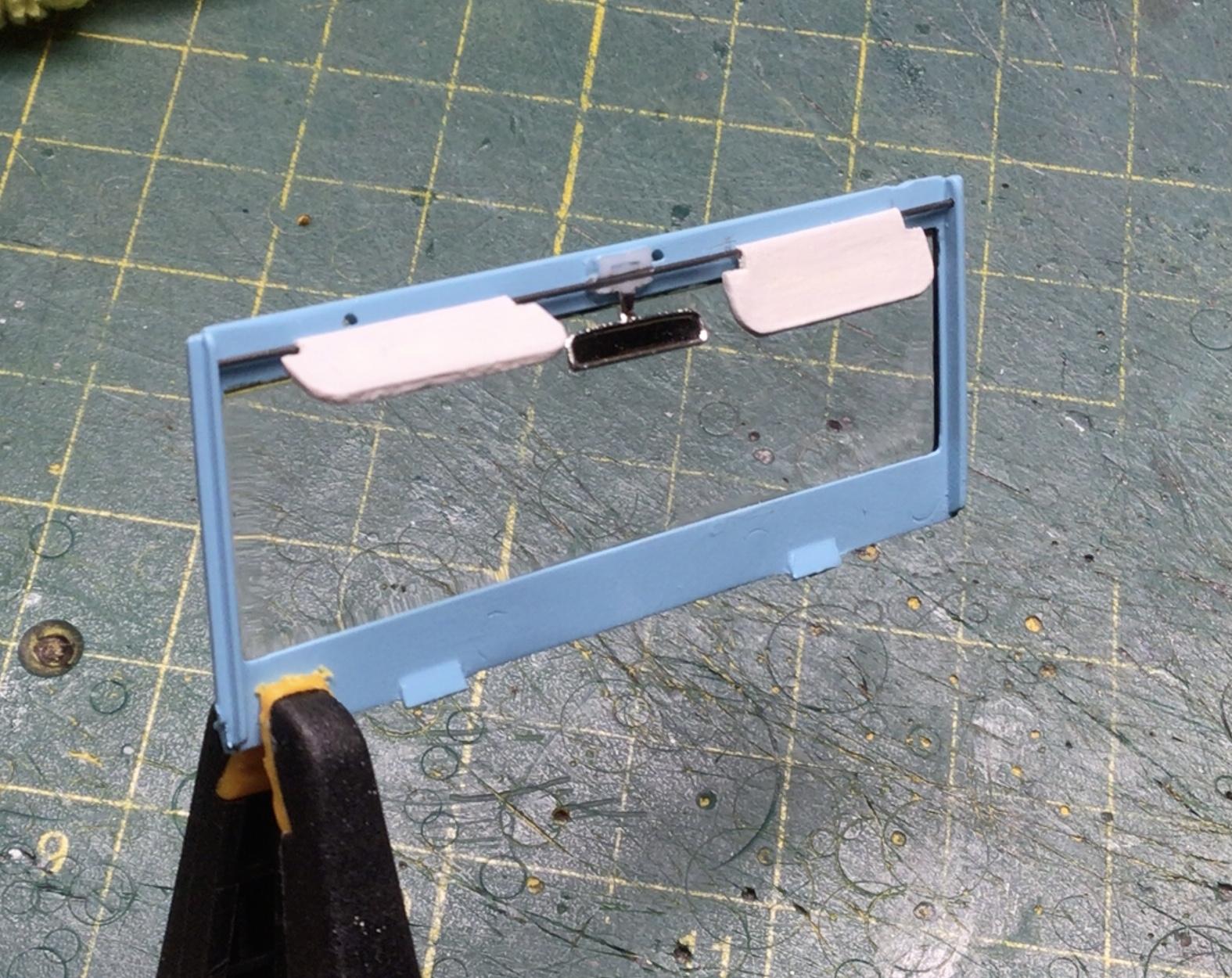

  4. I previously made these similarly on my ‘65 Chevy. The pin is not removable, but the visor will adjust…at least until the tape dries up.?

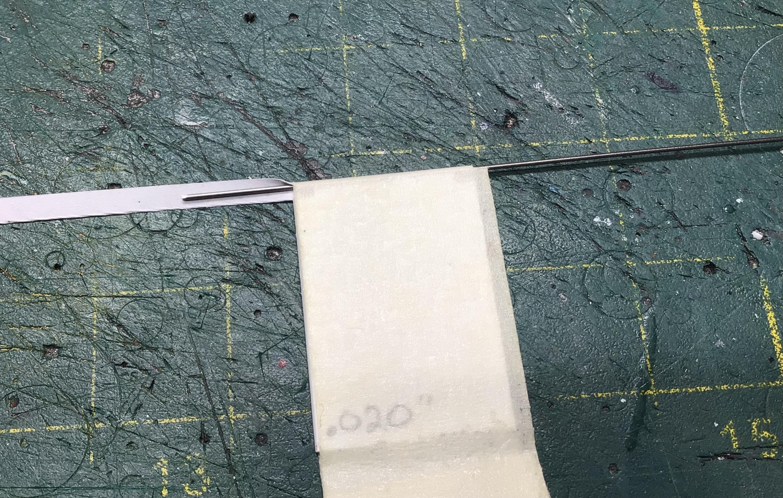

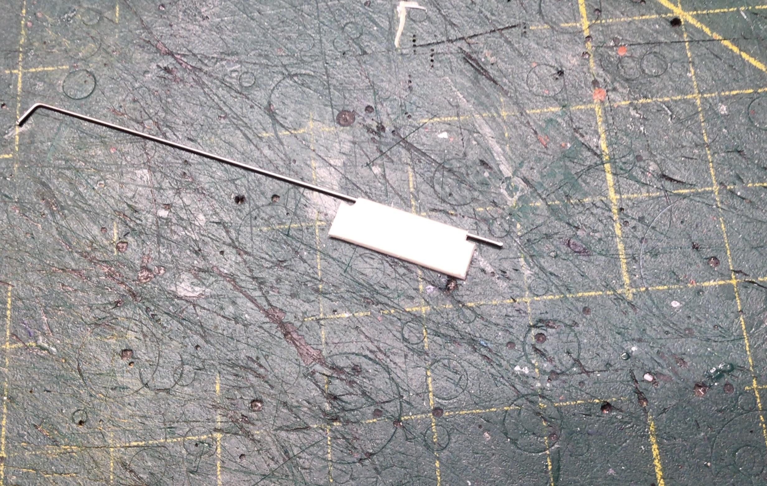

  5. Some kits have inadequate or no sunvisors, like this Revell Bronco. They should be attached to the windshield frame and not the removable hardtop.? So,I made some with masking tape and styrene. I am using .020” music wire and .020” styrene sheet. I put a narrow strip of paper across the sticky side of the tape, so the pin won’t be stuck, laid the wire and styrene down and wrapped the tape around it. A little trimming and shaping later.? The pin can be removed and replaced and the visor position adjusted. I coated the edges with some thin CA before paint in hopes that the tape will never let loose.
