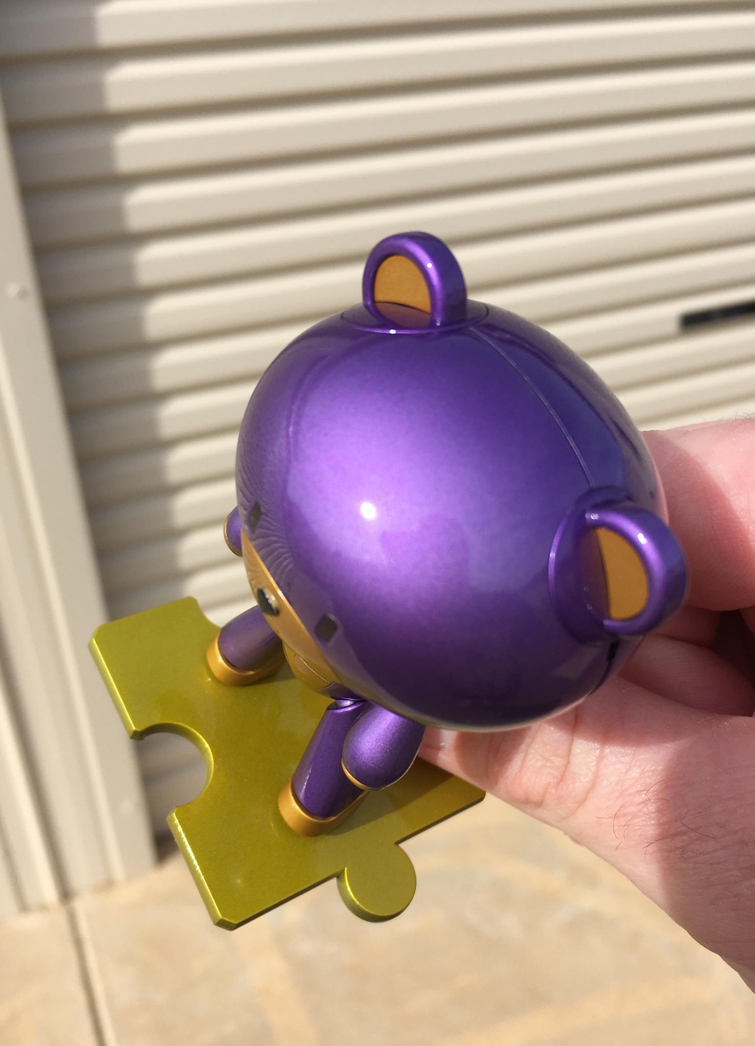

Spots on gold spray paint
Sandboarder replied to Hondamatic's topic in Model Building Questions and Answers
I normally just blow air to remove dust (airbrush or from mouth) I only wash after sanding or polishing if I need to remove particles. You could spray your clear coat 30 minutes after your last colour coat depending on paint thickness and it it’s the same paint that’s flashed off (normally won’t taken more then a few minutes) That would reduce the time/chance that dust has to settle on your model. -
I also think it because of the washing. Either step this step or shoot the clear coat closer to the last colour coat. -

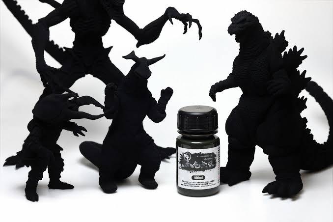

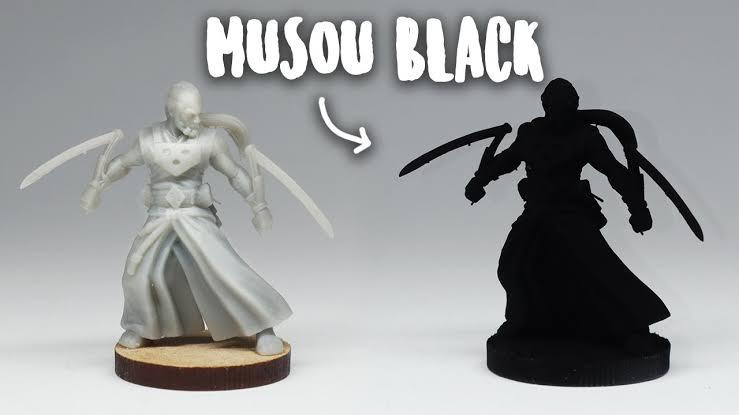

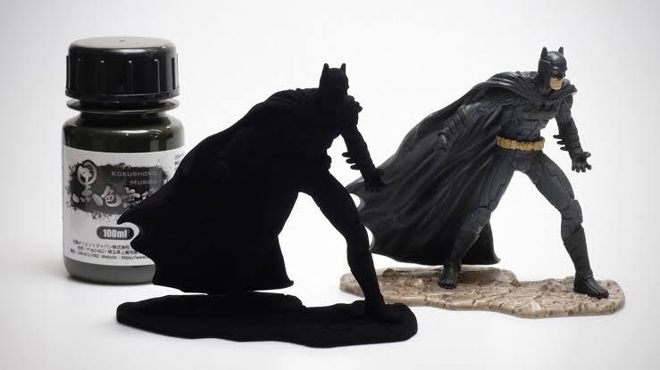

Not really what your looking for but it’s black and it definitely isn’t shiny, Musou Black. Ive just been leaving on flat black parts in Mr Hobby 1500 primer/surfacer. It has the right look for what I’m doing with interiors and chassis. -
