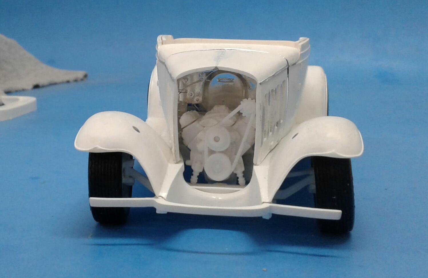

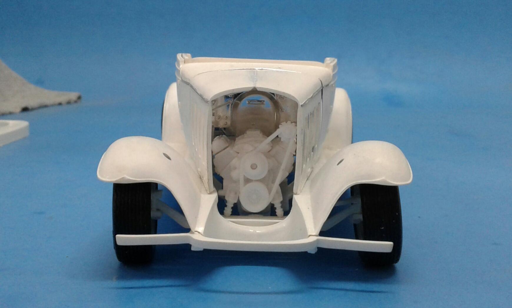

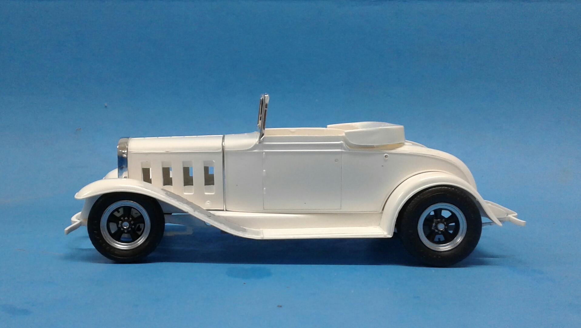

The way the louvers are, there's no way to add a blister without eliminating one or maybe two of them. To me, they make the Chevy instantly recognizable. Leaving the sides off will be a last resort. I'm sure I can get the engine stuck in there. It's just gonna take a little work. If I can get a Hemi inside the hood on a '34 Ford, surely I can get this little small block in this Chevy. -

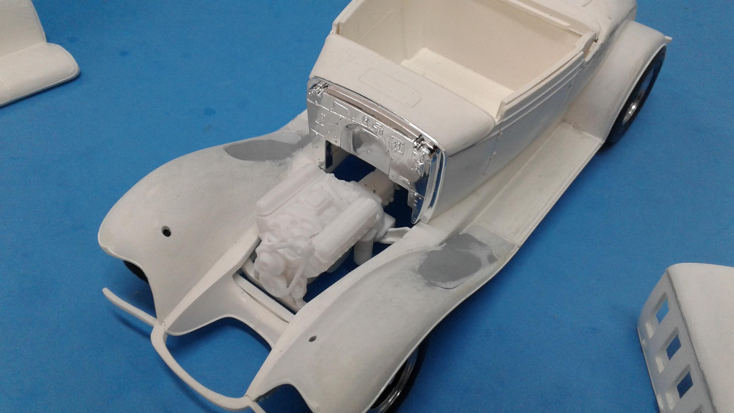

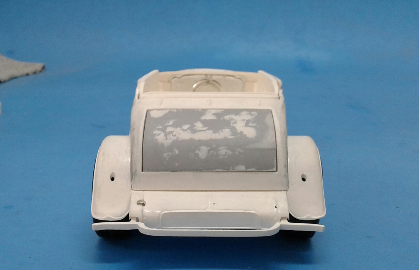

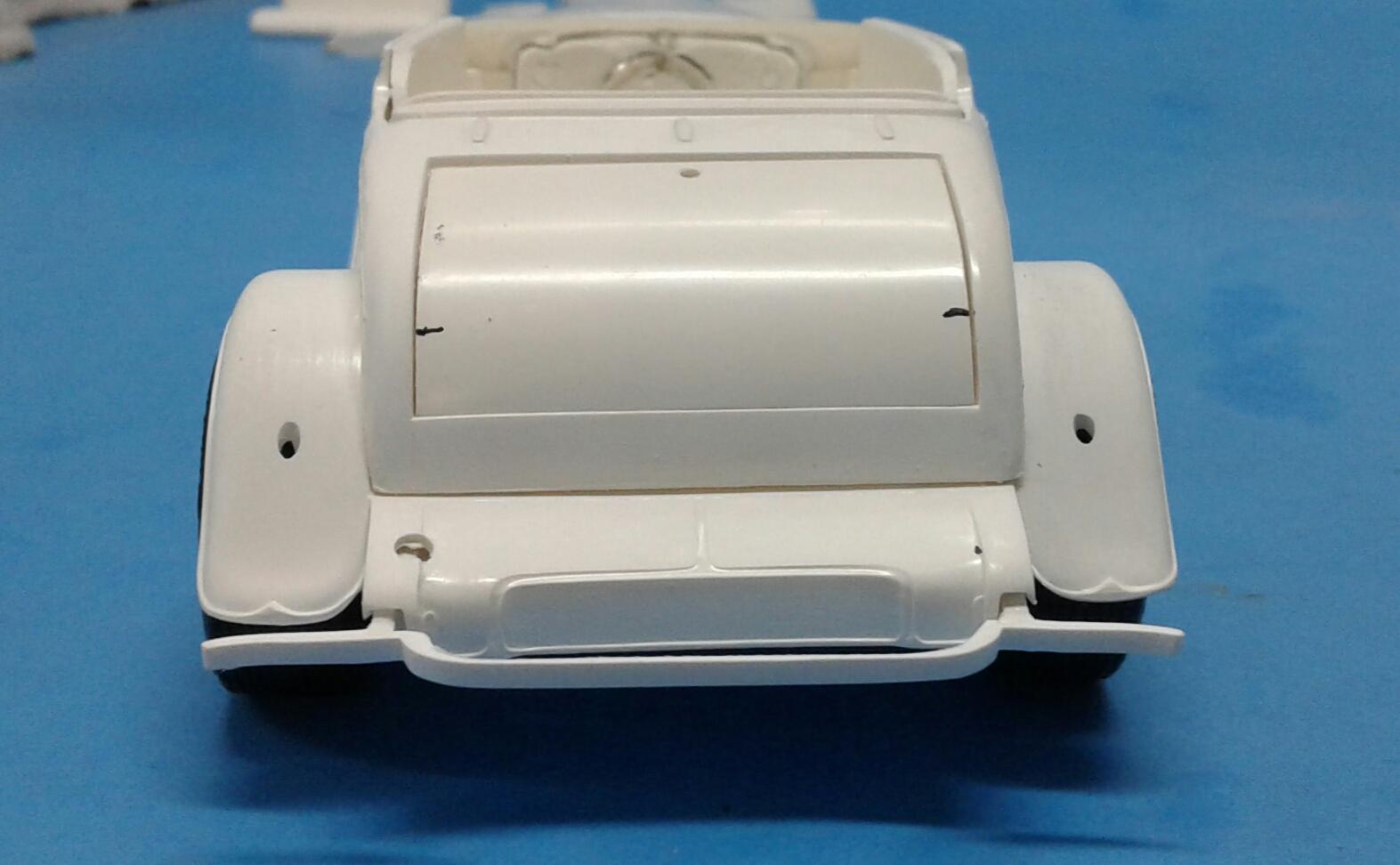

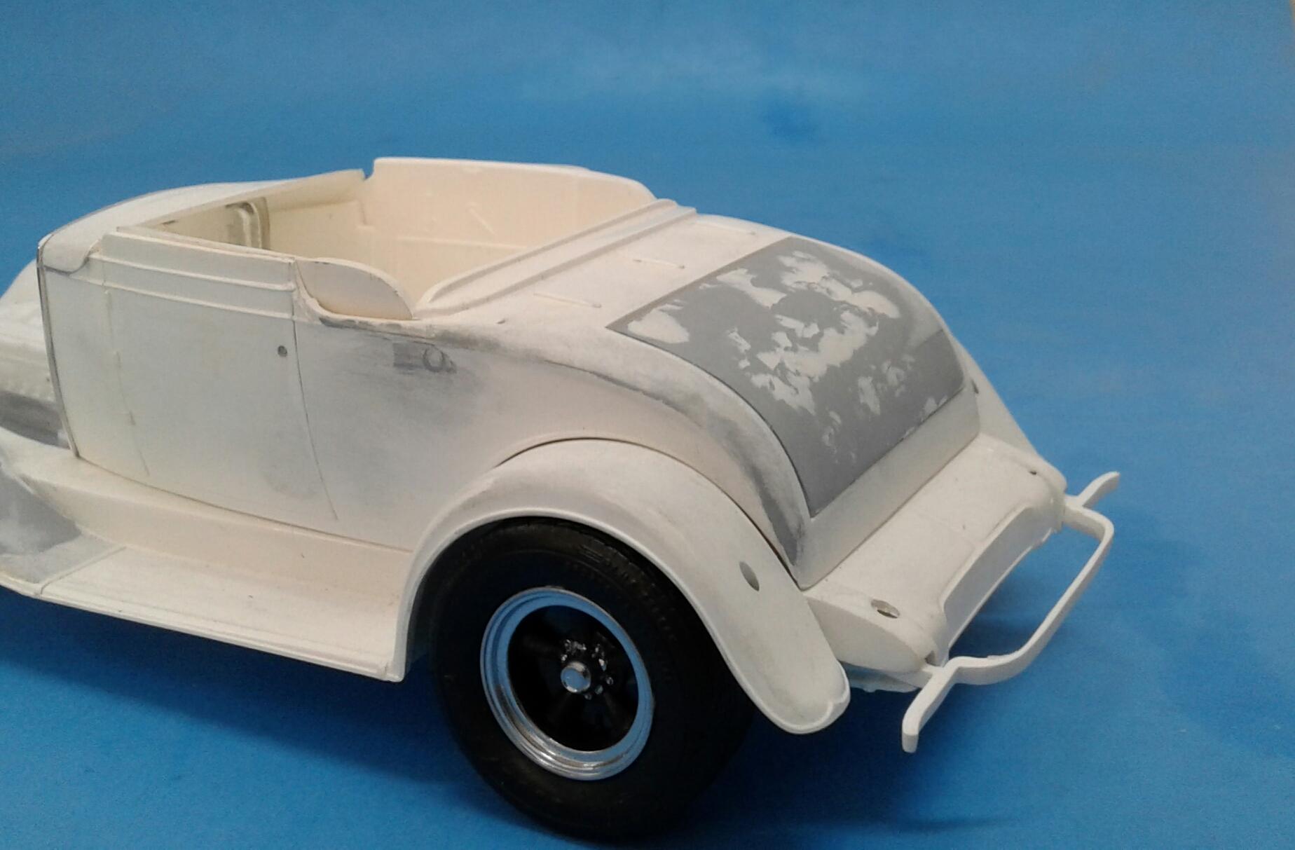

The following photos illustrate why I get annoyed with '30s models. While I was able to modify the belt and pulleys to make room for the generator, I saw immediately that I had no room for manifolds. The easy solution would be to leave the hood off or remove the sides. But, I want to be able to display it with or without the hood. So, it's back to square one on getting the engine fitted. Luckily, I have plenty of room between the engine and firewall. There was too much space between them anyhow. But, it's annoying to think you're almost there and then realize you have to start over. Which means I'll have to cut the crossmembers loose and move them back. I'm thinking the one I originally moved will go back to it's original position. On the plus side, I did get the trunk fitted to the body. But, it took a piece of .015 styrene and a lot of putty and sanding! -

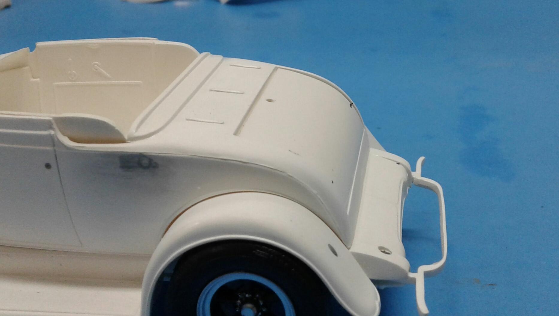

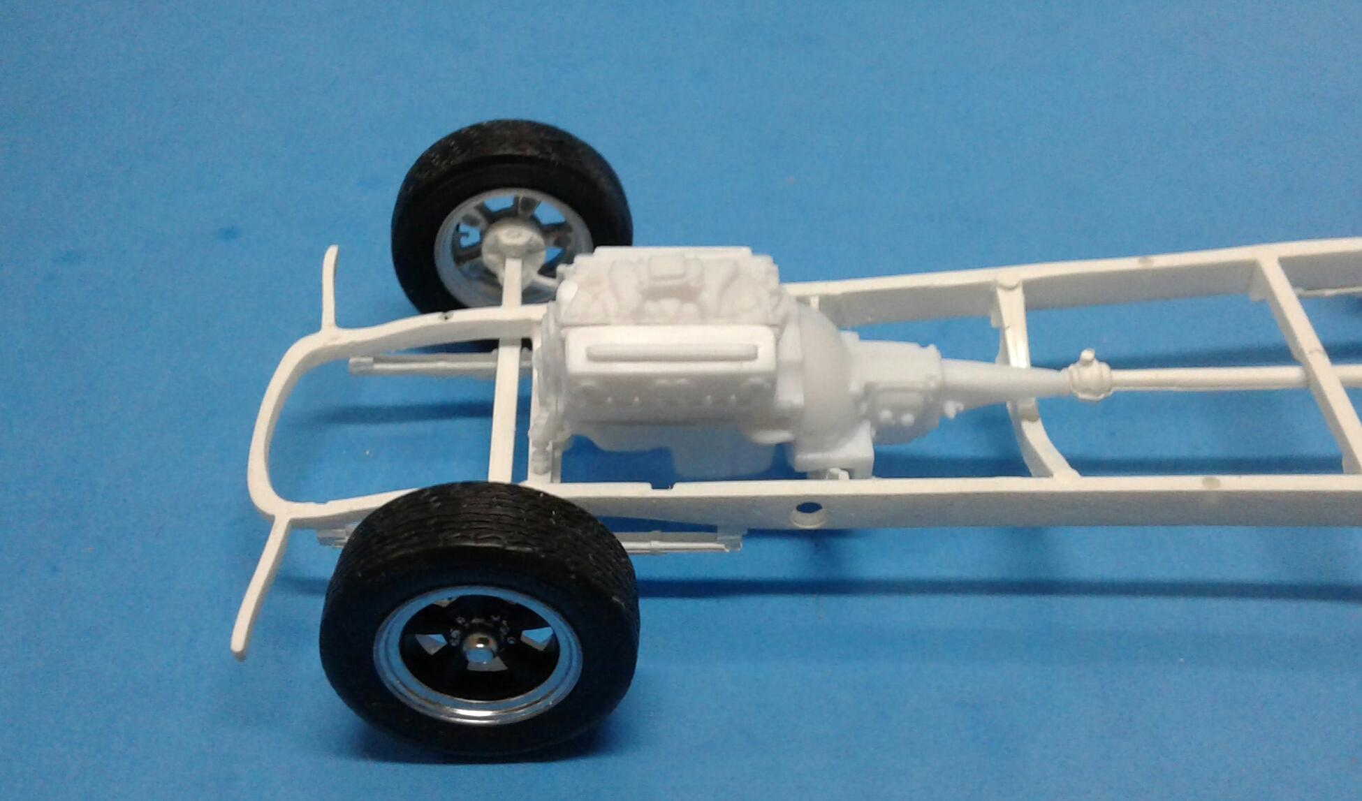

I got the engine and transmission fitted to the frame. The engine is from a Revell '57 Chevy "Black Widow". Since I still had most of the front crossmember left, I figured an early SBC with the front motor mounts would work about right and it did. All I had to do was cut the next crossmember loose, move it forward about 3mms, glue it back in and notch it to fit the bell housing. I've been doing some work to the body. I filled the two small holes behind the doors and sanded most of the body. I test fit the trunk and let's just say it leaves a lot to be desired. I'm planning on gluing a piece of .015 to it from the marks forward and putty the rest. I also have some knarly mold seams to deal with. -

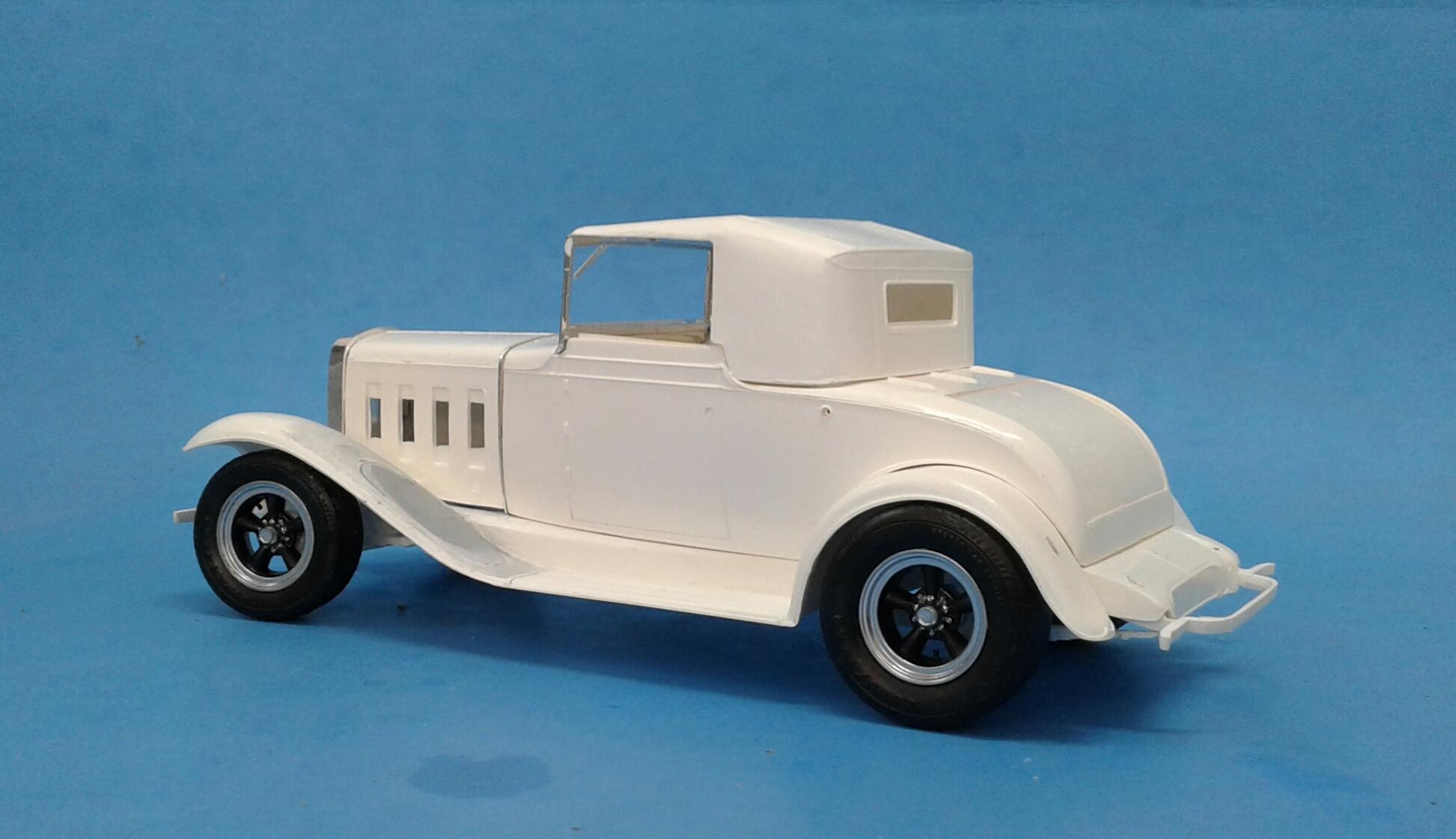

Those wheels and tires aren't traditional and don't fit the look I'm going for. I'm thinking I'll raise the rear back up just a touch. Maybe a mm or two for clearance and a little more rake. I still have a few other wheel and tire combos I want to try out on it. -

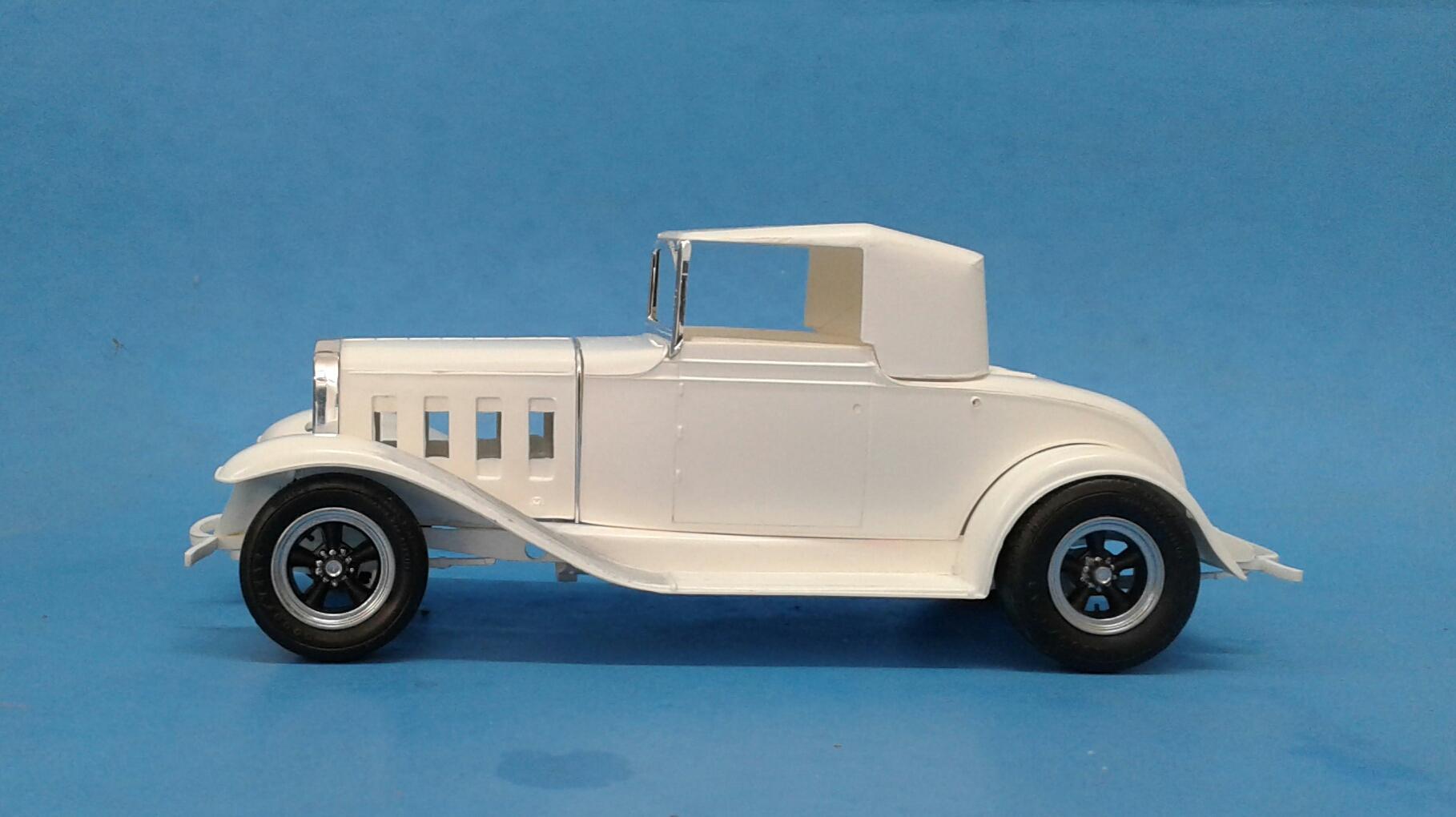

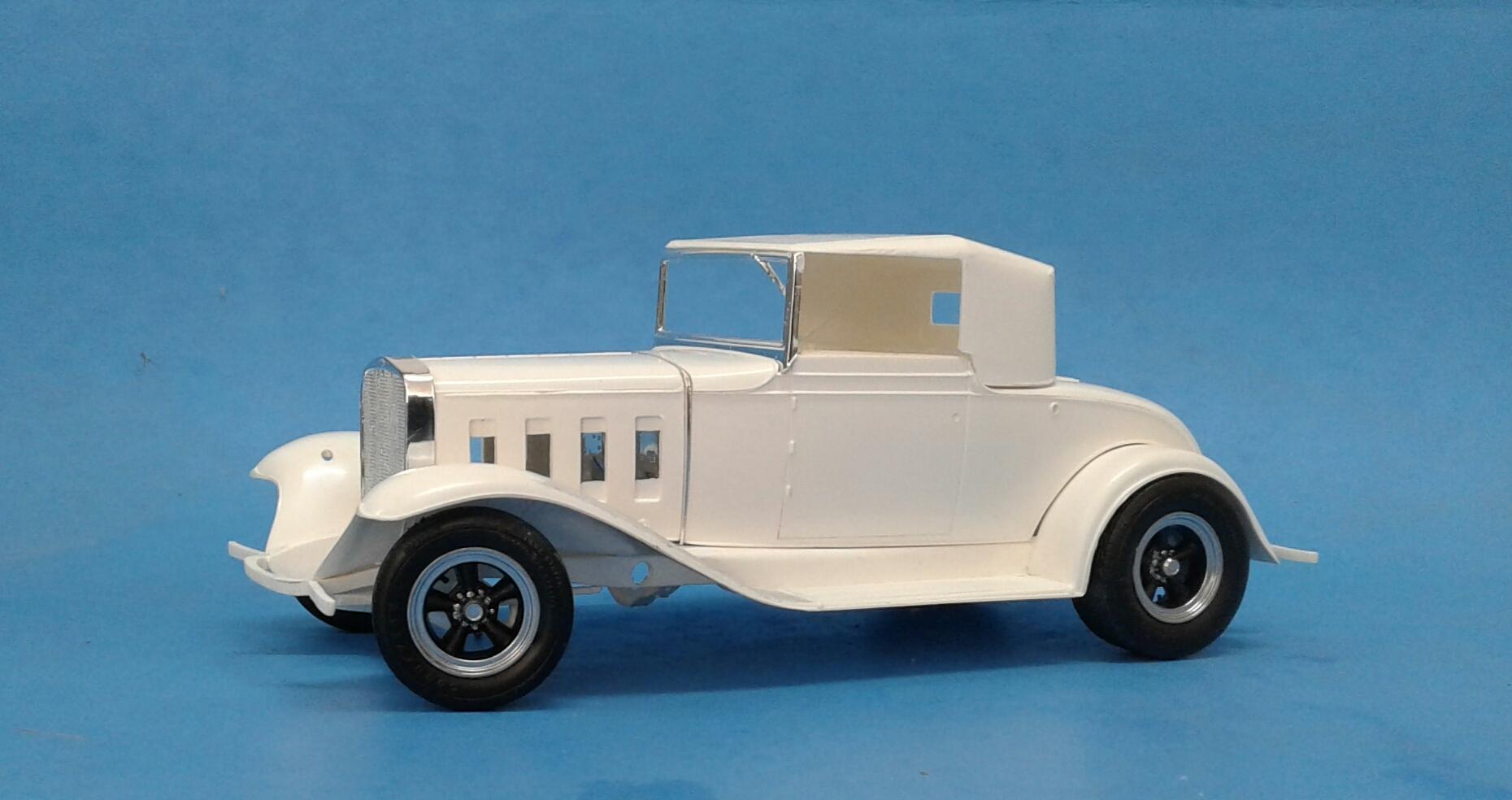

Thanx for the advice and the engine offer! I have the engine and parts picked out. More on that later. There's only so much that I can lower the front with the fenders on. I kept it simple by cutting away only part of the crossmember (for now) and doing an axle over. I had to add blocks back to the springs as the axle was resting on the frame. I now have room between the axle and frame as well as room between the tires and fenders. The stance has been improved greatly. -

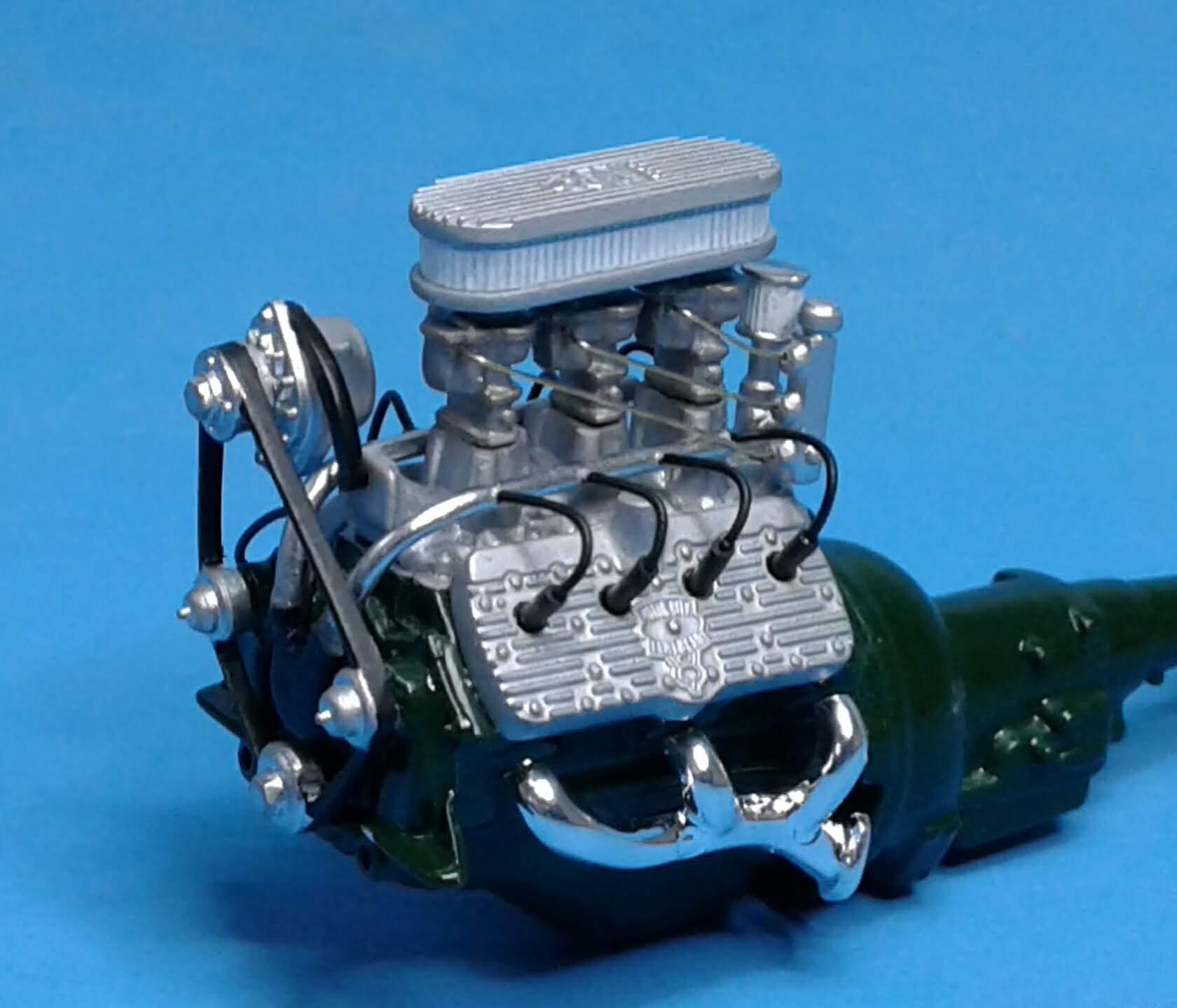

Thanx for the photo Mike! Any way to get a closeup of the center chrome tree? I'm very interested in the wheels. I can make out the chrome reverse wheels. But, can't make out the other set.

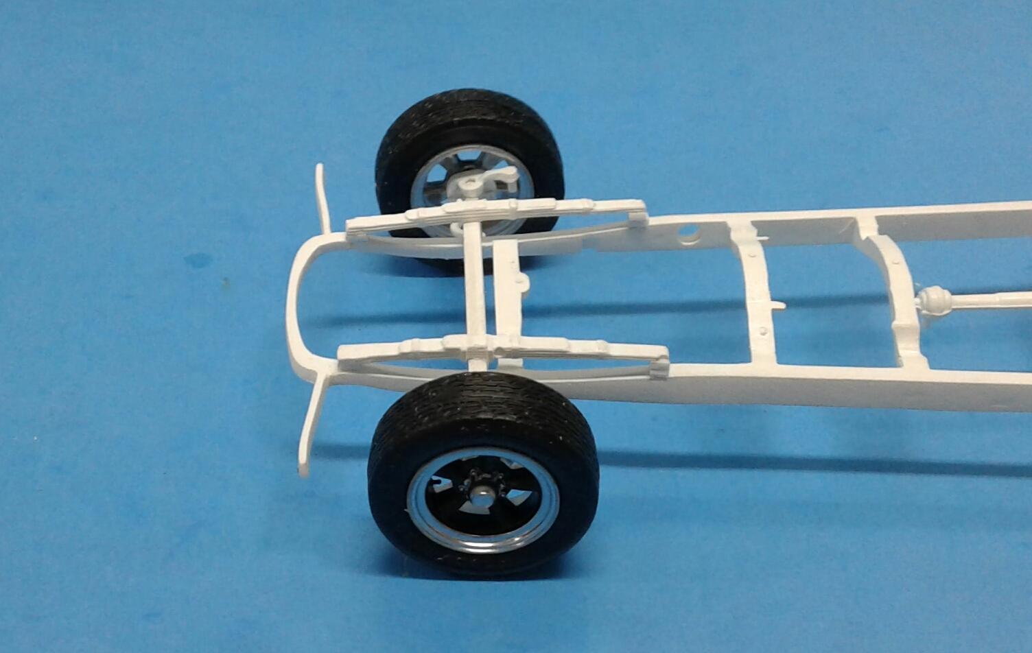

Me too! I may do a fender less highboy later on. I was thinking about doing that with this model. But, that modification wasn't going to be as simple as I thought it would be. One thing that really messed up the look is the parallel leaf springs. They just don't look "right" being exposed IMO. Here's my problem with lowering the front end. That crossmember is in the way. Since the only purpose it serves at the moment is mounting the six cylinder, it can go. That's the plan anyway. I think I'll have to change the way the axle is mounted. Looks like I'll have to do an axle over conversion and probably have to raise the springs or re-arch them. This could get tricky! -
So far this year, I've fizzled out on five projects. Squirrel! That seems to be my issue. Anyway, I've had this idea in my head for years. Everyone and their brother, sister, aunt and uncle has built a '32 Ford at some point. But, what about a Chevy? Nope! You rarely see them. Even the full scale is poorly represented. I like different cars and prefer them over the usual. So, this model should be a perfect fit. We'll see. After mulling over how I wanted to build it, I decided to take the simple approach and build something that could have been around in the '60s or early '70s. Hence the traditional-ish. About the only changes I'm going to make are going to be simple. I hope. I have bad luck with making a lot of changes to a '30s model. So, I'm to try to restrain from making big changes. I definitely want a SBC in place of the six cylinder. Haven't decided what transmission I'll use. I want it have three two barrel carbs and the rams horn manifolds. Right now, I'm drawing a blank on where to come up with the intake and carbs. So, if anyone knows, please clue me in! So far, I've been cleaning up the chassis and assembling it to get the stance set. It still needs work as the photos show. I had to get rid of the spare tire wells on the fenders. I also clipped off the cowl lights from the firewall piece. Kinda surprised that the firewall is chromed. I'll get it stripped ASAP so that I can glue it to the body. I have the tires picked out. The current wheels may or may not make the cut. The rear is right where I want it. But, I've got to lower the front and that's going to take some work. I'm going to attempt to keep the poseable steering. But, willing to sacrifice it. Much better without the spare tire wells! I think I'll make a trunk for the rear instead of a rumble seat. Or I may keep it. I'm also undecided about the bumpers on whether to keep or can them.
