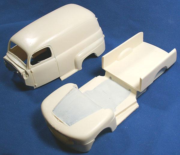

Resin Body Pin holes
Plowboy replied to Len Woodruff's topic in Model Building Questions and Answers
That's odd. Tamiya white is quite thin for putty. I used Squadron white which is a lot thicker and had no problems. -
I had a resin body that seemed like it had a thousand pinholes in it. At the time, I shot a coat of primer over it and used the white Squadron putty. Today, I would use Tamiya. It's held up well over the years. But, it did take a lot of prep work to get it smooth. You'll definitely want to use a guide coat (different color) on your primer and be prepared to do a lot of sanding. -
