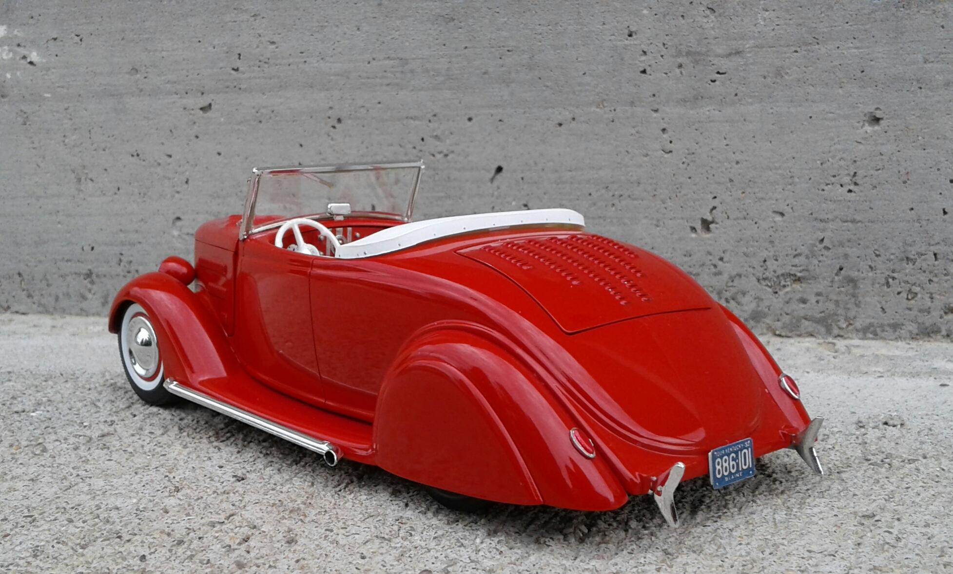

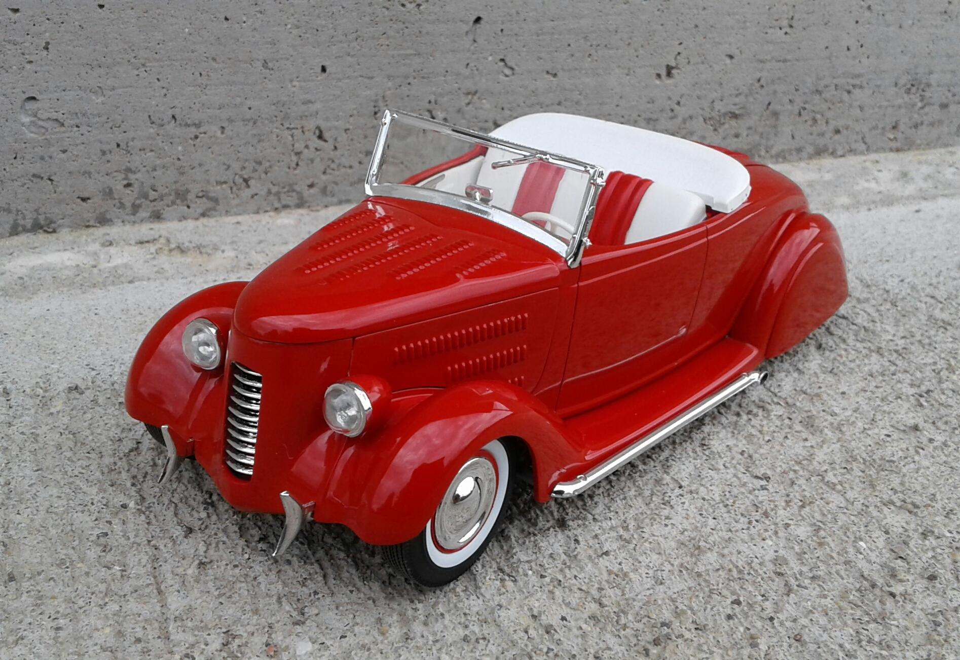

Your chop work looks good Jim! I built this kit around three years ago. I converted it to a three window, gave it a three and a half inch chop and three inch section. The only issue I had with it was getting the rear wheels centered. First mockup, it was 3 mms too forward. I moved the crossmember back 3mms. It was 1.5 mms too far back! Moved the crossmember forward 1.5 mms and finally got it right. What I learned from that ordeal was that the placement of the rearend is very sensitive to the angle of the pinion. Some members reported the same issue. Some reported no issue. It's definitely something to get worked out beforehand!

This model has resin copies of of the pieces I mastered using the technique I mentioned earlier. The hood sides were done differently. I did a tutorial on the TRaK forum if you want to look it up. How different are the '34 and '36 trunks? I think I have an extra resin trunk around here somewhere.
I've done louvers a few times. But, not on resin. Only difference is the glue. The way I do it is graft the louvers from a panel that has them onto the panel that doesn't. I cut each individual row of louvers. I place the row of louvers onto the panel, trace around it, cut out the section and glue the row of louvers in. Then repeat the process until done. The toughest part is sanding between the rows of louvers. I made a sanding stick from sprue with sandpaper glued to it.

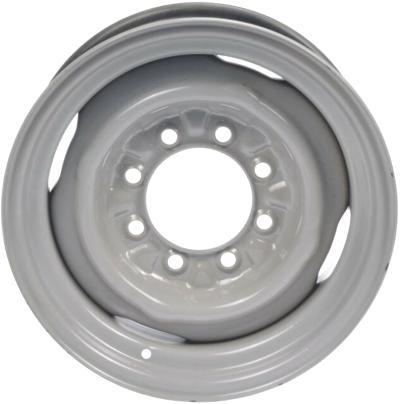

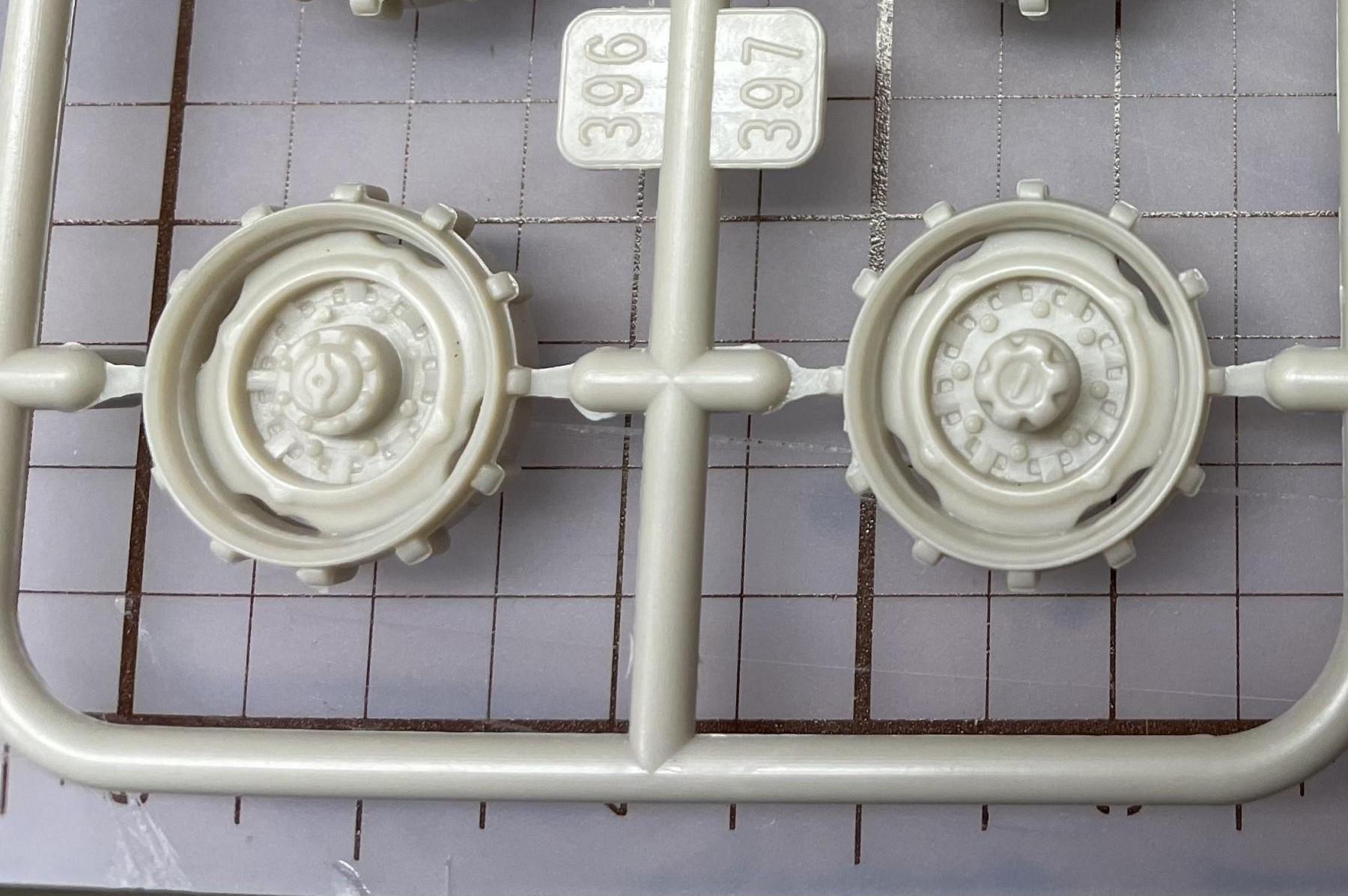

Moebius didn’t do very well copying his wheels. Or the Ford wheels for that matter. Ford eight lug wheel. Fireball wheels and tires. Moebius. It's pretty sad when you can't even get a wheel right.
