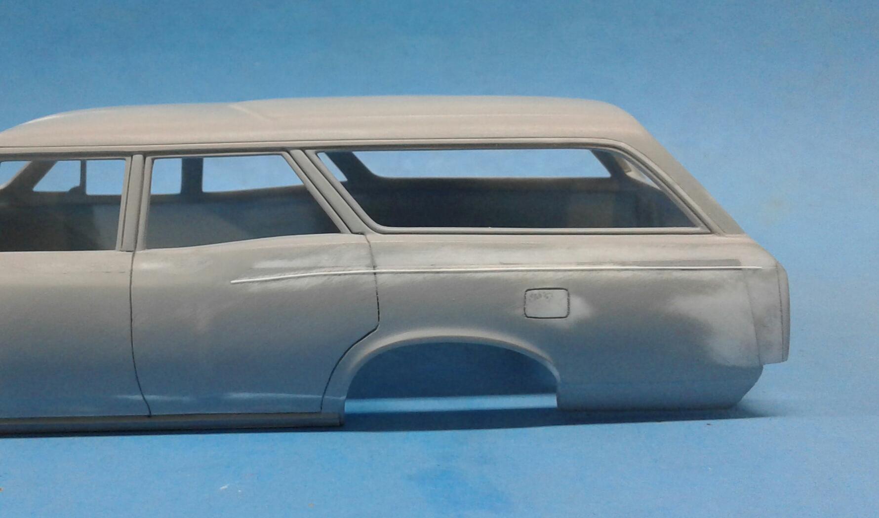

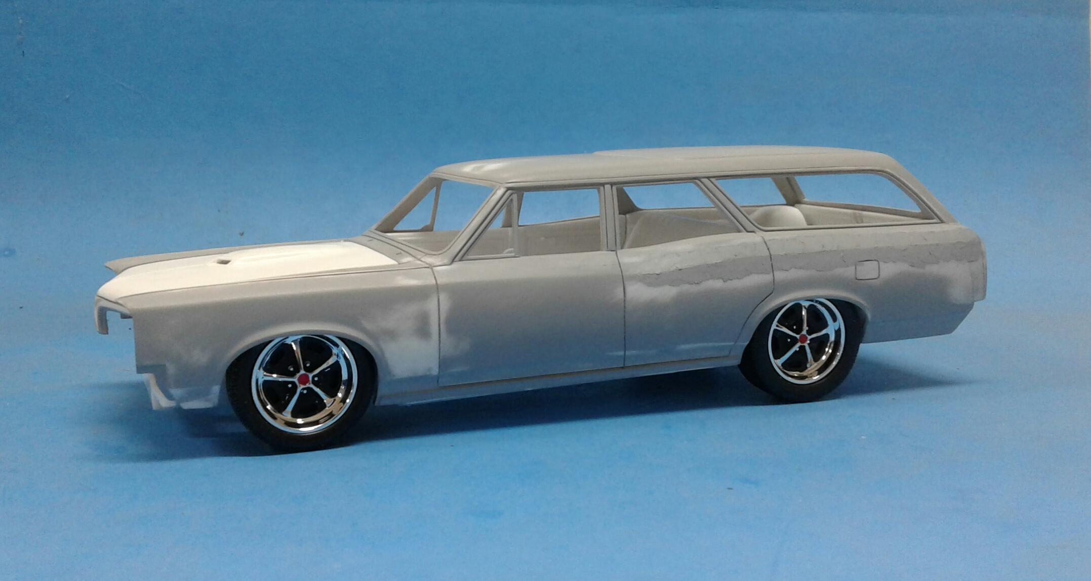

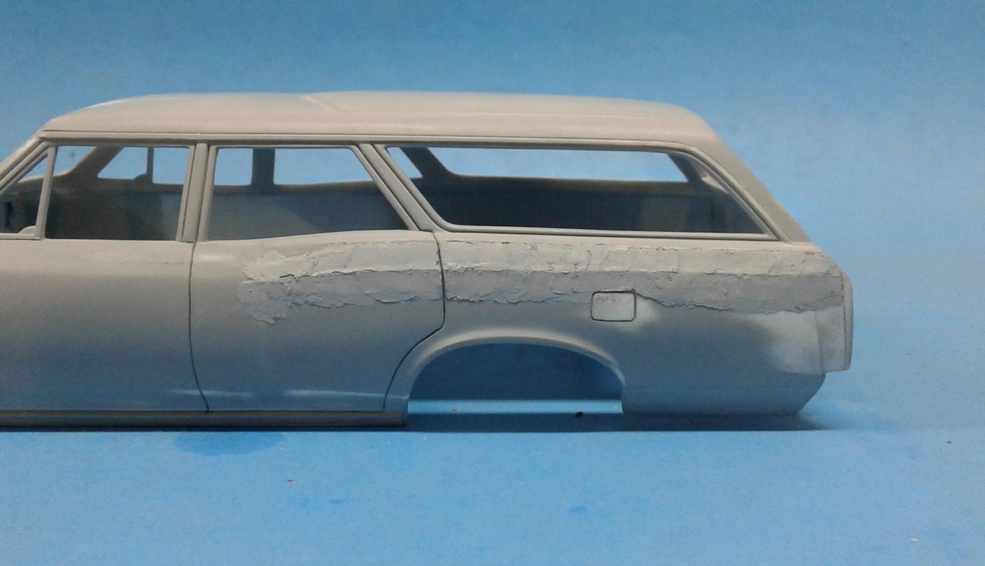

Something that's been bugging me with this model was the quarter panels. They didn't have that definitive line toward the top like it should. So, I decided to fix them. I first sanded the area back down to bare styrene. Then I took a length of .010 styrene rod and glued it where I wanted the line to be. Once it was dry enough, I cut through it at the door line and puttied it in. Even in this rough stage, you can see the line it creates. I also found a new set of wheels and tires for it. These are from the Foose '67 Coronet. To me, they suit it perfect! I just gotta modify the wheel backs so that they are see through. I thought I could use the wheel backs from the other wheels. But, these are designed completely different. More on that later. Something else that's bugging me are the tail lights. Kinda doesn't make sense to me to have the rest of the body right and the tail lights wrong. But, they're definitely not going to be easy to replicate. Gonna have to some siphering on that one.

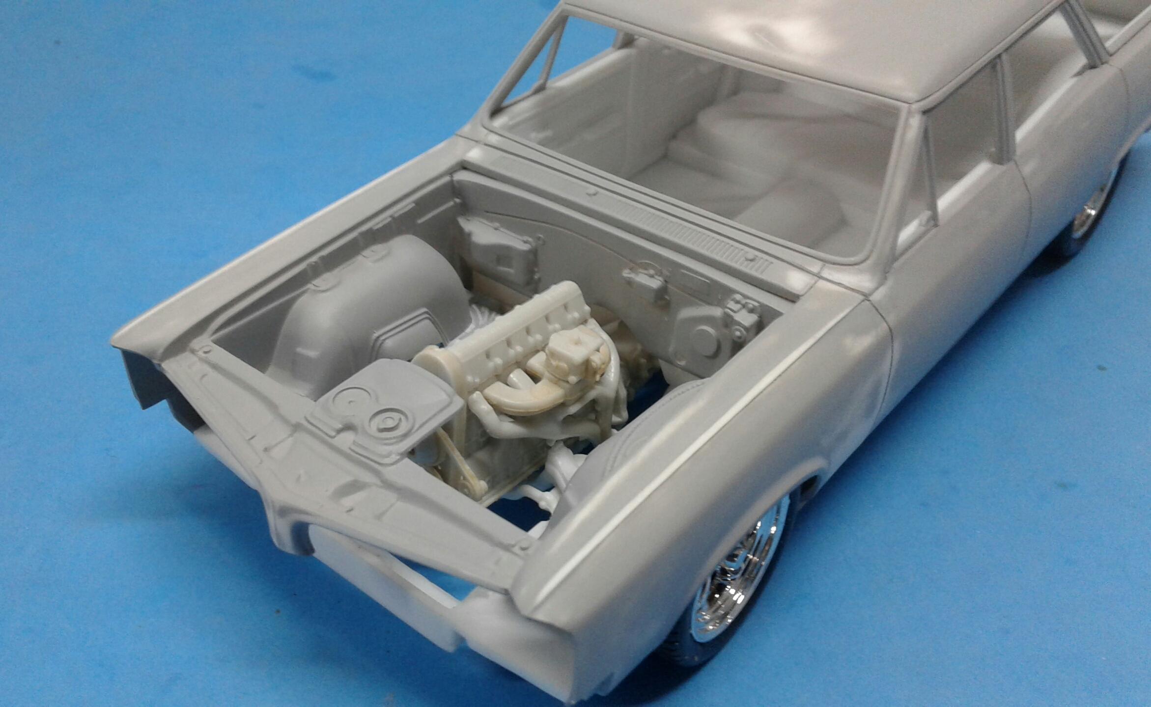

The six is out and the 5.7 LS is in! Much better than the six cylinder! I had to do a little trimming here and there to get it to fit nicely. But, now it fits like it should and has plenty of room between it, the radiator and firewall.

I've decided to can the OHC six cylinder. I made some motor mounts for it and got it fitting well. But, it just doesn't work for the look I want. I don't think a turbo or supercharger would help. I'll stick it in something else. I found an LS from a '98 Corvette in the stash that I'll stick a four speed behind. I tried a five speed. But, it wouldn't fit without hacking up the transmission tunnel. I don't want to get into that. I'm planning on also using the radiator and dual electric fans from the Corvette.

The engine in the '69 Firebird kit is the Sprint OHC. I got the engine tacked together enough to do a mockup with it. It fits fine. It just looks so swallowed in the engine bay. In one way, it's cool. In another way, it's lame. Definitely something different!
