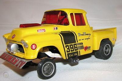

I saw a built model of one. It was cool as all get out! Found it! I think the Cameo bed would work better so that the Badman could go above the rear wheels.
It's pretty obvious. The decals have two 327's on them. Look where the front wheel opening would be on the flag decals.

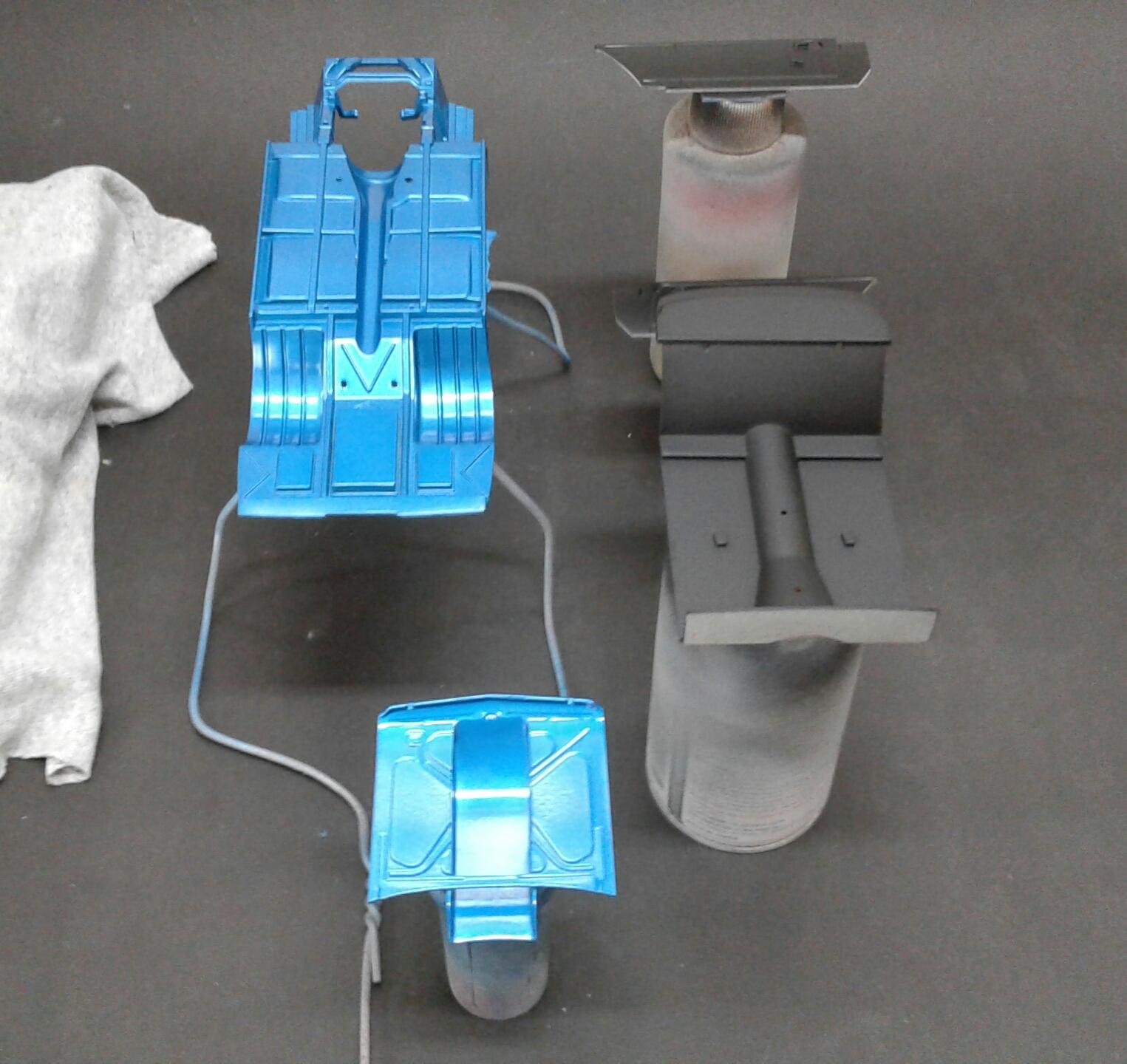

I'm back on this one for a minute. Hopefully, until it's done this time around. I was able to steal a bit of time and was able to make some pretty good progress. I have the chassis, floor pan, door panels, dash, roll bar, underside of the hood, engine, radiator support and rearend in paint. I'm hoping I can steal enough time to get the body and hood cleared too. We'll see. I still have to paint the tops of the door panels body color. But, I have to wait until the satin black is dry. I also have to pick out a pair of seats. I don't like the seats from the Moebius kit and the Nova seats won't work either. -
Looks like it has both the "Badman" and the street machine wheels and tires. I don't remember the rear slicks sticking out that far though.
I doubt it. More than likely, they're the same slots that always came in the black street machine version.

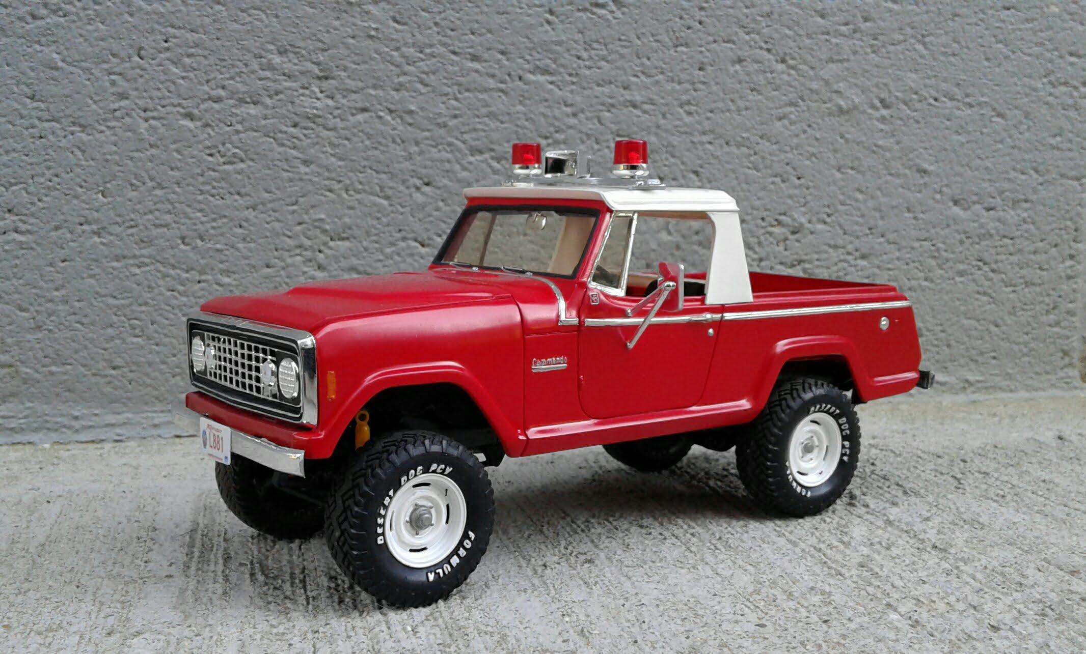

Yours may have came with the Desert Dogs. There could have been a mid run change or something. Are your tires like these?

The Model King version came with the Firestones. The box art builds have the Desert Dogs on all three of them. But, it actually came with the Firestones. It also didn't come with the stripes that are shown on the black version. I was disappointed when I opened mine up.
