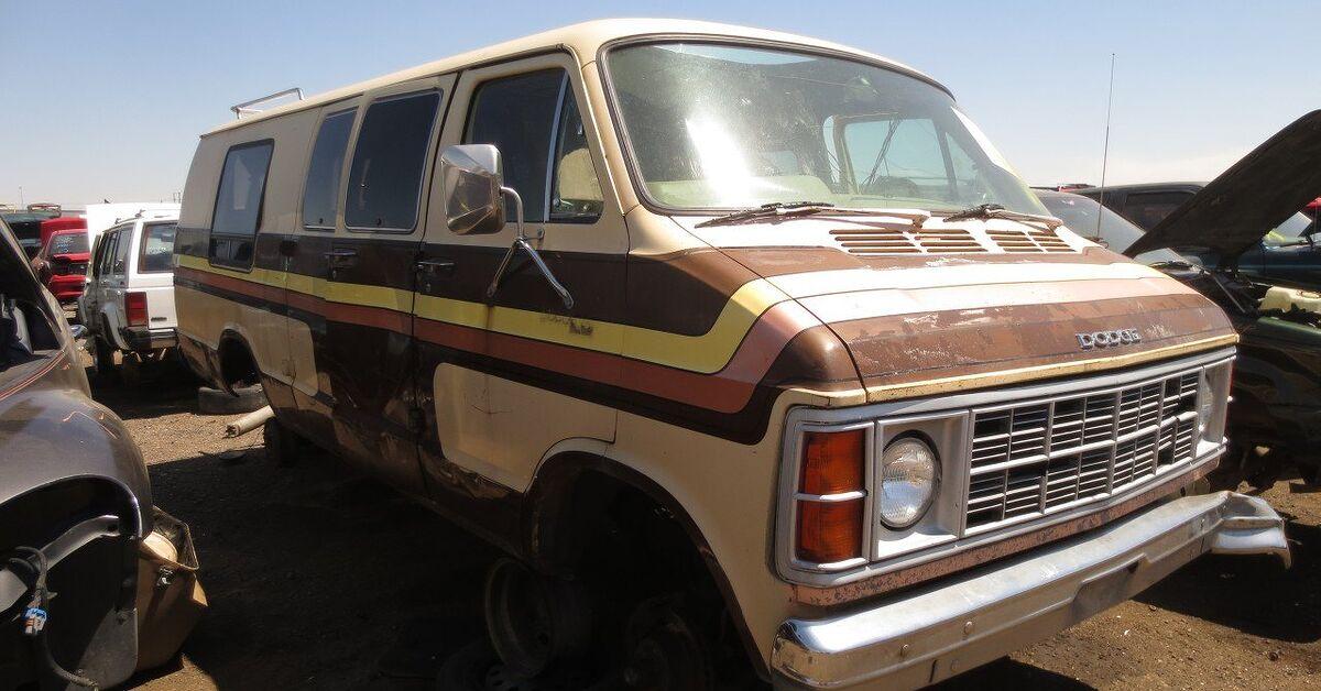

Here you go. I remember everyone slamming this model because of the round headlights in the newer grille. Turns out, the '79 Dodge van had a round headlight grille with the markers and signals on the corner. It's still not an accurate grille. But, these prove that the newer grille did come with round headlights in '79. The AMT grille looks like they just added the markers/signals to the '78 grille.
