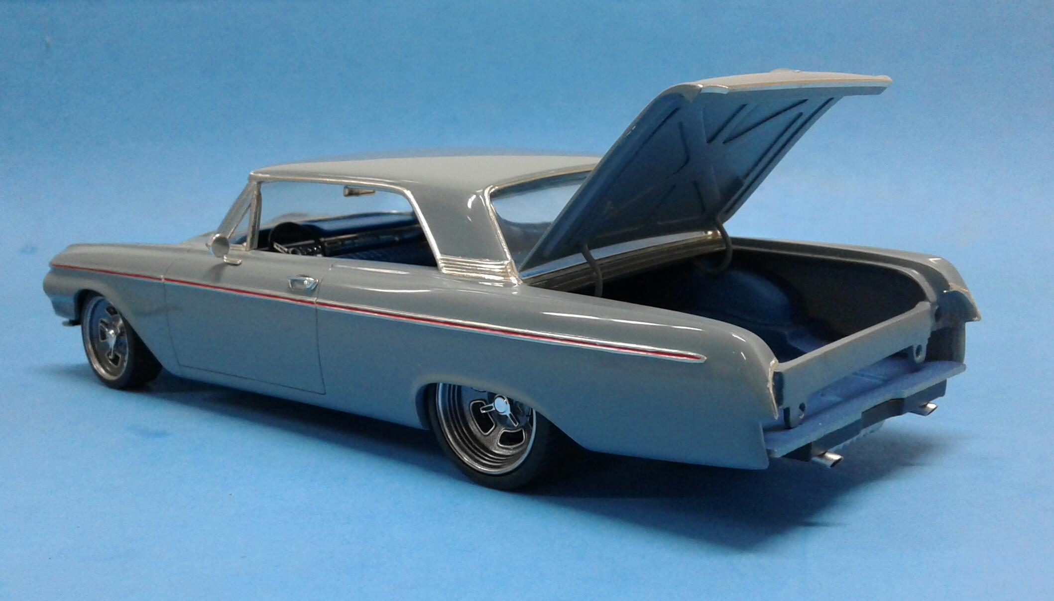

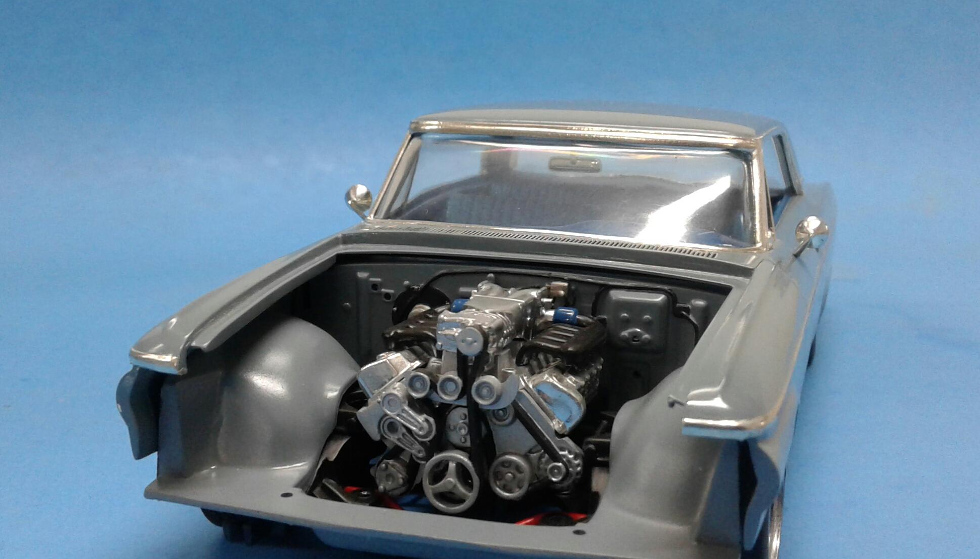

'62 Ford Galaxie 500 Update! 12/23/22 Finally Done! Pic pg. 7
Plowboy replied to Plowboy's topic in WIP: Model Cars
I finally got the body ready to go onto the chassis and interior. But, I have a bit of a fitment issue. The interior fits the body just like it should. But, for some reason, I have a pretty big gap (1mm+) between the firewall and the body. Not good! I think it may be the dash and windshield not getting along. So, I'm going to remove the dash and check the fit again. If that's the issue, then I gotta figure out which one to trim down. I think I can cut the windshield down a little more. But, I need to remove it to do so and I have it glued in pretty well. It may come loose. If I can't get it out, I'll see if I can drop the dash down a bit. Besides that issue, everything fit great! My trunk even works like it should! Once I get my fitment issue resolved, it shouldn't take long to get it finished. -
