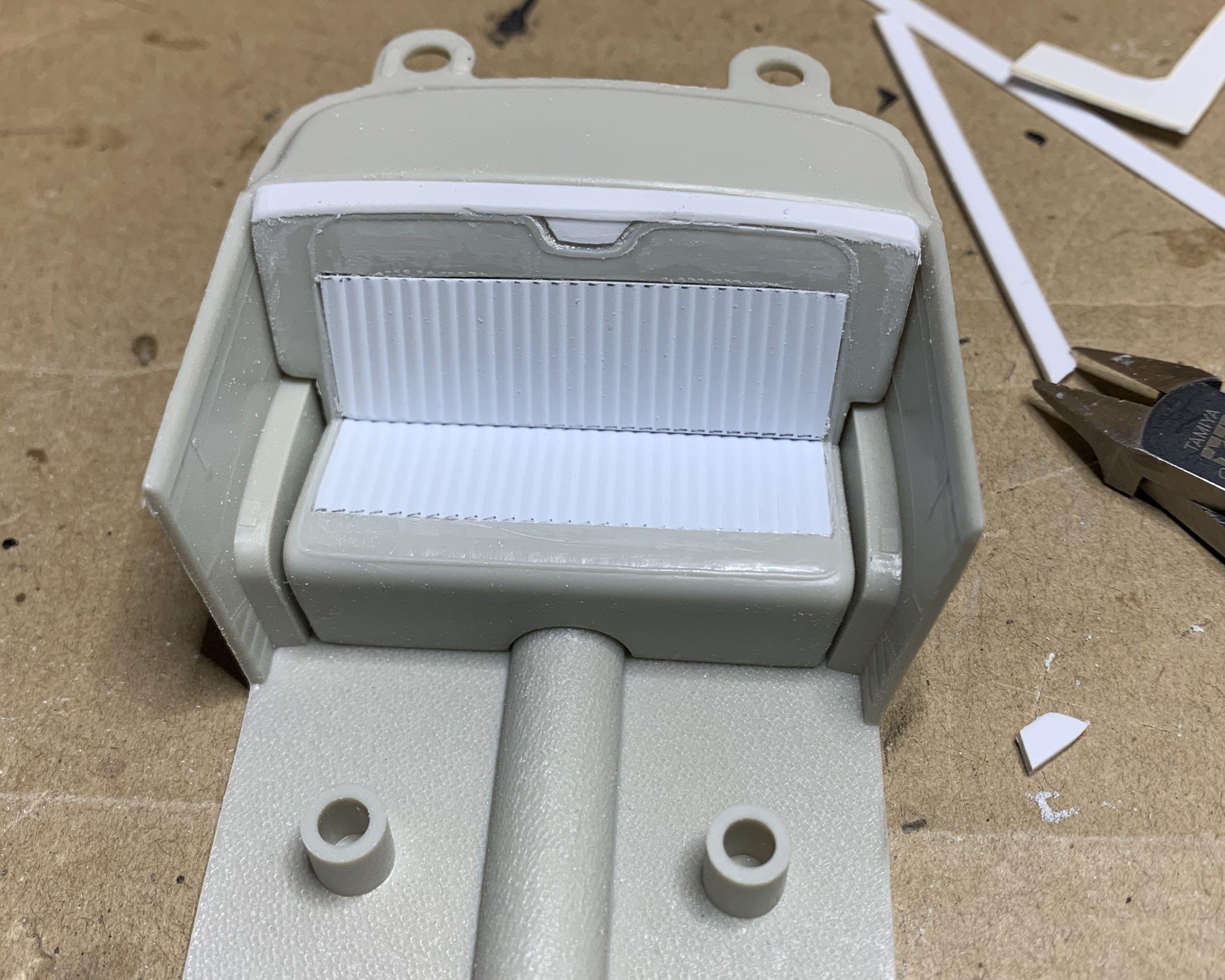

The tub was quite warped. I cut a vee groove where the front seat will cover and glued a wedge then secured it with these side pieces.

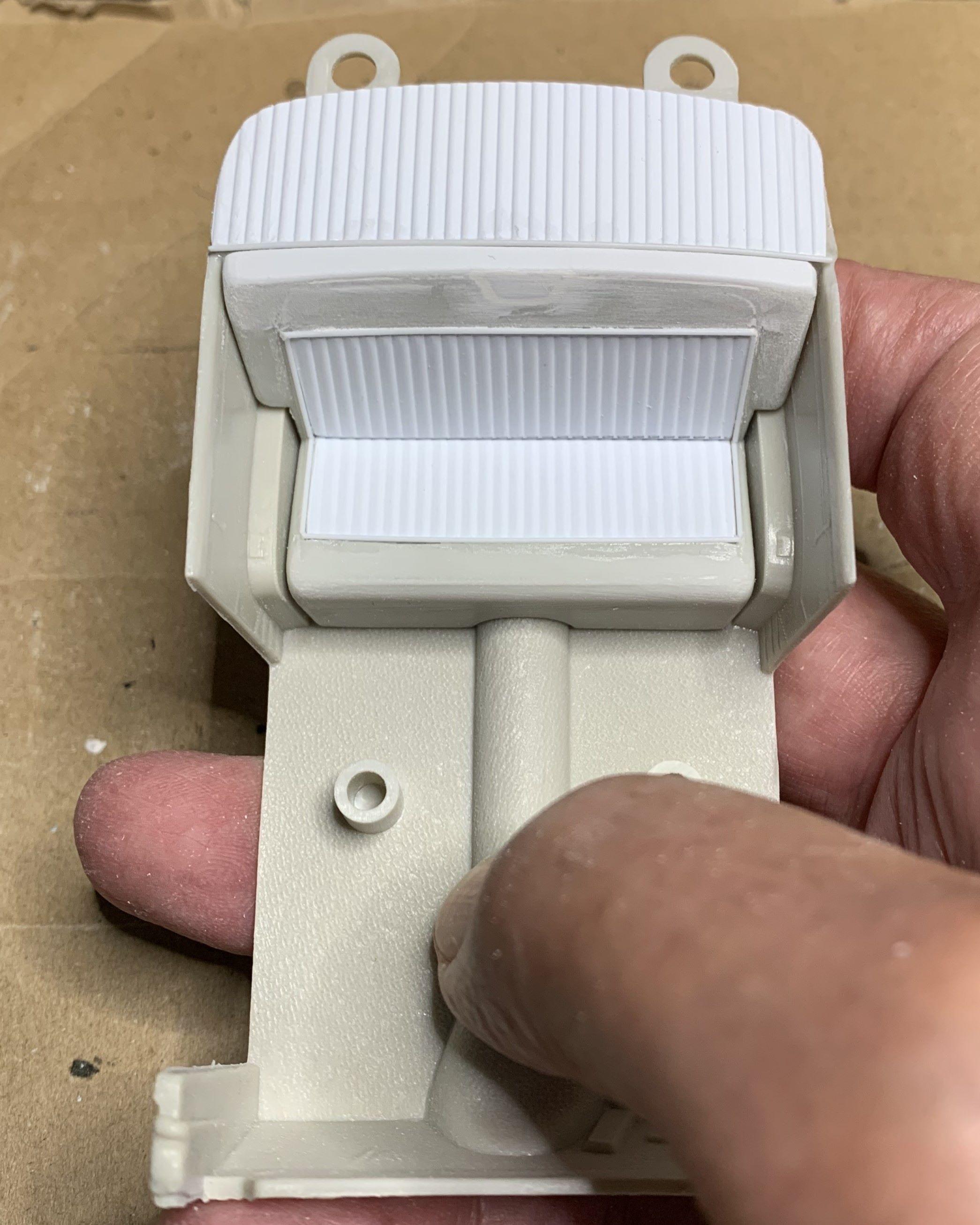

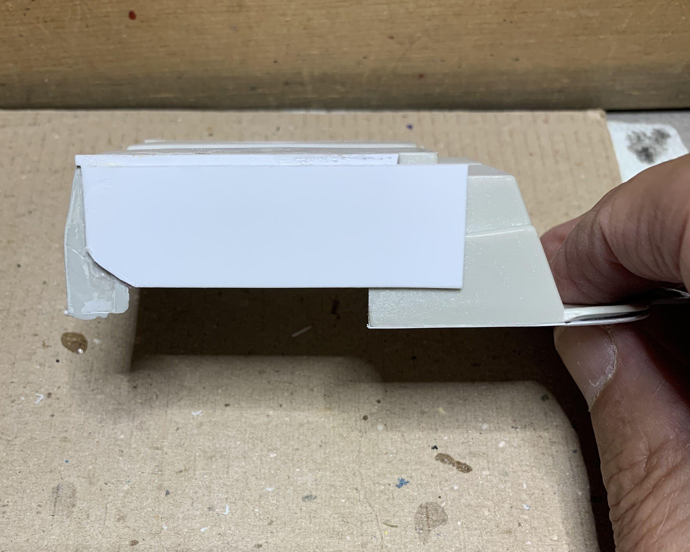

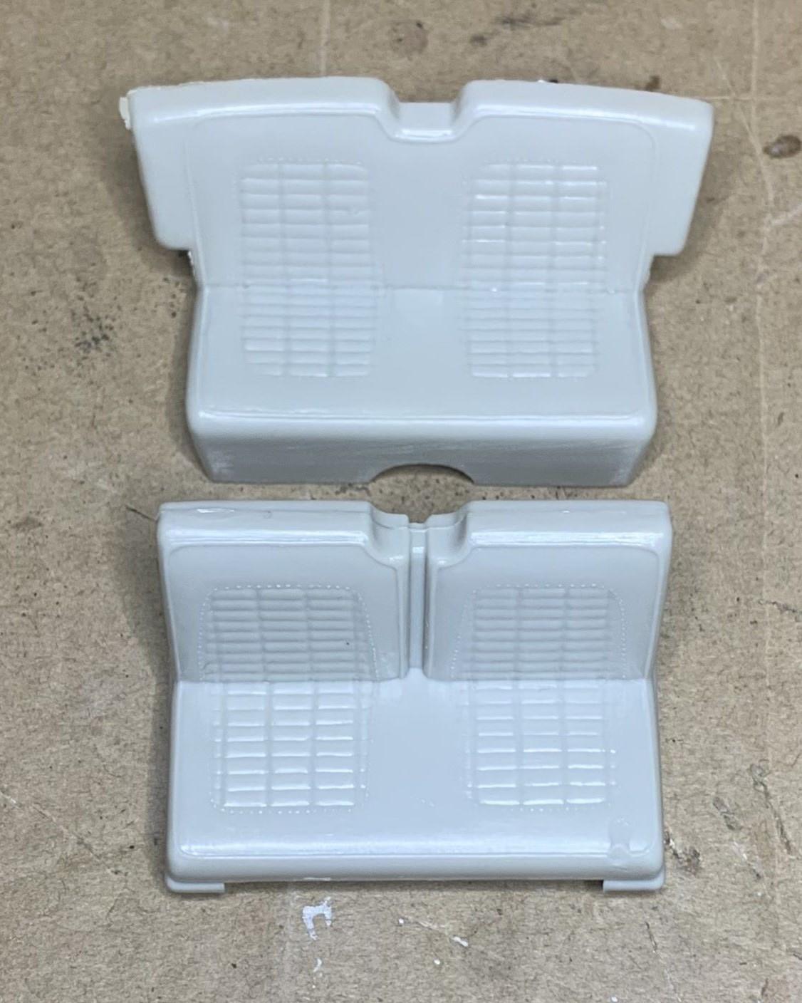

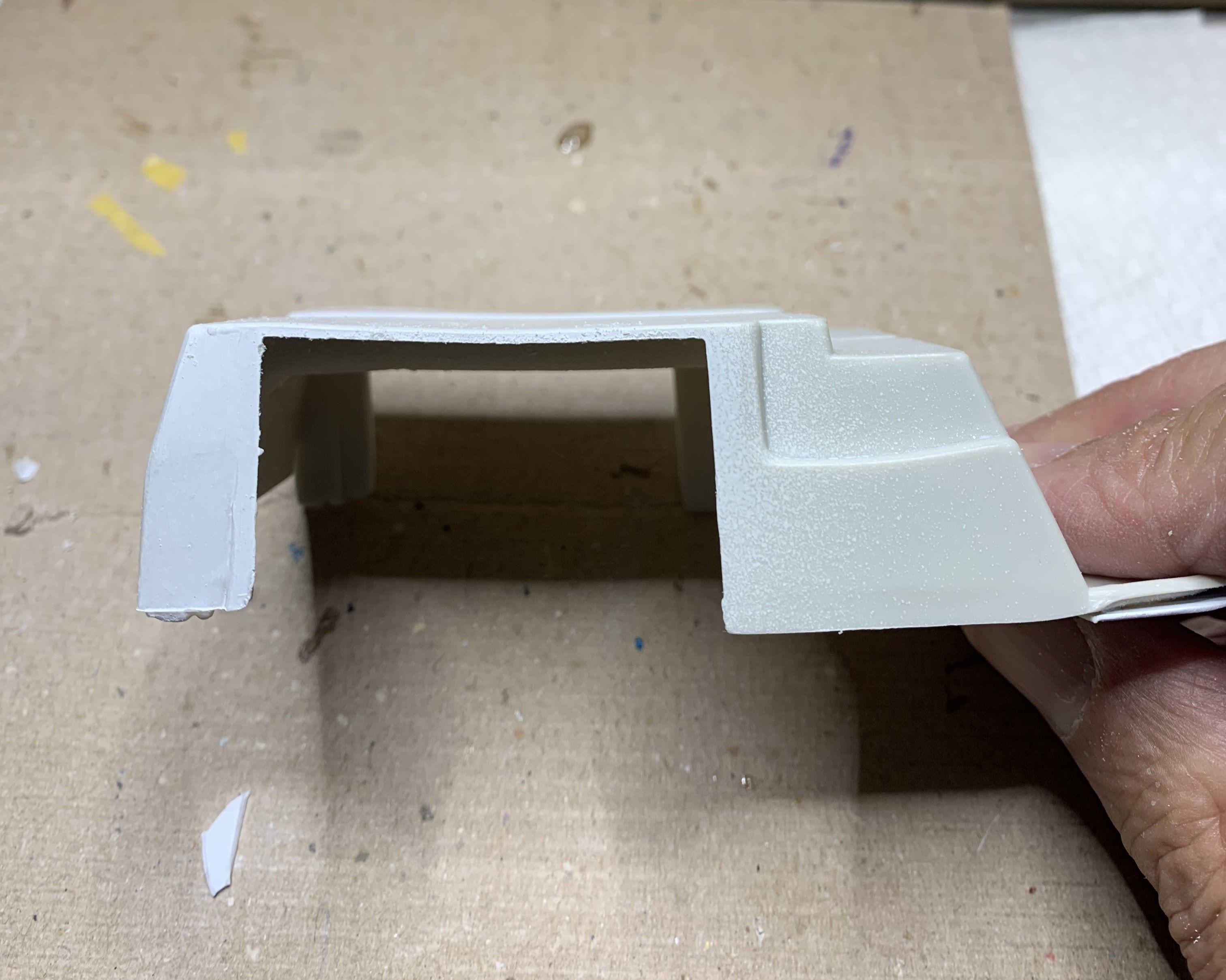

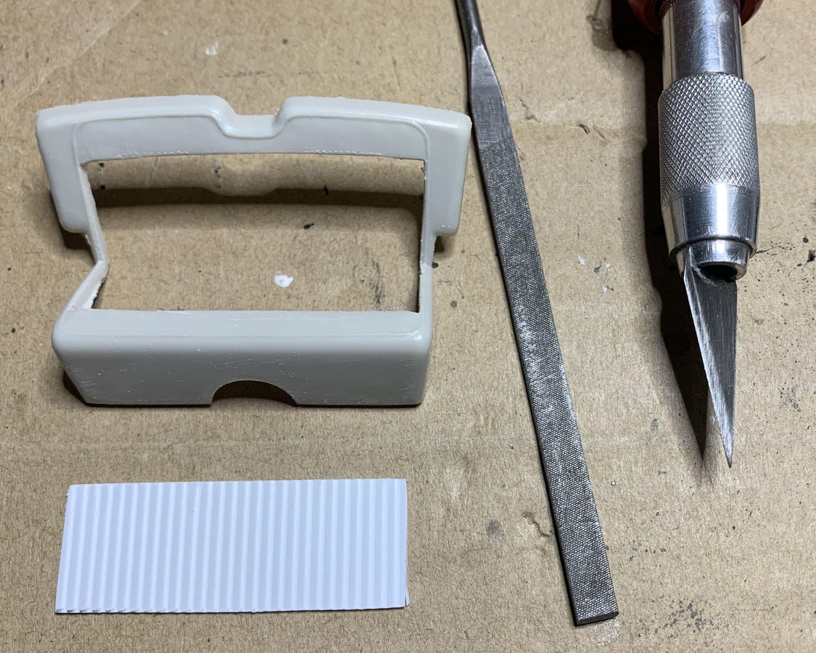

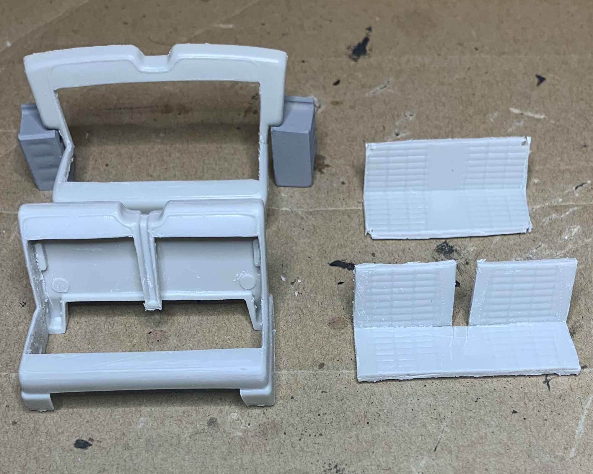

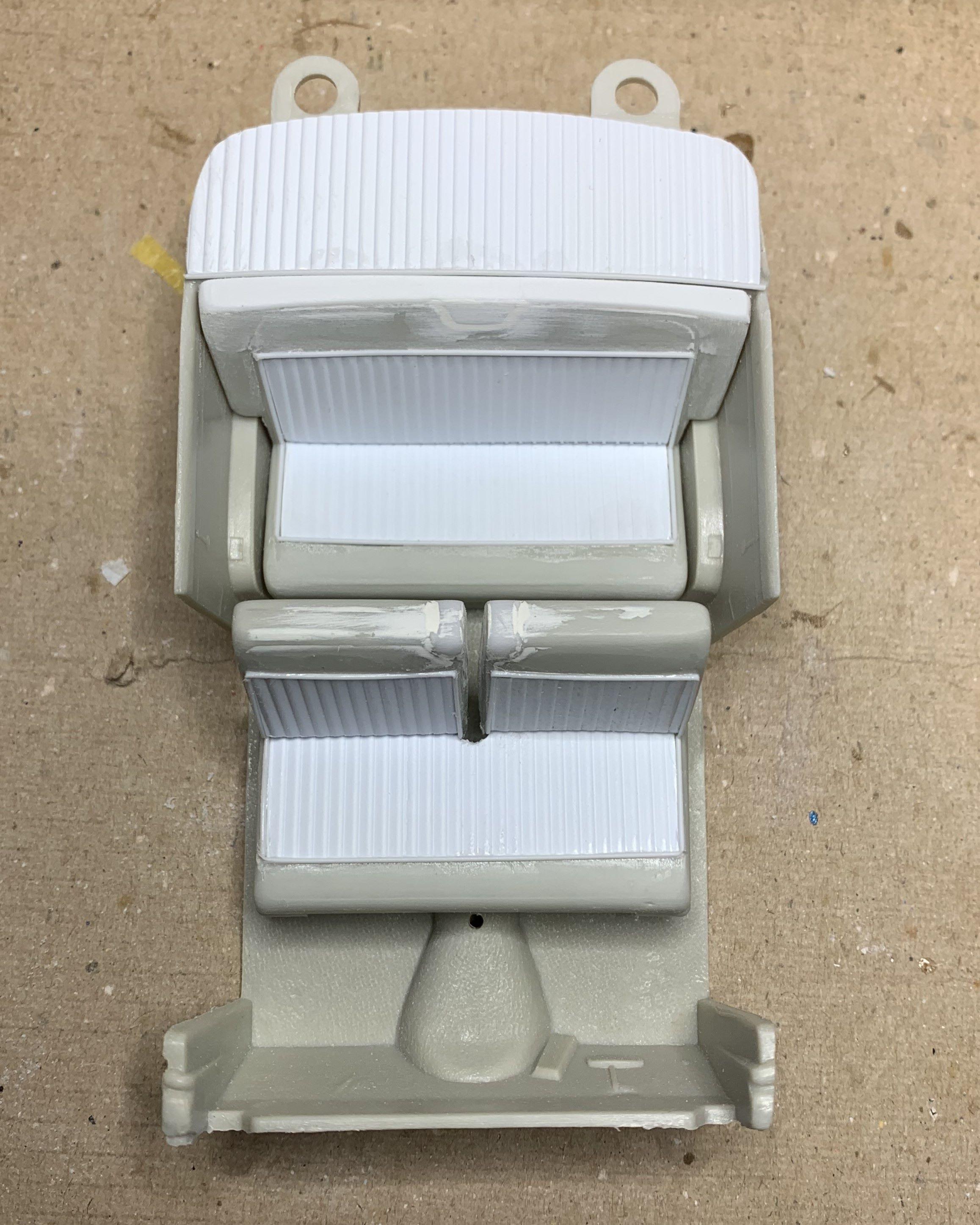

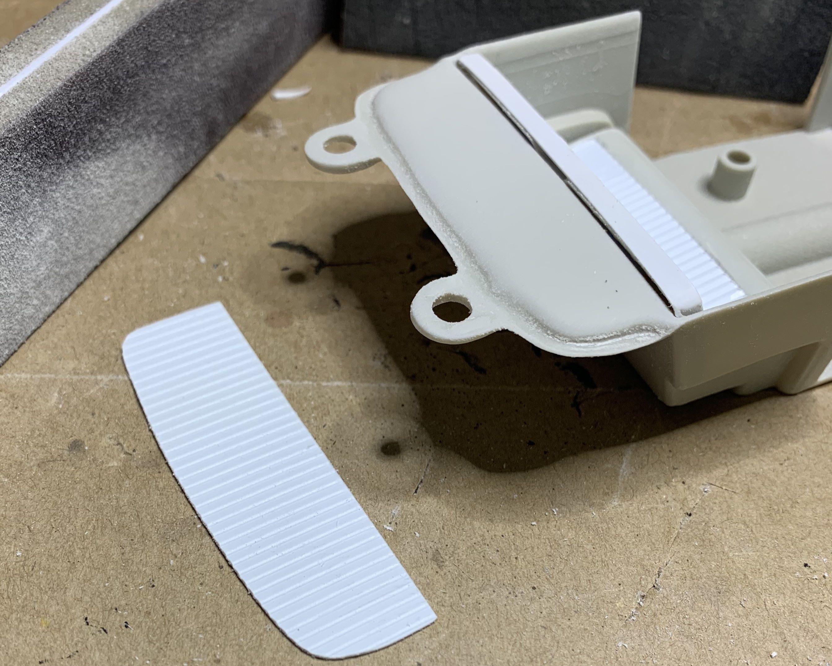

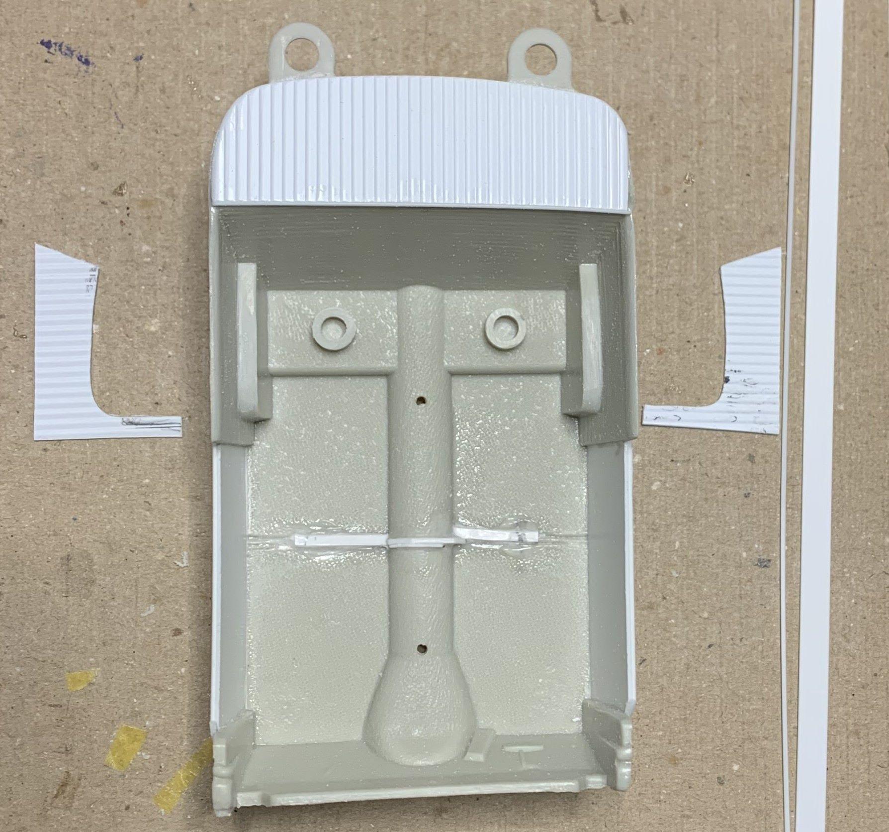

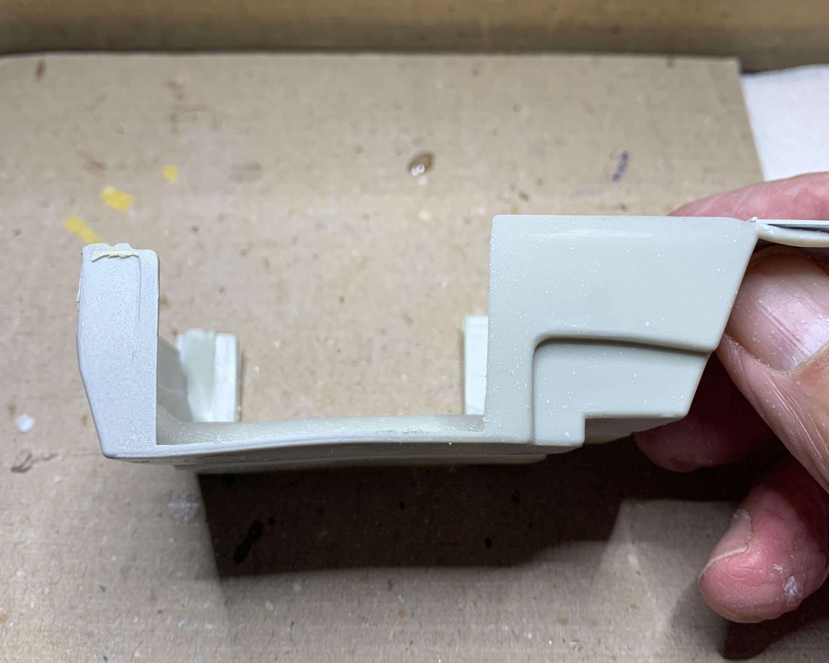

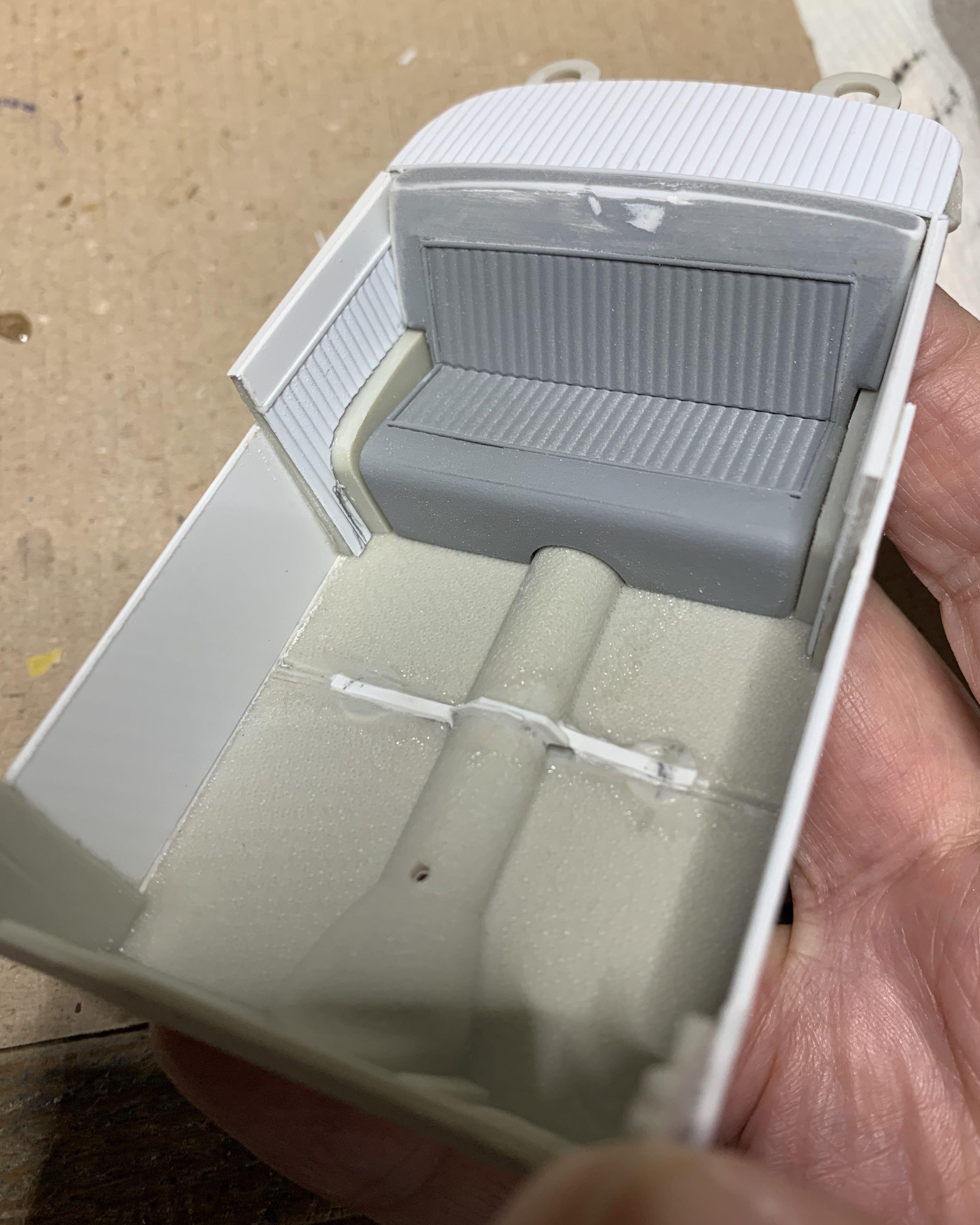

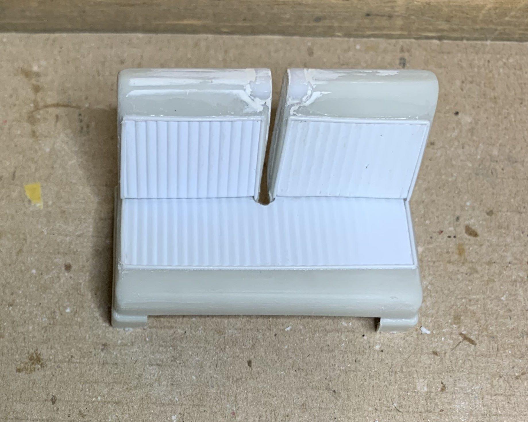

Started the '56 Ford interior, 9 pictures: 1: Here's the kit seats. 2: I want a simple rolled and pleated custom interior, so I cut out the stock upholstery. 3: Here's the "rolls and pleats". 4: I also eliminated that dip in the seat back top. 5: Then I thinned the package tray so my added styrene wouldn't stick up too far. 6: Here's how the package tray lines up with the rear seat now. 7: For the front seat I added styrene to the center because I was going to cut down the middle of the seat back. 8: Looks much better with the seat back separated. 9: Here's just a look with both seats together, not glued in of course. I still have to modify the rear sides and door panels, prime, paint and flock, before I can glue the seats in. Cheers!
